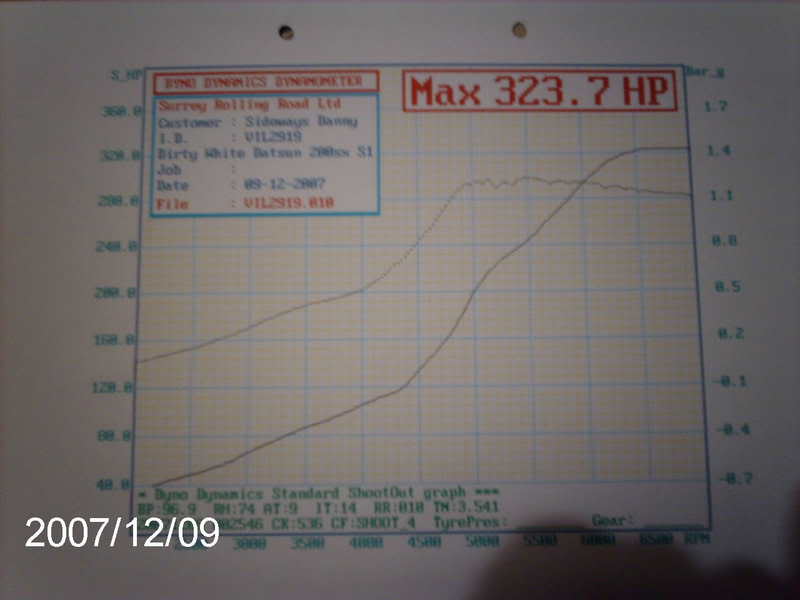

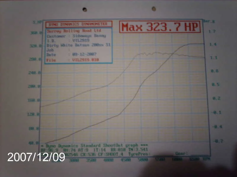

Yep. It's actually already doing that at the moment. The RR graph shows it dropping off (although I can't remember at what RPM). It should drop off a bit higher up the rev range with more boost but it will still drop off nonetheless.
Do you know why it drops out of interest?
compressor efficiency. There comes a point where the turbo can only flow so much air. you can tune some of it out with electronic boost control, which holds the wastegate shut longer if properly setup. Remember though, boost isn't directly related to power, and it's not even directly comparable between turbos of different sizes, a larger turbo will flow more air at a lower boost pressure. Just because the pressure is dropping off, doesn't ALWAYS mean the power follows the same trend
DMS
  A thirsty 172
Re: Ben_stevo172 - Supercharged Monaco 172
Ah. Like so... ?
  ITB'd MK1
yeah kind of. Boost is just a measurement of restriction at the end of the day. It tells you how much air the engine can't use. If the boost is dropping but the power isn't it just means that engine is working more efficiently and using what is't being fed. That's actually a pretty good boost curve. Hold on and I'll dig out mine

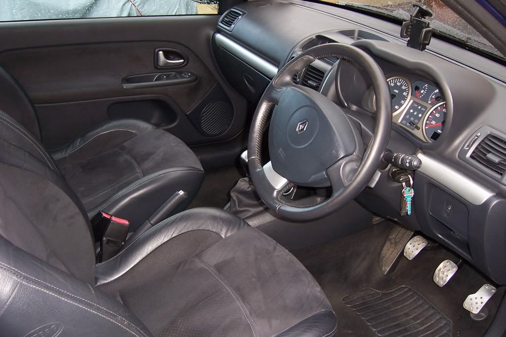

Just a few pics of what I have been upto on the car recently
Today I have smoothed the wiper hole cover (I still have to paint it black btw):
And heres some pics of the strippage:
Still retained a bit of luxary though:

planning on stripping any further ben?
I dont know to be honest? :S I dont want to sacrifice too much! I took the rear doorcards off at first and then put them back on beacuse it just looks a mess with them off! Im looking at removing the carpets, taking the sound deadening out then putting the carpets back in. Also looking into some lighter front seats?

Not really seeing the point of 'stripping'.
The bits you've taken out weigh nothing! Its the front seats/carpets/soundproofing that weighs a ton!
  alien green rs133
ktec systems are weird... when i was running mine with a cat it was barely audible but then i decatted it..... OMG you couldnt stand within a mile of my car sooo loud, baisically the boxes were hollow :S, so i ditched and orbisoud in now in place :D
  White Evo V
Read post #150!! I am on with soundproofing, carpets and seats!! ;)
