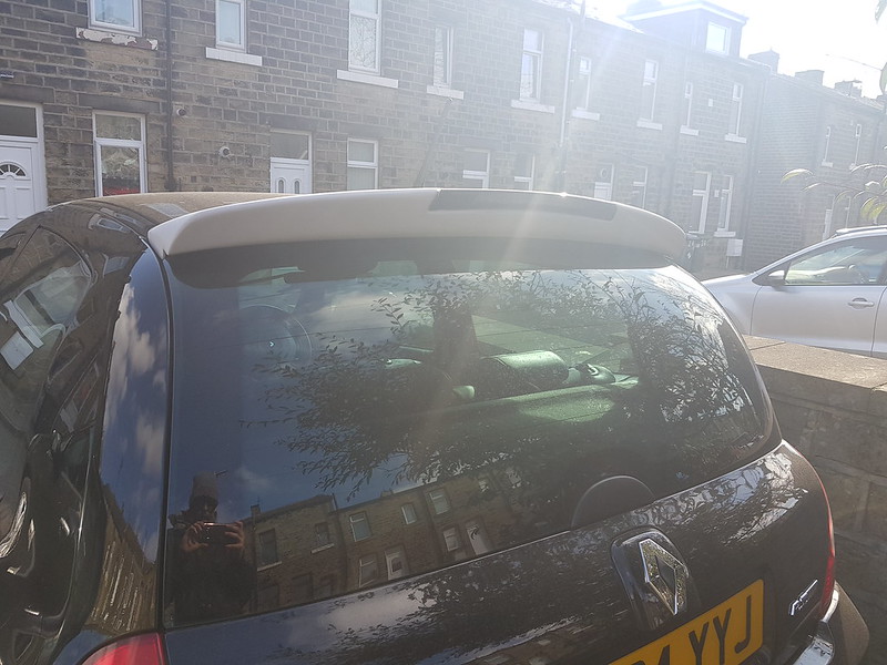

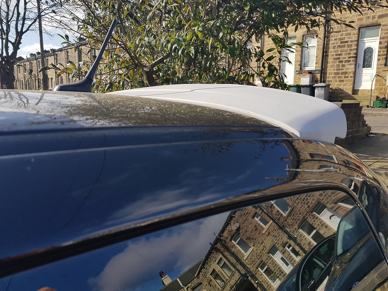

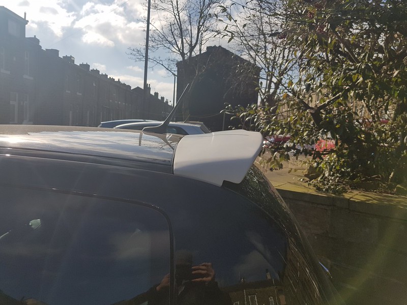

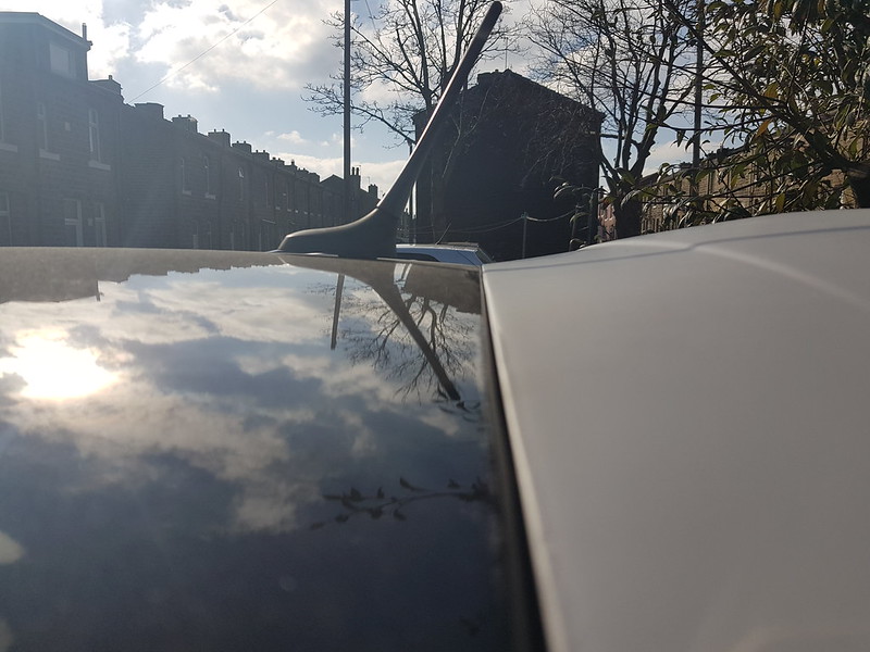

I then wanted to try my trophy spoiler for size and i'm pretty chuffed with the fit! It's just sat in place, but looks like it'll be perfect. Will need some slight fettling but i'll leave that to the bodyshop to sort.

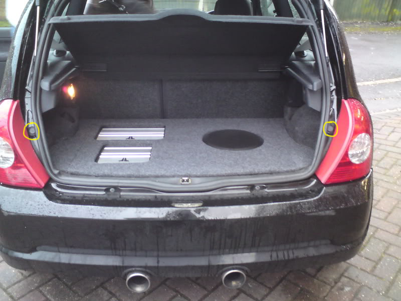

Have you cleaned up the earth wires underneath the carpet/plastic trim at the rear of the boot, just under the rear lights?
These rubber gromets can leak. You might be able to follow the water staining down inside to the earth points.
Also the connectors inside the rear lights can be a bit loose too, can usually tweak them so they have a tighter grip on the pins when clipped in.
I did both mate.
All those earths were absolutely perfect as I'd previously sealed up those grommets with silicone. I did brass brush them clean but there was nothing to suggest corrosion at all.
I might just need to have a play with those connectors in the lights even though they were clean too. I know last time I had a similar problem it was down to the bulbs having corrosion on the threads where they earth. I'll give that a go when Its not freeeezing

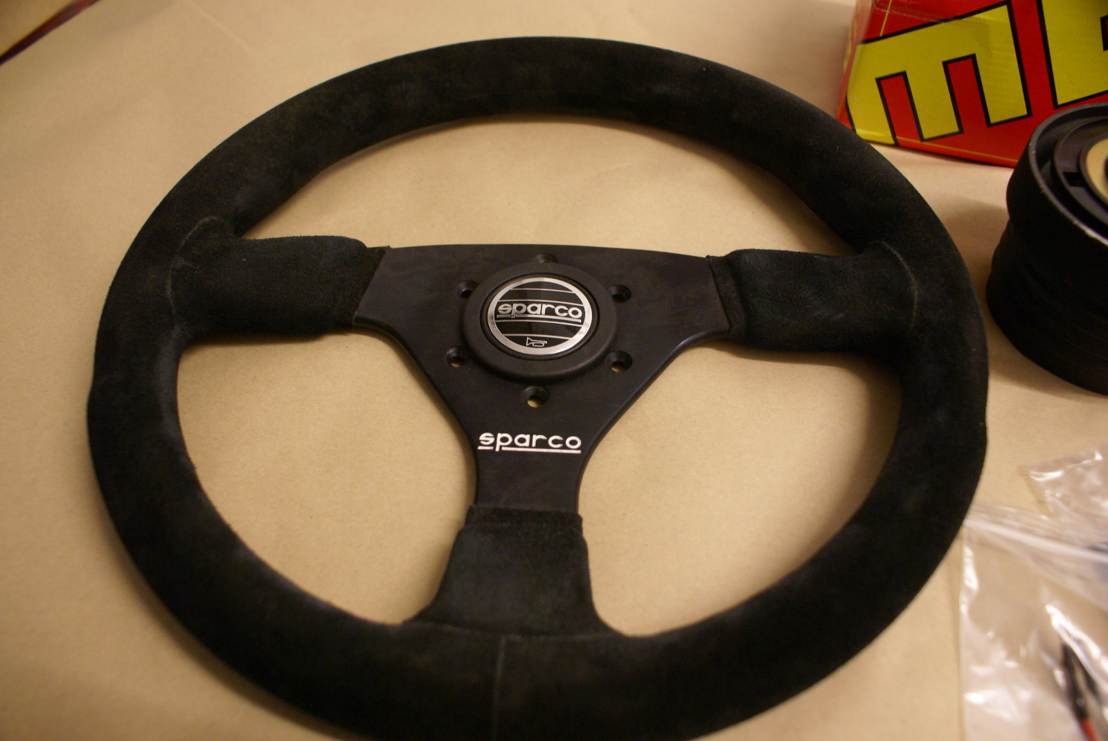

Finally.
I fancy the 383. Where did you buy yours?
Got this on ebay. I've been stuck between which one to get as i was tempted to go for one of the oreca ones but they were just short of £100 imported from france. Momo team black had taken my fancy aswell

I'll be making my own bracket for this out of acrylic to retain the CC and stuff

You don't know what I paid! Unless Daniel told you? ;)
It is 'used' but it was apparently only fitted for a photoshoot then removed from the car. Definitely looks to have absolutely no wear on.

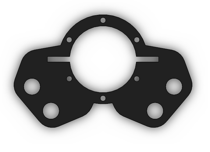

Mocked up a quick bracket in Solidworks. I'll tweak it more when the wheel arrives but you get the idea. Have to choose a button colour scheme next!
Looks good. What are the slits for?
Allows the cables for the cruise control to pass through without getting squashed, same as on those FB ones. I'll be adding some engravings too but unsure whether to go for full words or just letters. :)

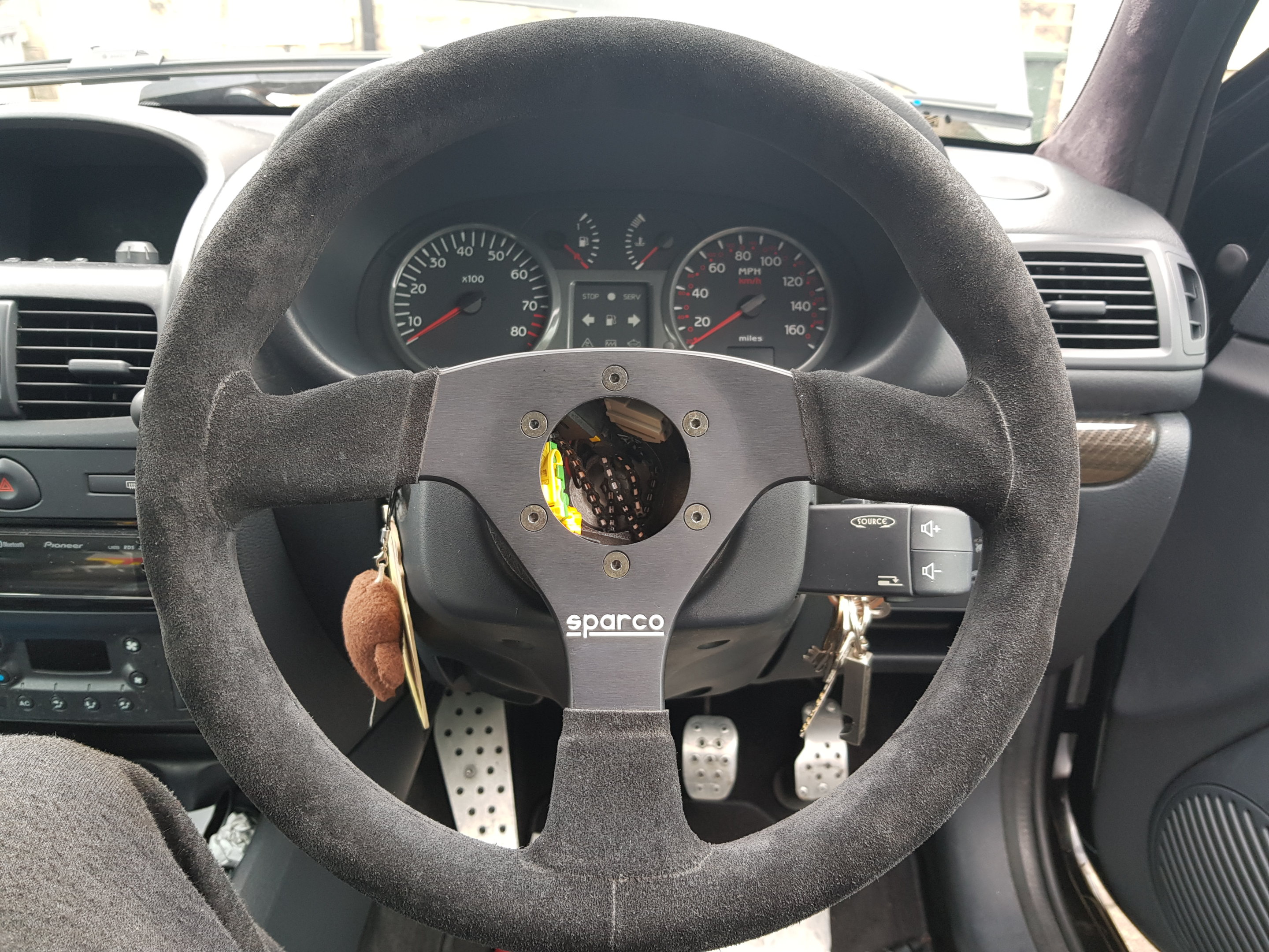

I also managed to get this fitted!
I have cruise control bracket to finish wiring up and also some airbag resistors to get but I'm chuffed with how it looks.
Can't wait to drive it!
Had a knocking coming from my front end so I went over all the engine and gearbox mounts and retorqued them and loctited them as I believe it was the manifold banging on the subframe.
Looks nice that mate! I couldn’t live with Alcantara on my wheel though[emoji24]

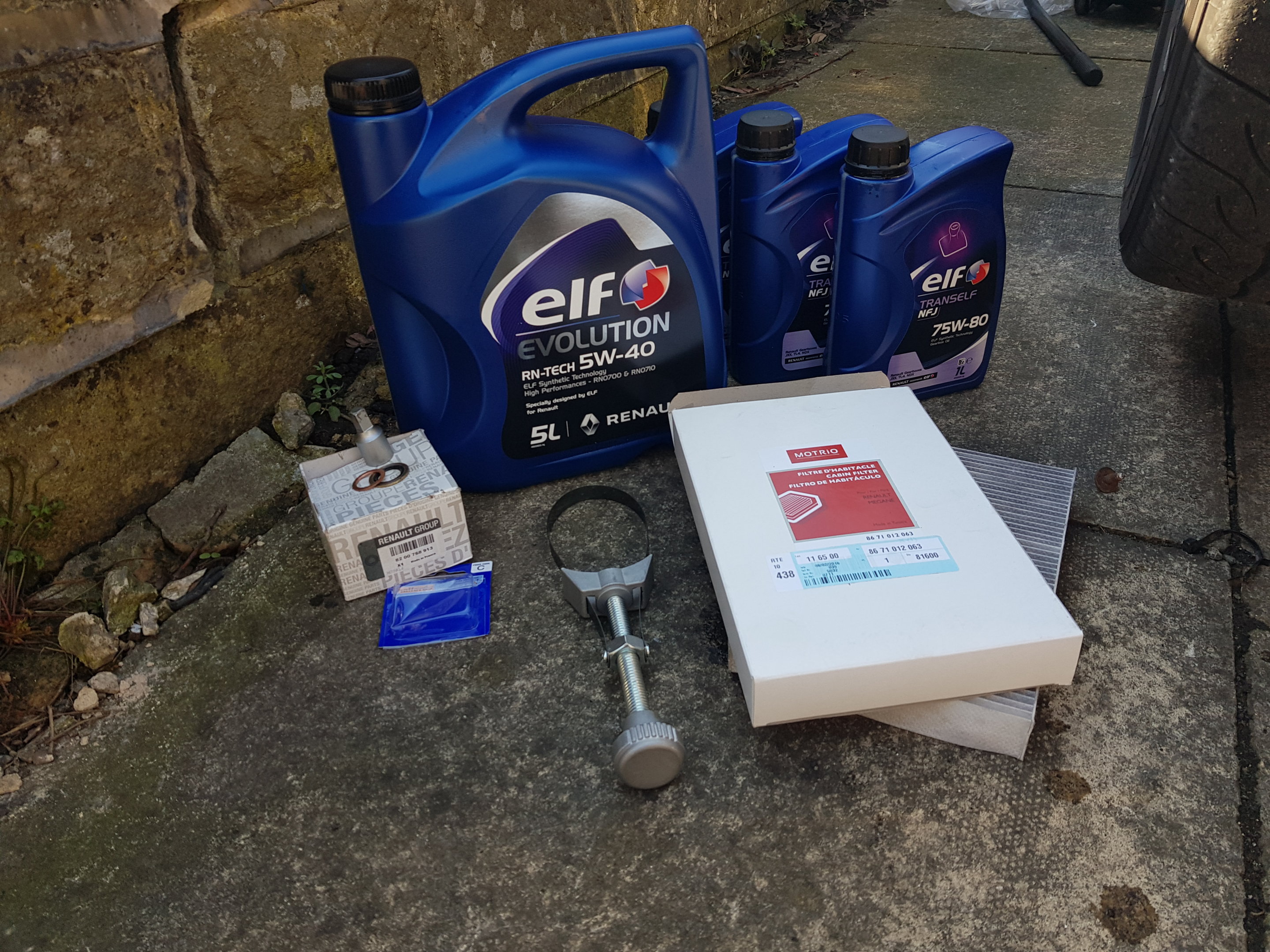

Gave the car a full service today -
Engine oil,
Gearbox oil,
Oil filter,
Pollen filter,
New washers all round.

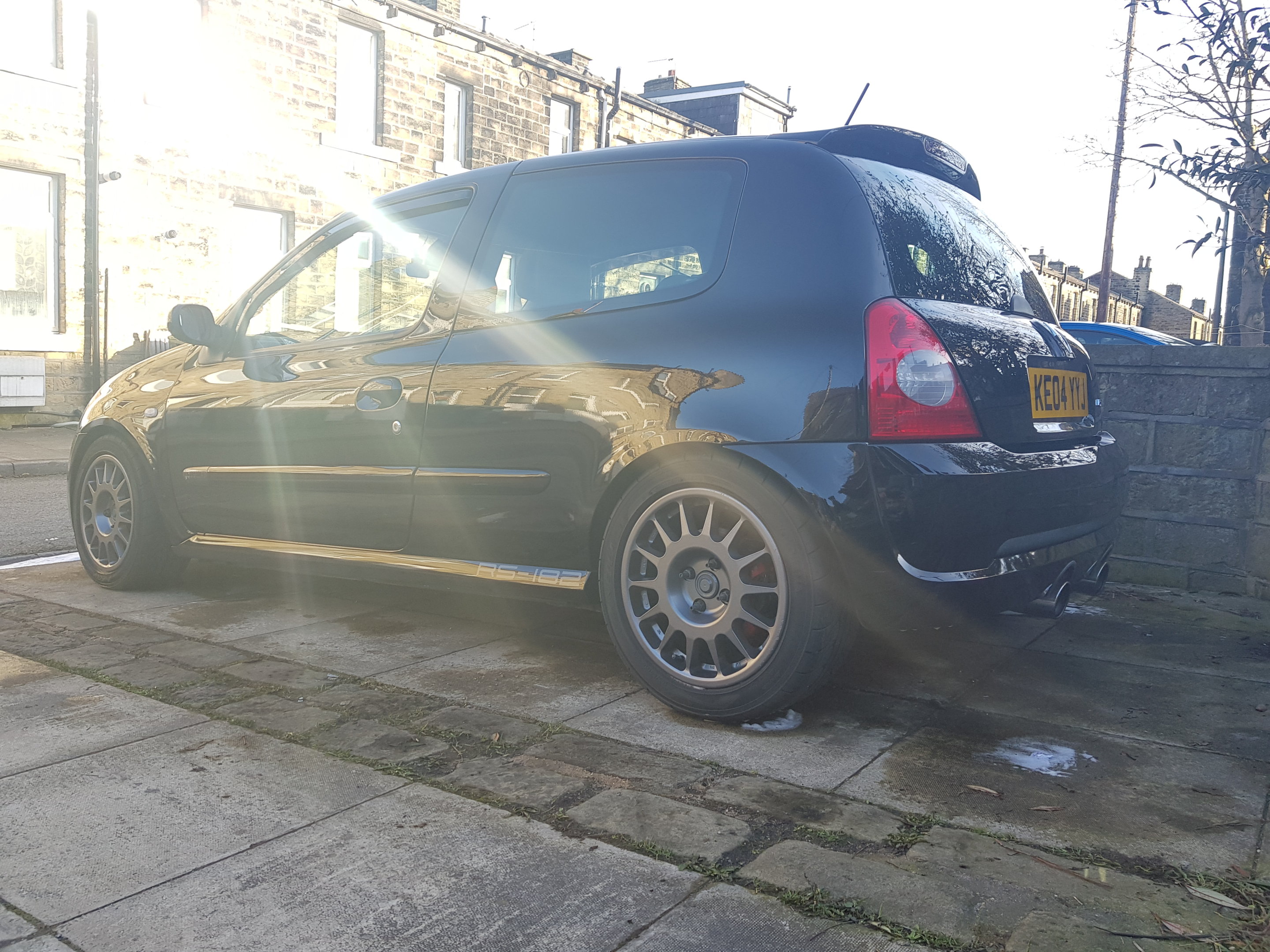

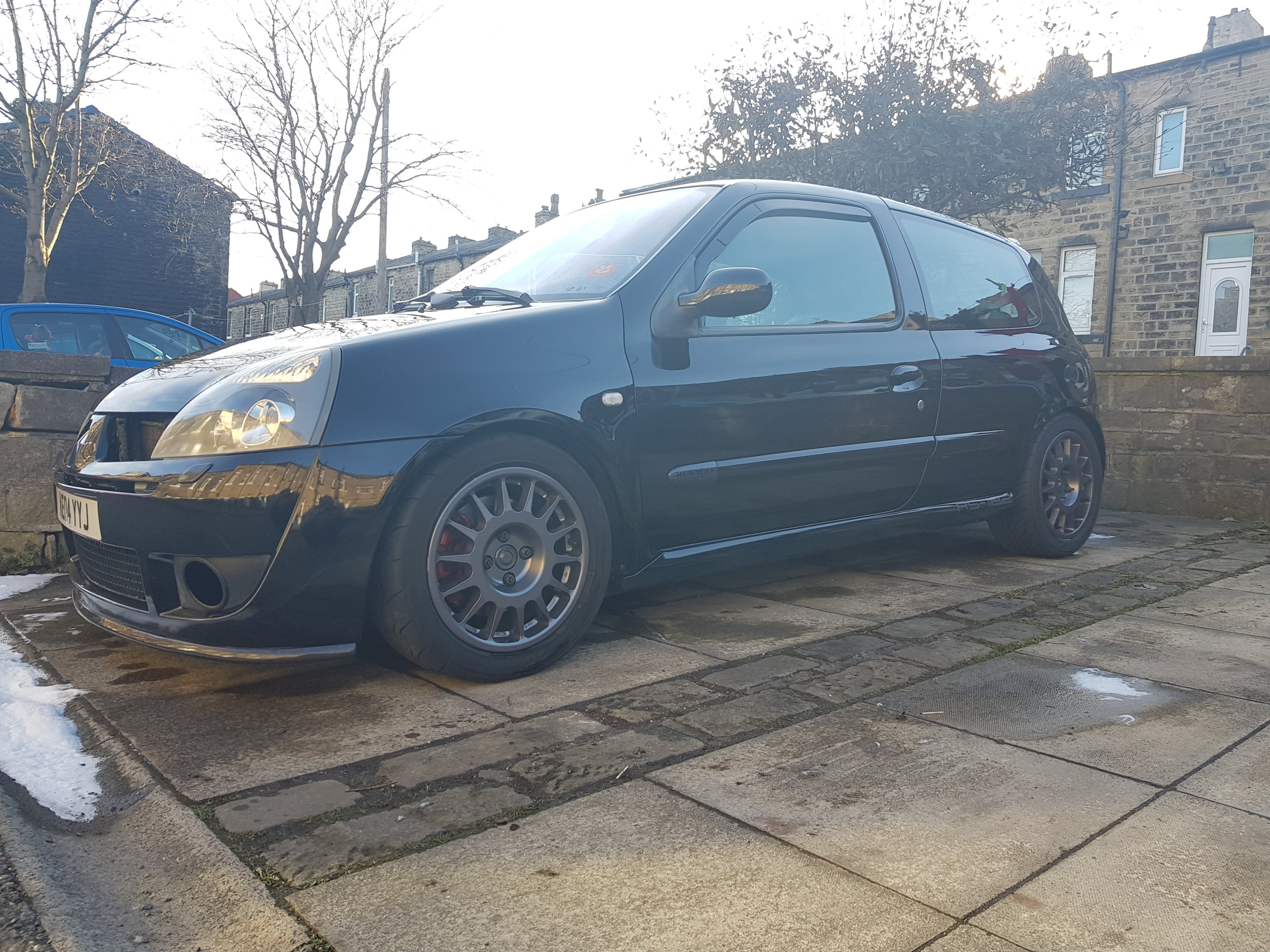

Engine oil was black despite only being done around a year ago (about 8k miles) so glad I changed that. Gearbox was still crystal clear but it got changed anyway.

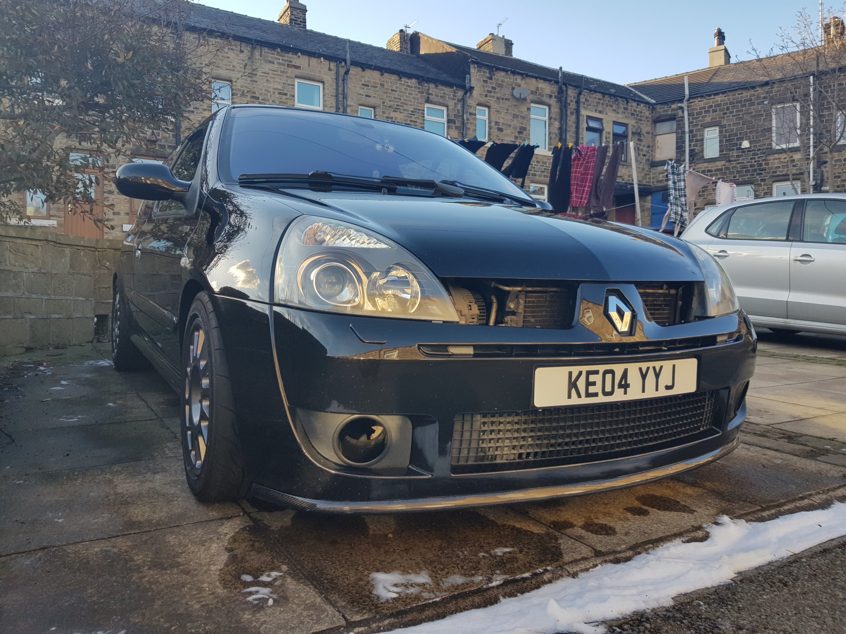

Then gave the car a quick once over with a sponge. Shocked how the hubs have just been stripped back of their paint over this past month. All this salt on the roads, hate to be by the sea!
No polish in these photos as I just couldn't be bothered haha.
You'll notice I've also removed the grill. Has been annoying me how blue it is so it'll be getting a once over with some satin black :)
Finally no shocking looking grille[emoji57][emoji6][emoji23][emoji23]
Not that bad really ;) don't know whether to prime it or not? I only have normal grey primer but just hycote satin black.
Also do I remove all the stickers or just mask them off? Decisions decisions
Just spray it with any primer mate. I rubbed mine down with a wire brush to scuff it up.
And get rid of the stickers anyway[emoji40][emoji6]
So the steering feels loads better with the new 330mm wheel but it definitely feels slightly heavier. Is this normal or have I done something wrong?
Did ya not do moments at school?
"Moments. A moment is the turning effect of a force around a fixed point called a pivot. For example, this could be a door opening around a fixed hinge or a spanner turning around a fixed nut. The size of a moment depends on two factors: ... the perpendicular distance from the pivot to the line of action of the force."
So yeah, normal that you new wheel.makes you feel weak[emoji23]
