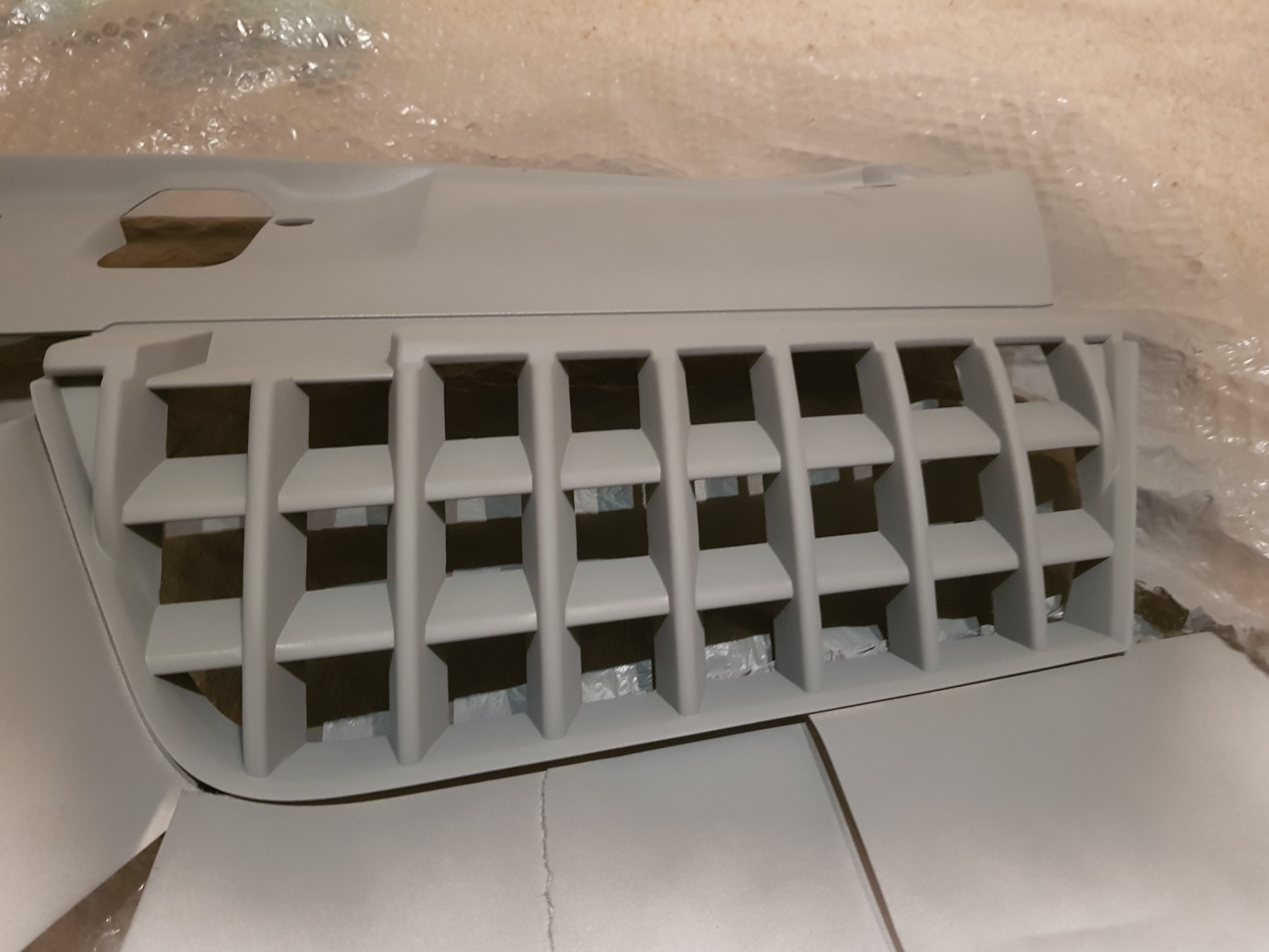

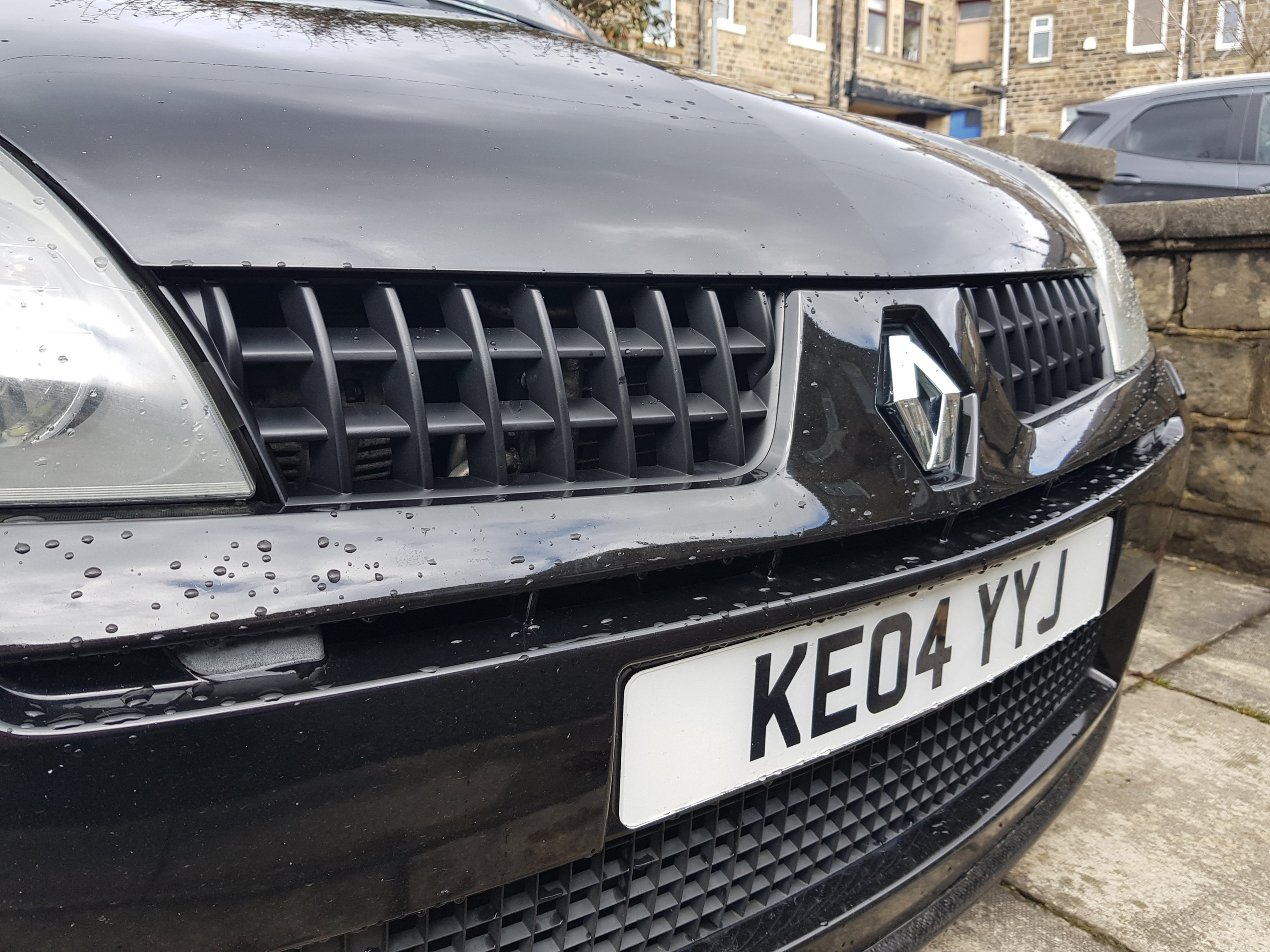

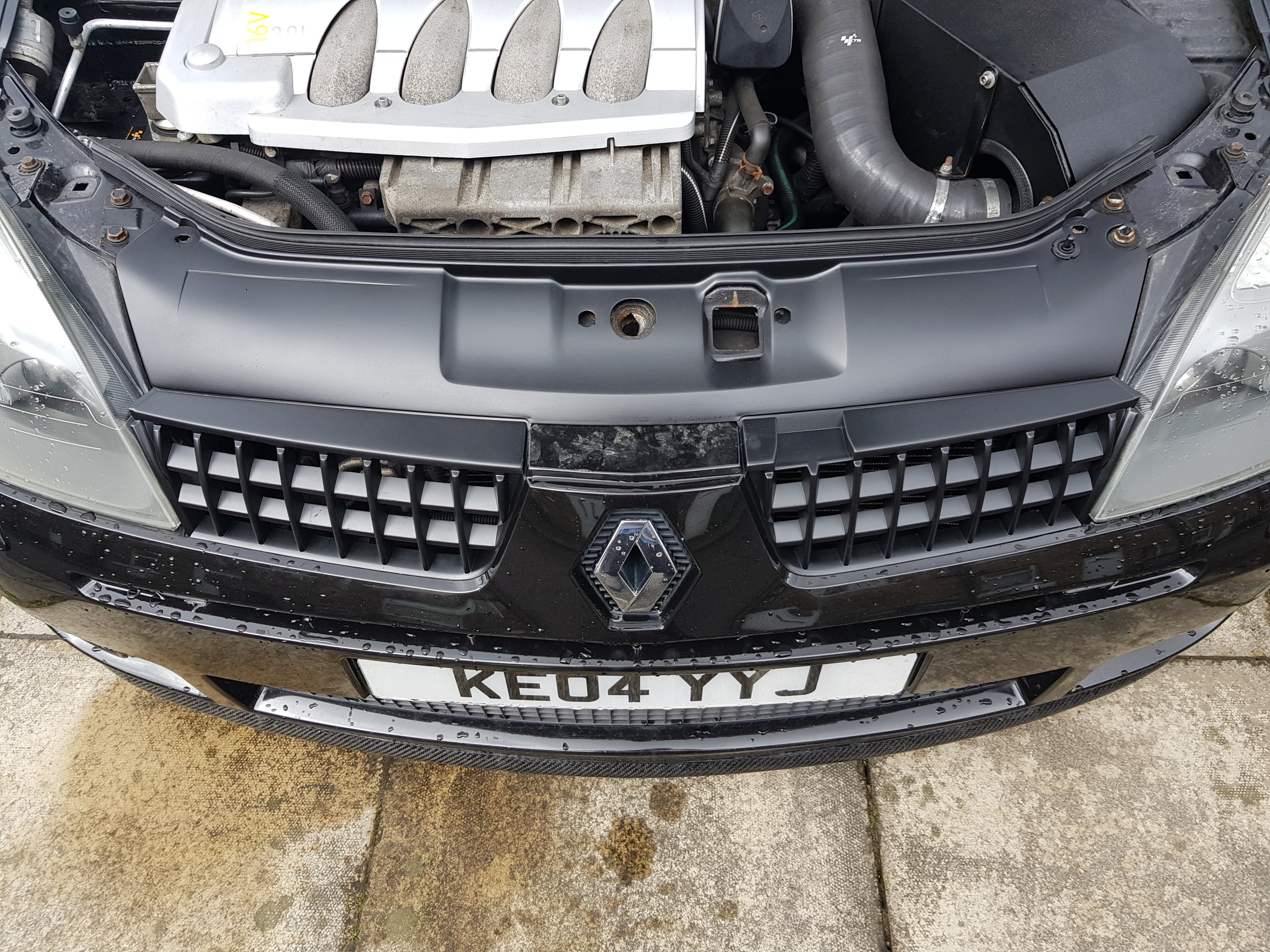

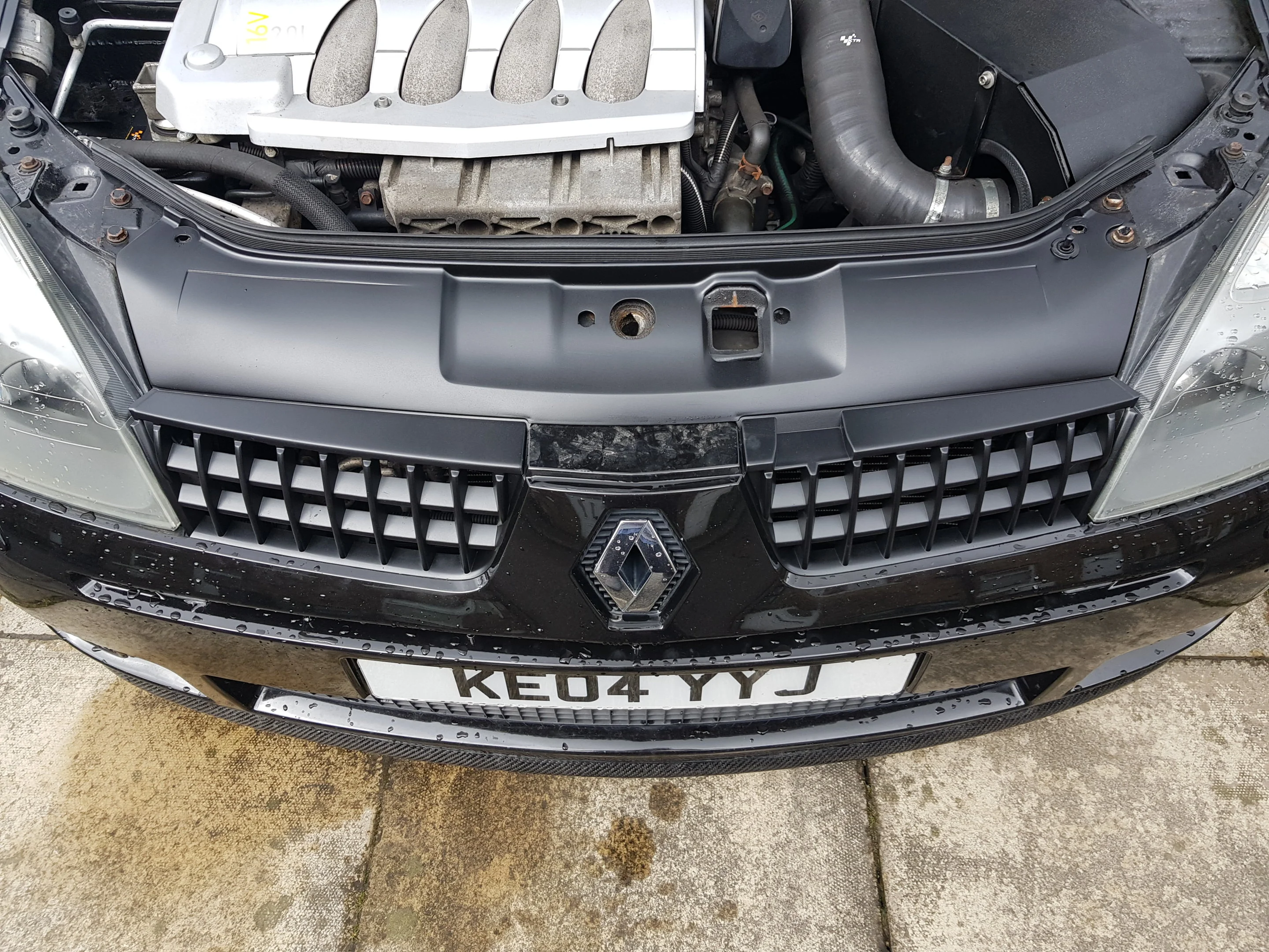

Degreased the grill and lightly sanded it back with some wet and dry then gave it a spray with some grey primer.
Then using some hycote satin black it got a further 4 coats then refitted onto the car.
Looks miles better now being full black rather than the grey blue it was before.
Not sure whether I'll put the stickers back on yet but I managed to take them off carefully so could do if I wanted. I'd prefer to go brand new but they're NLA

Looks miles better now Louis.
Louis
I Love Ed Sheeran
Cheers Paul.

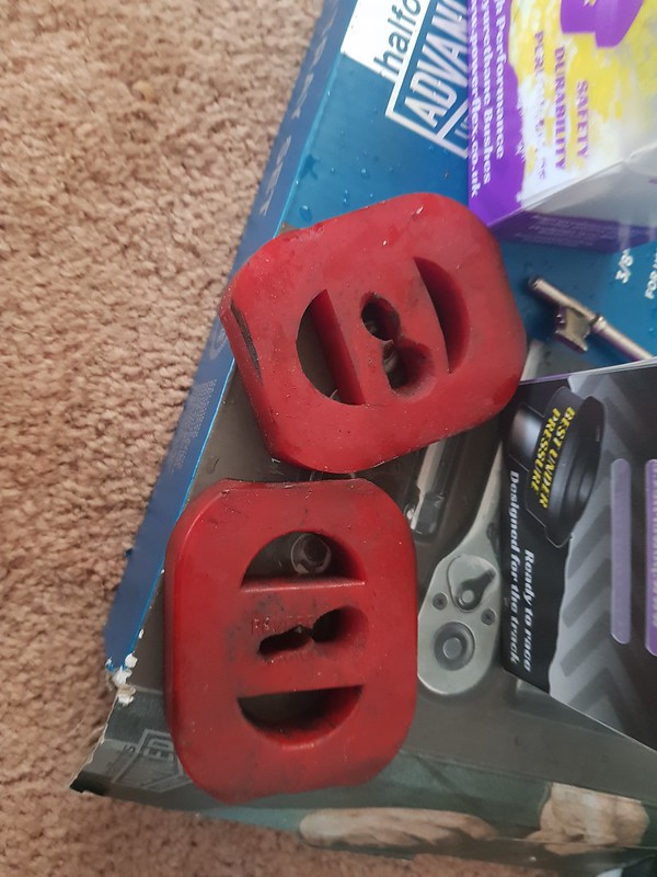

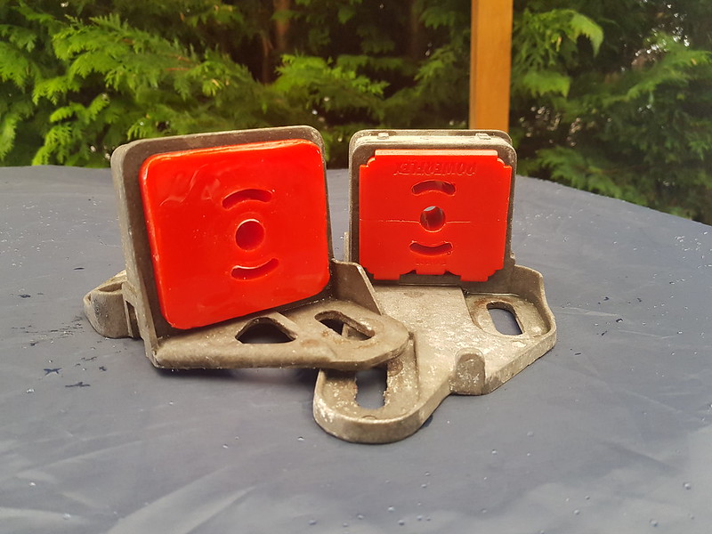

Pressed some new EXH020 Polybushes into the exhaust surround to replace the old ones that led to the exhaust not sitting straight.
New
20180331_171344 by Louis Walker, on Flickr
Old
20180331_172008 by Louis Walker, on Flickr
