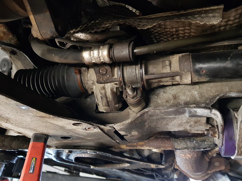

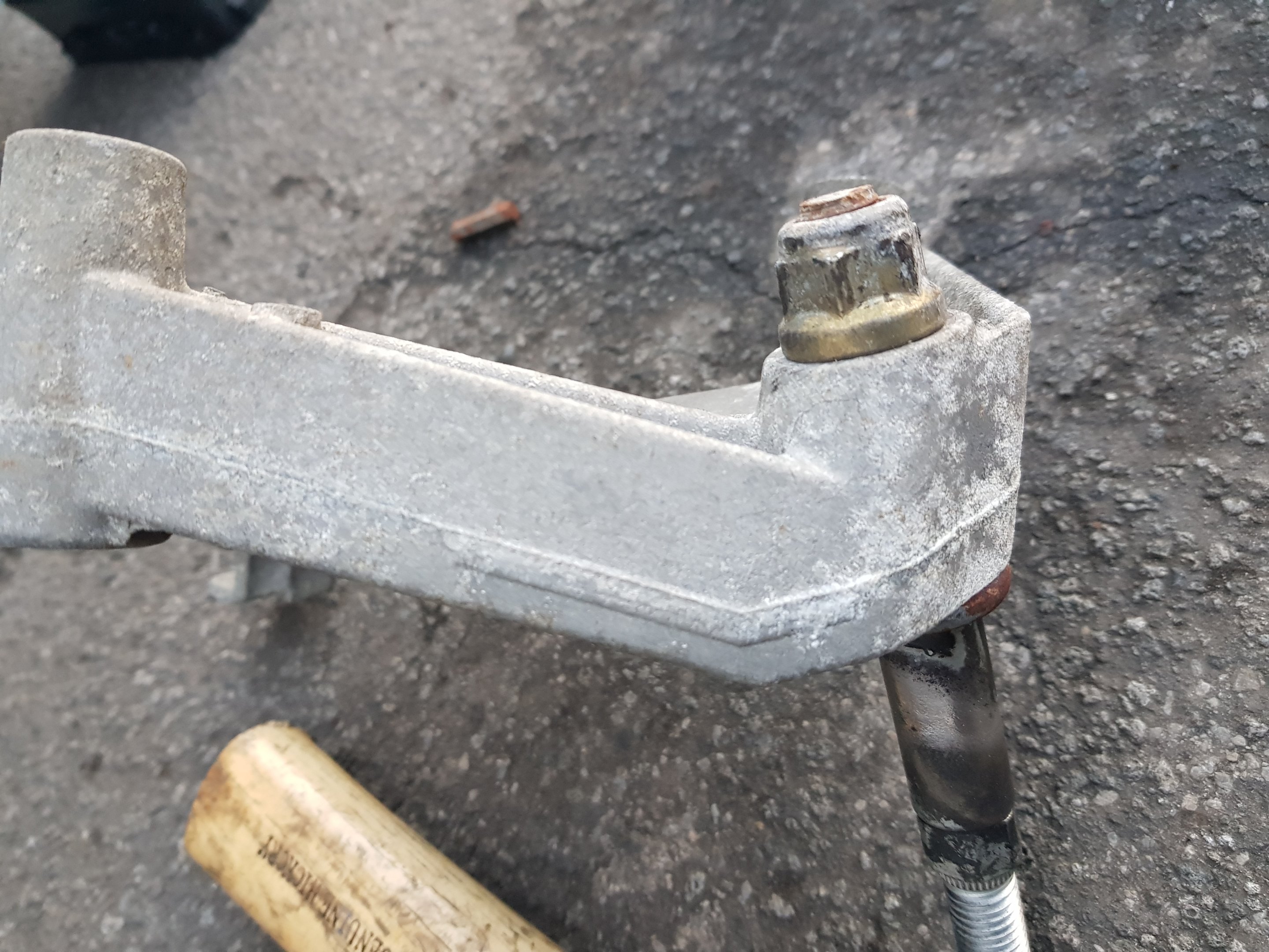

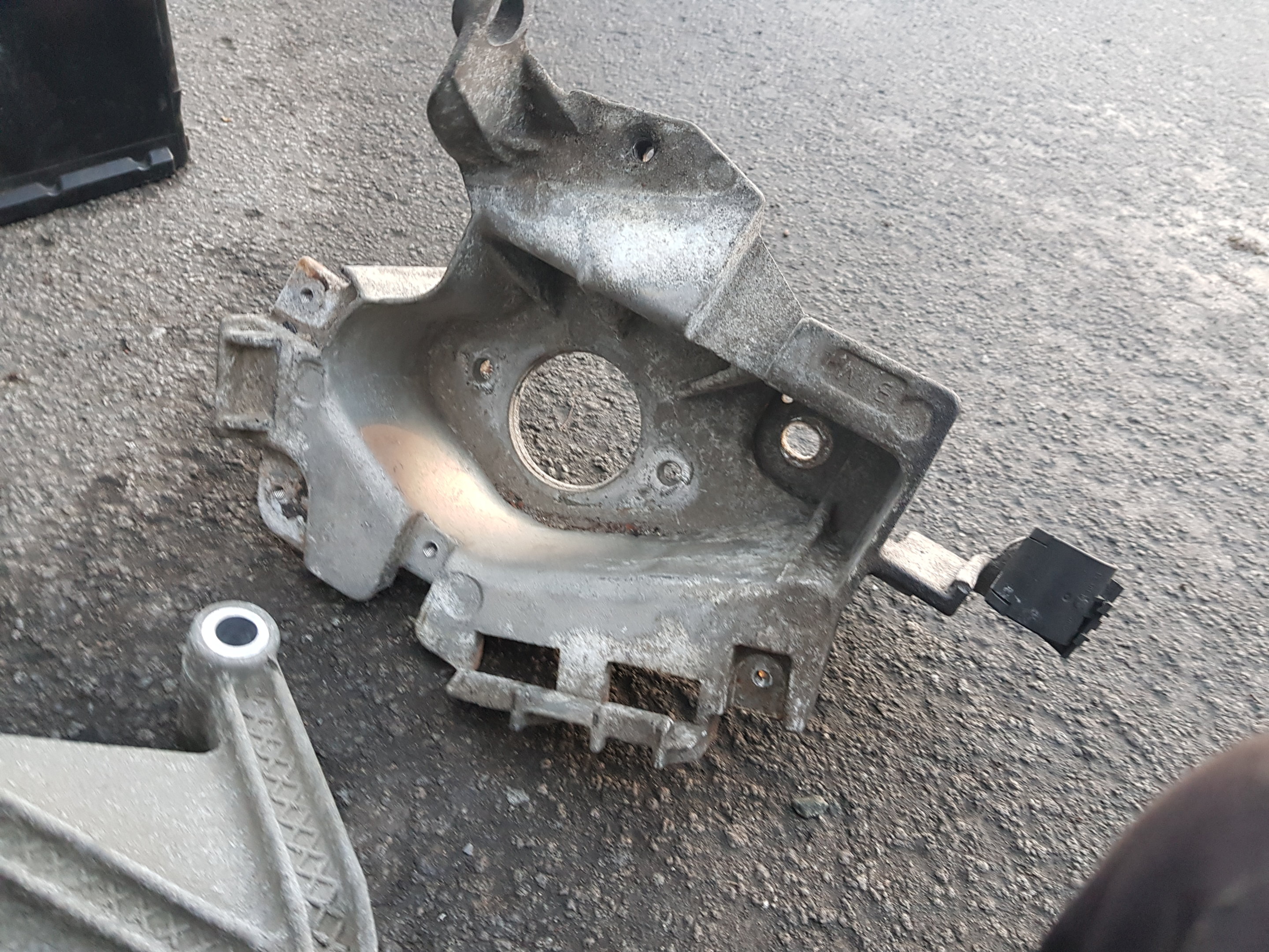

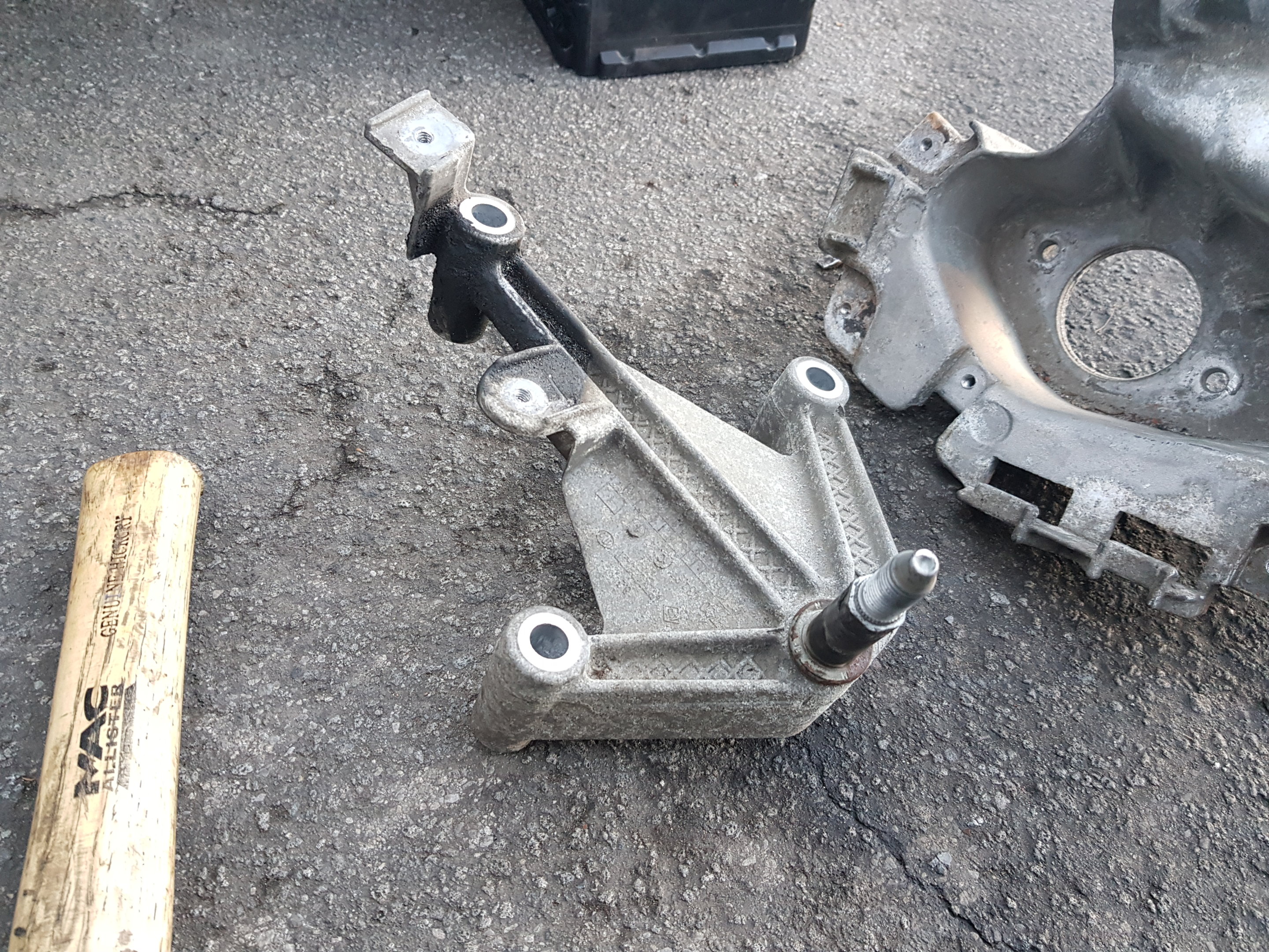

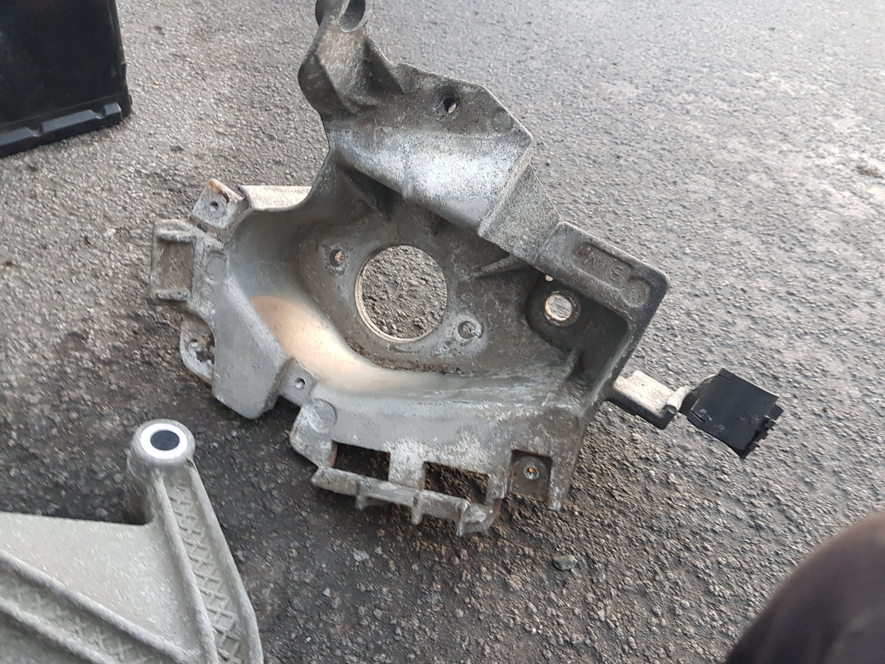

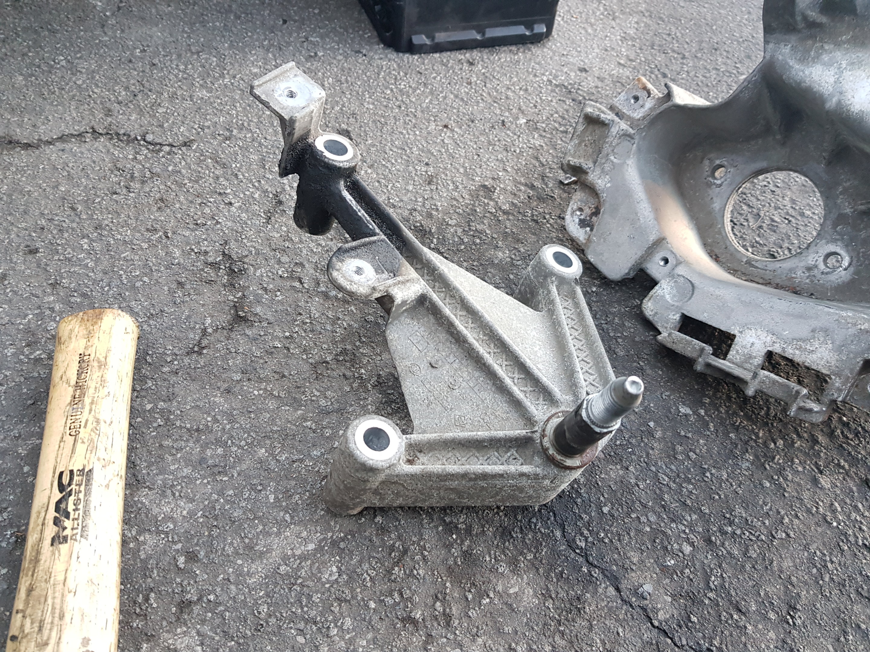

I also removed the gearbox mount cage and spider cage to make sure the spindle nut and bolt was fully tightened.
View attachment 1350509 View attachment 1350511 View attachment 1350514

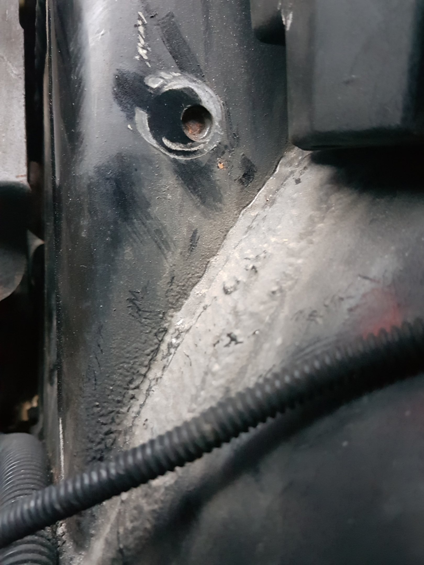

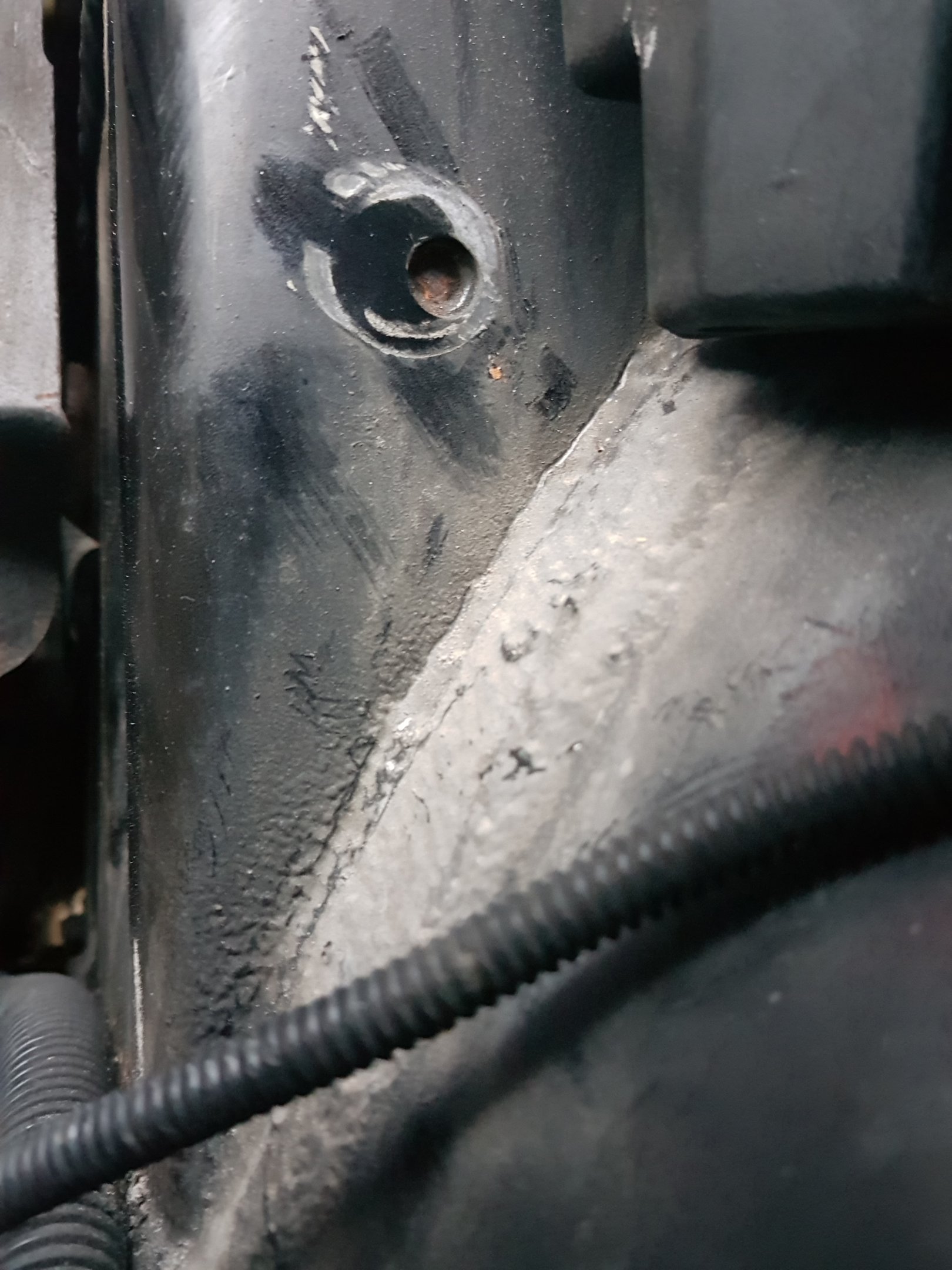

Annoyingly a previous owner had snapped this bolt in the turret. I'll be trying to weld a nut onto the back to remove this otherwise it's drilling it all out.
This is as far as I got as it came dark really quickly. One of the negatives of working outside...
I too have discovered that bolt has snapped but am unsure of how to remove the gearbox mount?
Louis
I Love Ed Sheeran
You can get away without removing it as you can just grind the captive off the back through the wing then nut and bolt it unless it's moved.
There's 3 bolts down there that need removing to access the main mount if your 4th is snapped. Shouldn't need to remove the gearbox mount itself.
If you want to remove it put weight on it through the gearbox and tap it with a hammer

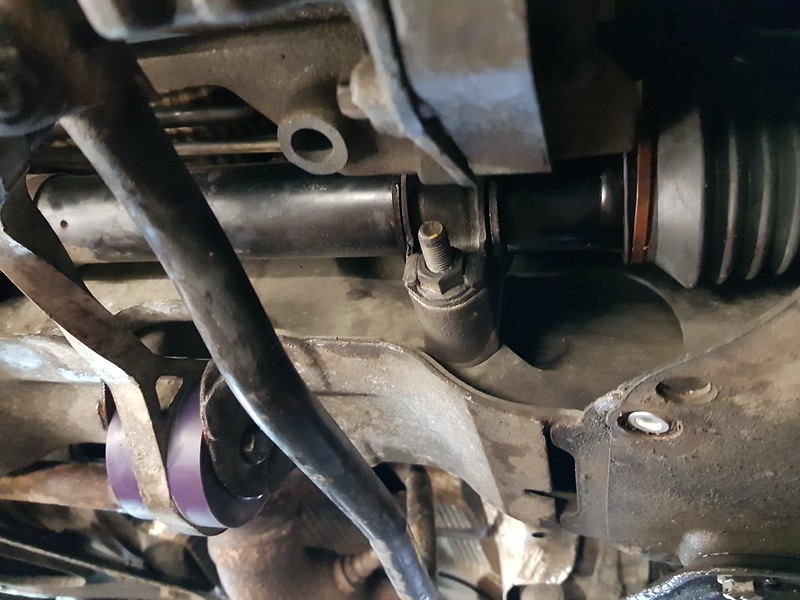

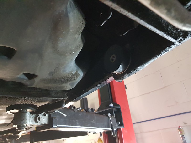

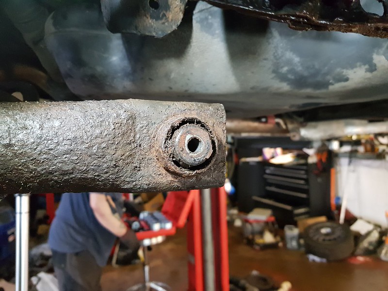

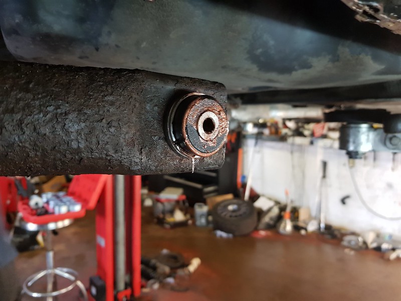

Popped over to see @bloke last weekend to have some black series steering rack and rear beam bushes fitted to complete the Polybush package throughout the car.
It's something I wouldn't have wanted to attempt on the floor due to access and it being a pain in the arse! Thankfully all went well, and all the rear beam bolts came out with no problems at all.
The original bushes weren't too bad, but after 128k I'm glad they've been replaced with something more hard wearing.

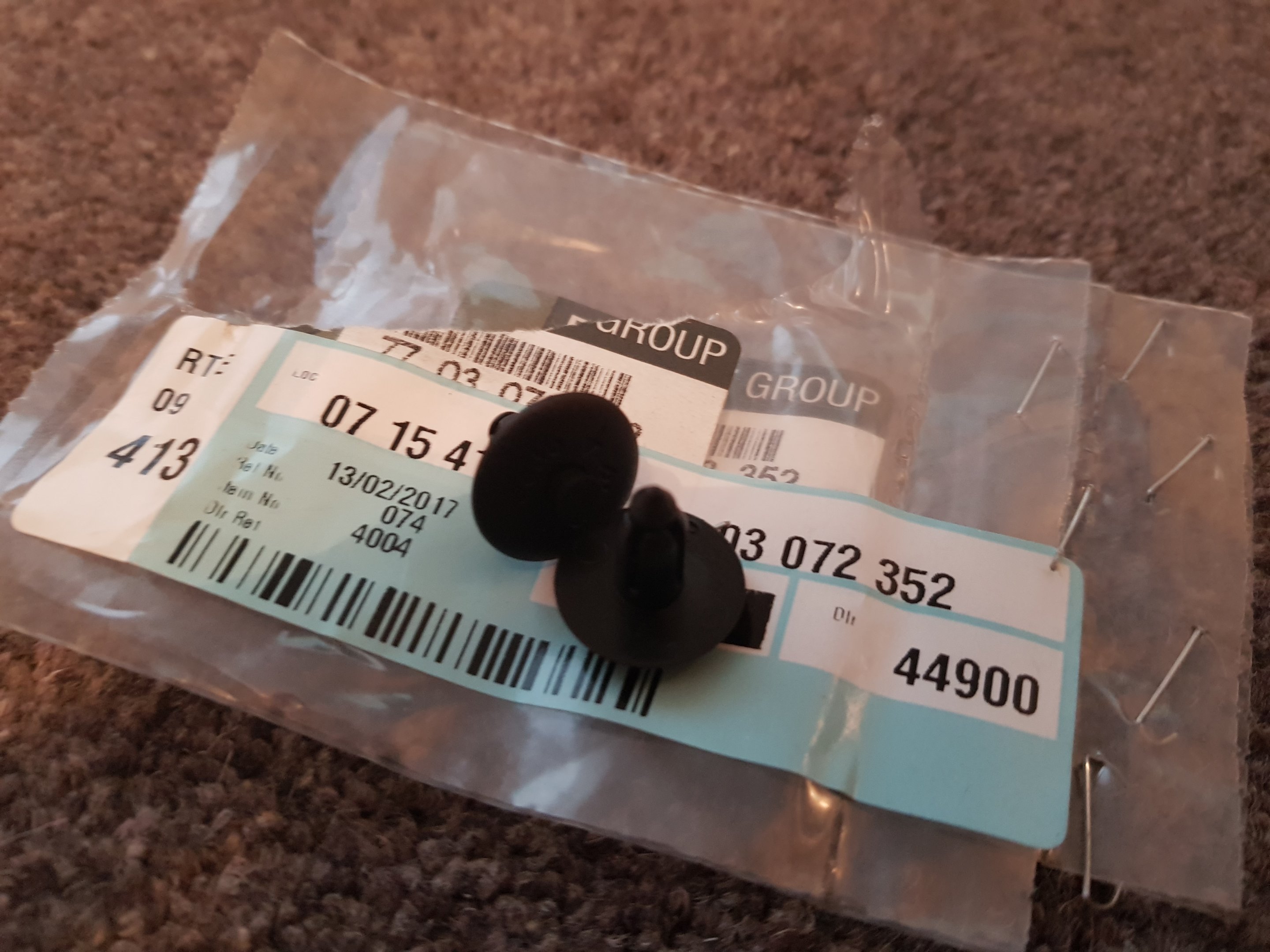

Carl also removed the captives that were damage on the undertray and replaced them all round so I no longer have to mess around with cable ties! Thanks again mate!
After mentioning the knocking issues i've been having carl also helped narrow it down to being the topmounts having a very small bit of play in them, but whether the bearings have gone or they just need washers under them is not known. It was also found that the front carrier has worn on the slider pins, so rather than just in out movement it has some up and down movement too. This is causing a knocking noise to occur which is most likely contributing to it overall.
I'll be looking to buy one in very good condition or buy new, depending on price. Thankfully it's only on one side, but I wonder if it's been down to the sliders being seized last year when I bought the car and just wearing out. I was going to try packing it with grease first to see if it made a difference.

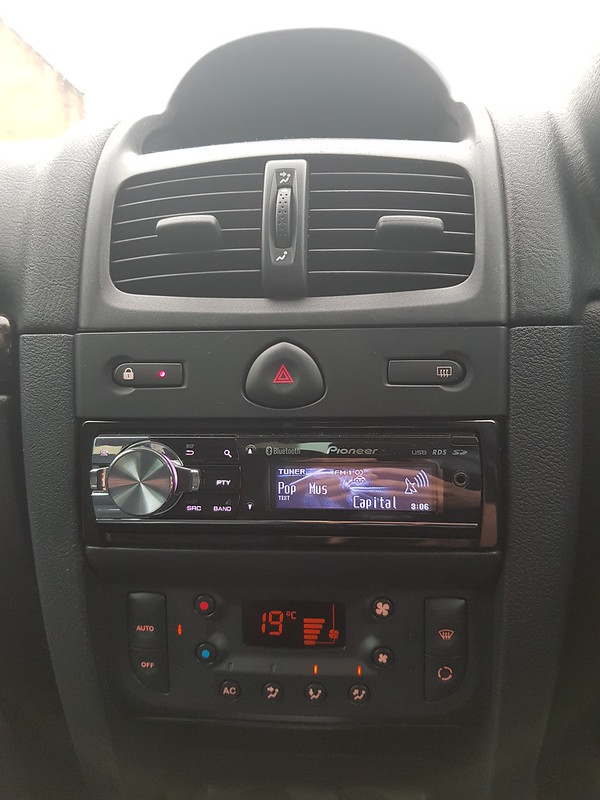

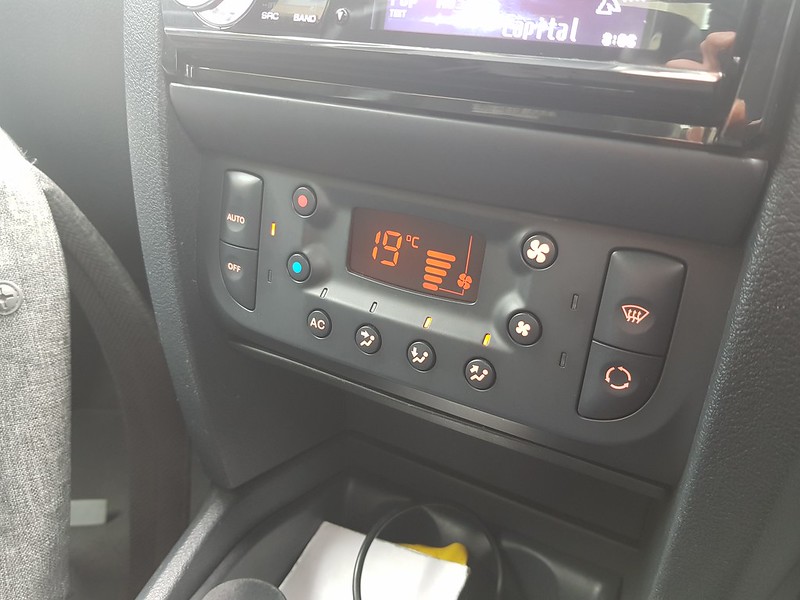

Another job I had been meaning to get around to was fitting my climate control panel from a non sport. This is identical colour wise to the rest of the trim pieces and was a relatively easy changeover. Much happier with how it looks, as the old one was all chewed up as they all seem to get in the sports. Much easier to keep clean, and the display even looks clearer than my old one!
20180413_082754 by Louis Walker, on Flickr
20180413_082758 by Louis Walker, on Flickr
Only thing left to change is the satnav top, but as these were never in nonsports, they dont exist! It's not so bad anyway, so i'll leave it.
Next thing I finally finished after a bit of messing around with resistors (Maplins, say no more!) I got it fitted. Works perfectly and happy with how it looks! Bit of a squeeze getting all the wires in and the horn into the boss but I got there.

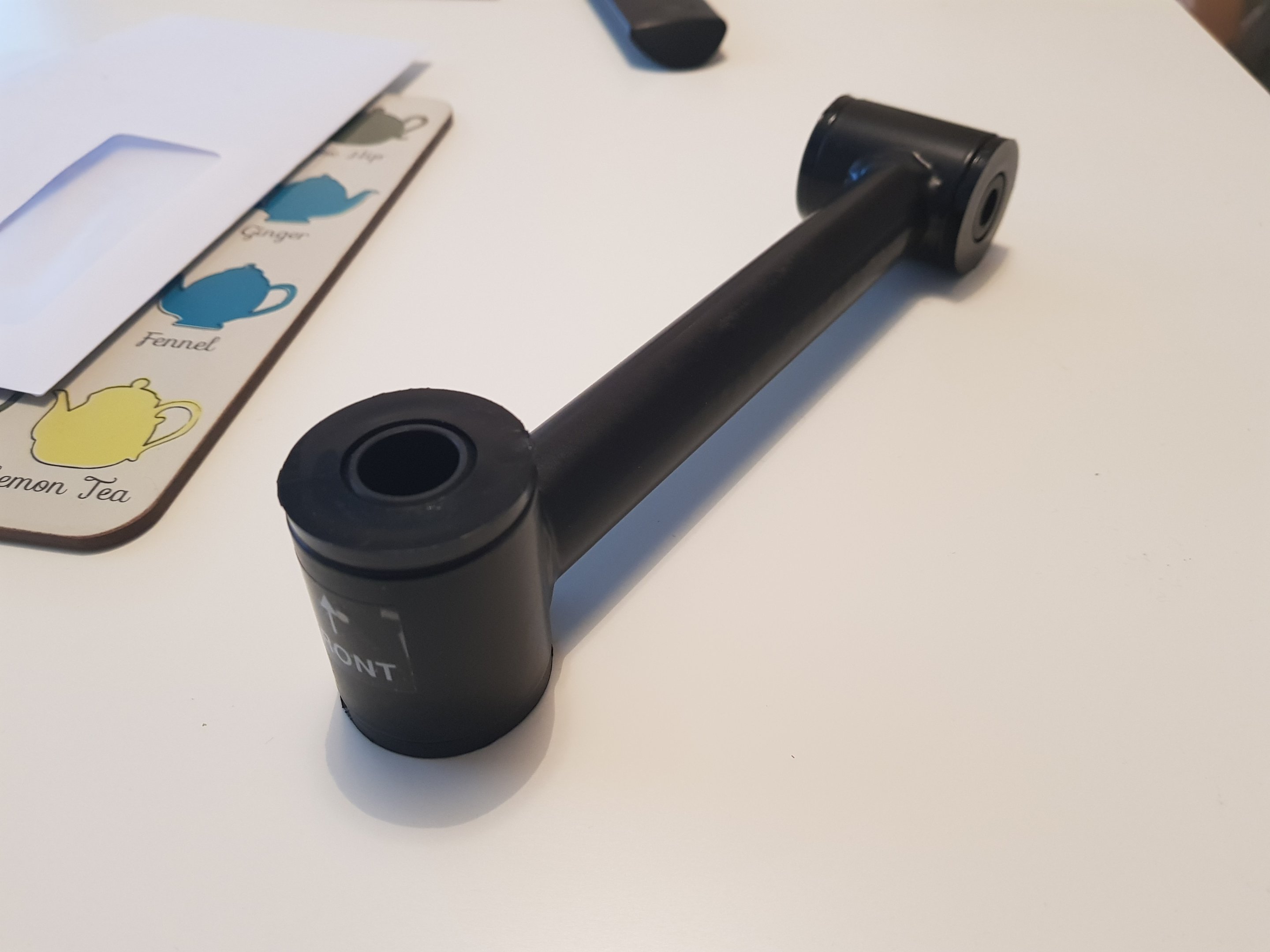

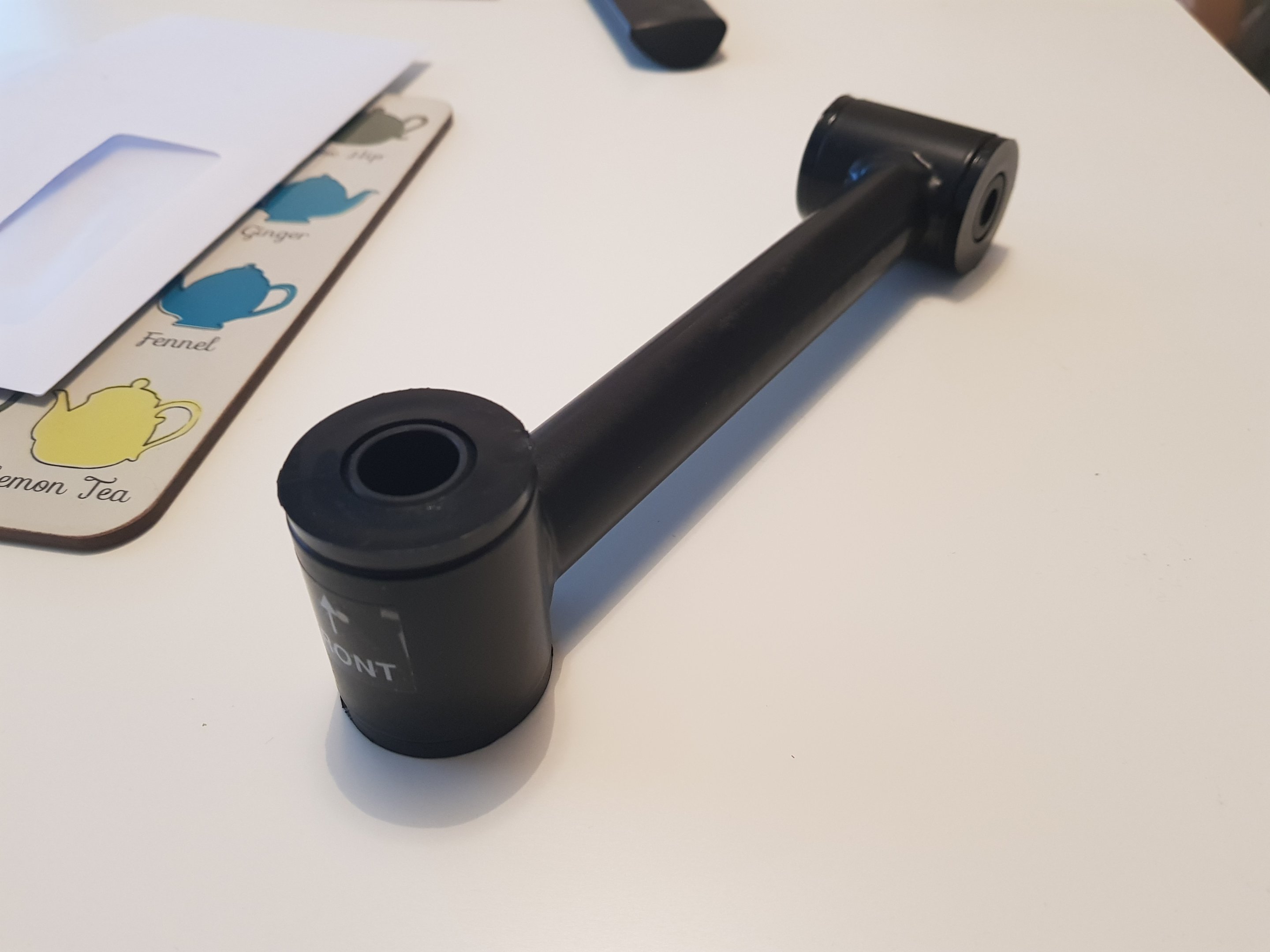

I have bought an EVOL dogbone to replace the polybushed one I'm running at the minute to hopefully remove some more play, then tomorrow I'm heading up to Keltec for my flange cutting off and either a new flange welding in, or a vband and flexi.

Got my evol mount today that I'll fit this weekend

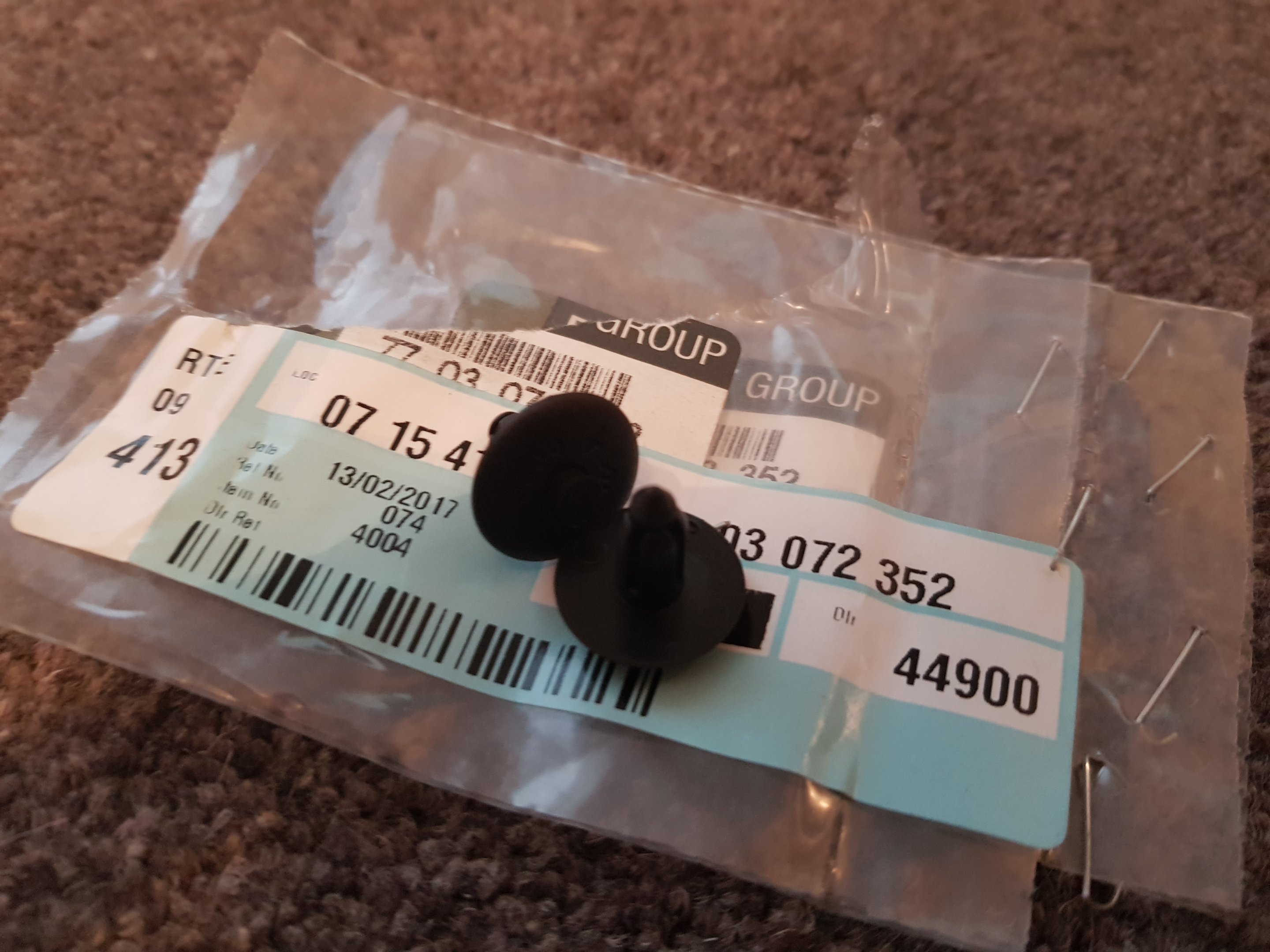

Also some clips to go into my grill

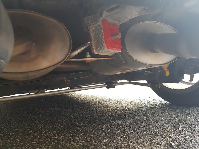

Took the trip over to Keltec today to get a quote on removing my manifold flange and getting a vband and flexi welded in but they were pretty expensive so I didn't bother in the end. I just got them to buzz up the backbox brace as I had noticed when doing the polybushes that the welds had cracked.
Polybushes can be seen here too

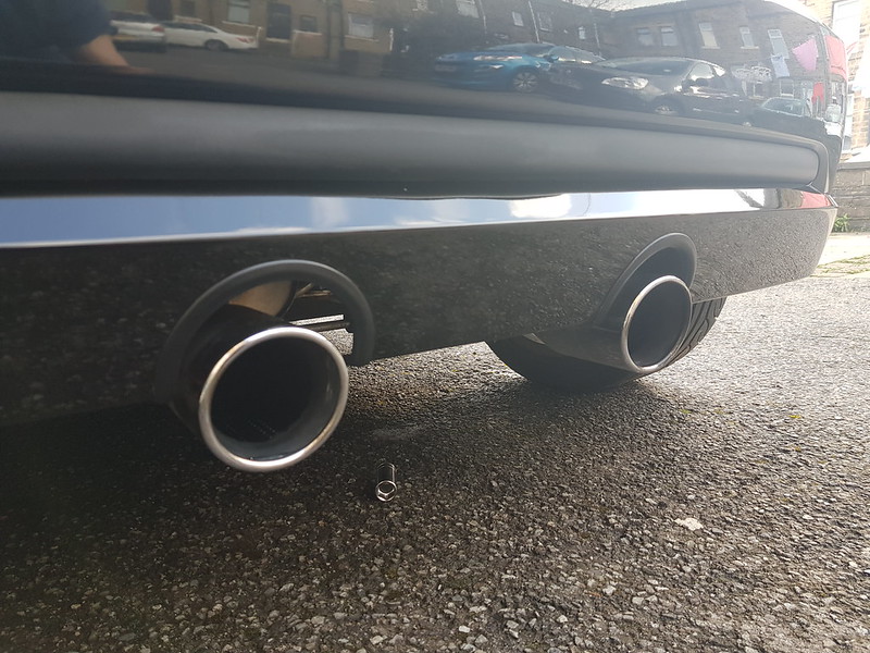

I managed to buy some very good condition exhaust trims and gave them a few coats of satin black a while back. My old ones were melted and broken so these freshened up the rear nicely.

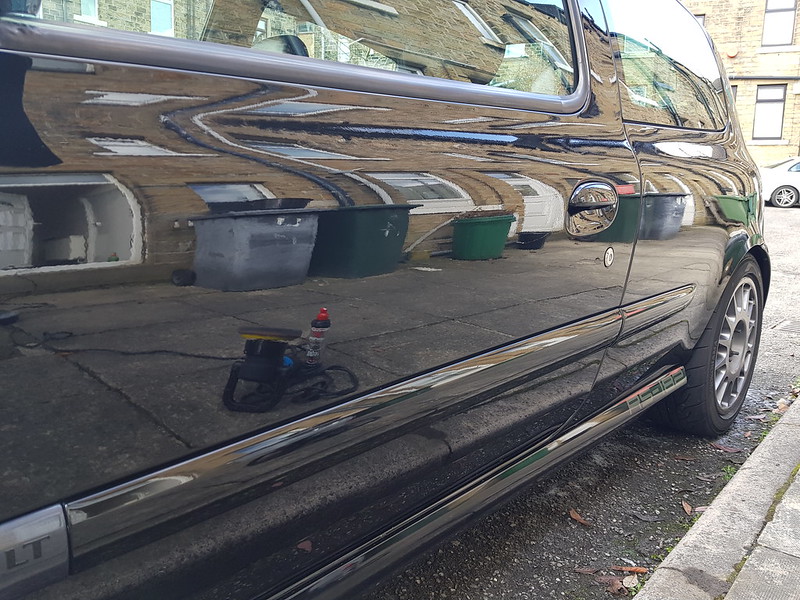

I then spent around 5 hours machine polishing the car with some heavy cut Menzerna compound to remove some of the swirls in the paint. I'll be looking into some different compounds and pads to use in the future as I would like to remove some deeper marks but for now it's better!
I took lots of pics and they look the same as the last ones because that's where i wash my car. Need to get into some new environments!
