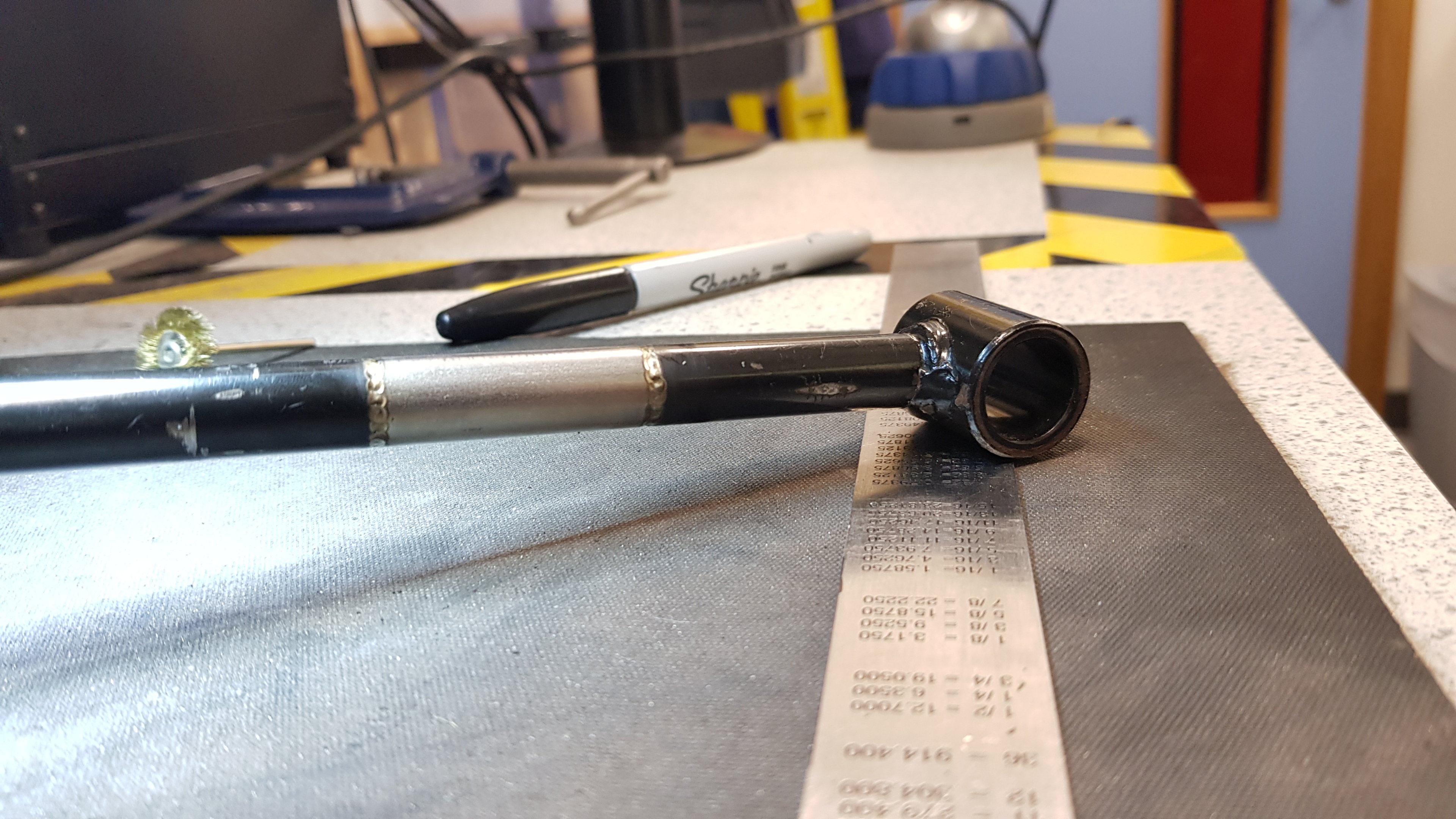

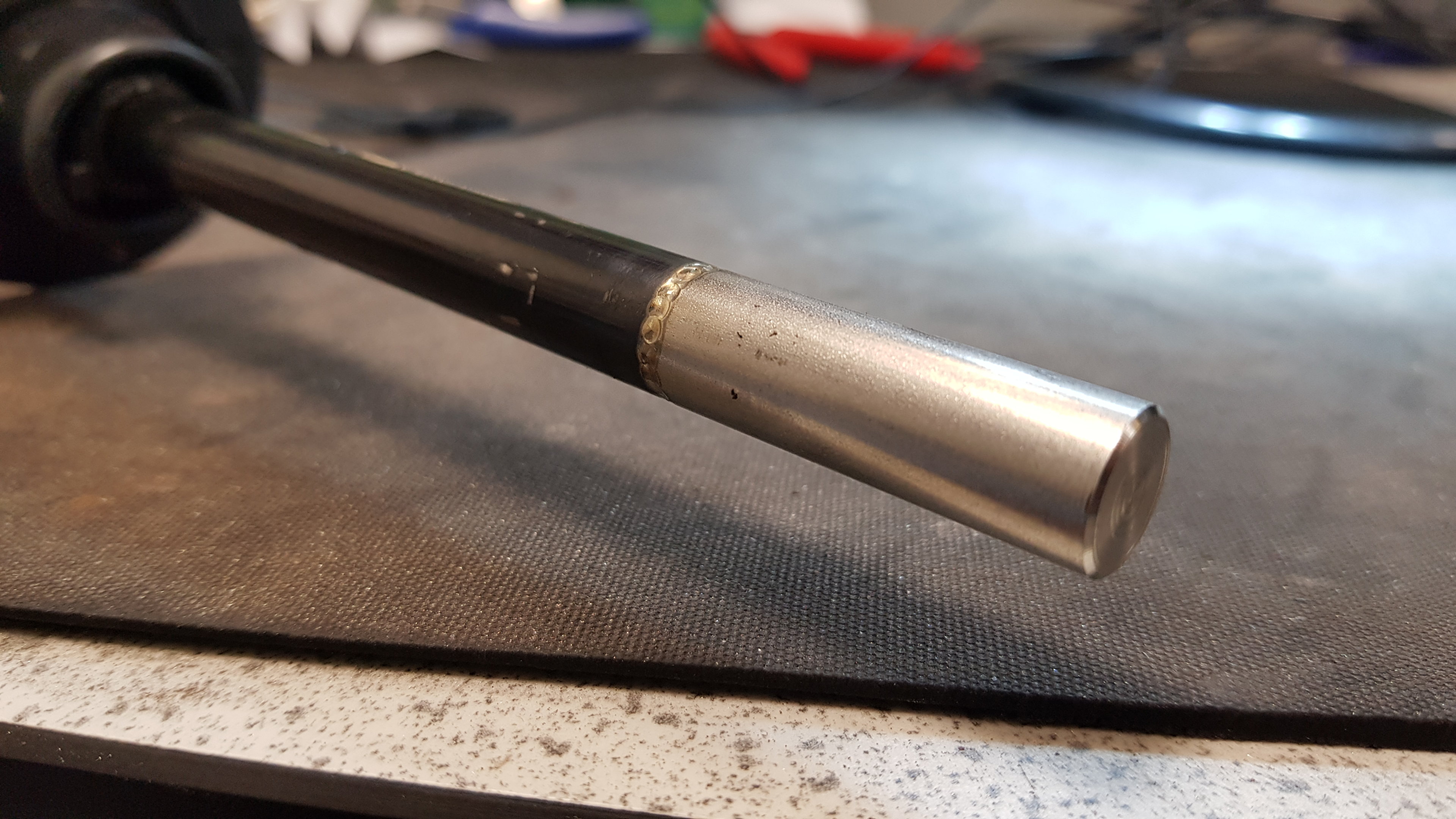

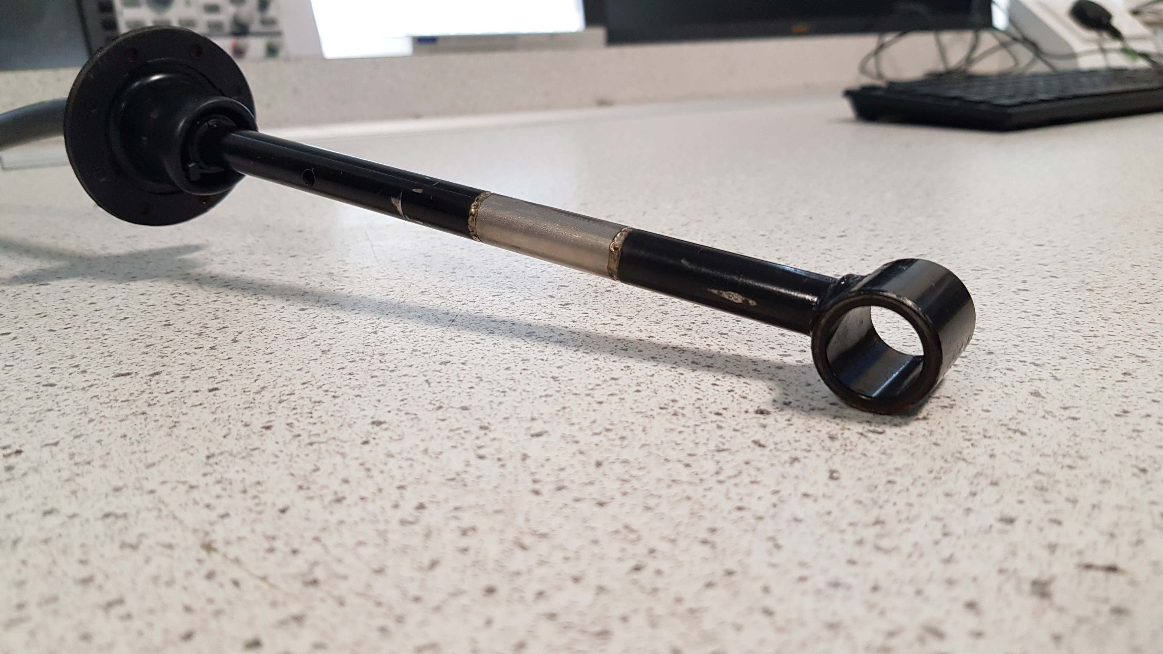

Restarted work on my modified shifter.
Cut it in 2, turned a piece of steel back to 1.5" and tig welded it back together. I'll be running a thicker bead with my mig when I get chance for extra strength.

Lovely and neat that mate, makes me feel warm inside haha! Turn up the tig and get some proper penetration on it though!
It's only a pulse tig welder, this was on quite a high power! I won't be using these as the main form of weld

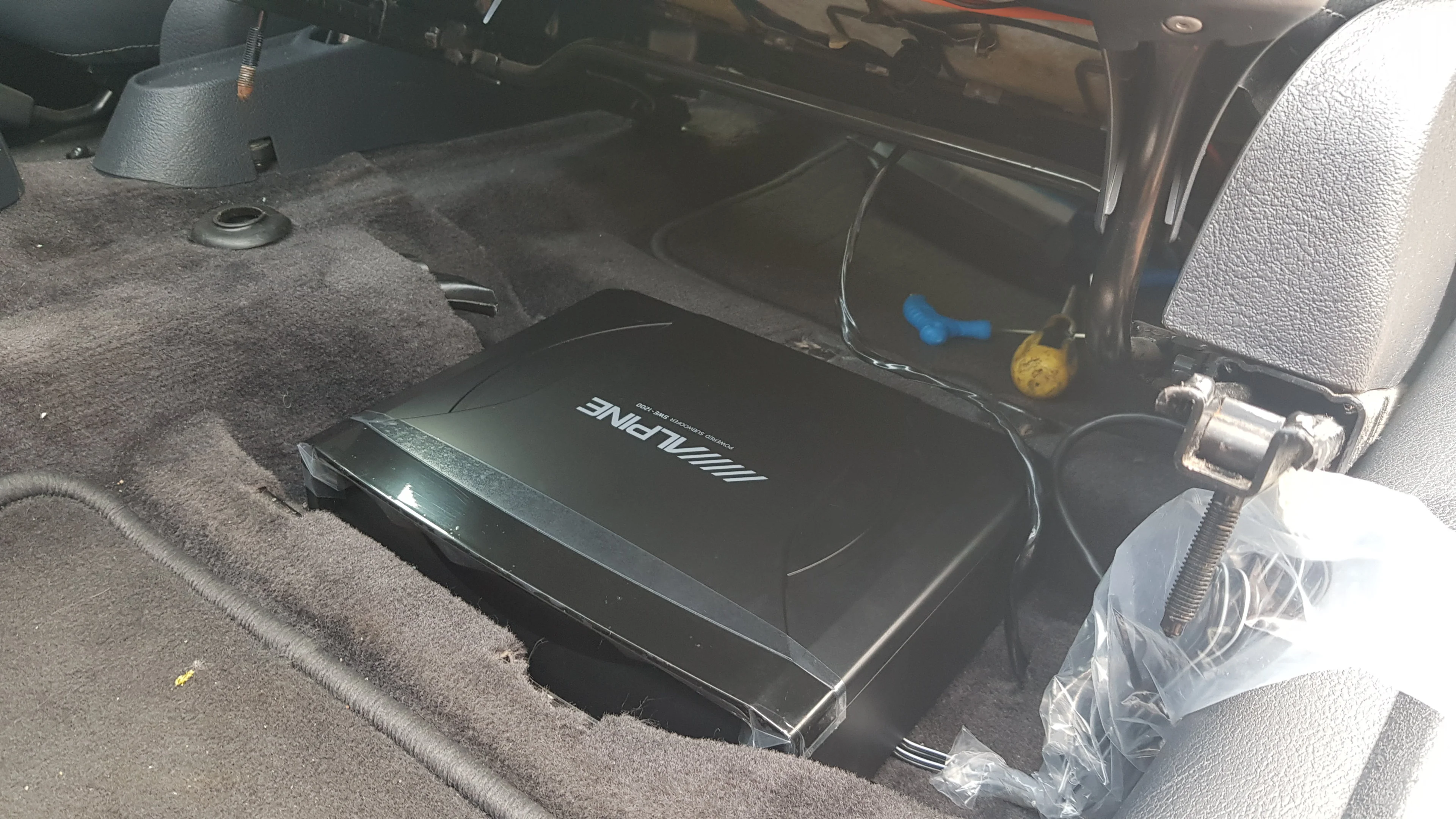

As there was a 10% off ebay code I treated myself to an underseat subwoofer. Been after one for ages!

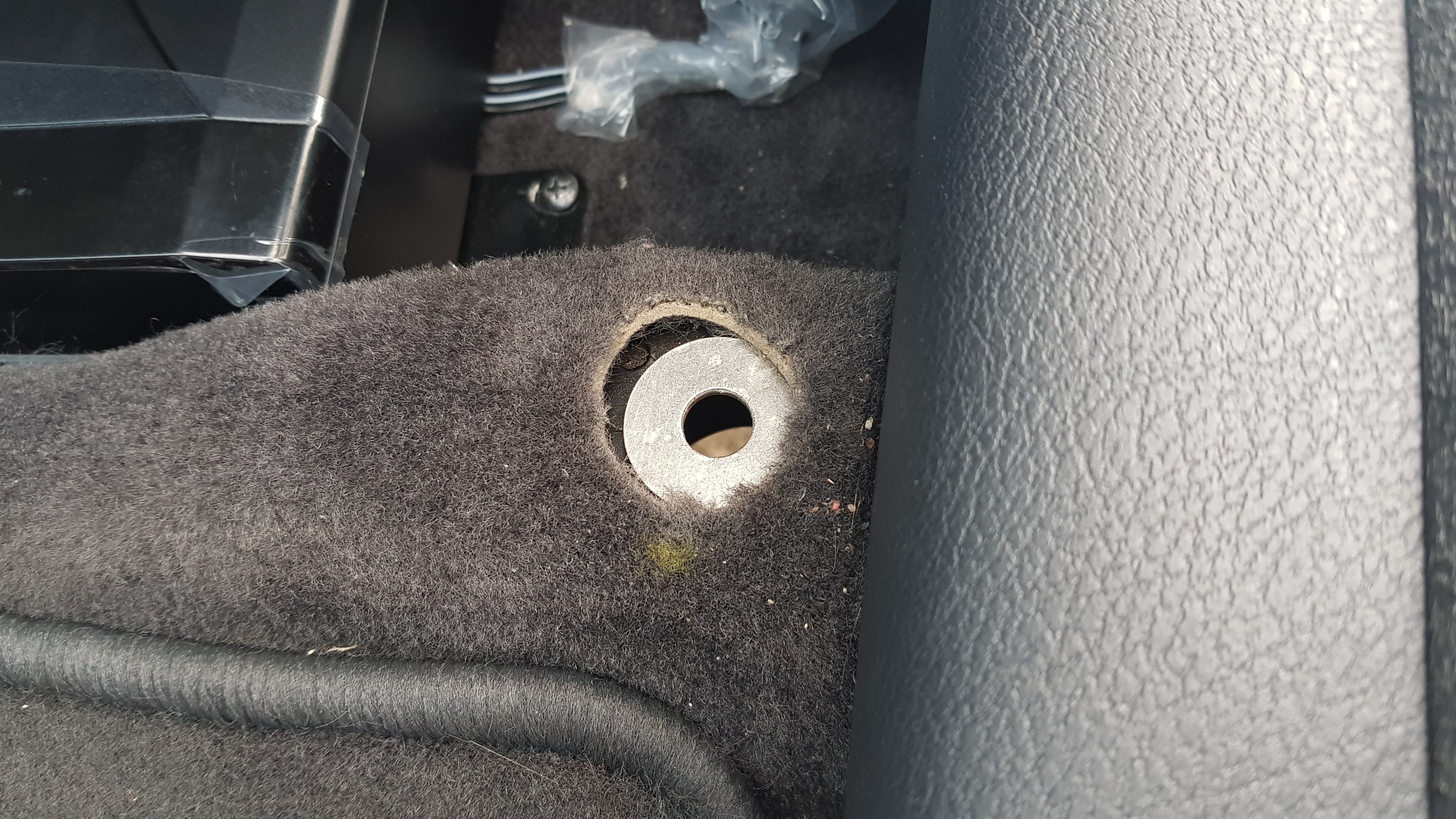

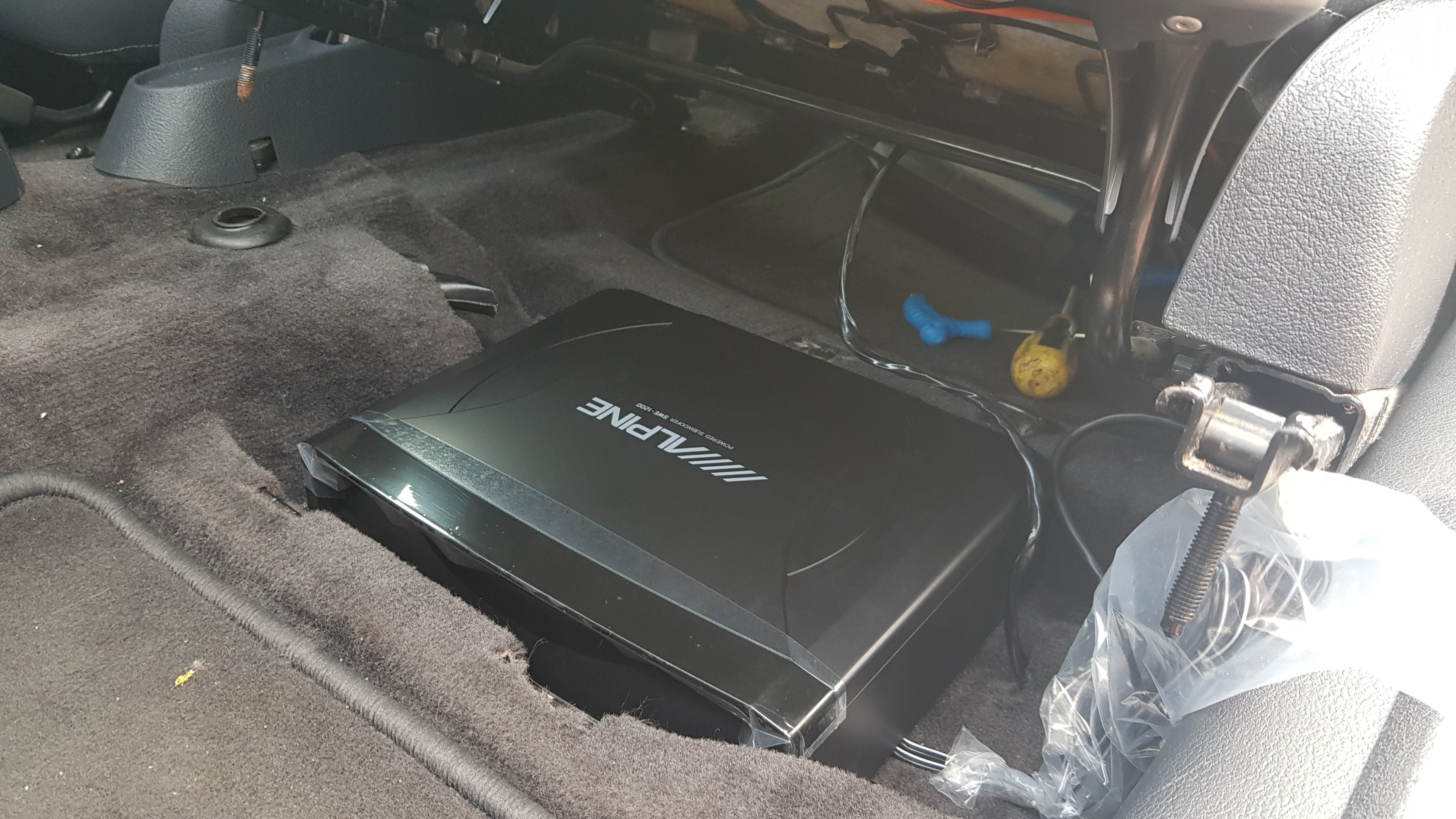

Managed to get the CD changer removed and the subwoofer fitted under the passenger seat. Slides in like a dream and I've drilled the floor then put some self tappers in to secure it in place.
I also removed the antivibration washers to lower the passenger seat slightly. Put some washers there to keep the runners free when sliding the chair. Was quite satisfying cleaning under the CD changer as it's probably 14 year old dirt under there ?

What does the underseat sub sound like ? Might get one for my dci
No idea yet! It's not wired up haha. I didn't realise I had to buy a male to male RCA, so got one from amazon coming tomorrow. Shame maplins has just shut down...
Louis
I Love Ed Sheeran
Also intrested in how the sub sounds. How much are they?
It'll be great for passengers ? Should sound pretty good for me too tbh. I have the satnav system under the drivers side so didn't want to remove that to put it there.
Cost me £134. Never had a subwoofer before, but didn't want one in the boot taking up space.

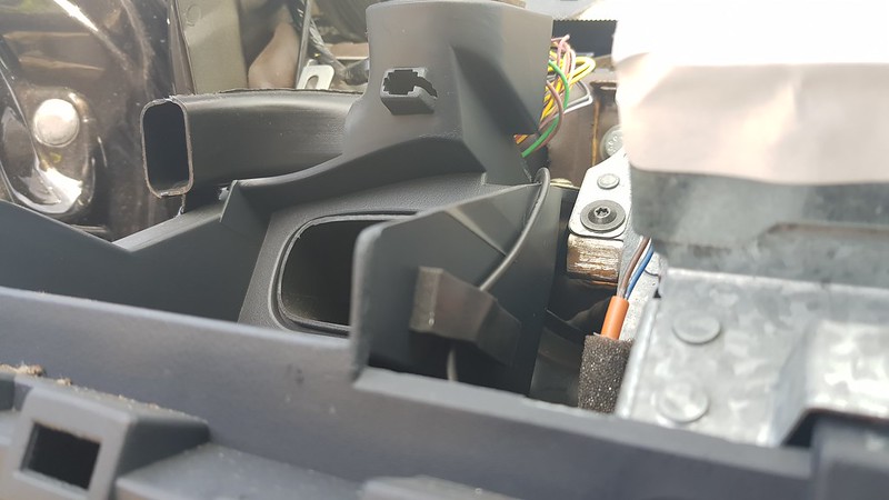

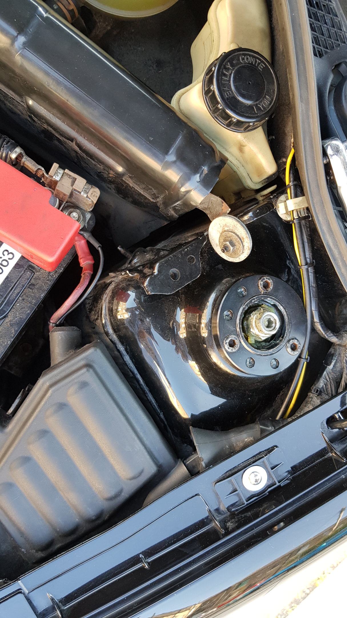

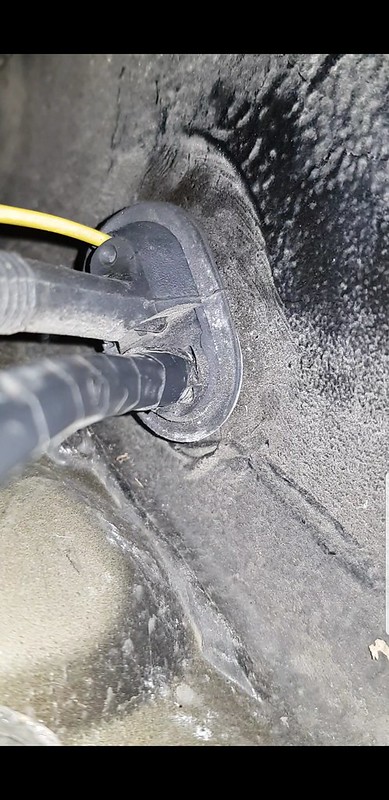

First up was the hardest part, piercing the bung under the passenger side and feeding through the battery cable. Took a lot of contorting to first stab a screwdriver through it, then used an empty bic pen to poke through and push in the cabling. To get at it from the other side it required the PAS reservoir and coolant reservoir removing as it's hidden behind the sound deadening.

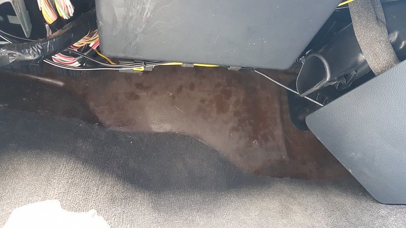

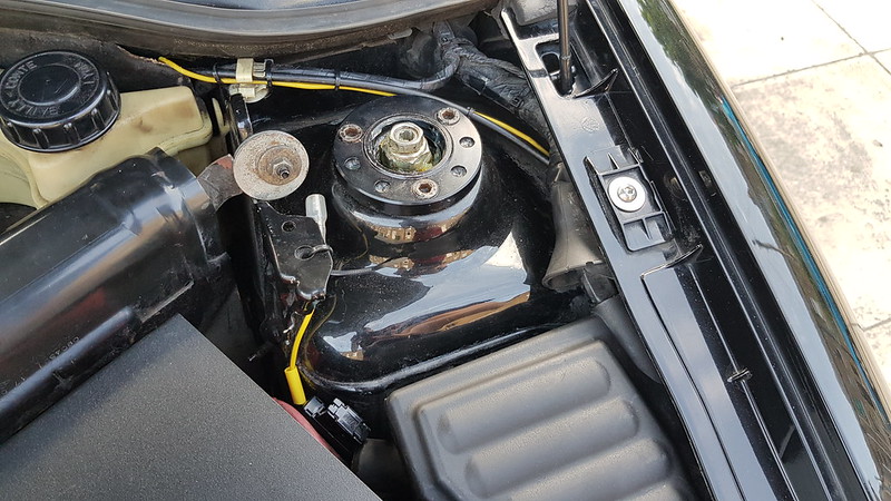

Cables routed round behind the top mounts, through the fuse box and up towards the pos terminal. I need to get a ring crimp to attach it to the positive terminal but that's tomorrow's job.

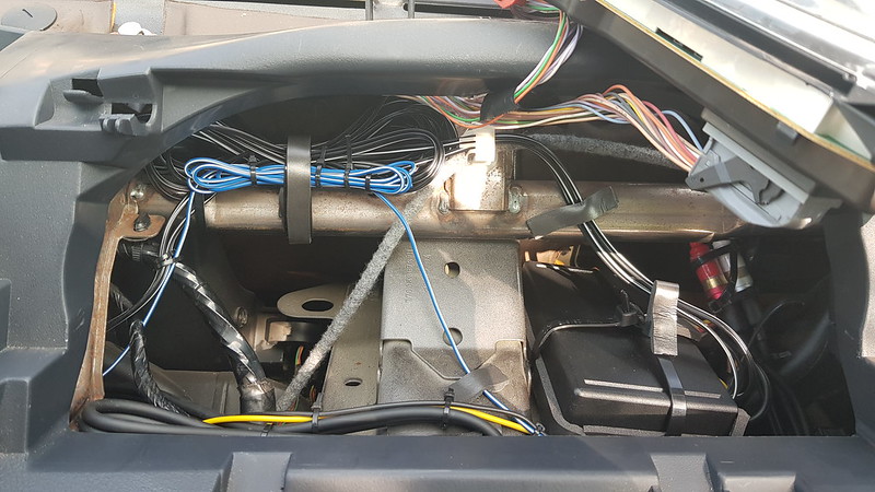

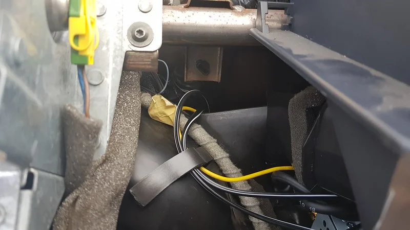

Fed the sub cables and power cables under the glovebox
20180610_181601 by Louis Walker, on Flickr

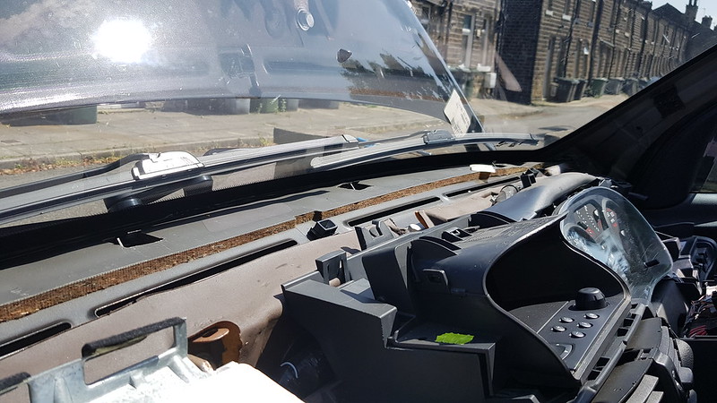

Removed the dash top as this is a 5 minute job and I wanted to fit the amp behind the Speedo as recommended by Gus

Cables fed up behind the glovebox and down into the top of the dashboard. Single sided foam tape is great for securing all of the cables in position!
20180610_165415 by Louis Walker, on Flickr

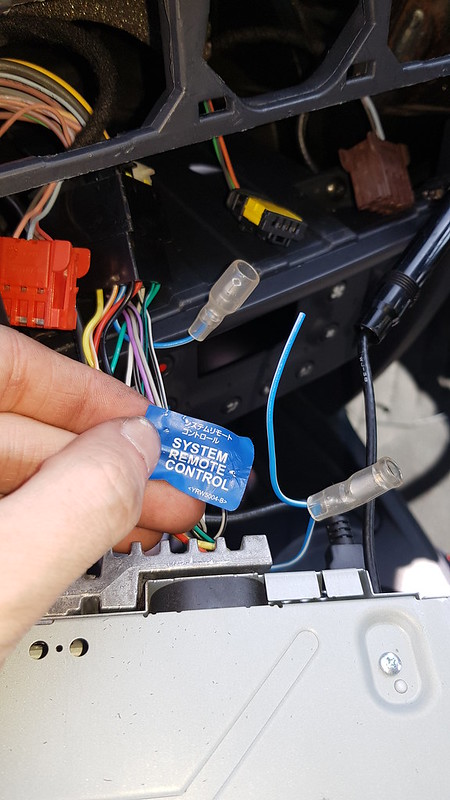

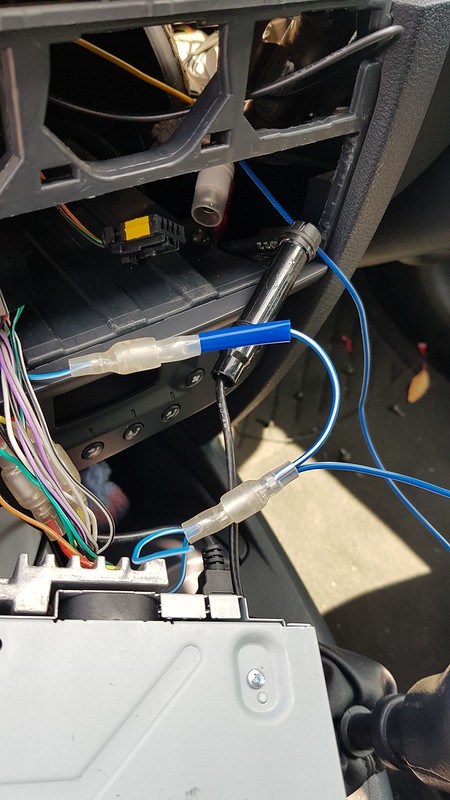

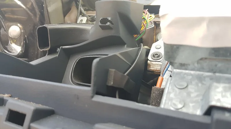

Pulled out the radio and connected up the the amp remote turn on

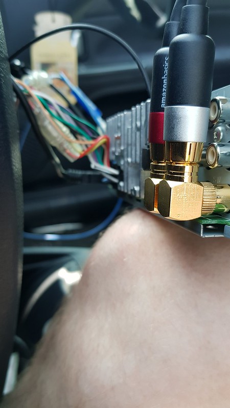

Amazon Basics RCA Cables fitted with 90Degree connectors to allow the radio to sit all the way back

Then behind the Speedo is where I positioned the small amp. I ran foam tape all around it then cable tied it in place. It's very secure!

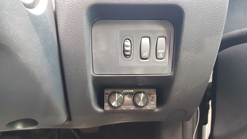

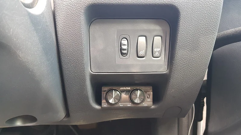

Cubby hole was drilled and the dials velcroed in position

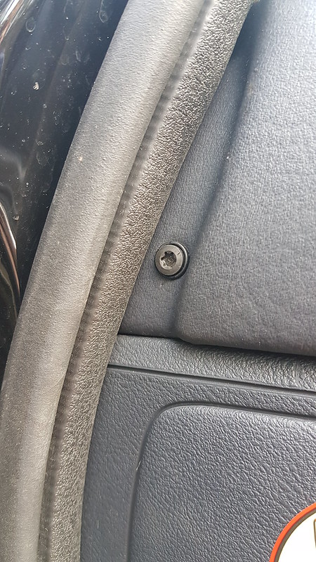

When refitting all the dash trims I put foam tape on the reverse and clipped them in as they've been buzzing recently when driving and stop on touch. I also did the same on the a-pillars and on the little tweeter covers.
In my box of trim clips I found some that were ideal for the dash sides as these were missing when I bought the car. Not sure if these are what were originally used but they're perfect and it's nice to have all the fixings in as they're meant to be.

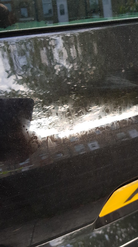

Tried to get a photo of my boot lid as you can see it has this weird staining that occured a few weeks back when a fallout remover dried too quickly. I had tried machining it off with menzerna but it came back on the next wash.
Any ideas how to remove it?

Try using more fallout remover, it may sound dumb as s**t but it may dilute itself down again and the fallout will get the crap out of the paint.
Unless it's really badly etched in there and then you may need wet sanding or a full repaint #RIP

I already tried more fallout remover, didn't help. I might just give it another pass over with the DA. Was literally left for about 30 seconds and rinsed off with lots of water. Only done it on the back end so must have been hot.
I machine it straight after and thought it had gone
