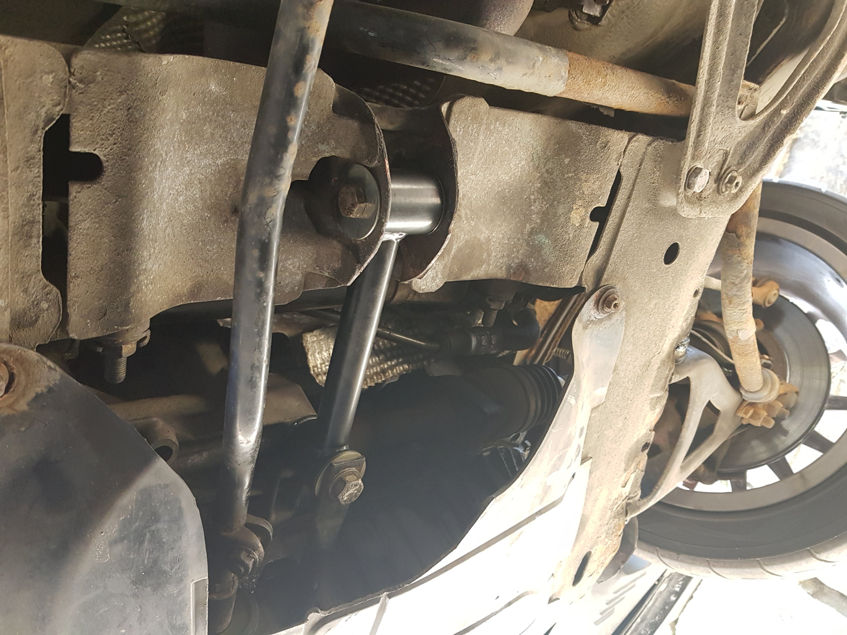

Removed the old polybushed dogbone and replaced it with my evol mount. I used some washers on the front part above and below the evol mount just to spread the load out across the bush.
Nipped up the bolts rather than torquing as recommended by @EvolEngineering2013.

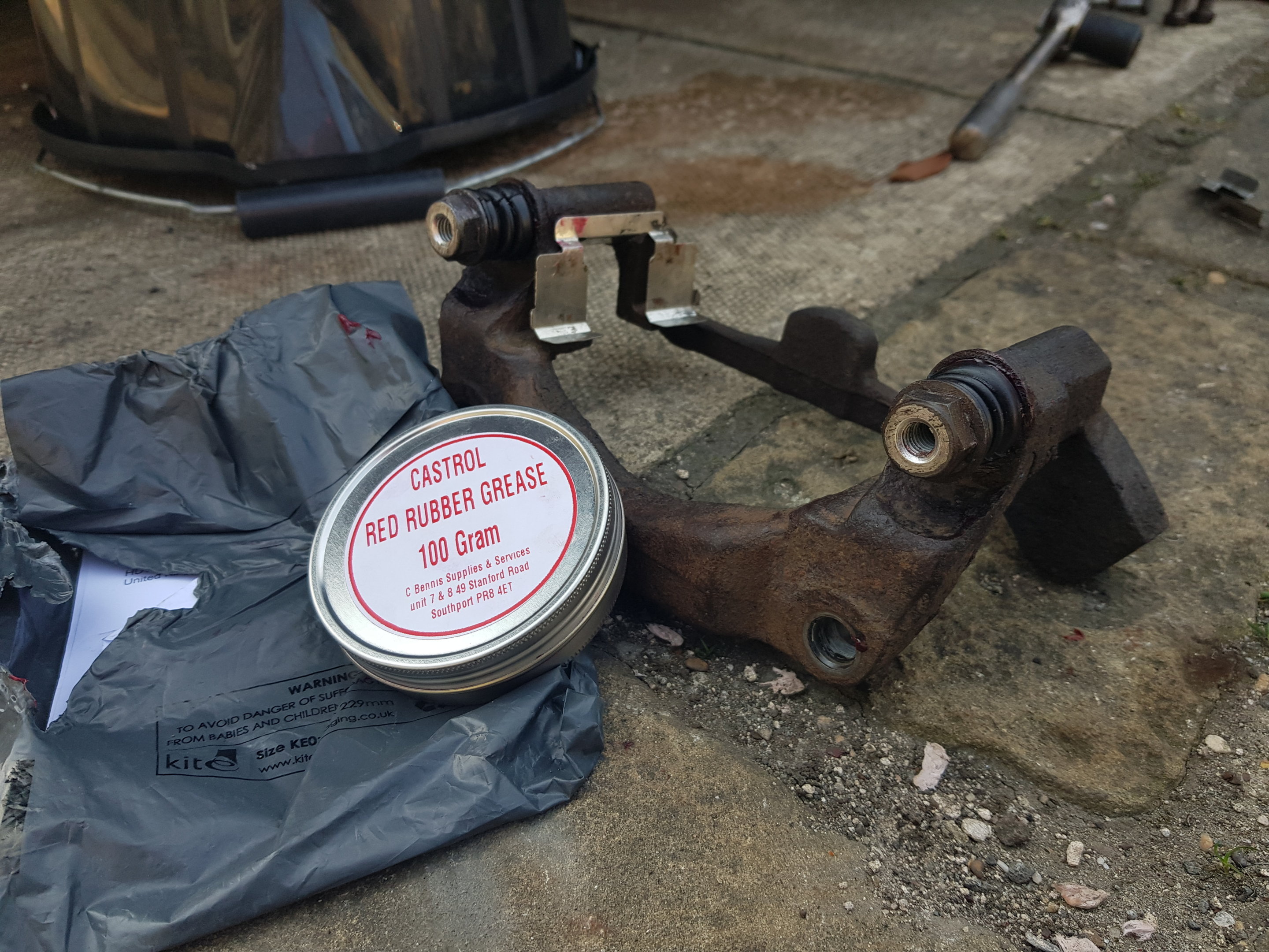

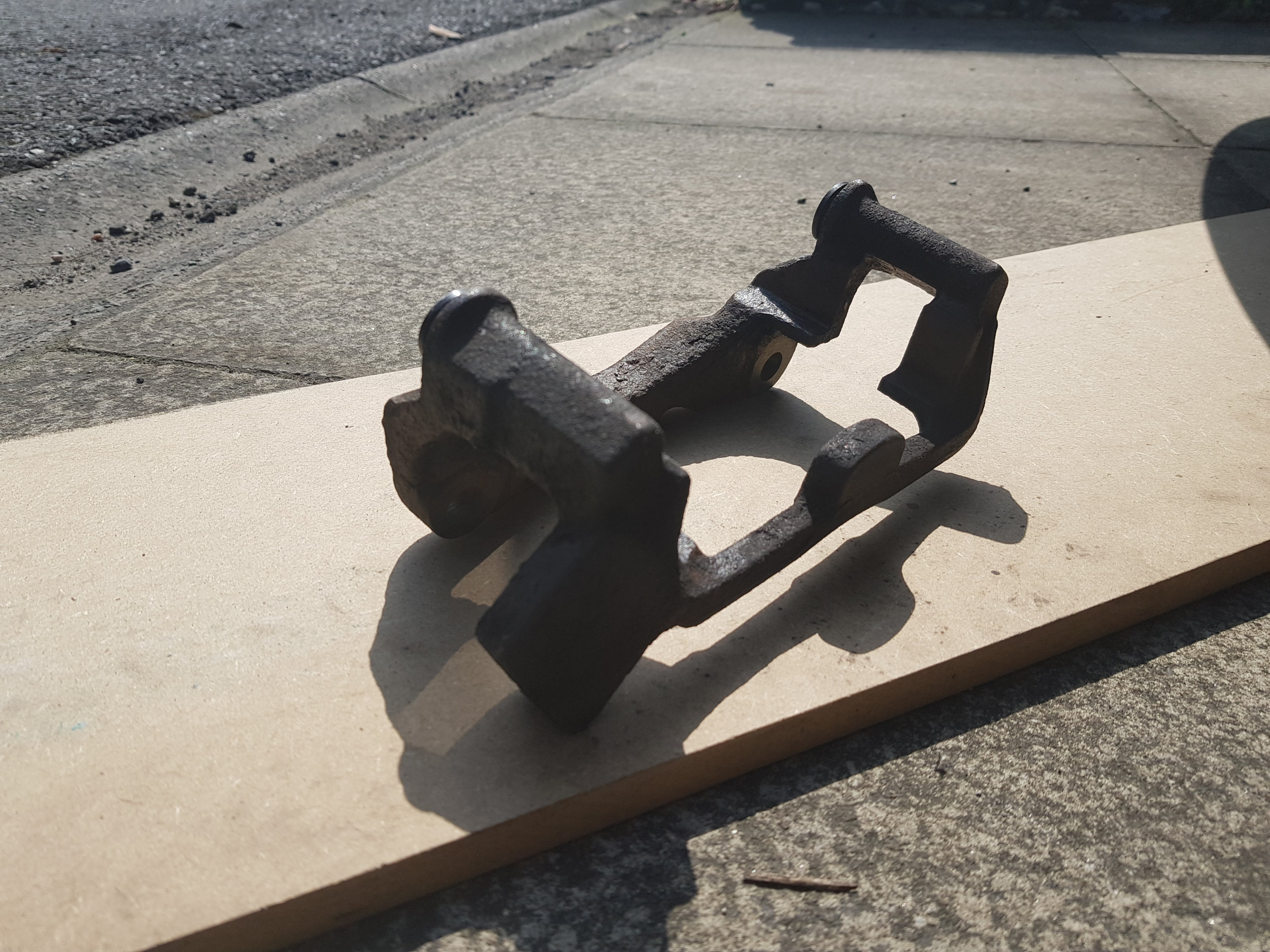

I then received a new carrier from a guy on the Facebook group. Unfortunately after cleaning it all up there was a bit more play in one slider to the other, just like the one on the car now.
As I'd spent time cleaning it and degreasing it I thought I may aswell change them over and just pack it with grease. I bought a small tin of red Castrol rubber grease to use on the sliders as to avoid damaging the rubber seals.
I had replaced all my sliders last year and they were still in great condition but only had a very small amount of grease left on them. These were cleaned and the carrier holes packed with just enough grease to limit movement but not too much to create a vacuum.
I did both sides and cleaned up all pads and pad slider clips before reassembling. Physically it felt like there was less side to side movement but wear in this top slider hole must be common as all 3 carriers I have were the same.

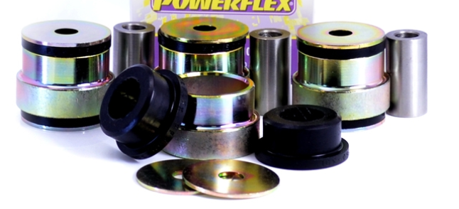

Aren't the polybushed wishbones meant to have a special washer on them?
Where abouts? I'm running washers either side of the wishbone bushes

The big ones at the bottom iirc
Yeah I'm running those. That's not what was loose!

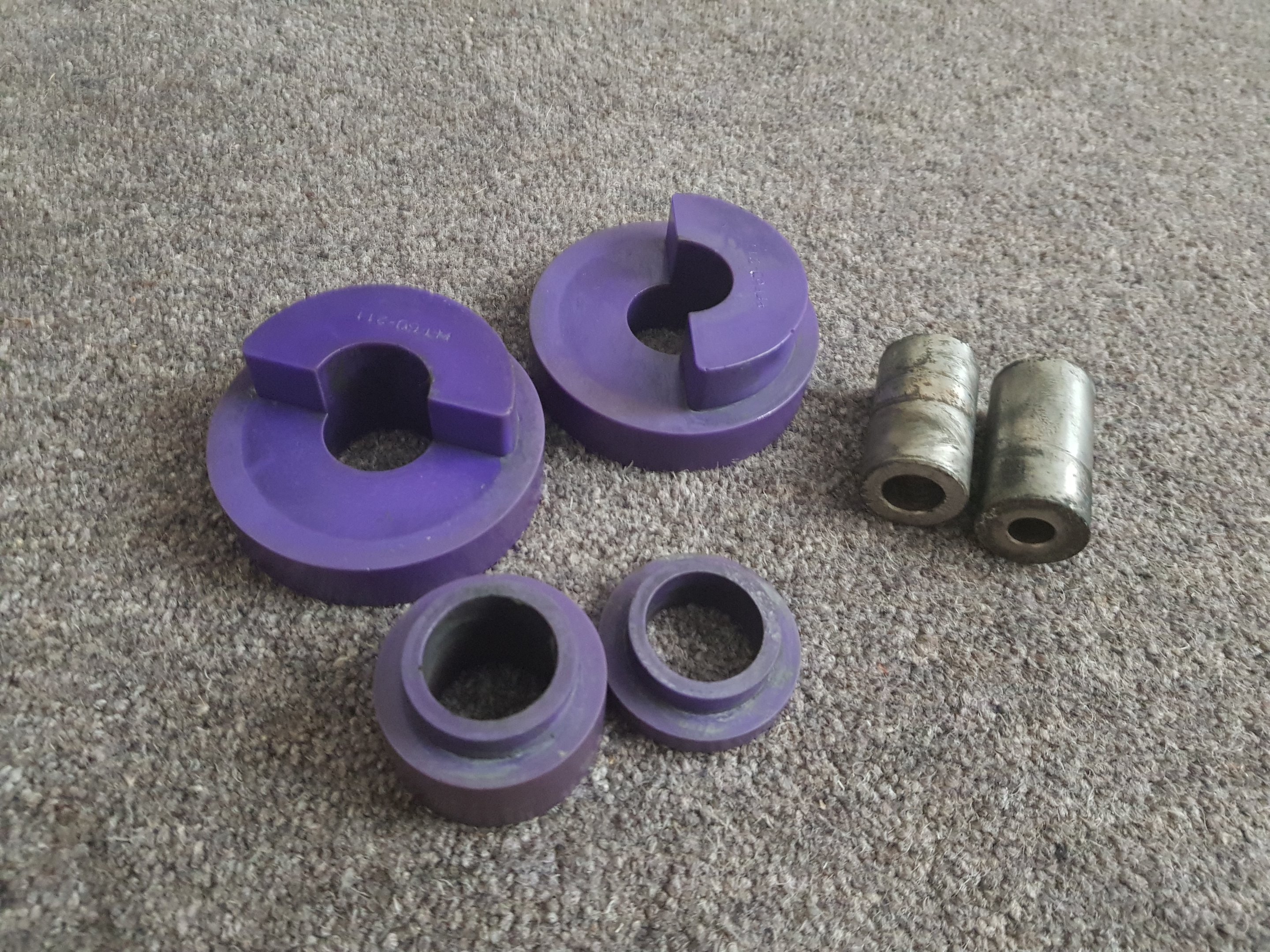

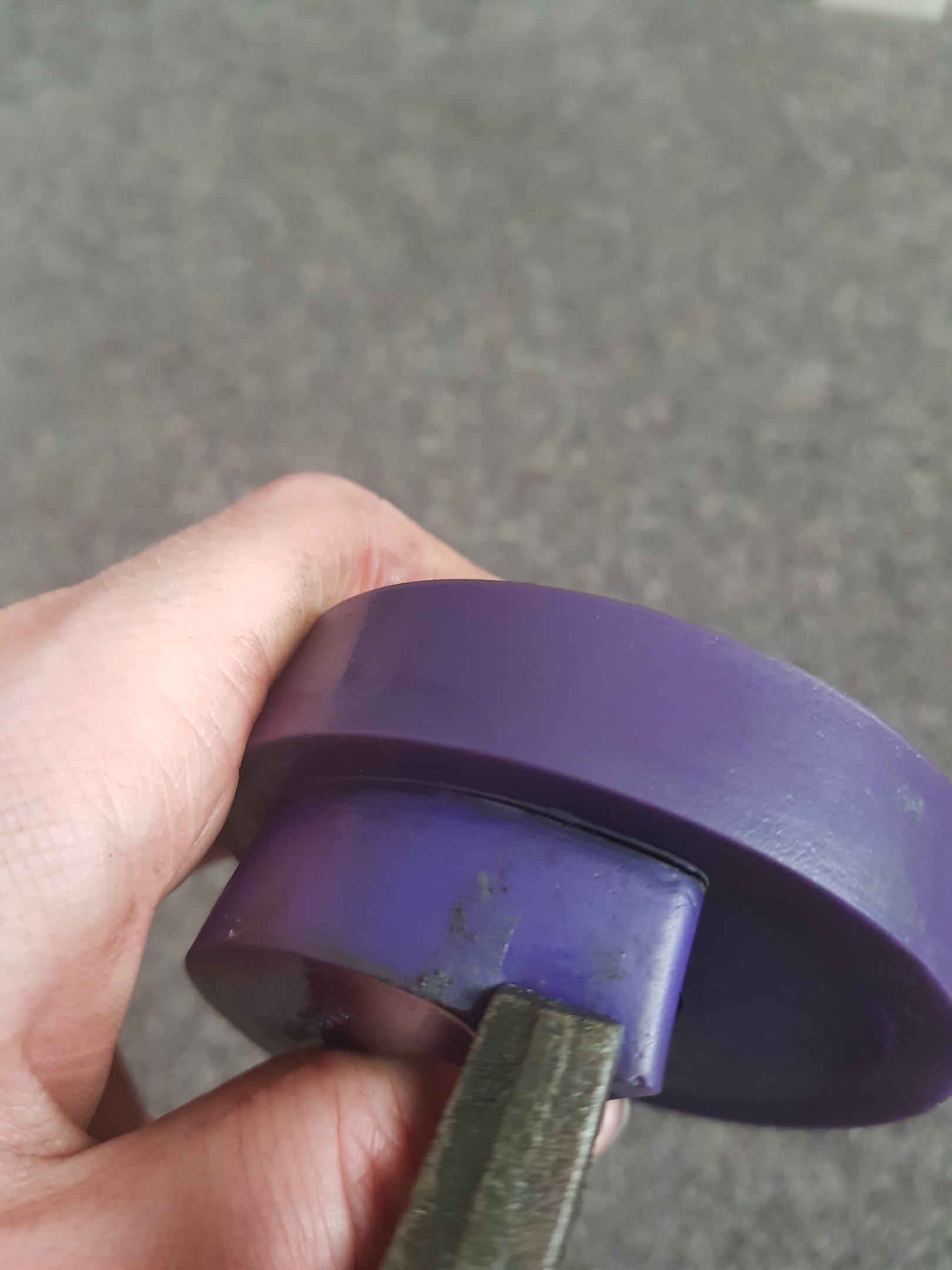

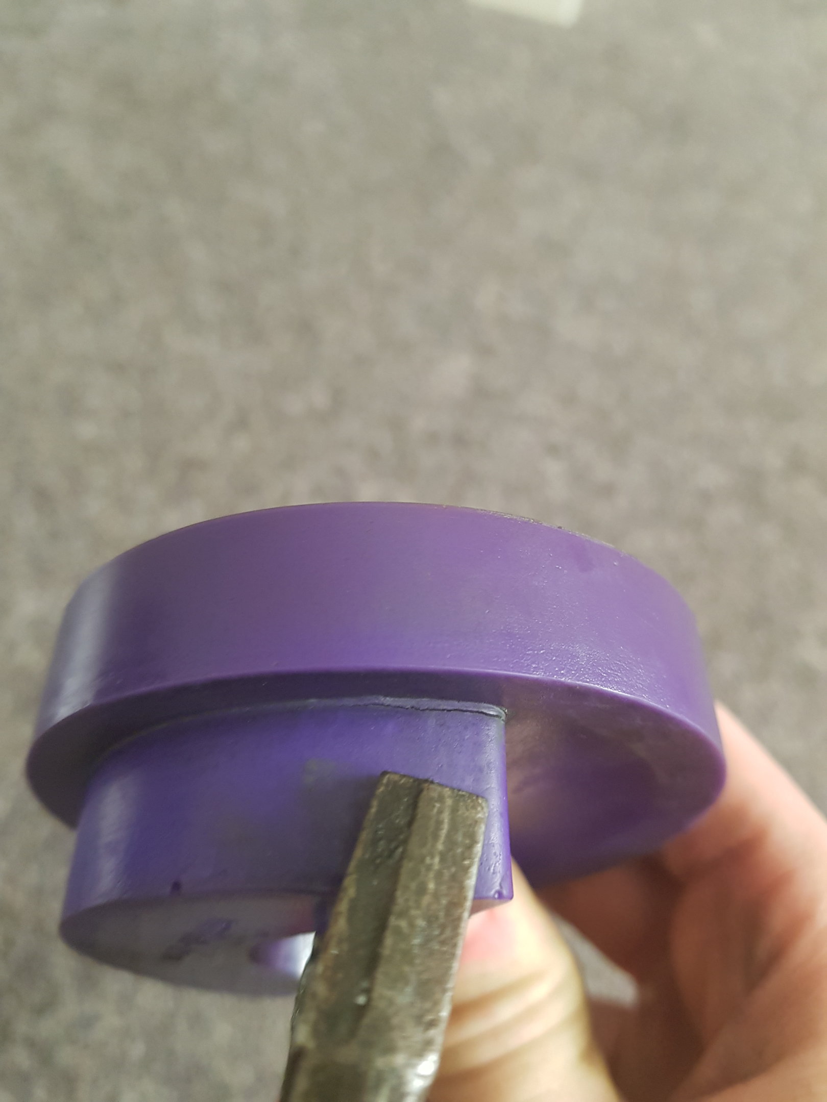

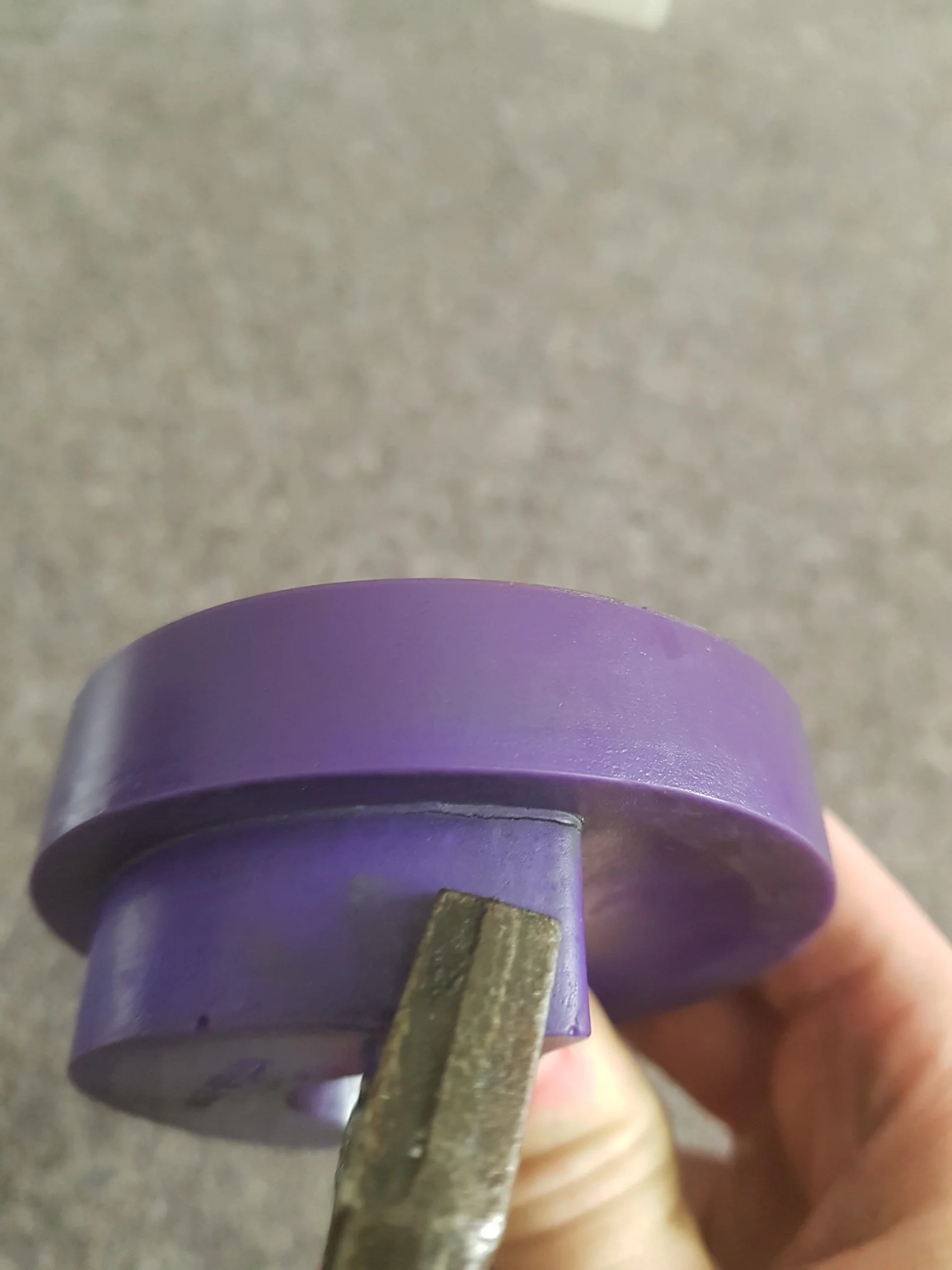

Removed the dogbone polybushes and they're the old design that powerflex changed from.
I levered them with pliers slightly and you can see they are cracking around the edge. Don't know what sort of impact this would have been having?

Just been out and the gear changes are transformed. Wonder if that wear in the bush was causing me some problems?
I also now have zero knocks. Just a s**t ton of vibration from the evol. Presume it'll settle?

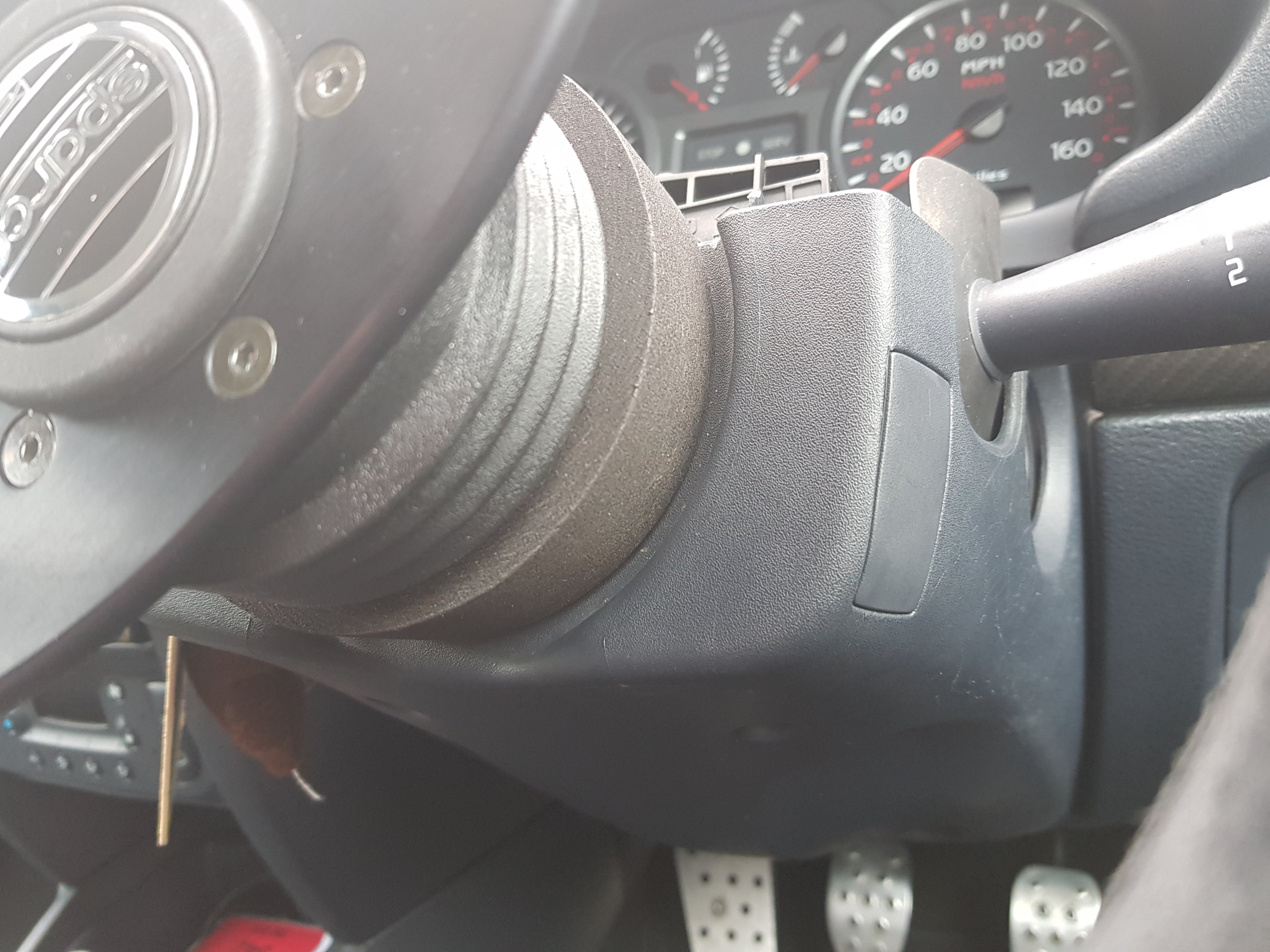

That does look very neat actually!

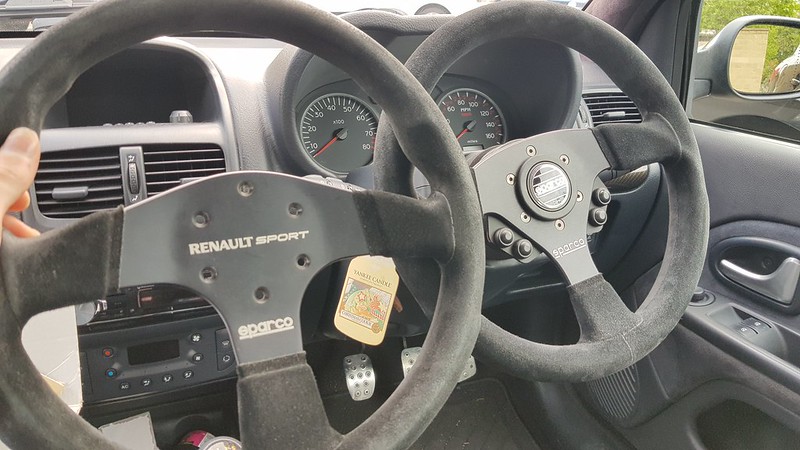

I know you've said before you don't understand why people remove the audio stalk but I've never touched it in all my Clio ownership!
Didn't like how it looked once the smaller wheel was fitted either. Just the little things! I wont be binning it, just go in with my other OEM parts pile

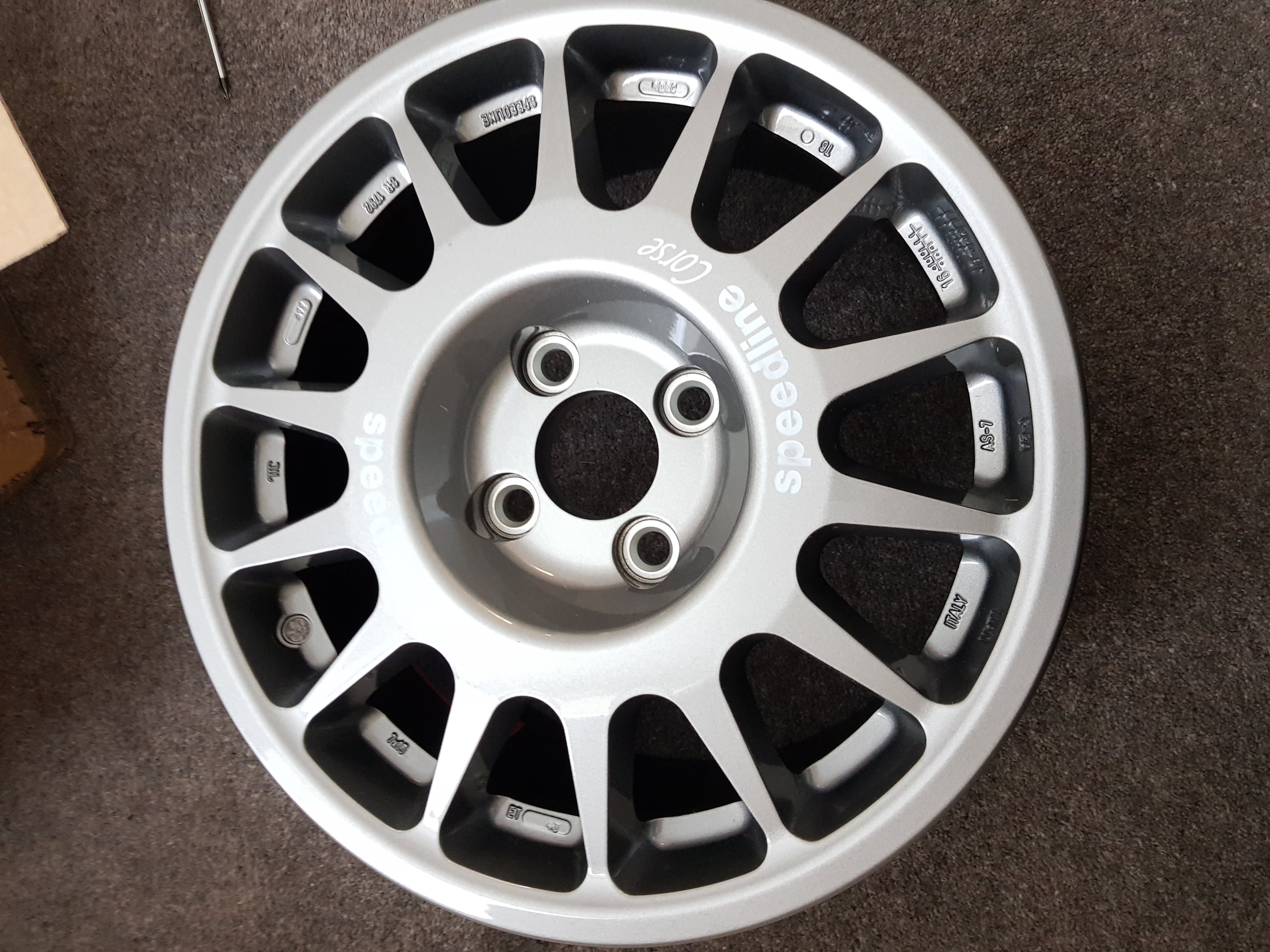

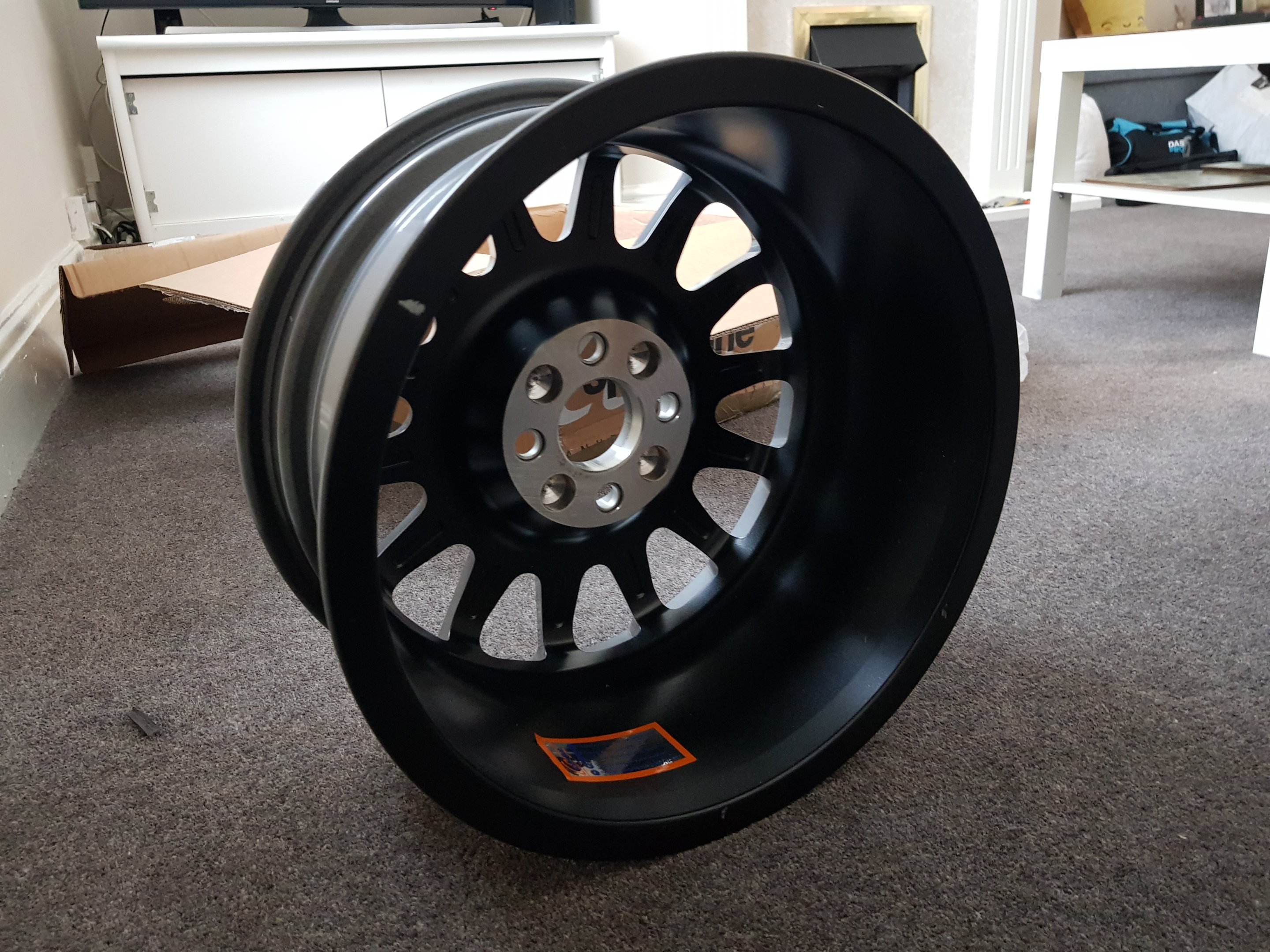

I bought these as they're a bargain and makes more sense than refurbing my current ones.
Can't beat factory brand new powdercoat and they also have black insides whereas my current ones don't.
They'll be for sale soon with barely worn ad08rs.

Black insides? That must be a new thing!
Louis
I Love Ed Sheeran
I'm not sure tbh! They were brand new never fitted by the person I bought them off but don't know when he bought them or when! My other ones are anthracite inside but these black. Not sure whether to remove the stickers inside or not.

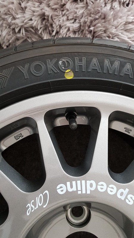

Even fitted the AD08R's properly with the yellow dot by the valve.

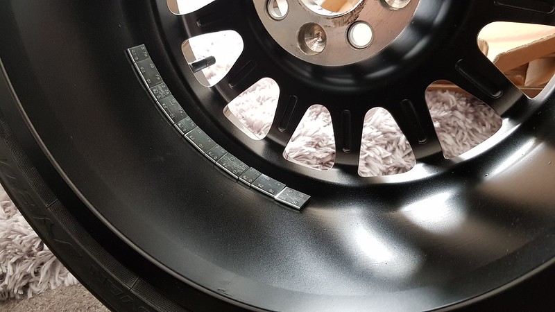

Most wheels balanced up fine, but one of the tyres took a little more weight than the others. Pretty strange really, hope I experience no problems.

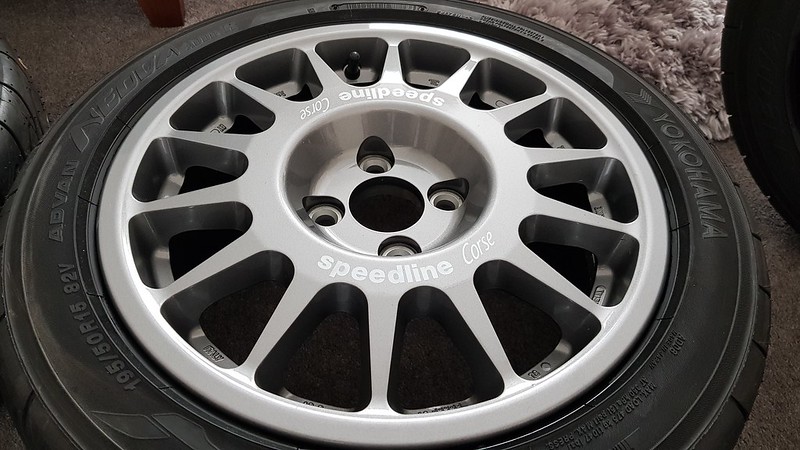

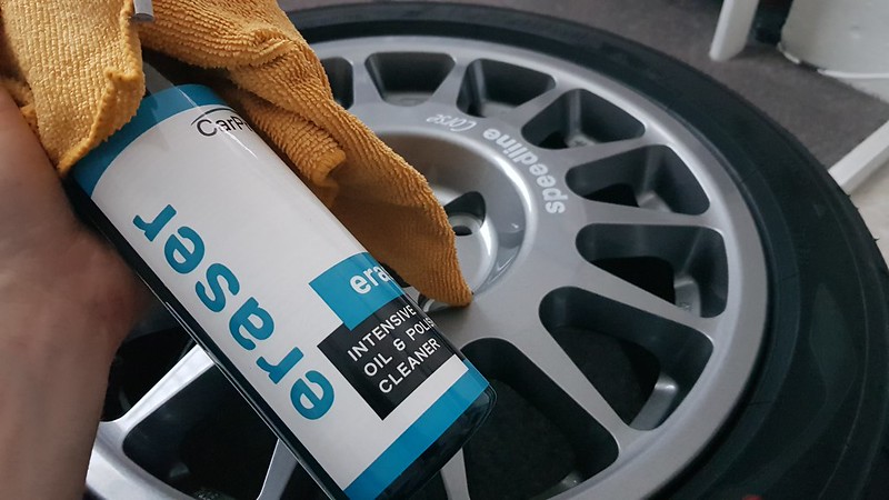

To get them ready for fitting I cleaned them up with some Carpro Eraser then have finished them up with some Gyeon Rim quartz coating. I've done two, need to do the others when I get time!

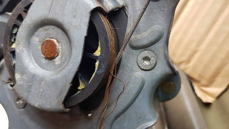

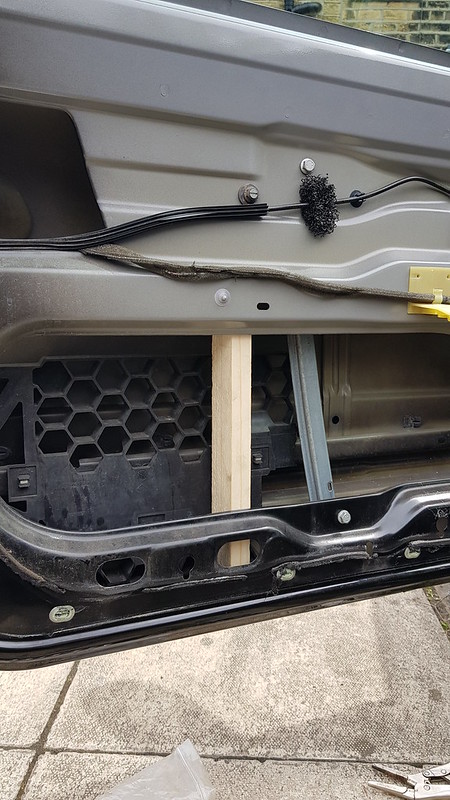

When I got back from Kwik-fit my passenger window decided to stop going up. Removed the doorcard to find this...
20180512_112928 by Louis Walker, on Flickr
A quick bodge sorted me out for a few days before my regulator arrived
20180512_123536 by Louis Walker, on Flickr

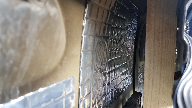

As the doorcard was now off it seemed a good time to get some silent coat sound deadening inside there. There was a noticeable improvement to the speaker quality and there was slightly reduced road noise after refitting the doorcard.
20180516_175452 by Louis Walker, on Flickr
I got the new regulator back in place at the same time. So frustrating not having a working window but thankfully an easy fix. Much better than some other cars where the window is bonded onto clips on the regulator. Renault did good here with a hole in the glass.

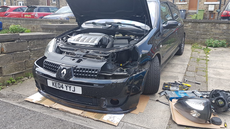

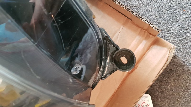

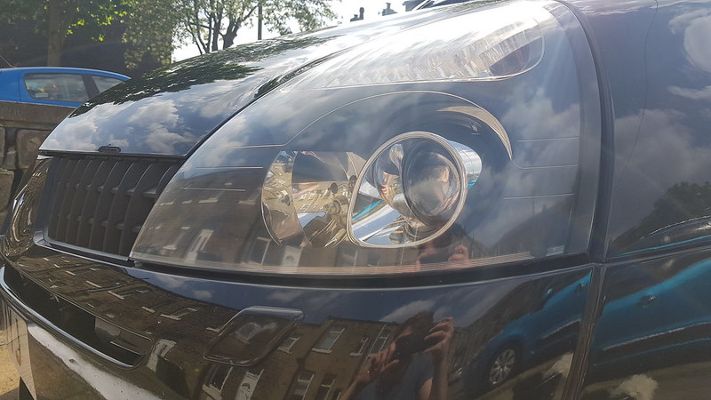

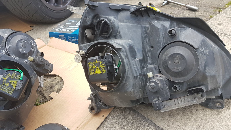

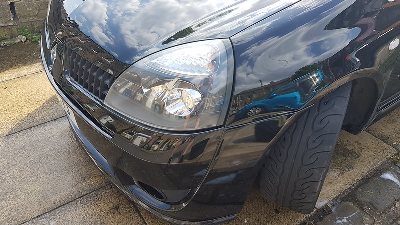

Next up was fitting the black insert headlights that I had been sitting on for a while. They were sanded right back and polished up before fitting but halfway through I found a broken clip on one of them... So I cut one from my salvage light, cut it until they both mated up correctly then plastic welded it into place. It was then backfilled with epoxy to strengthen it further. Worked great!
20180520_081910 by Louis Walker, on Flickr
20180519_181744 by Louis Walker, on Flickr
Bumper off
20180519_140620 by Louis Walker, on Flickr
Swapping over the Silvervision indicator and xenon Osram bulbs
20180519_140628 by Louis Walker, on Flickr
Both on and after a quick wash
20180520_155611 by Louis Walker, on Flickr
20180520_155559 by Louis Walker, on Flickr
20180520_155621 by Louis Walker, on Flickr
20180520_155627 by Louis Walker, on Flickr
Very subtle but much better than the grey when against the BG!

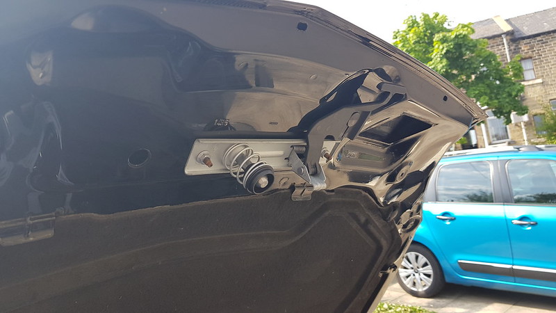

I had intended to dip my bonnet catch into some deox-c but a cheap genuine unused catch came up for sale on the fb groups for £12 so I grabbed that. Even came with some new genuine nuts!
20180517_124933 by Louis Walker, on Flickr
20180520_163250 by Louis Walker, on Flickr

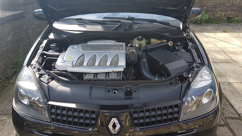

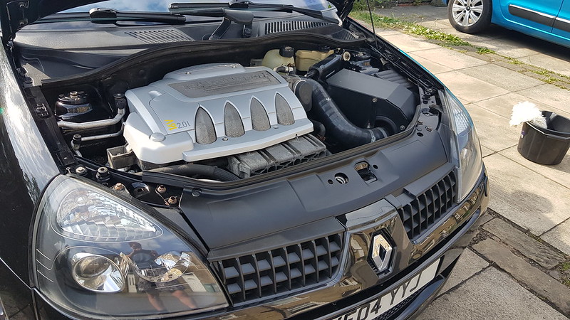

Gave the whole engine bay a going over with a detailing brush and some Autoglym engine cleaner.
20180520_163229 by Louis Walker, on Flickr
20180520_163240 by Louis Walker, on Flickr

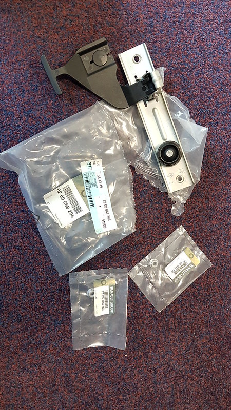

I have a ph1 stalk to go on anyway so will fit this whilst I'm there! I like the one I have fitted now as the lettering is engraved much further.

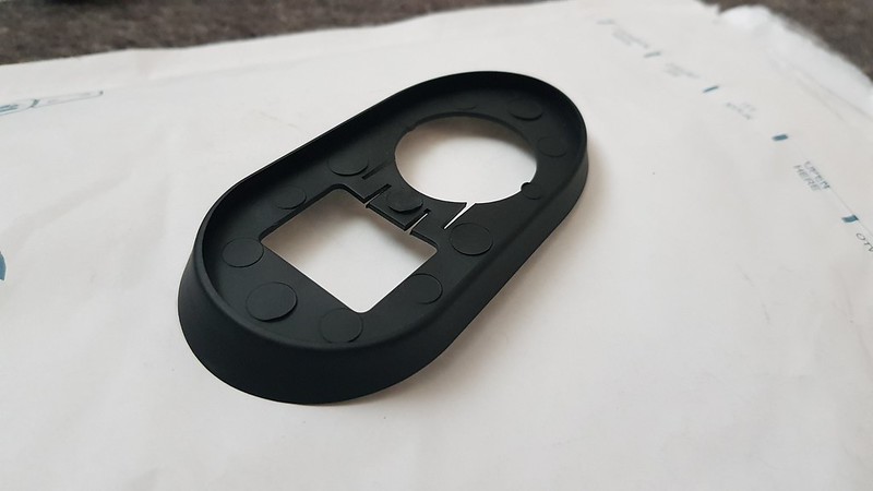

Finally, I managed to find some genuine clio aerial gaskets that are for the clios with the satnav aerial base! These are ultra rare and I had to get it from Germany but I can't wait to get it on the car as the gap that is there currently is awful.
