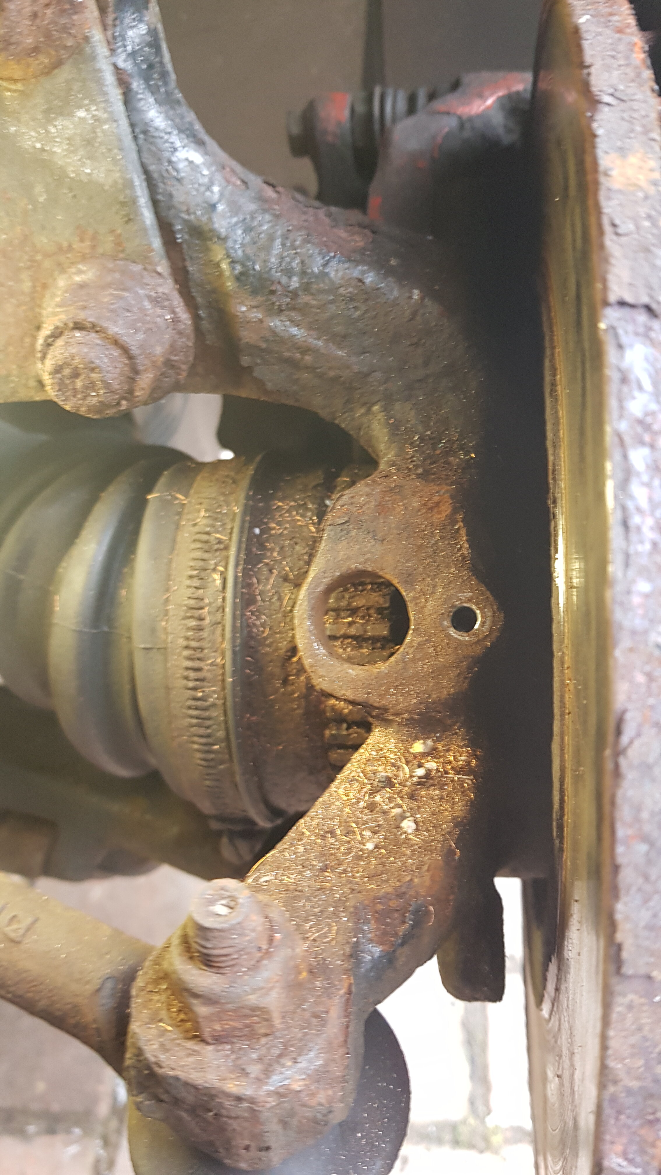

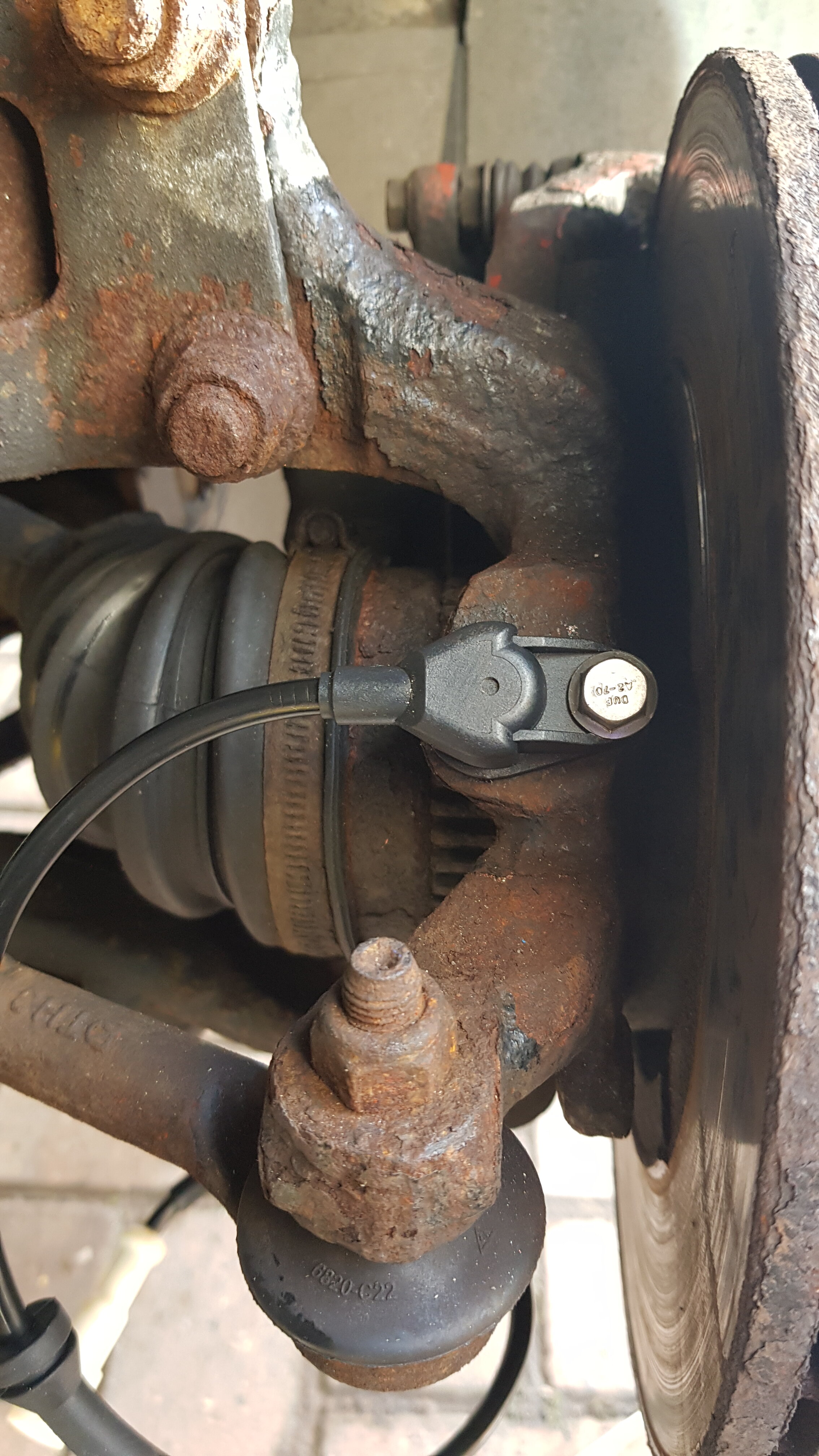

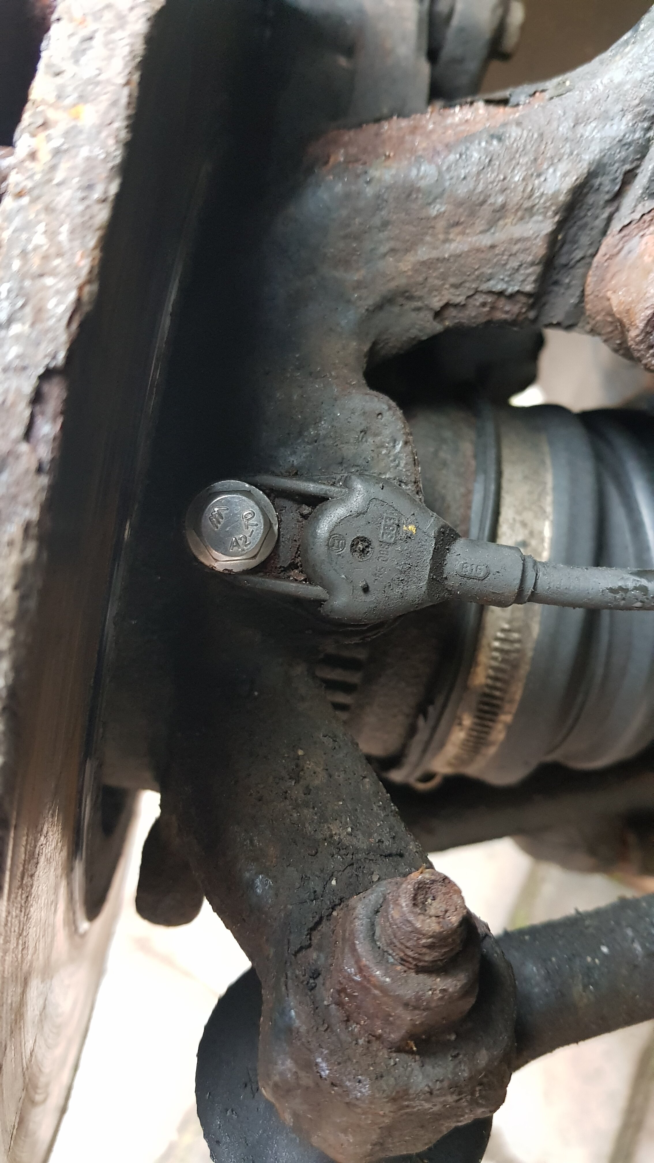

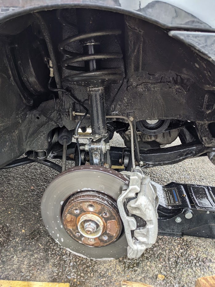

Couple of weeks back my ABS light started to flash on during journeys. It would reset itself when turning the car off and on but it got to a point where it was permanently on.
Got the multimeter out today and measured the resistance on both front corners. I was unsure what I was actually looking for in terms of resistance but they were both wildly different so I knew it was one of the fronts. I had some cheap ebay sensors I'd bought recently so compared the resistance to these and concluded the offside was the problem sensor.

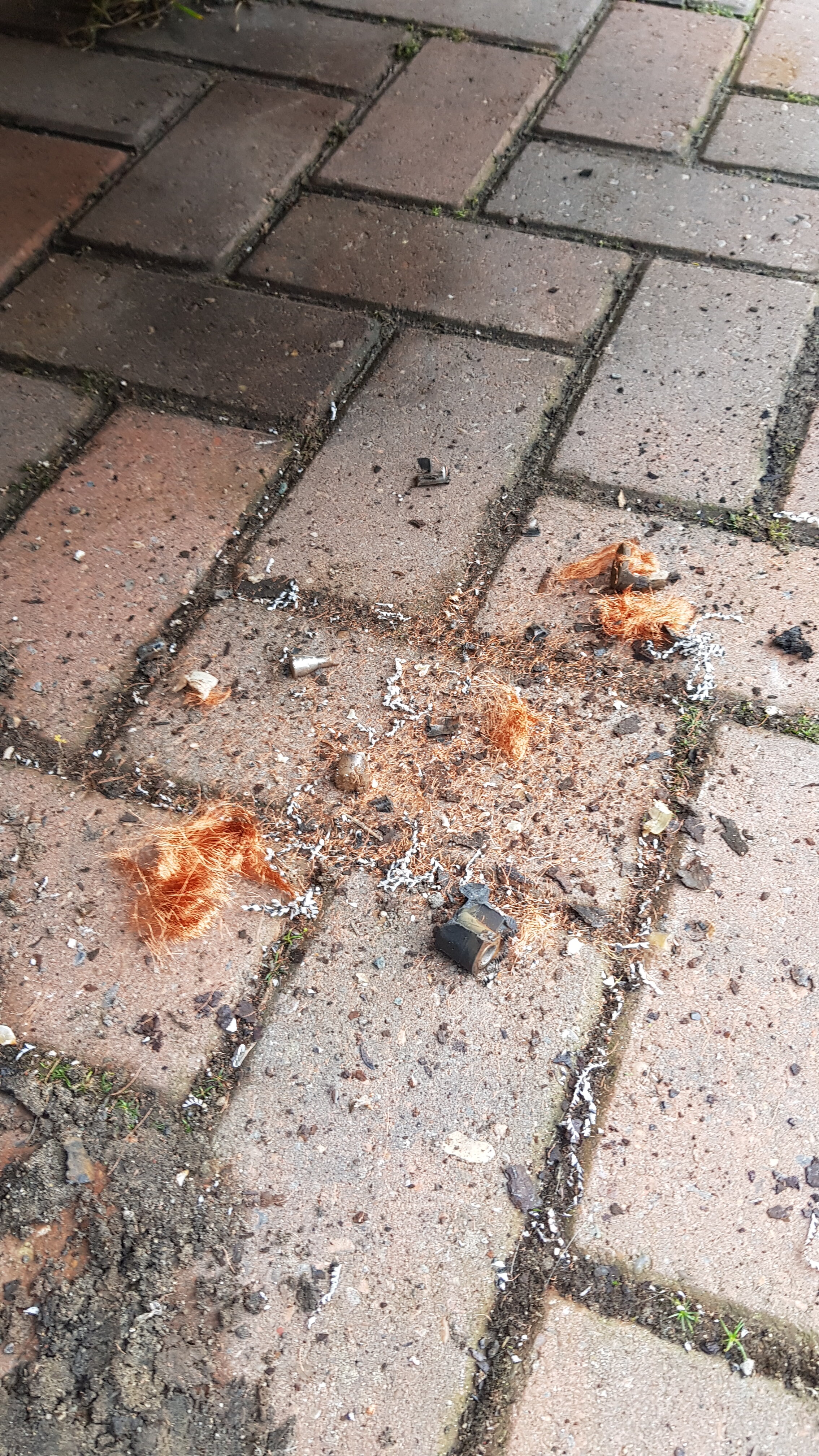

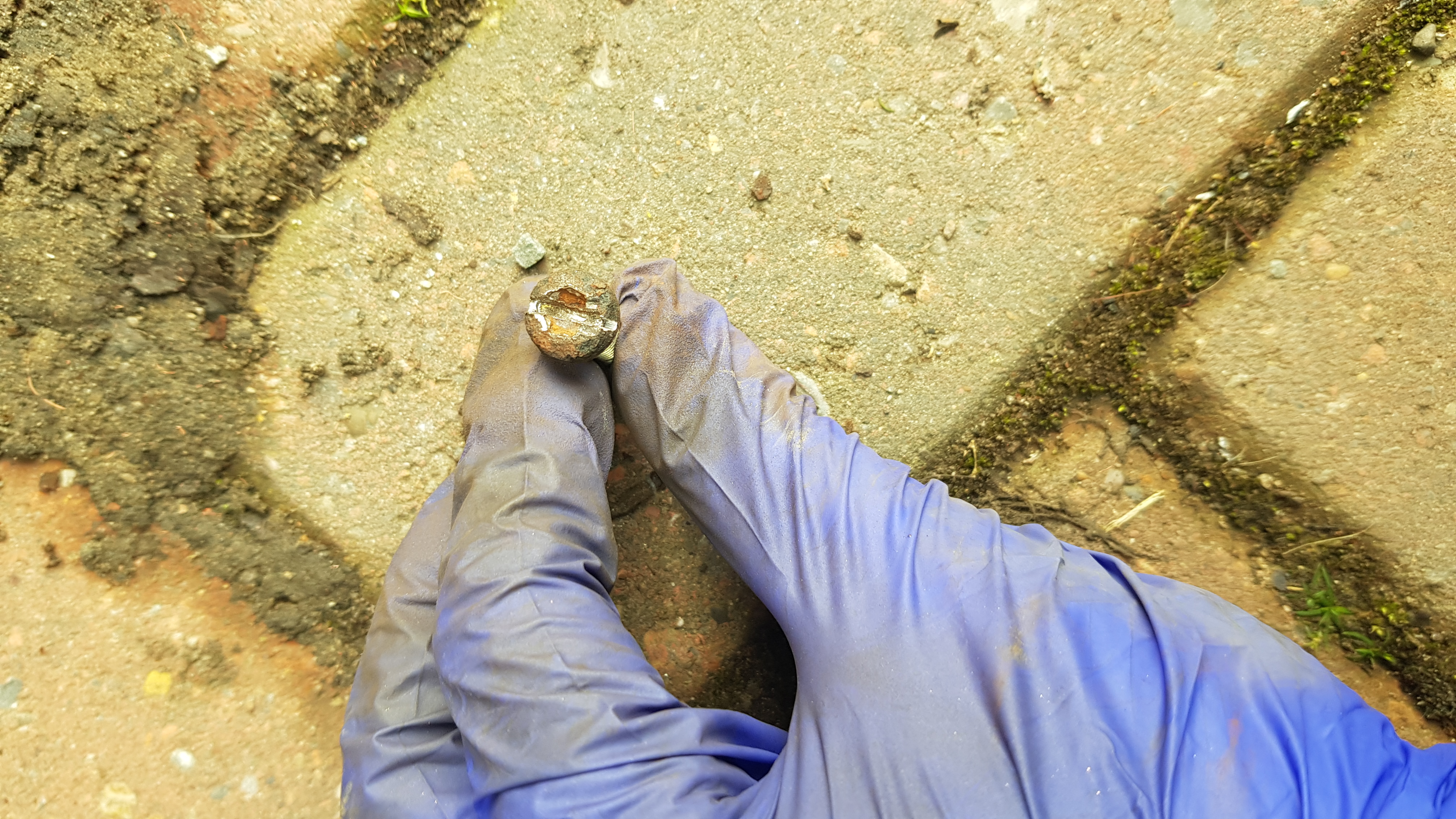

Obviously the torx completely stripped out the head of the bolt but I managed to hacksaw a slot into the head and use an impact driver to remove it.
From here I used a combination of a drill, hammer, punch and screwdriver to remove the old sensor. It was pretty messy but got there in the end!
Hole cleaned up and greased before tapping the new sensor home using a block of wood.
Stainless bolt was fitted with liberal amounts of copper slip. Felt lucky so decided to see how the nearside bolt would move and this came out without any hacksawing! Shoved a stainless bolt in this side too to make my life easier in the future.
ABS lights all now off after a short drive up and down the driveway, a full test will be completed tomorrow. This was only a 15quid sensor so we shall see how long it lasts!

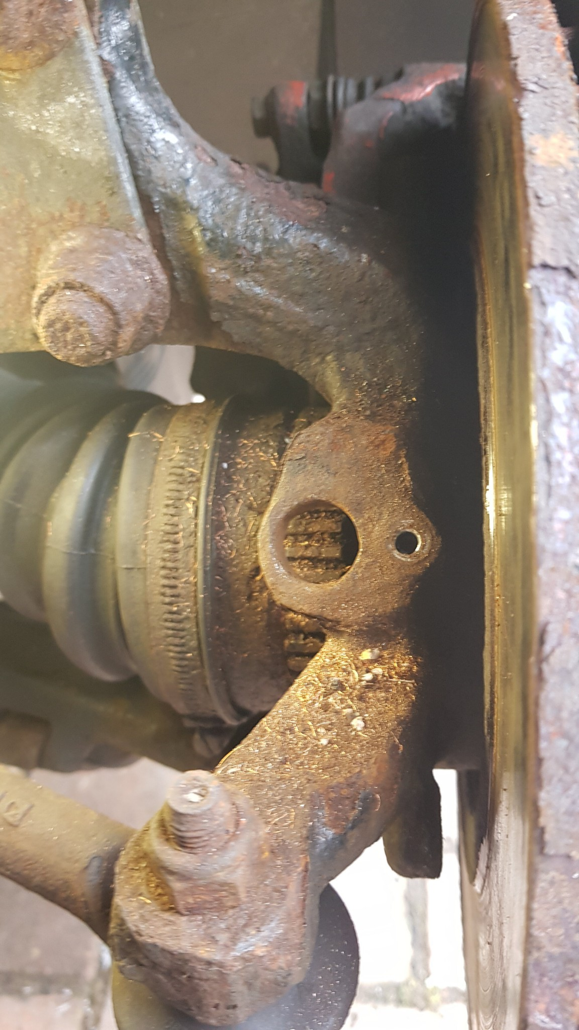

You say that but then...
I'm only trying to encourage you to sort it out. Pwease don't cwy 😢.
When you took a picture of that, did those nuts say cheese 😂
That's what they'll do when you come to remove them haha
You say this but those hubs were refreshed 2 years ago and they went like this about 3 months later 😂 TREs are about a year old too! This is what happens when you drive a car more than twice a year 🥵
Don't see the issue, his hubs have ant theft nuts and bolts - sensible stuff!
When are you going to fit your new calipers Louis? Or will the old ones not come off due to the ant theft bolts?

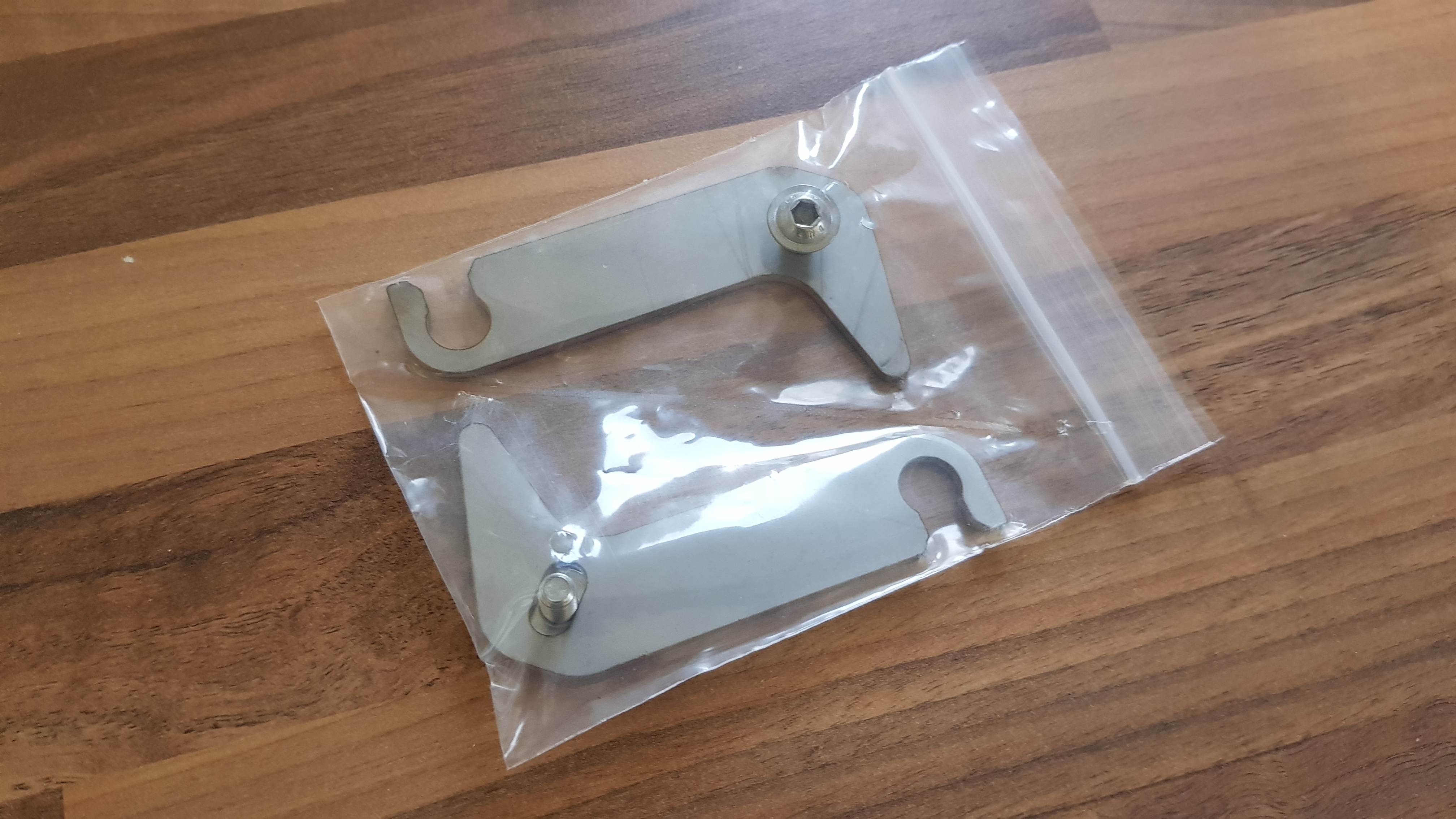

As a treat purchased some stainless abs brackets to try appease @Porl And @Touring_Rob.
Look decent quality for the price and in 2.5mm wont be bending anytime soon Might need to clean up the hubs a bit before fitting...

good man, make sure you put them on the right way round, I have no clue why but i managed to have mine on the wrong sides like an absolute moron.
MOT man deterrent them bad boys.

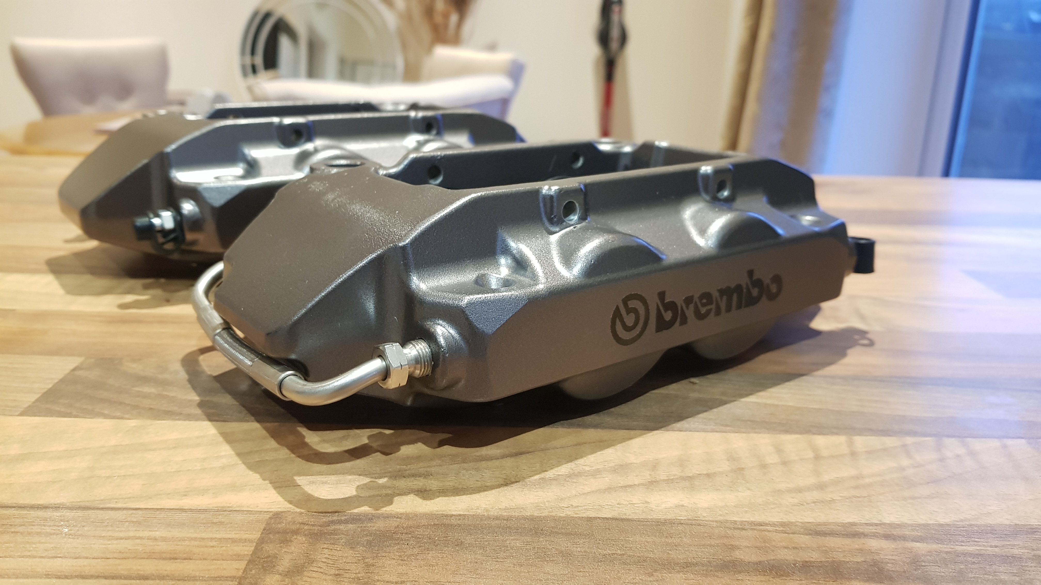

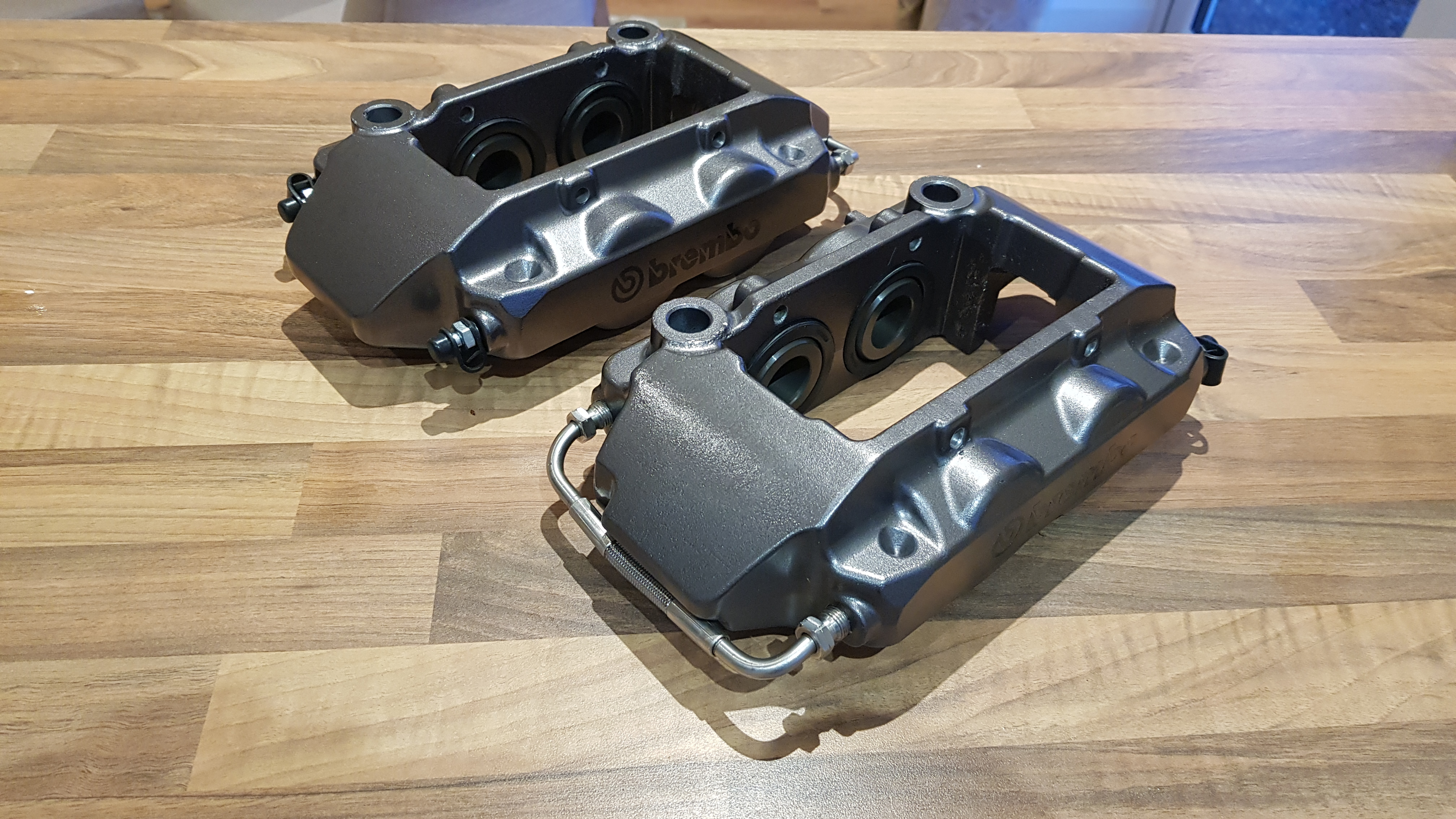

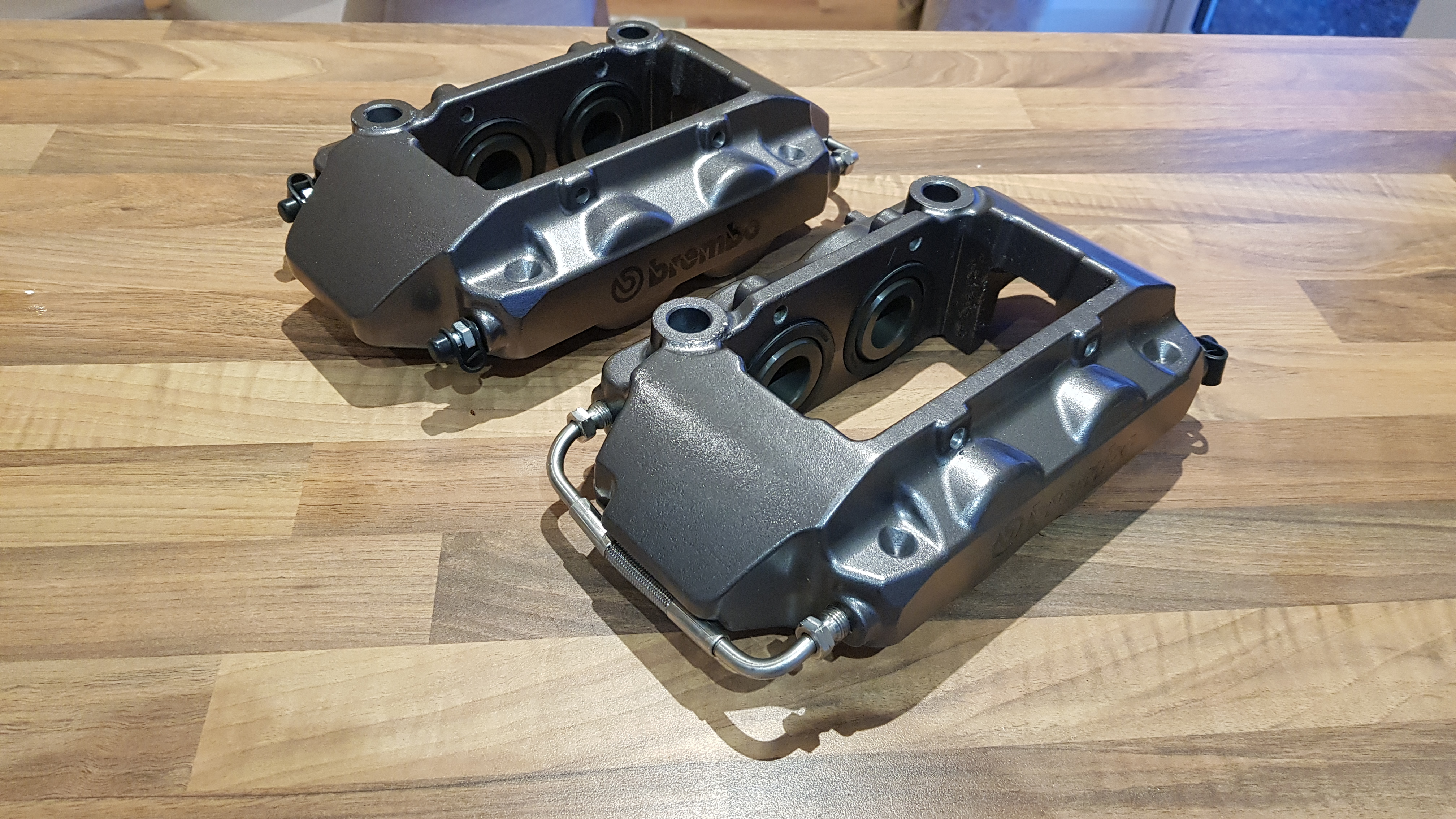

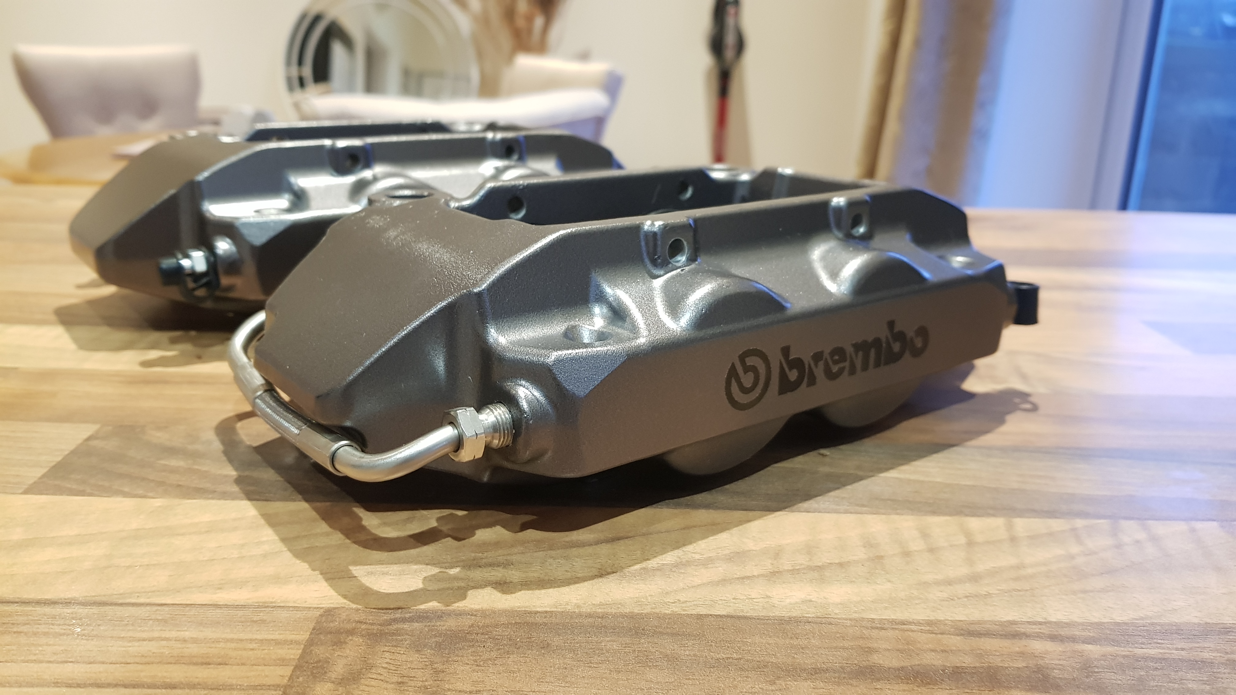

Also finished up my other brembo caliper. I'd only done one as I ran out of paint then other things got in the way. Seals still need pushing in properly yet...
Need to quartz coat them and they can be fitted. Plan is to have some new front lines made up in copper as they're corroded then bosh these on with their braided lines.
Really happy with how these turned out 👍
Look great them mate 👍.
Those abs brackets are a nice upgrade too, at 2.5mm they must be the thickest on the market!
Brembo look spot on @Louis 👌🏻

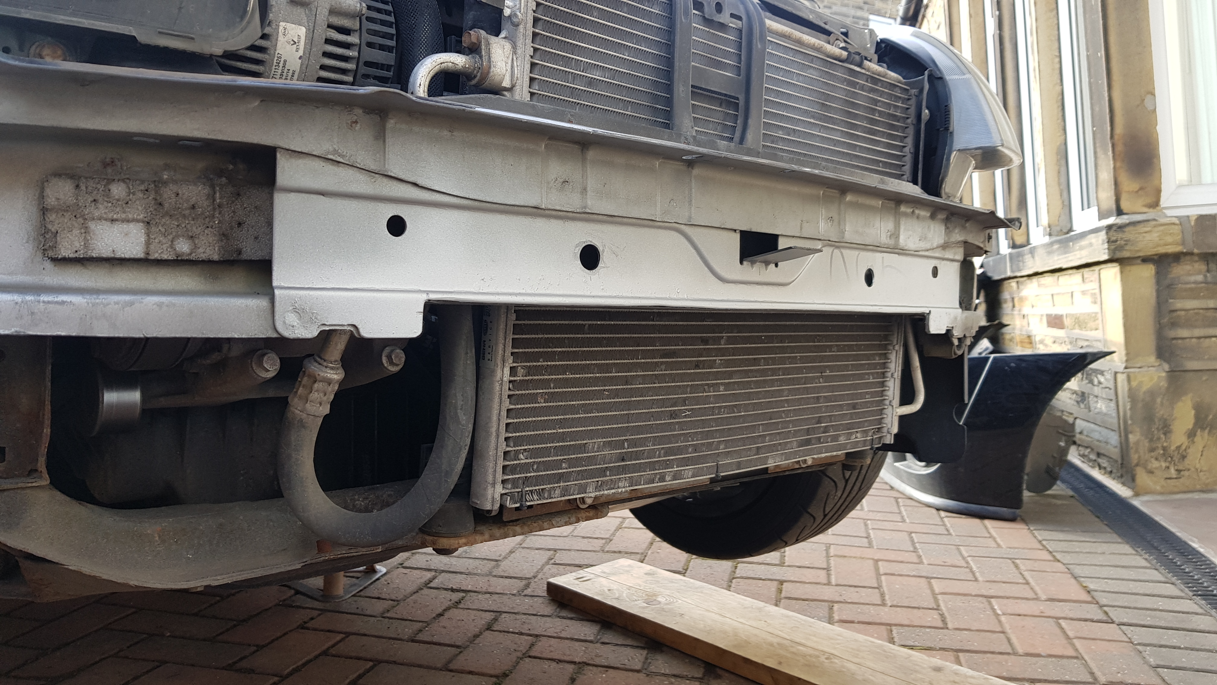

Nothing too exciting but refitted the decat today as driving onto wood everytime I want to get off the driveway isnt ideal. Got the exhaust tips lined up much better now too.
Whilst the car was jacked up I finished cutting out the crashbar for the intercooler. Gave it a quick lick of paint to keep it from rusting after. Might add a couple of welds along the bottom to keep the steel together but integrity is still good.
Plan is to get the IC in place, route the pipes then see where to move the horns.
Louis
I Love Ed Sheeran
Is your plan to run with an exhaust leak and visible intercooler for a while so everyone thinks your turbo, without you going to the effort of actually installing a turbo? In which case I approve.

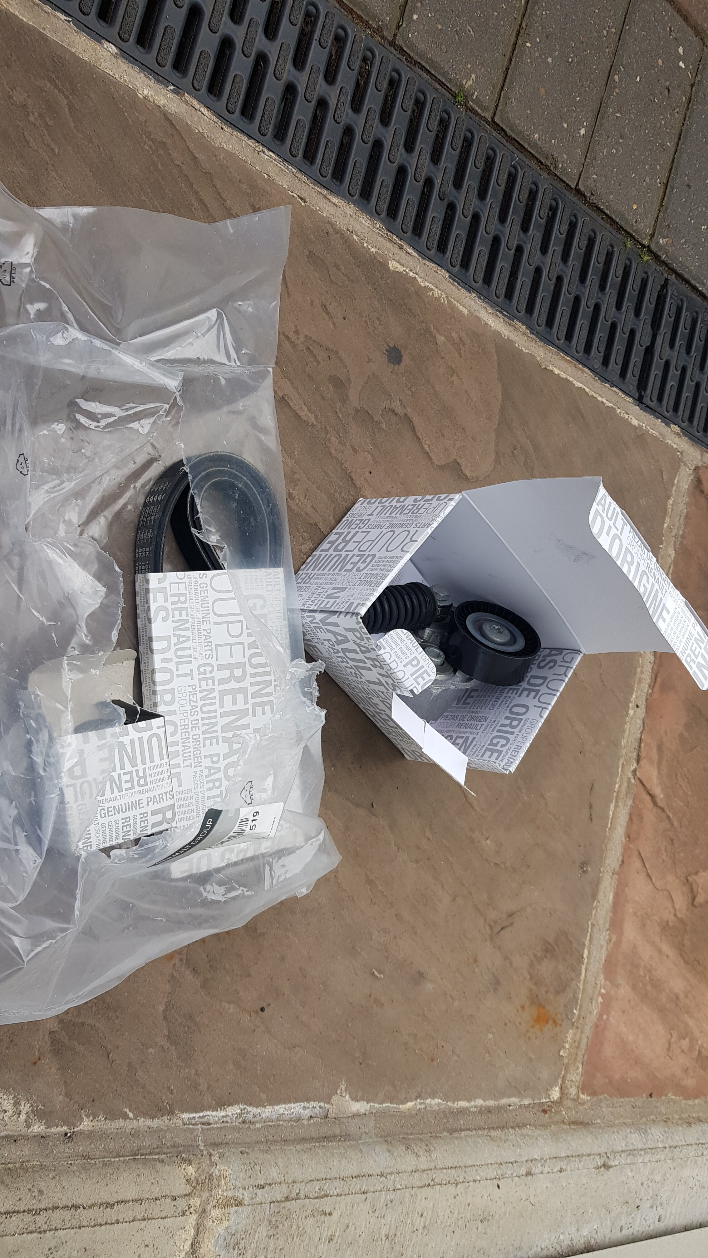

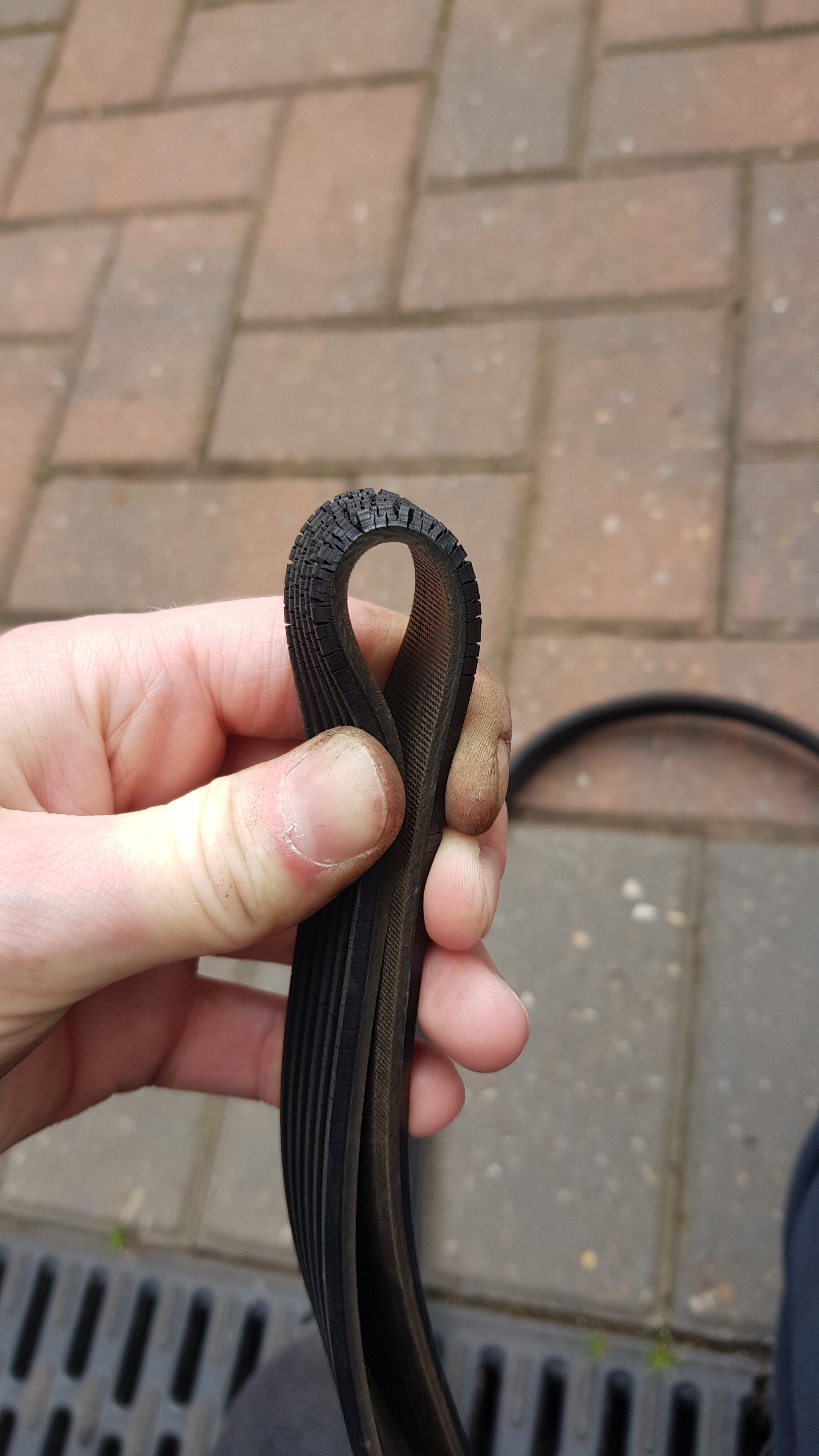

Today's job was finally changing the aux belt and tensioner. It's been whining for about 2 months now, and being 5 years since it was last changed I was pushing my luck.
Bought genuine parts from RPD. Suprised the tensioner didnt come with a new top bolt but there we go.
Disassembly is relatively easy. Frustratingly the 120-100mm jubilee i bought didnt have a worm drive that went all the way around so these were too small. Luckily I had 2 spares in another box of parts otherwise it was a wasted strip down!
All came apart easily, I'd say the belt was probably overdue...
Tensioner was free and unseized but obviously swapped it for new. What a c**t to remove. Had to remove the ac lines and pull the alternator forward to get it out! Be easier on a stand for sure.
Idler pulley was also replaced. It's so tight in there that I had to rig my tools just to get bolts undone. Utter pain! Refit was reverse of removal, just remember to leave the alternator loose as this makes getting the belt on so much easier.

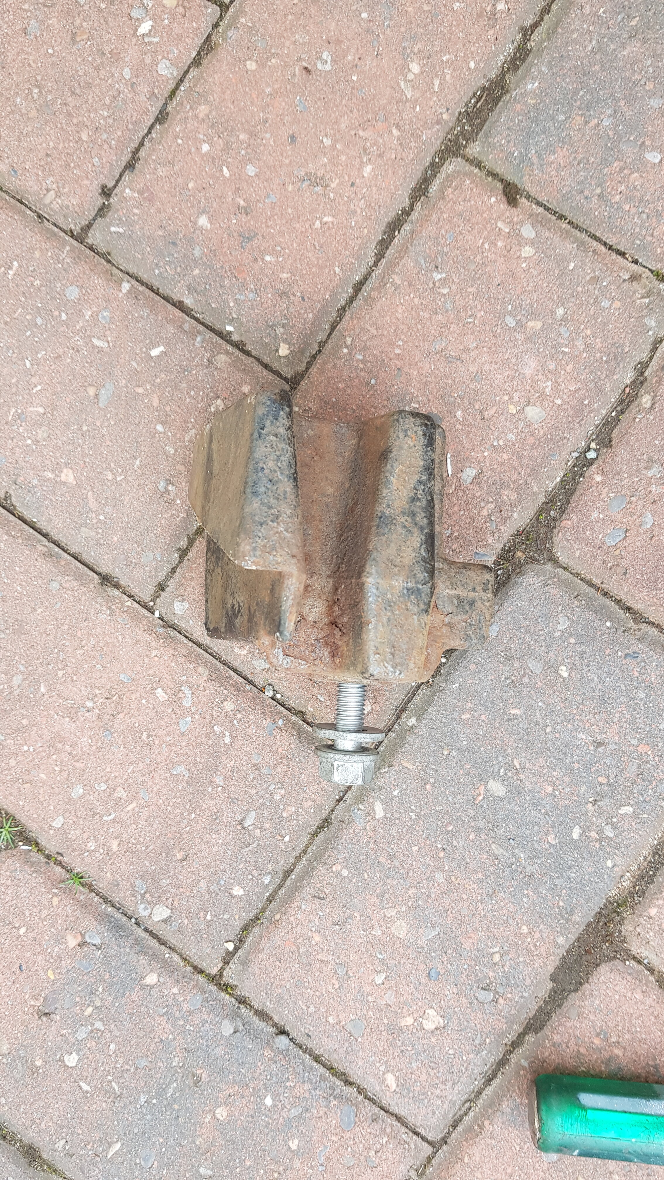

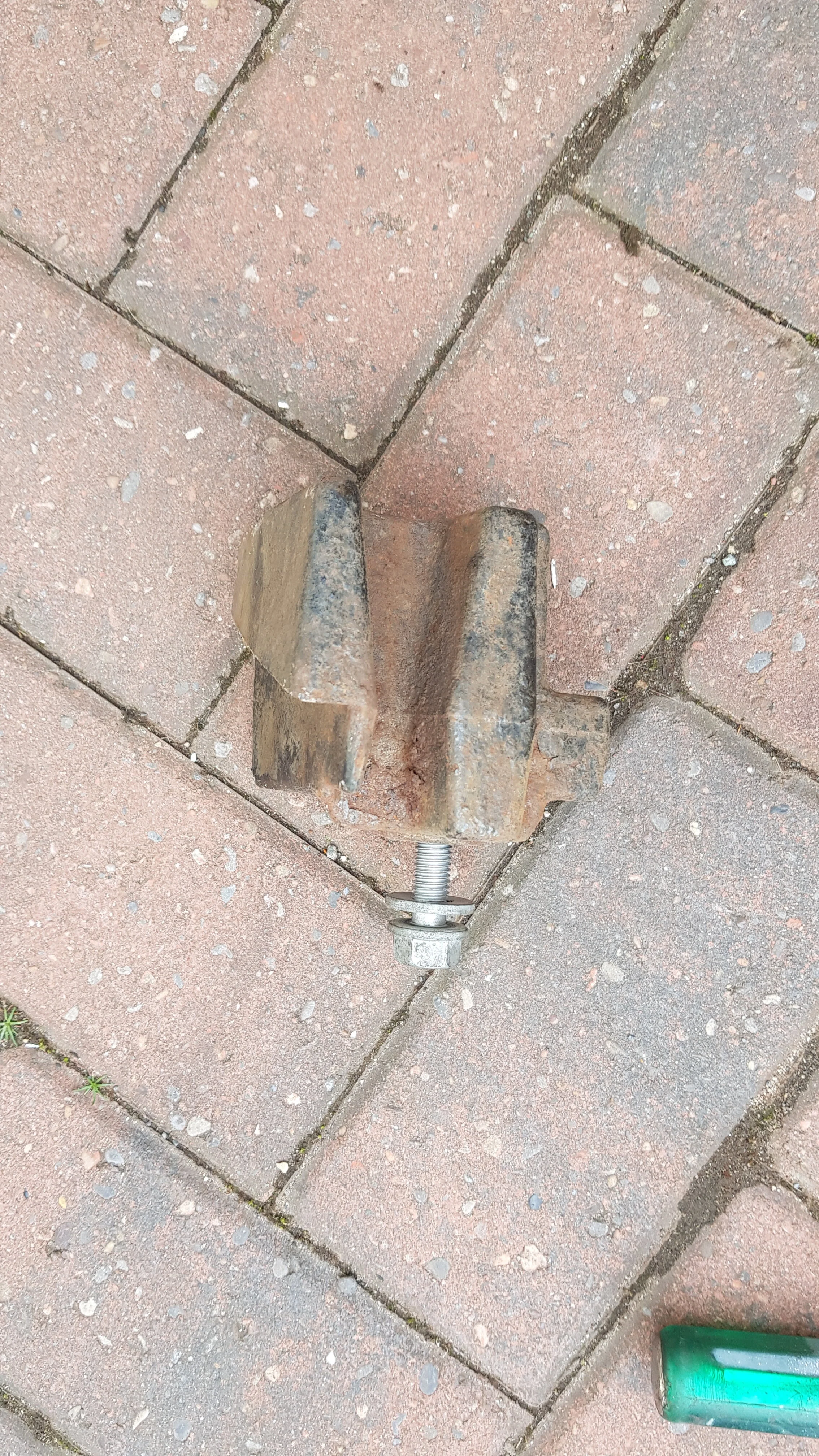

Whilst I had the engine mount off decided to remove the ridiculous block of metal that is sat in the bay.
Overall a b*****d of a job purely because of space.

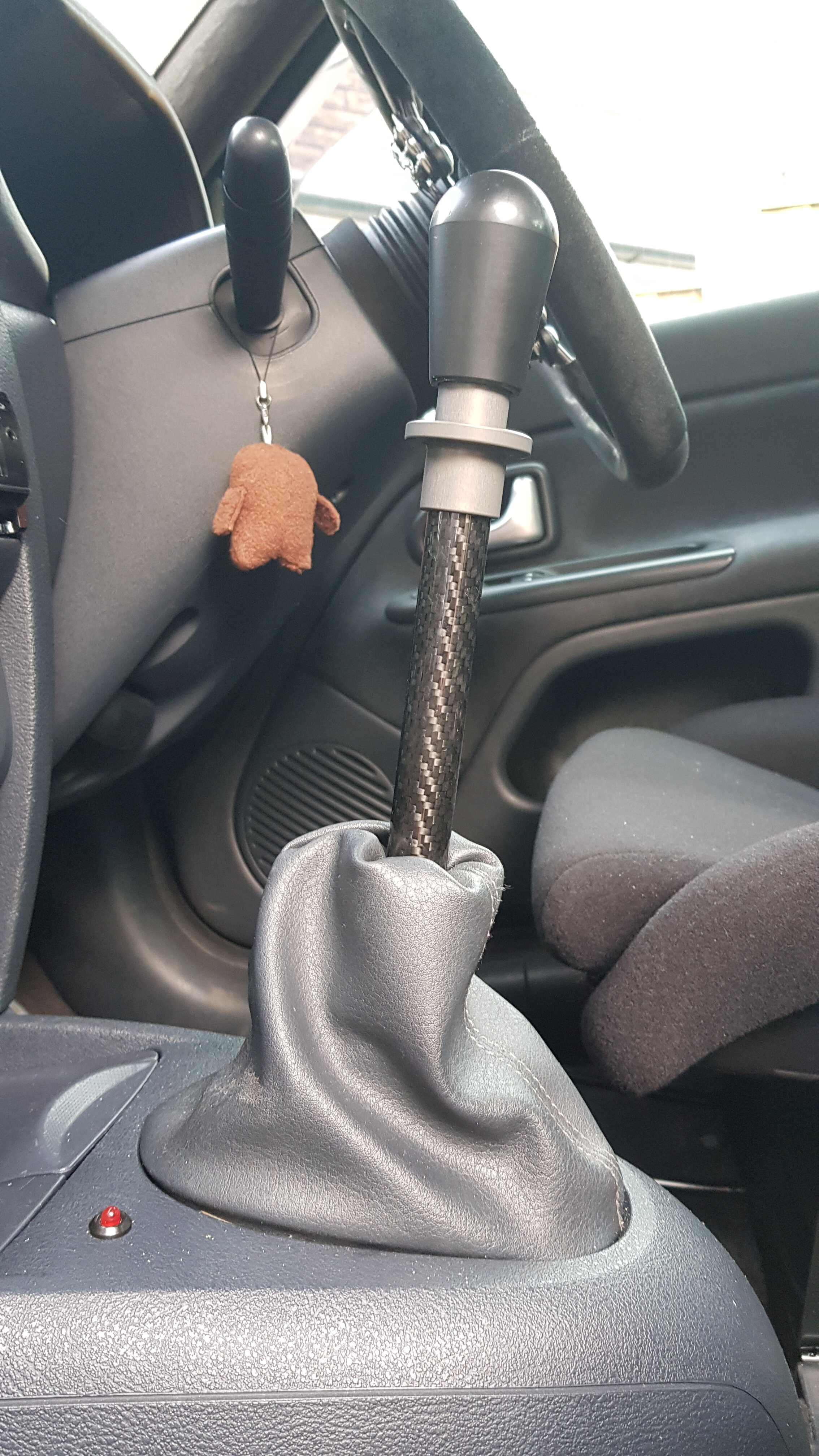

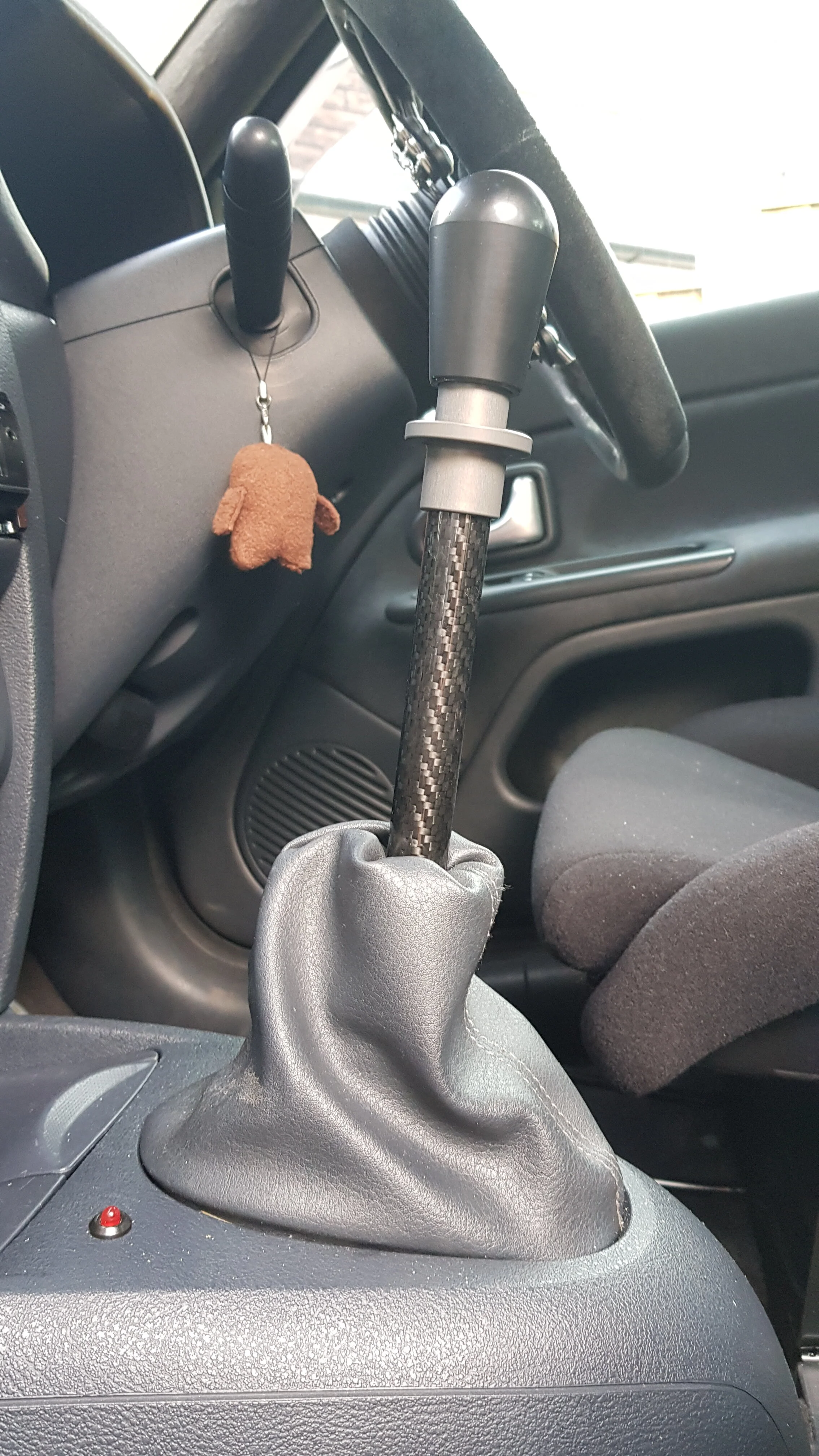

A more fun job was fitting my carbon shaft that has been sat in the garage for months. I have noticed that this version the bottom nut seems to hit the turret when going into reverse? The bottom spacer is dimensioned differently to the previous one that came off? Looks fantastic though and matches the interior trim.
