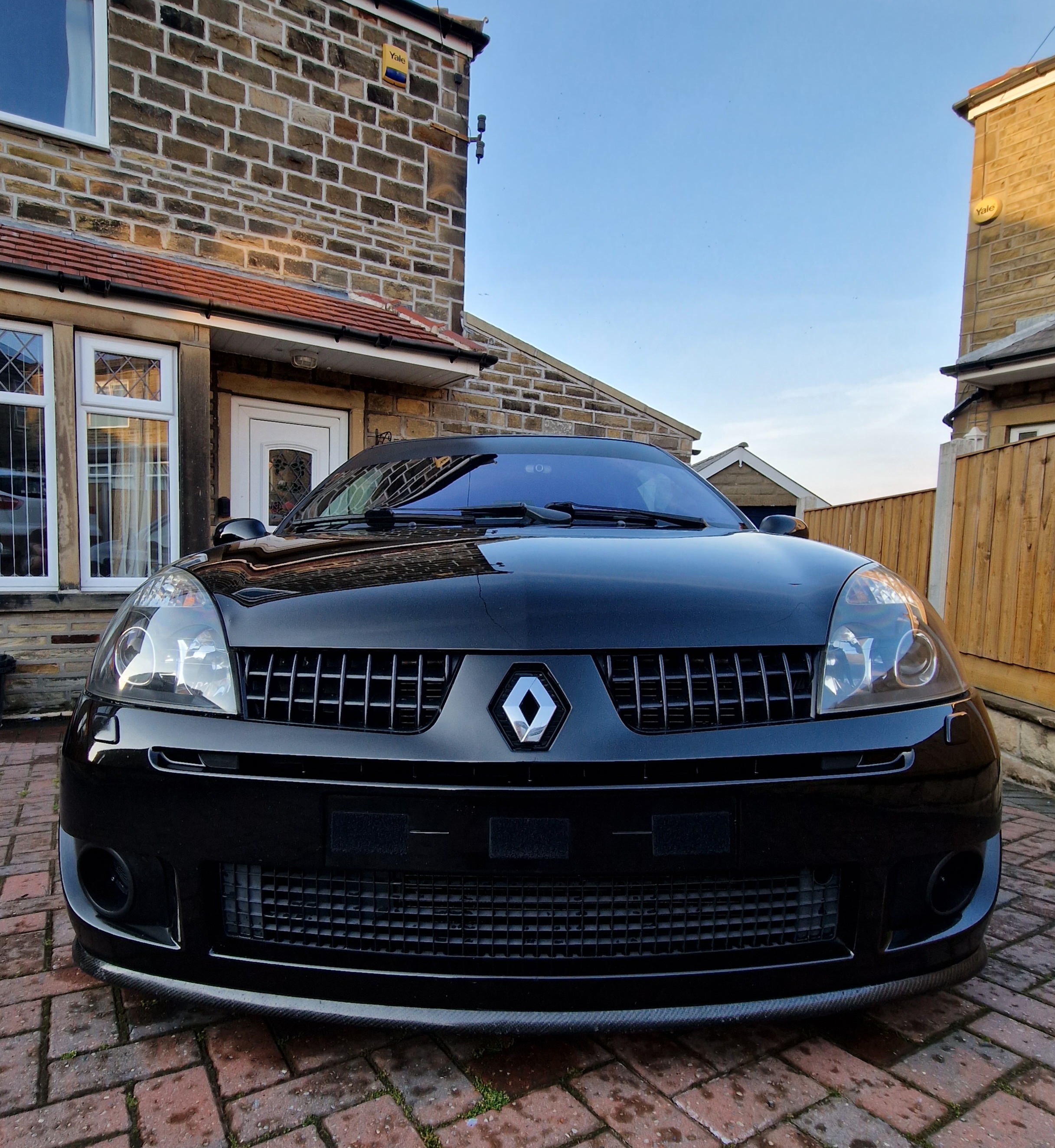

Looks great this Louis. That carbon shaft (ooo err) is mega nice (y)
Cheers mate. I always think they photograph worse than they look in person, especially the anodised collars.

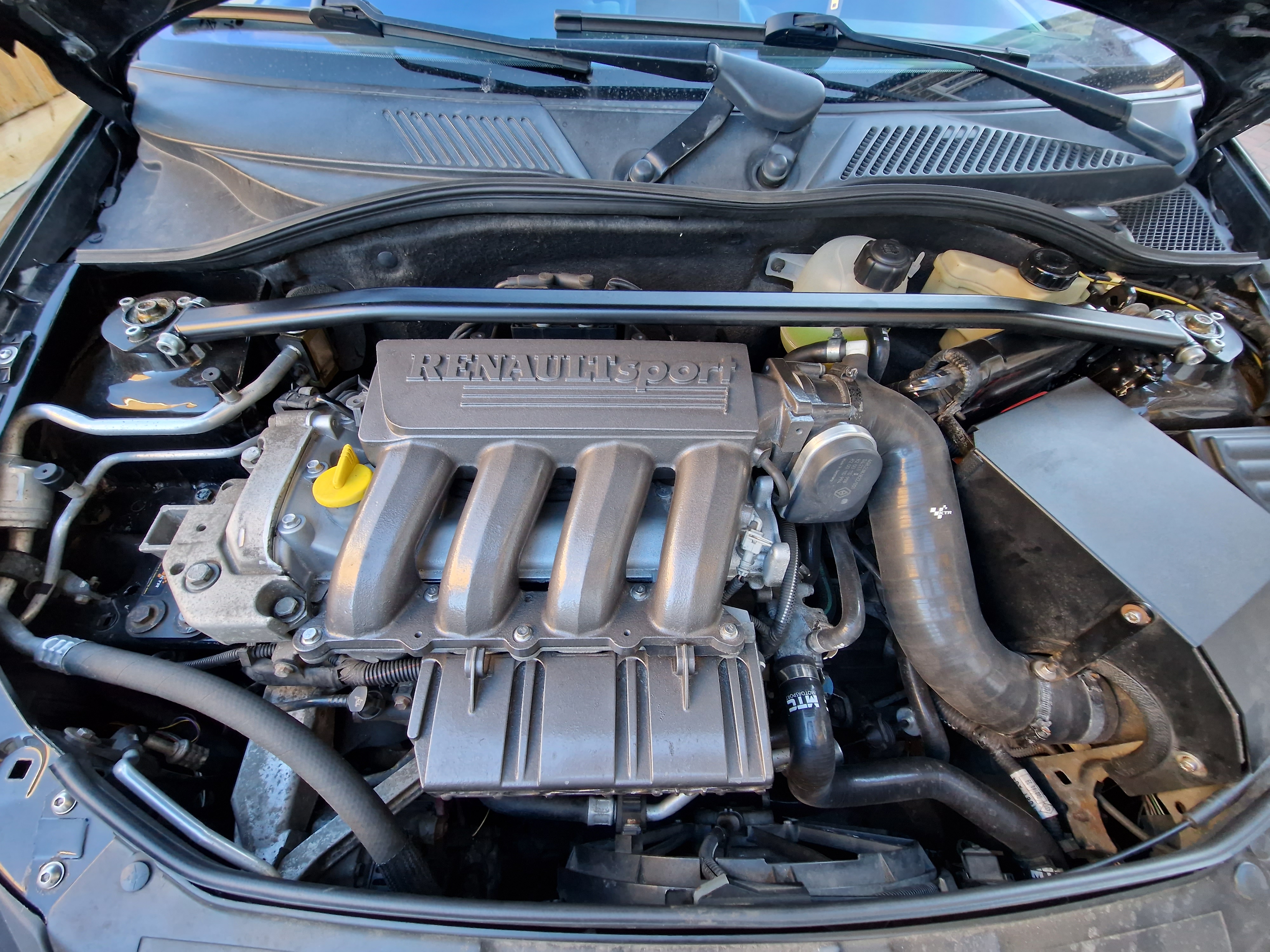

Tomorrow I'll be taking the seats out and shoving another subwoofer in. Might look at moving the horns too as the intercooler pipework will be there.

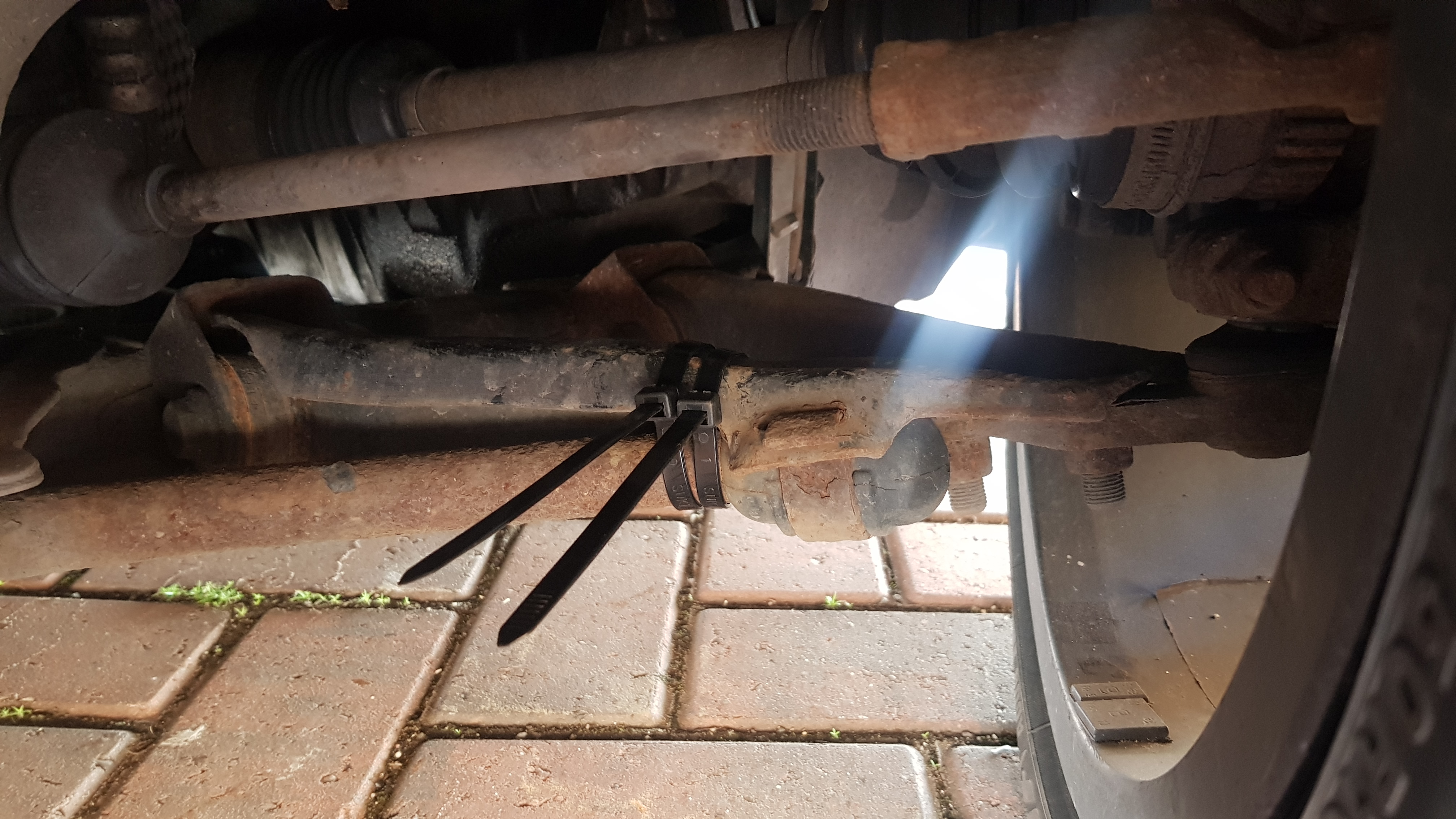

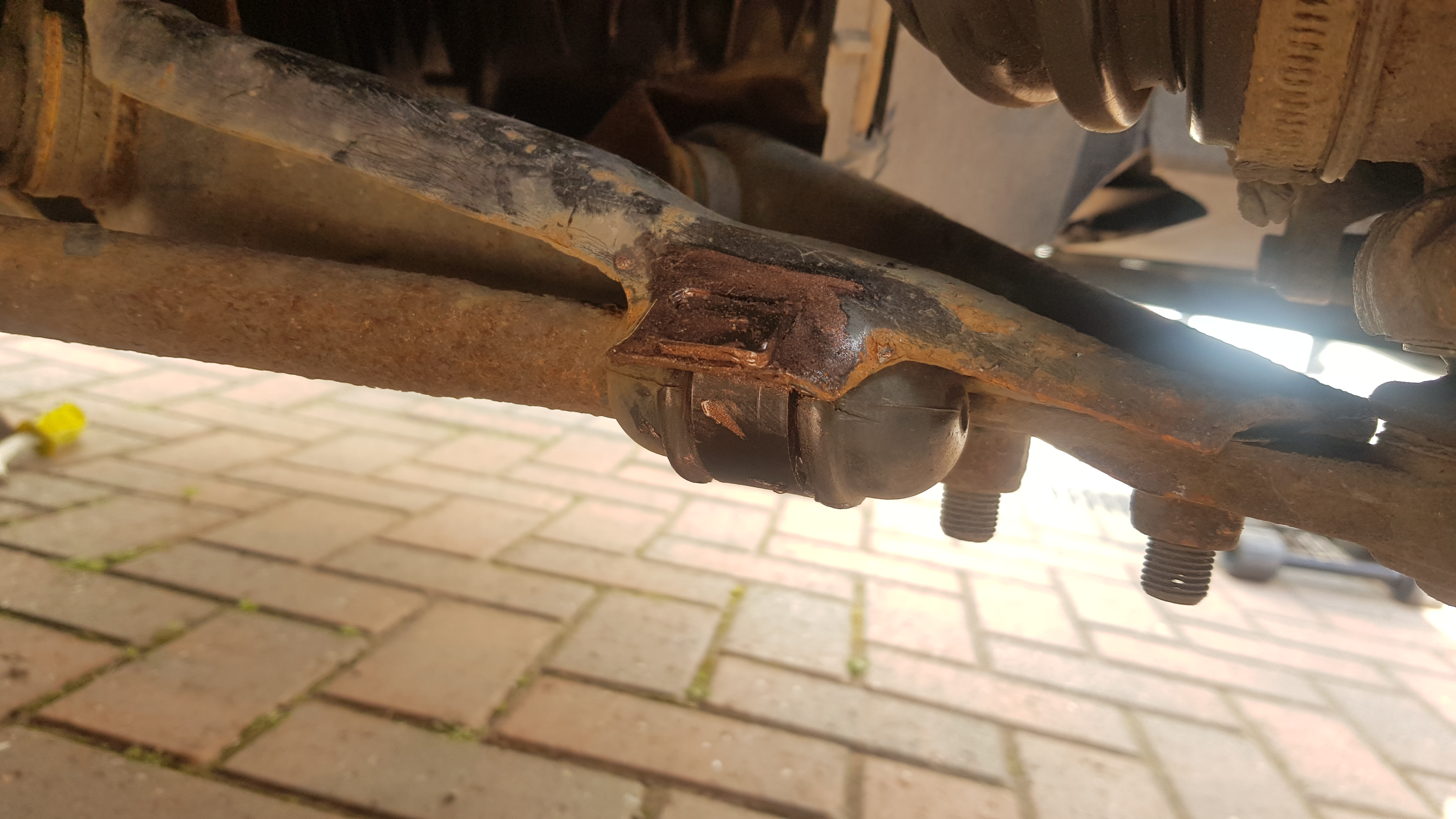

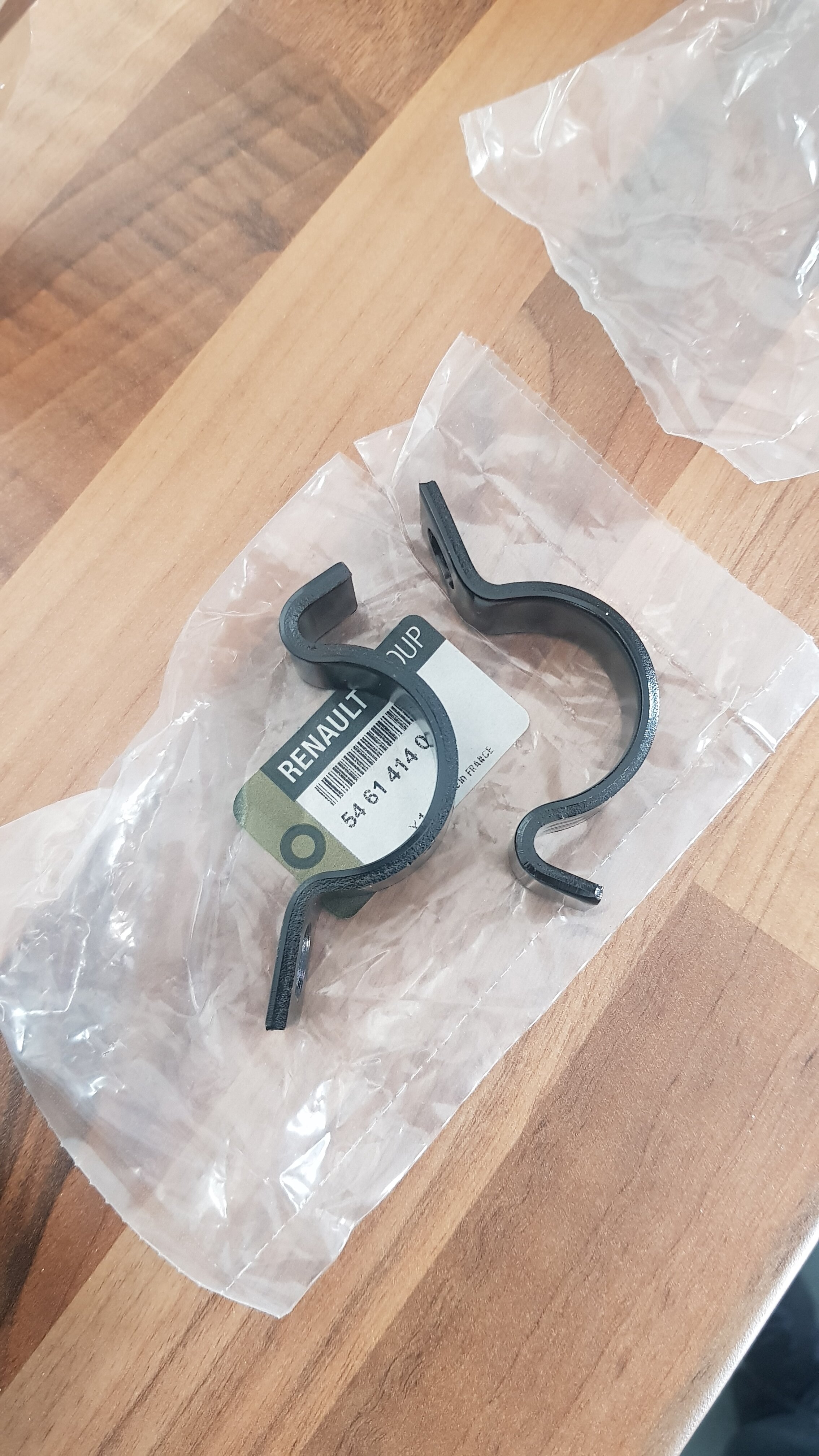

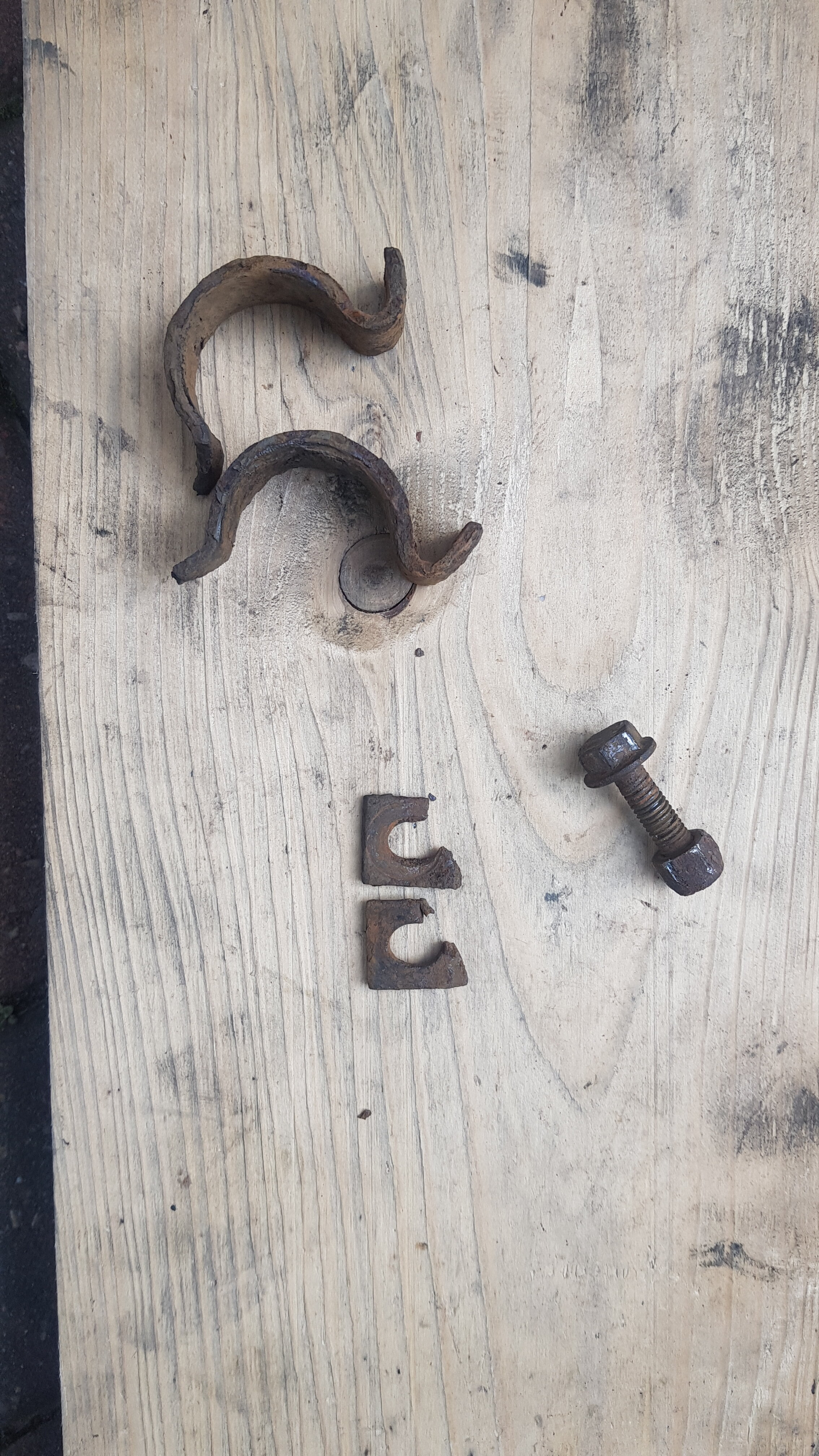

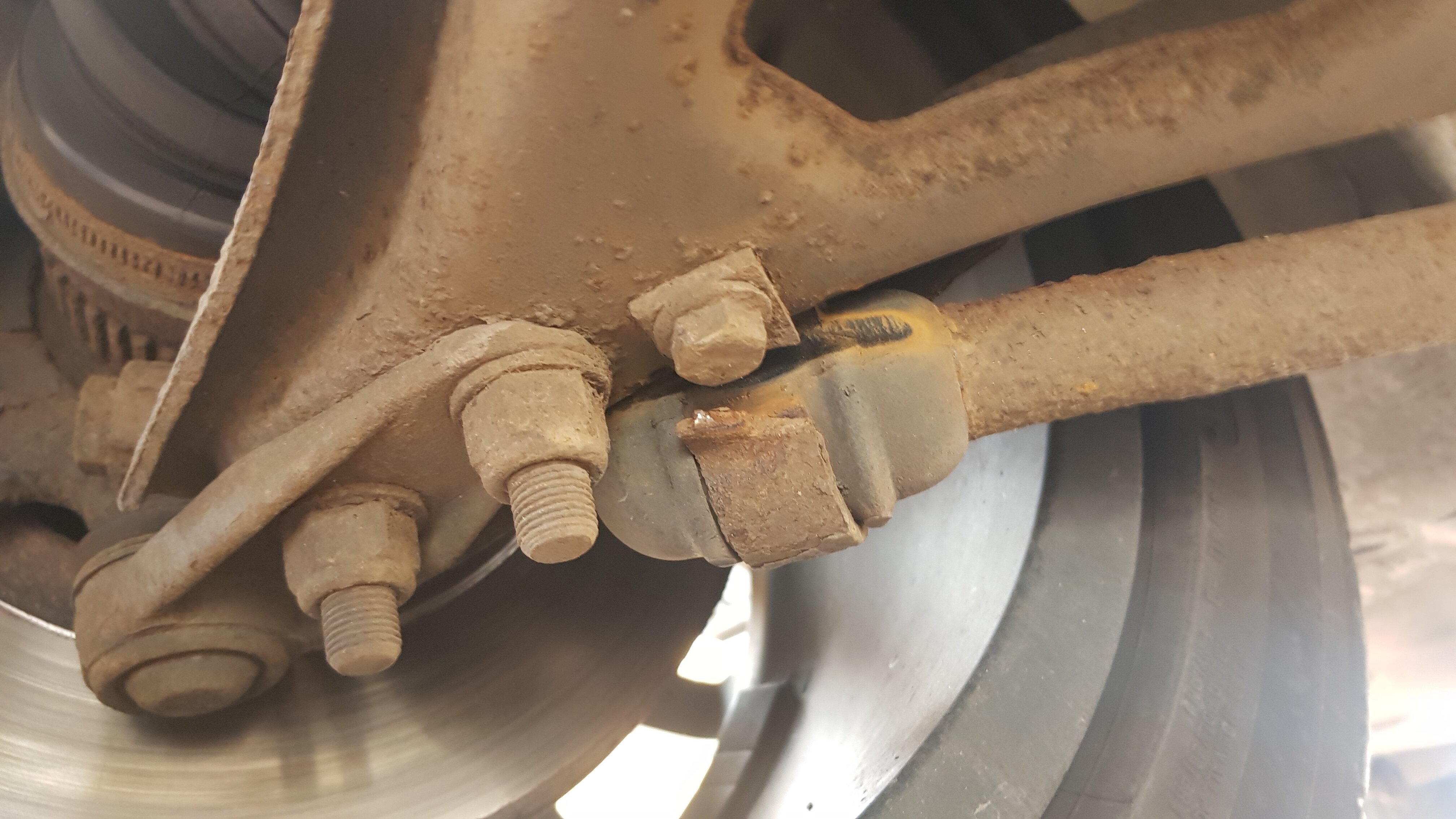

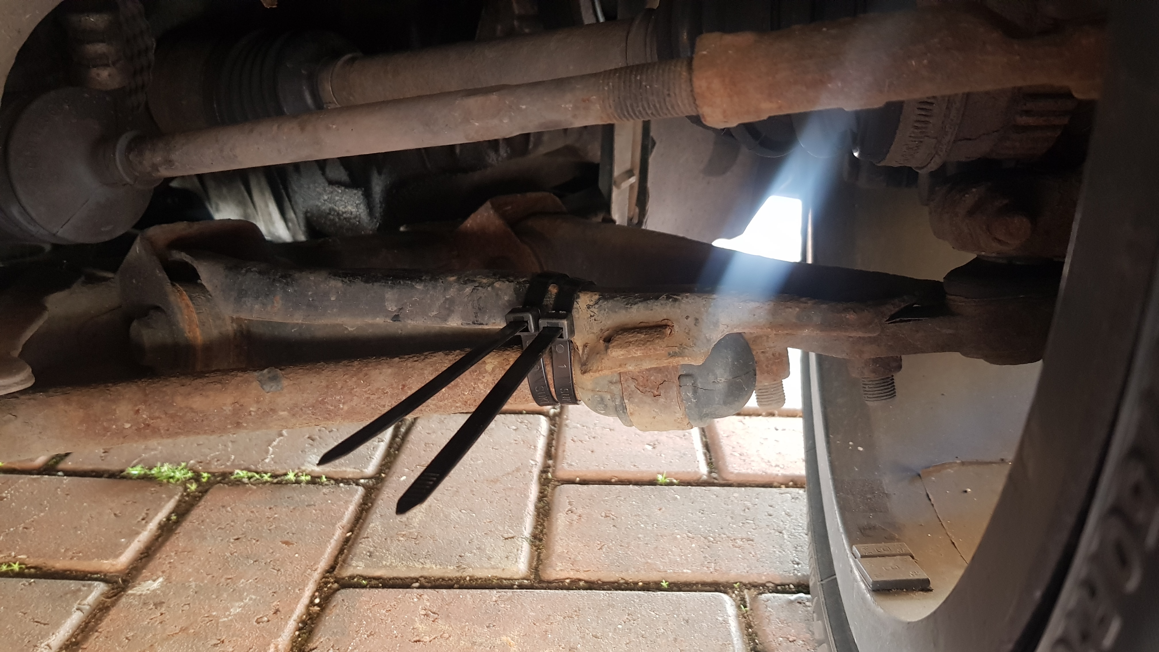

Decided my cable ties maybe werent a permanent fix so bought some new arb brackets. These were the last ones kam had in stock and they're now discontinued by renault...
Strange how both old ones snapped in the exact same place. It's clearly the stiffness of the arb combined with the black series polybushes which causes this issue.

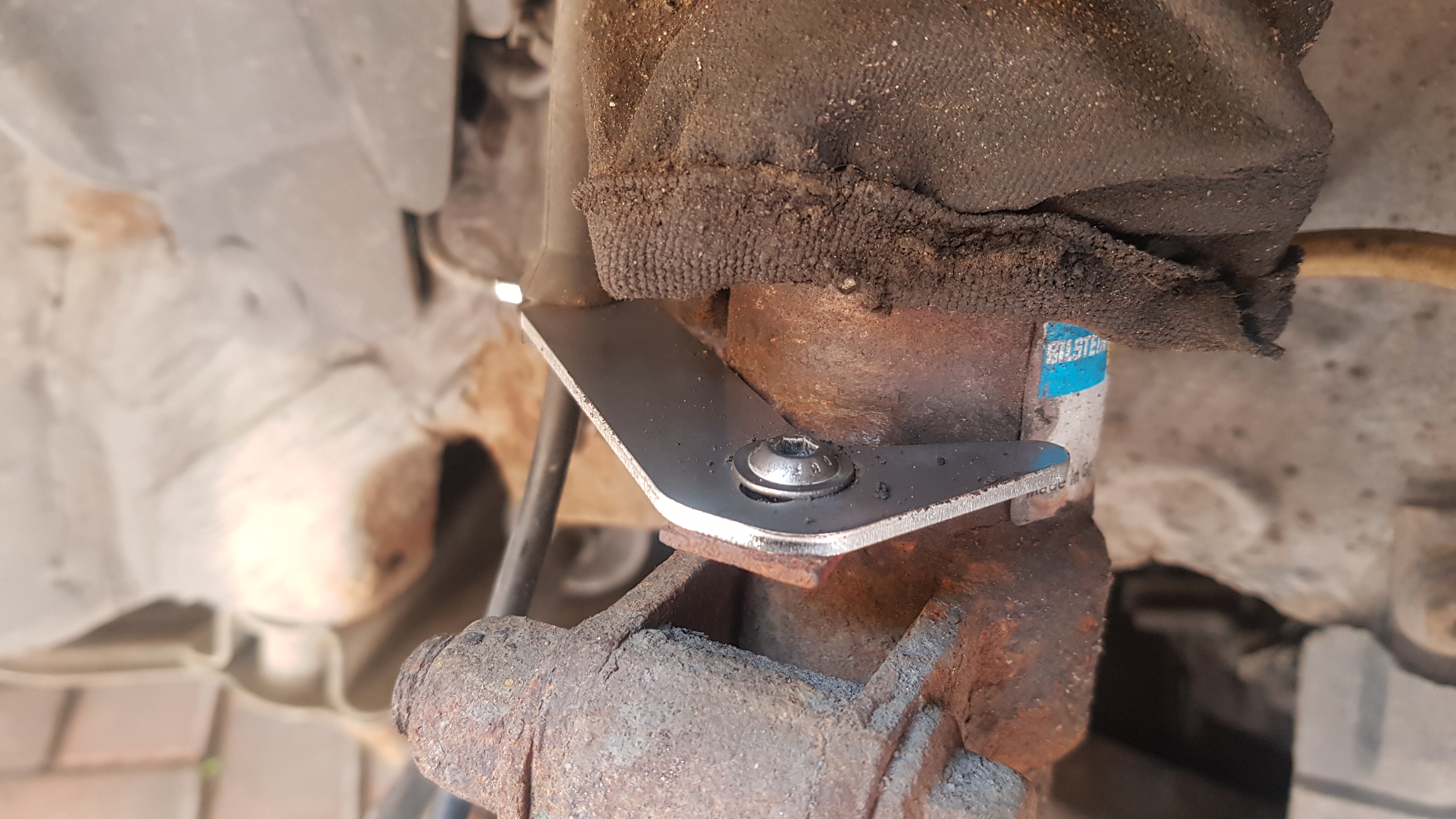

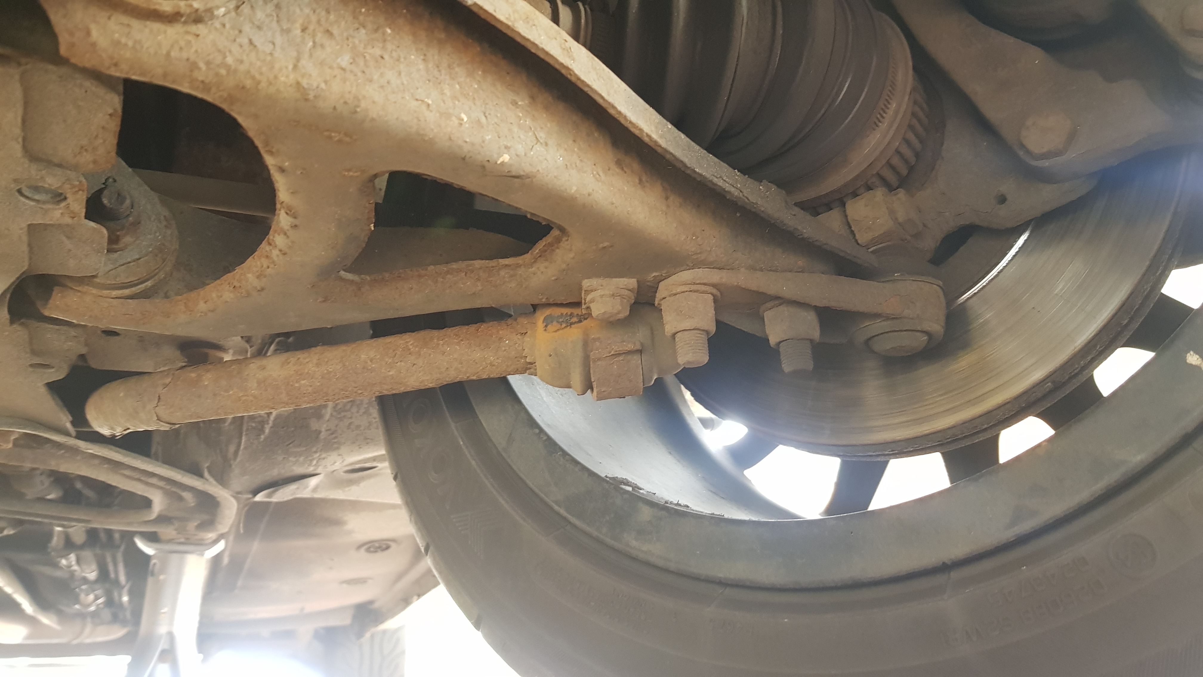

Slathered in some copper slips to ease with fitment.
Whilst I was there I fitted my stainless abs brackets. I didn't clean anything else, obviously.
Job jobbed.

I tend to limit the amount of copper slip where I can because there’s lots of evidence that copper based anti-seize compounds can cause galvanic (bimetallic) corrosion, particularly involving stainless steel or galvanised fasteners. Basically it dries out exposing it to water, which in turn aids corrosion.
More likely yours have gone through old age and stress on the component. I tend to use a silicone based lube (oh er 😂) like that used on rubber bushes.
Be grand! The wash i gave it yesterday probably cleared up most of it anyway.
By the time those brackets snap again I'll have bigger rust problems 😭😂

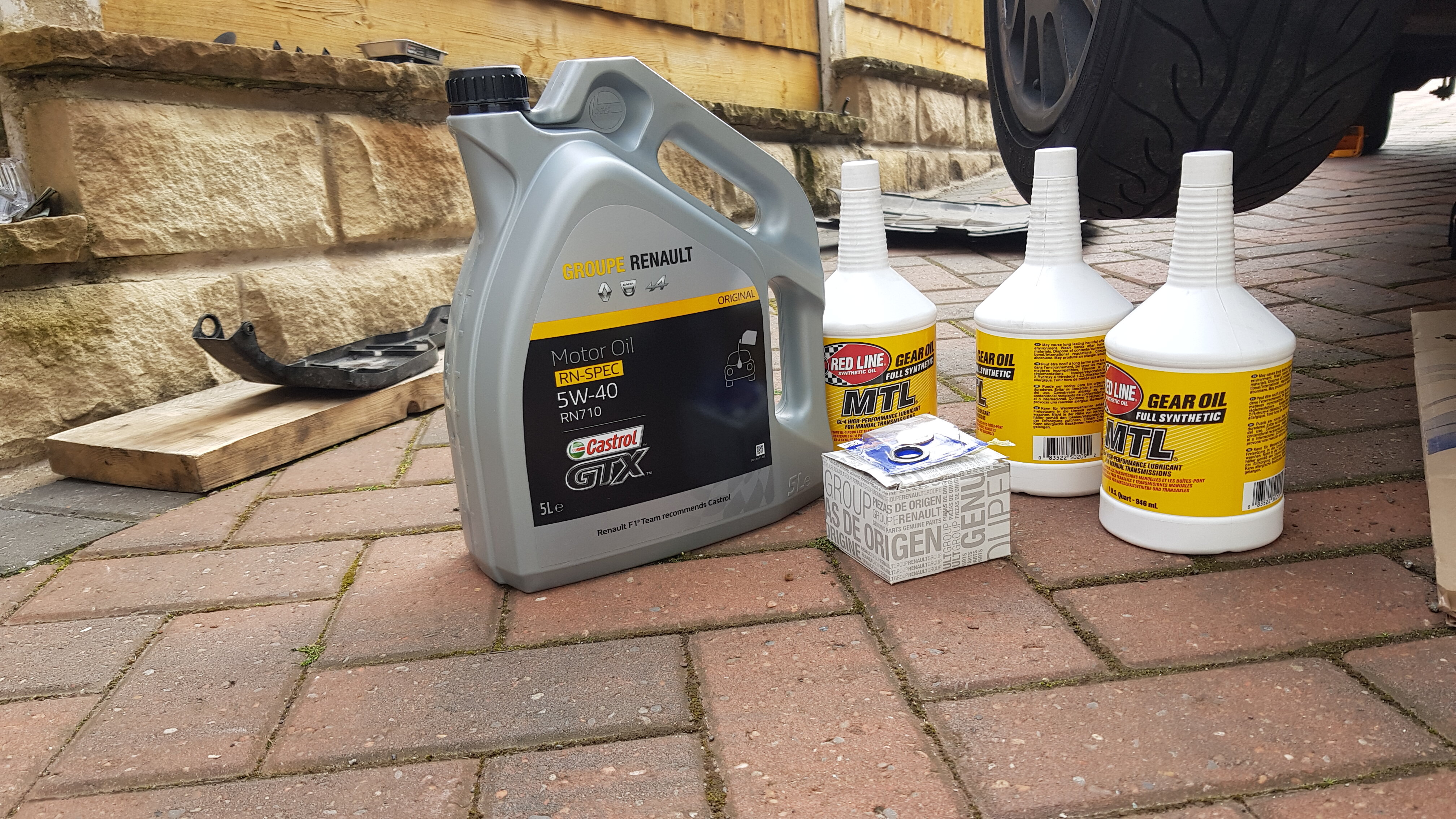

That time of year again when its due a service. Struggled to find any MTL in stock at a reasonable price before finding it at classic-oils.net. Website was a little dodgy but as it is apparently owned by fuzz Townsend off car sos I was more confident i wasnt going to get scammed. Ordered and it turned up next day 👍

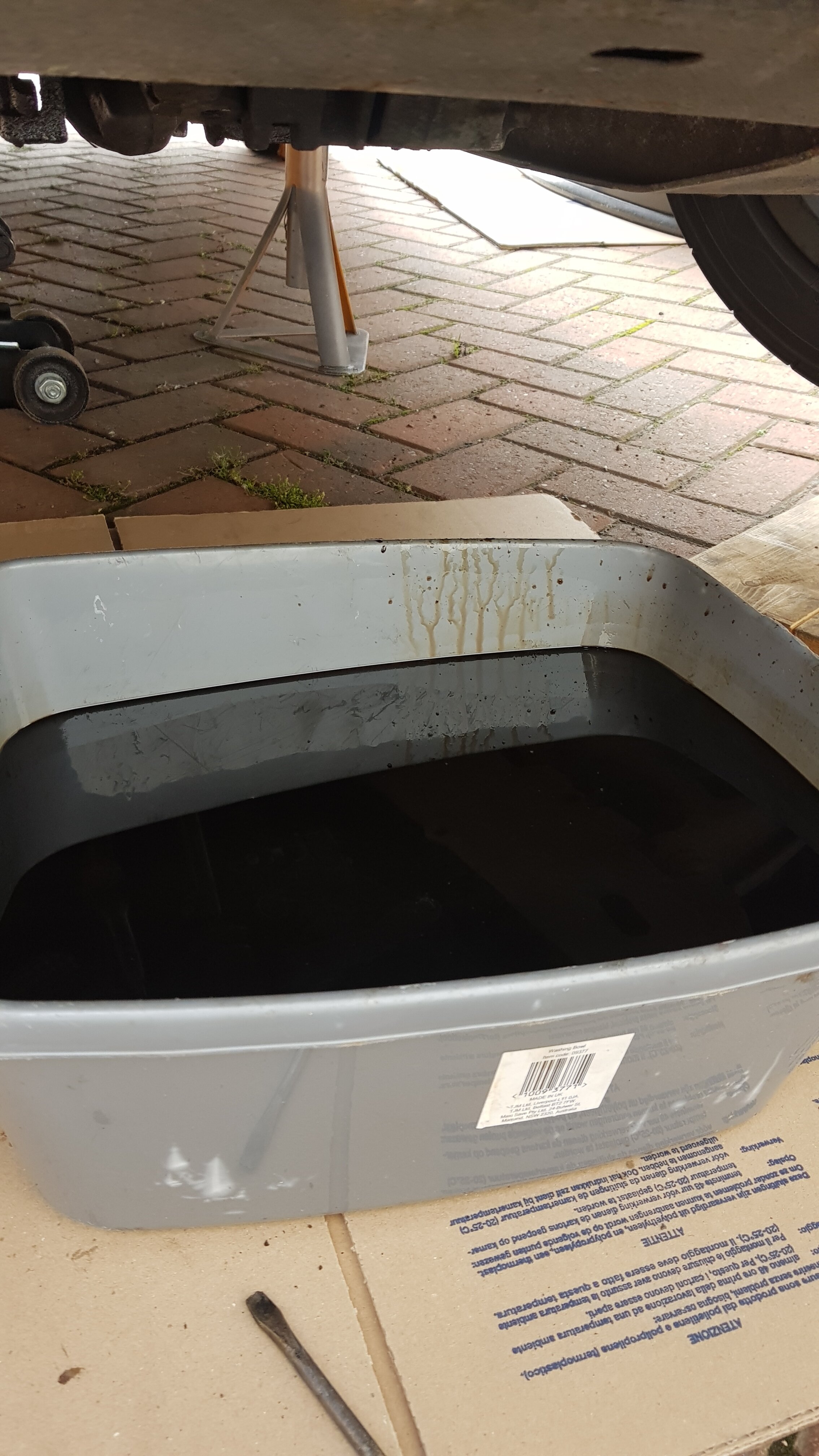

Engine oil was again of the Castrol variety and the oil that came out was black. Crazy to think its only been a year and it's so bad! Gearbox oil was now golden but as it's red when it goes in was obviously due a change.
Went easy enough, oil filter wasnt as tight as last year thankfully.

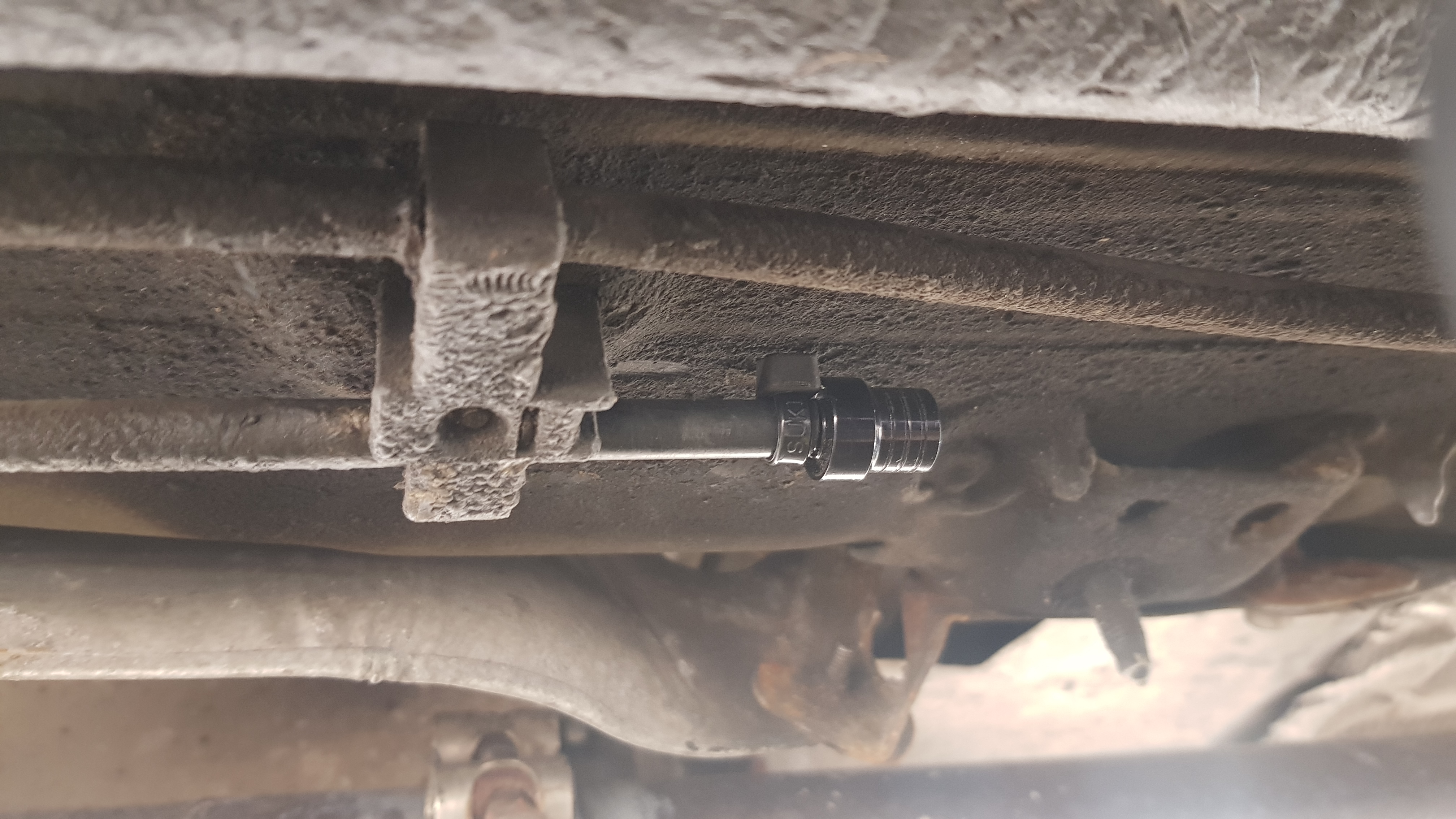

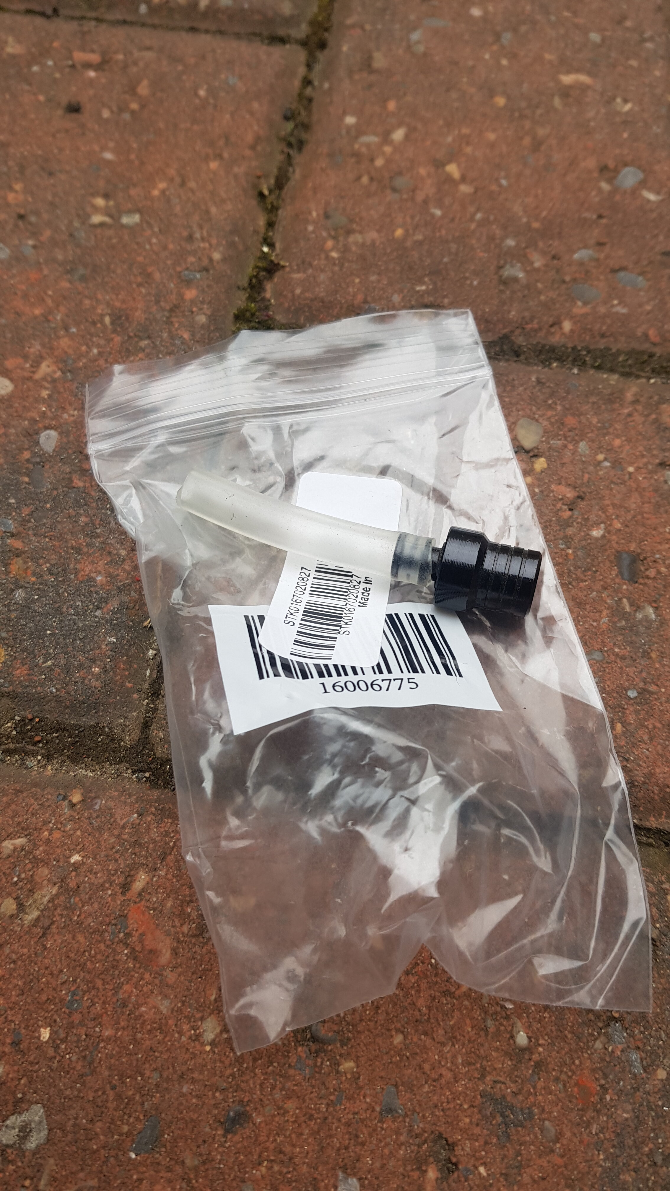

Managed to find some 2 way valves from China which didnt cost the earth, so cut the petrol vent line right back from where it was previously cable tied up and fitted the valve. Simple job 👍

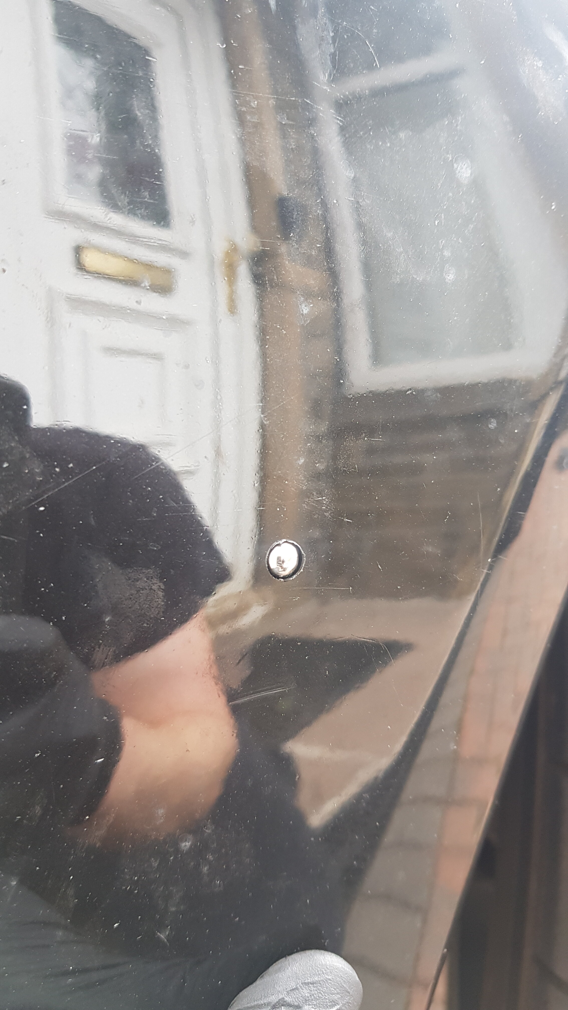

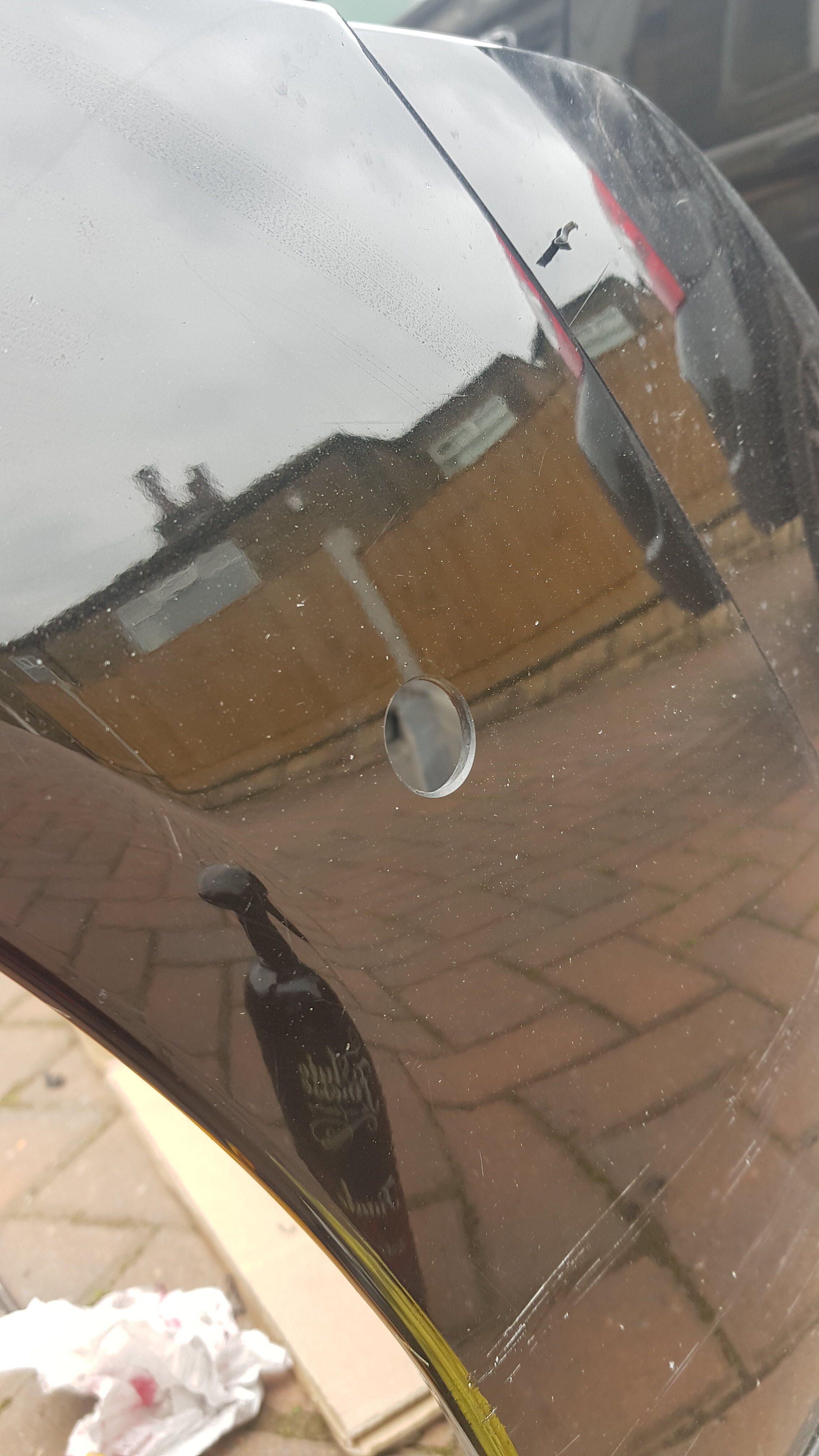

Next up was fitting the quick release bumper catches. These I ordered from exoracing and seemed to be identical to a group buys that was on here a year or so ago. Measured up multiple times to save drilling multiple times and got them spot on first time. Obviously a job you dont want to mess up when drilling into the bumper!
Plan is to buy some more and remove the reinforcement up the front of the bumper fitting the quick catches instead.

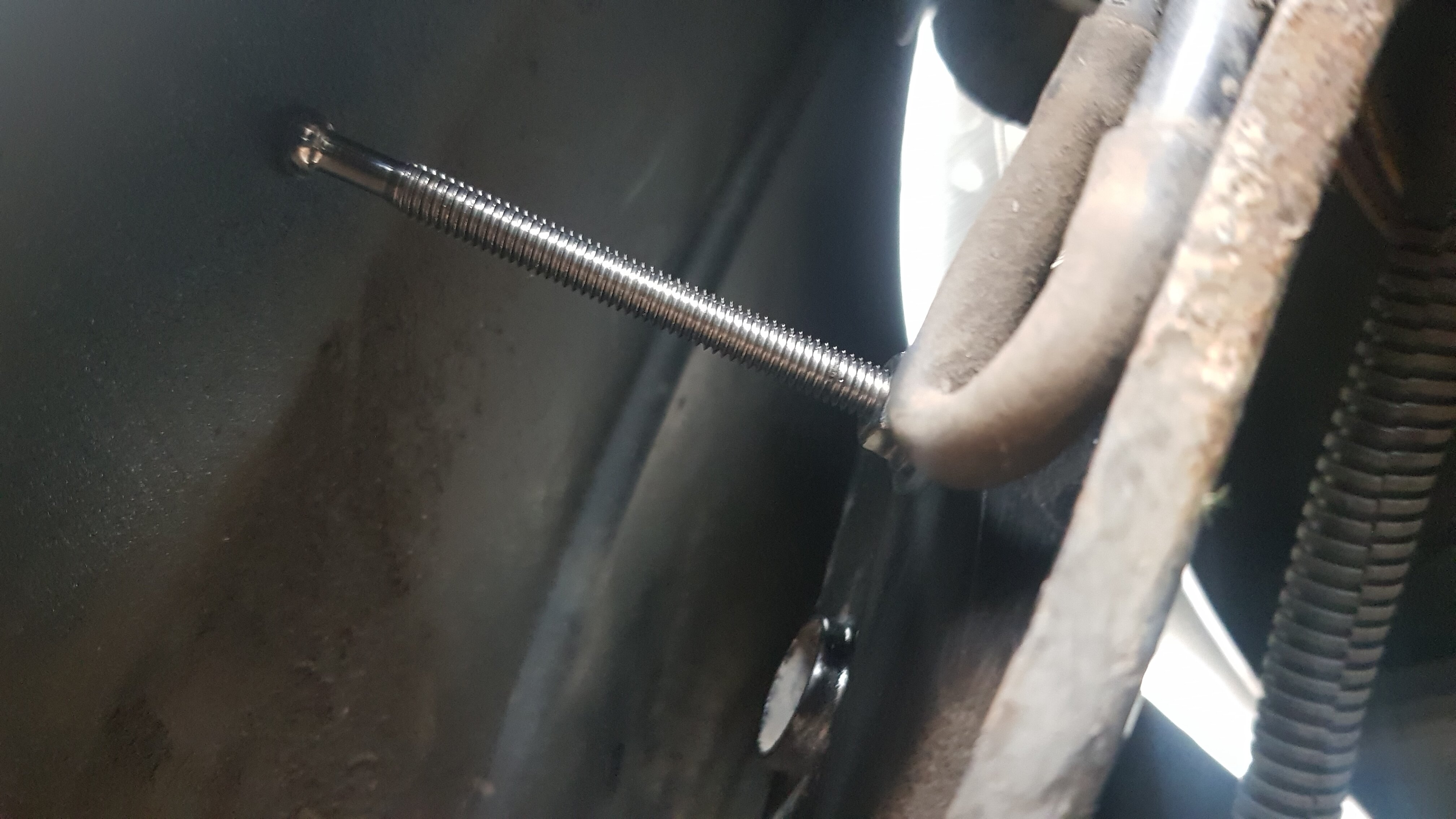

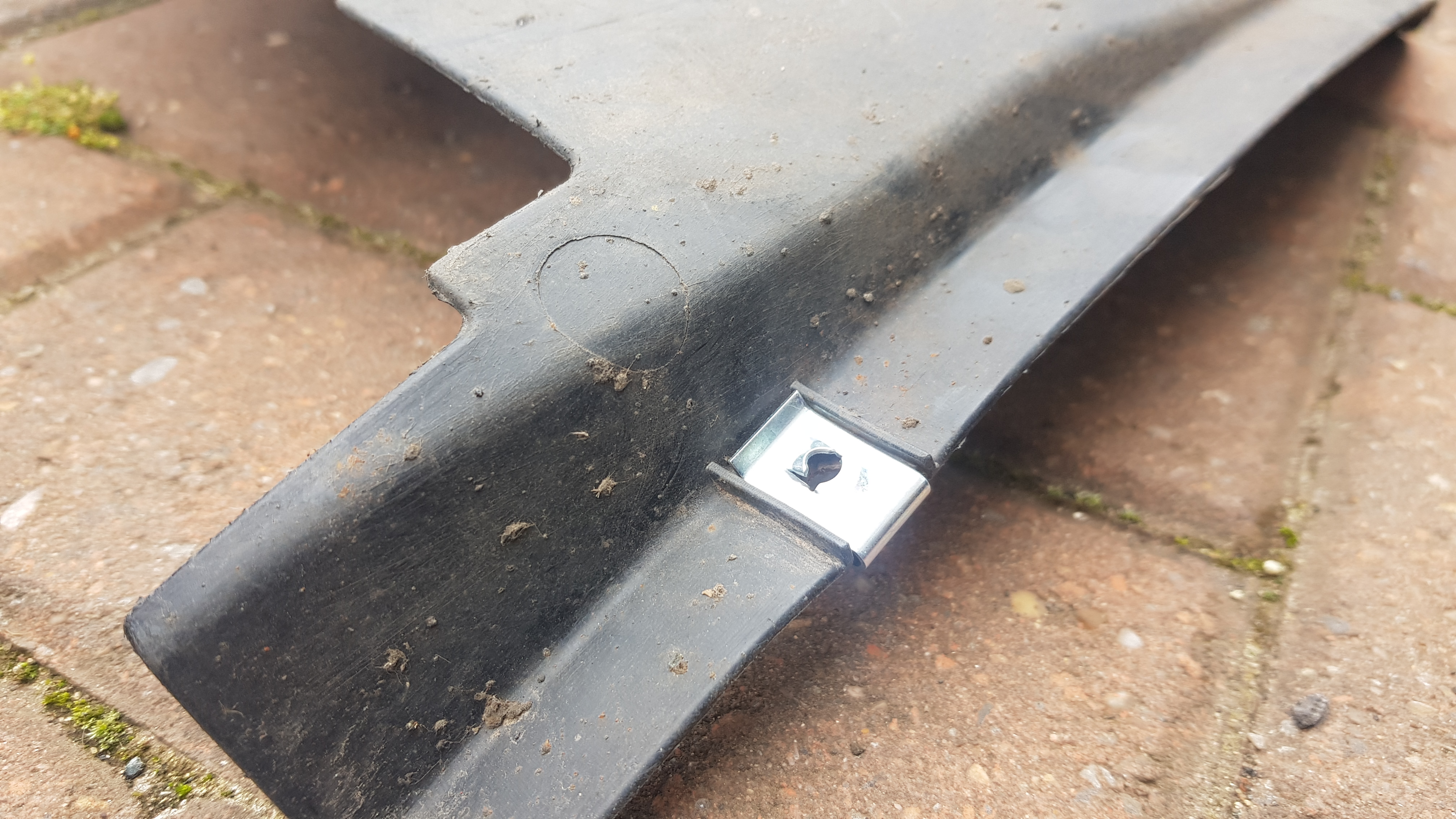

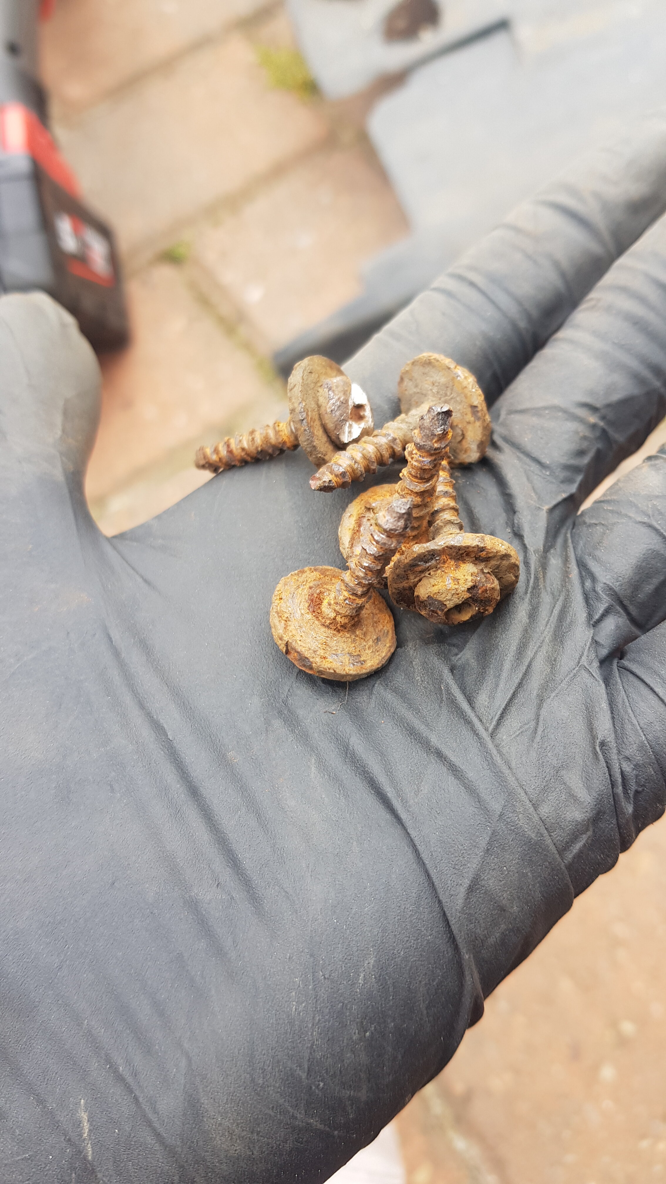

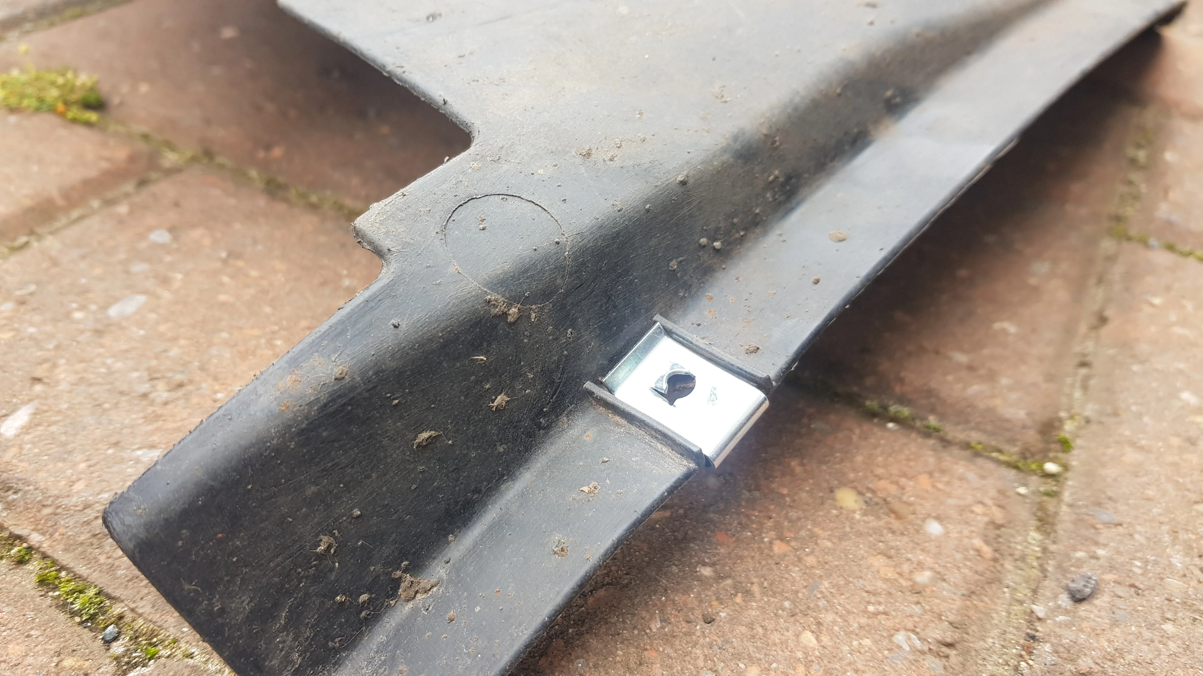

Finally as the bumper was off I renewed the spire clips and bolts with some new stainless ones off ebay. Theyre much larger and seemed to hold firm within the liner so I hope they dont seize in like the old. Had to dig the grinder out for most of the original bolts as they were basically cheese.

I recently put all new spire clips on my bumper/arch liners. Was very satisfying. However I now see why I liked only having a total of five holding things together lol

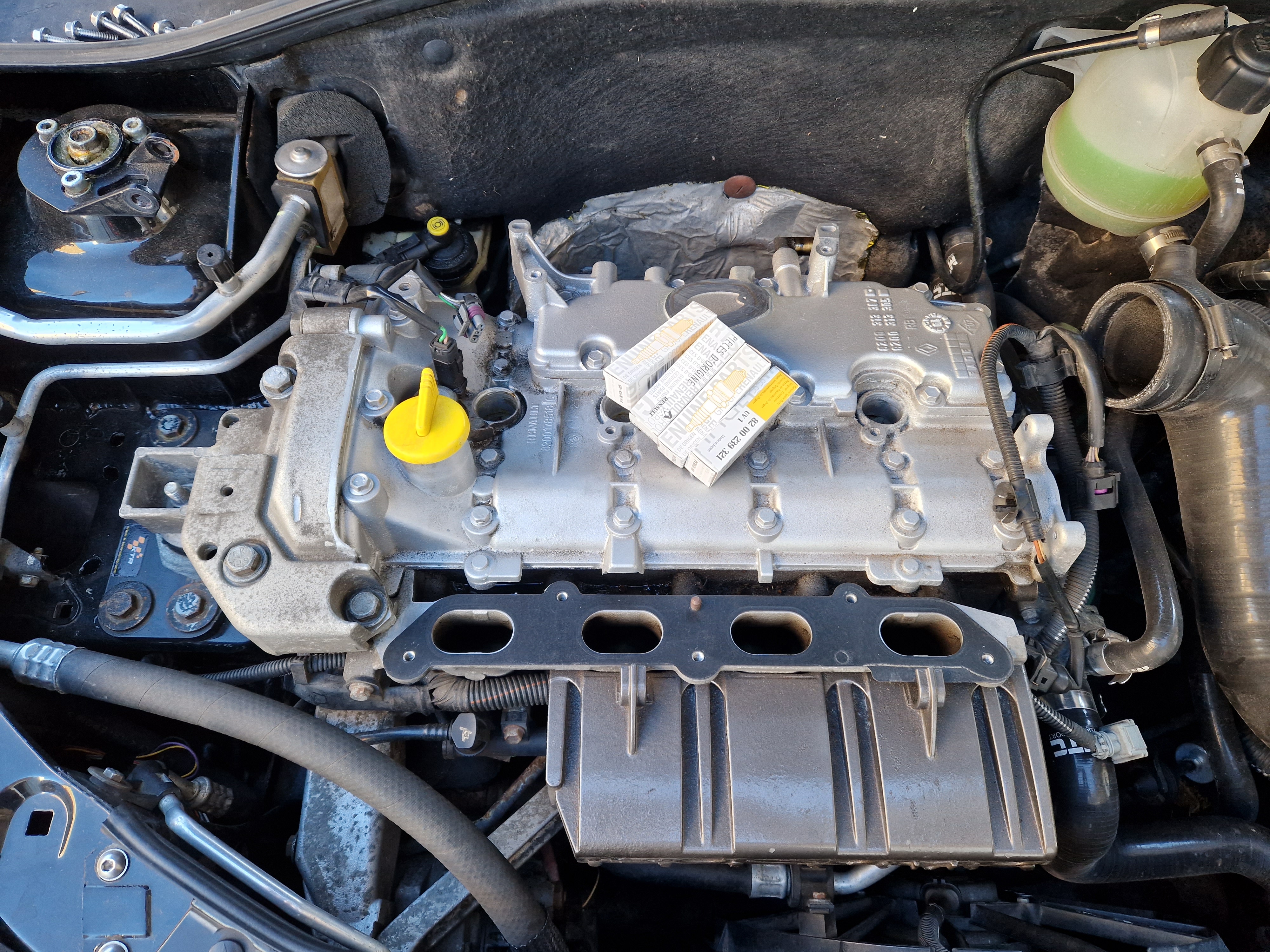

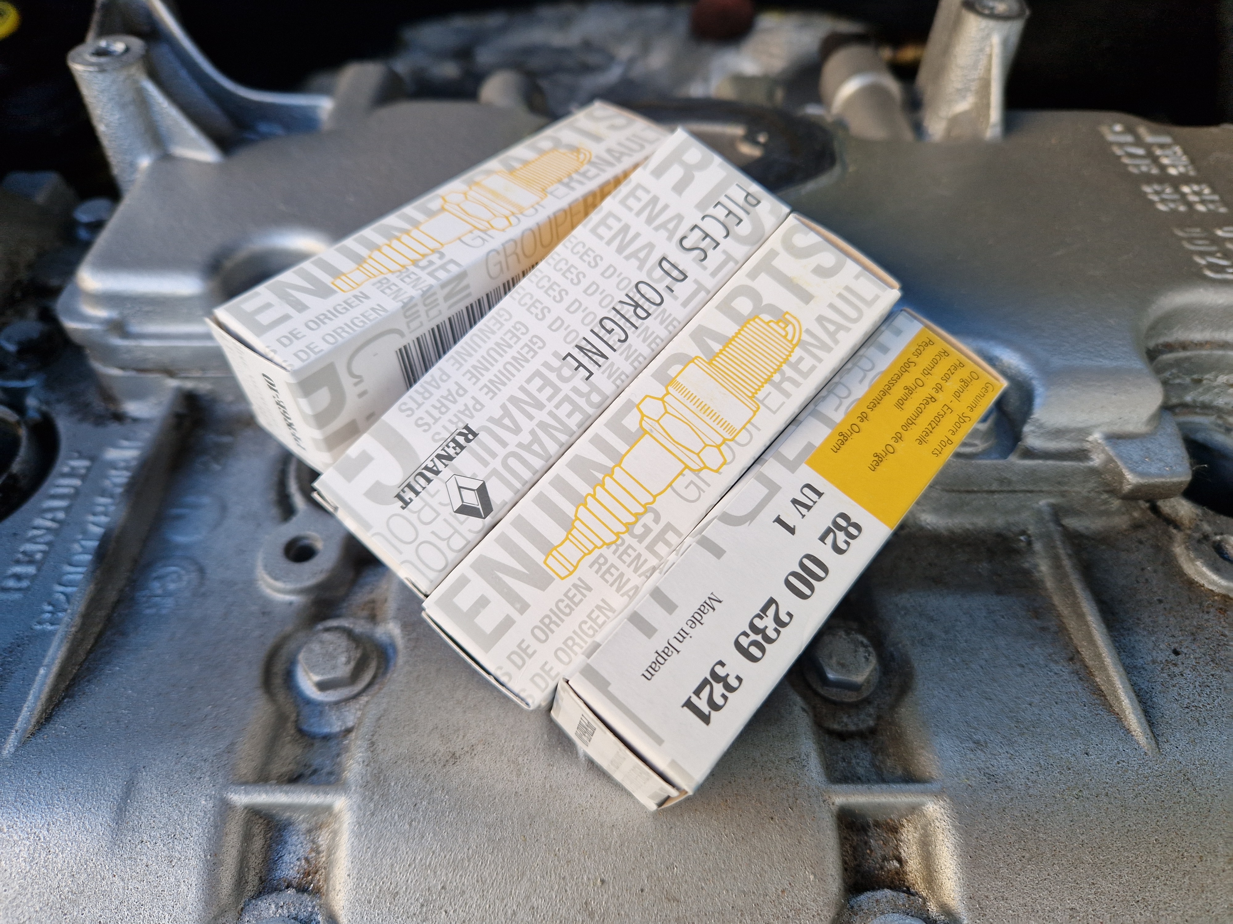

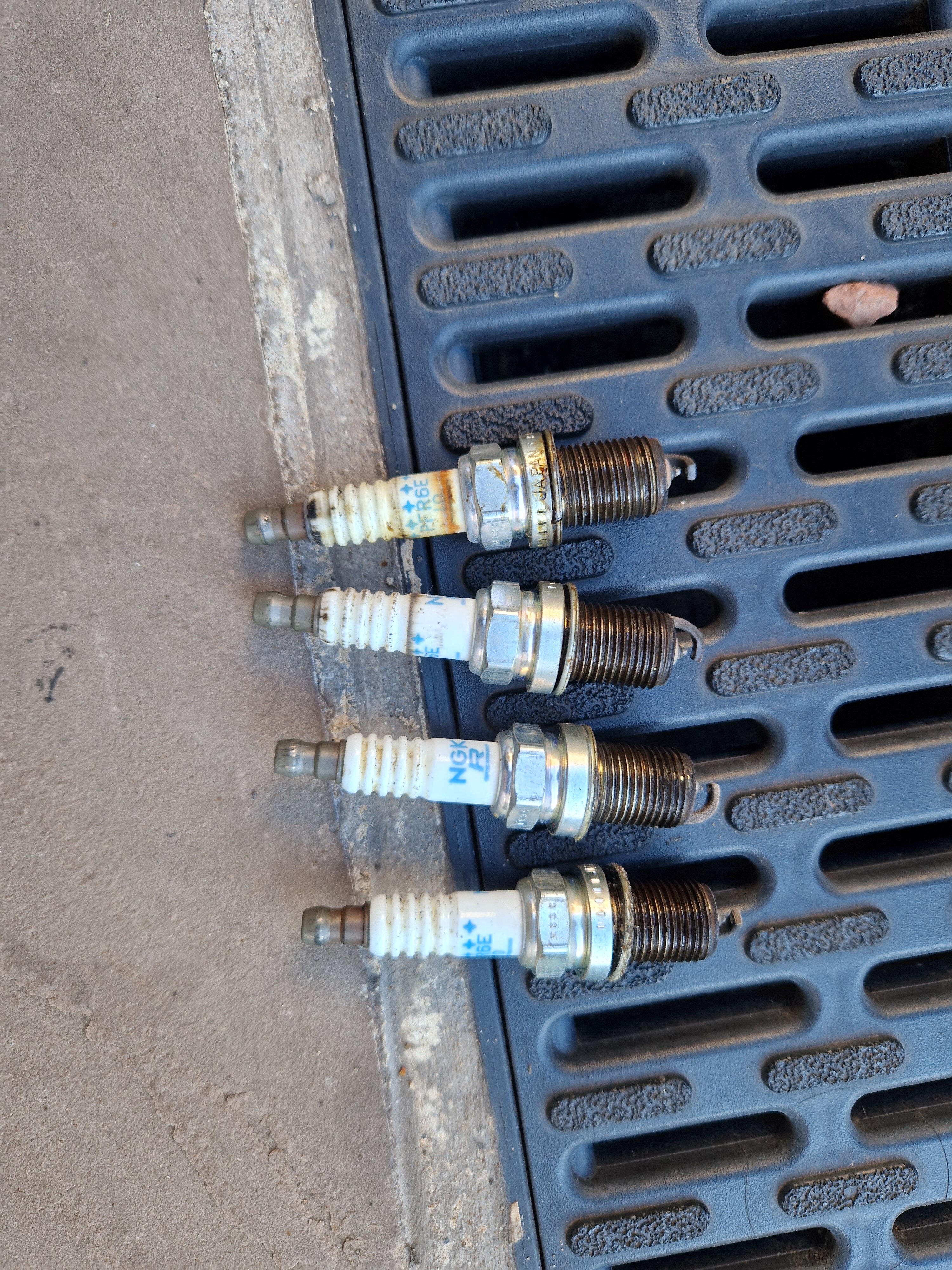

Had a bit of low RPM judder/misfire so after some advice I replaced the spark plugs. Pretty quick job, majority of time was taken cleaning all the mating surfaces. Old ones looked fine, but being 5 years since I did them was a good job to review.
Genuine Sparky Bois fitted again and will see tomorrow whether it's sorted this issue. Might look at getting some Magnecors too as the HT leads have clearly been replaced individually as some point as there is 2 x 1's unless that's OEM?

Genuine ren leads are best bet if you can find a set. Never rated the magnecors on any car ive had them fitted to, fitted crap on my old 172 Kangoo.
