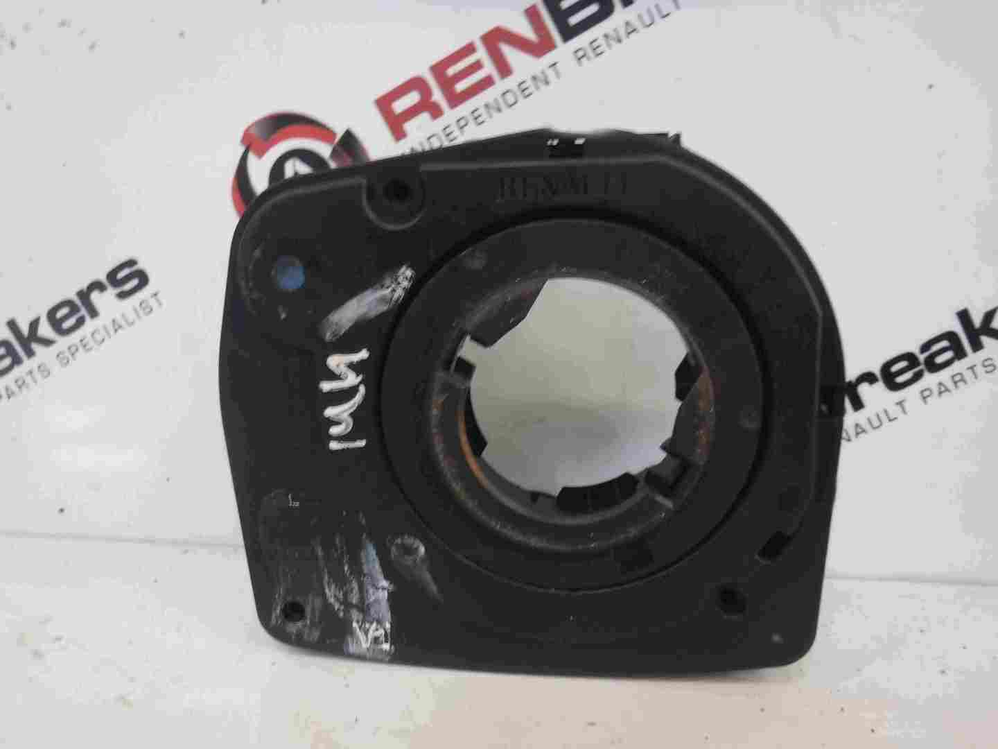

Ye I'd say dead as a doorknob if its still playing silly buggers after a dosage of CLIP[emoji23]
@Inferno182 you got any mate?

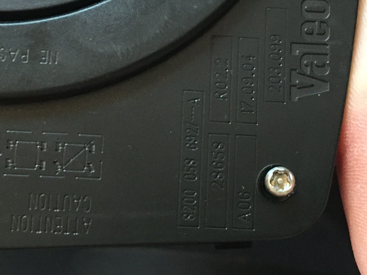

Clips useless on angle sensors, one in the personal collection is the same, won’t reset no matter what you do
There must be something in the air, 3rd time this week I’ve been asked for one,
However all being said I need the 8200 number off yours, Theres about 500 different ones for some reason [emoji2359]
However all being said I need the 8200 number off yours, Theres about 500 different ones for some reason...
82 00 058 692 Sir! 👍👍👍
Thank you @cliocollins 👍👍

Managed to get a steering angle sensor from the smashing chap that is Tom aka @Inferno182 aka BTT motorsport in Wigan. Definitely worth reaching out to this chap to see if he can help if you’re in the 💩! Very responsive and knowledgeable, thanks mate!! 👍👍

Managed to get a steering angle sensor from the smashing chap that is Tom aka @Inferno182 aka BTT motorsport in Wigan. Definitely worth reaching out to this chap to see if he can help if you’re in the [emoji90]! Very responsive and knowledgeable, thanks mate!! [emoji106][emoji106]

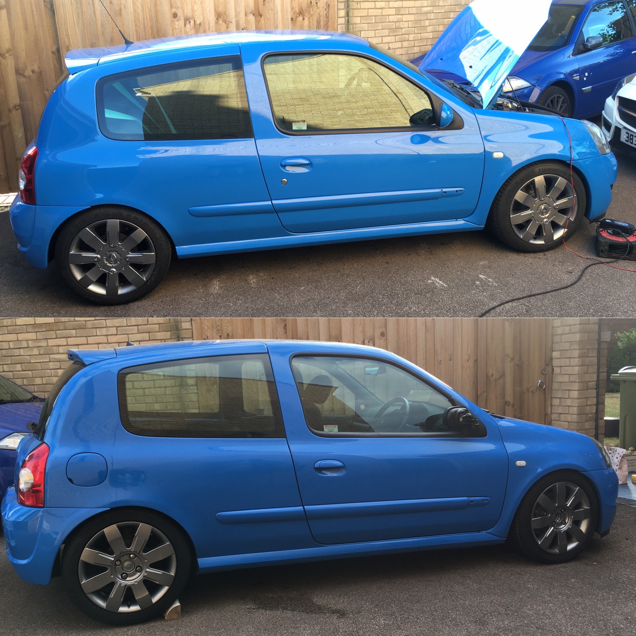

Gave the Bilstein’s a bit of a tweak today and raised the suspension front and rear to allow me to run the front wheel spacers with the 205/45/16 wheels. Interestingly, a 25mm-ish increase in the Ride Height doesn’t make the car looks like it’s on stilts:
(The picture with Bonnet open is after the increase)

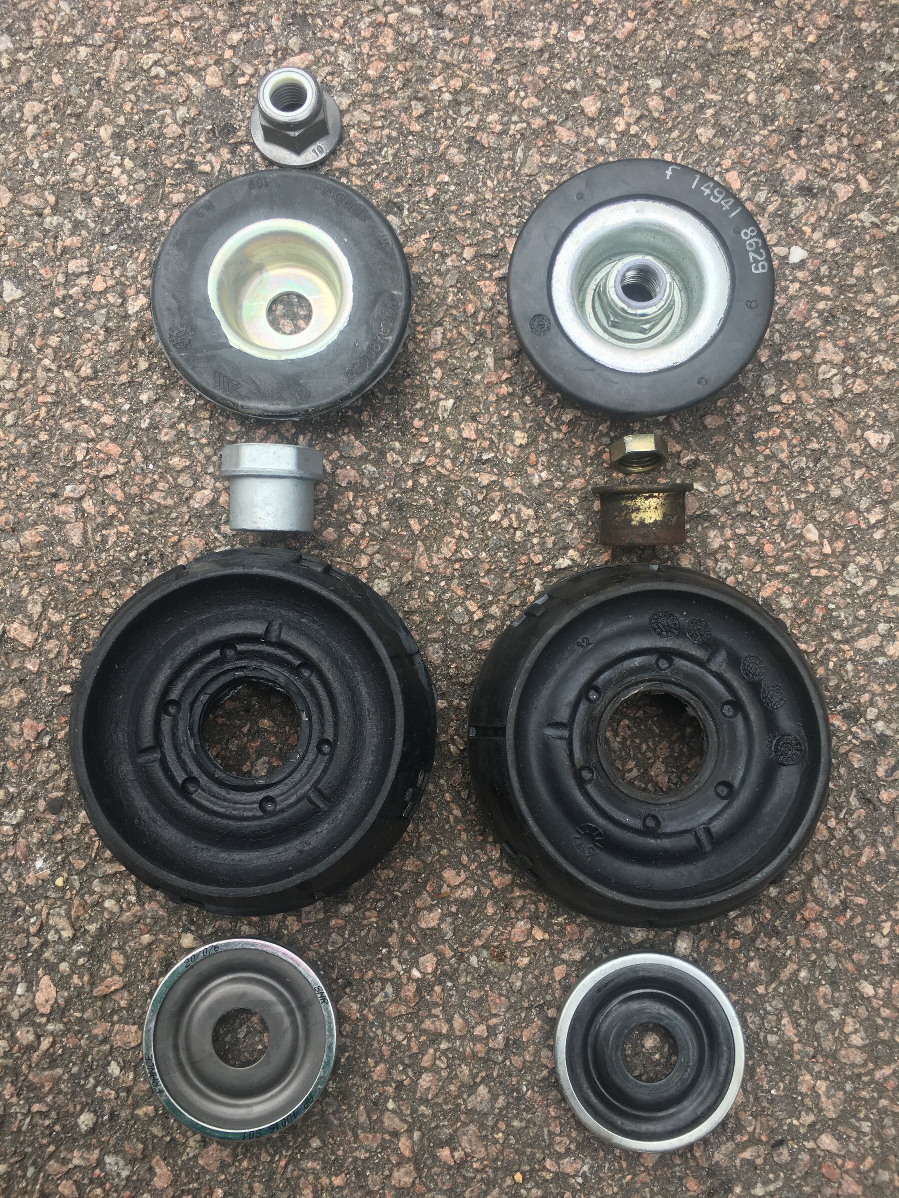

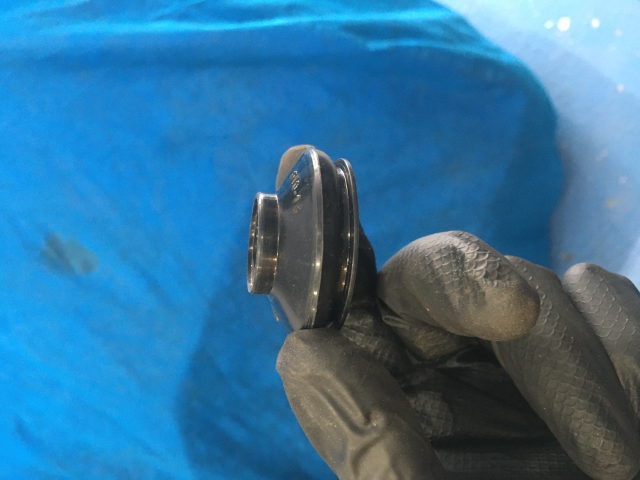

Last thing to do in advance of the MoT was to fit a new pair of OEM Renault (updated design) front suspension top mount assemblies as the brand new Febi Bilstein ones that were on the car were knocking like something on the bloody Ghost Train 👻!!
I took a photo to show the old/aftermarket assembly, with the new Renault design. First impressions seem to say the knocking has stopped...!?

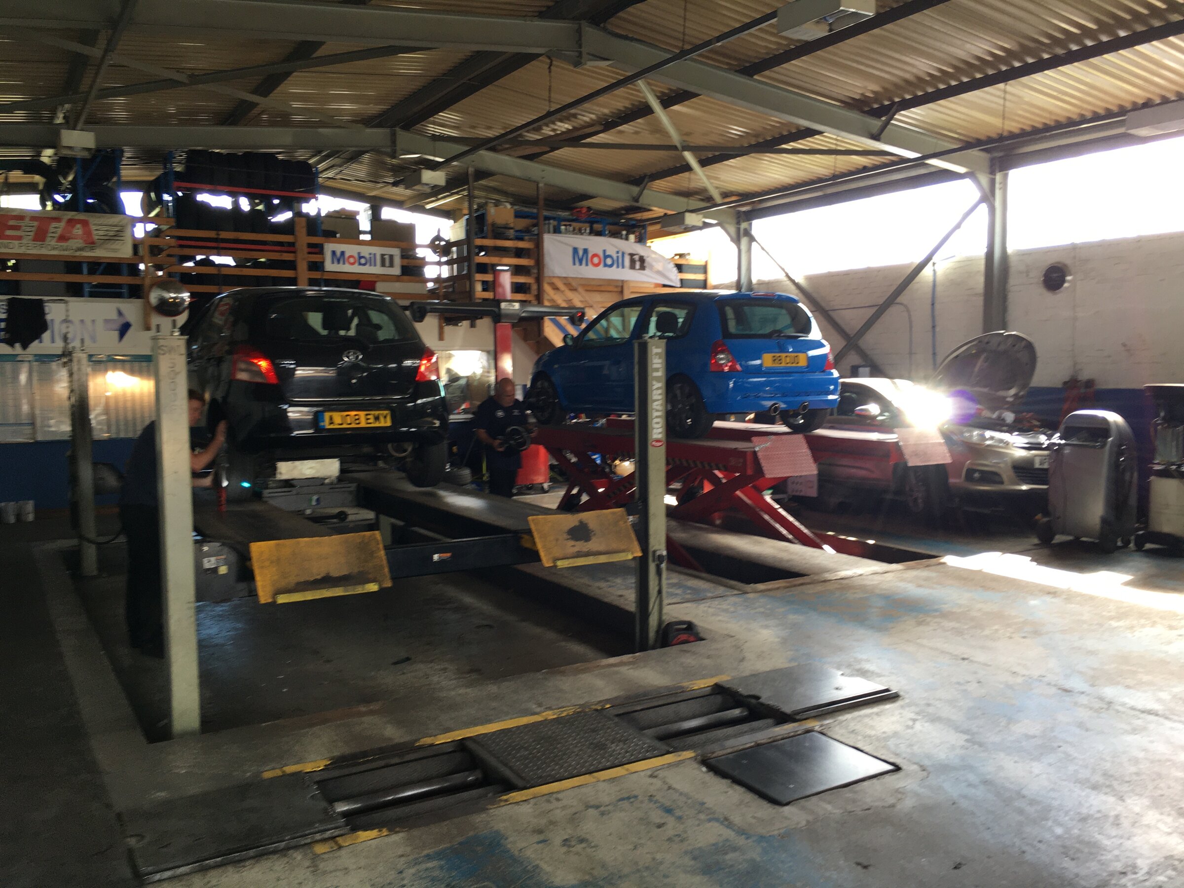

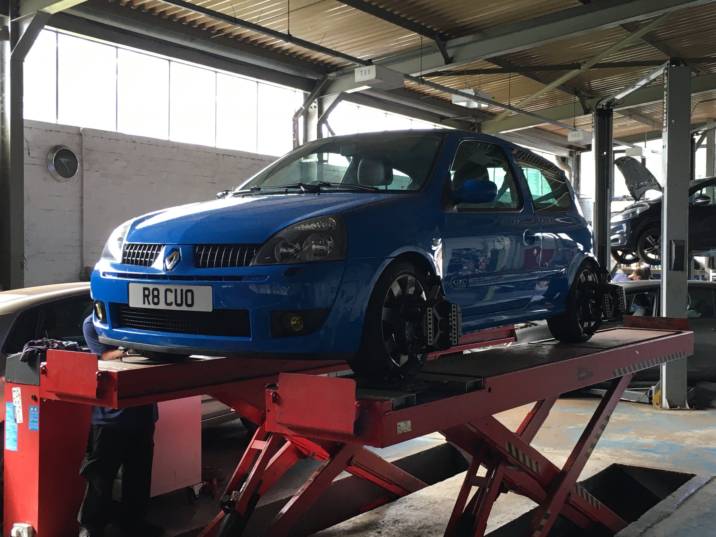

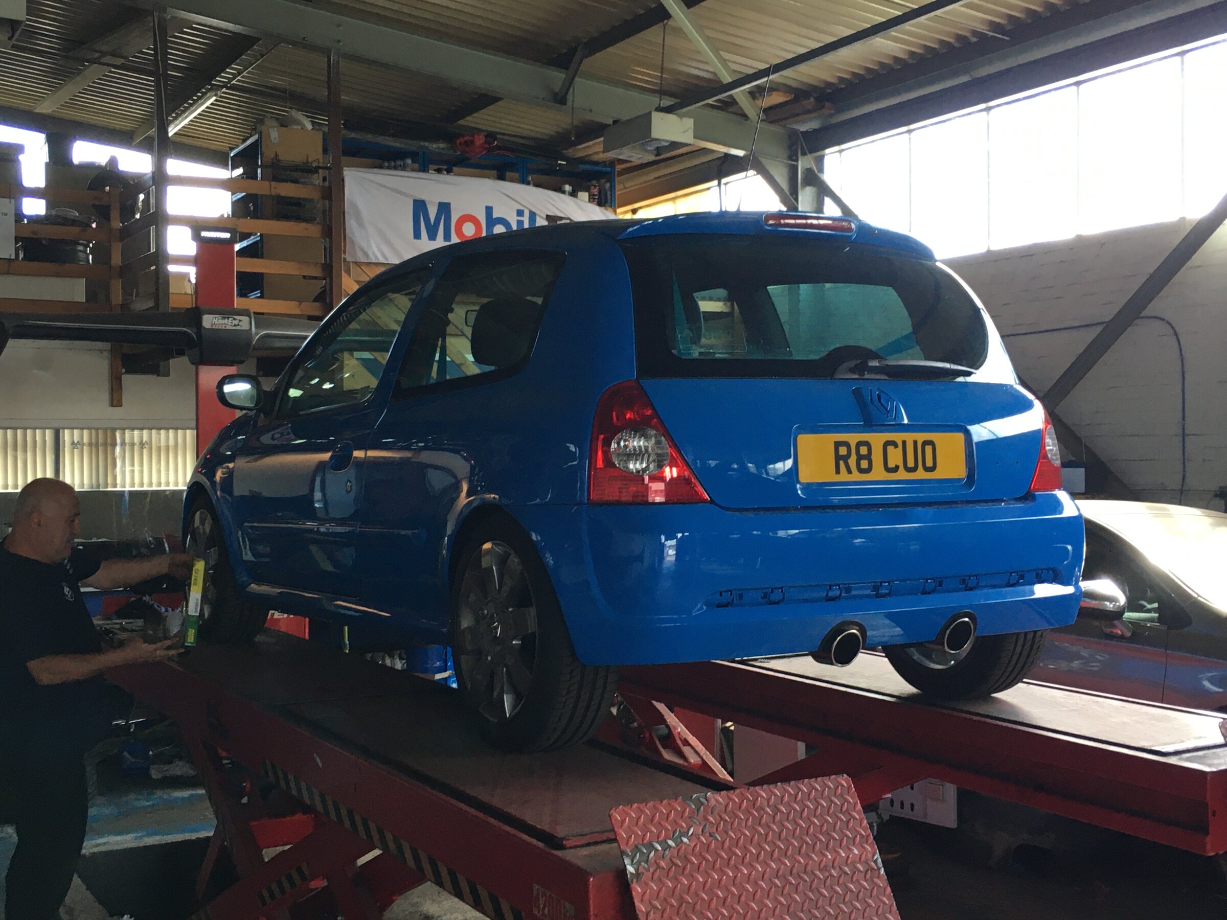

First thing was down to the local garage to get the tracking done:
Then it was tentative little Drive around town to get the feel for the car. Overall super pleased by it but noticed something... quick search of Cliosport later:

1st August 2020, Car taxed this morning so I could have my first drive!!
View attachment 1488207View attachment 1488208View attachment 1488209

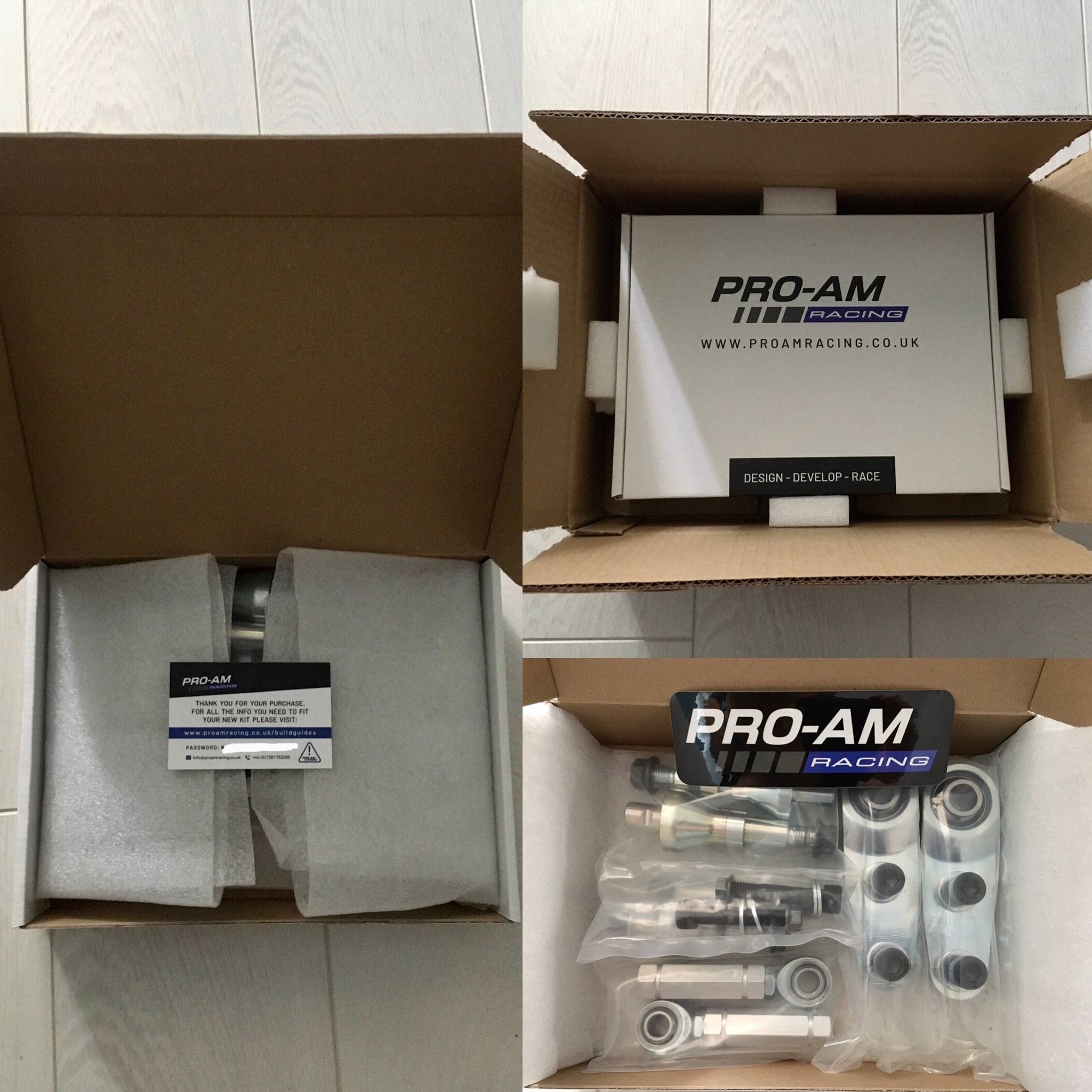

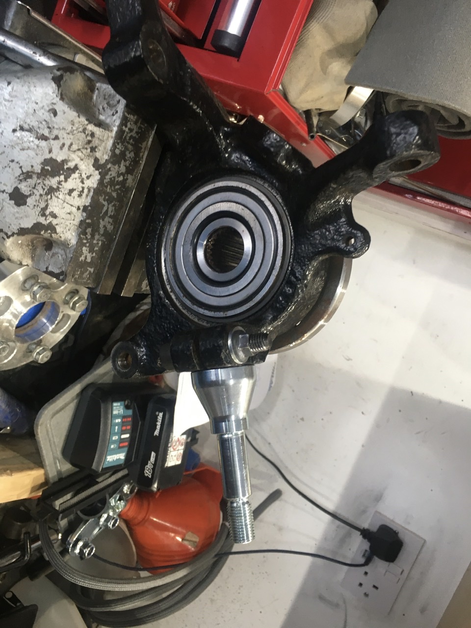

I noticed the Lower front suspension arms and driveshafts being nearly horizontal when I had the tracking done last weekend so being aware of these roll Centre kits, I thought I would have a punt on one of the Kits from Scott @Tomotek as it’s easily reversible if I switch back to bone stock sometime in the future.
Ordered the kit on Sunday, and it arrived today (Tuesday) in some beautiful packaging:
Look forwards to getting it on.

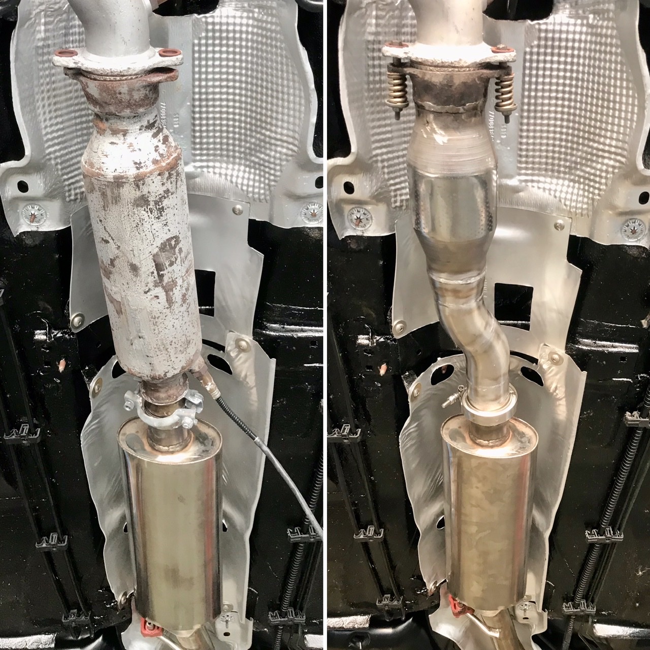

Nipped down to a local garage that offer custom exhaust fabrication and had a chat with the guy about removing the restriction in the original Catalytic Converter 🐱.
After a few minutes of chatting I was soon talked round to removing the OE cat all together and replacing it with a 200 Cell Magnaflow Sports Cat and new pipework to improve that area all together.
Picked it up today, and chuffed to bits with how much better it looks, and all the restriction’s have gone:

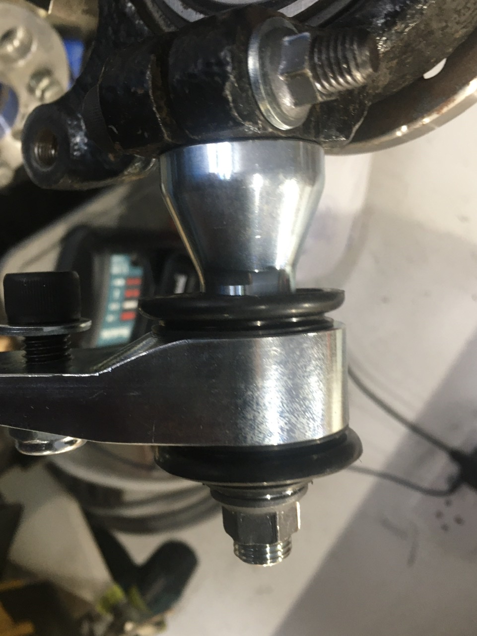

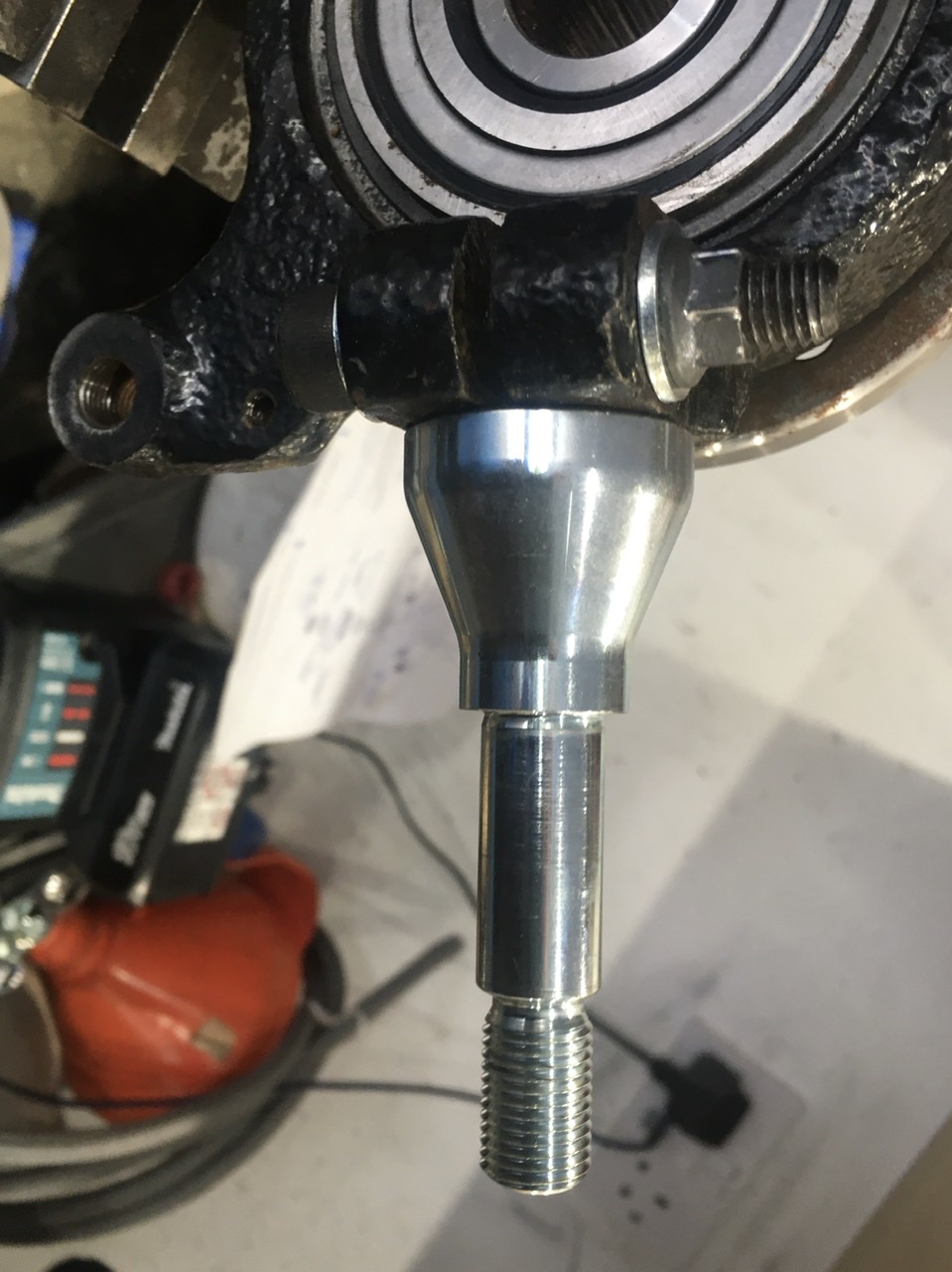

Finally got round to fitting my Roll Centre kit from @Tomotek today.
A fabulous bit of kit with everything you need and super clear instructions, all credit to Scott, it’s well worth the money 👍👍
I know many people are concerned about the open bearings on these roll Centre kits, as there’s no dust covers, but I’m not too concerned, as this car won’t be driven in the depths of the British Winter and it’s salty roads... however after a quick eBay search, I found four of these:
Which when fitted to the kit, should keep the worst out of the bearings:
Now just need to get the tracking done... again 🙄
Thanks for reading 🍺

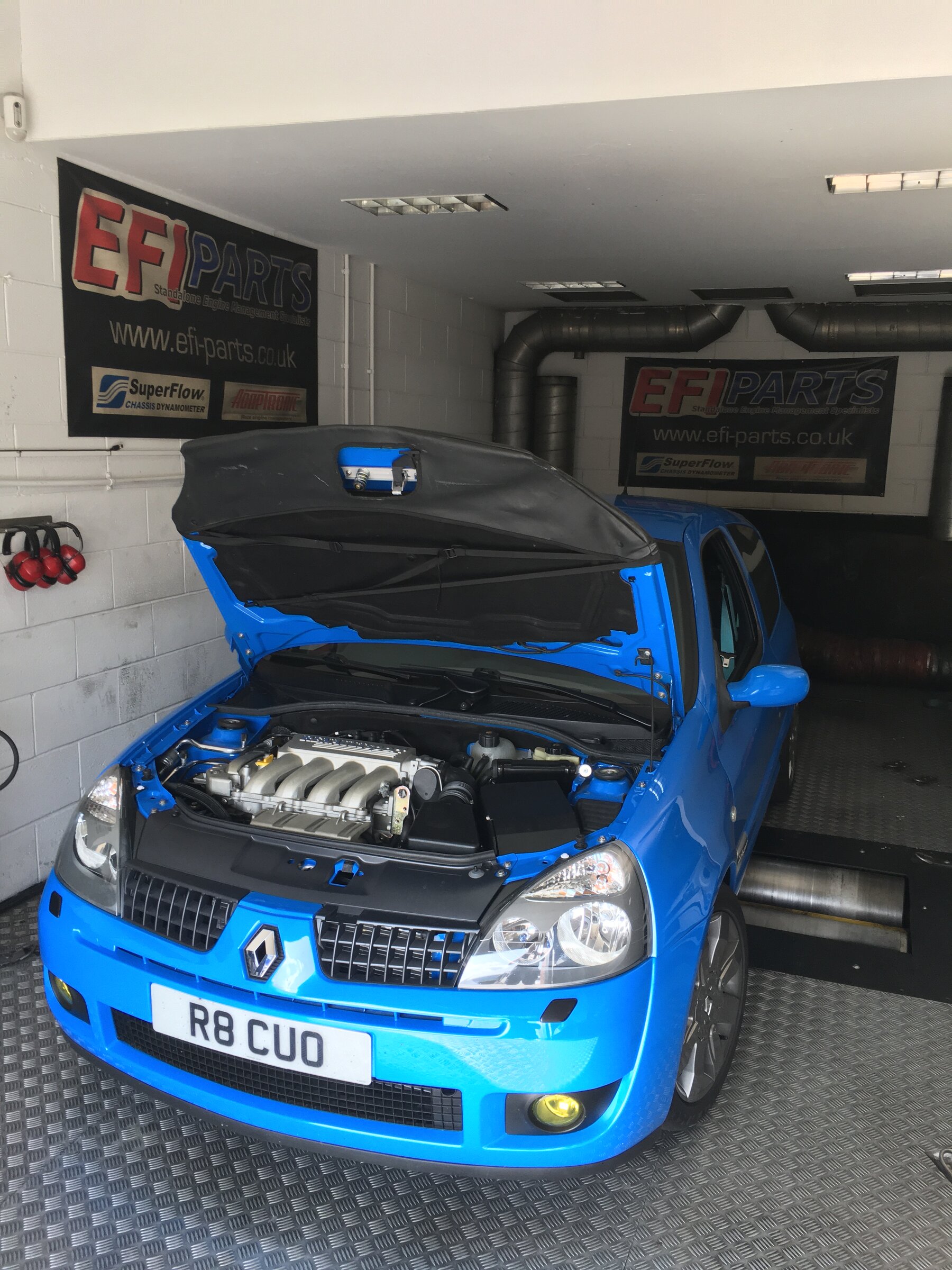

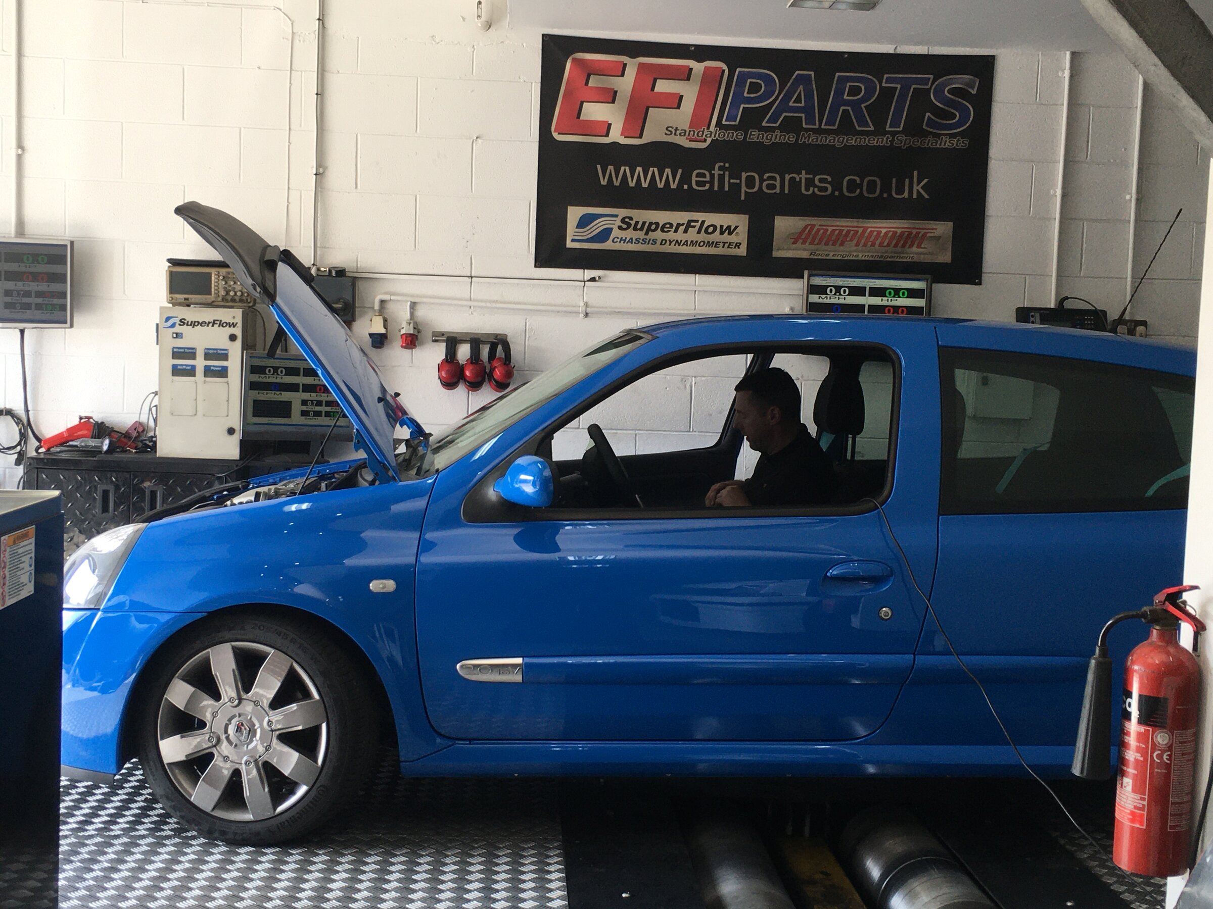

Yesterday was the day to see this project wrapped up, as I took the car to Chris/Scoff at EFI Tuning to be mapped so I can finally drive it properly rather than potter around at my own imposed 4K Limit,
Just to remind you all what’s been done to this engine during this build:

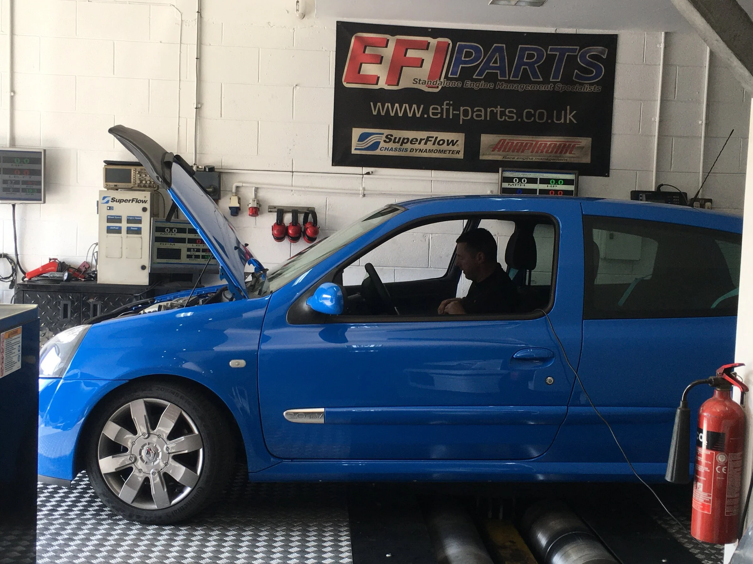

Arrived at EFI parts and first fitted the 197 Injectors to the engine, before Scoff spent a few minutes updating the Software on the car. Turns out that the ECU programme was the oldest 8001 version, rather than the latest 8003, so Chris updated that for me:

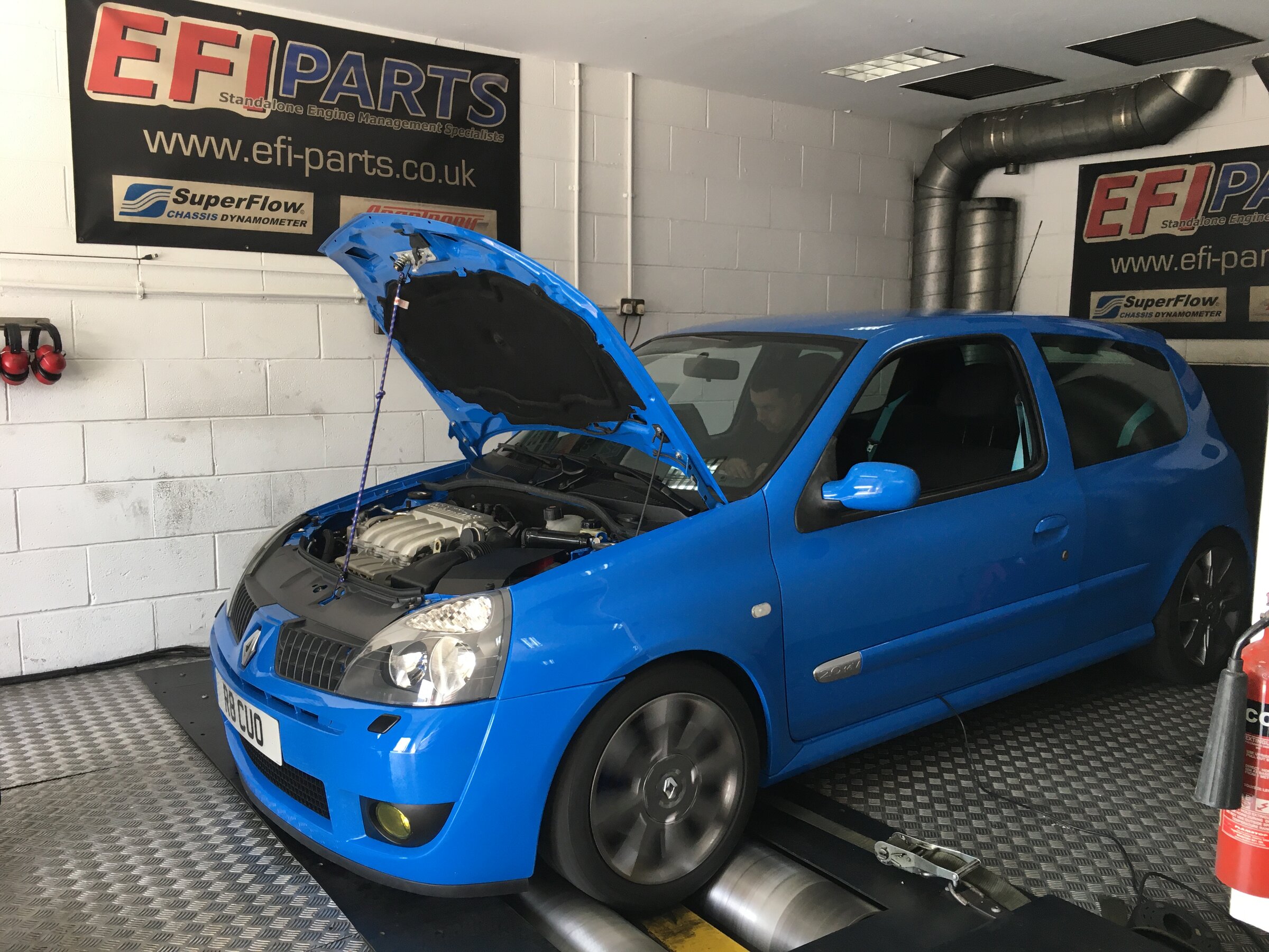

Next it was time for Chris to put it on the Rolllers and start to work his magic:
I was super impressed with the amount of effort and time Chris put into the work, and could see him tuning all parts of the map, not just doing the power run, but making sure the car will drive well, as well as perform as intended.
I took a little video of one of the power runs:

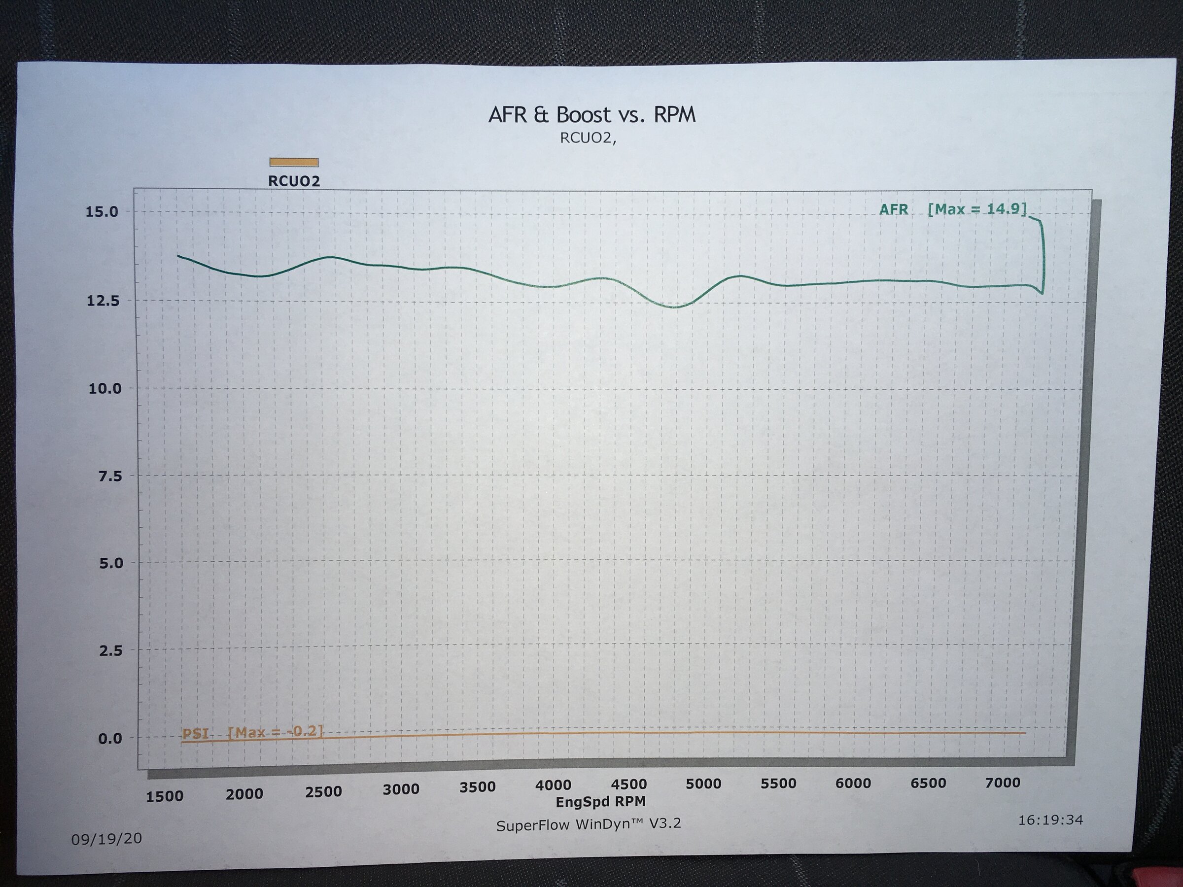

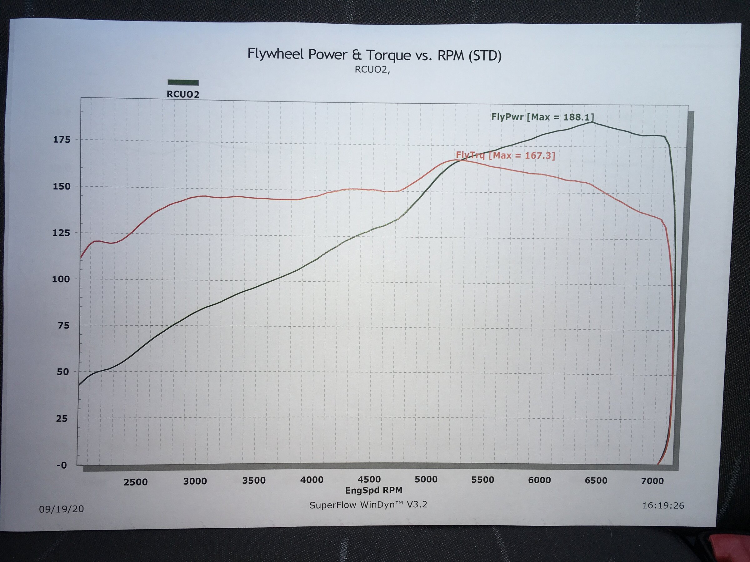

So enough of the text, it’s the graphs you’re waiting for eh..? Well here it is:
188.1 bhp at 6400 with 167 lb/f at 5250 🙄
Little bit disappointed with that as was hoping to see the power at 190 something... but it appears that everything is not right with the engine....

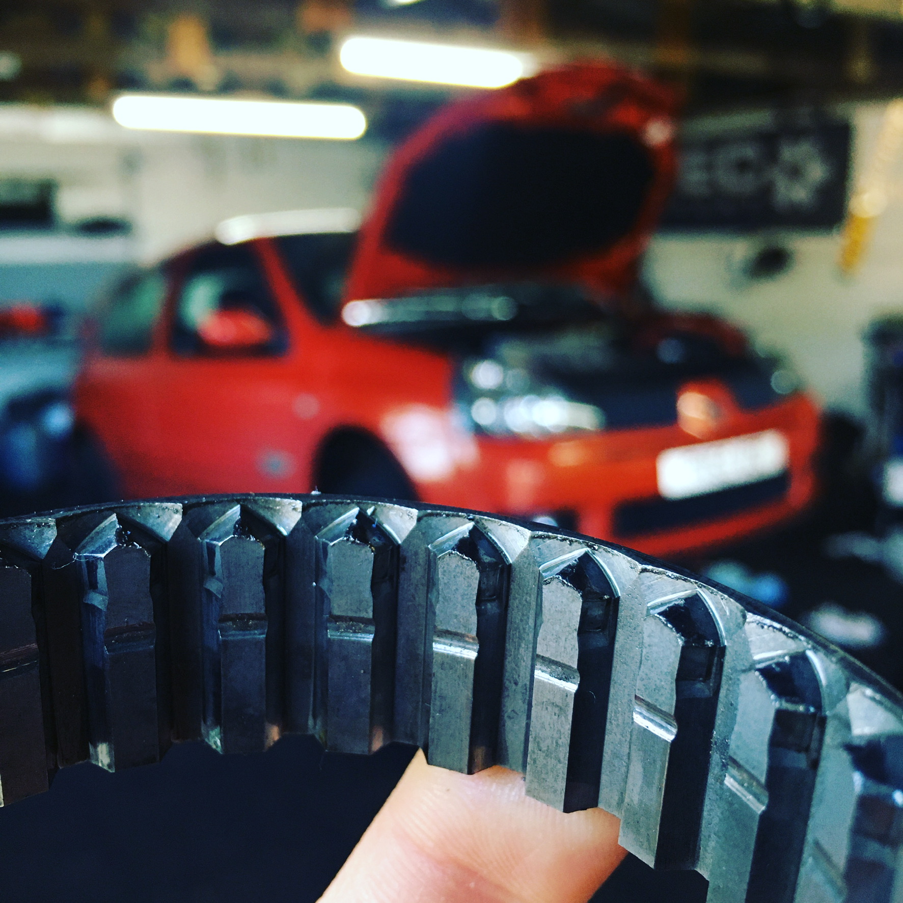

Chris noticed a rattle during the mapping and saw it during the power runs also, there seems to be an issue with the BRAND NEW Dephaser Pulley as it’s rattling a little bit, and doesn’t seem to be “locking in” when the VVT tells it to?? You can see that the power really drops off after the peak. He saw during the mapping that sometimes it seems to work, and then other times not... 😤😬
SH1TBAGS!!
So it appears that whilst I’m removing the gearbox to fix the 5th Gear Synchro Issue the Engine has now also got to come out to get the Dephaser Pulley changed at the same time...
