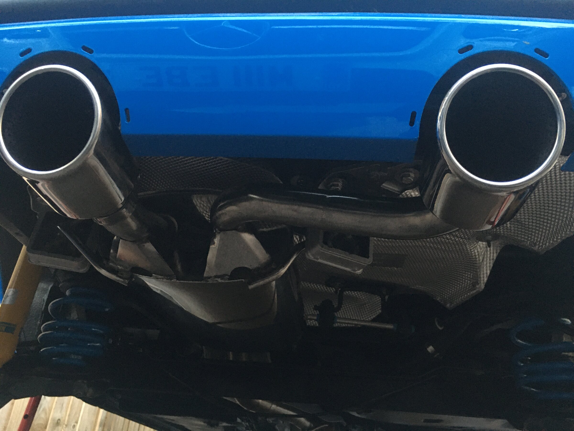

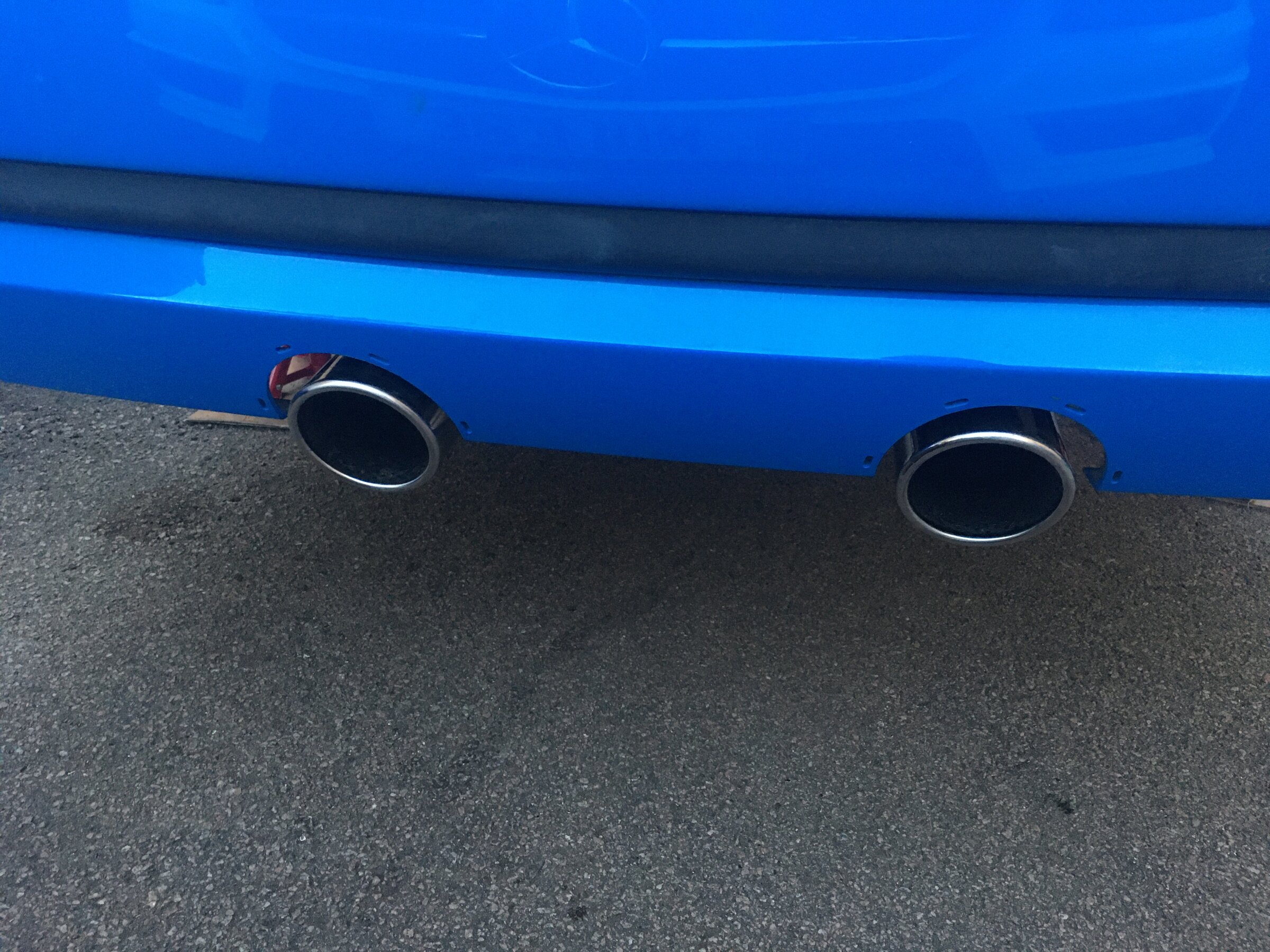

Removed the passenger side headlight, pulled the 4 small relays out and checked the connections all looked clean.. and then put them back in, and it bloody started first time!! 🙄

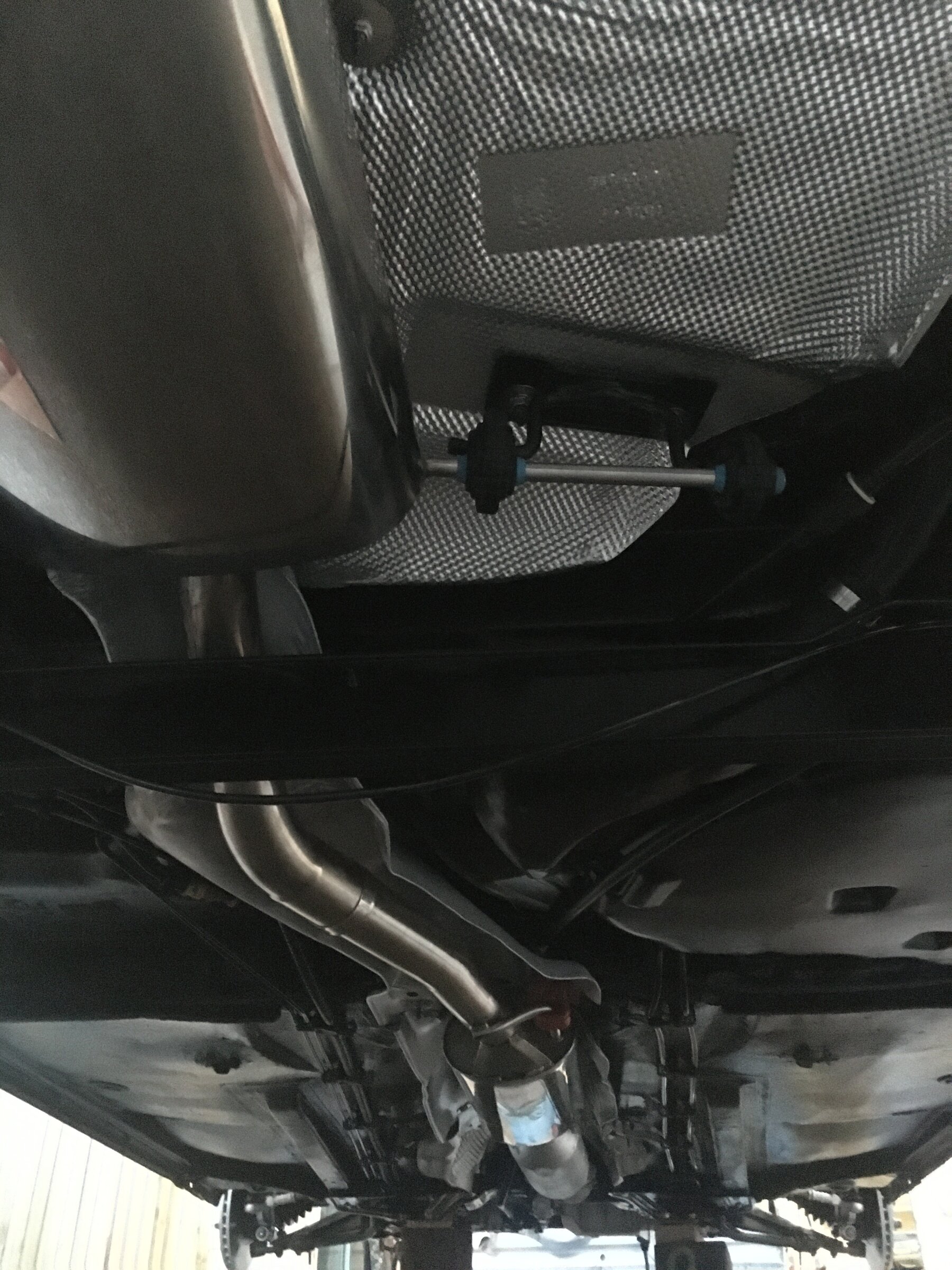

So now the engine’s running, I had a very successful evening bleeding the brakes, and then fitting the exhaust:
Don’t think I’ve ever had an exhaust go on a car so easily and so tightly (fitting!)
Thanks for reading 🙂

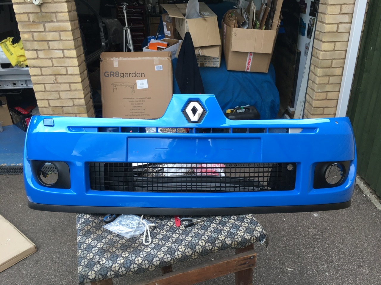

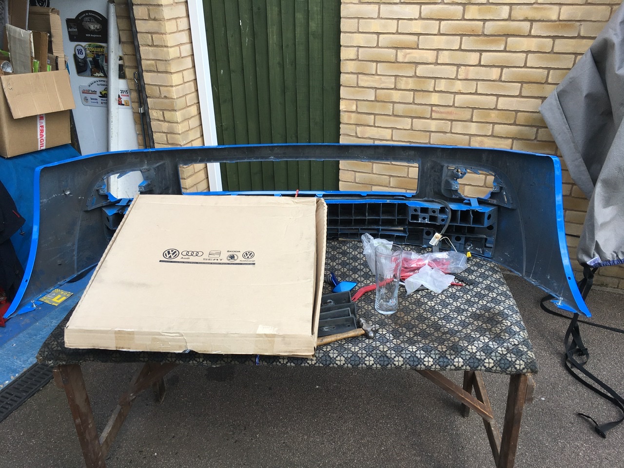

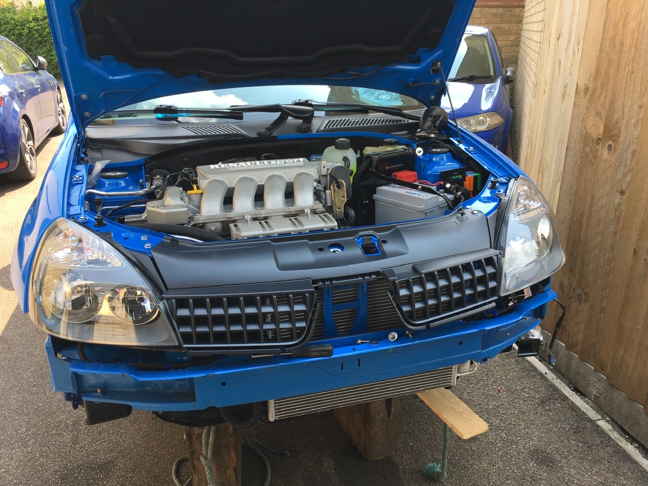

A beautiful sunny day fiddling with the front of the car today. 🌞

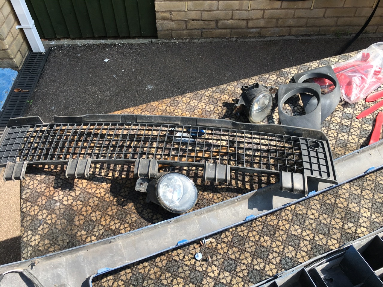

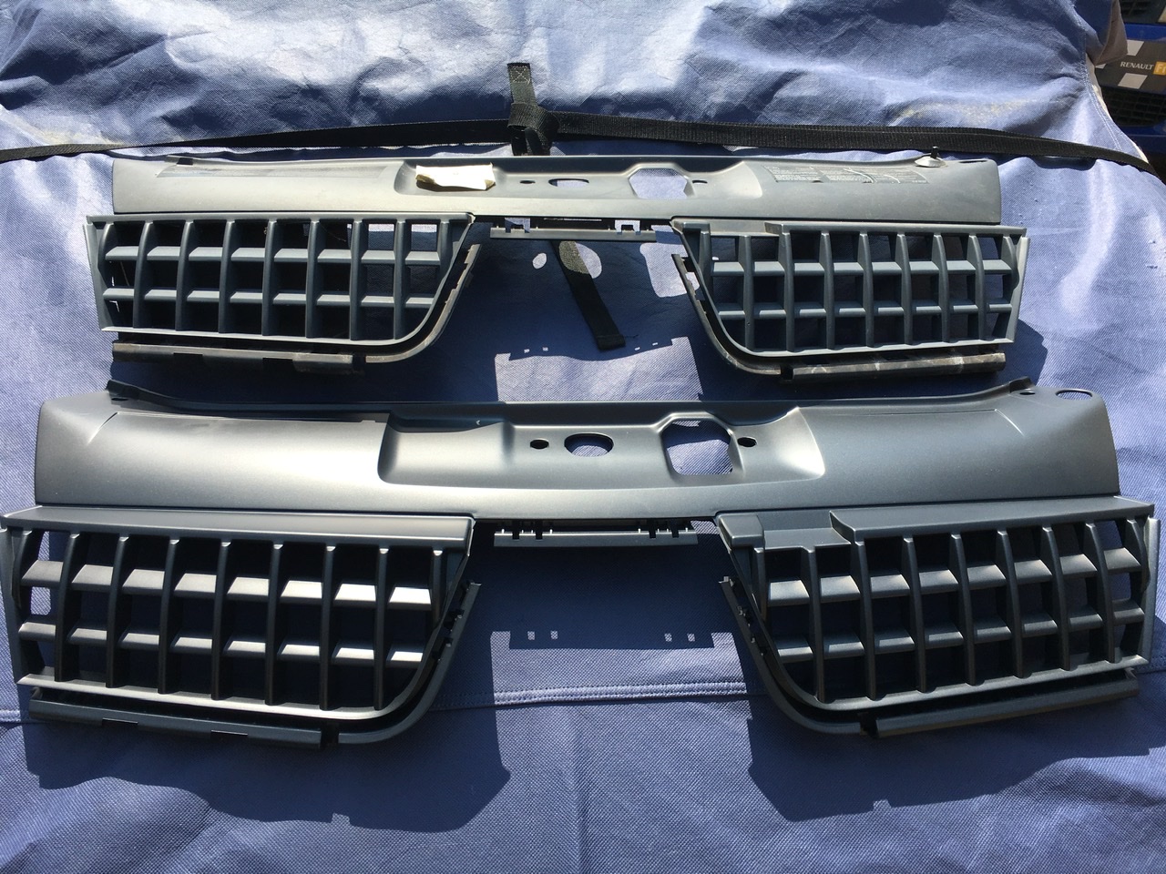

New grille prepped for fitting, need to drill the hole for the bonnet switch as they don’t come pre-drilled. 🤷🏼‍♂️ Old one was looking very sorry for itself, and had a few knocks:

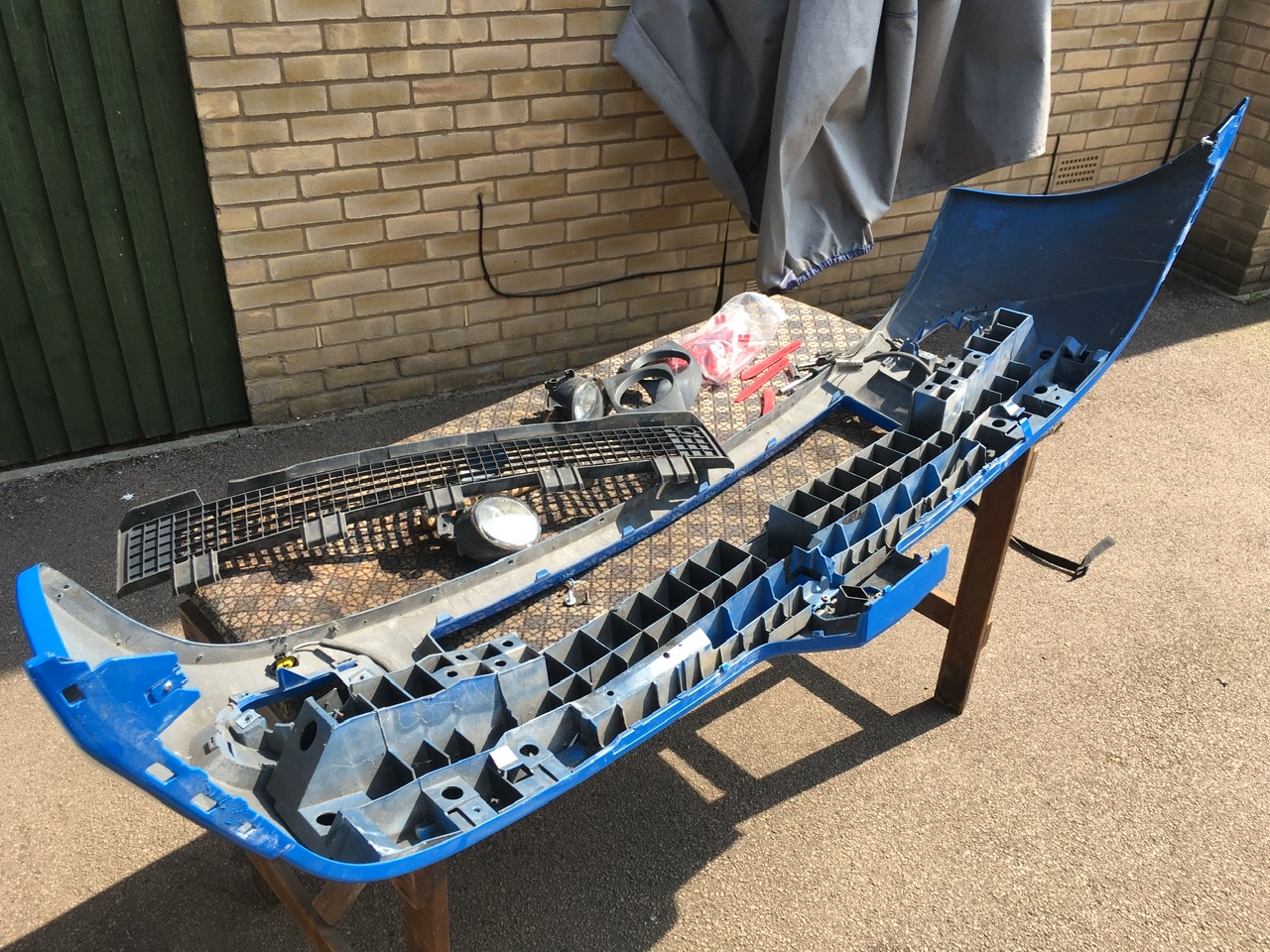

Next I dismantled everything from the front bumper to be cleaned:
Whilst I fitted the obligatory Skoda Fabia front Splitter:

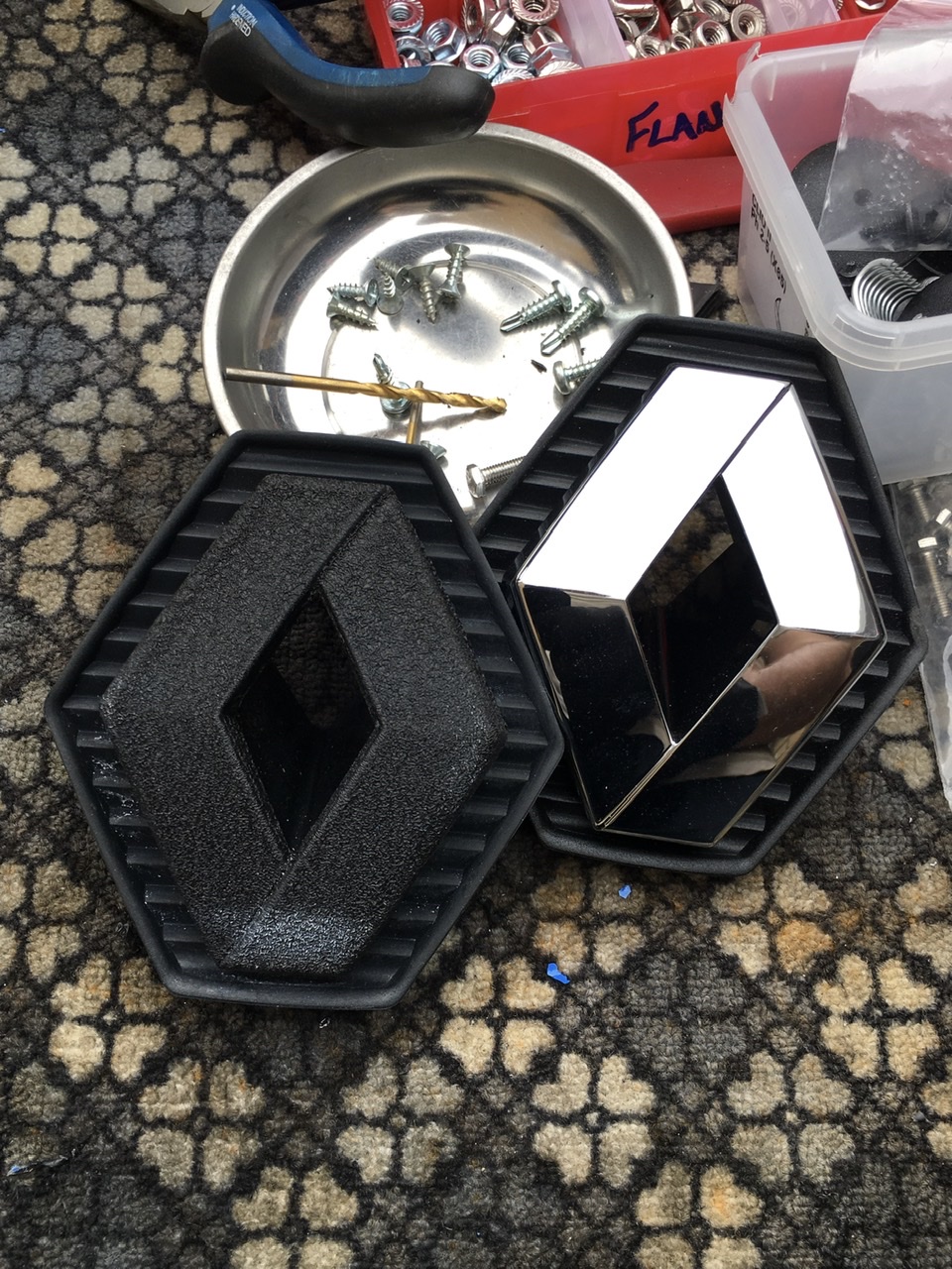

I then removed the GASH front bonnet badge that had been crinkle painted (like all the badges on this car) to replace it with a nice new shmoo OE one:
Finished off with a front bumper looking very pleased for itself:
Ordered new fog lights tonight, so when they arrive, I’ll be able to get them onto the car, but before then, I think I’m going to pay a little homage to my R5 GT Turbo Raider with the Fogs... 💛
Thanks for reading 😎

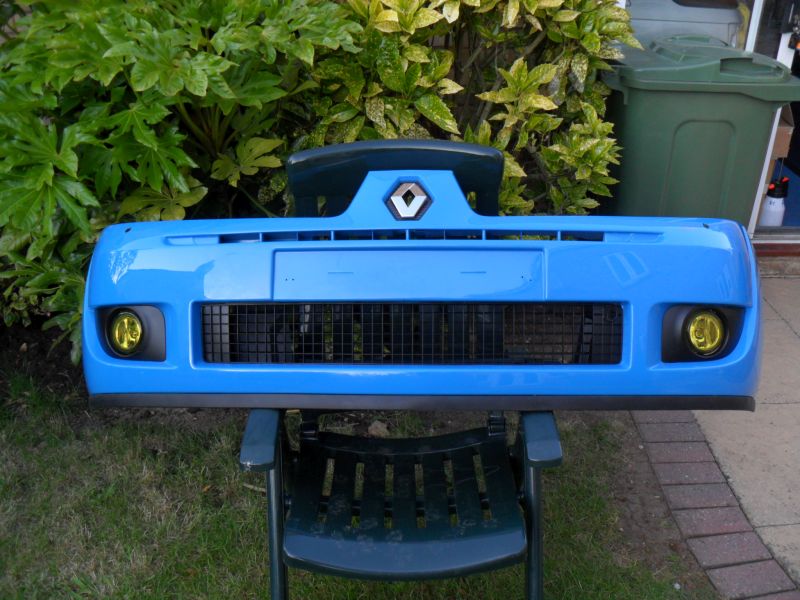

Managed to rope in my dear wife for an hours "Covid-19 Car Crafting" ;) one evening this week to get the Fog Lights covered in Yellow Vinyl:
Chuffed with the final result, and how they look in the finished bumper:
I know they might not be to everyone's taste, but I love the nod it gives to the car's grandfather (my 5GT Turbo Raider) If i decide to go back to the clear lenses, it's only 10 minutes work to peel off the vinyl??

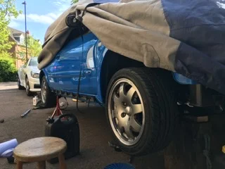

I was pleased that even though it had been covered in all sorts of crap, it hadn't picked up any damage. I then decided I wanted to re-fit the original Raider wheels and tyres, so I nipped out to pick them up from storage, and then jacked the car up to fit them.
As I've just had a load of brake fluid delivered for the RB Clio project, I thought I would take the chance to change the brake fluid on the Raider, as it's been in there for a good number of years now.. So it was a wheel change, and brake fluid flush & change:

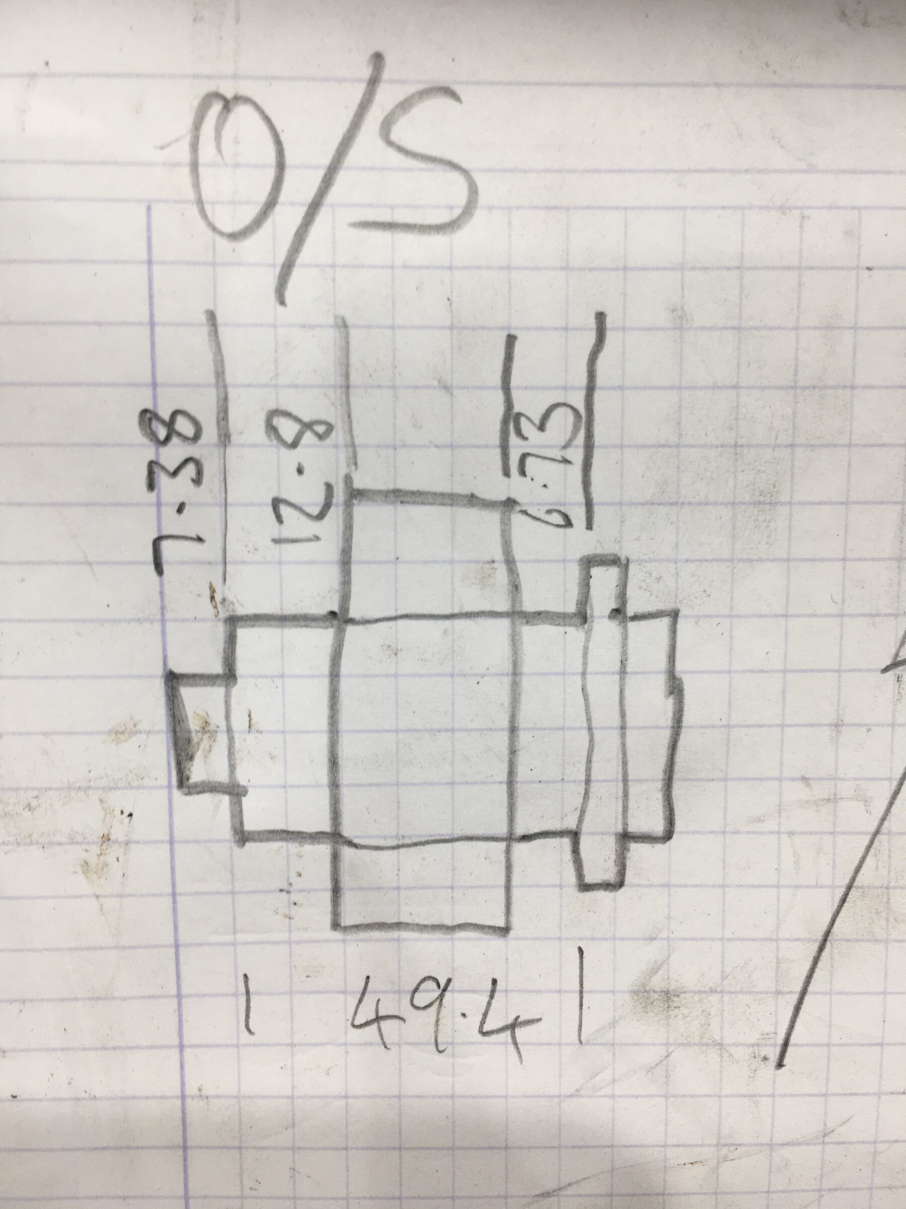

Hi @DomP182 ,

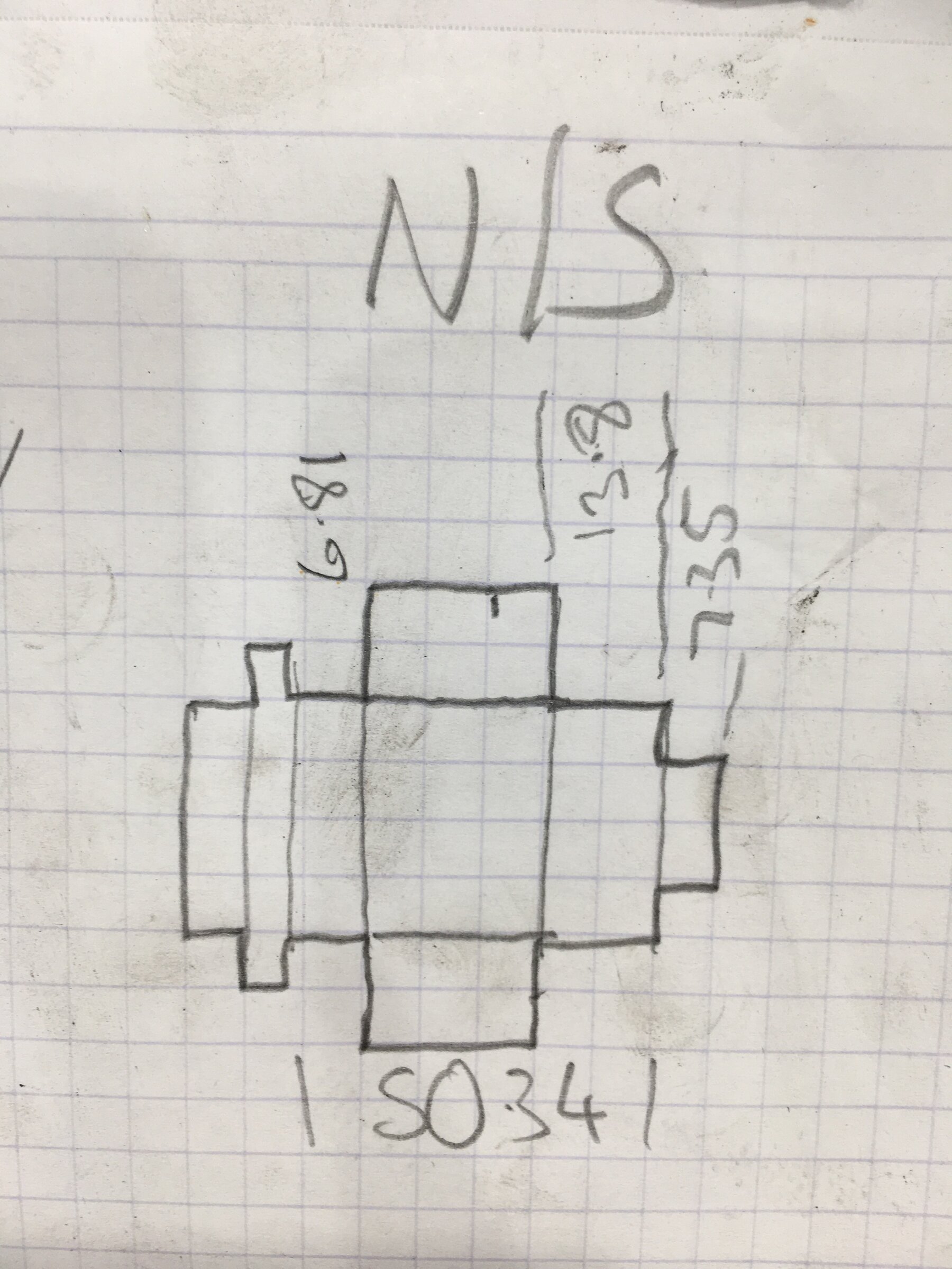

Interesting you ask that question, I measured the positions bushes in the rear beam accurately before I removed them, and gave the accurate dimensions to the garage who pressed the new bushes in for reference.
When it came to fitting the rear beam back onto the car, I did all of the nuts up until there was only 2/3mm of movement and found that I couldn’t move the beam left to right across the car, but found I could move it from front to back. So I just pushed the beam towards the FRONT of the car in the centre to equalise any tolerance that might be present (and hopefully stop the beam going on skewed...
At the end of the day it’s a mass produced super mini with a bigger engine, so I don’t think it’s worth getting too hung up on it, no doubt Claude didn’t when he put it on at the factory... 😆
Dont suppose you have the measurement for the distance the beam bushes press in Steve?

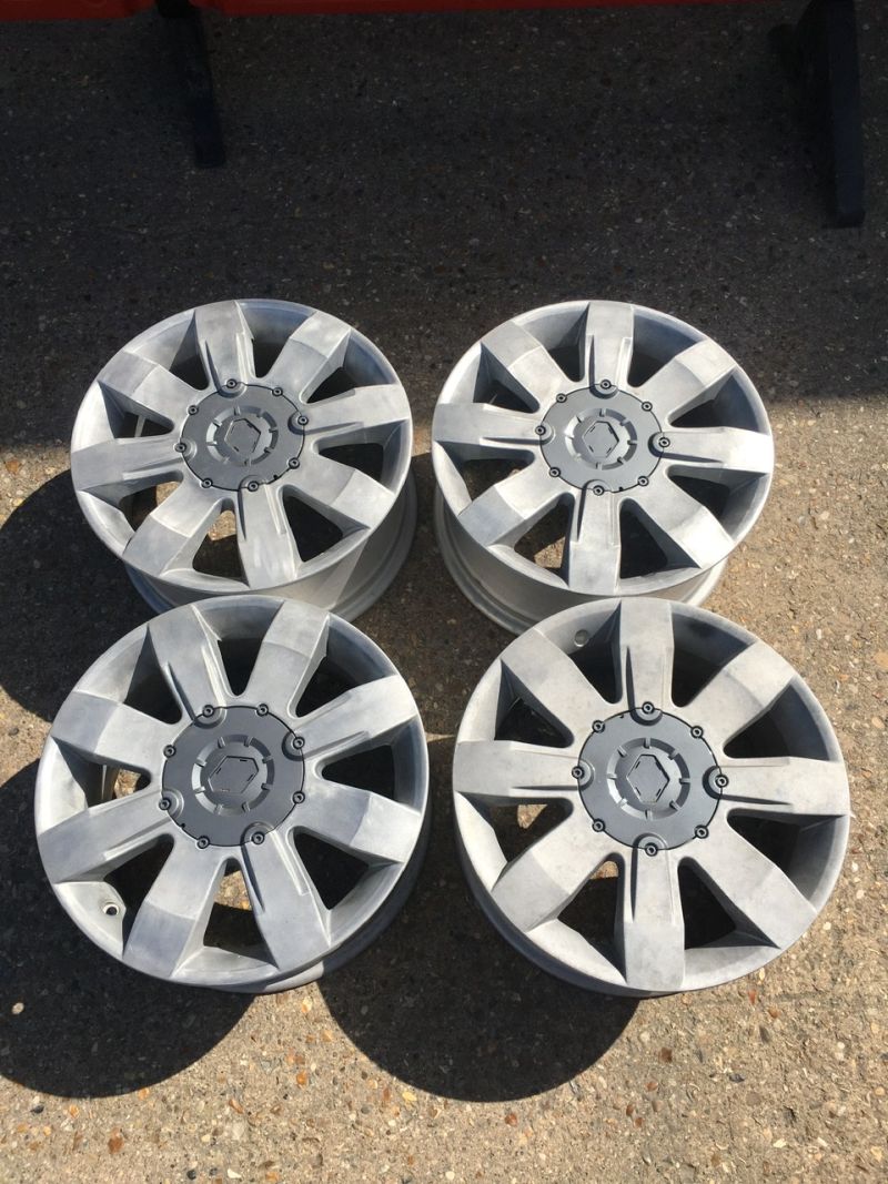

Phoned up my local Renault parts guy:
"Hello Paul, can you still get hold of the original 205110 paint for the wheels on my Clio 182 Cup?"
"Yeah sure, I'll order you a tin"
🤦‍♂️:poop: Bugger!
So I've dropped off the wheels with a local refurbishment place, and they're now going to colour match the OE paint, and get them painted up for me:
