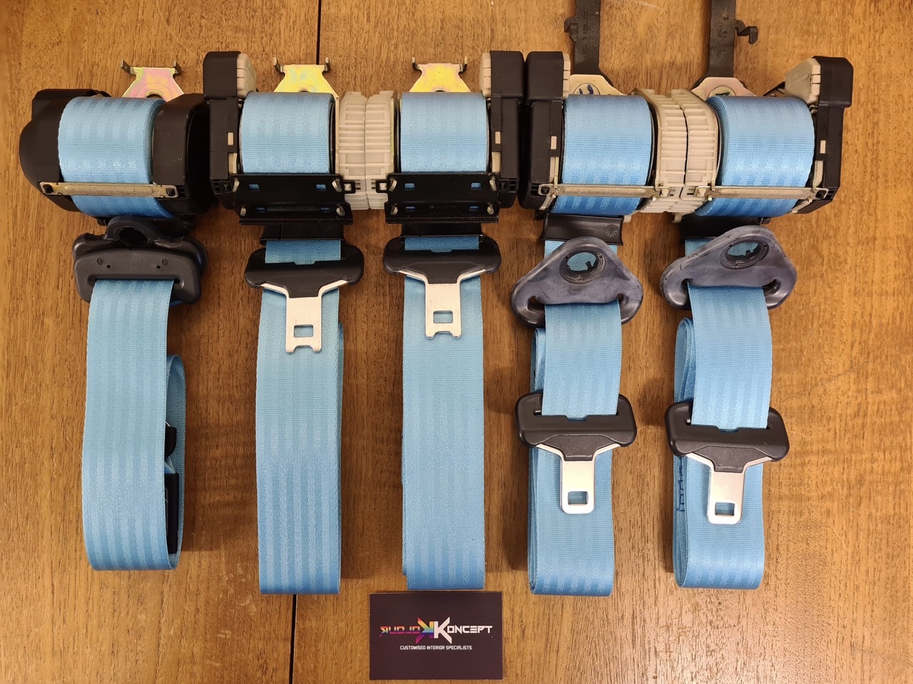

Sent the seatbelts to a chap on Facebook called KolourKoncepts who has worked his magic and changed them from the OE silver/greasy fingerprint brown to this:
Amazingly fast service from this chap! Posted them off to him on Saturday, and he sent me this picture tonight showing me they had been done!!!
Hopefully get them back this weekend and the interior finished off.
Thanks for reading 😎

Just had my black set back from him. 👌🏼

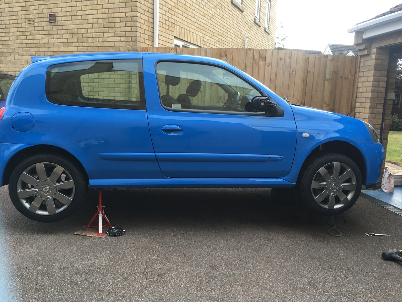

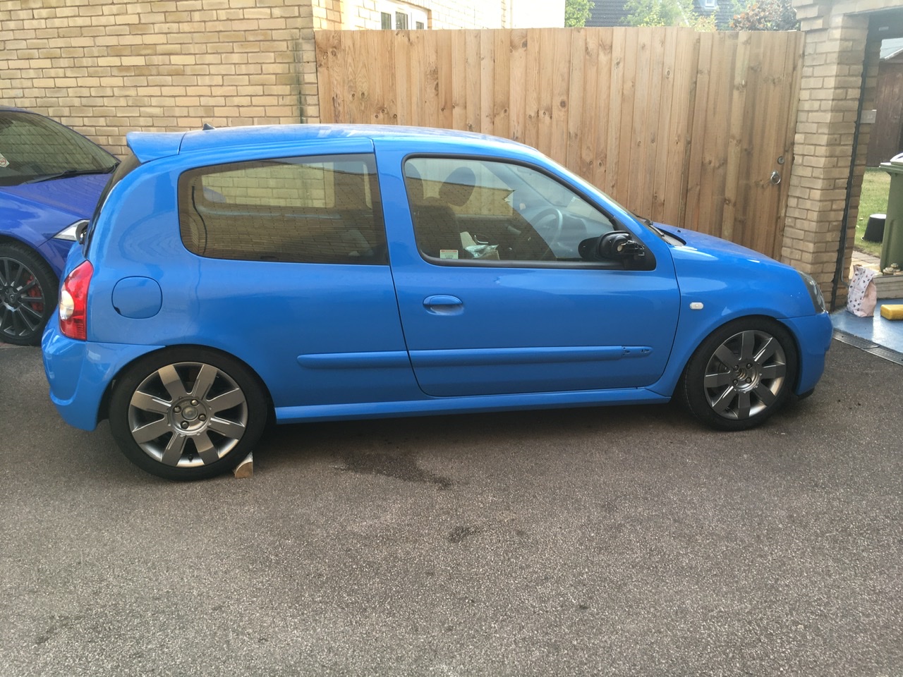

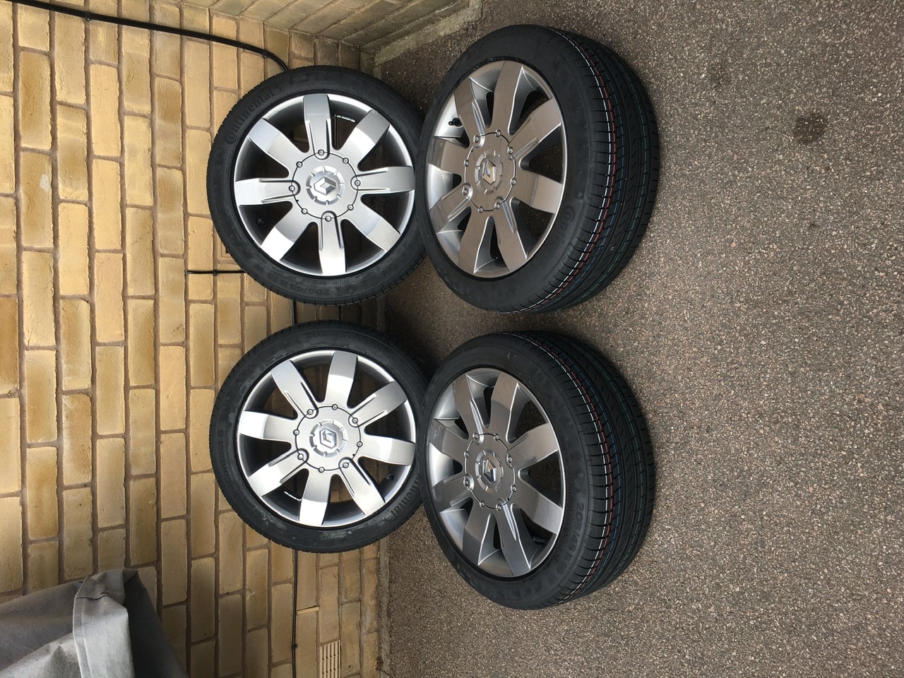

Wow, to see it on its wheels again must be a huge accomplishment Steve.
Agreed its too low and it wont drive very nice either at that height.
Massive well done on getting this far, it looks superb :)
Big_Steve_T
Thank you Sir!! 👍👍
Yes it’s certainly starting to come together. Just the interior to finish off sometime when The nice weather returns..! 🤷🏼‍♂️

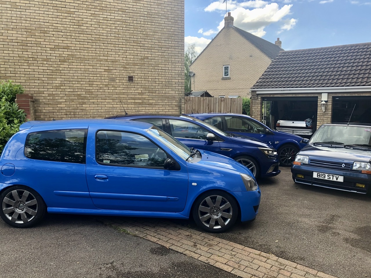

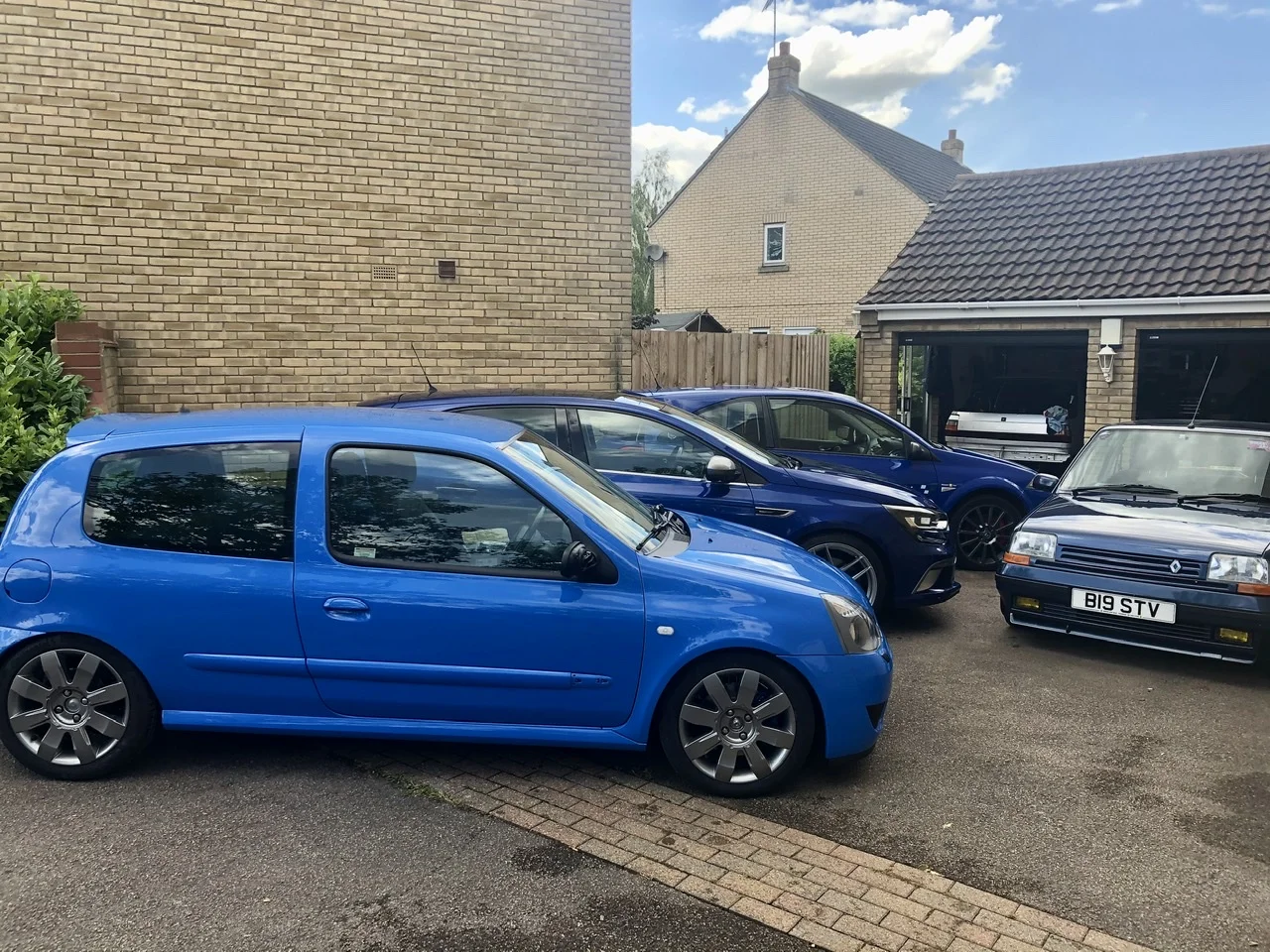

Did something yesterday I’ve been meaning to do for ages, get a picture of all my cars together:
It was the first time I’d driven the Clio As I was manoeuvring it around my driveway as of course it broke my bloody heart as the PAS pump was clearly not a happy camper!! Typical!! It was the only part I didn’t replace when I was rebuilding it all.. and of course it’s not right... 🤬🤬
So I whipped it off the car this morning, and will be fitting a new one in coming days.
Need to get it roadworthy soon as it’s booked to be in with Mr Scoff soon!!

What models the new megane out of interest?
it’s a Megane 4 GT. it‘s the “Warm” version rather than the full cooking HOT version that is the RS.
it’s got the same engine & gearbox out of the Clio4 RS slightly detuned to 205bhp, instead of the 220 in the Clio.
Goes very well for a daily 👍
Oh and it’s blue! 💙
Andy P
  Clio 172, i20N

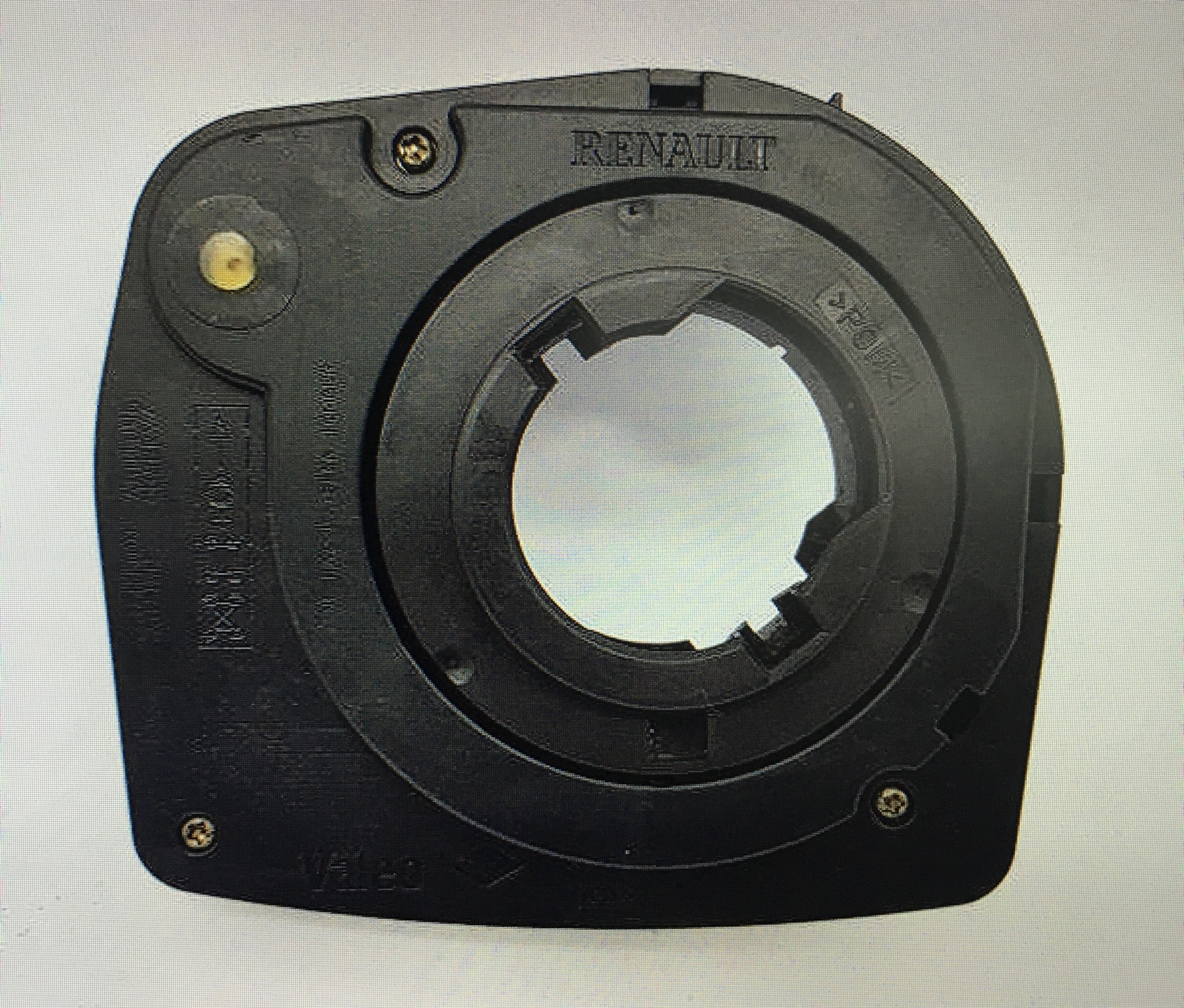

Cars now all back together but the only thing stopping me getting it finished now is the bloody steering angle sensor..
If anyone’s got one laying about please let me know.. I’m struggling to source one quickly!?
