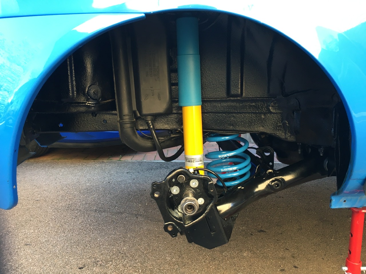

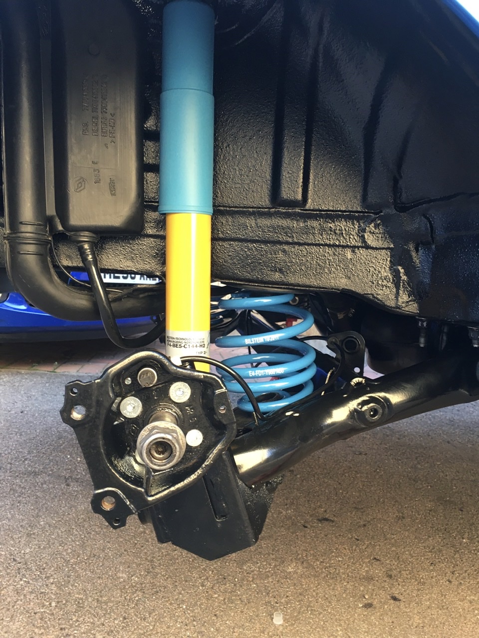

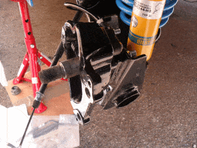

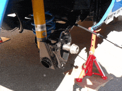

Got the rear axle back on the car today, together with the rear Bilstein Shocks and springs:
Thanks for reading 😎

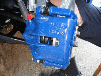

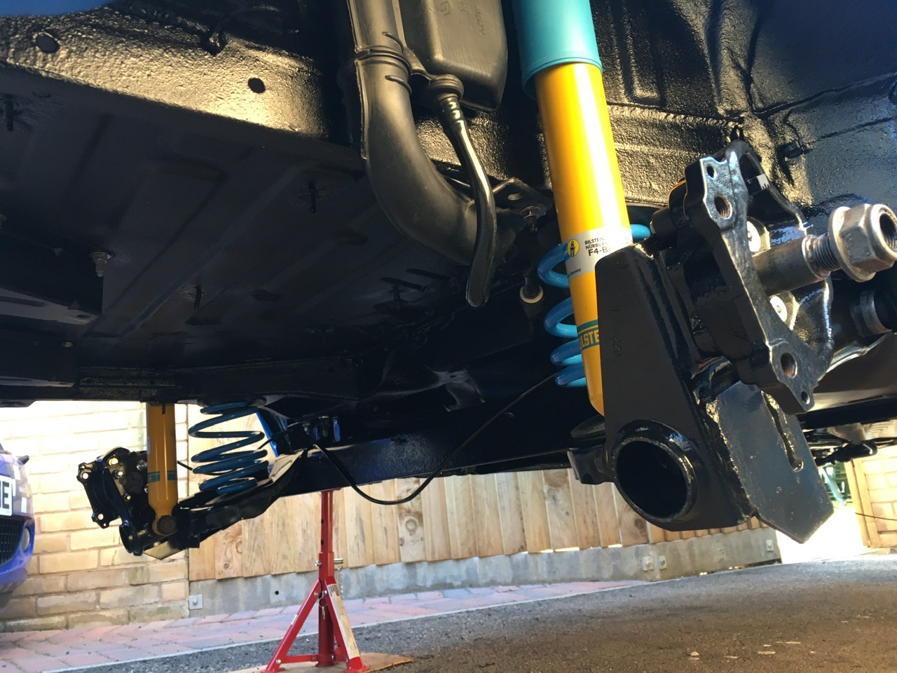

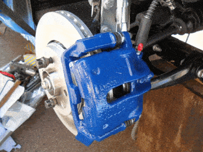

Now the rear Axle is in, It was time to get the brakes fitted. Rear Axle first:
Then finished off the front Axle, fitting the DS2500 brake pads:
Thanks for reading![]()
Did you paint the calipers? Car is going to be stunning.
@Big_Steve_T did you have any problems aligning the rear beam brackets? I've heard there is a fair amount of play in the bolt holes or did you take reference measurements prior to removal?
Was there much front to back movement?Hi @DomP182 ,

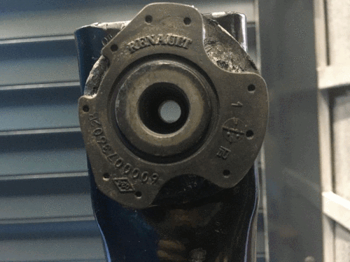

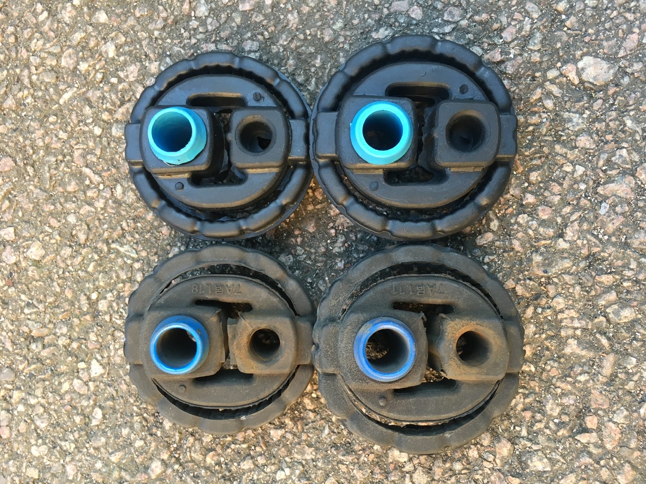

Interesting you ask that question, I measured the positions bushes in the rear beam accurately before I removed them, and gave the accurate dimensions to the garage who pressed the new bushes in for reference.
When it came to fitting the rear beam back onto the car, I did all of the nuts up until there was only 2/3mm of movement and found that I couldn’t move the beam left to right across the car, but found I could move it from front to back. So I just pushed the beam towards the FRONT of the car in the centre to equalise any tolerance that might be present (and hopefully stop the beam going on skewed...
At the end of the day it’s a mass produced super mini with a bigger engine, so I don’t think it’s worth getting too hung up on it, no doubt Claude didn’t when he put it on at the factory... 😆
Theres me worrying about aligning it all back up, I should be more concerned about the rust around the brackets.

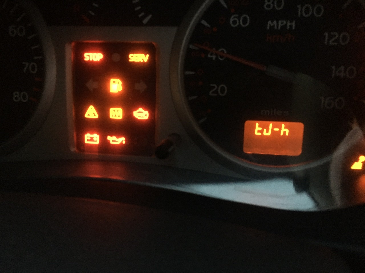

Looks like you’ve got a fueling issue.

I’ll be working thru the steps to try and understand the issue now in coming days..

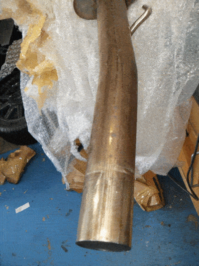

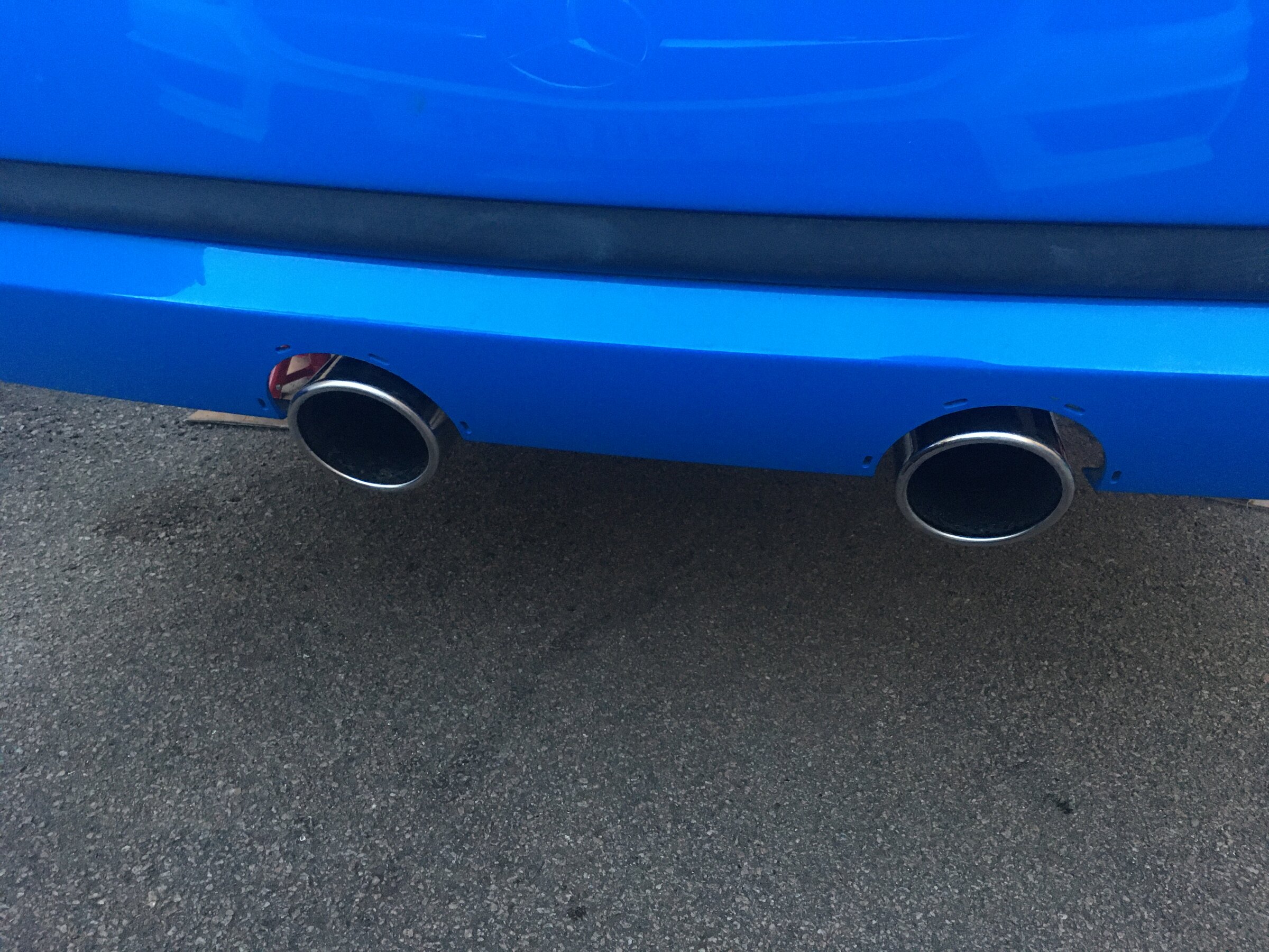

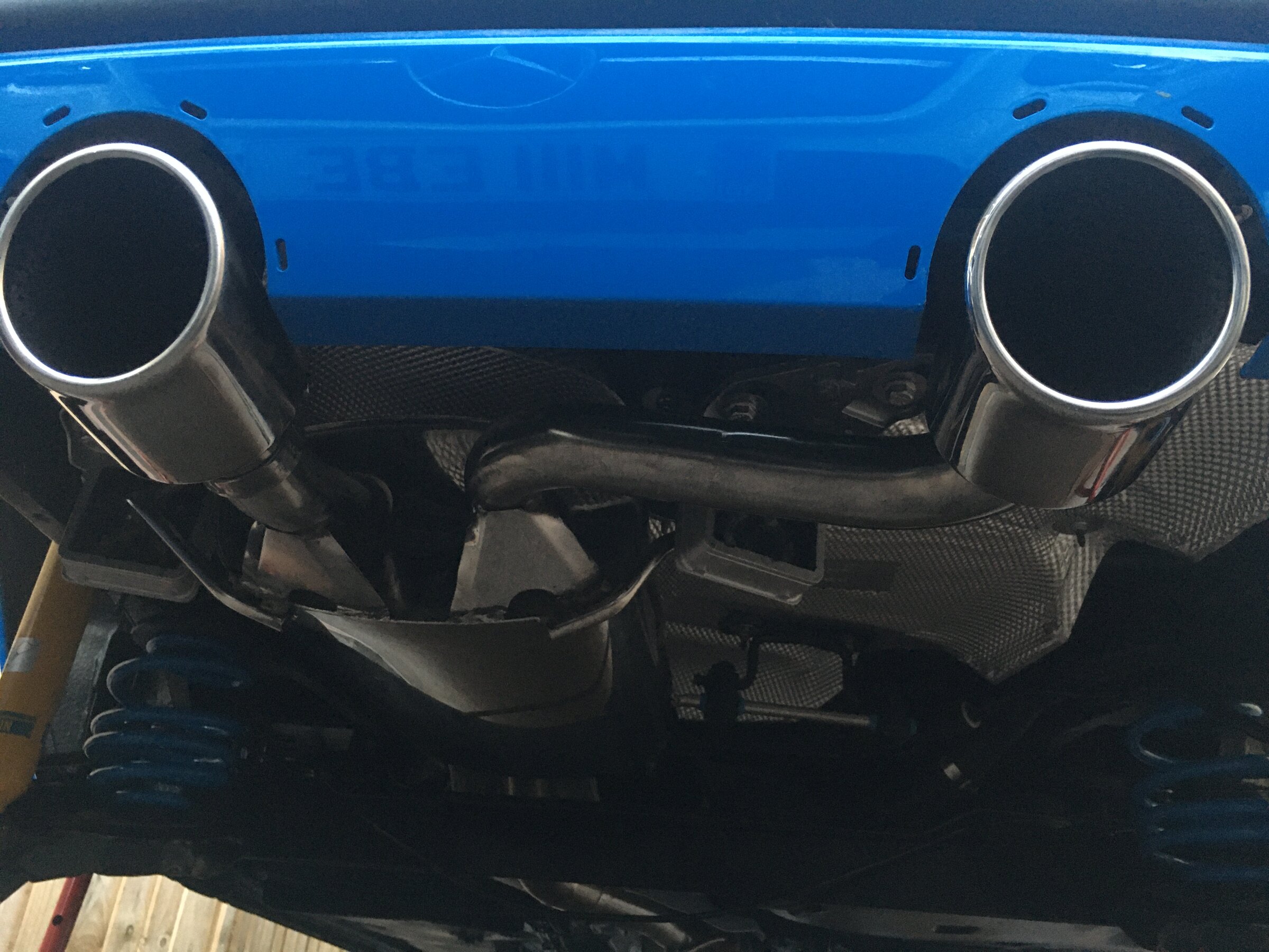

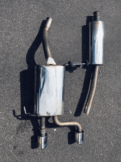

Janspeed @Big_Steve_T best fitting exhaust
Massive congratulations on hearing it fire up Steve. Huge achievement hearing that. Well done.
