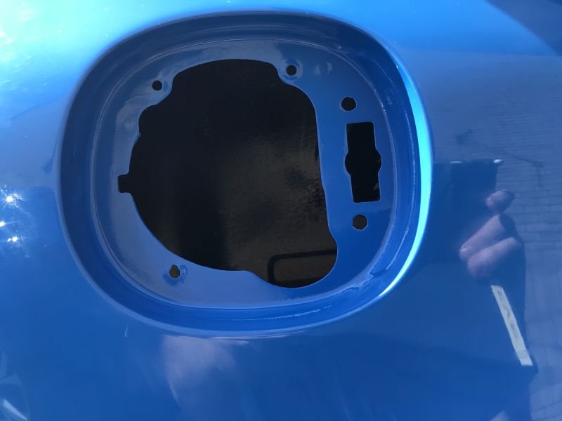

also got a couple of coats on the fuel neck area:
Thanks for reading 🙂

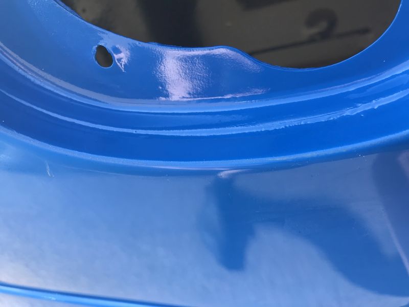

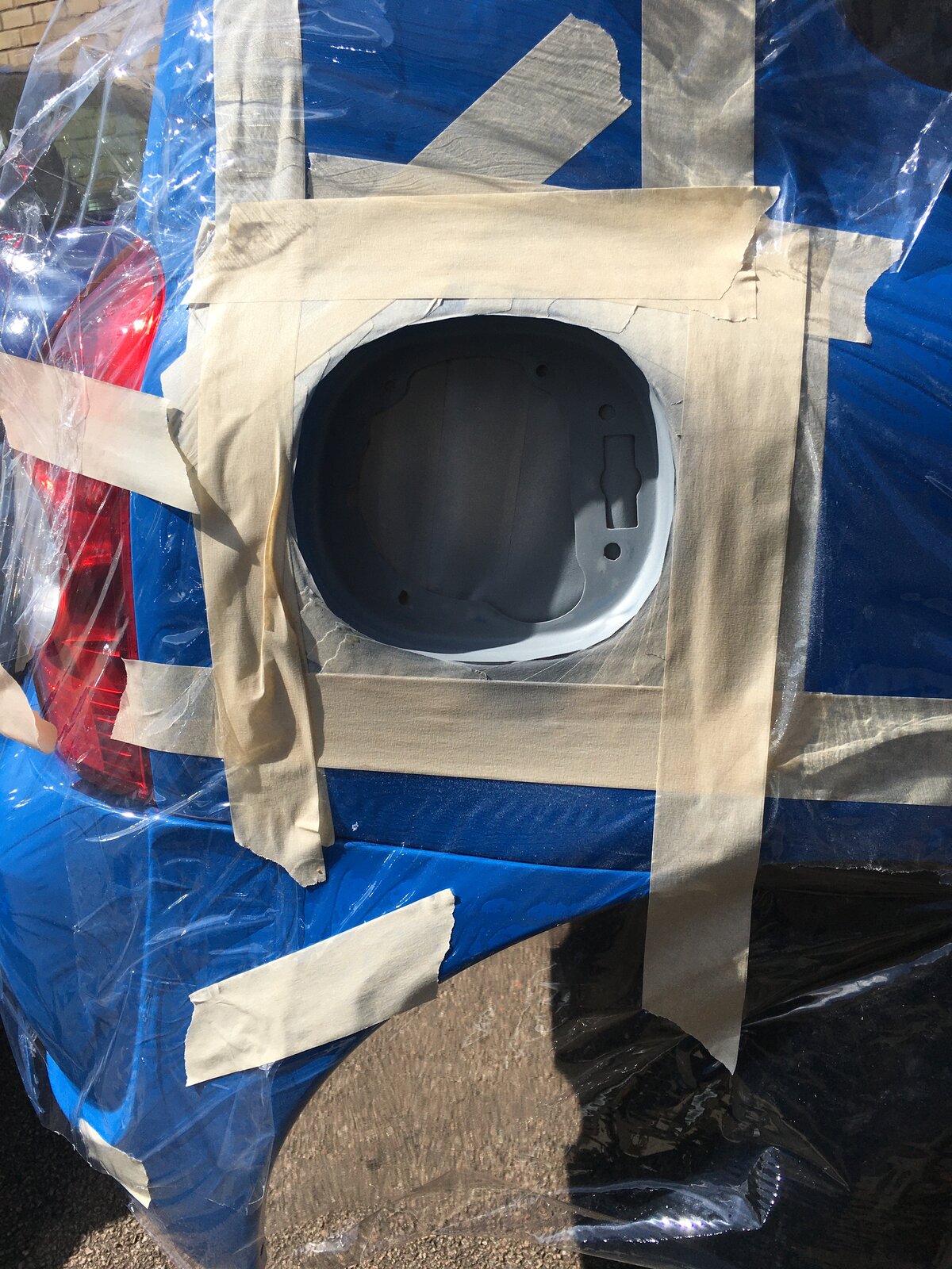

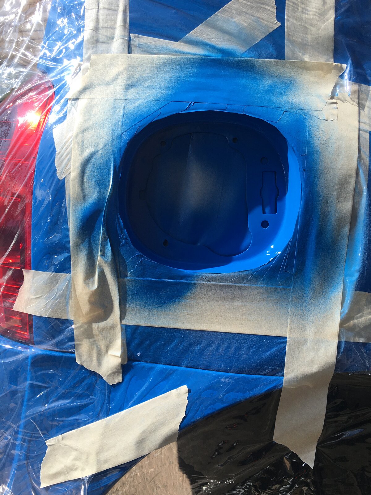

Whipped all the masking off today after letting it dry overnight... and chuffed with the results! :cool:
I tried an old trick I learnt when I was painting R/C Car body-shells back in the day of leaving the masking tape proud of the edge so as not to create a "HARD" line between what I've painted, and what I've not.. Turns out that worked a treat as well!
Overall a very happy camper, and I would say this job isn't too hard at all, but very much worth the effort!

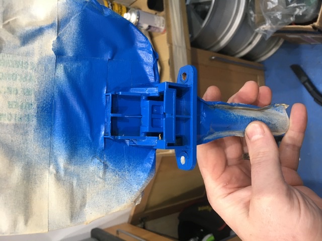

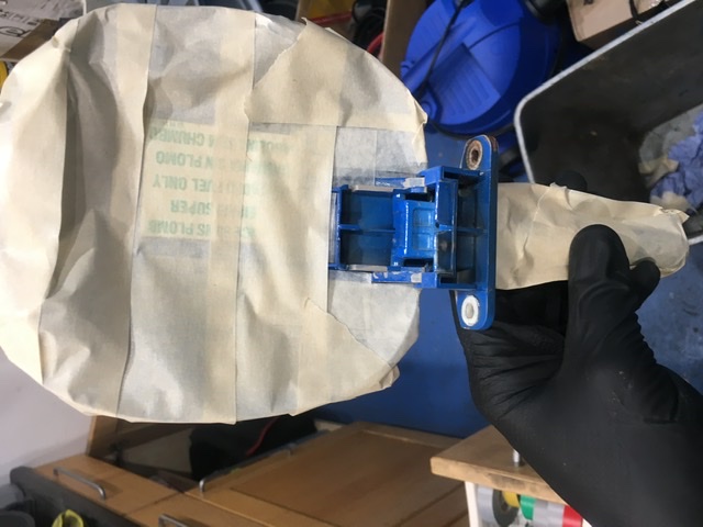

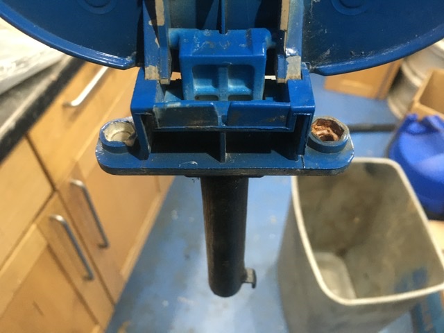

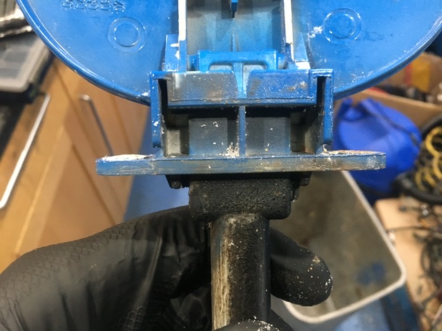

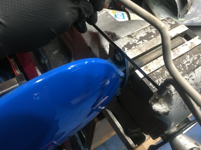

Now the fuel filler neck is cleaned up, the fuel flap is the part that looks gritty...

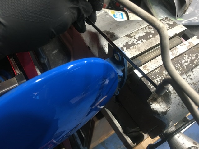

Knowing I will be using a pair of M6 Flanged stainless bolts to hold it back onto the car, I don’t need the previous moulded-in bolt head securing pockets, so I carefully cut the buggers off with a junior hacksaw:
They came off really cleanly with a new blade:
To dress it up, I masked out the hinge area:
and painted it:
Let’s see how that turns out...?
Thanks for reading :)

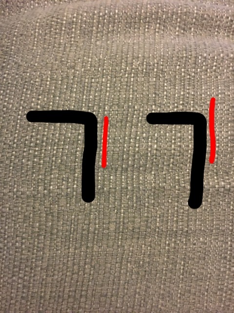

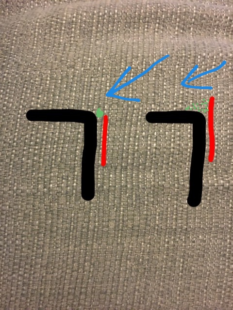

What is the trick if you don't mind sharing as I was wondering about that ;)
The best way I can describe it is with a crappy iPhone drawing below:
if the edge of the part you want to paint is the black part, and the right angle is the edge you are trying to mask. Typically you would mask the part to the edge with the masking tape (The red line).
However To feather the edge, if you put the masking tape on the part, but go past the edge you want to mask off, the paint will stick to that high edge of the masking tape, and not the edge of the part being painted, thus you feather the edge.
Ah I think I see what you mean looking at your action pictures with the tape as well.
To add to your awesome drawing, the spray direction is the blue arrow and because the tape does not end ON the paintwork you won't get the build up at the green dot (left picture) but it'll spread evenly like the small green dots (right picture).

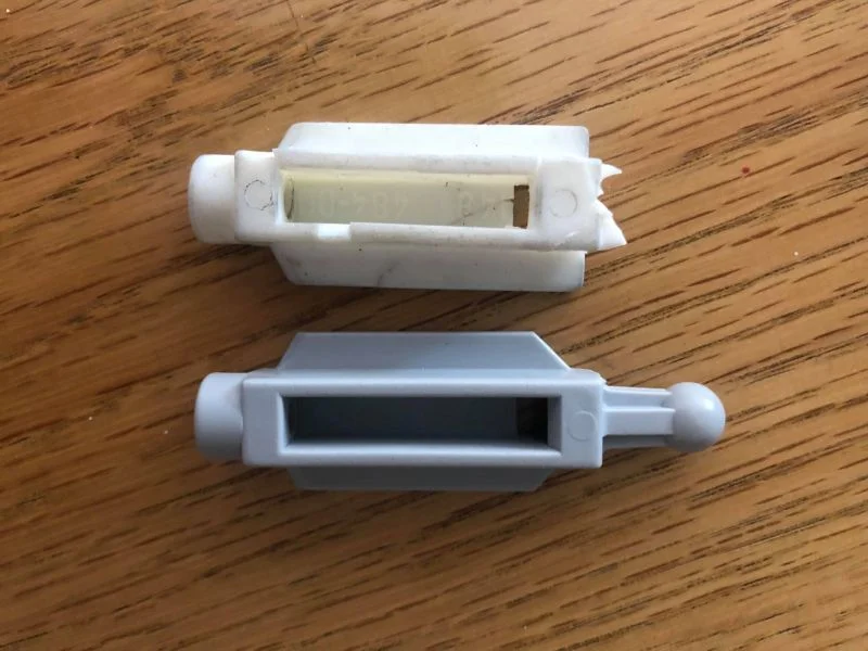

I got hold of a pair of OE Grey Insert Hella Headlights and I called on the support of my best man and detailing king Jez to see how good he can polish them up...

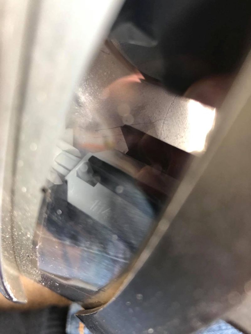

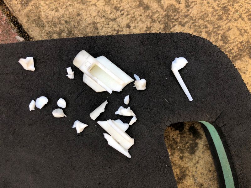

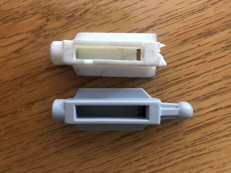

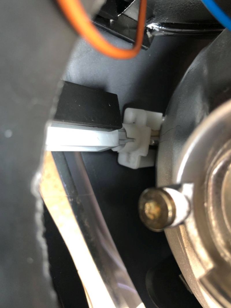

My mate Jez finished polishing up the Grey insert headlights, and saw that the adjusters in one of the headlights had broken:
Thankfully he managed to fish out all of the bits, and get hold of one of the BMW Adjusters:
New BMW adjusters all re-fitted to the headlights:
Headlights now ready to be fitted back to the front of the car when I get to that point.

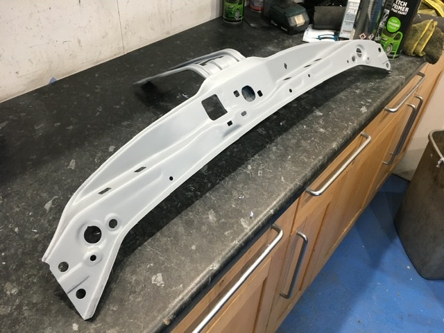

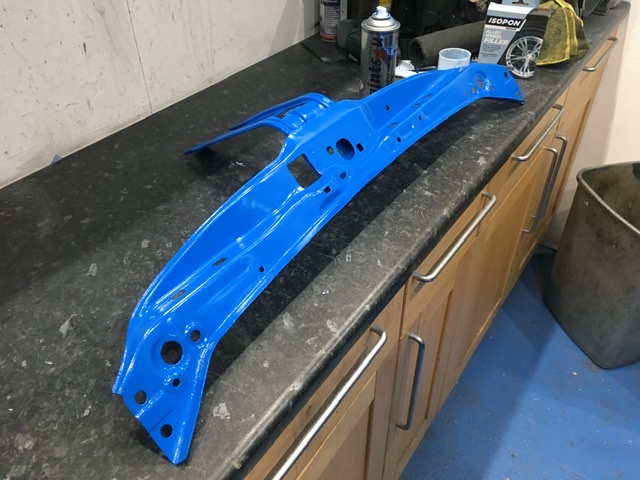

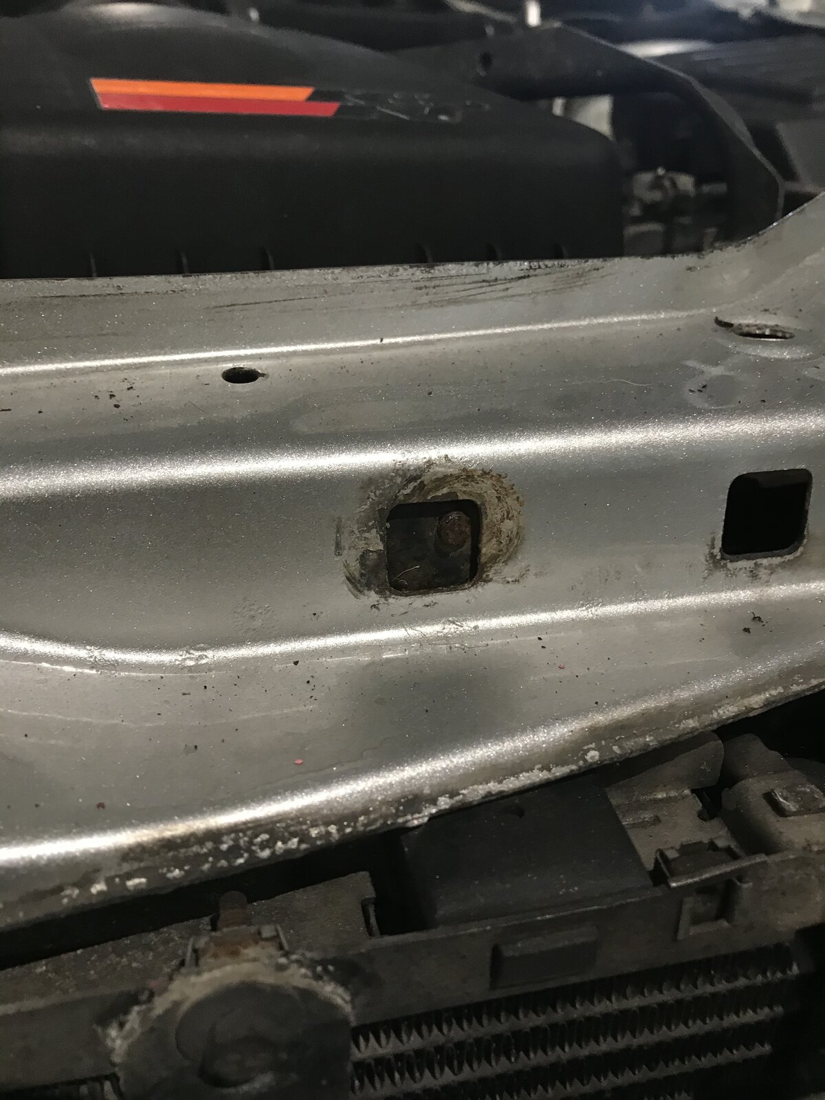

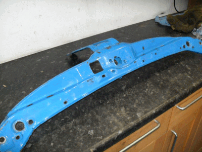

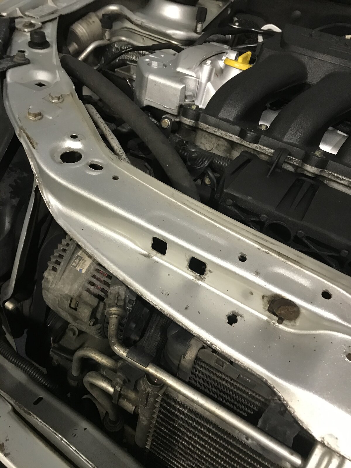

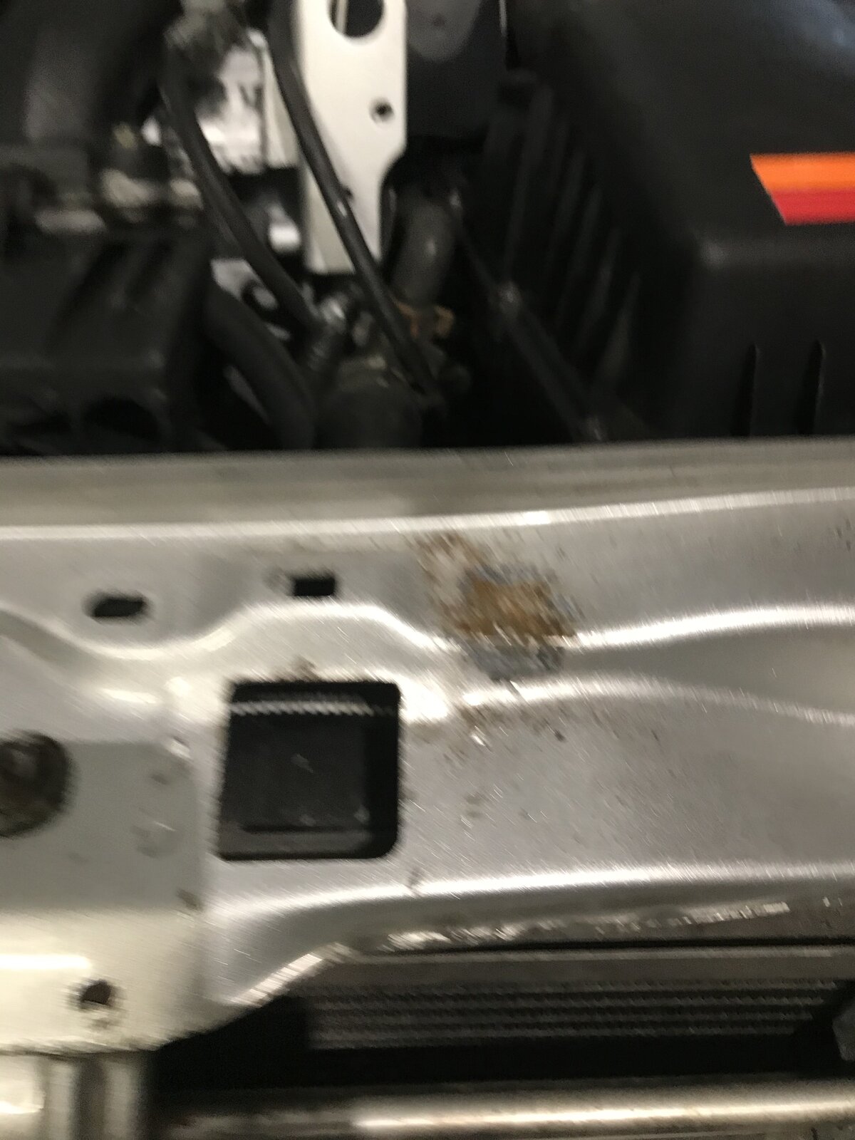

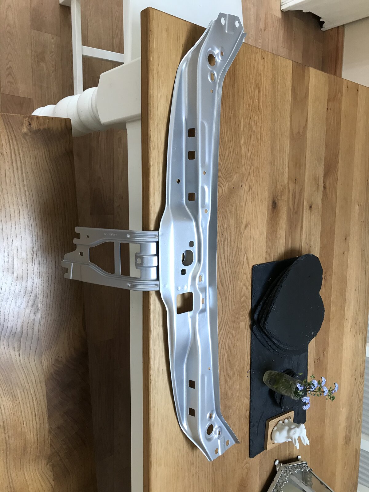

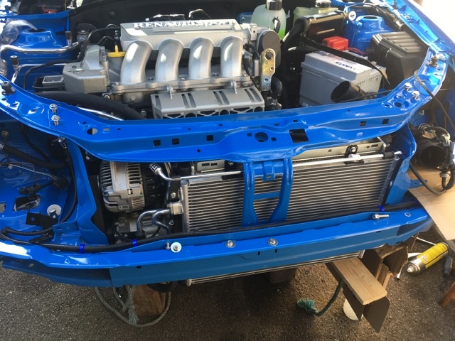

Been fighting with the front cross-member/radiator support for a few weeks now. Bloody thing was in shocking condition for a 2003 car! Looked like it had been at the bottom of the sea!! I've not showed pictures of the back of it, to hide it's embarrassment!
  • Stripped the paint off around the rusty areas
  • Then treated with Bilt Hamber
  • Then heavily sanded down to look presentable
  • Rust now converted with FE123 Rust Converter
Going to see if it will accept some paint this weekend...? 🤷‍♂️
Thanks for reading! :)

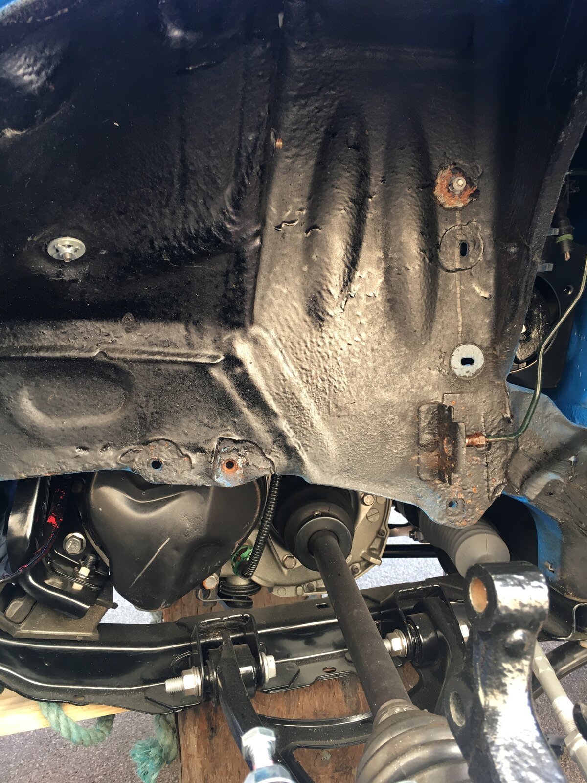

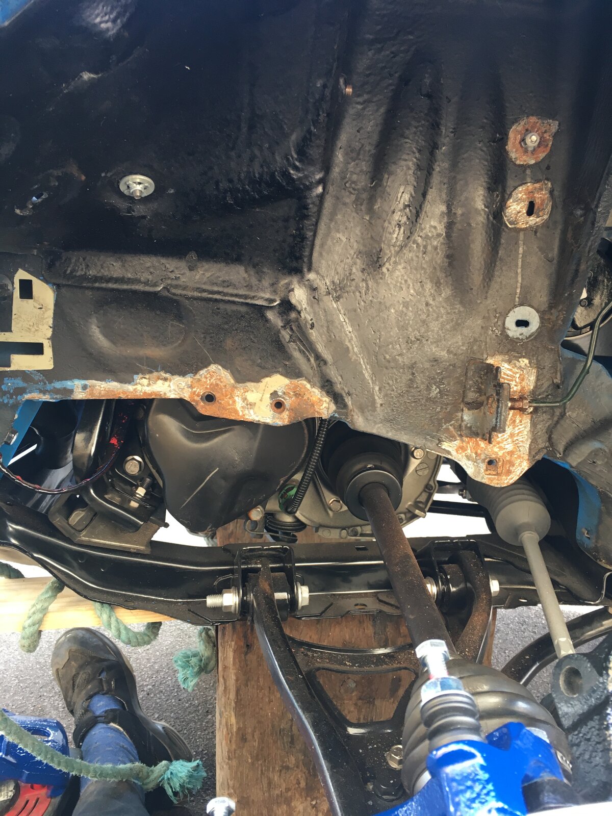

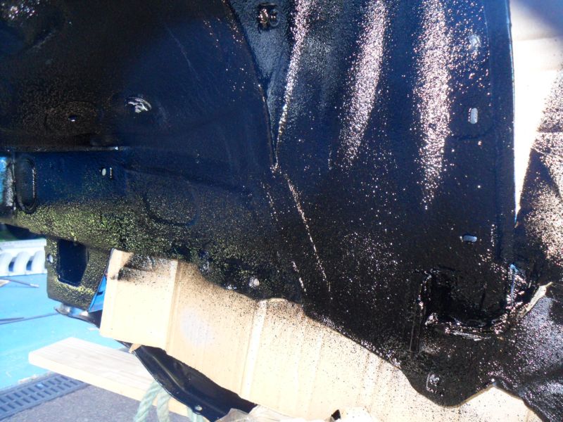

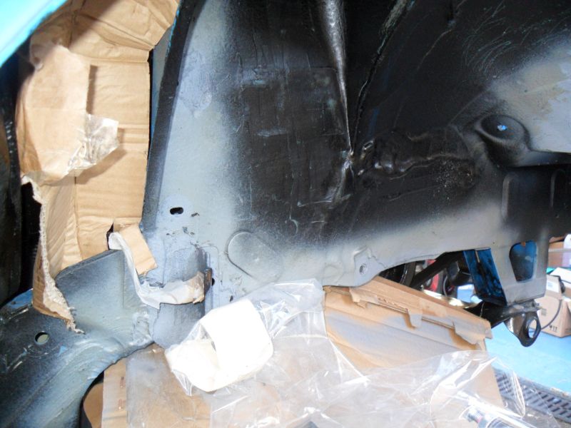

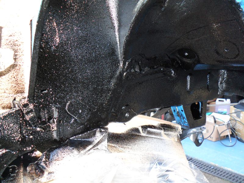

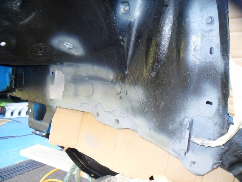

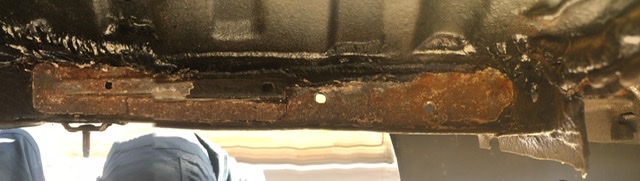

Finished off the under-sealing today... until I find the next bit of rust! 🤦‍♂️
Front Nearside Arch:
Front Offside arch:
And I also did the bits at the back of the car, but didn't take any pictures. 😲

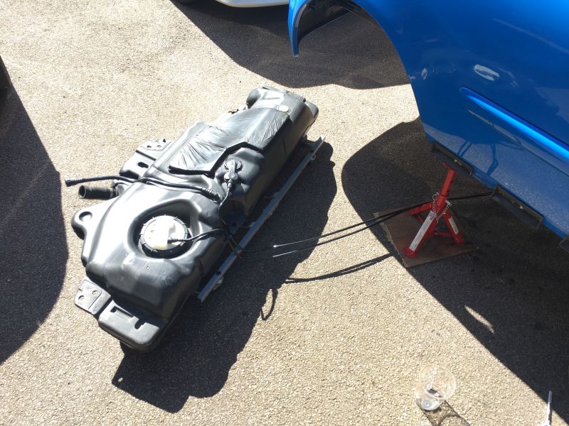

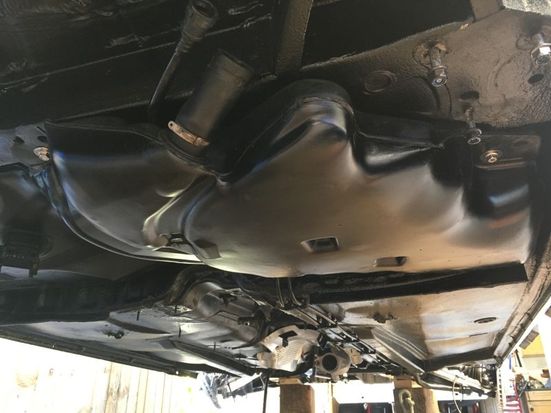

I then put the petrol tank back in, and installed the fuel feed and return lines:

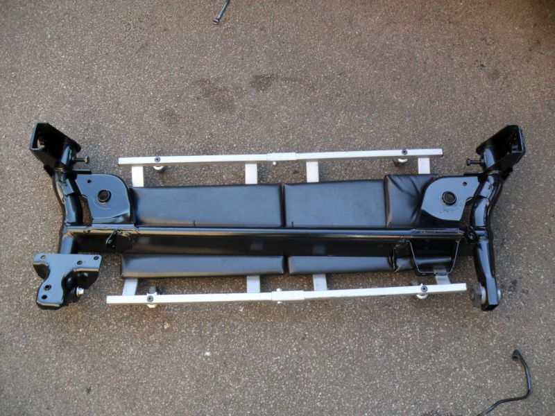

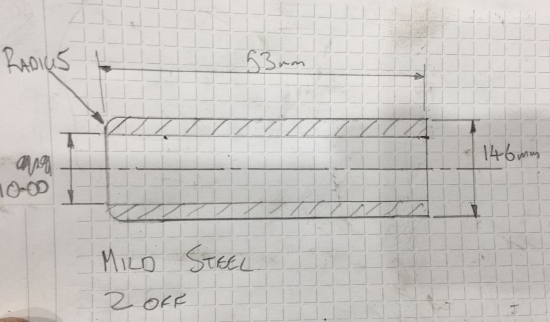

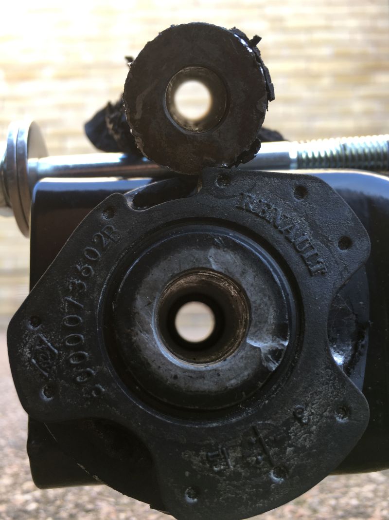

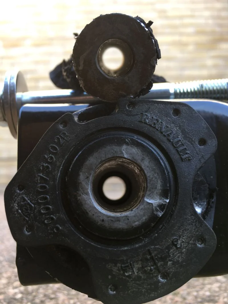

The PLAN was then to put the rear axle on.. I got it out and loaded it onto my dolly, ready to install and put the first mounting plate on... this is where it all went to :poop:!
I'd got the axle stripped and powder-coated and a pair of OE rear bushes installed. However when I inserted the mounting bolt... I noticed it was flapping around like a c*ck in a sock...:
I wondered what the hell had gone wrong... and had a closer look. Everything looked ok, so I then dug out the original bush that I'd stripped out of the axle for comparison...

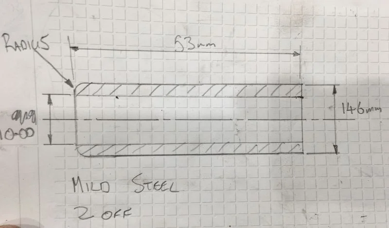

Sure enough, Renault have screwed me here somehow!!! The original bush is a 10mm clearance hole, all the way through the bush to accept the 10mm bolt. Whereas the new bush has a 10mm hole for a section only about 15mm long, and then opens up to circa 14mm!! WTF?! I'm not sure if the OE Renault bush is defective here... or my local dealership gave me the wrong part?? I checked the part number on the bush, and it looks OK so I'm a little in the dark!? Now I wish I just went for the Poly-Urethane bush like everyone else does... Problem is now the OE bushes are pressed in, and I can't very easily get them changed now due to the COVID-19 Lockdown... so I came up with another idea:
I quickly got the digital vernier caliper out, and measured what was missing... I then got hold of THIS CHAP on eBay and asked him if he could make me a couple of bushes in mild steel... Within 10 minutes we'd agreed a price, and he's going to make them for me tomorrow! Chuffed to bits that he was so quick in responding, and can help me out so quickly also... Lets hope my measurements are correct...?! Will let you know how that goes!

What a bloody nightmare that is!
Didn’t realise you removed the tank completely. Was there much rust underneath it? I have just finished prepping for rust treatment the back end of my car. (Awaiting a delivery) biggest hurdle I have is heat shields! The two that should be under my back box (?) are long gone! And the cat back heat shield is bloody awful!
Big_Steve_T
I like your axle stands!
Thanks, i usually use regular stands, but as I want the car higher in the air whilst I'm groping around underneath, I called the old blocks of wood into action. They're great!
Surprisingly no, behind the tank was fairly good. The worst areas where the fuel & brake line clip locations, and the rear "chassis rails" (not sure what to call them..)
