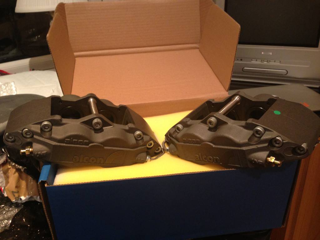

Can't bloody wait had another setback today though the bloody calipers are still leaking looks like I'm just going to have to buy a new set :dapprove:

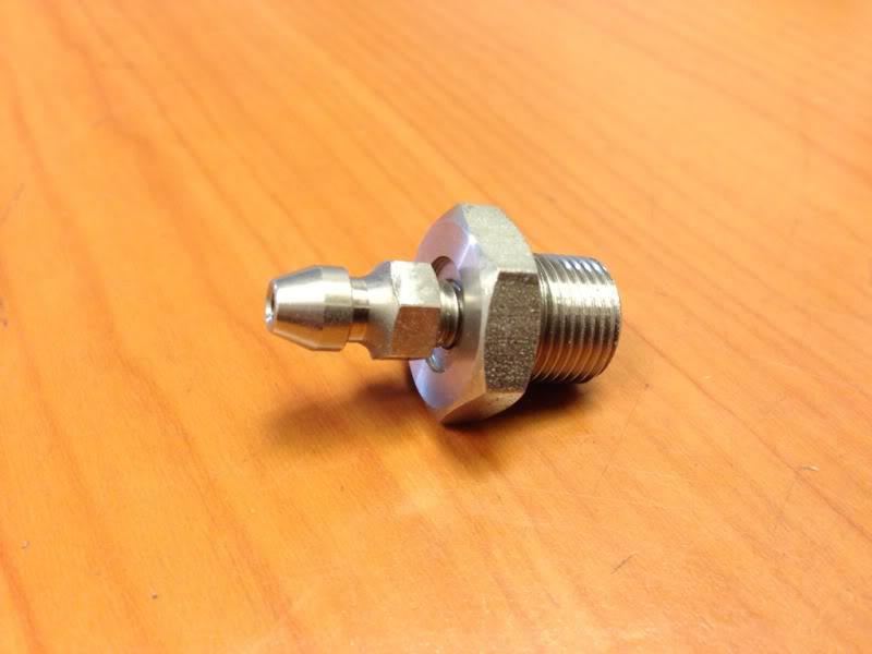

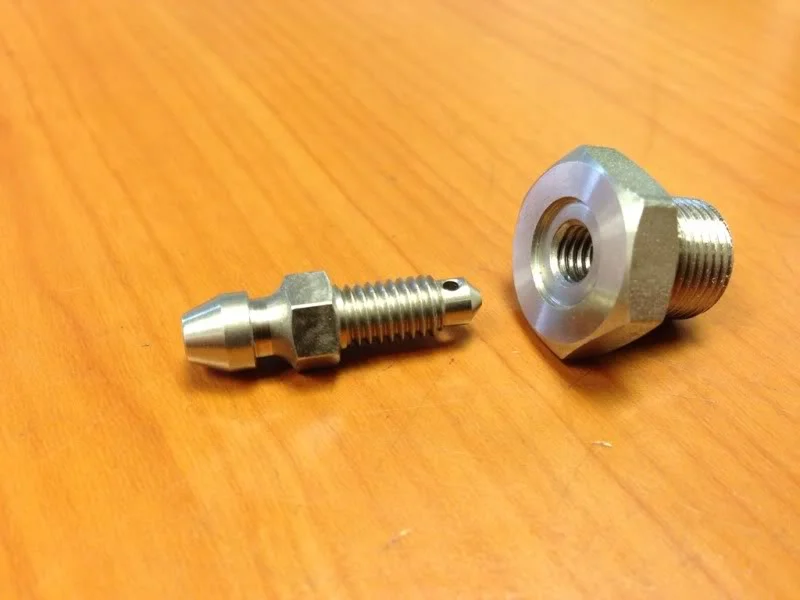

I haven't found anything anywhere near rated for the temp that the calipers get to A few other people I have asked have warned against it! I have already spent £140 with those fancy valves so don't want to keep pouring money at them just need them sorted. In the scheme of the build I'd rather pay and know i'm not going to have a brake failure lol!Unless there cracked James I wouldn't be buying any new ones, clean threads, ptfe paste in those valves you have and it will be fine.

New callipers ordered today.... that'll be me staying in and having beans on toast for a few weeks

I tightened down some standard ones to less torque than Alcon suggest and they dented into the seat again so I'm convinced its a dodgy casting as they were perfect when you sent them back to me.What did you put nipple wise in the calipers in the end , there is no reason I can think of that would cause them to leak , mine on the rally car will seep slightly when we get them very very hot on certain rallies , but a nip up on the bleed nipple when they are hot stops it.
Is it the adaptors you have fitted thats leaking , or the nipple itself ?

see if you can get a caliper with a larger pad area or go to an AP caliper (cheaper!)
Haha I'll save that until I fit a turbo......130mm centres is pretty common, you could even fit a 6pot AP to your existing brackets (with a little measuring)

I had a flyer come through the door for a bleed nipple repair kit. You fit an insert so the seat is completely fresh. sure I kept it.....

I'll put some pics up when we fit them in these Brembo calipers
