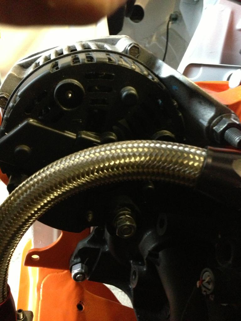

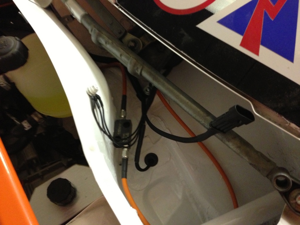

Can anyone help please? I need to know which pin on my alternator to wire my alternator warning light to? The dash says it wants to know 0v when its not charging so any of those metal studs okay?
Thanks

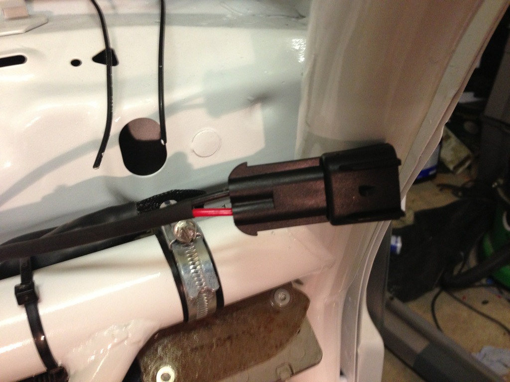

Yes Kenny it's the cup alternator, unfortunately the braided hose won't really shift so can't get access to the connector. Thanks for the offer mateIf it's a Cup alternator, it uses one of the two pins in the small rectangular (might be square) plug, which can just be seen behind that braided hose on the left of the picture.
I've got the plug cut out of my old loom so I know what pin to use but it's at the workshop, I'm at home, can check first thing in the morning if it's of any use?
The FF alternators just have the main output terminal 8mm stud, and a 5 or 6mm stud so they're easy to wire up.
On a 2 wire alternator, like the Cups have, the charge light needs to be a lamp, not an LED, if your using an LED you'll need to put a resistor in parrallel with it so there is sufficient current flow for the exciter circuit. I've used a 10w 33ohm aluminium clad type, which will result in about 4-5watts at 12v, most warning lights arent anymore than 5w
Yes its probably 1mm away and -10 so is pretty rigidNot quite sure how it manages to charge without the warning light connected up, I guess once it's spinning fast enough it must manage to get it's self going.
Is that hose really that close to the alternator you couldnt get a wee plug in there? I'll be at the workshop soon, will dig it out anyway and let you know.
That explains why it worked last year then without thanks Dan.these alternators don't need an exciter like earlier ones (williams etc). The charge light output it literally that, just an output to turn a light off.
If you look at a standard loom, one of the wires on the plug is blanked.
Yes its probably 1mm away and -10 so is pretty rigidThanks Kenny!
Do you know if the 3 metal studs see 12v when alt is running or earths?

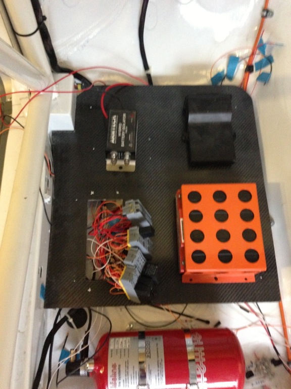

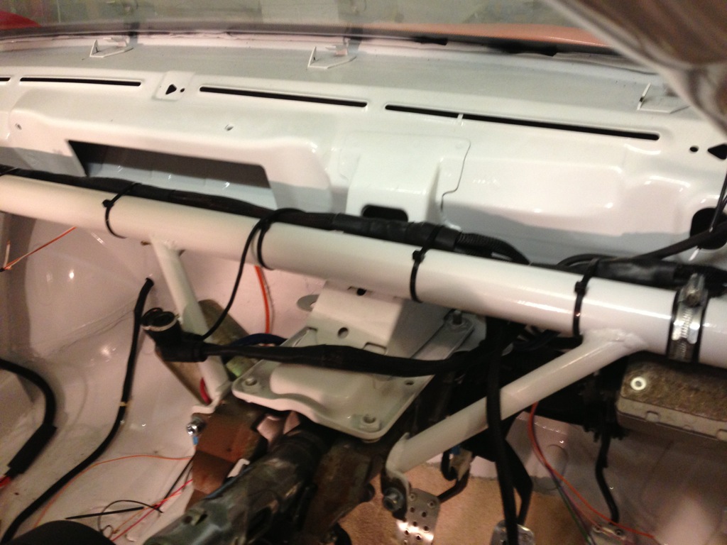

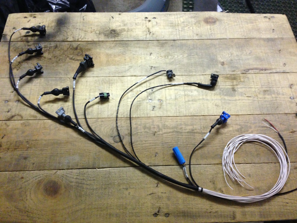

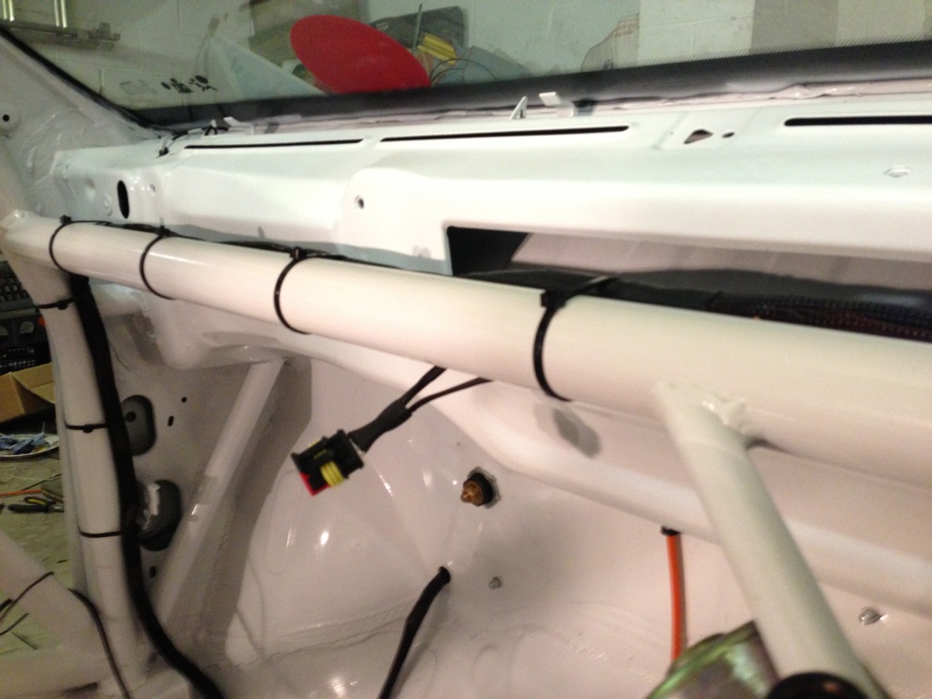

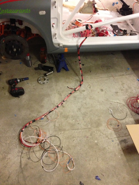

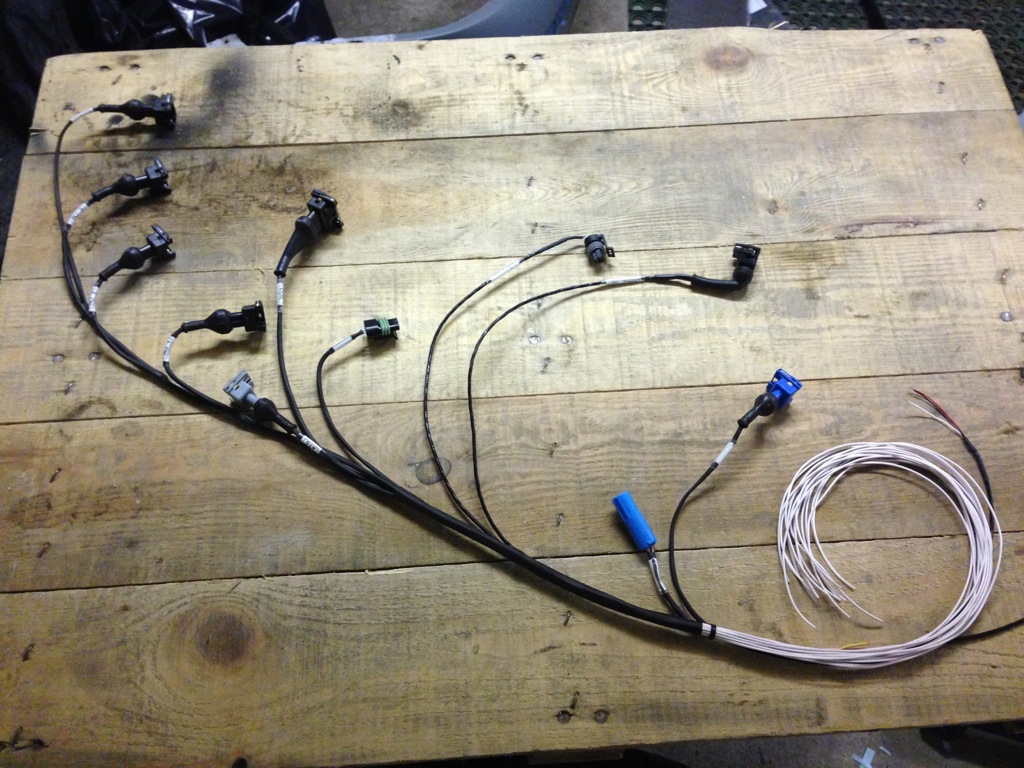

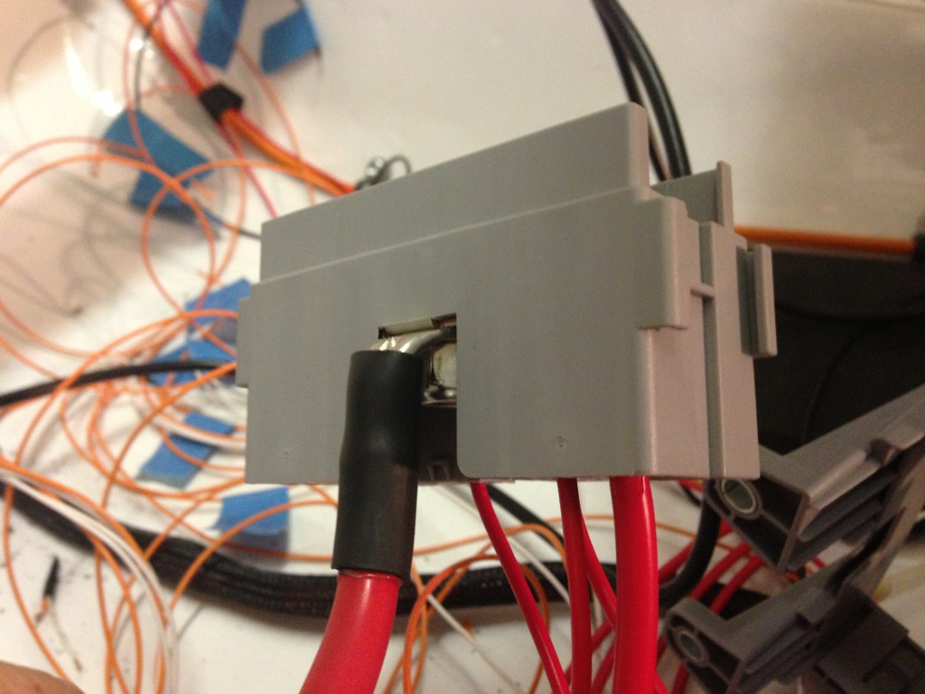

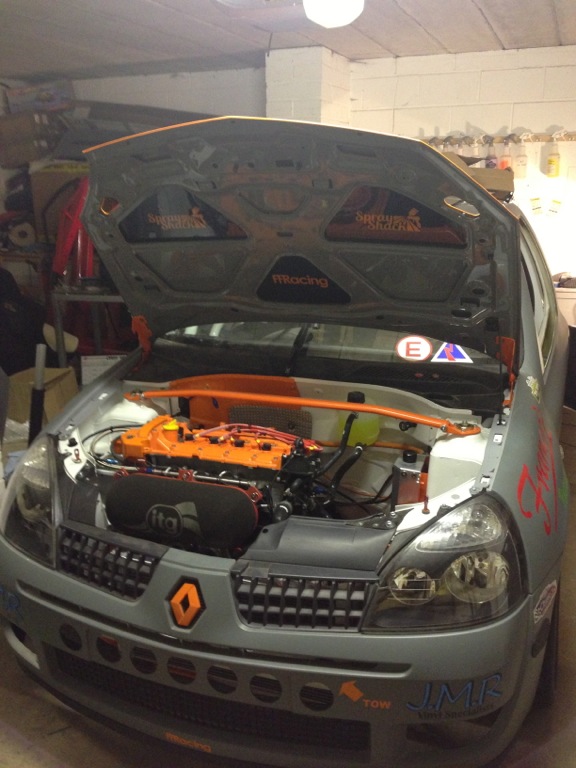

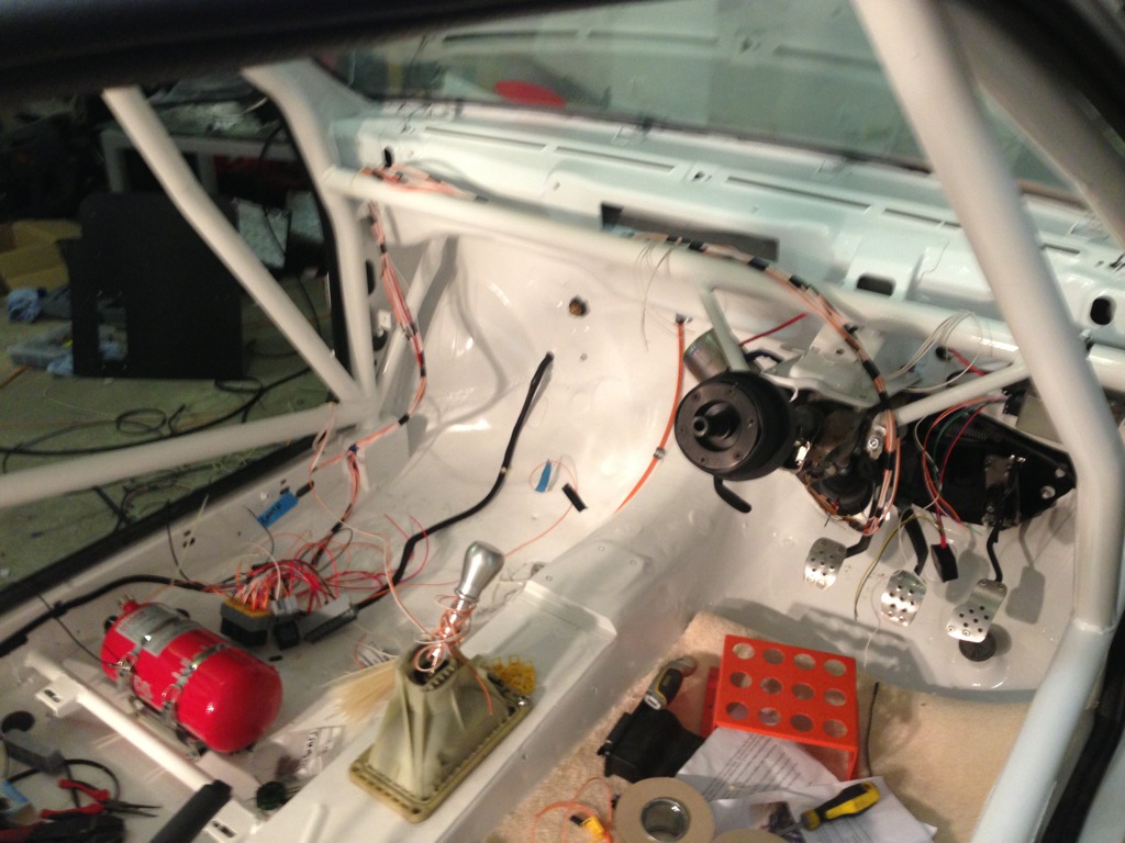

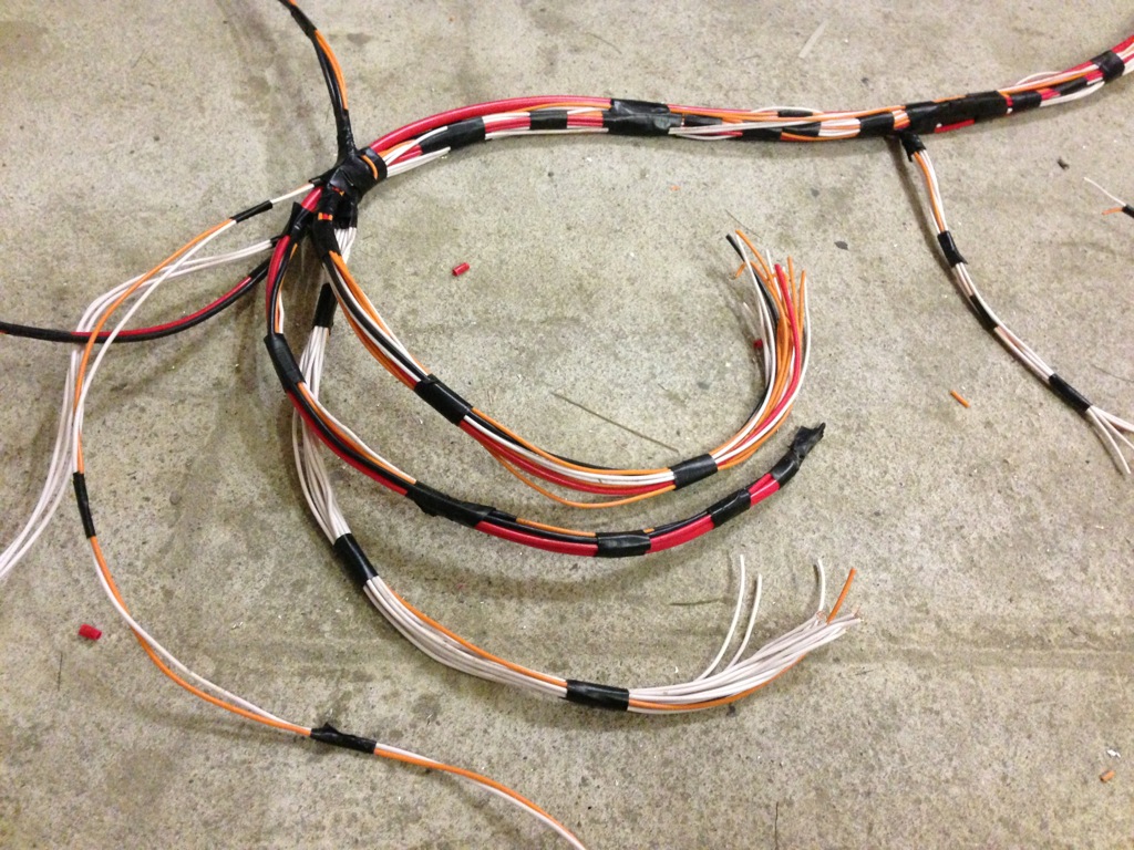

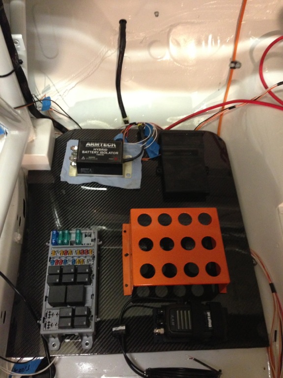

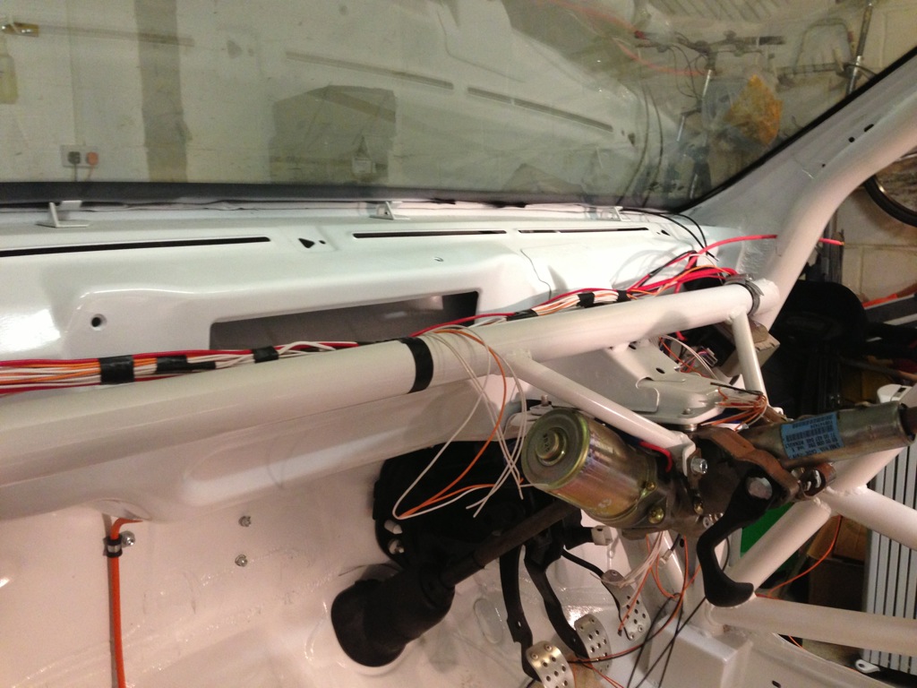

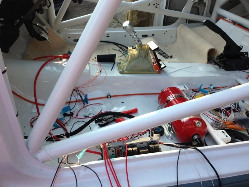

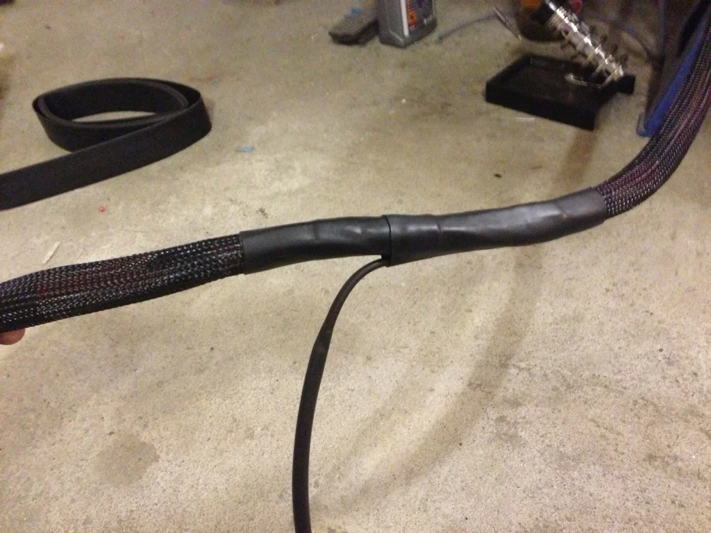

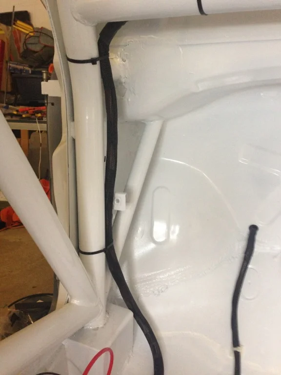

Engine loom finished other than it needs the bulkhead connector putting on the end

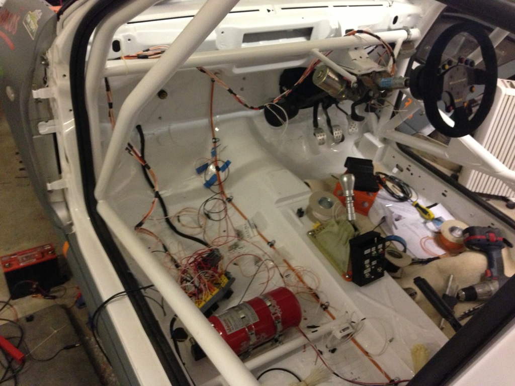

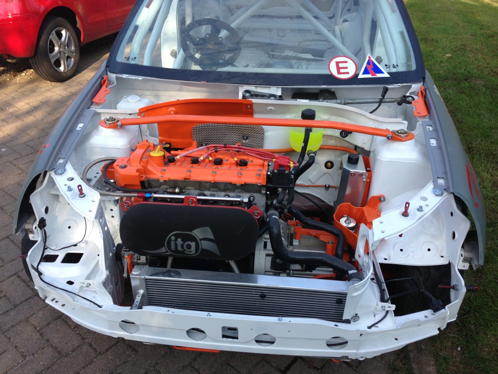

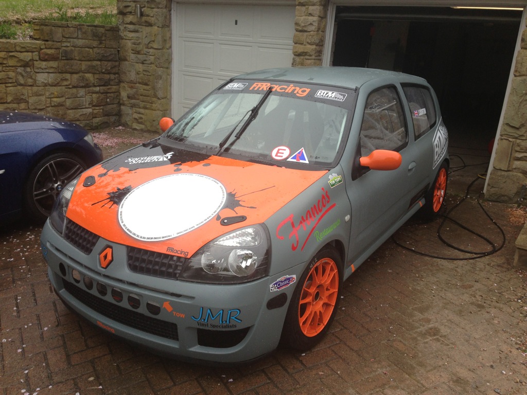

Car is pretty much finished now, few odd's and ends to finish tomorrow and then next week when I have a few more days off I will take it down to Freds, connectors on and mapped and then good to go!
Thanks DanLooks very tidy James!

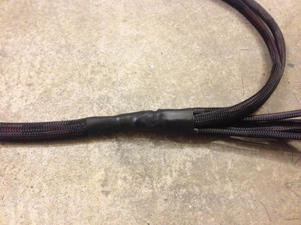

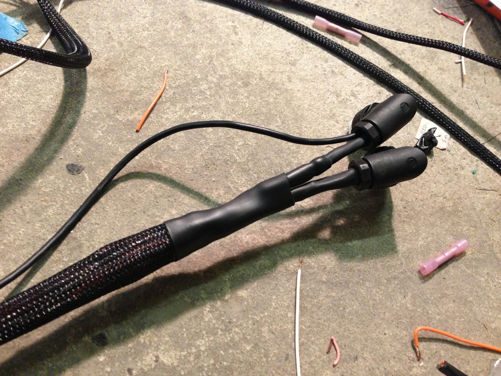

Thanks Kenny! I didn't use Raychem in the end looked at it fairly extensively but just chose thinwall pvc wire in the end, for what i'm doing it should be fine (I hopeLooking good, what type of wire have you used, Raychem 44 or 55 ?
TDF did my original engine loom in DR25 and it just seem to remain a little more flexible and also shrinks down in a uniform shape. The motorsport electronics guy who's doing the connectors for me uses tyco for all his stuff so i'm sure you'll be fineWhy do you wish you'd used different heatshrink?
DR25 is the mainstay of Motorsport looms but its very expensive and probably overkill for most applications.
I've been using a tyco heatshrink (not sure who owns who but they're linked with Raychem anyway) can't recall the part number off hand but its pretty reasonably priced and it's good quality. I tested some of in a tub of petrol, left it for 2 days and its still ok so I'm sure it'll cope fine with the odd splash of fuel, oil etc.

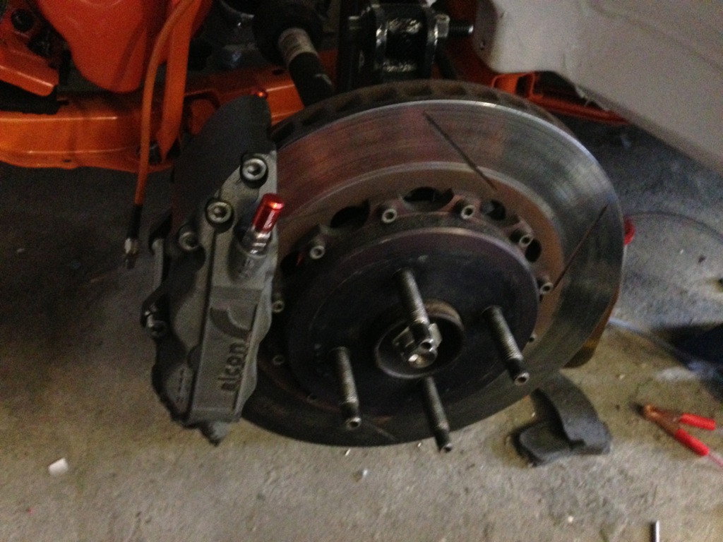

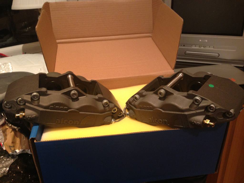

Just got home and greeted by my new calipers thanks to Jetstream Motorsport (the people who make the Alcon kit for the clios) for the speedy delivery![]()

Could be although the old engine loom was just laid in the same way I have done this one but I suppose the Raychem wire TDF used could of also added to the flexibility. Will be good to see what you doThe difference in flexibility could also be down to how the loom is built, ideally all the cores want to be laid in concentricly twisted layers, each one in the opposite direction from the previous. If your a professional loom builder then this will be second nature but for your average Joe, quite tricky and time consuming.
I've done small sections like this before but I dont think I'll attempt it for all the looms i've got to do for this car.
I have another plan which should result in a flexible loom, be fluid proof and be easier to assemble.
I'll wait and see what it turns out like before I disclose anymore![]()

Thanks hopefully they are as good as the ones I had last year as they were very good!these look epic
