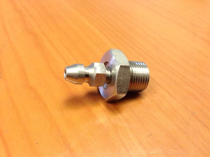

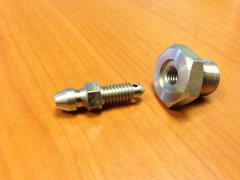

We have been sent some Impreza Brembo calipers to refurb and someone has had a go at drilling a bleed nipple out and totally fcuked it up drilling it off centre and destroying the seat , so he picked up one of these off ebay , we will be fiitting the insert into the caliper by machining a 12 mm thread , will seal it with a copper washer , the bleed nipple is stainless as well.
If it fixes this caliper it will fix yours as well.

Are those the "nipple therapy" ones, they look quite good if you have enough space to take the thread out that far.

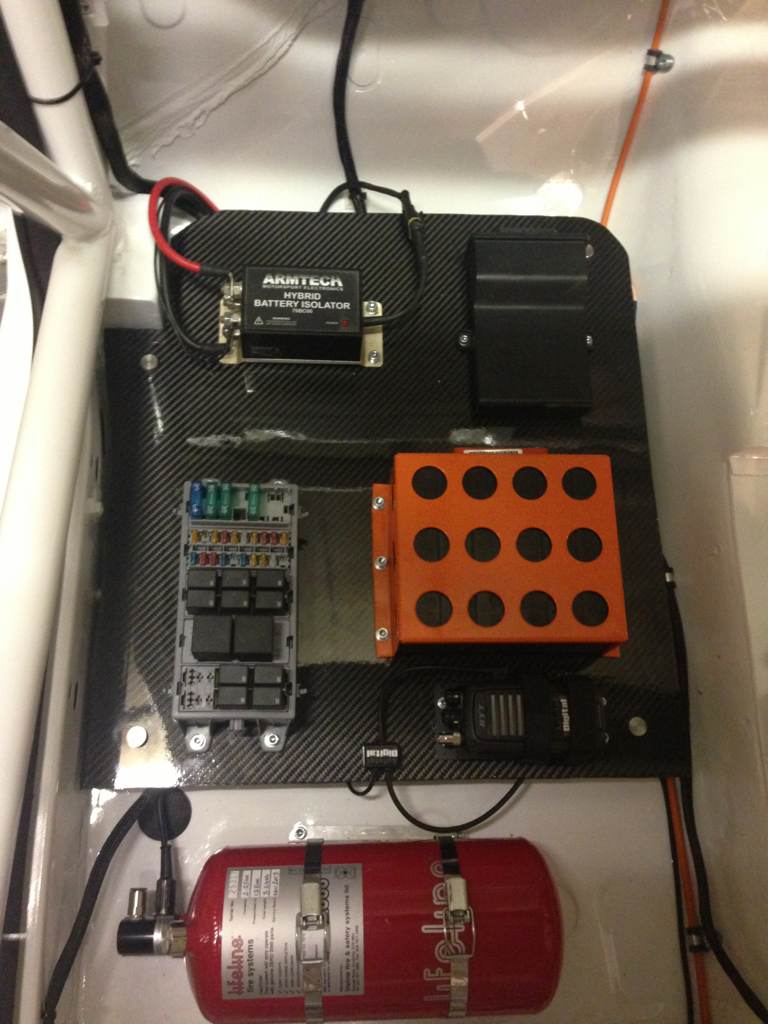

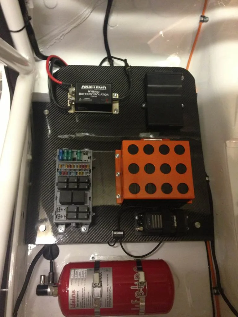

I did think about cutting out the passenger seat rails but I decided to leave them in so that I can still take passenger out. It won't be ideal as there feet will be level with the bottom of the seat. When I have the passenger seat in I have a second false floor that fits onto of the standoff's for the bottom on so the electronics are kept out of harms reach :)

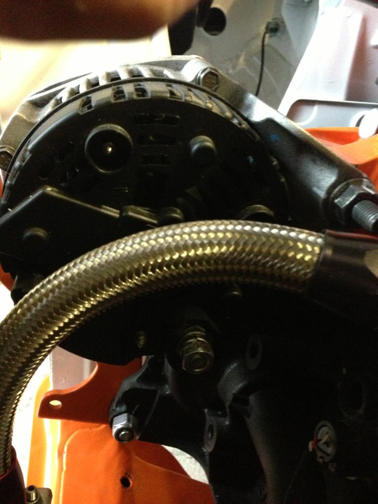

Can anyone help please? I need to know which pin on my alternator to wire my alternator warning light to? The dash says it wants to know 0v when its not charging so any of those metal studs okay?
Thanks
