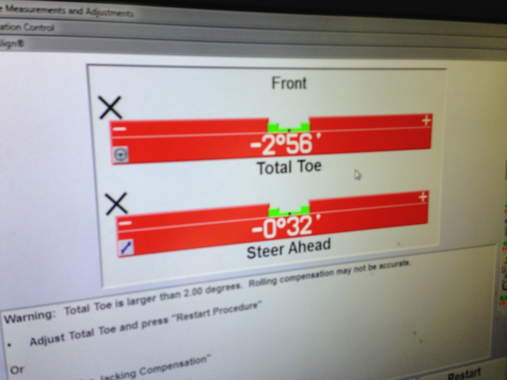

My eye's obviously aren't very good tracking gauges! I got the camber near enough even both sides but the toe was a little out ;) All sorted now though with quite a different setup to normal to try and overcome some of the tyre issues i've been having so see how that goes. Need more caster!

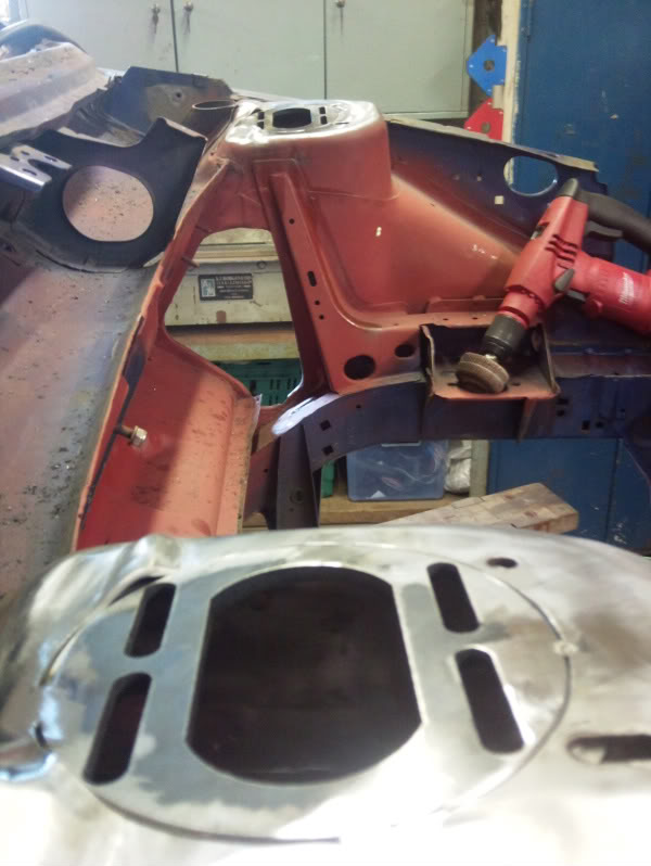

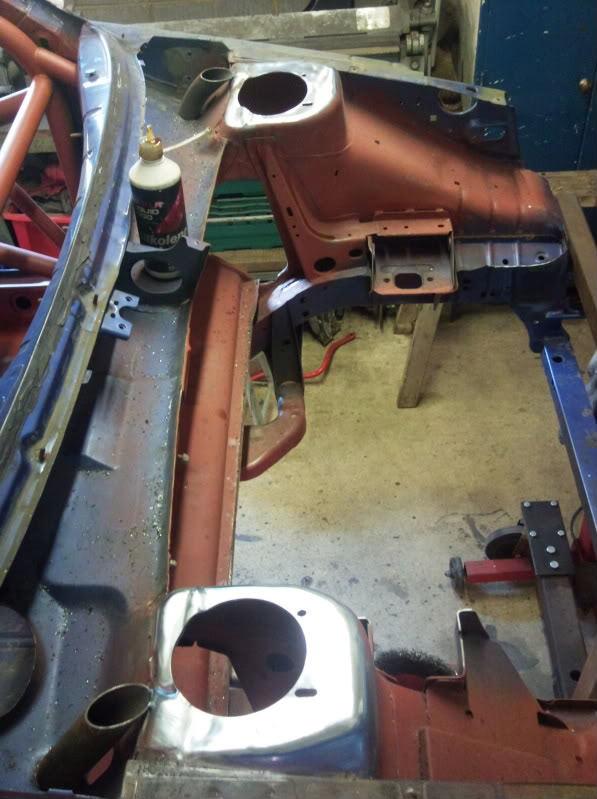

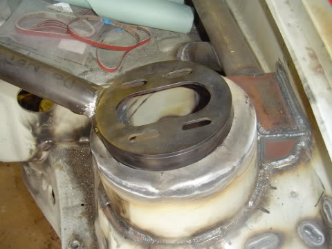

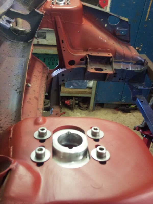

Could you not have built more caster into the adaptors on the wishbone, or are you out of room to move forward at the bottom so need to go back at the top?
As Ed says. But looking at tin top rules it's VERY vague anyway
It says you have to keep the original pick up points, but you can fit adjustable parts.
If the existing top mount holes where kept then you could say that's the original pick up points. Then oval the hole out and fit an adjustable mount to allow more caster. Arguably would be fine
  Cup In bits
Clio turrets are smaller Phil, you essentially need to do what Kenny has and rebuild them all together or your ride height will be about 2" higher.
  182/RS2/ Turbo/Mk1
Yeah the lack of space in the turret isnt good, although top of a coilover is smaller than of a normal shock so there must be "some" room for movement?

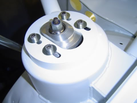

Yes Stu that is similar to what I had planned to do to it last winter but never got round to it. Pure Motorsport are making a kit as we speak to weld on which will give adjustable topmounts and also some other nice trick features :)
We've got all the laser/waterjet cutting done on your prototype kit James so hopefully won't be too long before its' all ready.
