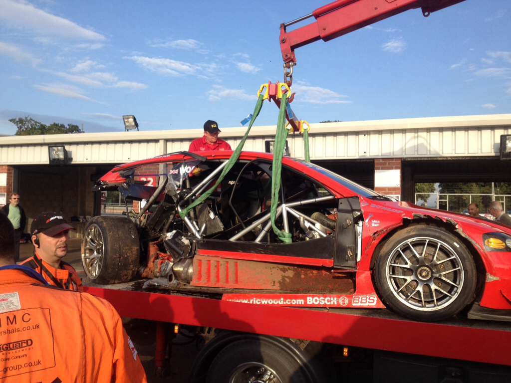

Unfortunately for James he did not intend to do this and was a mishap due to a cracked gearbox casing resulting in the tyres being covered in oil and lose of gearing therefore couldn't slow down in time due to lose of engine breaking and locking up into the corner.
I'm sure James will explain in more detail. Just a shame that it looks like the diff hasn't been installed correctly this causing all his problems.
Unlucky mate was nice speaking to you again and I hope to see you racing again.
Wasn't the only car that took a beating poor poor astra car was epic too!
  182cup & 172 racecar
Oh really, were you in the car?

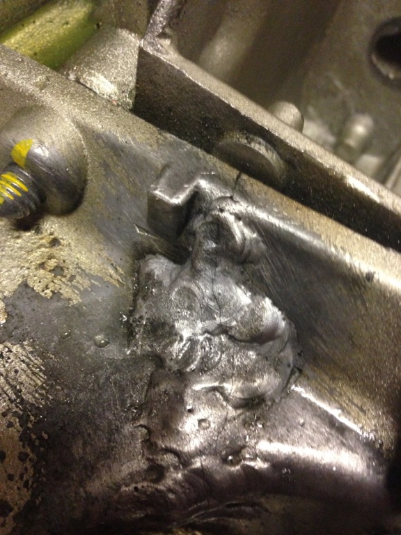

I managed to limp it to the end of the race with a pretty horrific handling car but anyway. The headlight was just dangling from the loom smashed to bits so that got launched straight in the bin! The front chassis leg looks to of been pushed over to the eye and also there are cracks on the seam sealer to suggest its moved, the wheel it fooked, something is bent on the steering, subframe is kinked, bonnet mount points have moved and the end part of the chassis is pushed in. It will all straighten up just need to get it on a jig shouldn't take long. Just need to get a couple of new panels. The cause of the gearbox issue was then found to be the gearbox casing has cracked again and it has really gone badly this time. The gear oil was all over the engine bay, NSF wheel and tyre and also under the car on the rear beam and the exhaust. Looking at the rear facing camera the lockup started off just with the NSF so i'm presuming where the oil was on the tyre hasn't helped along with the lack of engine braking.

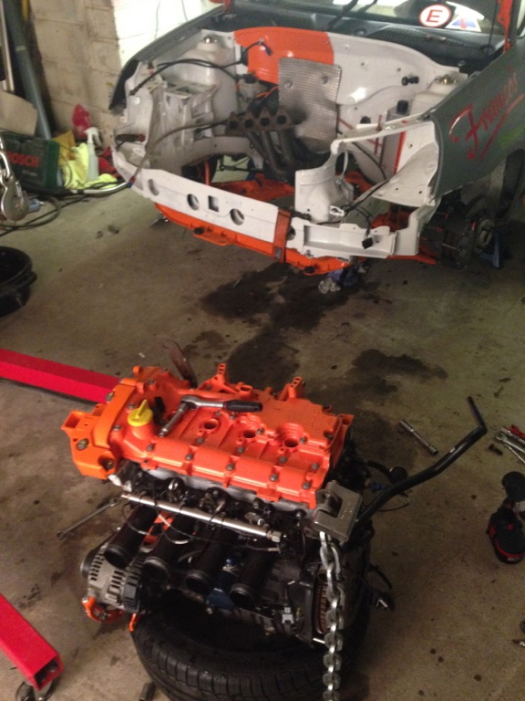

After seeing the damage I was pretty resigned to the fact of not doing Donington but while driving home was having a bit of a change of heart and Chip and Lesley then offered to come over tonight and help me get the engine and box back out. So that is what we did :) Started off with a compression test as I did feel a sudden dip in power in the afternoon of testing yesterday and sure enough I was about 10psi down of cylinder 2 than before the weekend. I also said to chip it had blown the dipstick out and straight away he said pistons/ring damage :( Engine and box out and then Chip did a leak down test on the engine and cylinder 3 is really pushing through the pistons/rings so not only does it need alot of other bits but now either needs a new engine or a refresh of this one. Pretty certain i'm not going to be able to afford to get it ready for Donington so I guess thats it for the year. Fairly disappointing really with the potential the car has I think but thats life and thats racing.

Sorry about bringing bad news with me as well as a helping hand mate. Me and Lesley were hoping by coming over it would help your chances of making your next race, but having to turn round and tell you that you've got a ring seal issue has no doubt done the opposite.
Let us know if there is anything else we can do to help although personally given the cost of each race meeting I must confess if in your position I would just decide it wasn't worth a quick fix to try and get back out. But if you do want to re ring the motor I don't mind coming ove and building it back up with you, or you could bring it here as I've got better facilities for it.

Jc5 089 (you can use the casing on yours, as this is the one the diff circlip popped out of)
