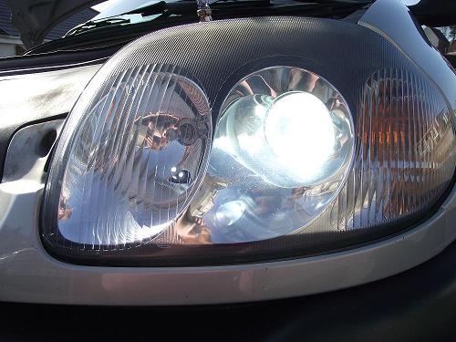

would like projectors. dont like the angle eyes on the ph1 tho. but i dont mind it still lights up the road well :D
HIDs in a reflector housing will burn everyone else's eyes out. HIDs should ONLY be fitted in a projector housing.
You don't have to get the angel eyes, I agree, they look crap.
Get Renaultsport Dual Optic headlights, £50-60 for a misty pair (easy enough to fix) or £70+ for a decent pair.
My old ones in the pic had the upper reflector section painted, have a plain silver pair now.
