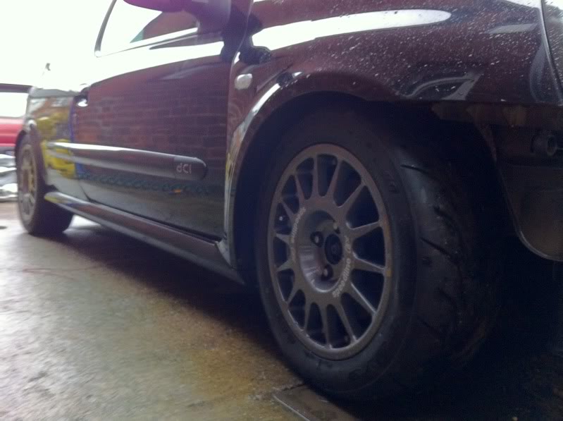

i dont know. might put the R888's on both. Or one set with normal tyres or wet racing tyres. we'll see
  TrackCar & F30 330d
No they are not terrible, not really that great for standing water but fine when in the wet.
In a perfect world be great to have a set of slicks and a set of wets. but not road legal to get to the tracks
100% fine in the wet if you're not acting like a hero, standing water is OK if there is tread on them, not so much if they are nearly bald - but its easy to adjust your driving style dependant on conditions with them IMO

off with the old wheels, in with the new, am gonna miss them a bit but im not gonna bother keeping a spare set as i will never be taking them with me
Dont know if its a new thing that speedline do or if they have always done it but the send me some little badges for the wheel bolts, so gave them quick blast with HT paint and stuck them on (not sure howlong they will stay on before they come off!)
