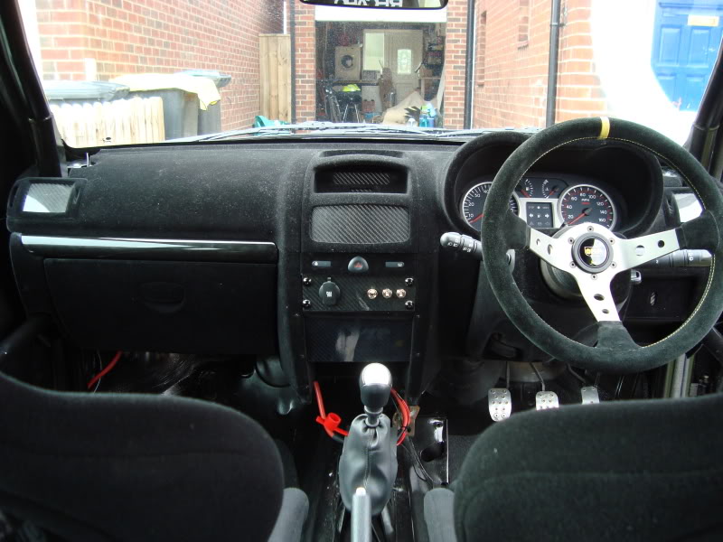

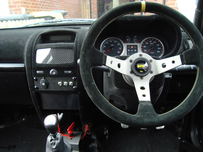

here is two quick pics (terrible quality)
then i will get a load when she is finished (better quality :p)

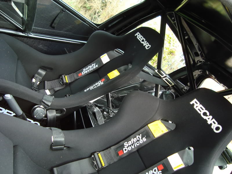

We had to fit one in the yellow one. Early mornings on a track with sun in your eyes is a right PITA!!
How low are the seats compared to standard height?
  182
just right for me coz im a short ass, wont be able to see over the dash! a lot of people make custom frames though so there on the floor pretty much.

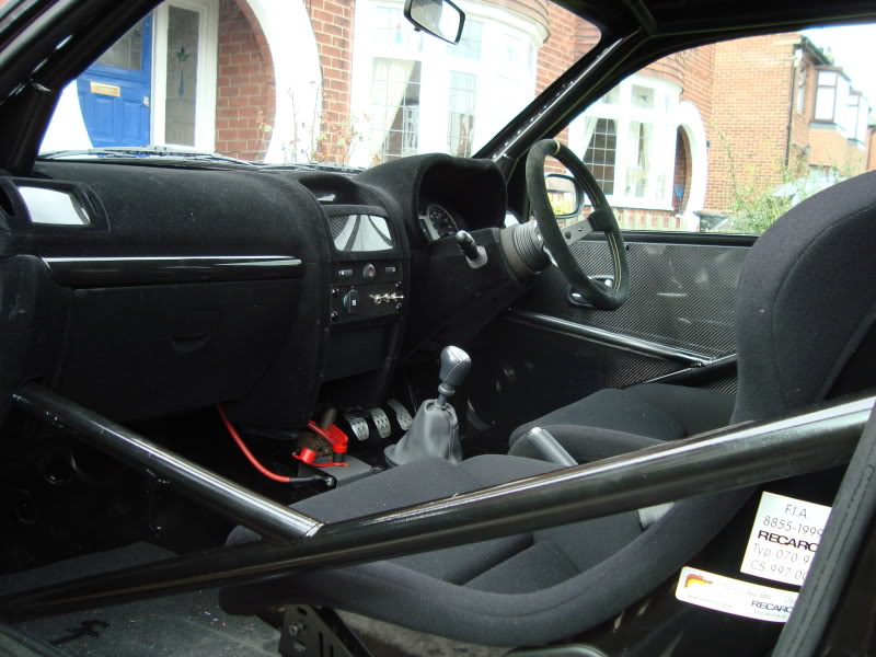

  182
right then, whilst waiting on the final bits to come back from the painters and the flocking company i didnt really have anything to
so replaced the number plate light and got a new plug from a breakers yard as it had totally corroded away! no pics though.
fitted the engine mounts and give the engine bay a splash of colour and a tidy up. didnt go crazy with this. wasliterally just the top bits as it will just end up getting dirty
cant wait till the end of the month now

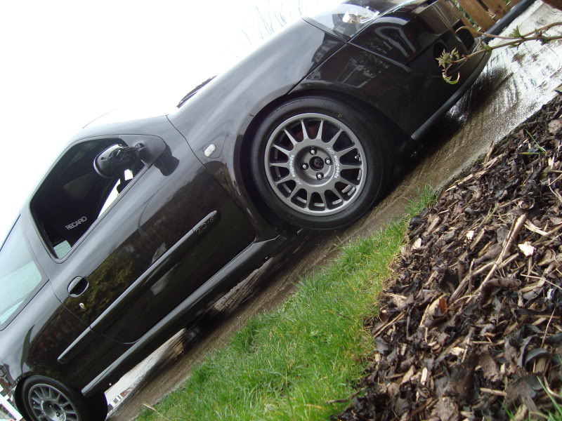

  182

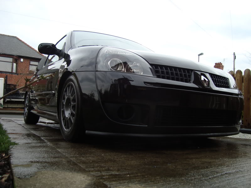

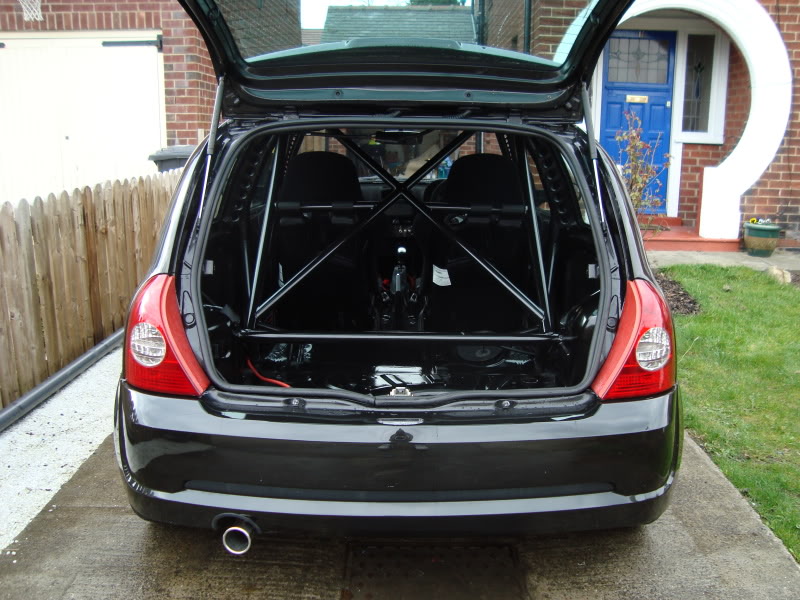

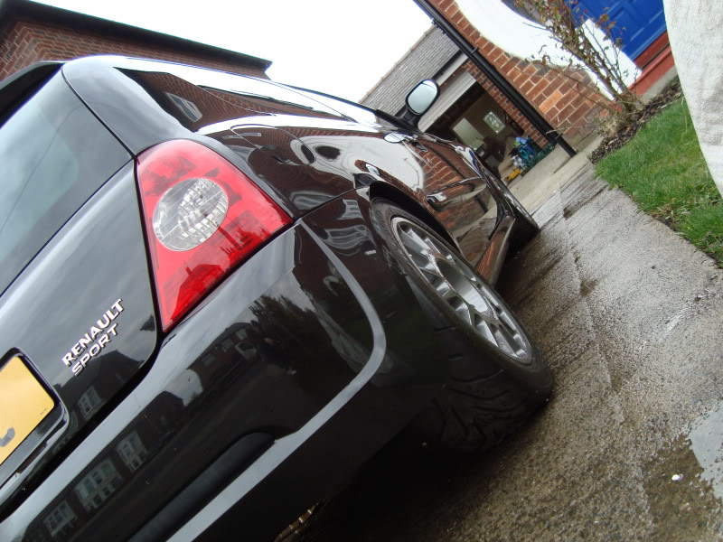

Right then, plenty of pics! gave it a quick wash, desperate for a proper clean and a good hoover. waiting for pay day now for tax, mot and unsurance. cant wait!
