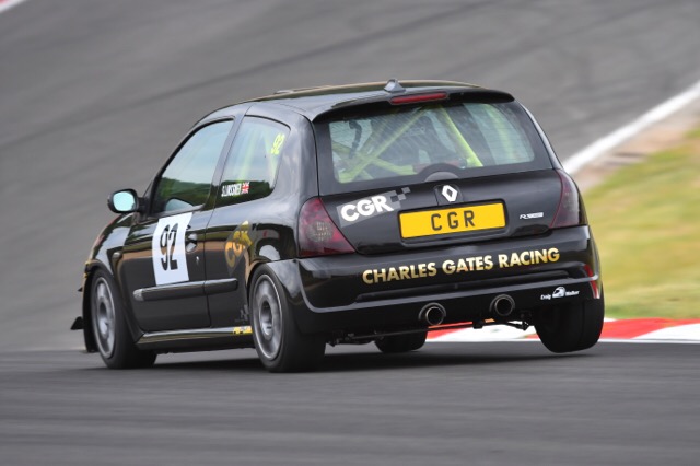

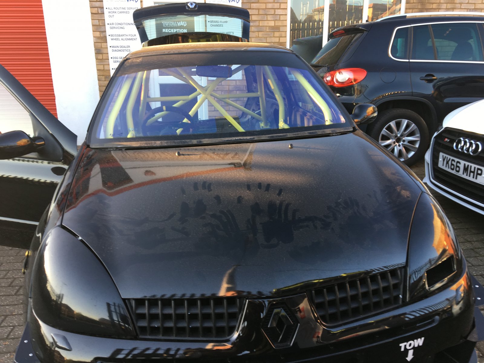

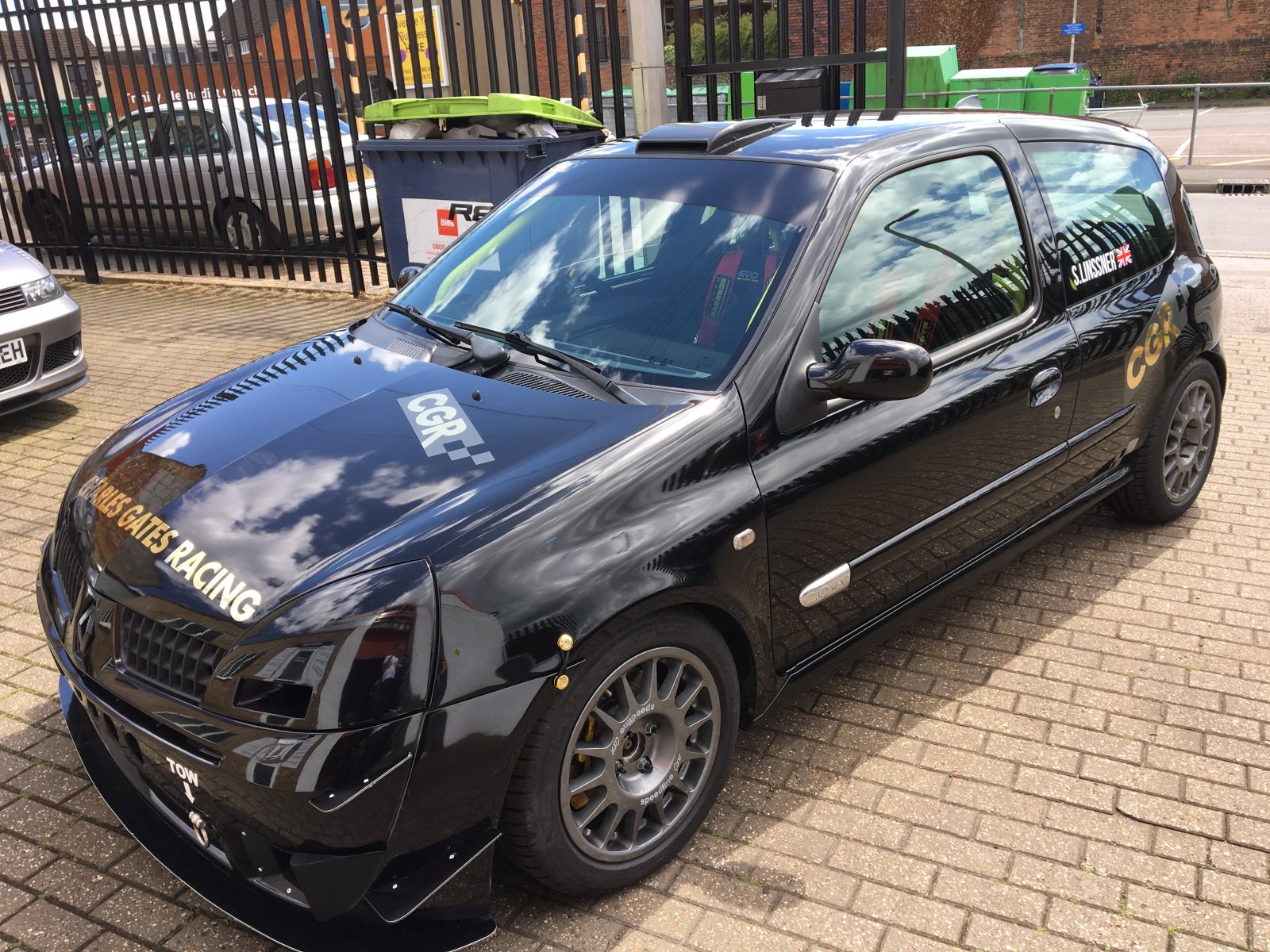

Looks mega in that last picture!
Thanks. :up:

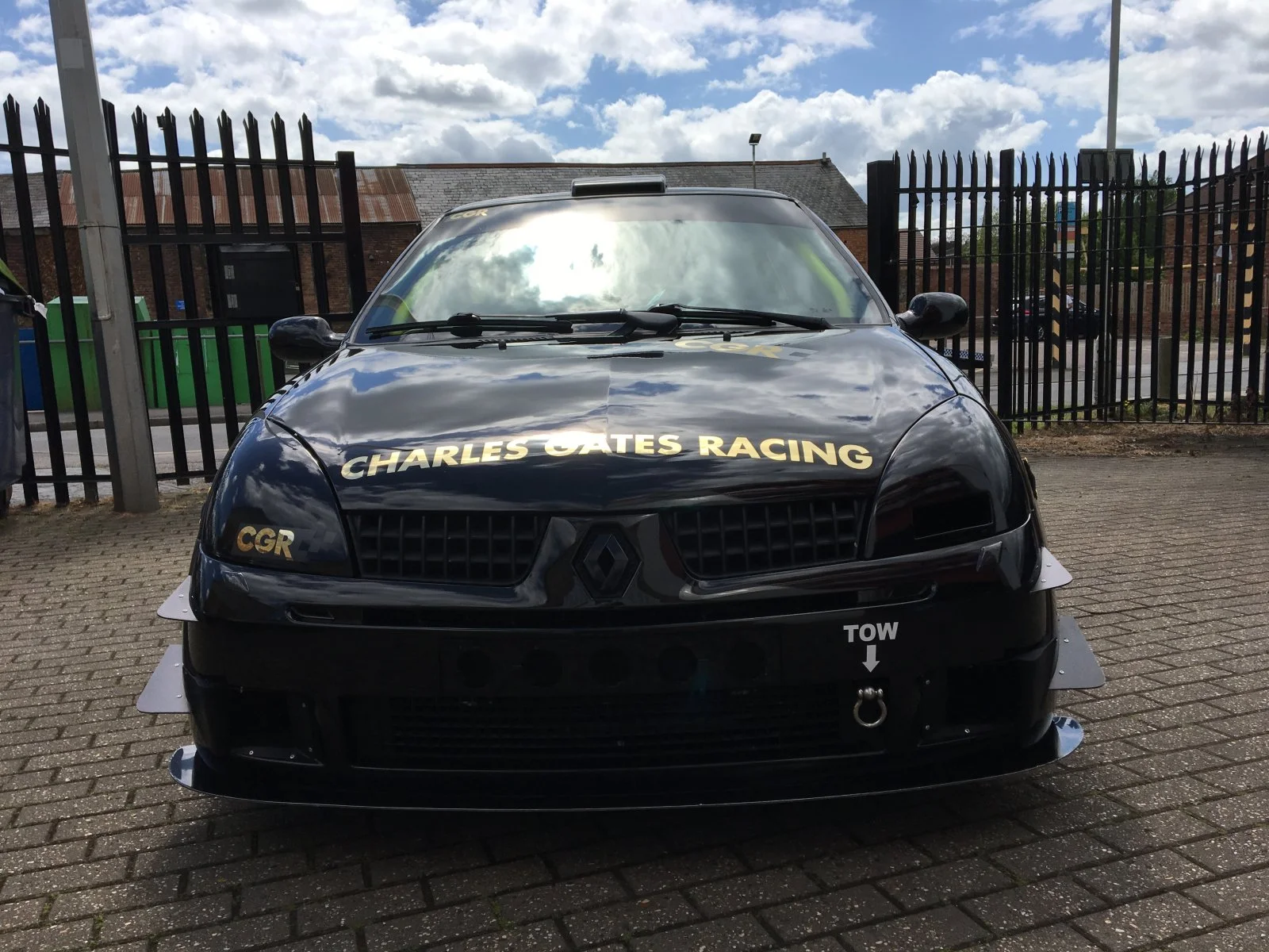

Hope it's alright for you mate. Wasn't sure on colour at first but looks good against the black.

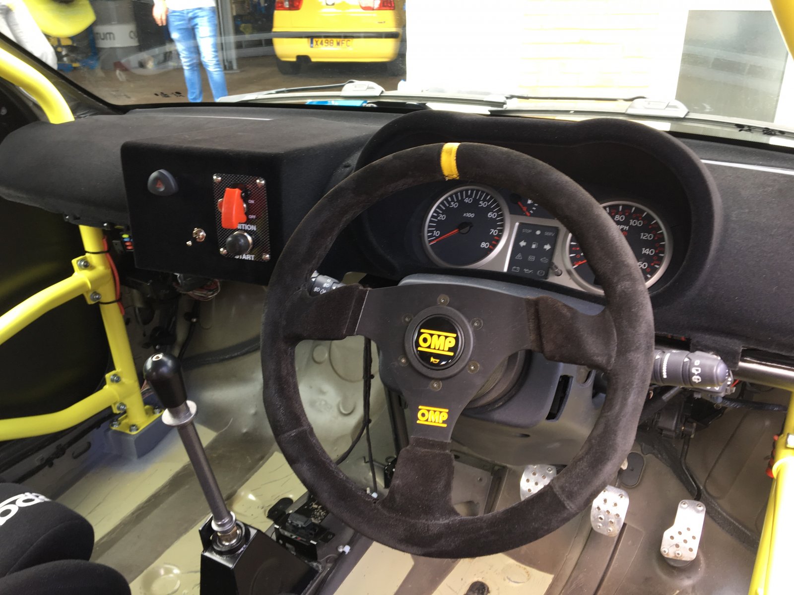

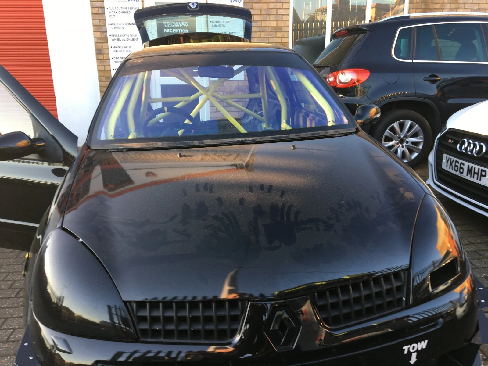

Saw your post on Facebook earlier too mate, out of curiosity what have done to bypass the immobiliser?

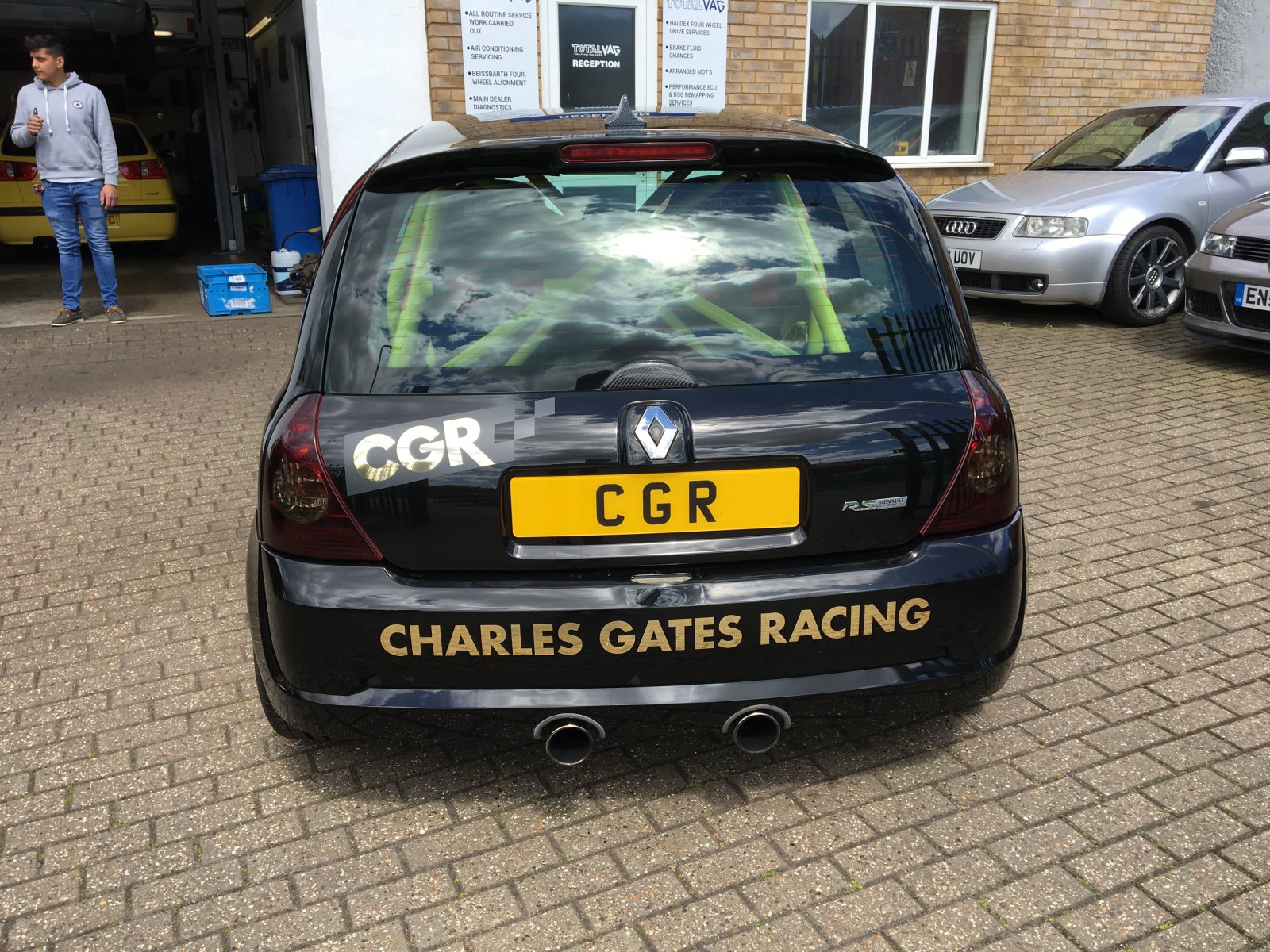

Looks epic! Got any pics of the uch/fusebox? Need to relocate/secure mine now Ive had my front cage done.

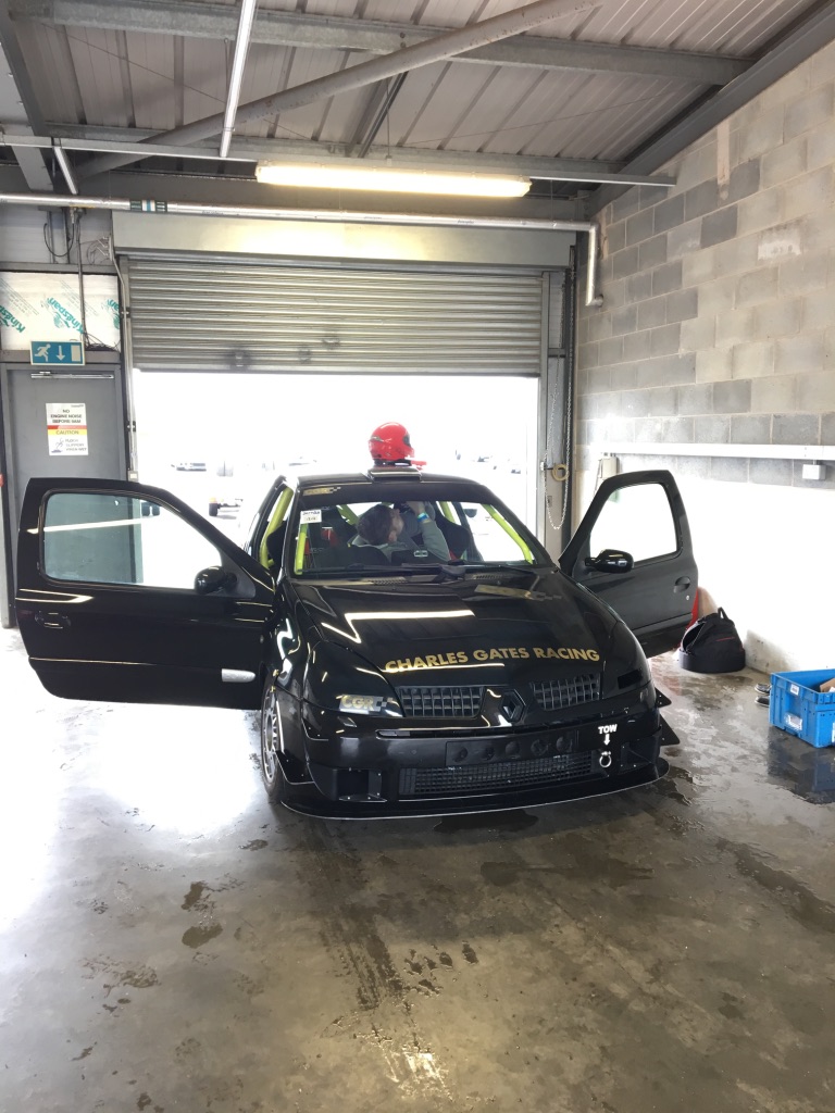

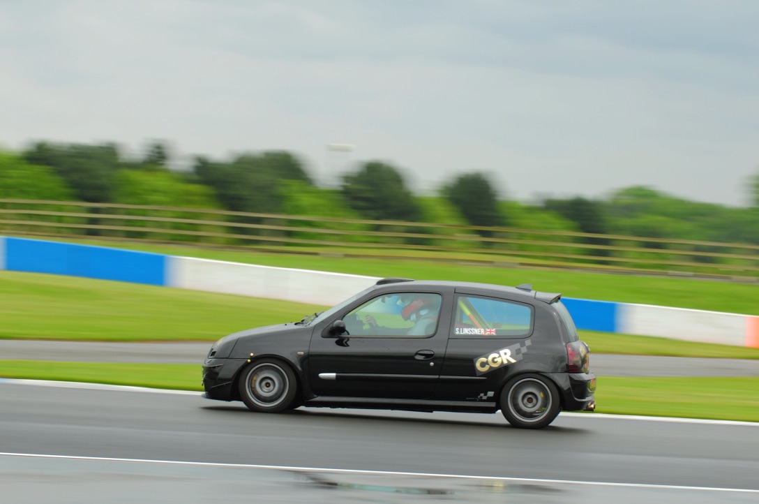

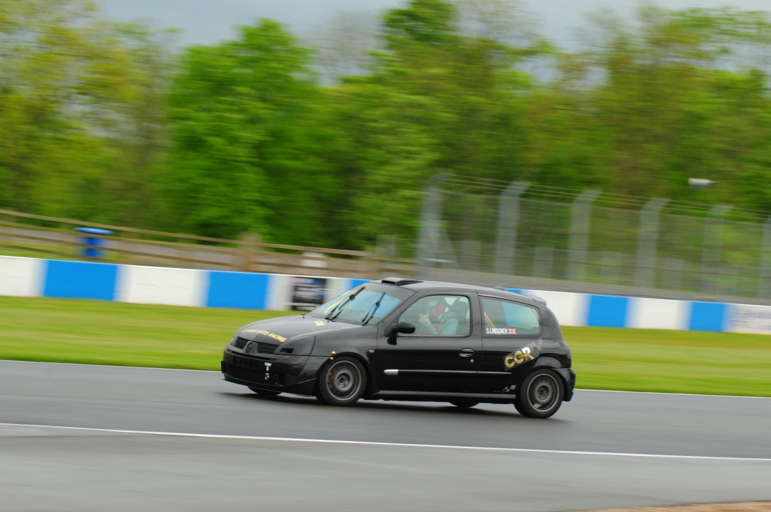

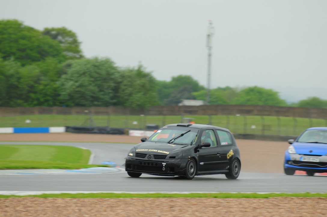

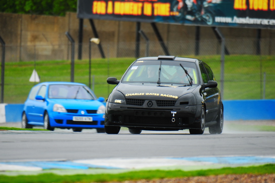

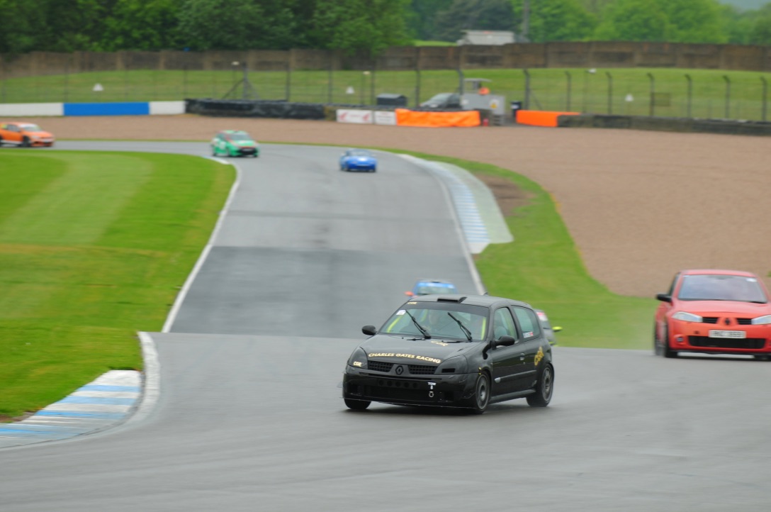

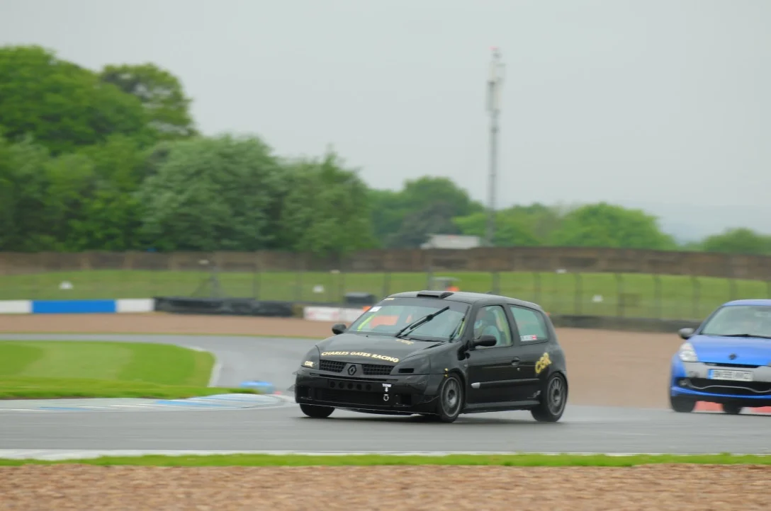

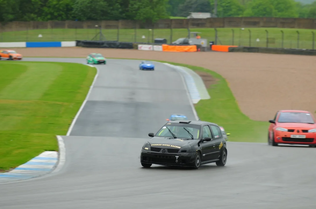

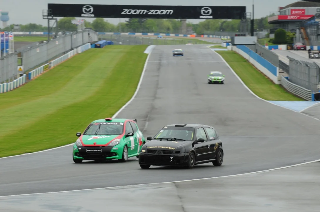

Donington today. First time on the circuit and its awesome. Its the first track i've driven where elevation plays a massive part. Loved the whole day. There was lots of fast clio's to play cat and mouse with and @mattsouthall of course. Started off very wet do decided to use the Michelin's and then span at Coppice. Too fast too wet and the wrong angle and knew as soon as I hit the apex the back was going to overtake the front. :tongueclosed: All fine though. Dried out in the afternoon and got the R888R's on and could go much faster. Def will be going back. Heres some pics...

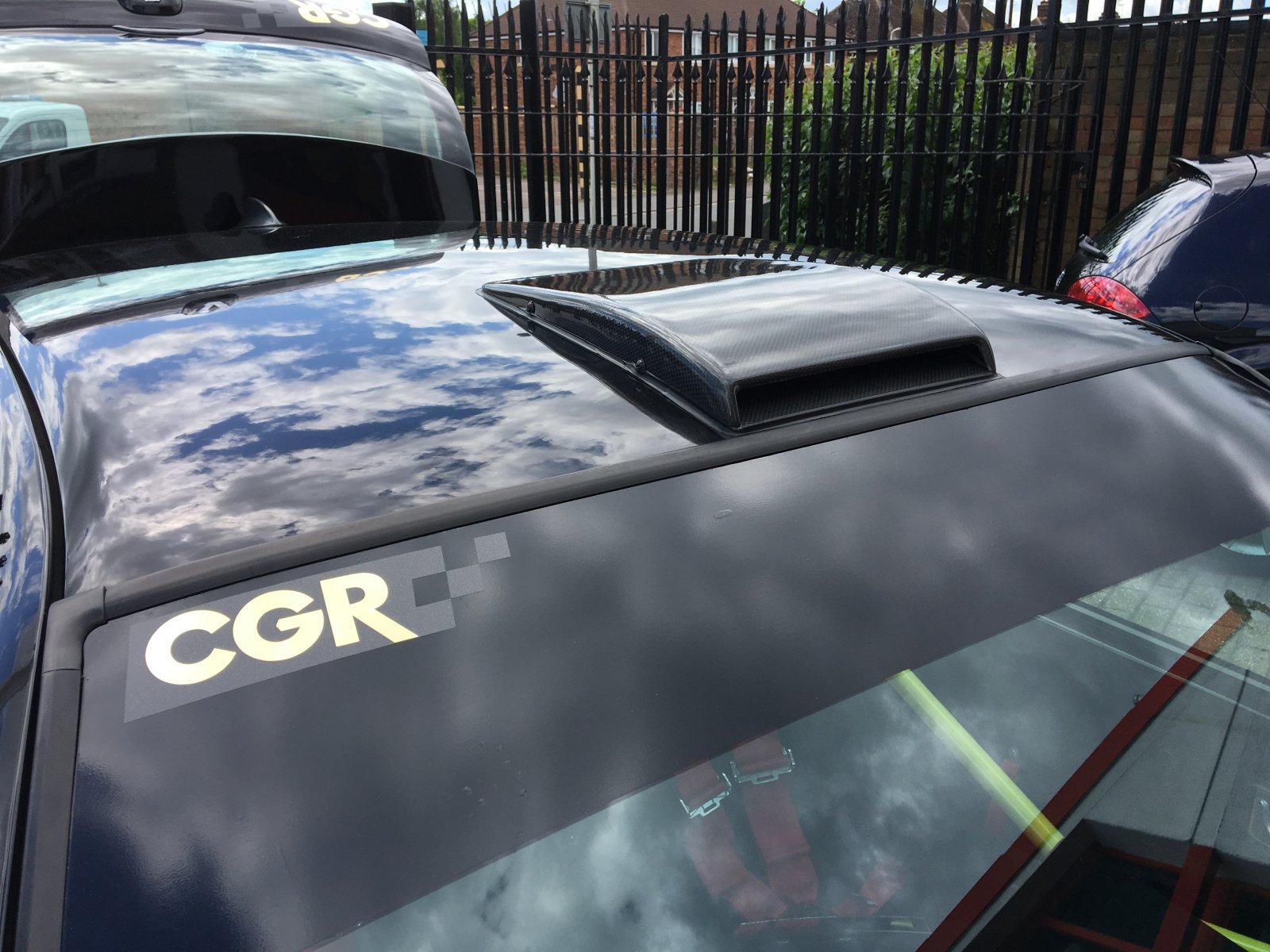

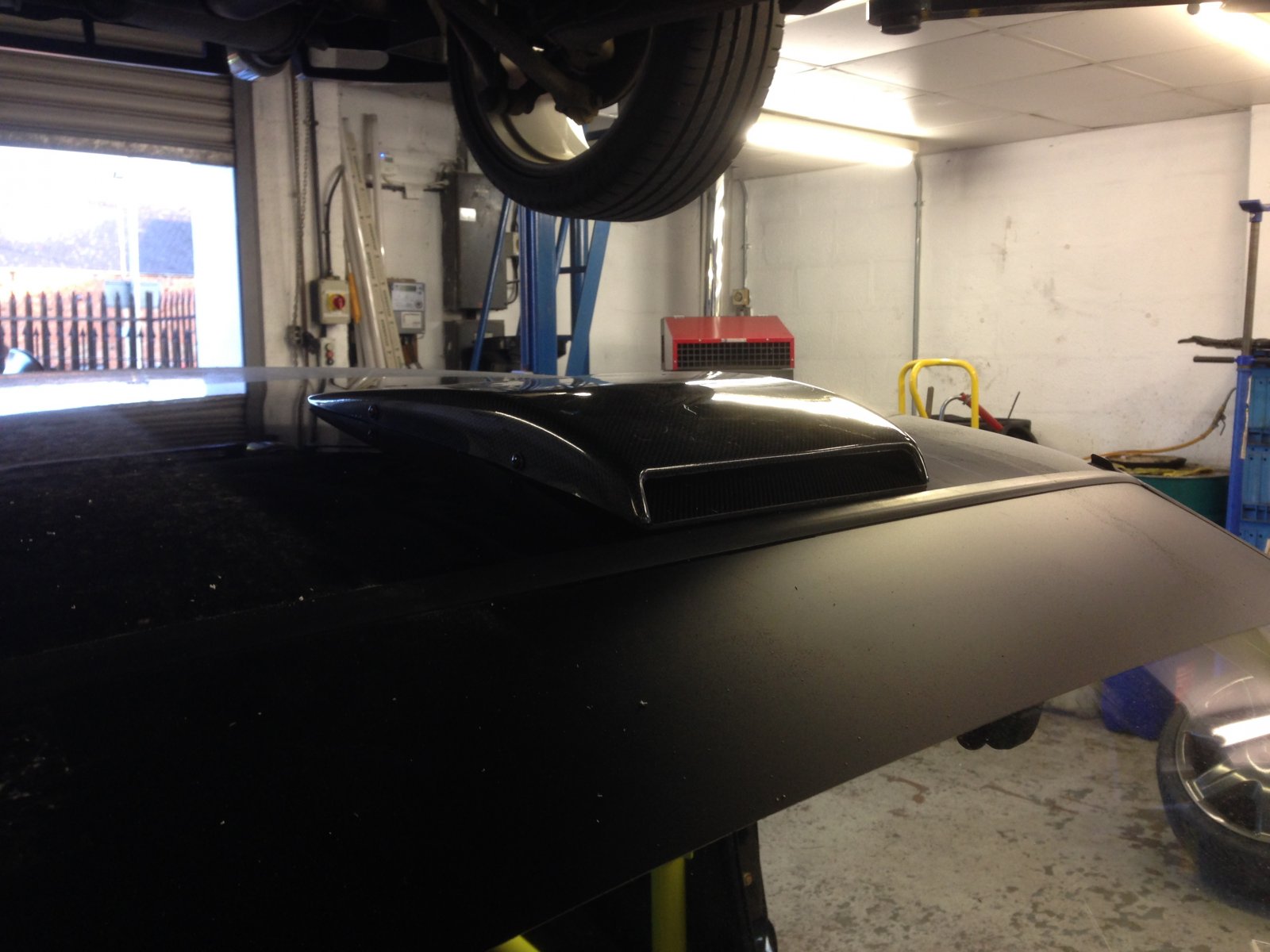

TRS Carbon Fiber Roof Vent

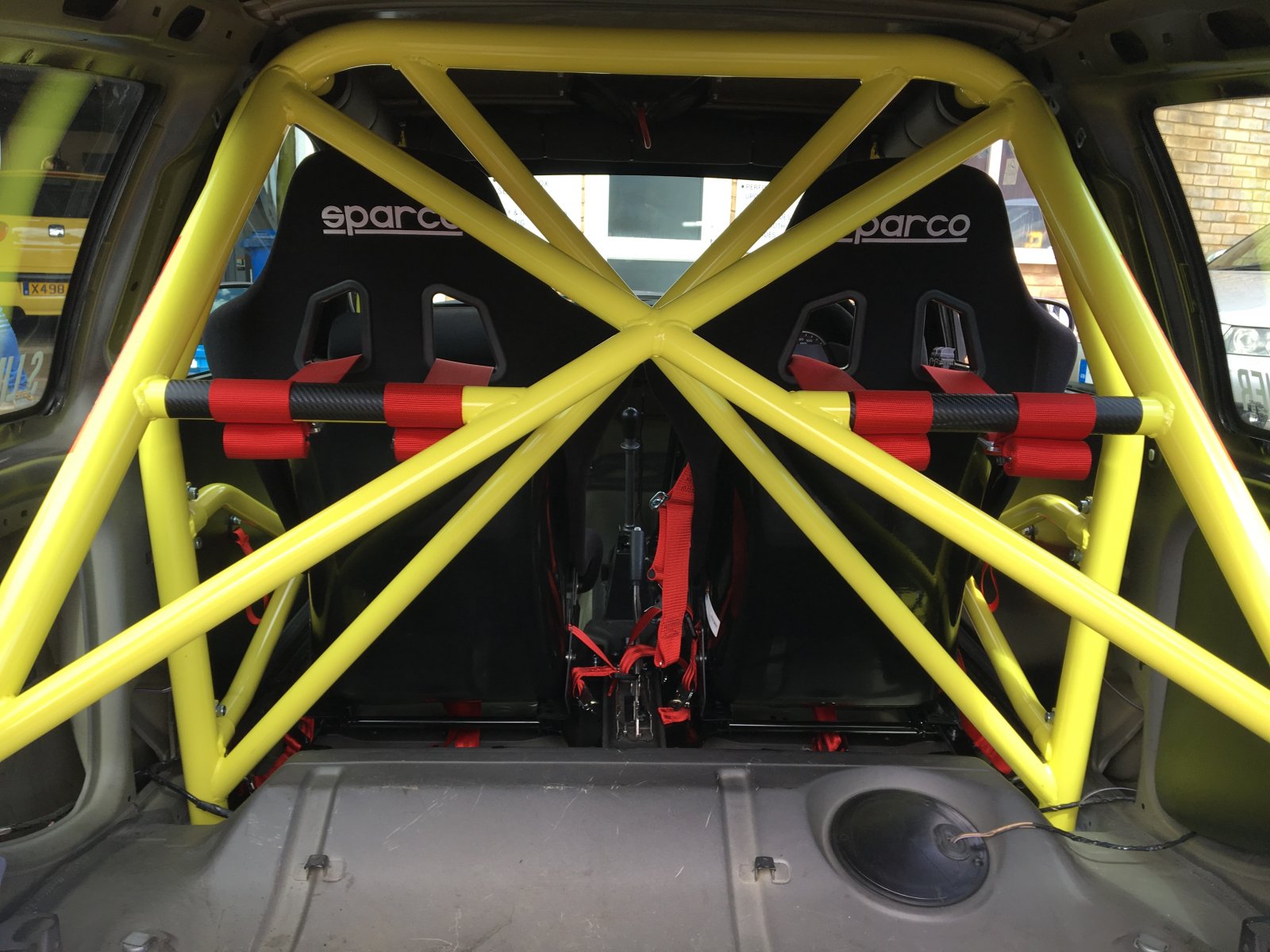

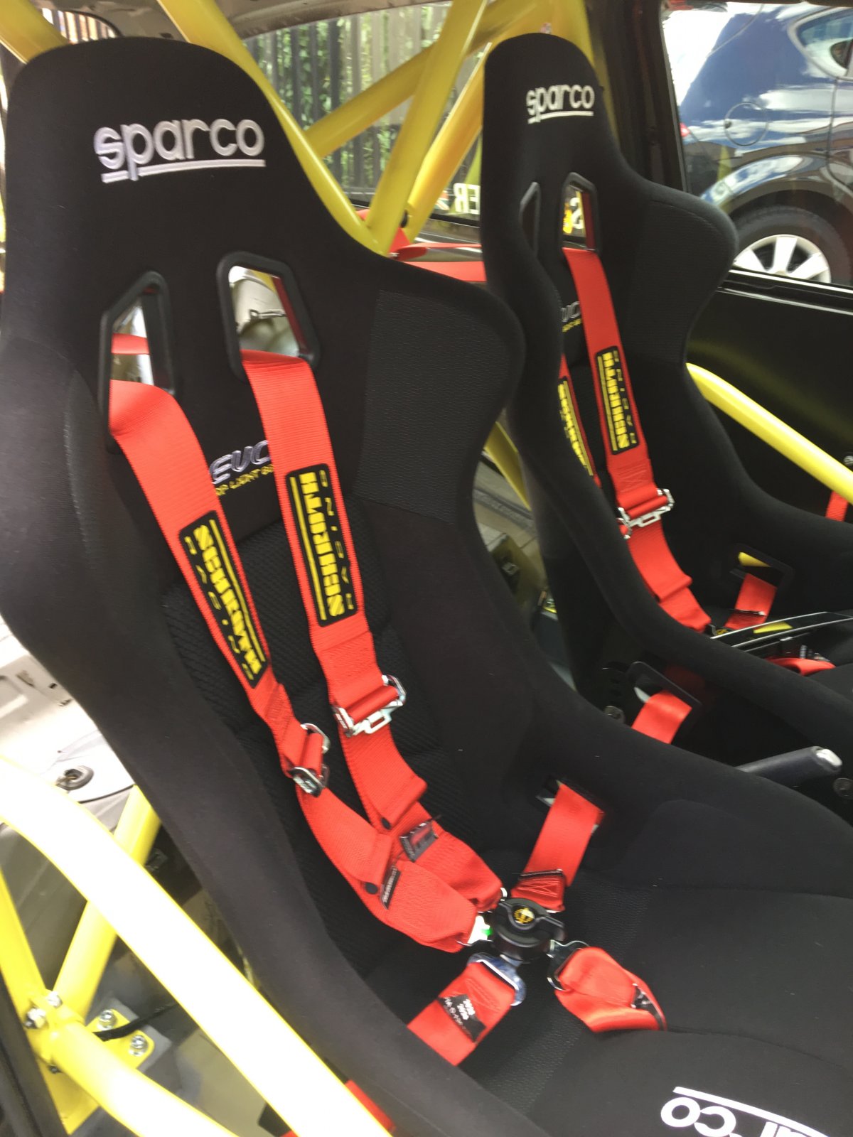

Sparco Evo LF Buckets
Scroth 6 Point Harness
OMP Steering Wheel/Momo Boss

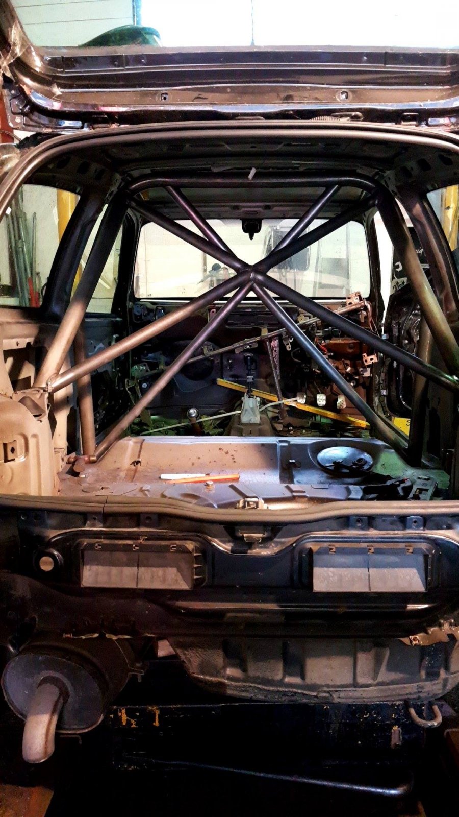

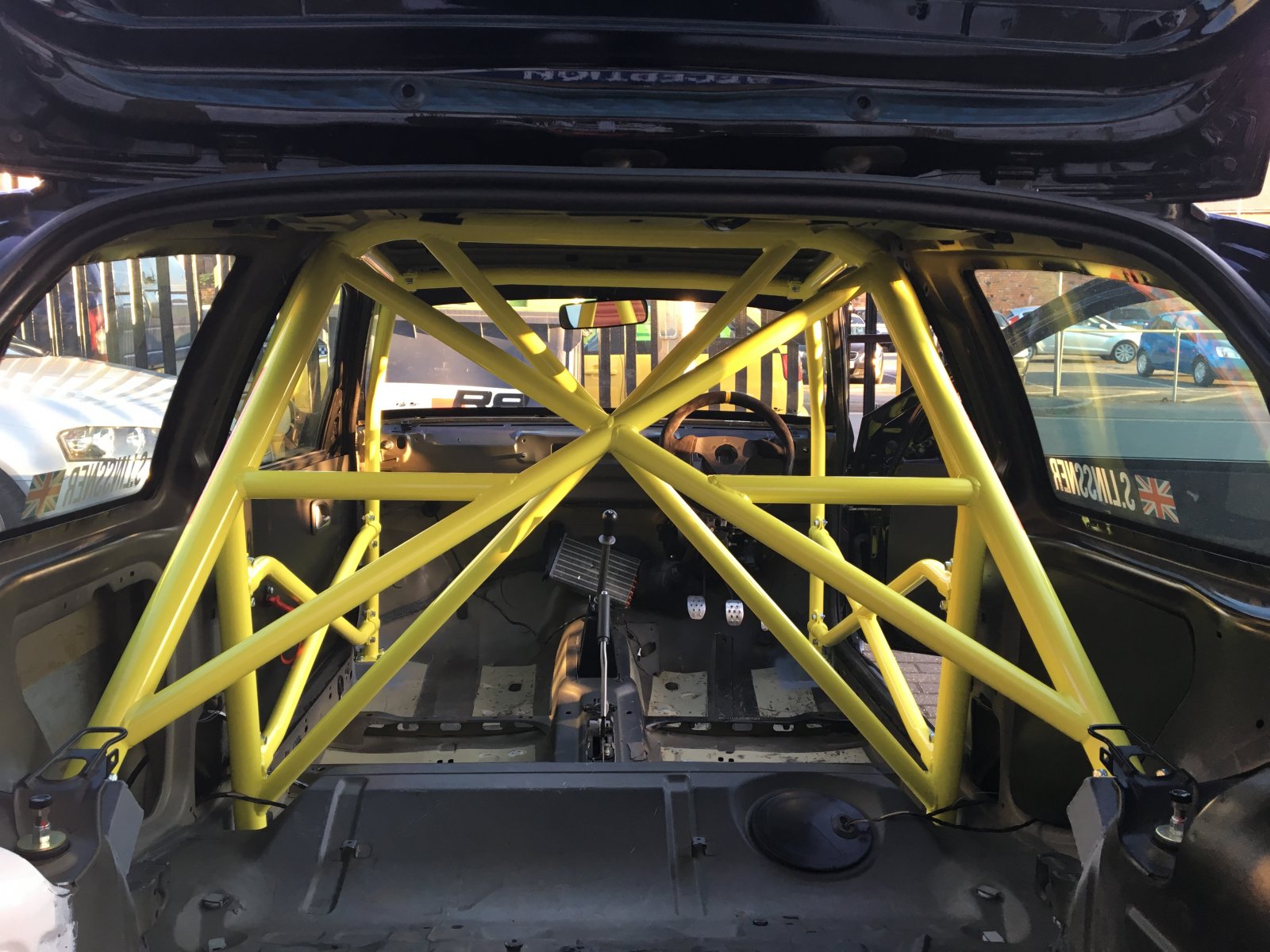

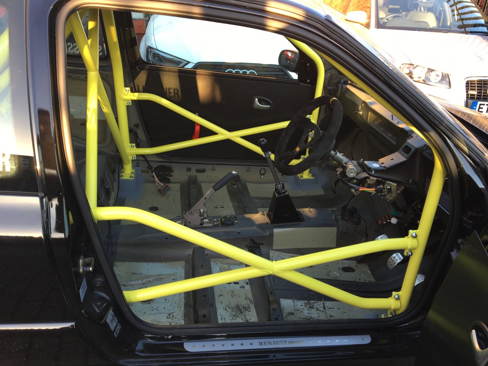

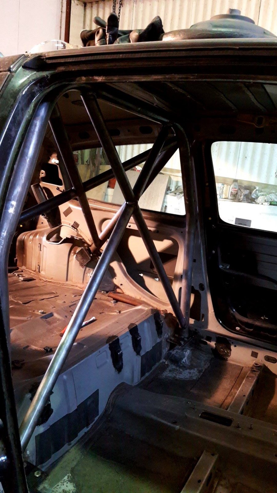

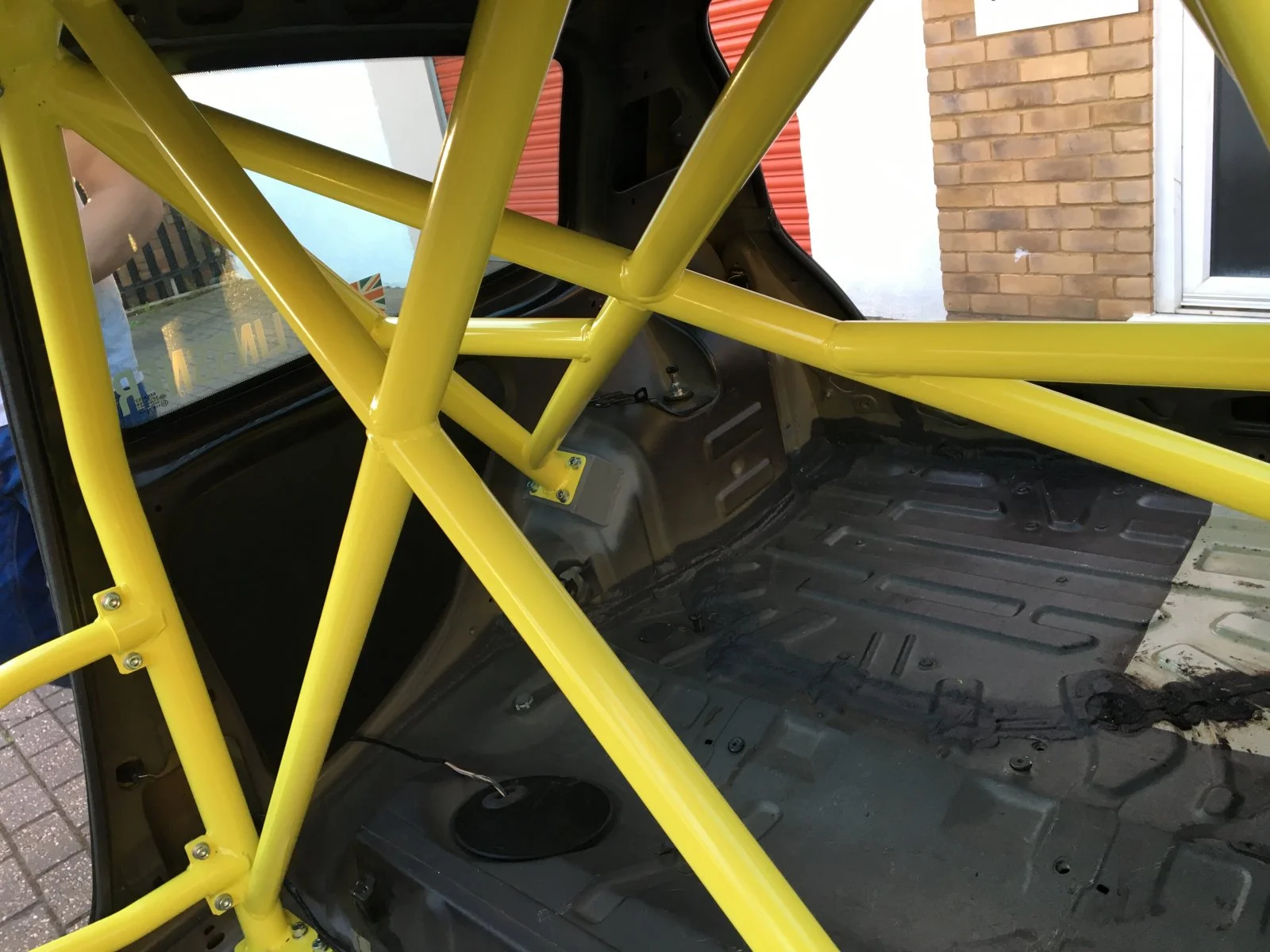

Full cage by Tom Johnson
I to would like to understand how this was done as I'm just about to put in the MSA electrical cut out equipment and if fairly easy would like to get this done as well. Great build btw
I asked my mechanic and now I've seen it in person I understand it a bit more. For the moment we had kept the key to work the immobiliser/alarm/central locking for security. Turning the key now does nothing it just needs the key in, the ignition is controlled by the switch. When I get round to fibreglass doors the whole lot will be removed and it will be controlled purely by the switch. As to how it's actually done I have no idea. Hope that helps.
  Clio 172 Merc ML55
Ahh that makes sense, I may have to make up something to hold the chip and ring then if I decide to lose the ignition barrel setup

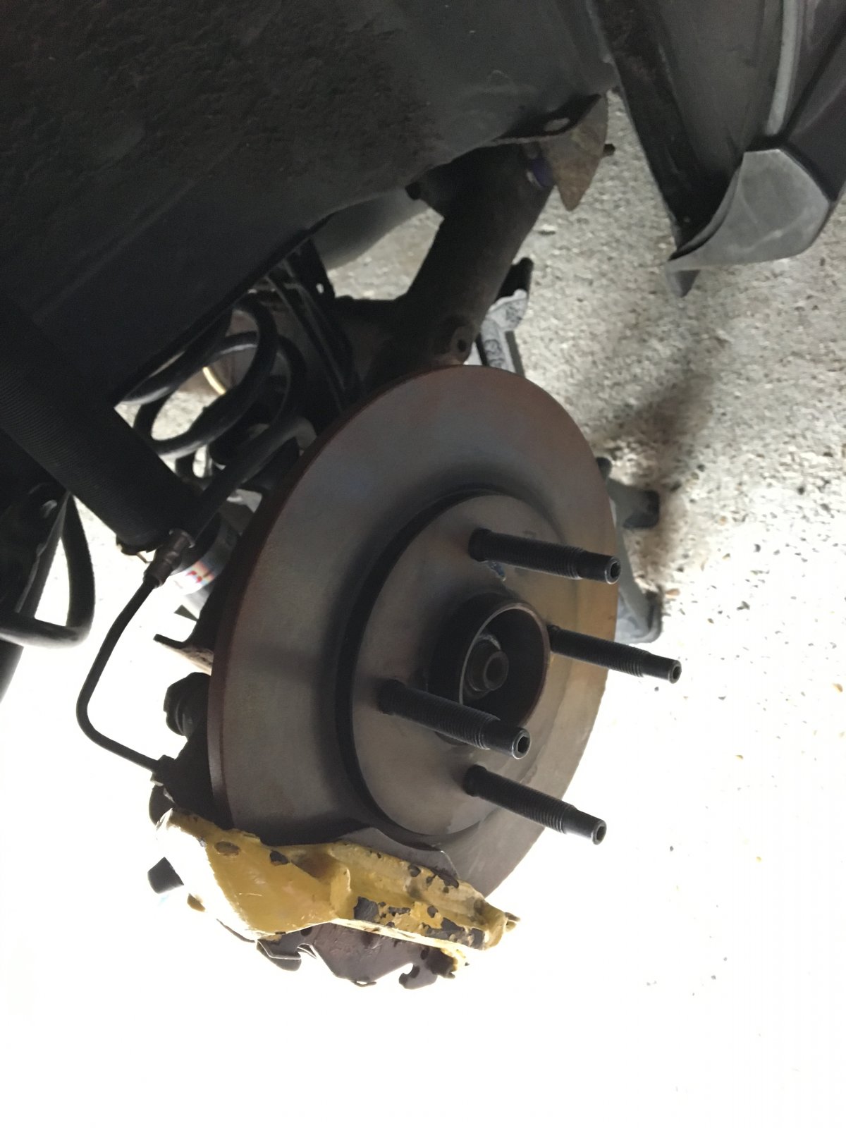

Today's efforts. New rear disk and studs after I killed them on the last outing. 😅

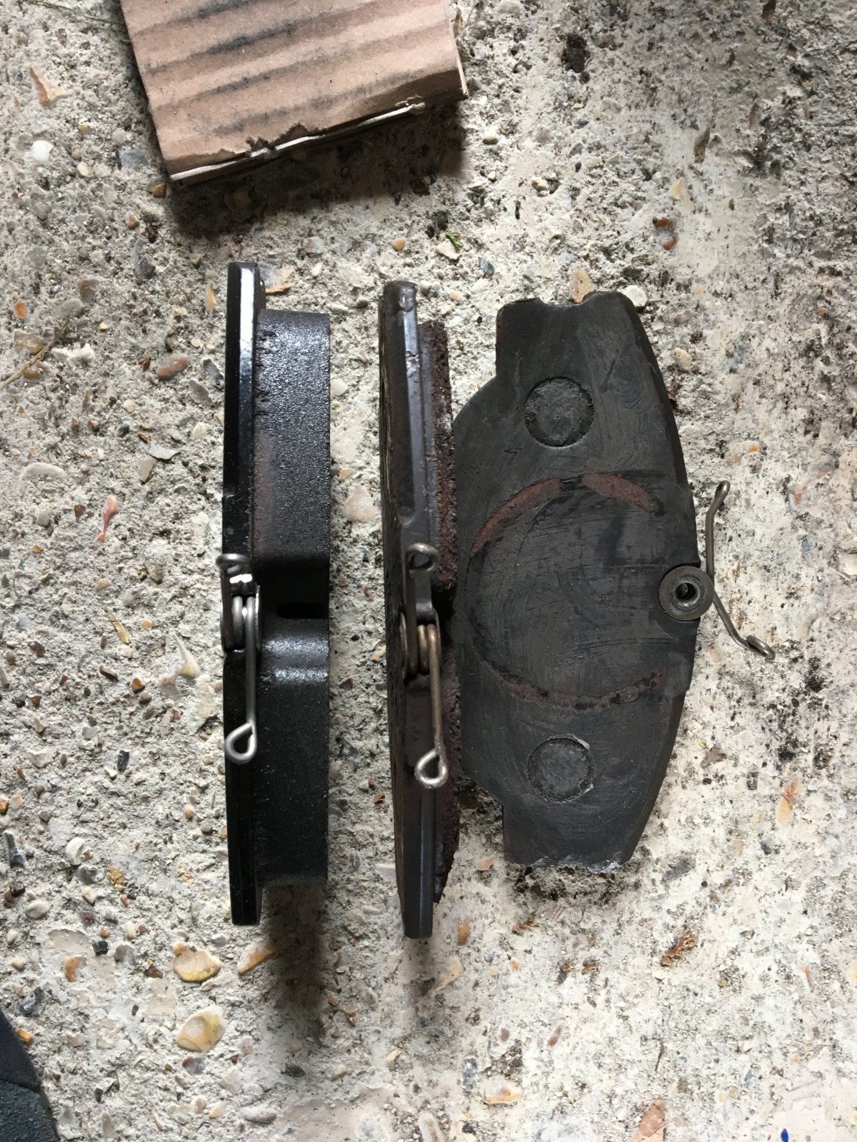

New pads. 4 track days those 2500's have done. Replaced with ds1.11's

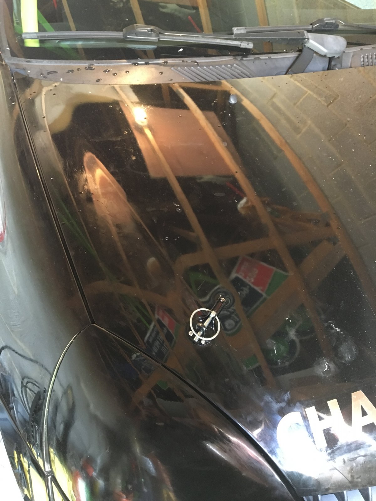

As I got black flagged at Dony for the bonnet latch failing twice :grimacing: thought I would get some cheap pin latches from DT. Will get replaced with nice carbon aero catches when I go fibreglass but these will do till then

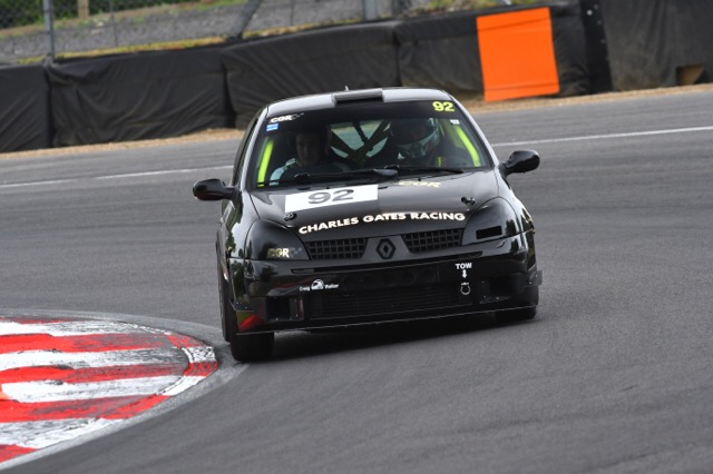

Couple of snaps from brands today...
Car behaved itself, really enjoyed the circuit and had a blast. Think I've nackered one of the front disks as I'm getting a lot of juddering/vibration under breaking. So I've ordered some new disks and will go from there. Nice to be taking the car out and enjoying it rather than looking at it sat in the garage.
