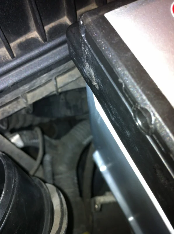

Bloody battery won't fit :@
Typed in my number plate in euro car parts and the list of battery's came up, ordered a Bosch S3 005 but it won't fit, my old ones much smaller, the Bosch is about 3cm over the cold air feed into the airbox??
I've looked at the other batteries on ECP's and there the same size ...

Cheers guys, silly idiots they are then! Should ECP have to collect the old and send a replacement? Pissed off as I have to go away for weekend

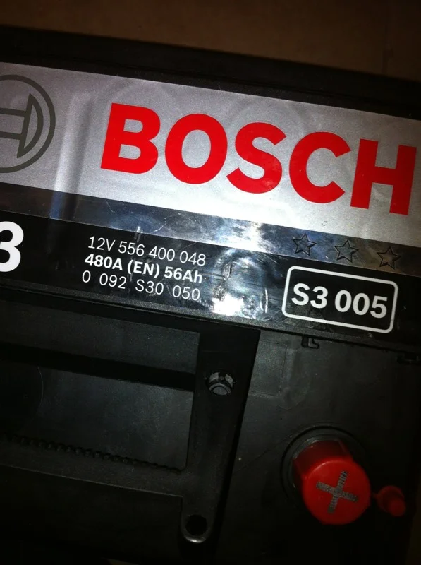

These are the details, what battery should it be please? Someone said it was an 065? I can't see that on my battery, maybe I've got another version but still too big, sorry or being vague I'm on my pone, here what I've got:

If you speak to them pal, tell them it's to big and you need an 063 they will understand totally! :)

063 = Correct.
065 = Incorrect. Too big, won't fit, small gap, nada....
Cheers lads, appreciate the help, it was about 4cm over the air feed hole and im standing there thinking wtf, they all say 24.5cm and my OEM is 21cm...

you need an 063
most of the cars I see have an 065 fitted and the airbox pipe can't be conected
i fitted a Bosch S4 type 027 battery and it fitted fine, had it spare in garage. Slightly higher CCA at 540cca and 60ah.
Same width, slightly taller and longer.
