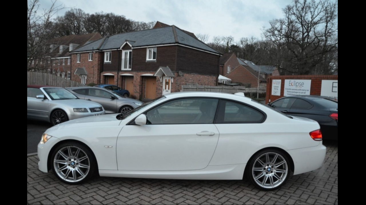

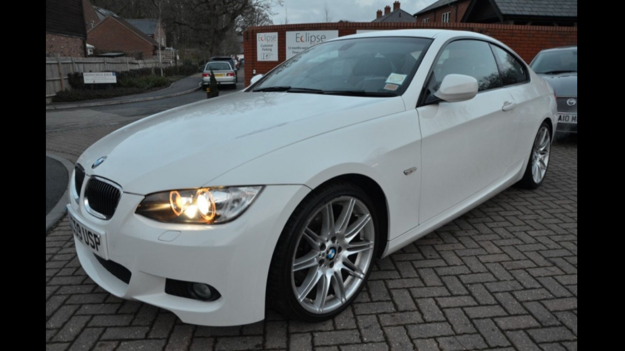

Well after 3 Clio's I've finally moved away from French! The 182 is up for sale and I will be sad to see it go, but onwards and upwards.
I wanted something bigger, auto, and coupe-ish looking. Had a look at Audi A5, TT, MB C350 but always came back to the e92. Had to have the iDrive and heated seats and M sport. Bought a grey one from private seller, the next day the car had a misfire, plugged it in, running rich and misfire cyl 1. Instead of repair the seller said he would buy it back for the same price - great result I guess!
This one isn't my first colour choice but looks good nonetheless.
BMW e92 330i M Sport Highline. Already have some 18'' MV3's to go on (prefer the ride and look over the 19's).
68k Miles
Full BMW service history
most importantly the injectors are still working...for now.

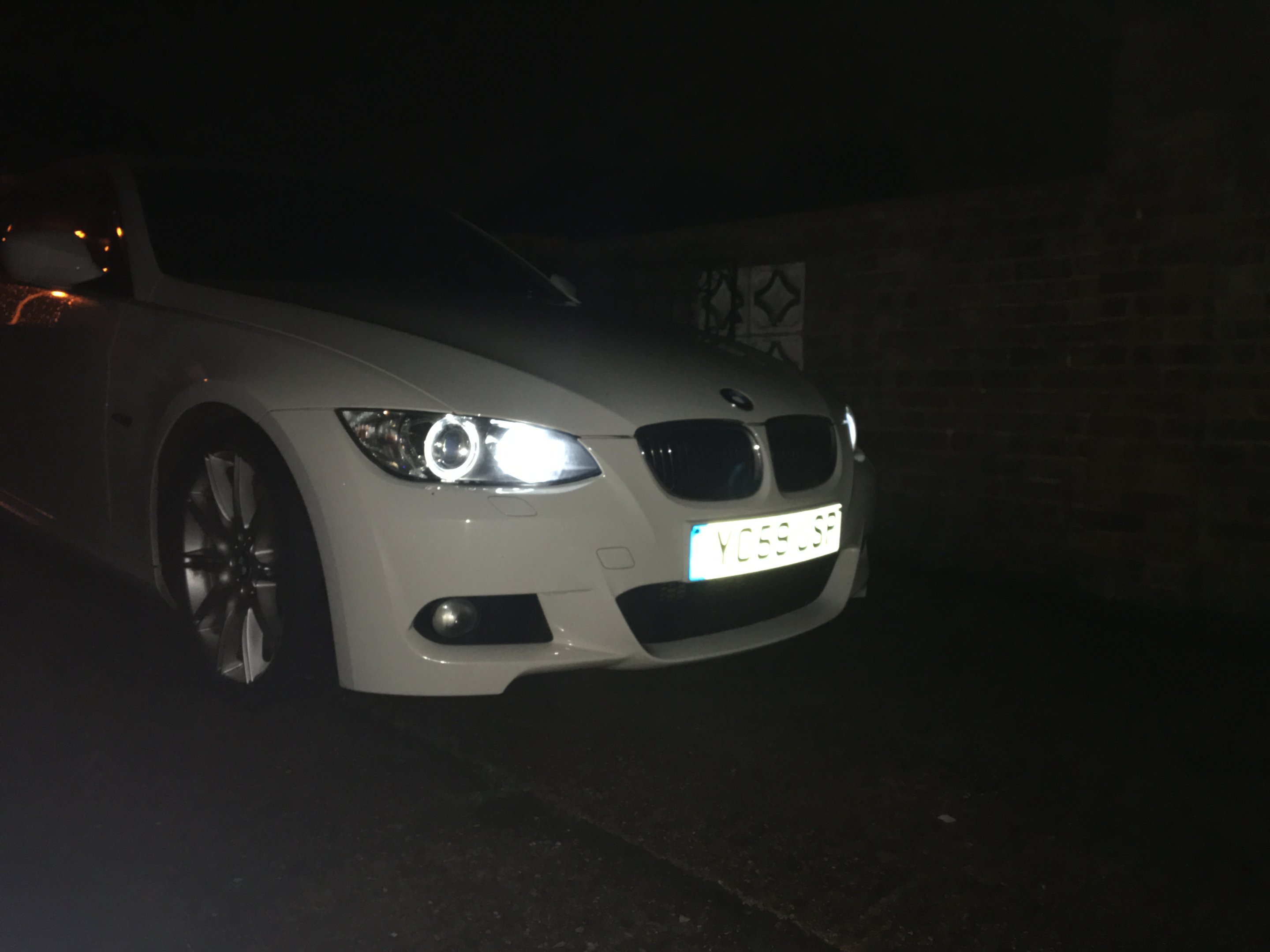

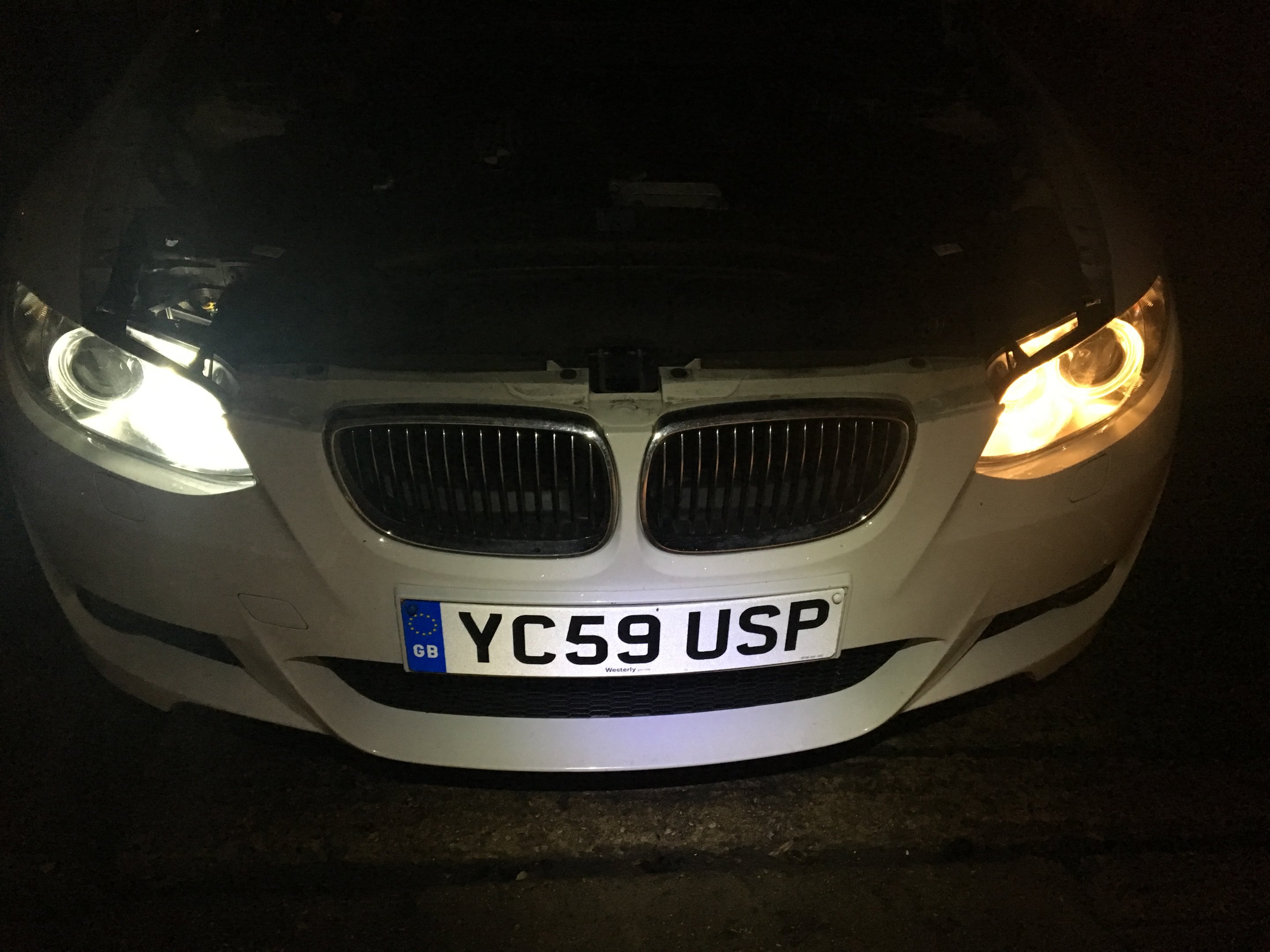

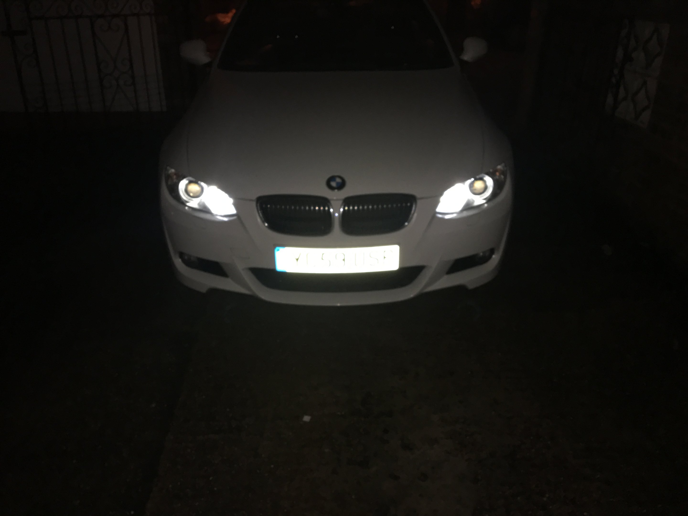

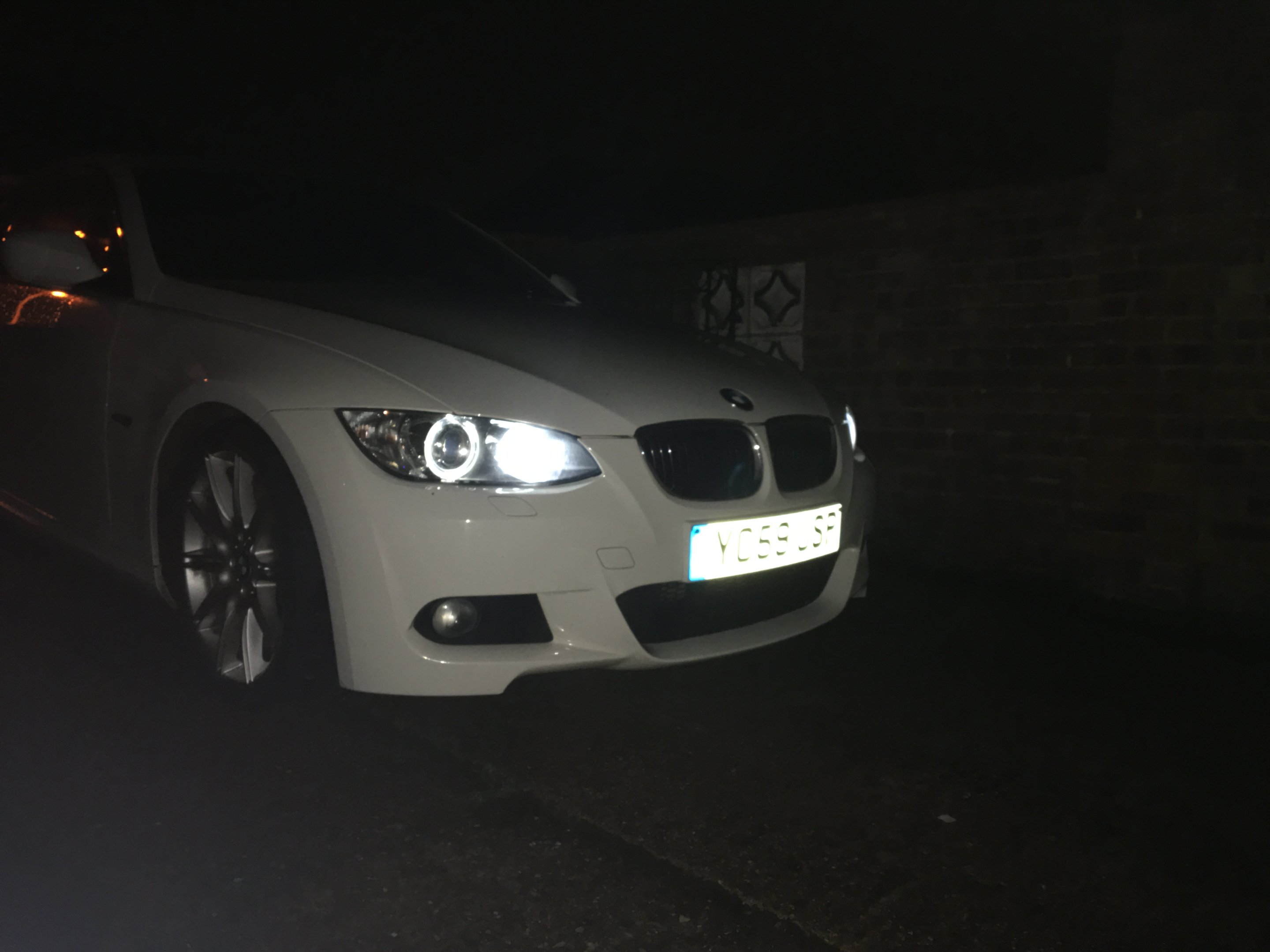

White halos are one of the best mods for the pre-LCI lights! Improves the front end so much.
With regards to the seating position, I'm about 5'11 as well and I have mines up a little bit from the lowest point. Do you sit quite upright? I have quite a relaxed driving position for the most part which maybe helps me, but I find if I lean forward then my hair can touch the roof near to the sunvisors.
Yeah it just looks more modern now. I sit as upright as I can really due to a dodgy back. Yeah it’s that part that drops down near the front which annoys me, it can move up so I might be able to sort something out.

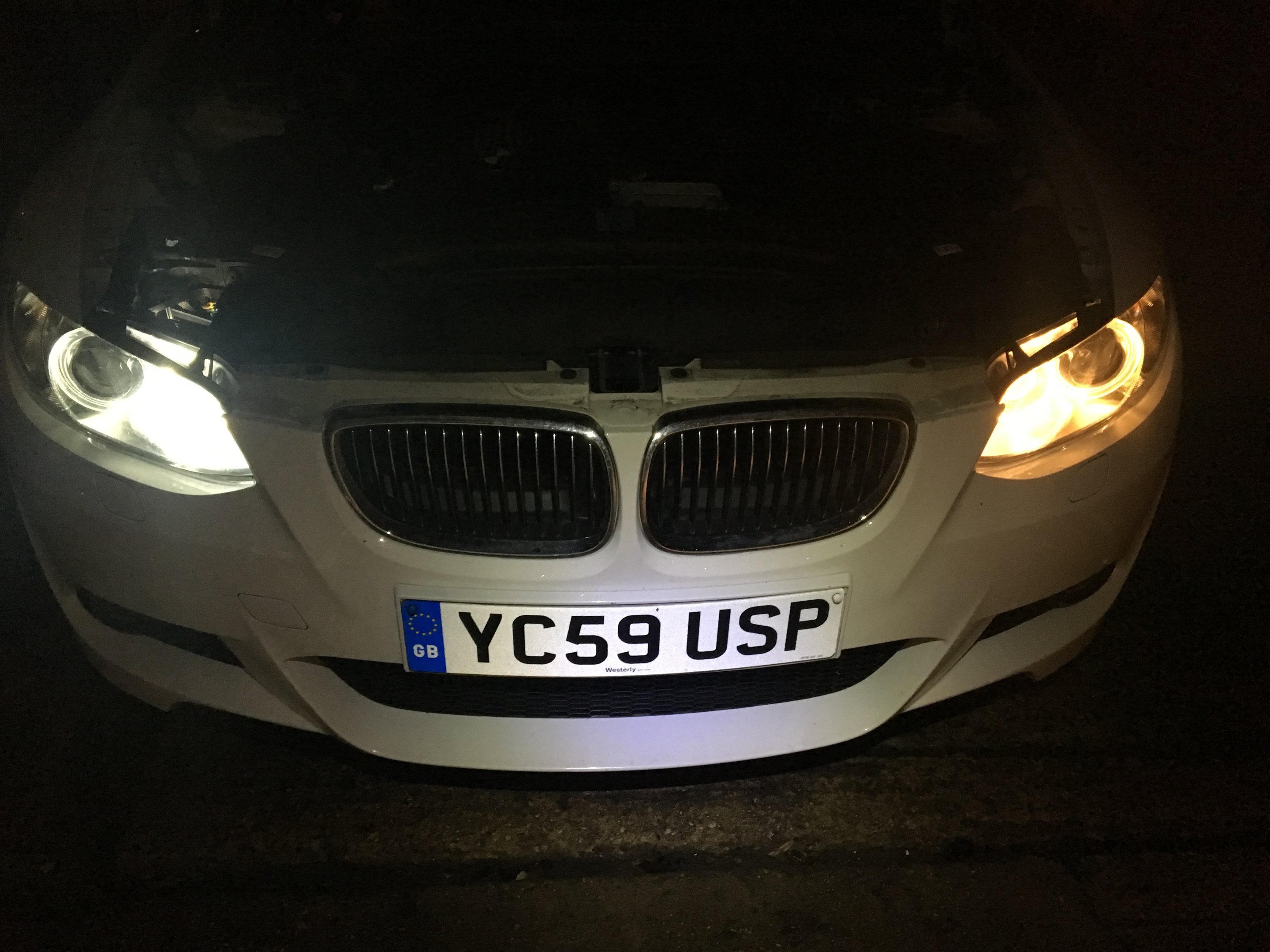

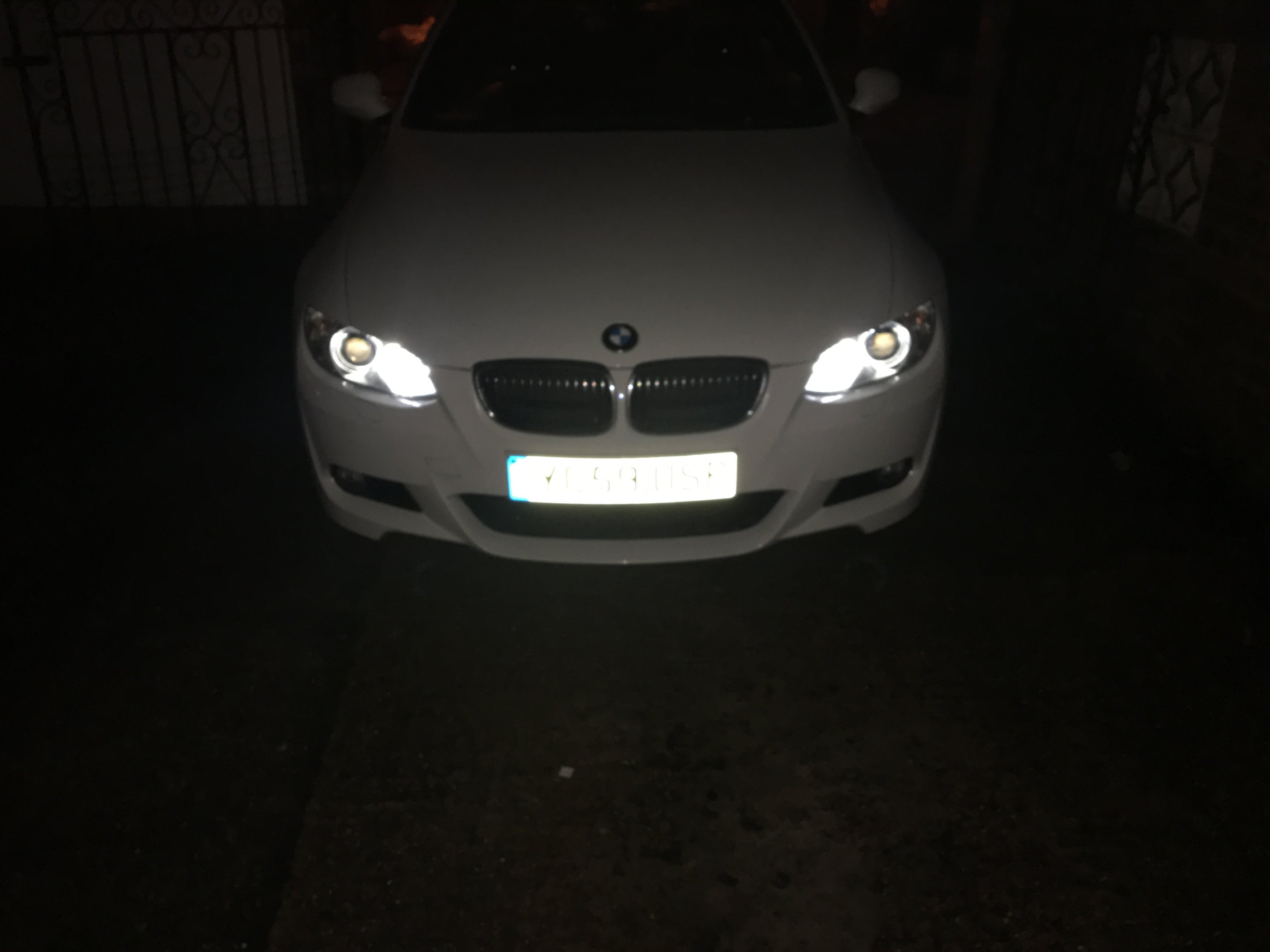

What bulbs did you go for? They seem to light up both rings quite well.
Some from eBay, I can pm you the link if you like. Didn’t realise they were 120watts and I read somewhere on the e9x forums not to go for anymore than 35watts so unsure if they’ll last, being led I think they should be fine. Regards to the rings, it looks better in the photos to be honest, due to the bulb placement I think the outside one will never be as bright as the inside!

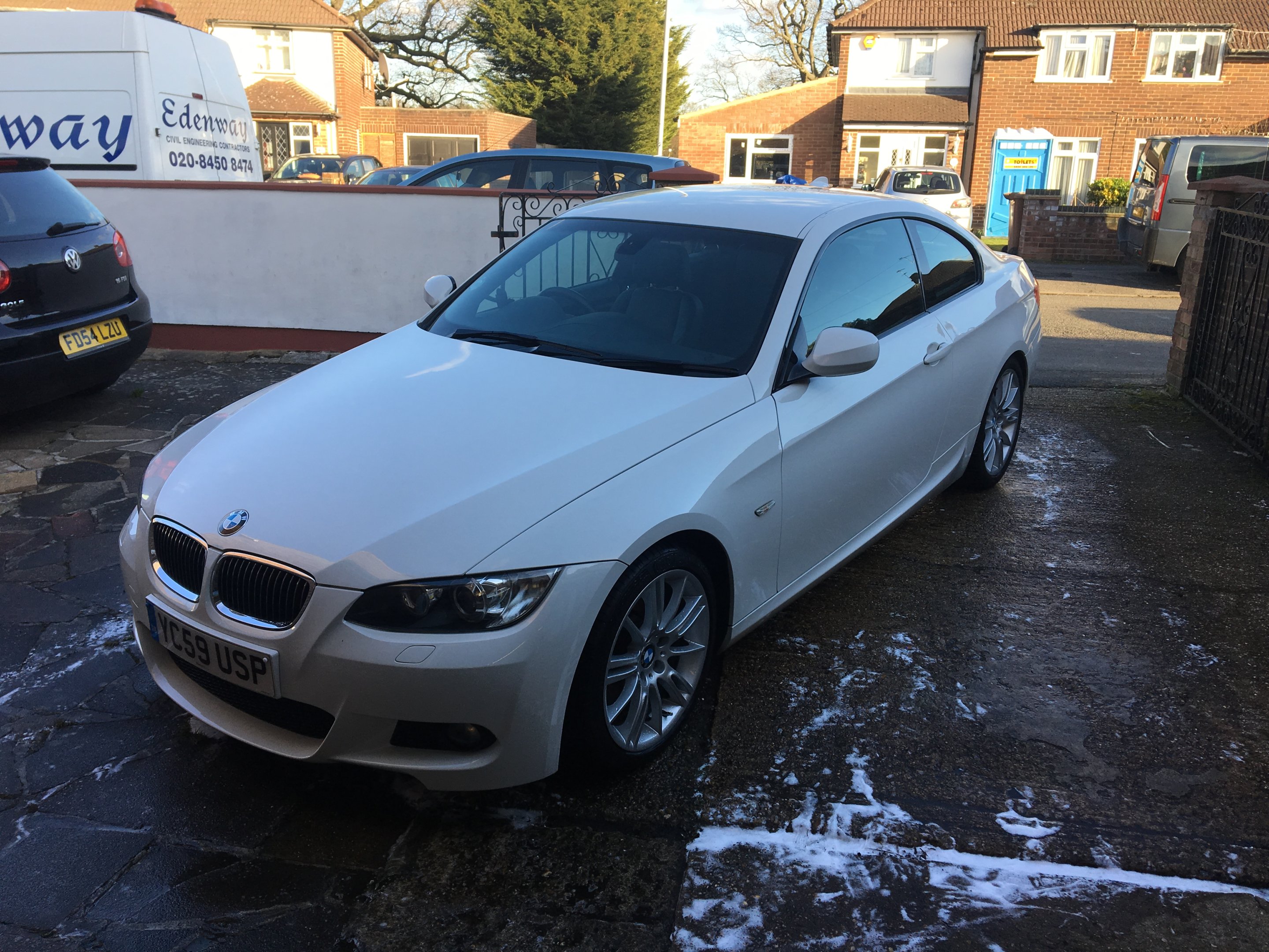

So little update on this - done the oil/all filters service last week and had the wheels all balanced and a slow puncture repaired, no more wheel wobble!
M performance handbrake and gear selector/surrond fitted.

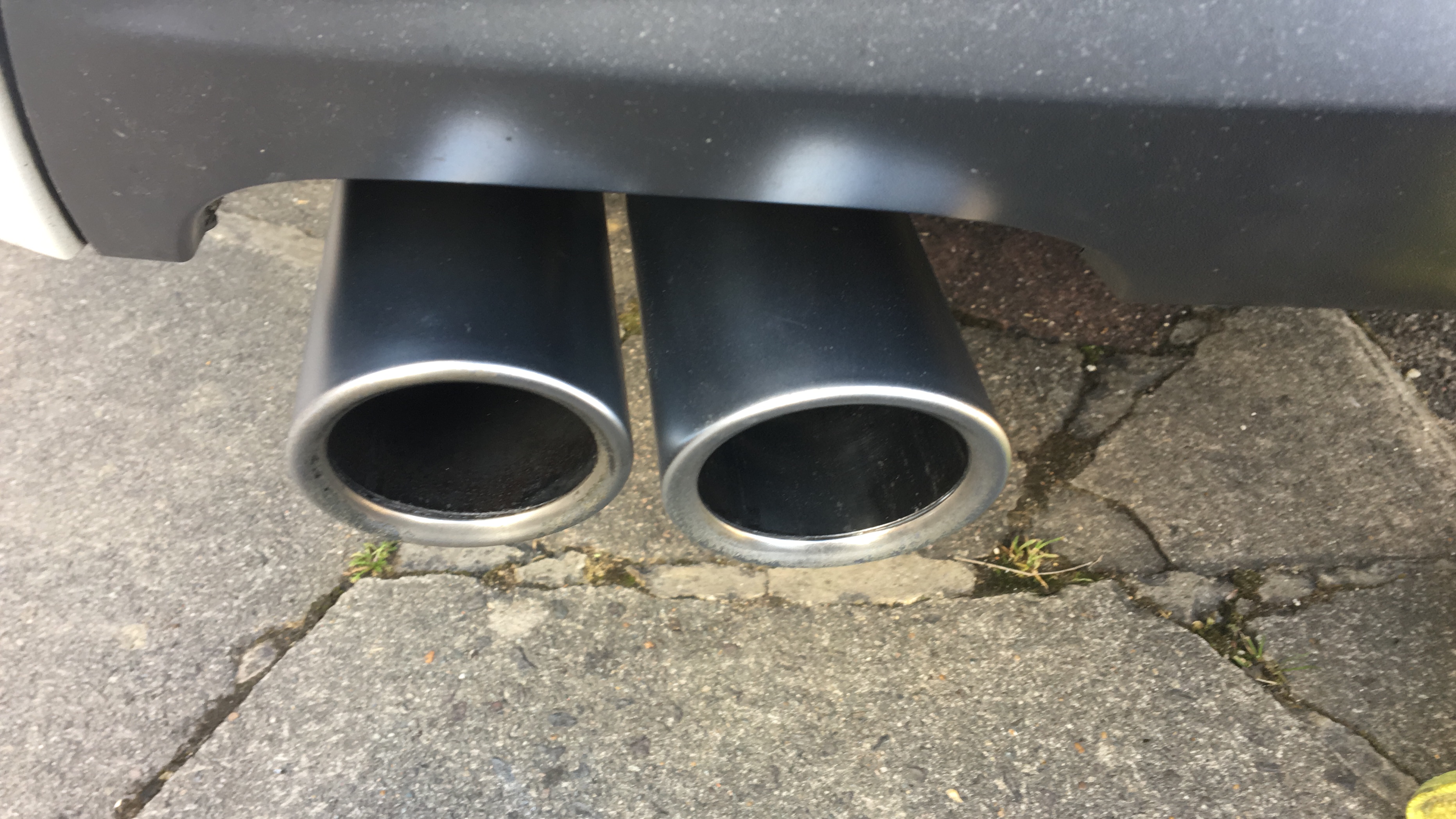

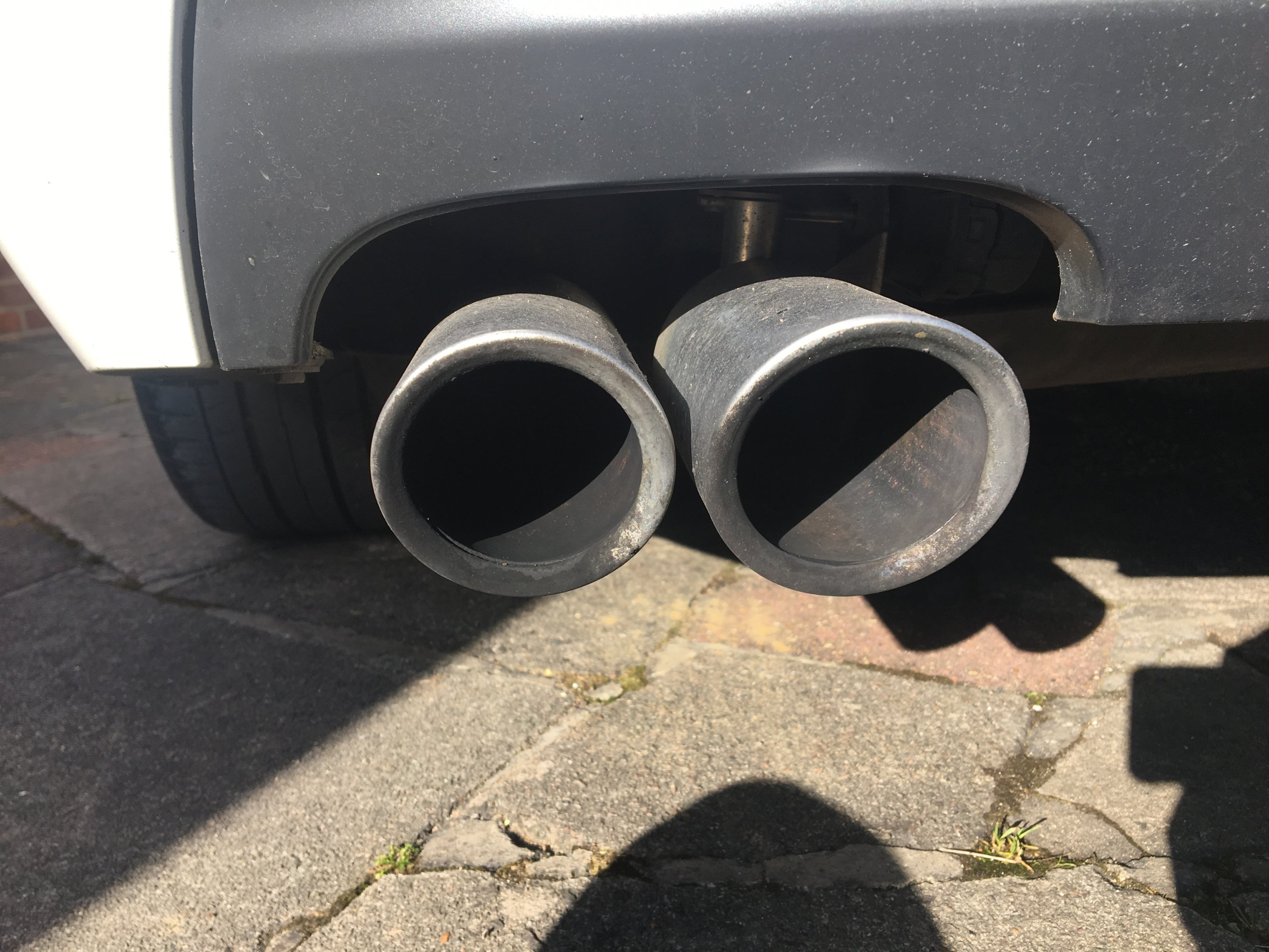

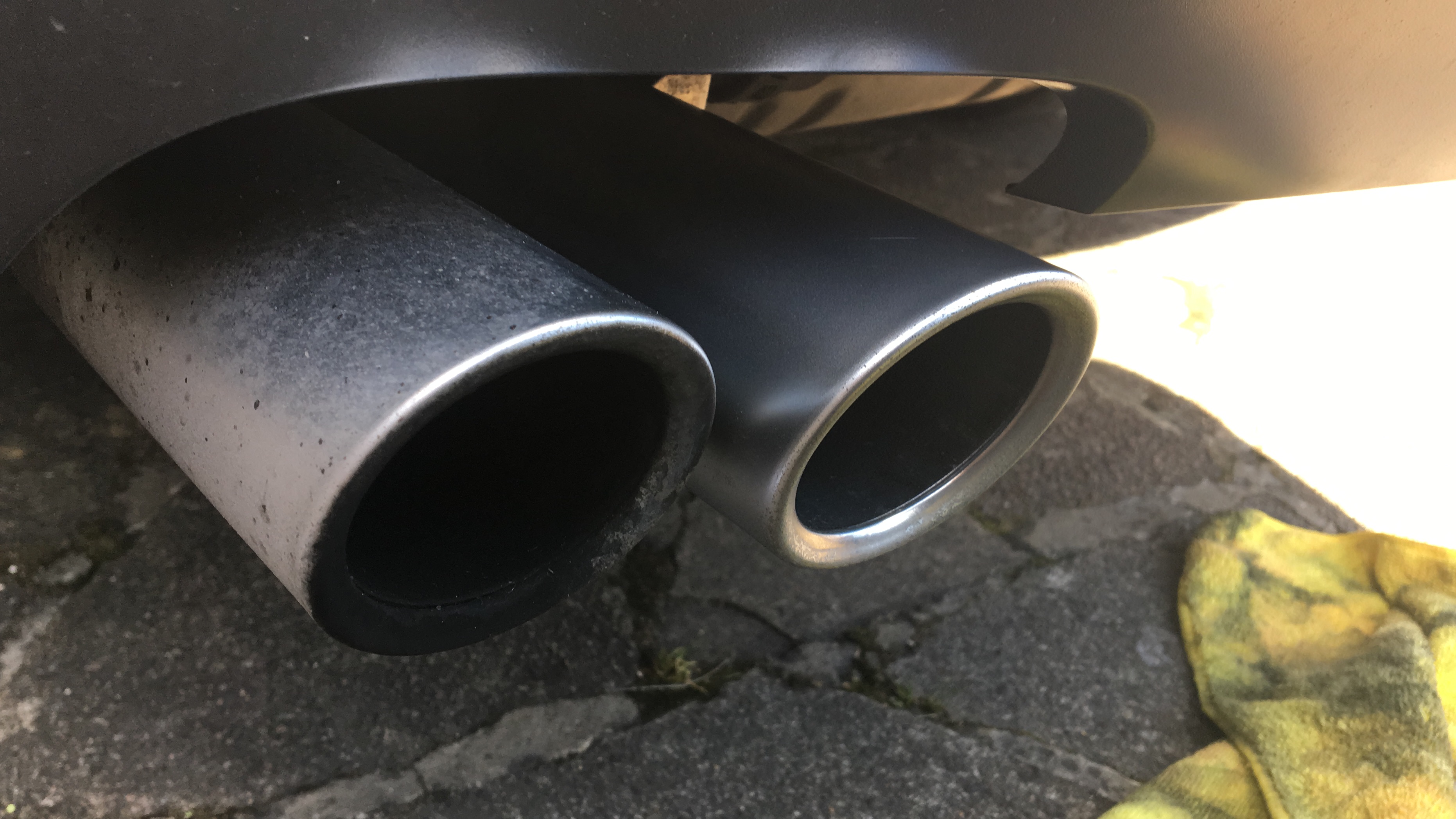

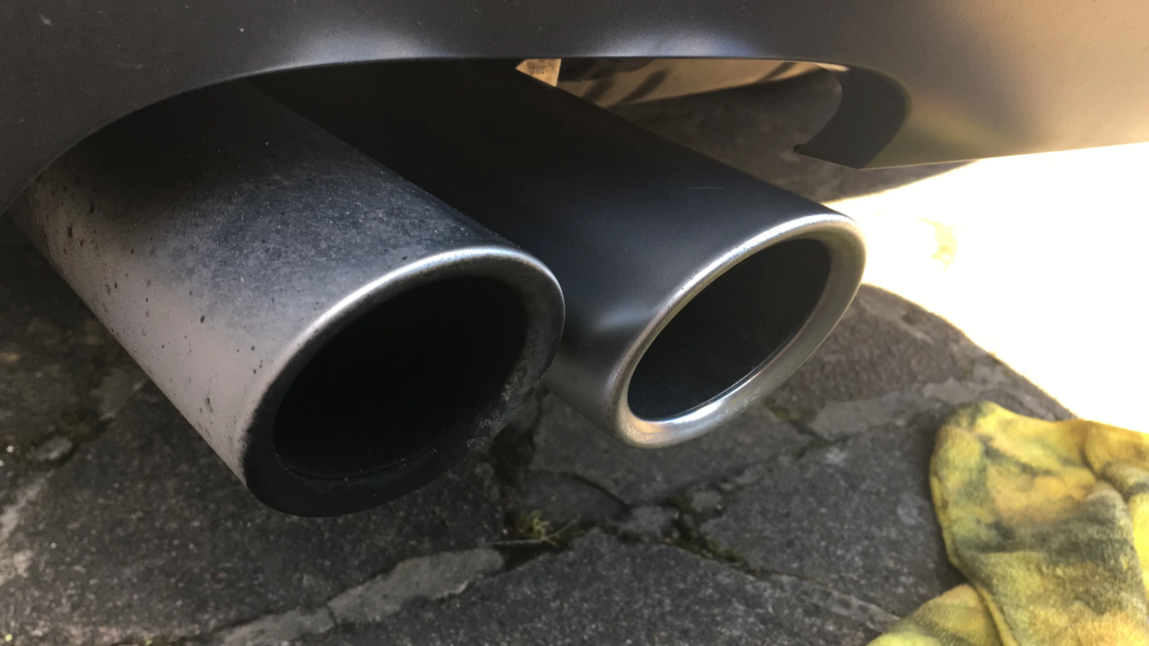

Exhuast tips were a bit of a mess so wire wool and autosol went form this
To this, not perfect but as good as they will get

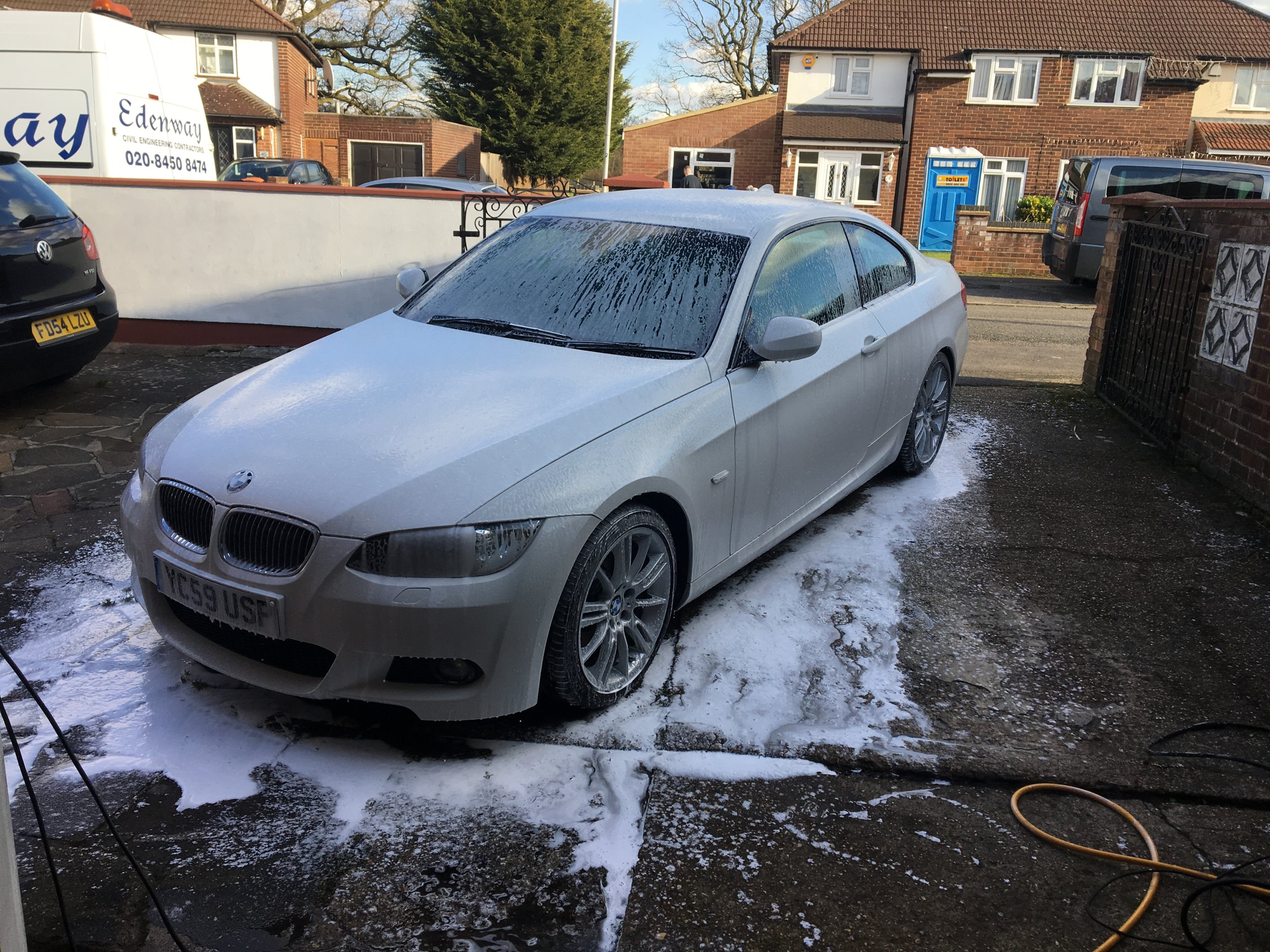

Then had a little detail, sealed the wheels and AF tough coat still going strong.

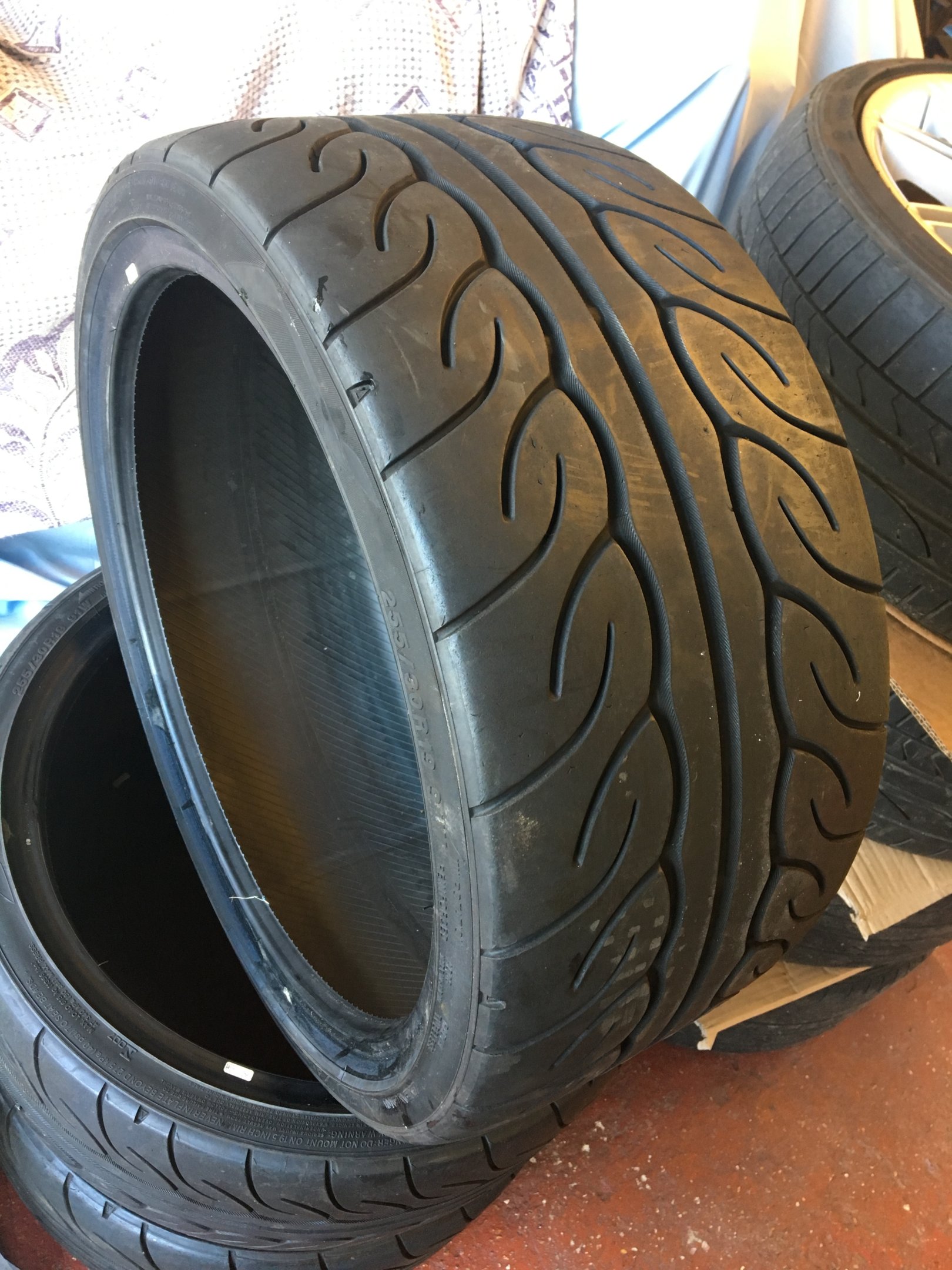

Also decided to keep the MV4's for summer and use the 18's for winter. The 19's needed new rears so bought these at half price with 6mm tread still! (yes I have a spare for the rear - lad was selling 3)
Finally I have ordered a BNG Arkym style front lip which should be here anytime soon. Been debating getting the black kidney's, not normally a fan but I like the double slatted one from the newer M cars, might work with the splitter also not sure. That's all for now!

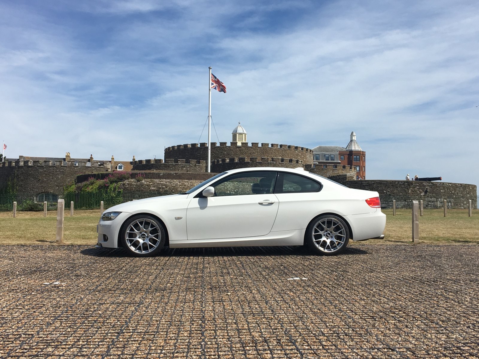

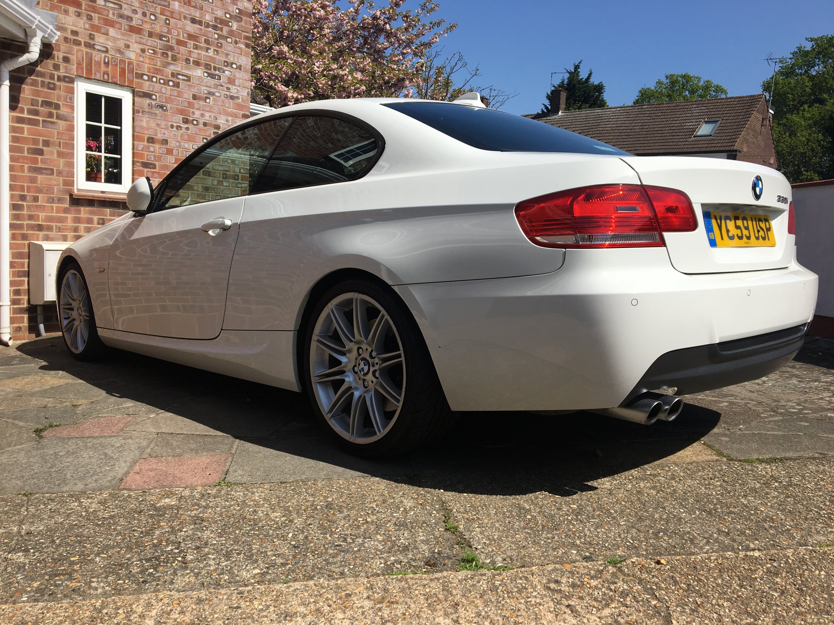

Fitted the 19’s with the fancy rubber and spent a day and half detailing it..

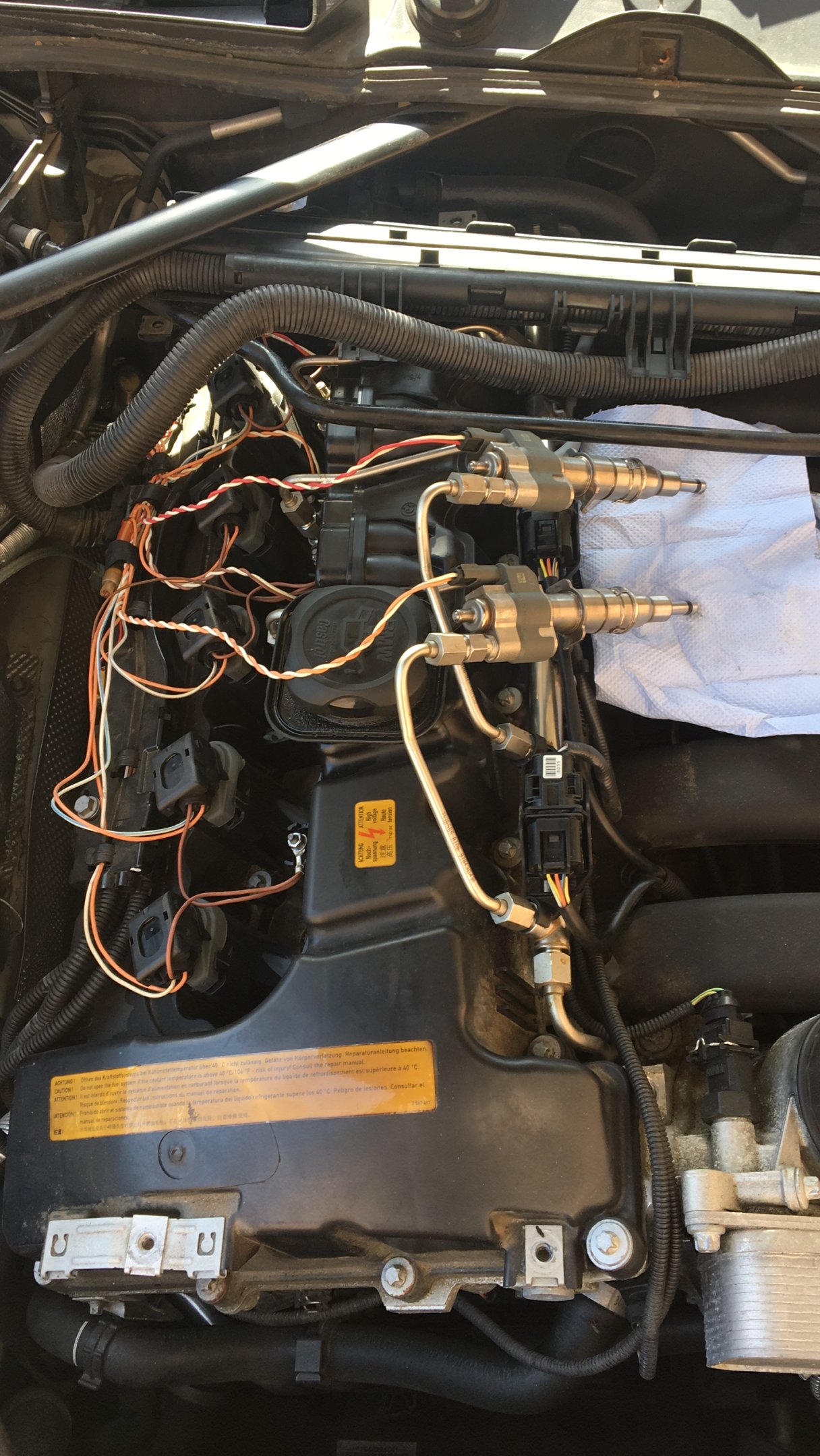

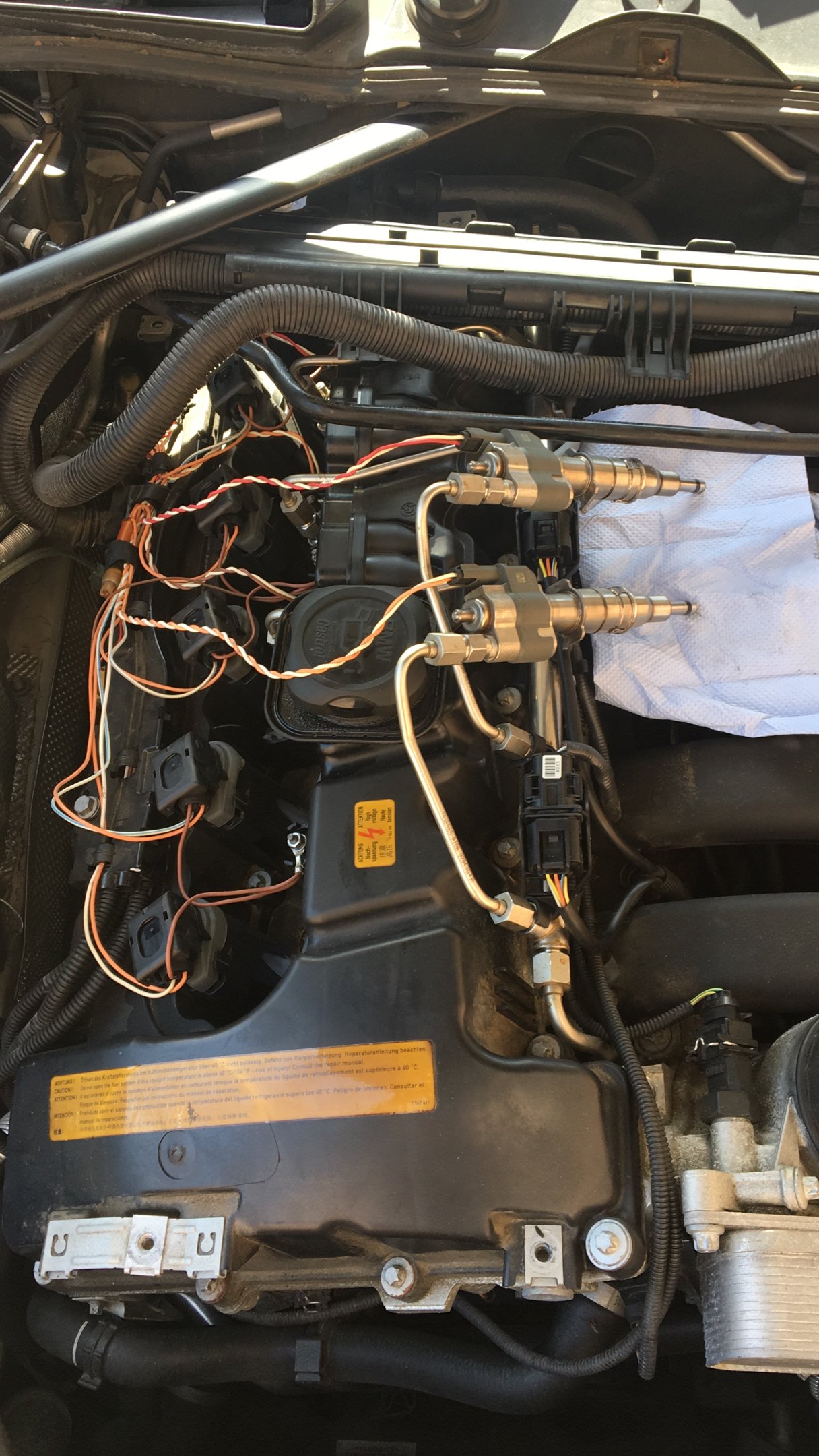

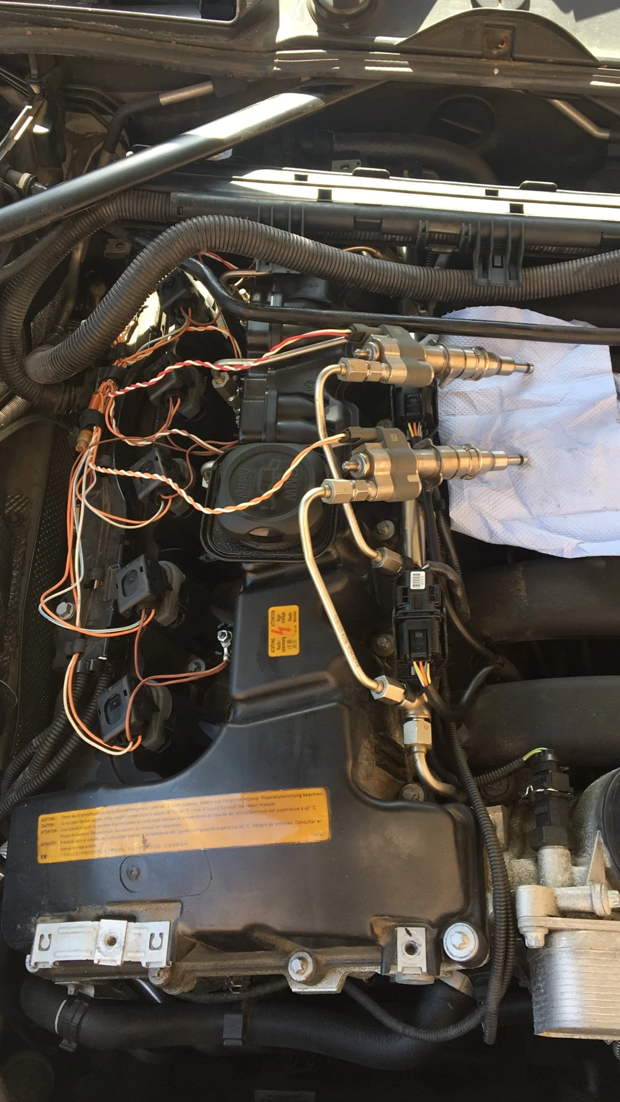

Decided to say thank you by throwing up injector fault codes on cyl 1&6, oh joy. Set up a little experiment to see if they will actually leak
Unfortunately this will be a recurrent problem. I replaced all 6 eventually on my 330i E92 (2008 build date), and within 20,000 miles the dreaded cylinder 5 and 6 misfire fault had returned (even with the latest version). Usual symptoms are rough idling for the first few seconds when cold, before levelling out once the excess fuel has burned off. I attempted to speak with BMW regarding a gesture of good will, as this was the third full set (both rows) of injectors this car had in 80,000 miles, however as the latest injectors were fitted and coded at an indy, they couldn't have cared less. Don't even get me started on the 3 NoX sensors I got through at £550 a pop either haha!
Sold the vehicle in the end for much, much less than I originally paid for it.
Speak with BMW to see if you've had the injector recall carried out on your vehicle. If you haven't, they're still crediting it to this very day!

I rang Bmw before I bought it and they said they only recalled for the coils not the injectors (the first N53 I bought the injector went the next day).

I believe so, there are plenty of threads on Bimmerforum documenting the full details of the recall. I'm absolutely certain the injectors were recalled, as I had the recall notice completed on my BMW online history (version 2's replaced with version 6 IIRC). Ironically though, they're now on version 14!
I went directly through my local BMW Sytner centre (Falmouth BMW) who were remarkably helpful about the whole thing. They accessed the vehicle history using the VIN, and then explained that all recalls were fulfilled on the vehicle, plus the details of where and when (even which version injectors were used).
The chap did say that if the injector recall was not fulfilled, BMW would honour it regardless of whether the vehicle has a full BMW service record.
Also, contrary to popular belief, they can replace single injectors as opposed to entire rails of 3, however, for two injectors fitted the quote was absolutely astronomical compared to the indy ( BMW circa £850 inc coding vs Indy £450).
What symptoms are you suffering? The misfire cylinder X codes are thrown in predominance by the coil packs.
Yeah I have read quite a bit on bimmer forums but that's an american site I think and they only got the N54 which BMW did a recall for. By all means I will definitely give them a call and see whats what as i don't fancy buying them at £250 a pop!
Luckily it does have full bmw service history, so that should't be an issue either way.
Yeah the usual lumpy idle and power down for the first half mile then cleared up once the extra fuel has been burnt off. After a few hours the injector had leaked a little bit so they are definitely at fault.
Fault codes are 29CD 29CE and 29CC , sorry thats cyl 1&2 not 6.

I've just located my old correspondence with BMW UK with the UK recall code present and as follows:
E92E93 325i/330i N53
Defect Code: 0013050200
Description: Ex Fx N53 N54 ECE: Check injectors and replace if necessary.
This is separate to the coil recall which reads the following:
Defect Code: 0012230300
Description: E6x E8x E9x N43 N53: Replace ignition coil (Bosch).
Hope this helps mate. BMW customer service were absolutely brilliant over the phone, very genuine and upfront from my experiences, therefore definitely worth a call.

That’s perfect thank you mate, could’ve saved me a lot of ££, I’ll see how it goes tomorrow! Is it worth calling Bmw uk first or just straight to dealership?

To change the colour of the halo lights is it just a case of changing bulbs in the light unit? Thanks
