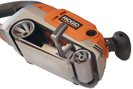

^^ one of these, and some 50 grit paper?
