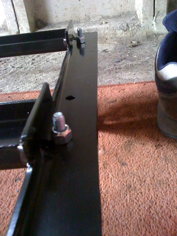

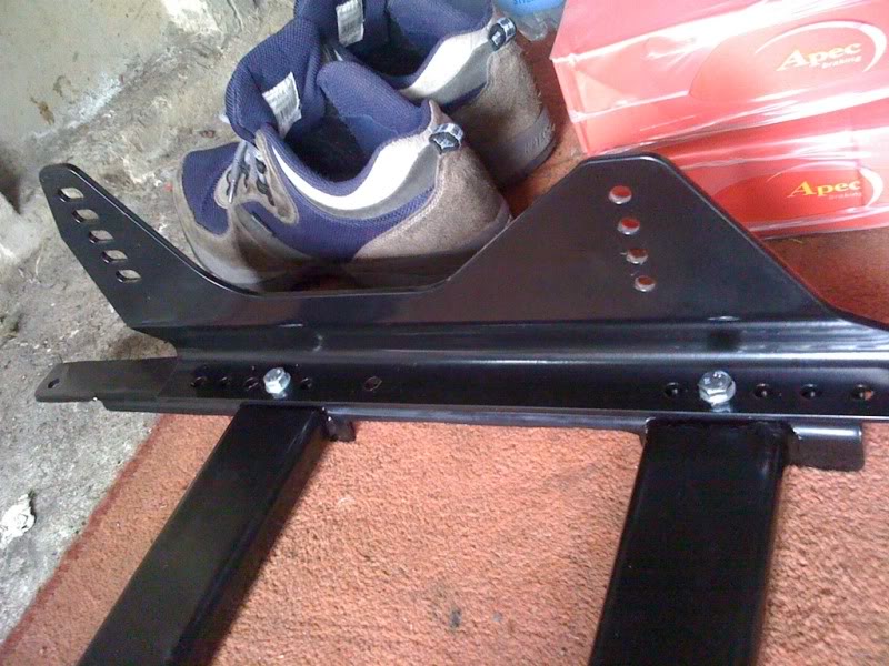

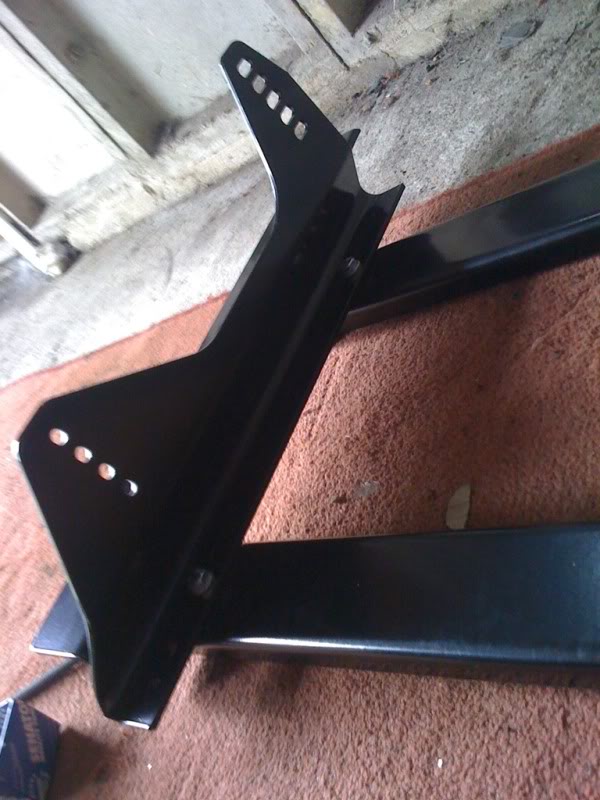

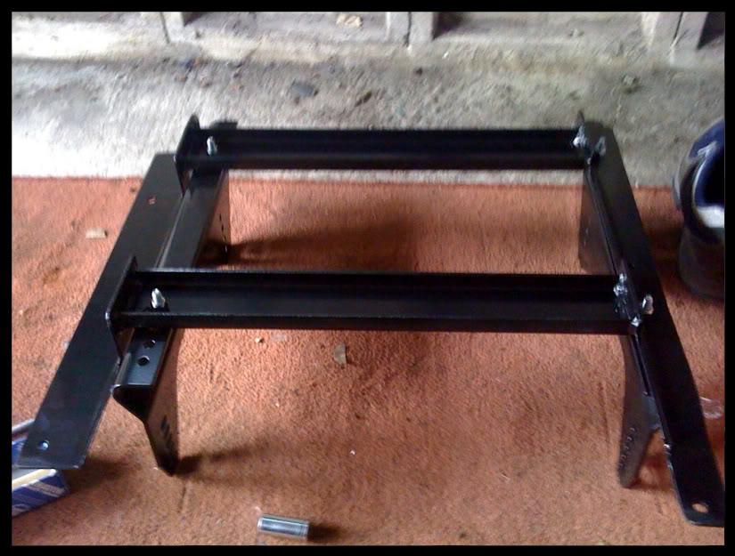

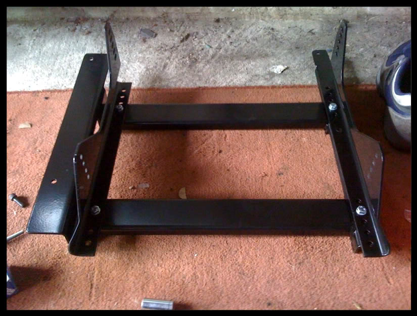

mate i think i already know the answer but i can't really be arsed to look through the whole thread to find it so though i would ask you as you may know better.
do you have any pictures of your subframes / how you attached your sidemounts to the car?
have fabricated some up but am a little unsure, pics of descriptions or anything will help...lol

Re: Bomber's Awesome Ph1 Track Slut
This kind of explains... (I assume your frames are similar?)
Remember to measure from corner to corner before you drill the holes to make sure they are square!
See below... ;)
Copyright Gray Motor-sport Fabrication Department.
they are a little different, i now see why you put the raised right angle on that side, i was going to use 2 tabs but we now fear the rear tab may not be sufficient. hence why i am asking around on how people have done it. i will update my thread shortly.

I tried using spacers / tabs on my original design.. but it didn't work, plus your putting alot of stress on a 1"~ square area which you are bolting to the floor pan.
exactly, hence my thoughts after various research to just bung the holes in the exhaust tunnel and to run bolts through the rails (in the chassis) and possible through the floor to some spreader plates underneath

Seat, sidemount, floor, sorted :)
