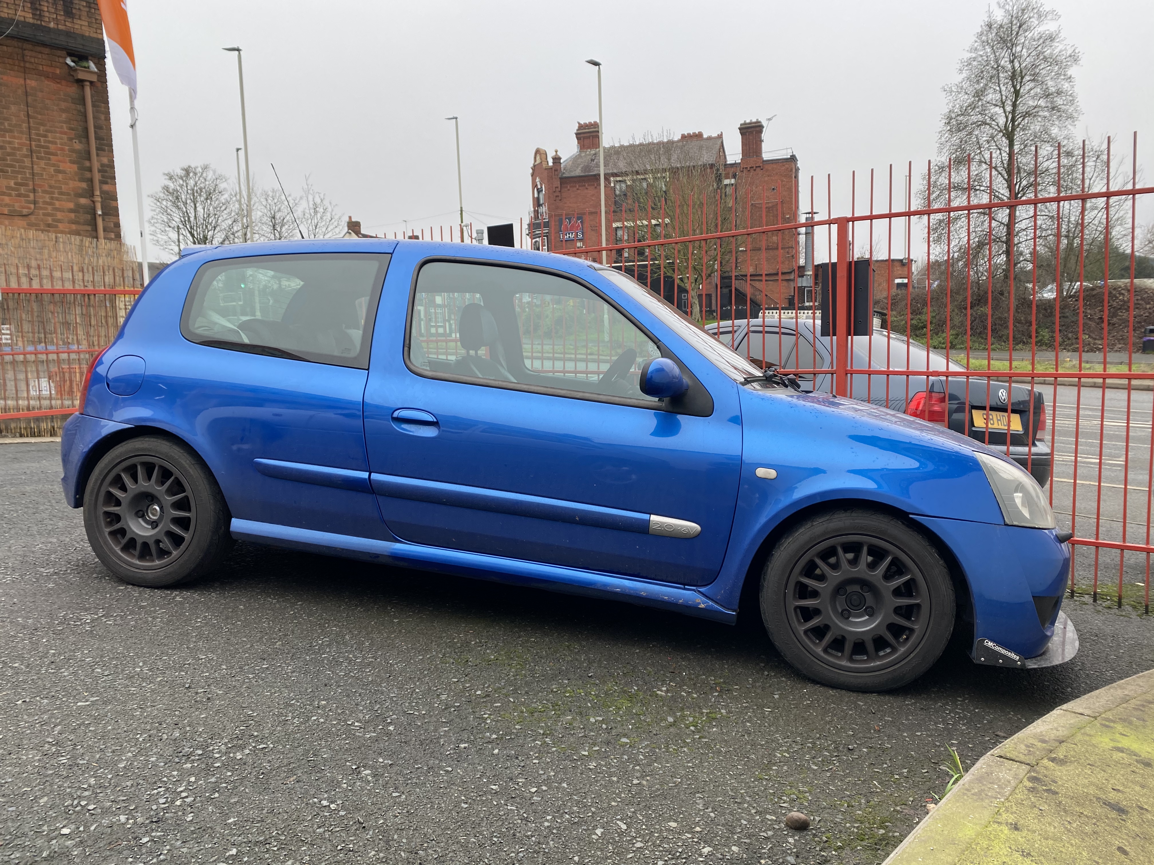

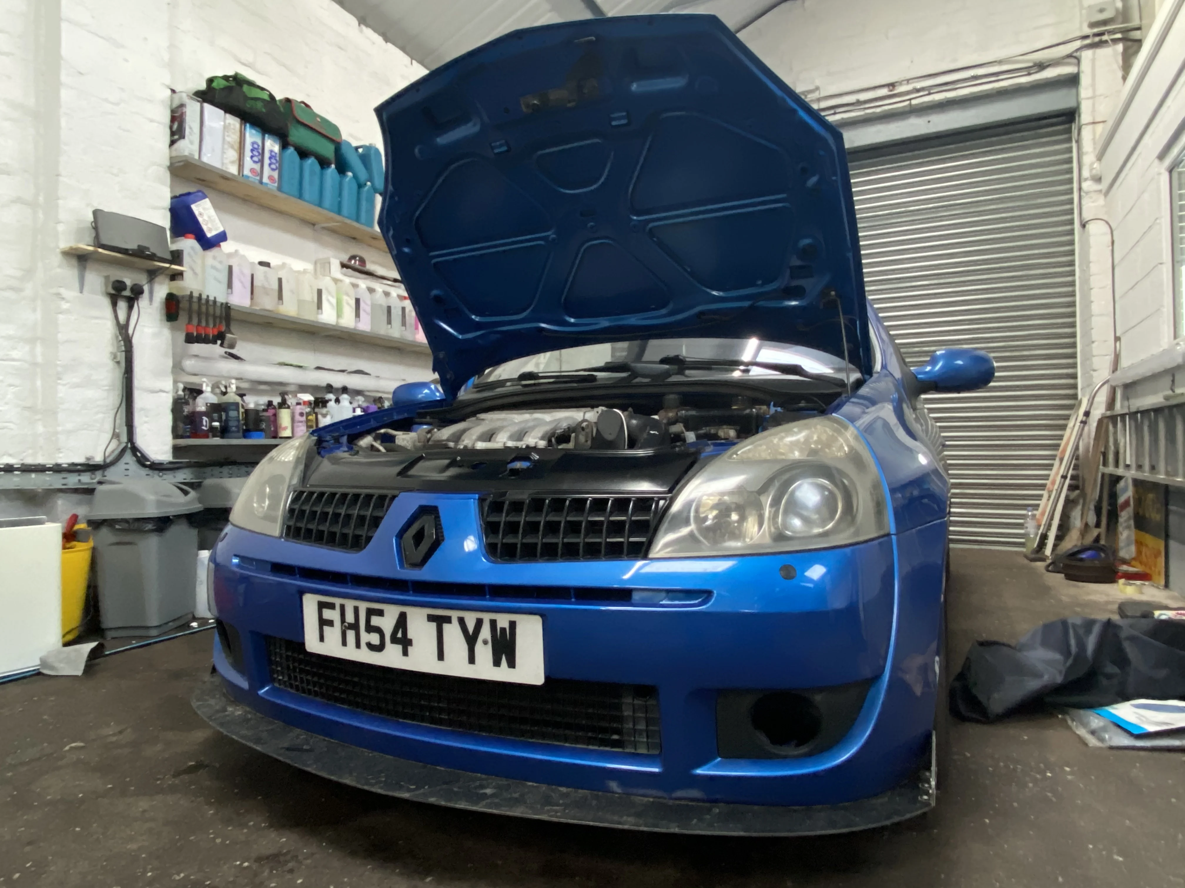

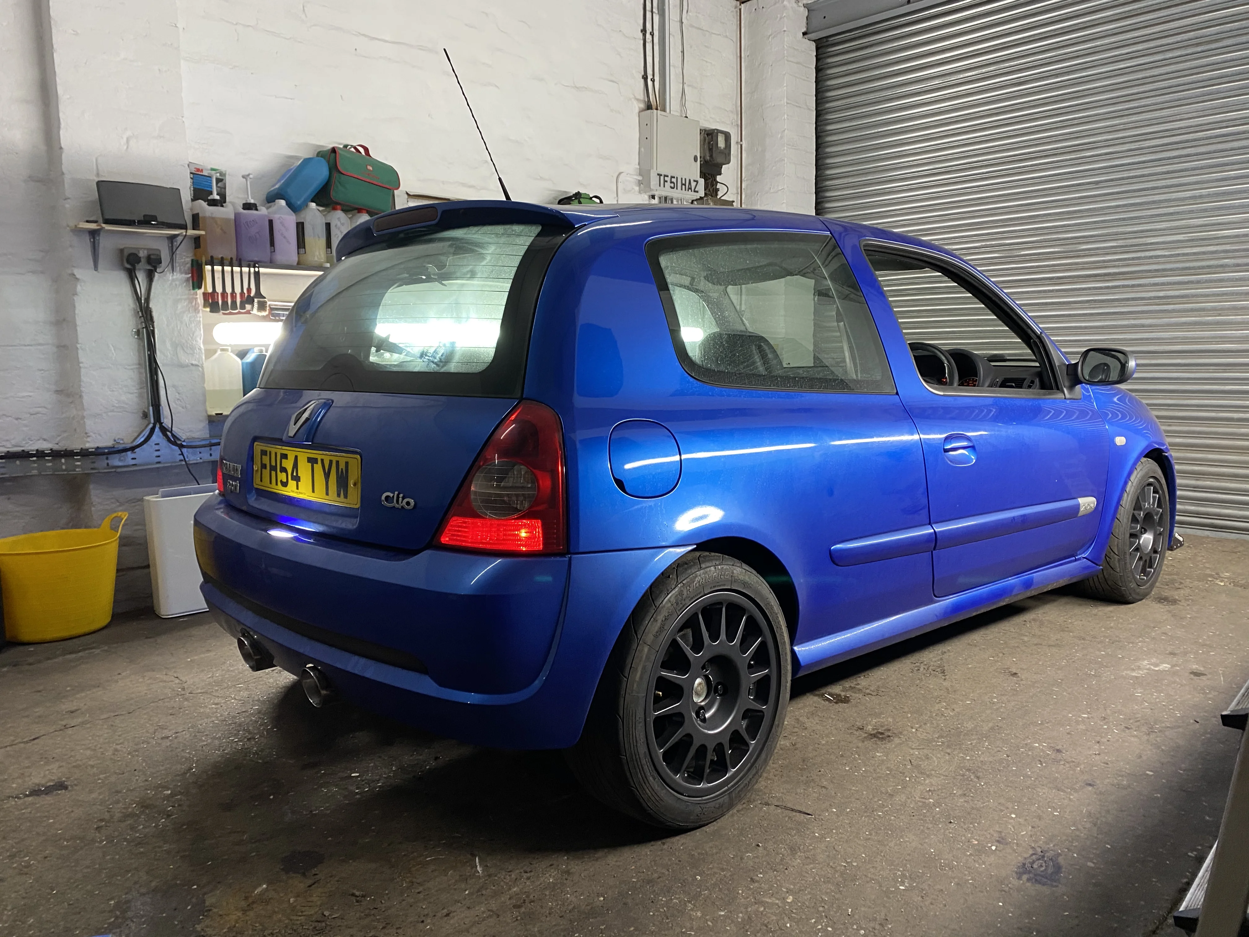

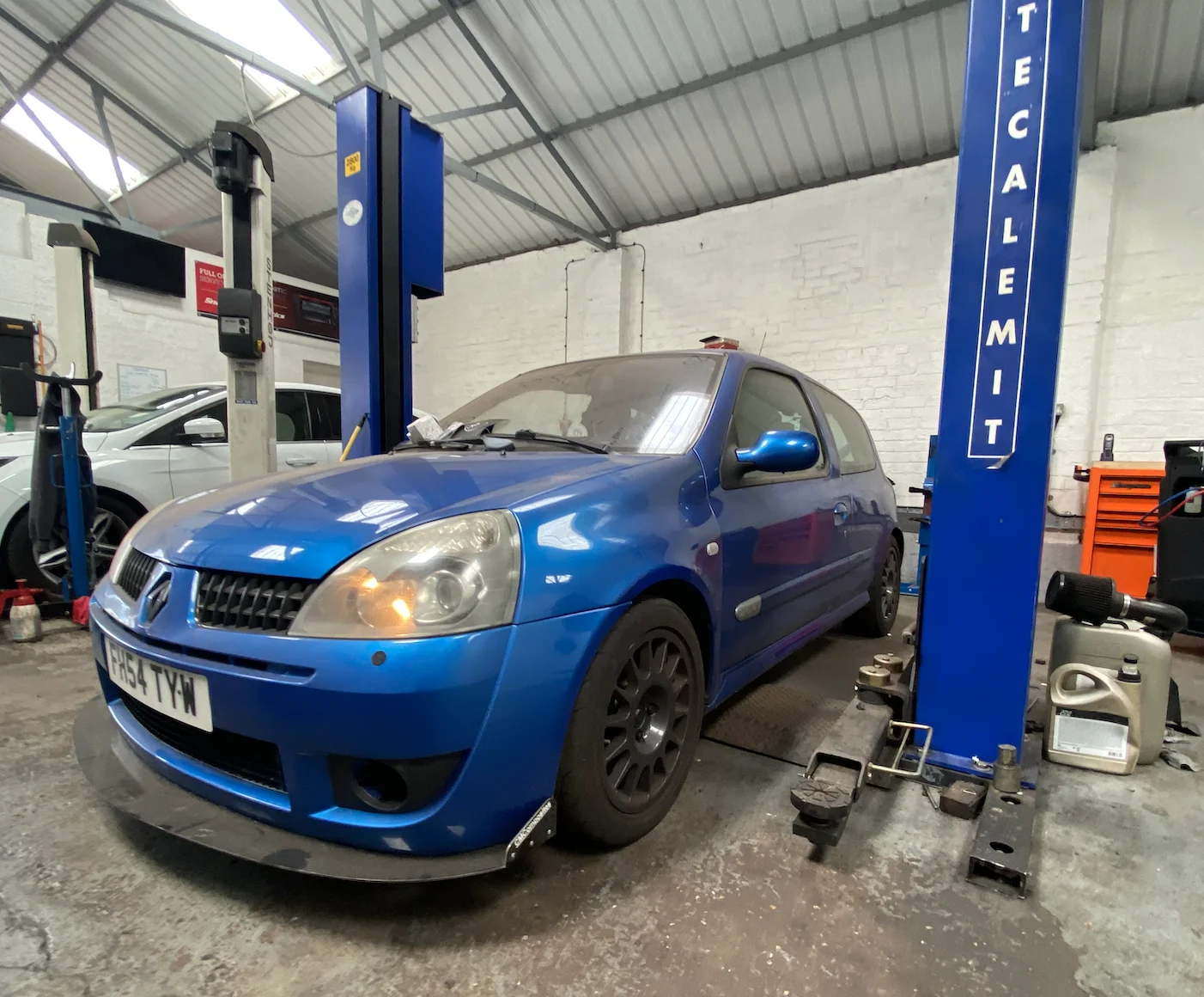

This beauty came up for sale in Wales at a price I couldn't refuse, so I took the trip and drove it home. Just over 100k but feels tight to drive, this is added by a few mods like solid engine mounts and remap to name two, I was happy. Only downside being a notch into 4th gear occasionally.
Plan is to refurbish the gearbox with a LSD. Whilst on the subject, do people know if the cheap diffs listed on the likes of eBay are any good? Seen one person recommend it.
I've got a front splitter to fit and some grams exhaust mount bushes and centre exhaust bush!

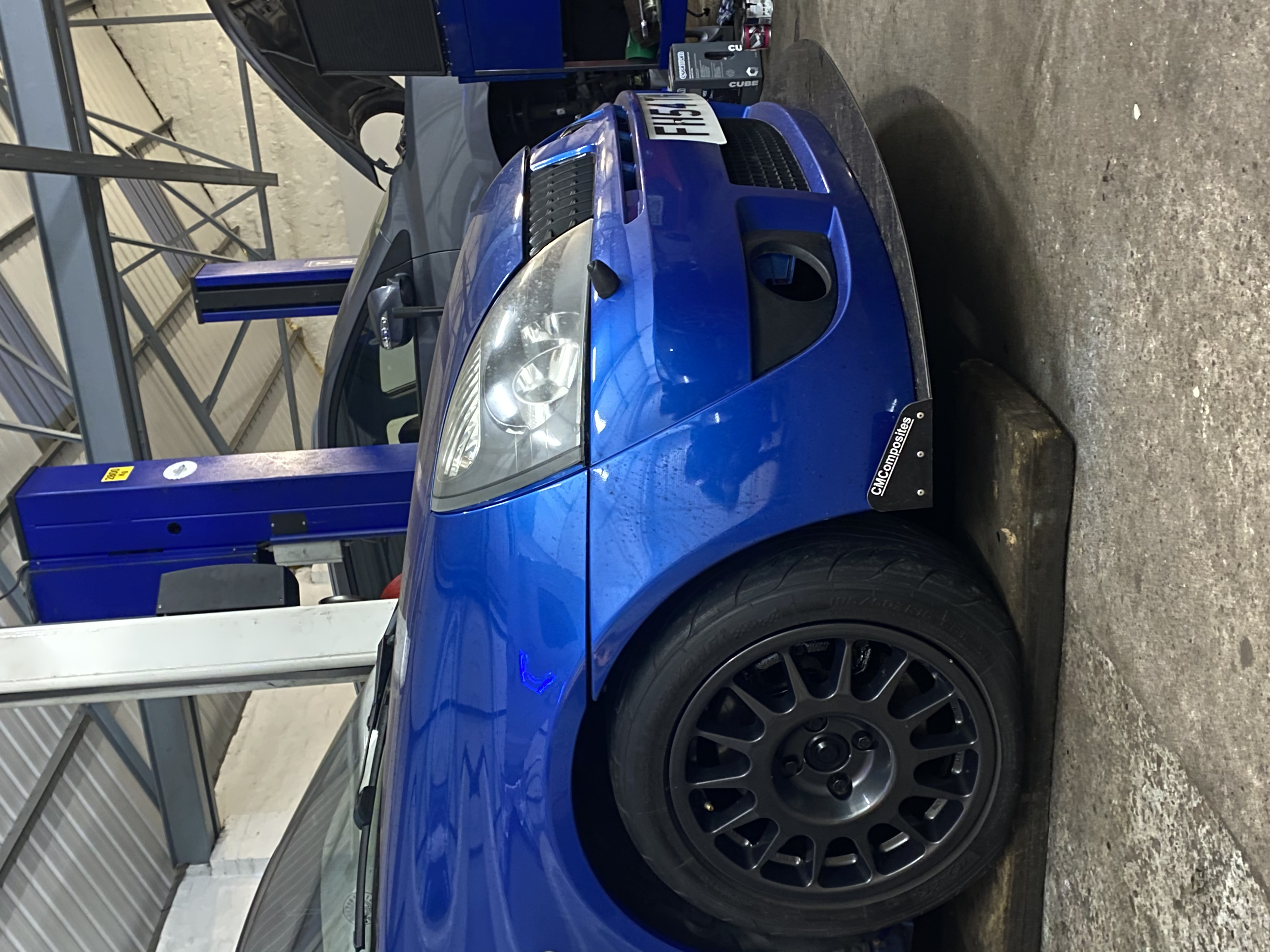

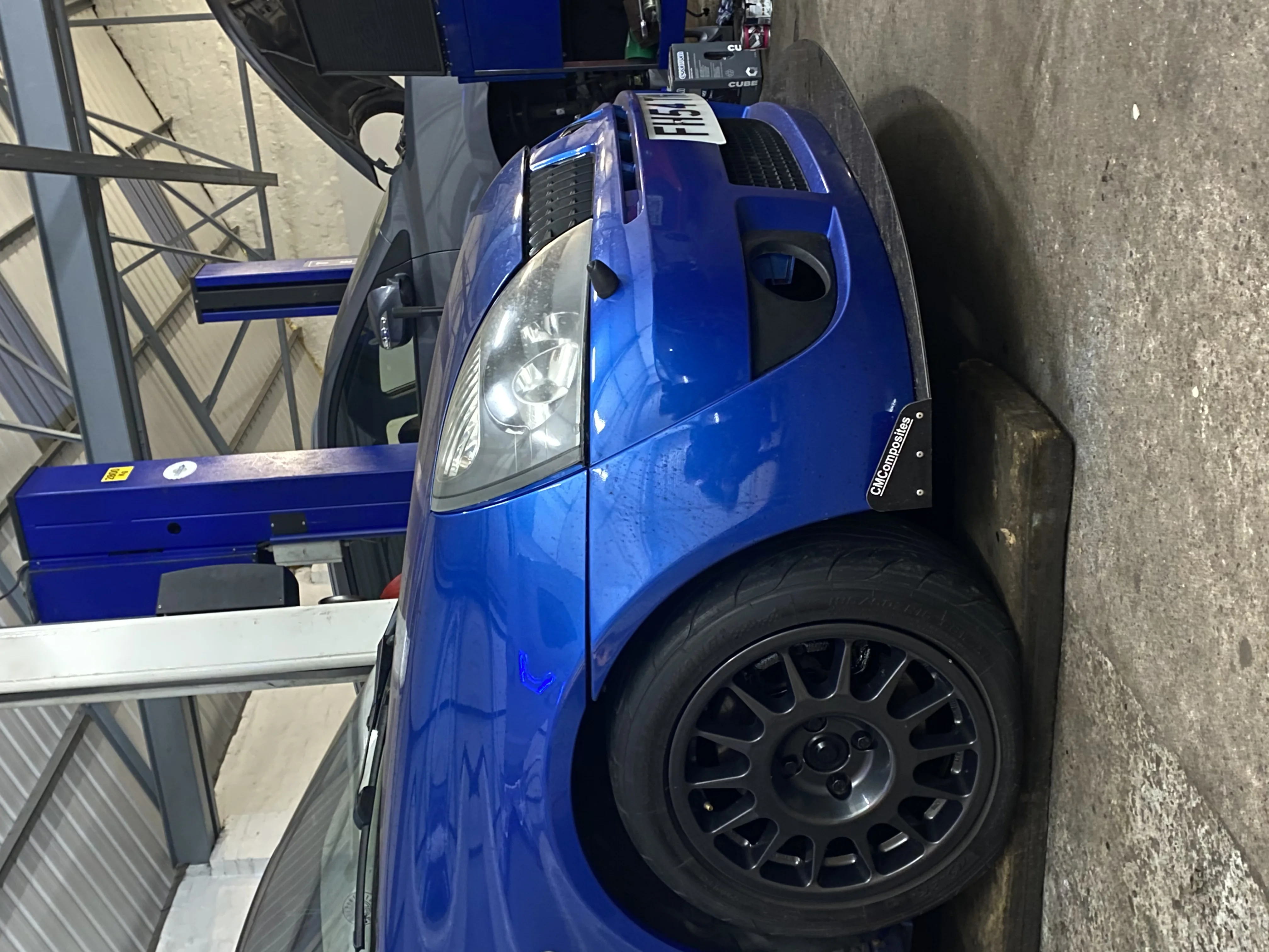

- Fitted CM Composites front splitter

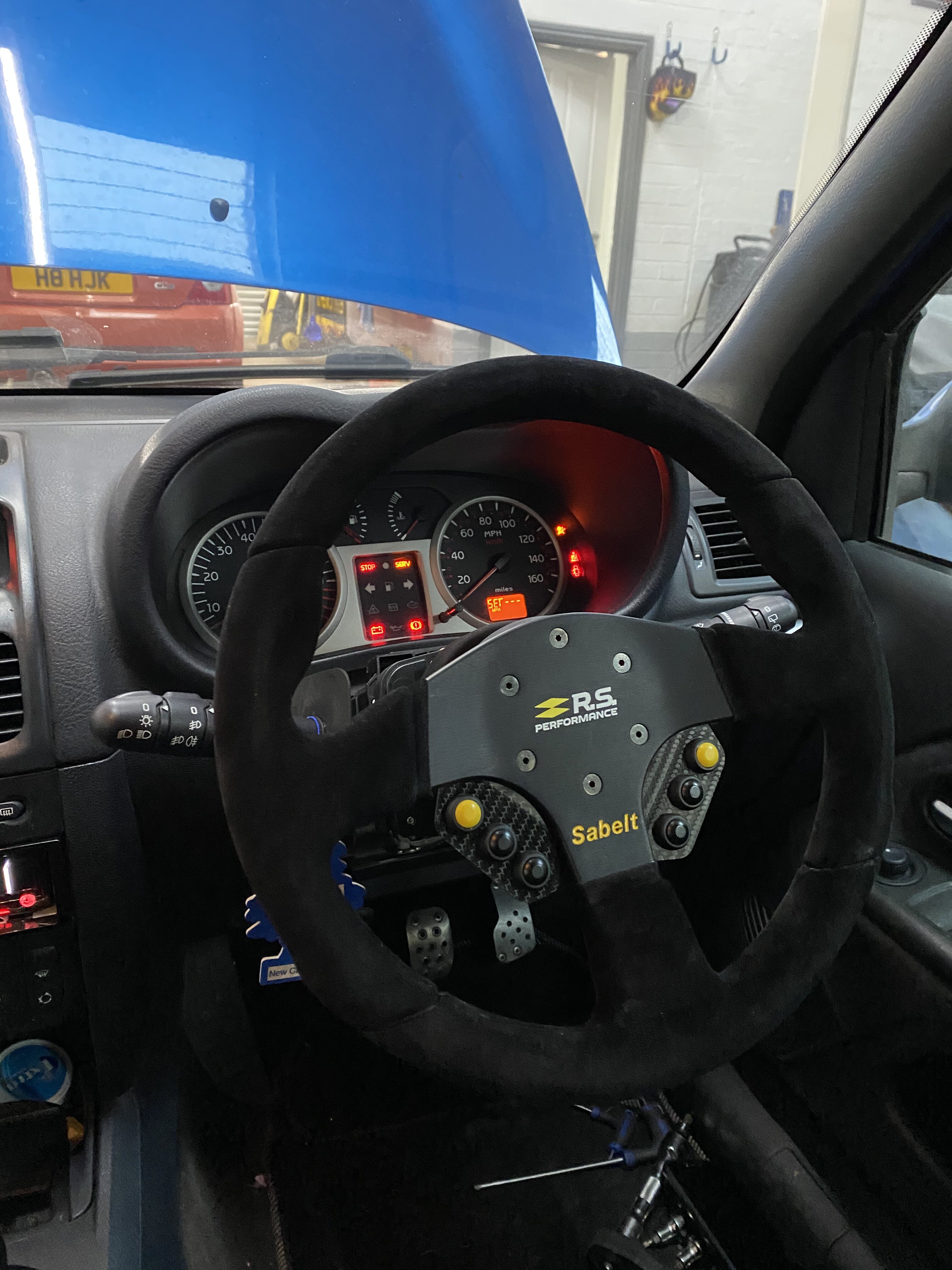

Finally fitted my Sabelt RS steering wheel fitted with the Volantech 6 button panel, which is amazing!
Having problems getting my airbag light out though. I've just tried some 3.9k Ohm resistors and made no difference, anyone have suggestions?

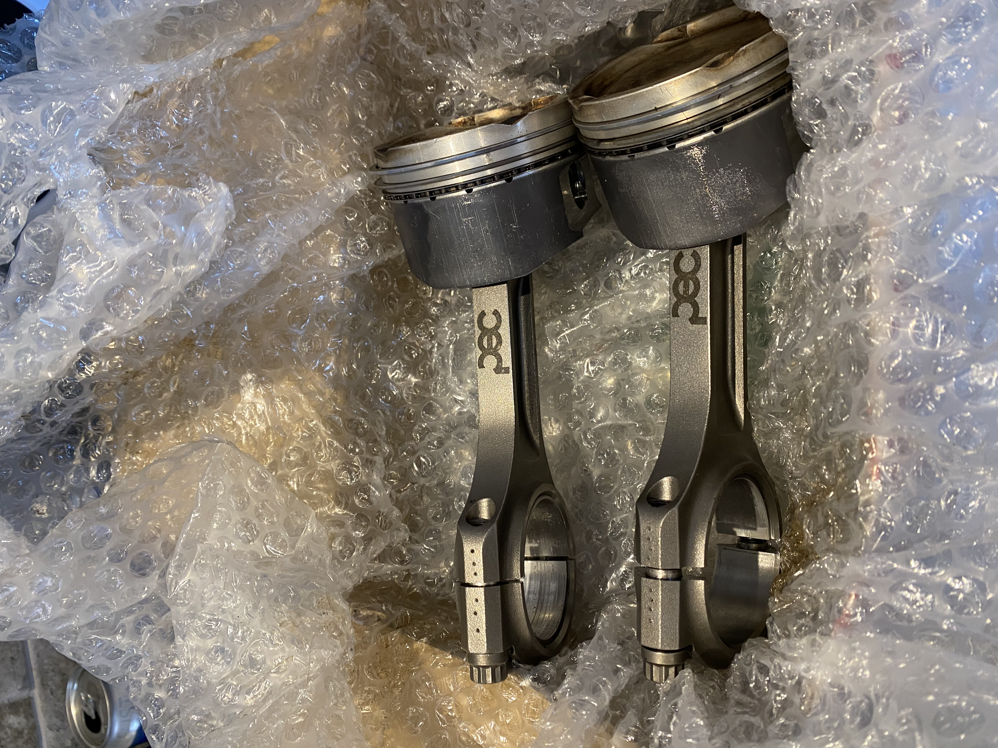

Also something exiting is that I've begun collecting turbo parts. Currently got TRW Downpipe (ordered), Turbo, Wossner Pistons and MaxSpeeding Rods. Can anyone recommend what else I should be changing whilst the engine is out to be forged?

3.9kohm is wrong, you want 3.9ohm mate.
Or do it properly and get access to an rstuner or clip! Was super satisfying turning all the lights off mine 😂
Wheel looks great.
Wheel looks great.
derp, definitely an error on my part. I'll get the 3.9 ohm ones ordered now!!

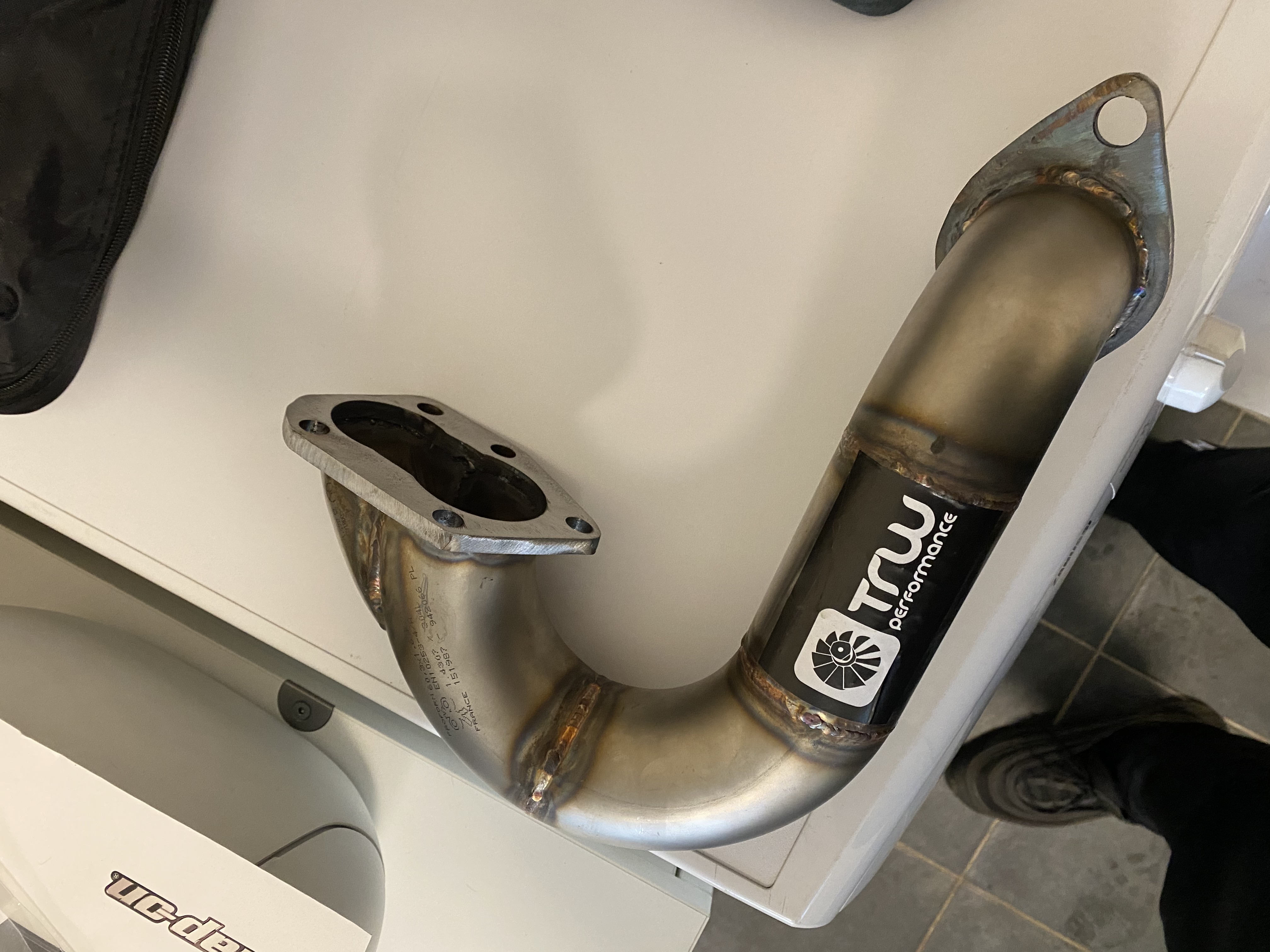

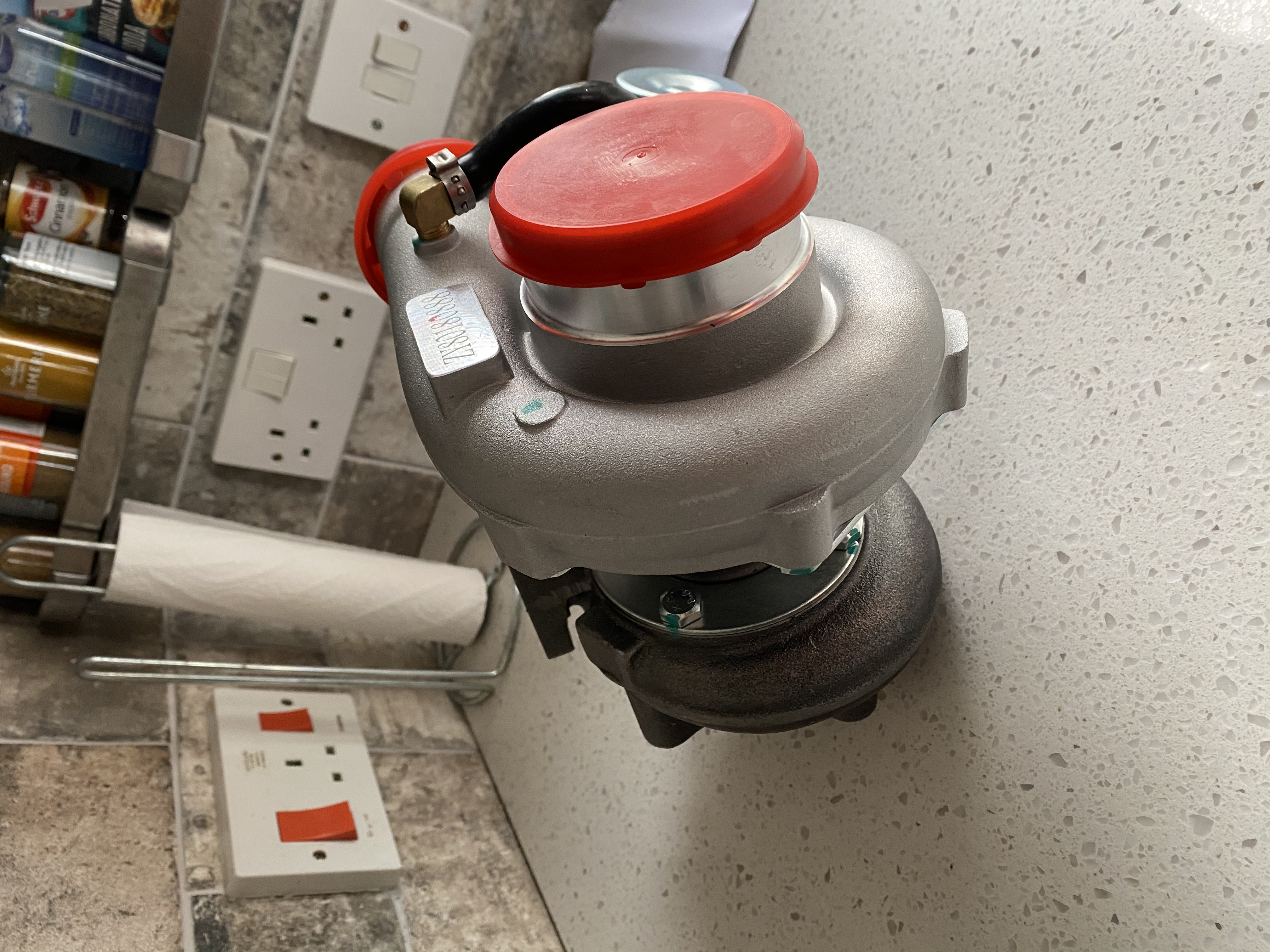

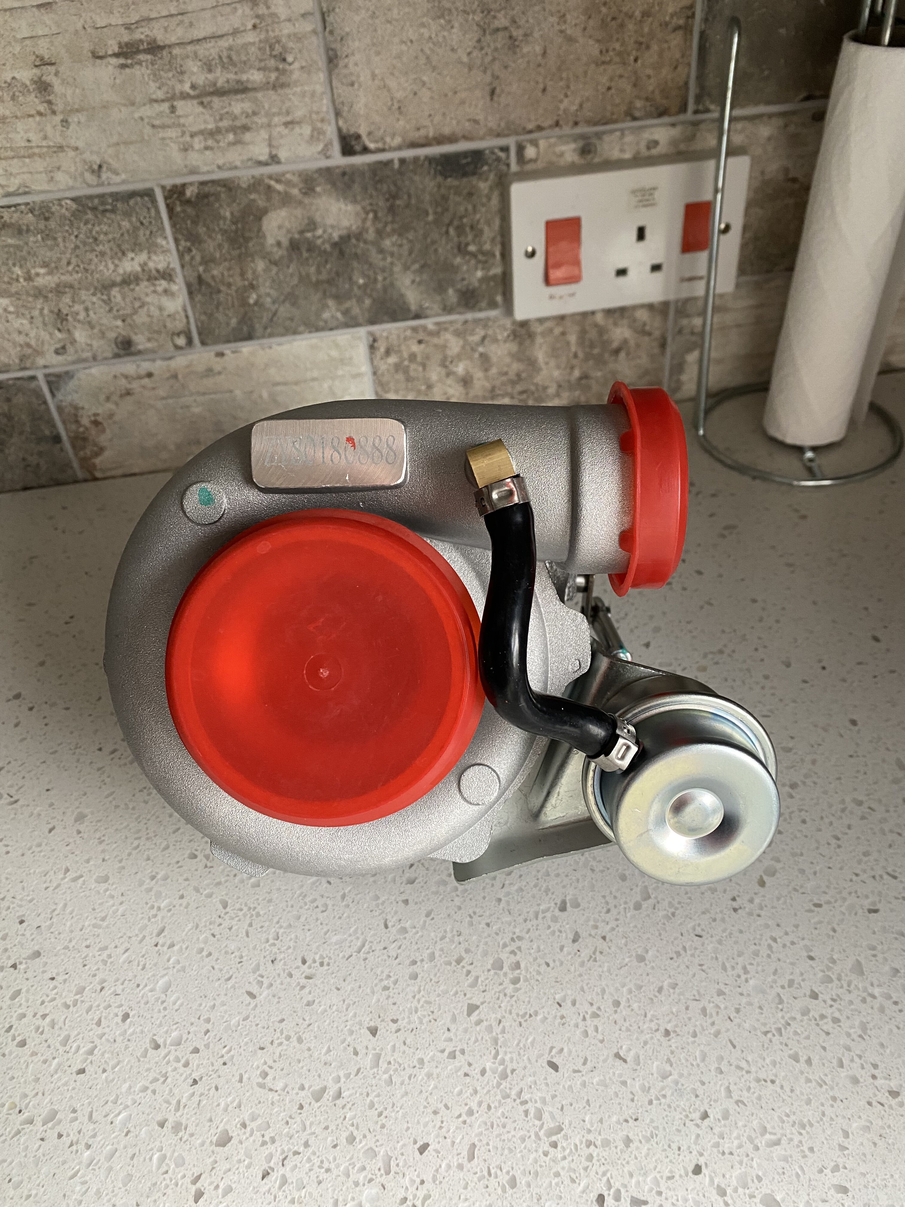

The 'Wuhan Whistler' as it's been named on Facebook by many people turned up today.

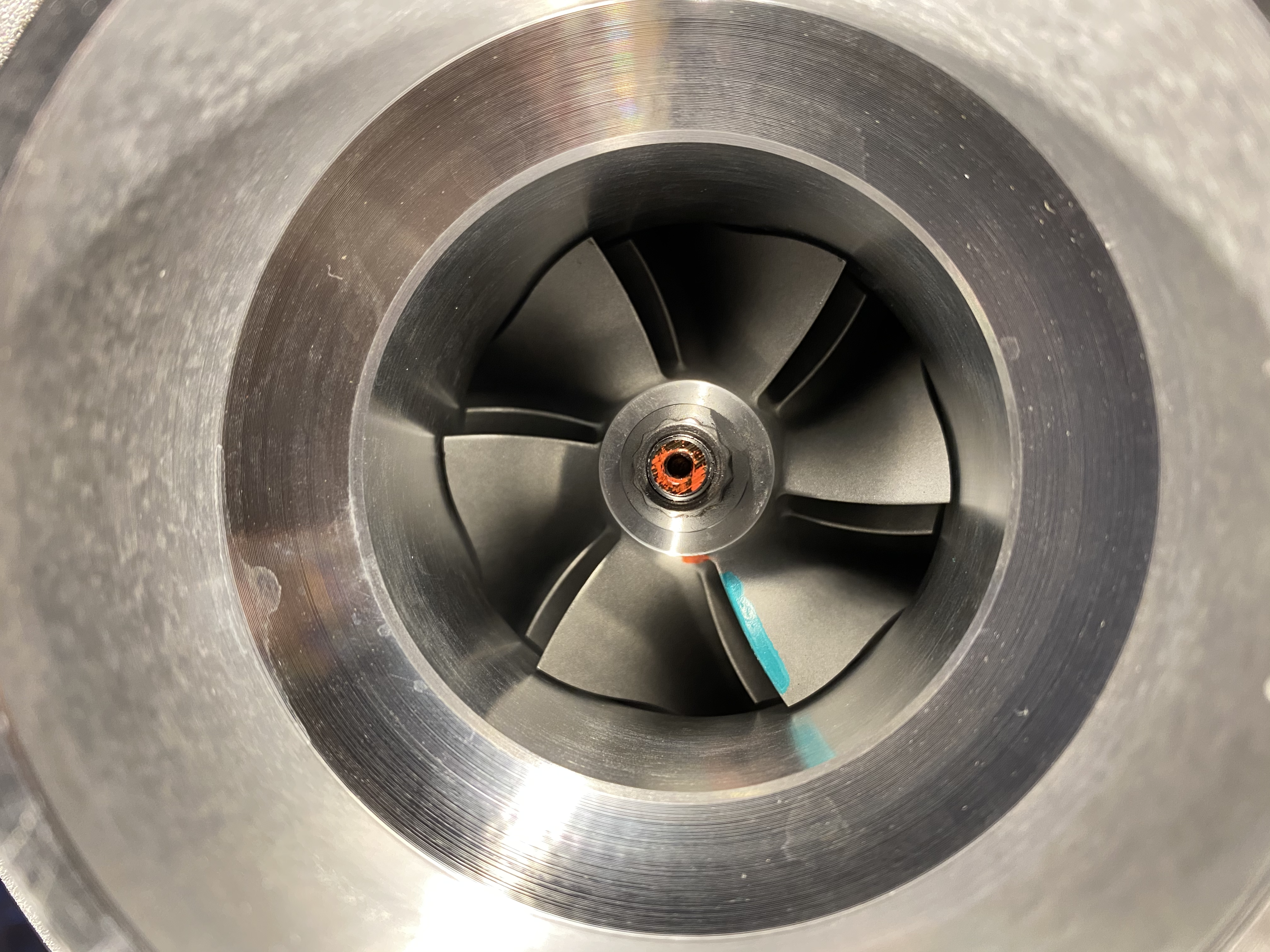

It's not a permanent solution, its just to get the car built sooner. I must comment though, a few people recommended this turbo and the quality of it feels not too bad! Let's hope its all good :sneaky:

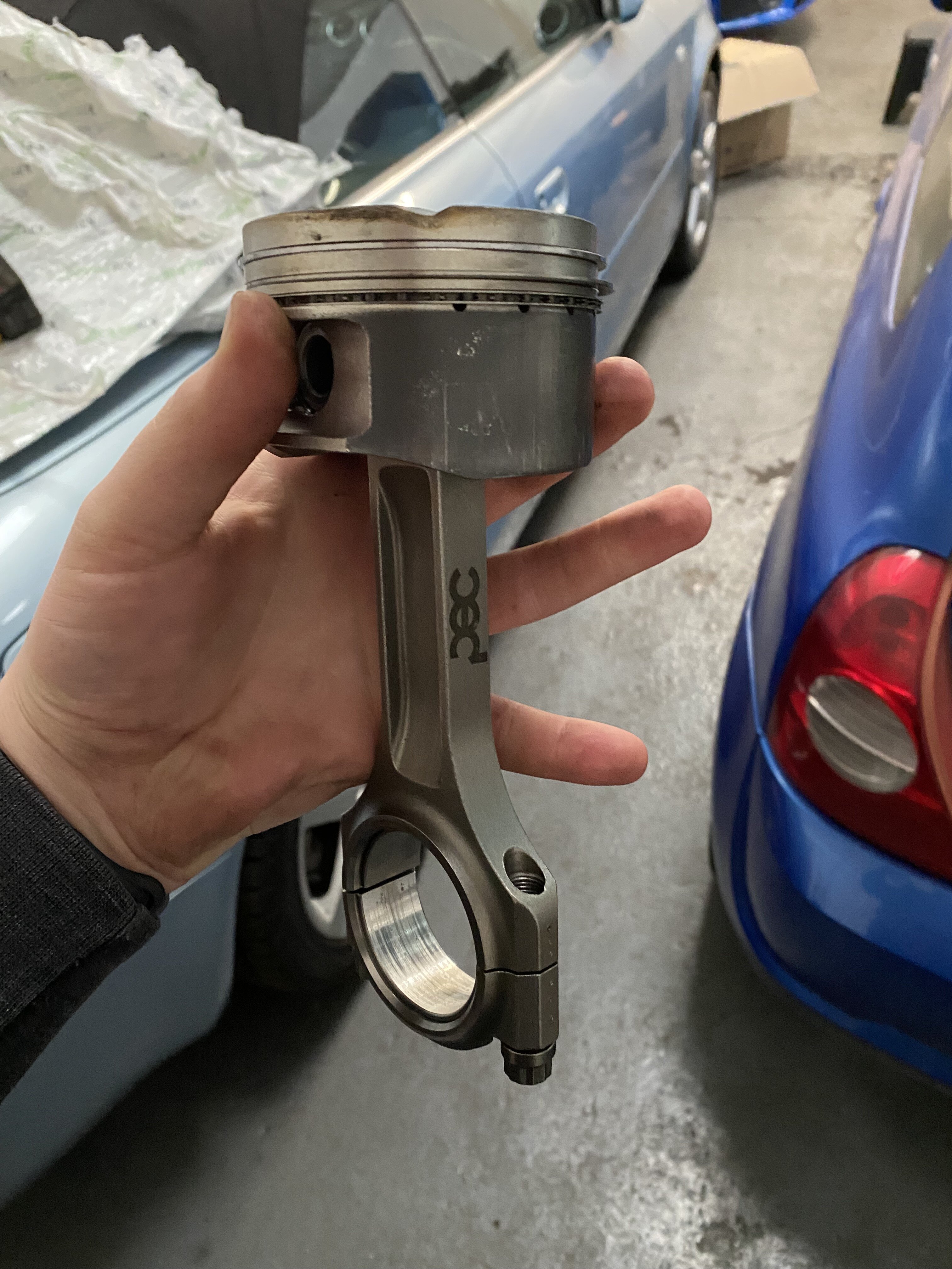

My MaXpeedingrods rods turned up yesterday too, and my Wossner 8.5:1 Turbo pistons will be here tomorrow hopefully.

I'm pretty much there with parts now for the build, just need to get my engine out really to start the rebuild with the forged parts, only problem finding time to take the box out.

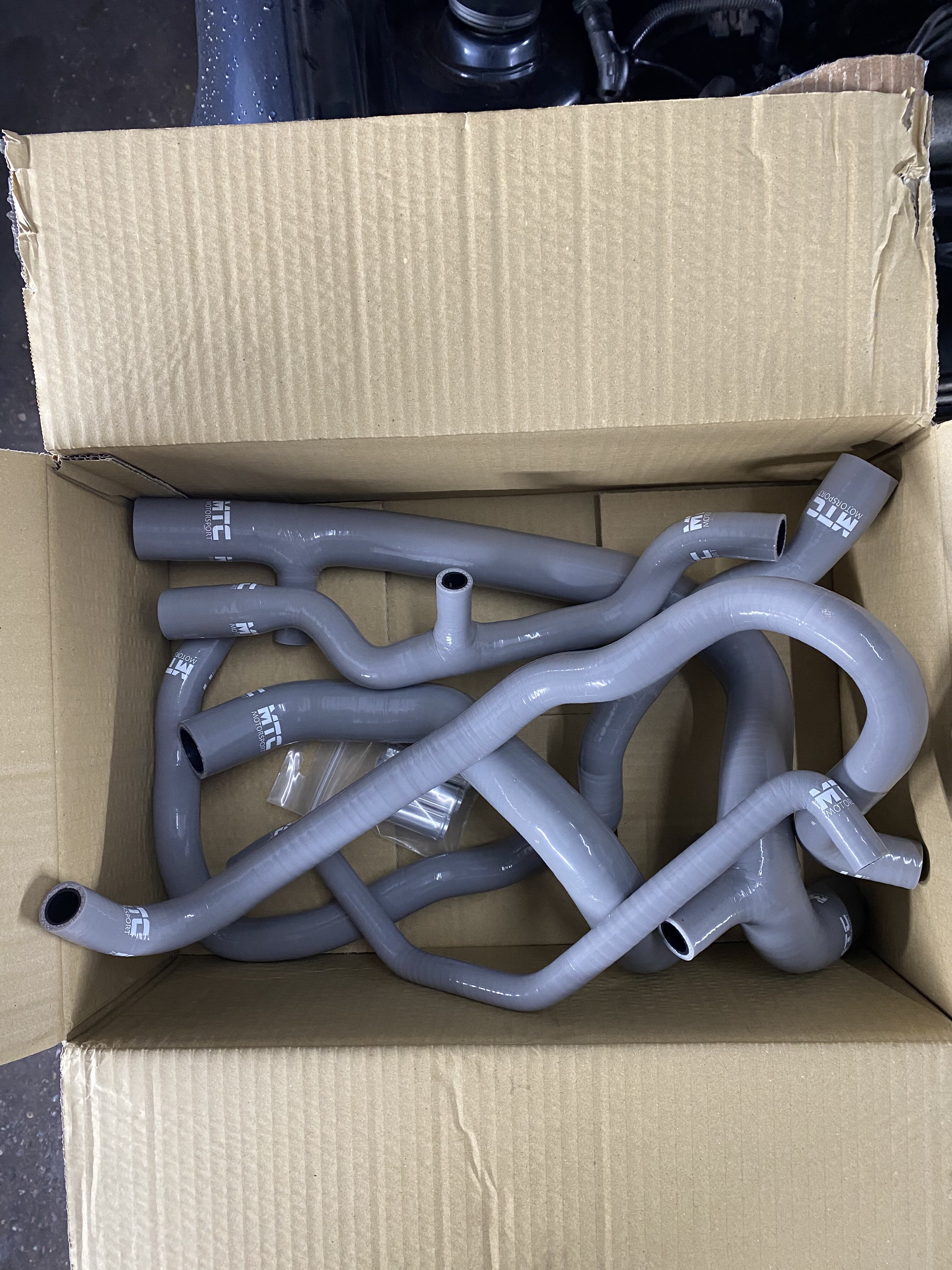

MTC Coolant hoses turned up yesterday, went for grey as got a blue/grey thing going on.

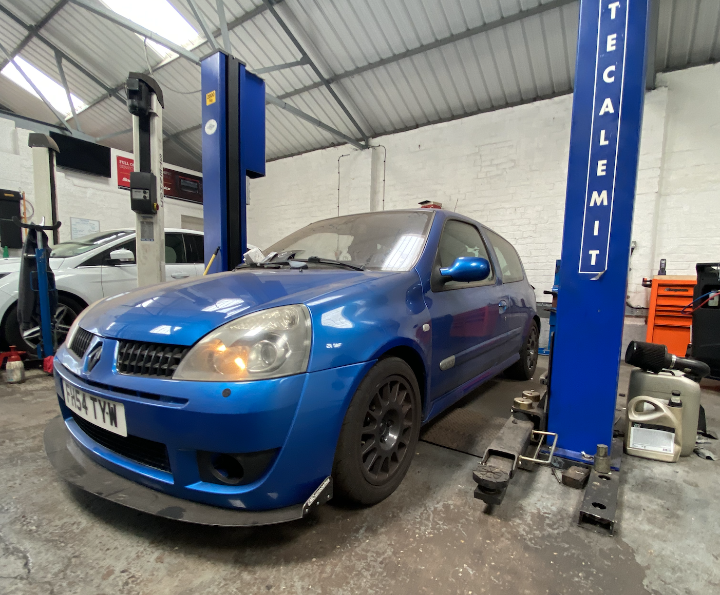

I'm going to try get the car on a ramp one of the weekends, rip the engine out and push the car in the corner of the workshop until it's done.

Finally got plans in motion, the engine should finally coming out next week to be re-built and forged.

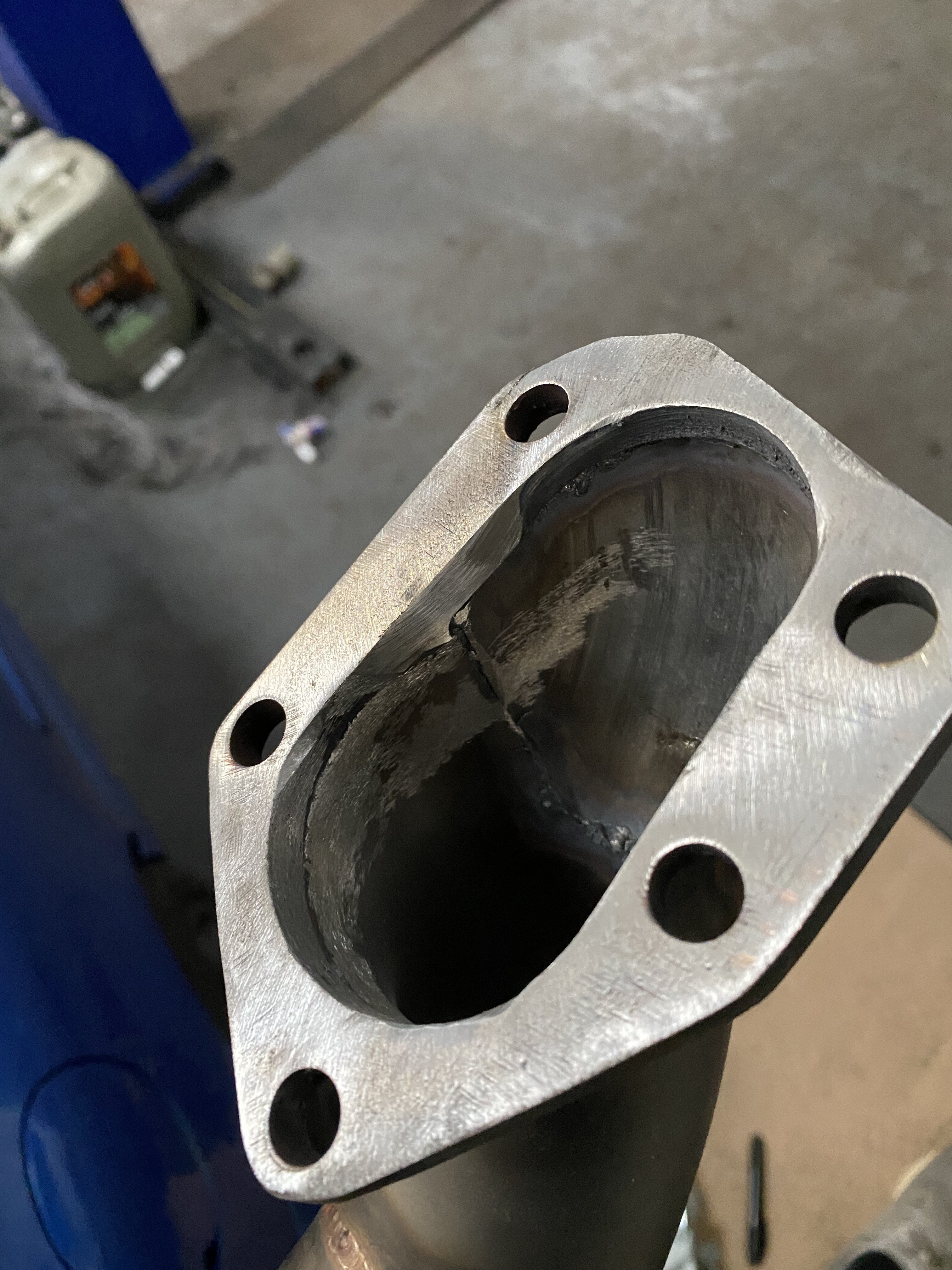

I've been working on tidying up my downpipe and turbo today, as you can see the waste gate hole is rather small!!!
Where should I be getting oil lines from for the turbo? Also need some heat management ideas for the bay. I've gold heat wrapped my intercooler pipework and will be heat wrapping my downpipe... What am I using on the bulkhead? Anything else I should pay close attention to keeping cool?

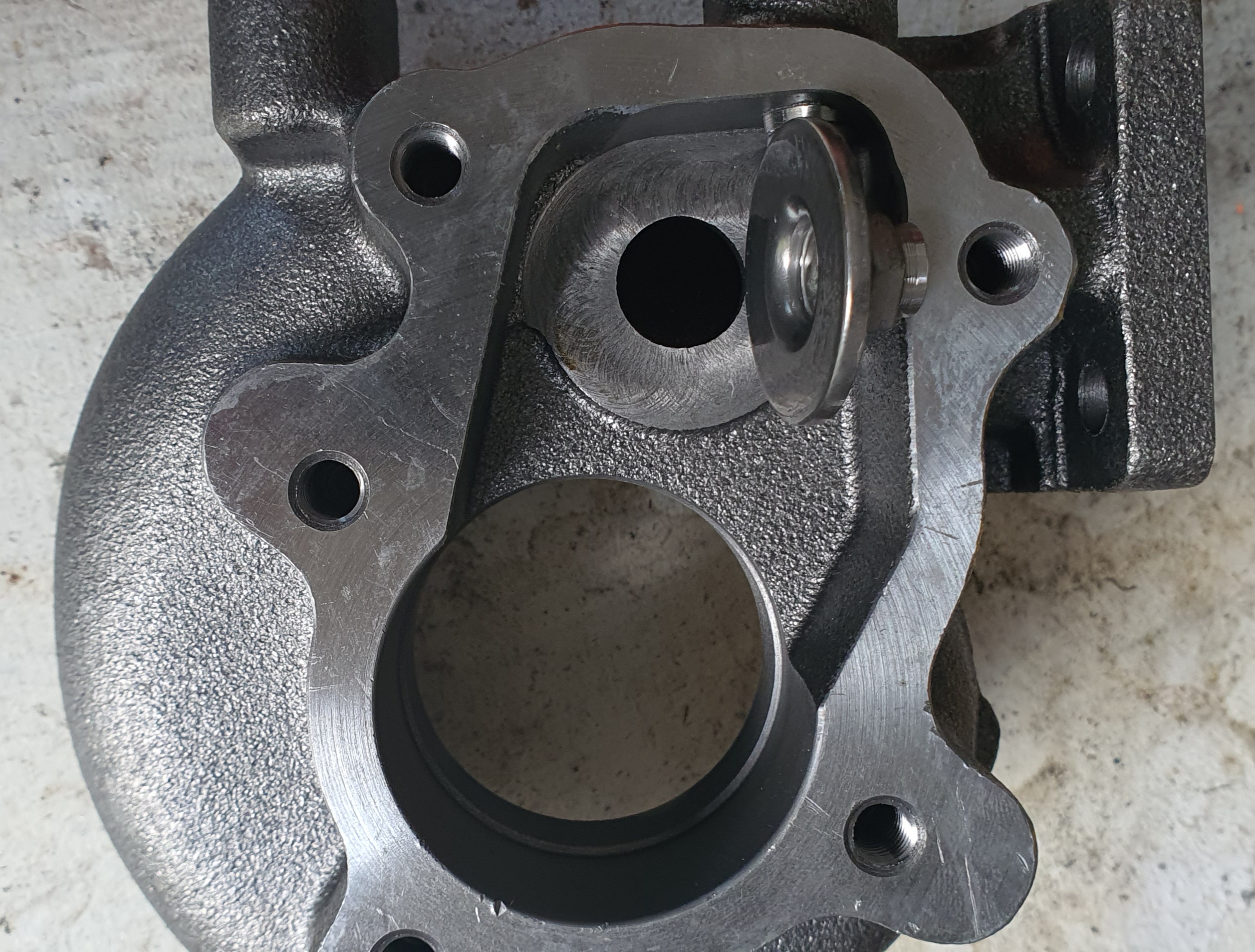

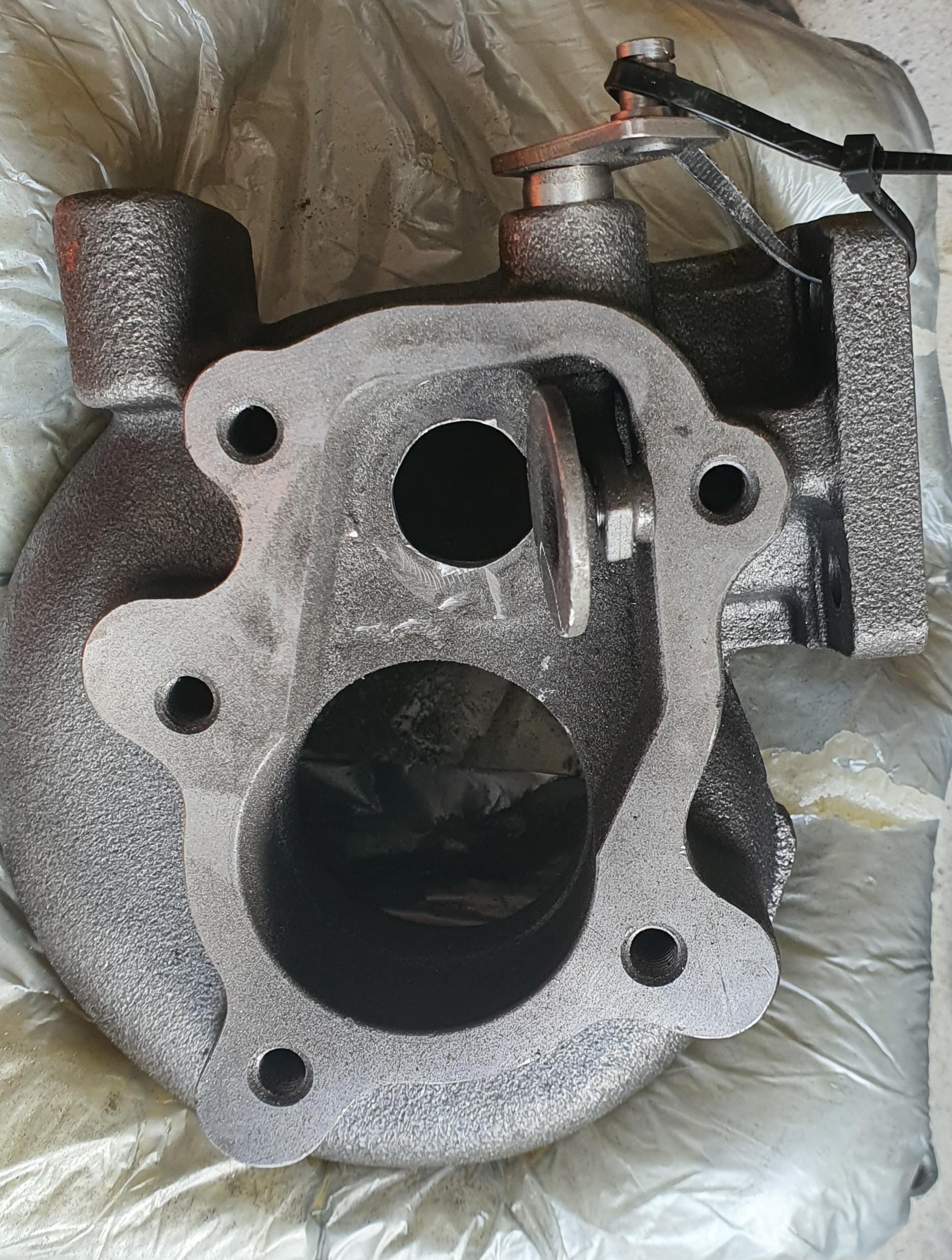

I ported my wastegate out a fair bit:
Should stop boost spikes with luck.

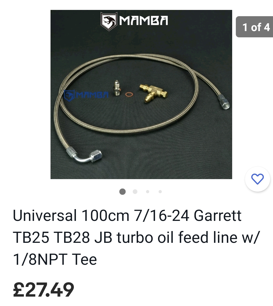

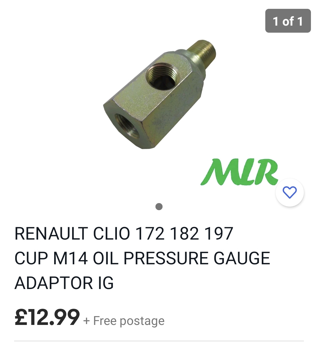

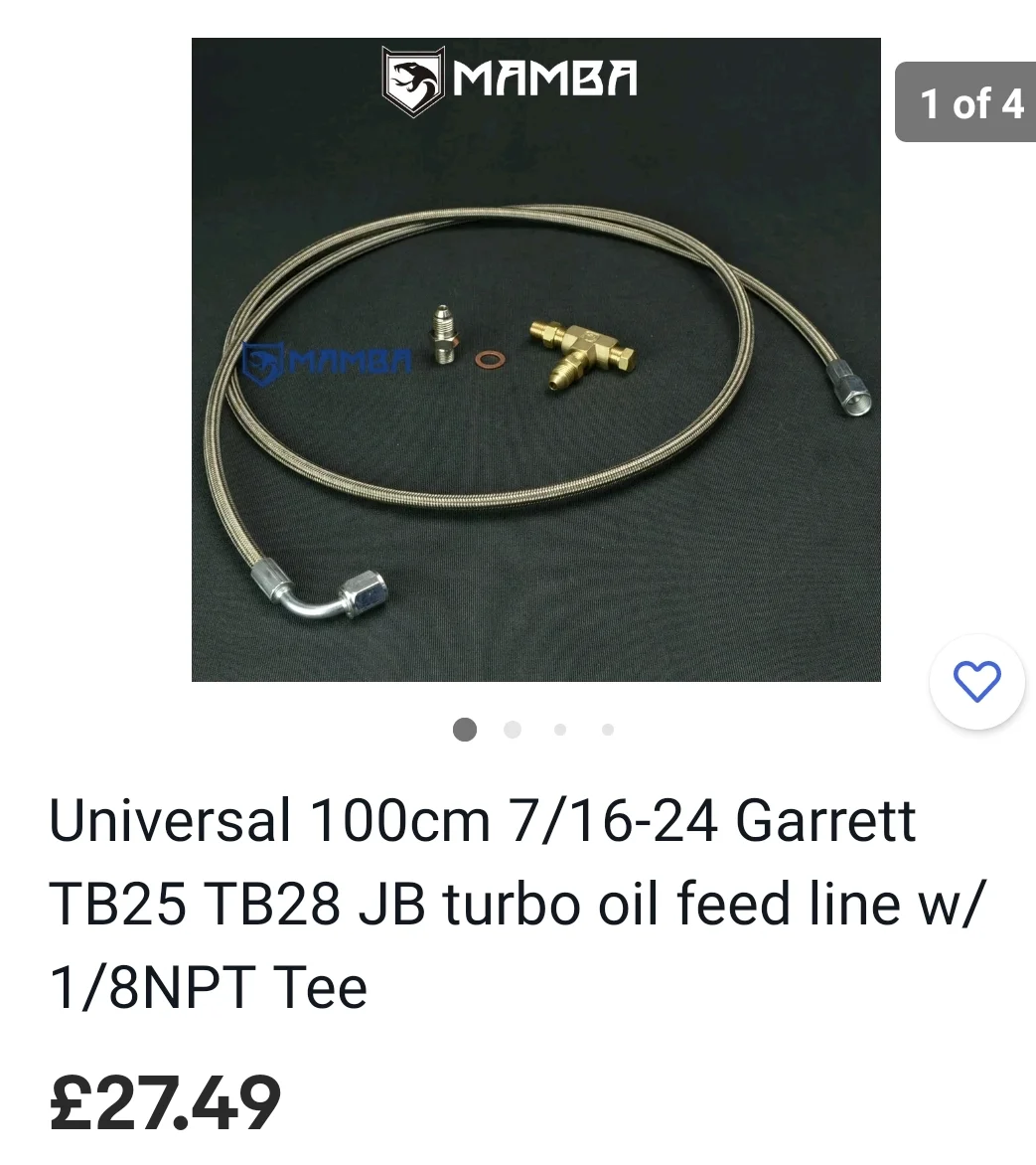

SteveC put me on the right lines with the oil feed. I got a 1 meter Mamba oil line for 27 quid and an adapter £13. All fitted with no dramas:

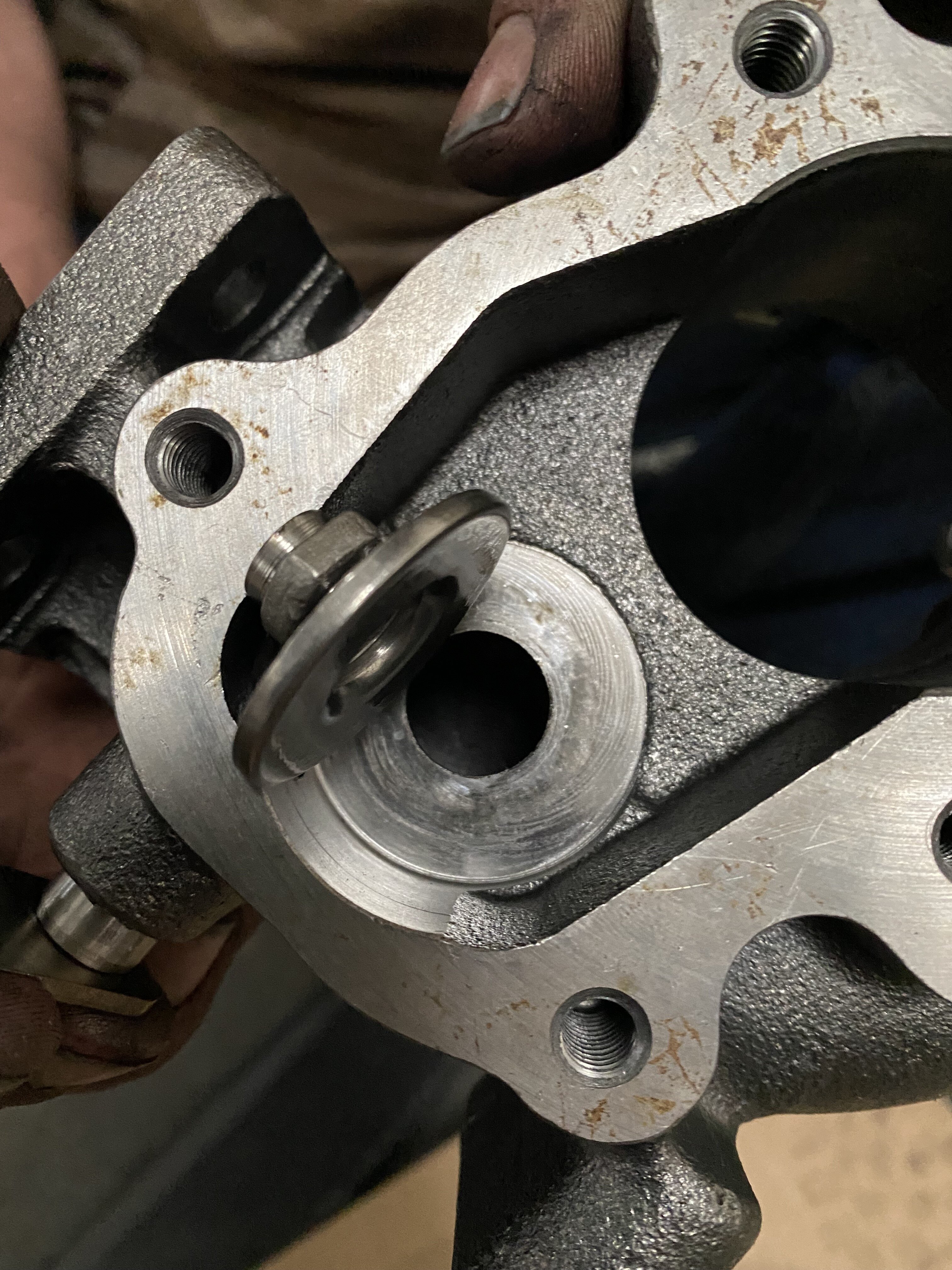

I've got the Engine Dynamics oil drain kit, which tbh you coukd source a lot cheaper, but for convenience, I bought it.
Take your time drilling into the block though.....I've managed to screw up drilling the hole straight, and now I can't get the 3/8 tap to take and may have to use compression washers and a nut on the inside 🤦
View attachment 1539902 View attachment 1539903

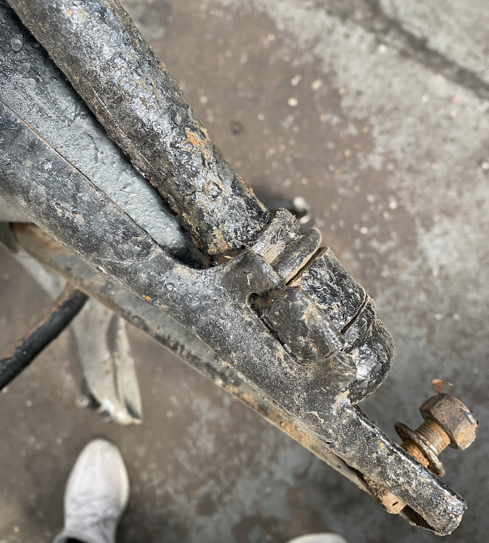

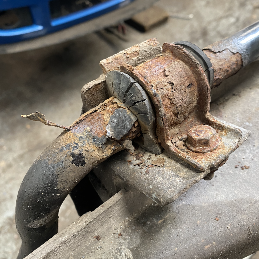

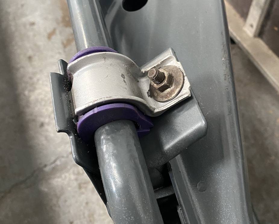

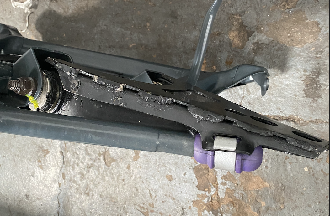

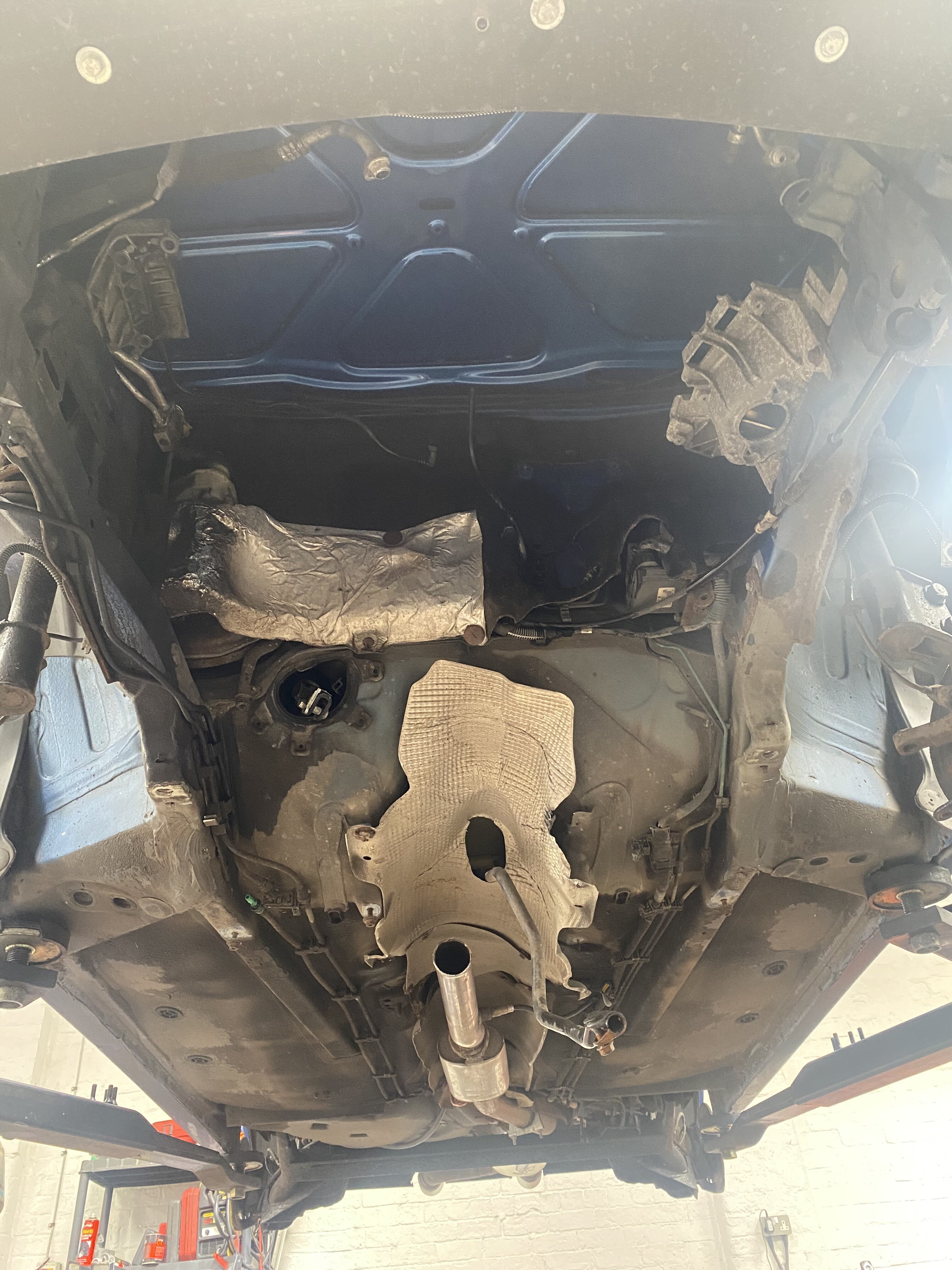

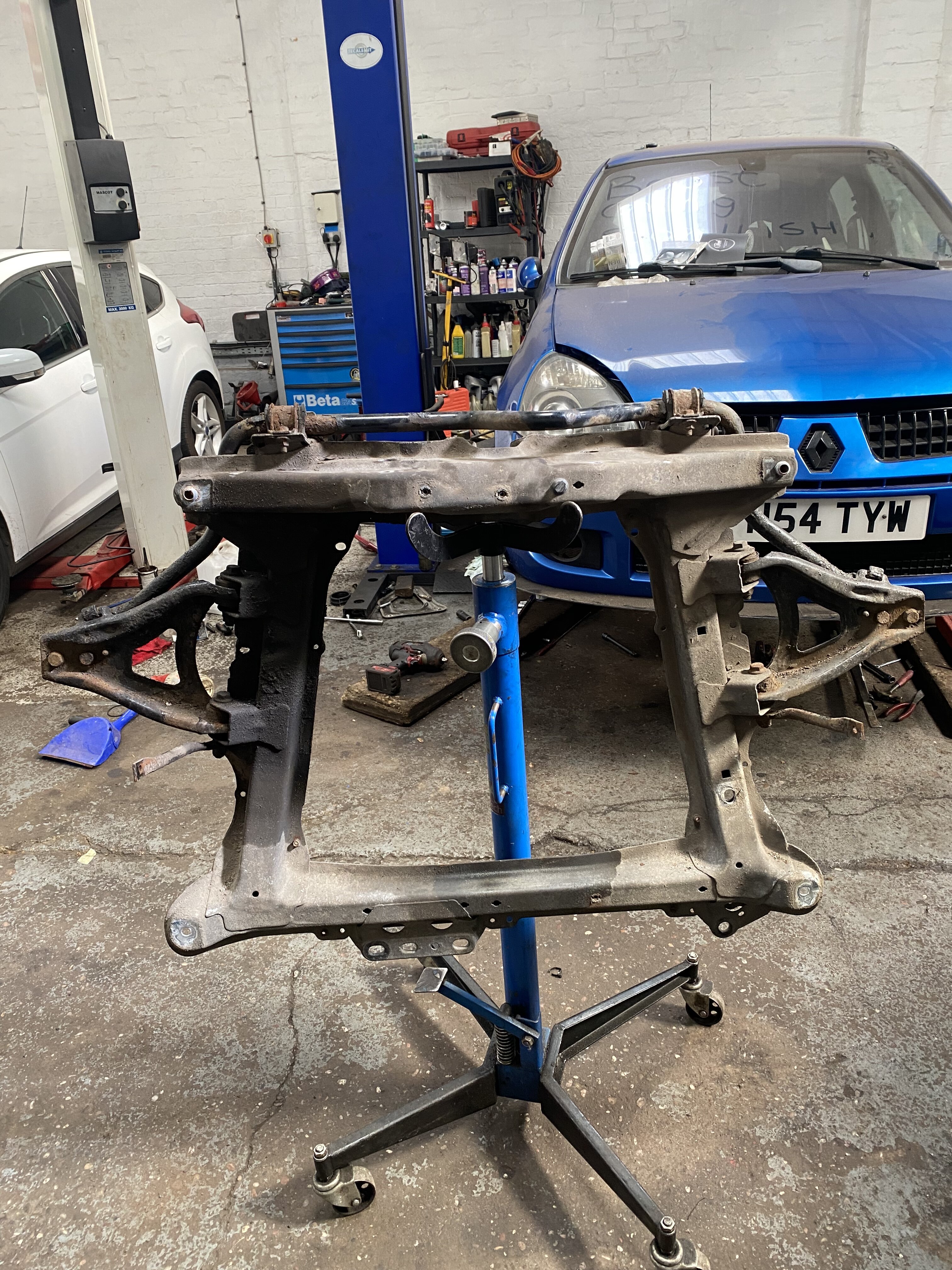

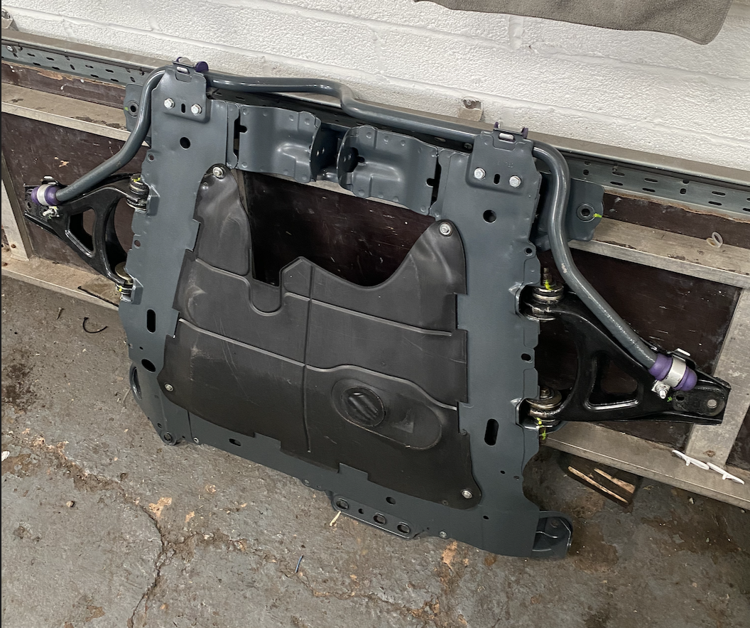

I was hoping to get the engine out yesterday but only managed subframe off and driveshafts out. Shocked at the condition of the bushes tbh, I should hopefully see an improvement with my ready-to-fit subframe with polybushes and strengthened arms! The coolant system was drained today and there was a lot of oil in the system, potential head gasket failure? It's always run spot on though, with the occasional lumpy cold start... Good job I'm stripping it down :rolleyes: :ROFLMAO:
