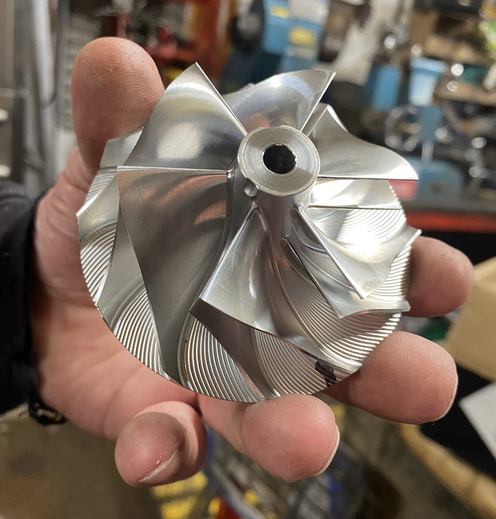

Turbo guy said the housings poor quality but should be fine, he said it would be sound at 12psi. Then he sent me this picture with no caption, not sure if it's good or not :ROFLMAO:

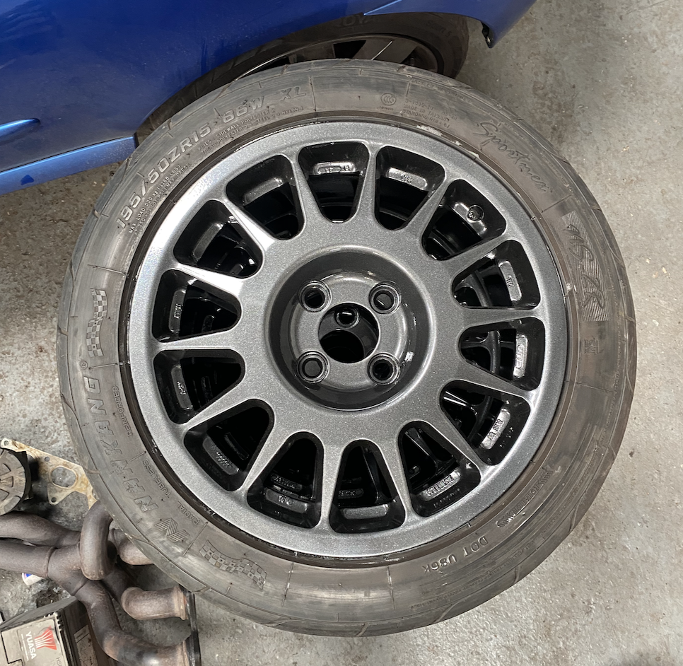

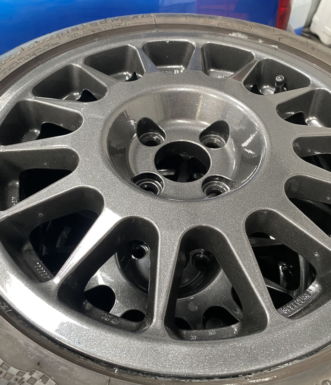

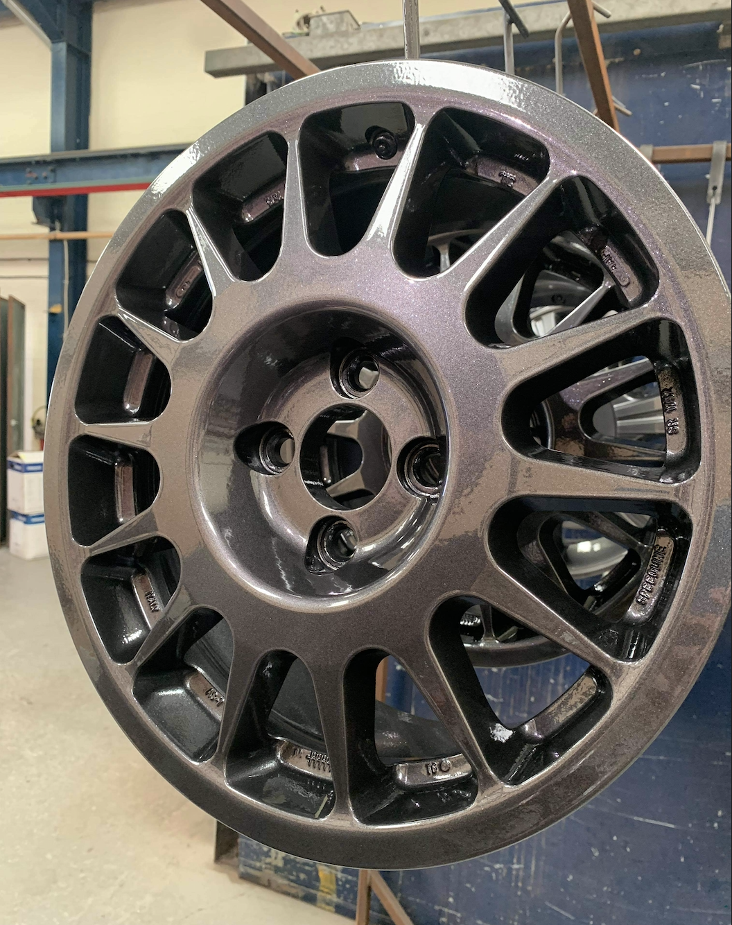

Got the turbo back too all checked over, ported and ready to fit. Also took me a week to fetch my wheels, only got them Friday but ran out of time to fit them before going away this week. The finish on them is superb!!
Look good those mate. I'd look at removing the coating where the nut taper sits as it can work the nuts loose.
Got any turbo photos? What did it cost in the end?
Yes mate will be doing that, not many people do it before fitting refurbed wheels!!

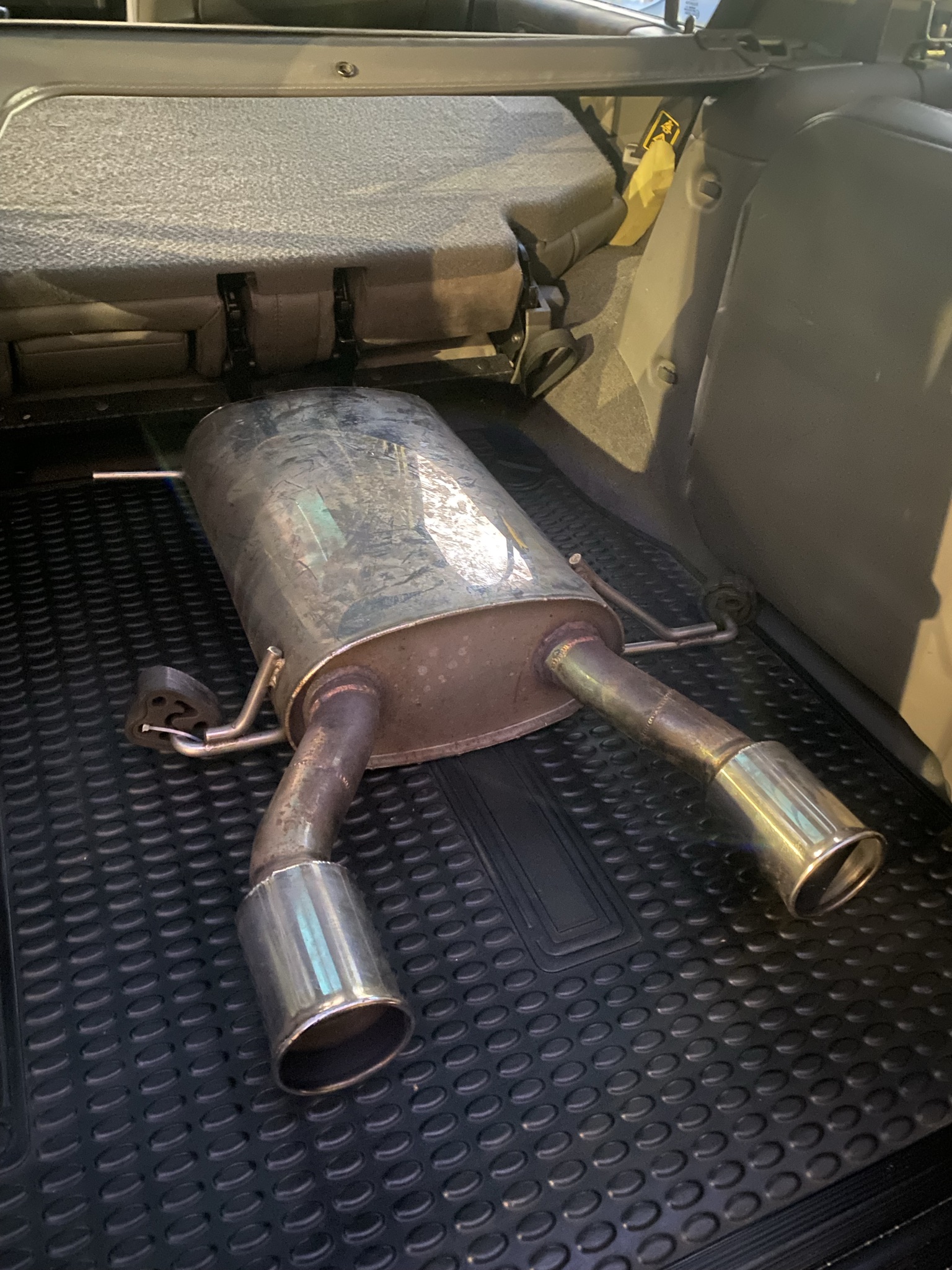

last night I picked up a bargain BTM exhaust, I think I’ll be replacing my scorpion exhaust with this one. Are they a similar noise to the Yozza fitted on my inferno 182?

I nearly bought that mate, saw you replied after me! In fact I would have bought it but the cat was welded to the centre pipe and I don’t have the time to mess around getting it removed. But it was an absolute bargain
It was only 20 minutes away from me, so at that price I couldn't refuse it! It's pretty mint as well!
The cat is gutted but I will just chop that off anyway as it's not needed

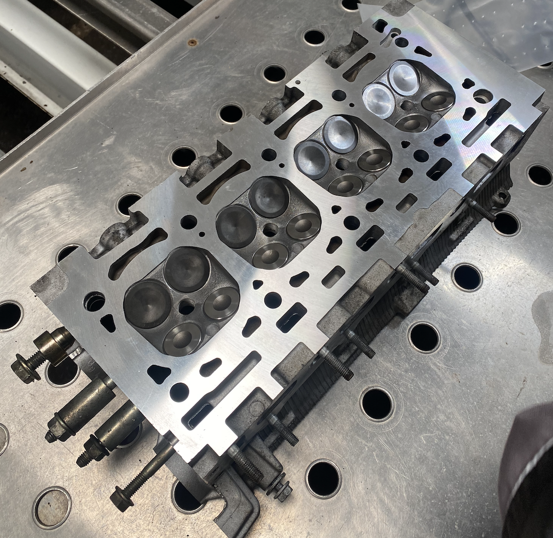

Progress has been slow. Work was getting so busy so i've taken on another mechanic to help cope with the workload, which means we're also making progress on the Clio!!
Finally got my head back, fresh skim with new mahle exhaust valves and catcam inlet valves.
It will be ready for CSF22, unsure if I tempt fate and try a track day too lol!

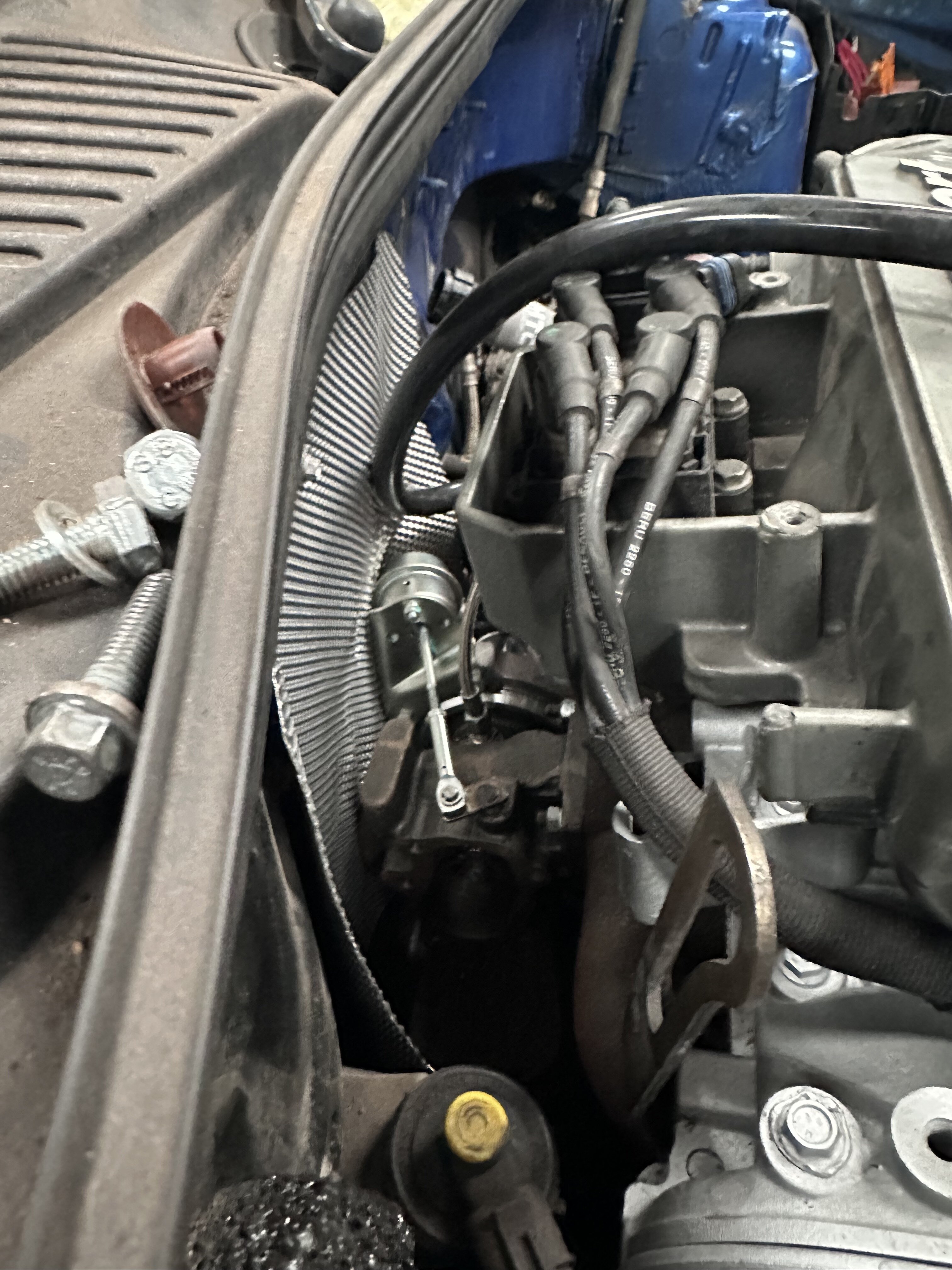

Engines in and on the mounts, having issues with the turbo touching the bulkhead though? Bought a heatshield from Engine-Dynamics and when the engine was lowered in, the turbo has ripped straight through the bloody thing - time to take it back out and fit a new one :ROFLMAO:
Anyone got any tips or tricks on how to stop it from touching? Thinking the kTEC mounts aren't helping my cause?

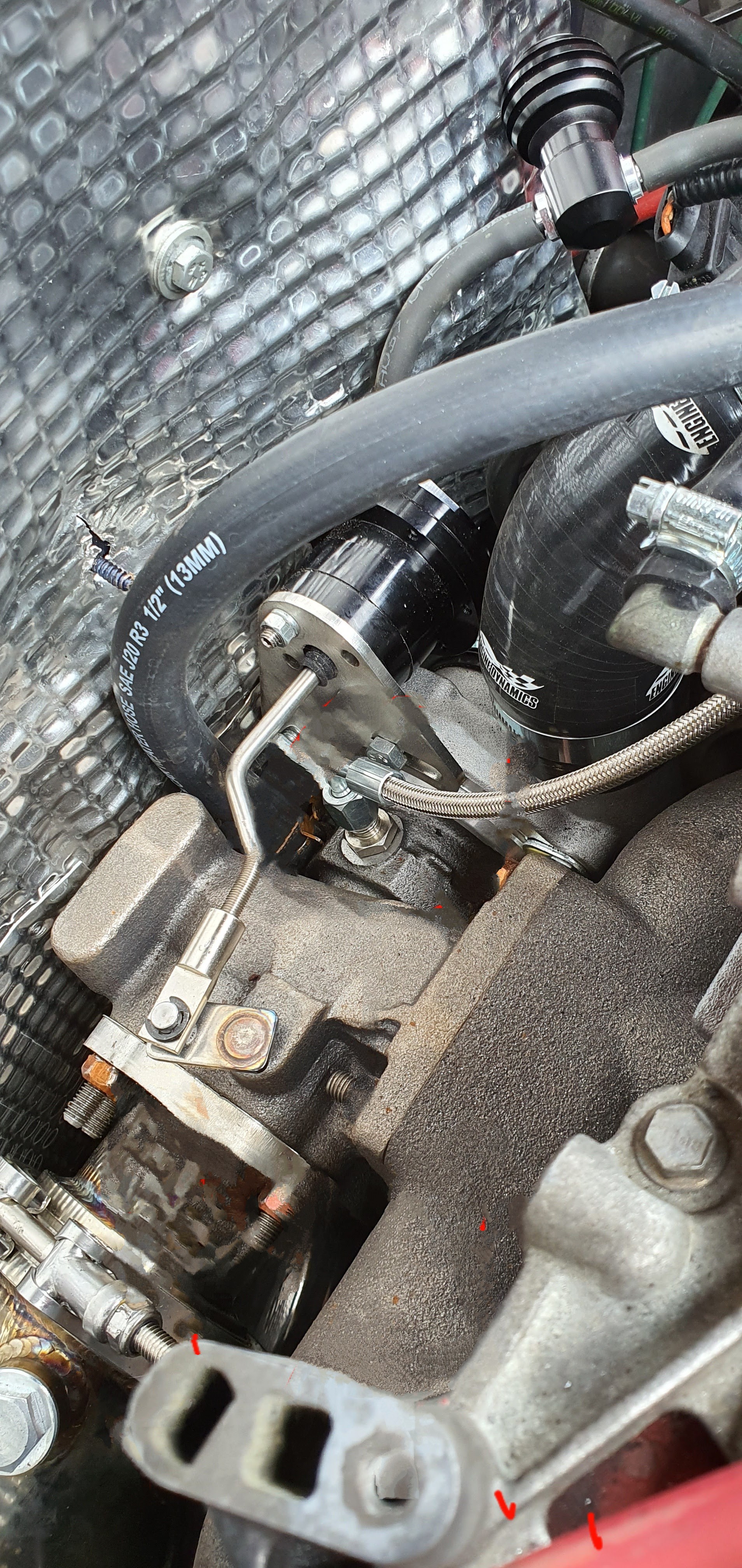

I used a wooden mallet to shape mine to the bulkhead so it cleared the turbo.
I'm running a gt28 churbo with about ¼" clearance now

Also my actuator mount allows for a bit more wiggle room, but you'd need an actuator arm to match.
The pic above is the first actuator I tried which wasn't great, so I went to a 5psi Garrett

As above. I re-engineered the bulkhead with a big hammer. Best bit is that it doesn’t matter how s**t a job or how much of a mess you make cos you can just stick a bit of heat shield over the top and all is well. It works a treat 😂.

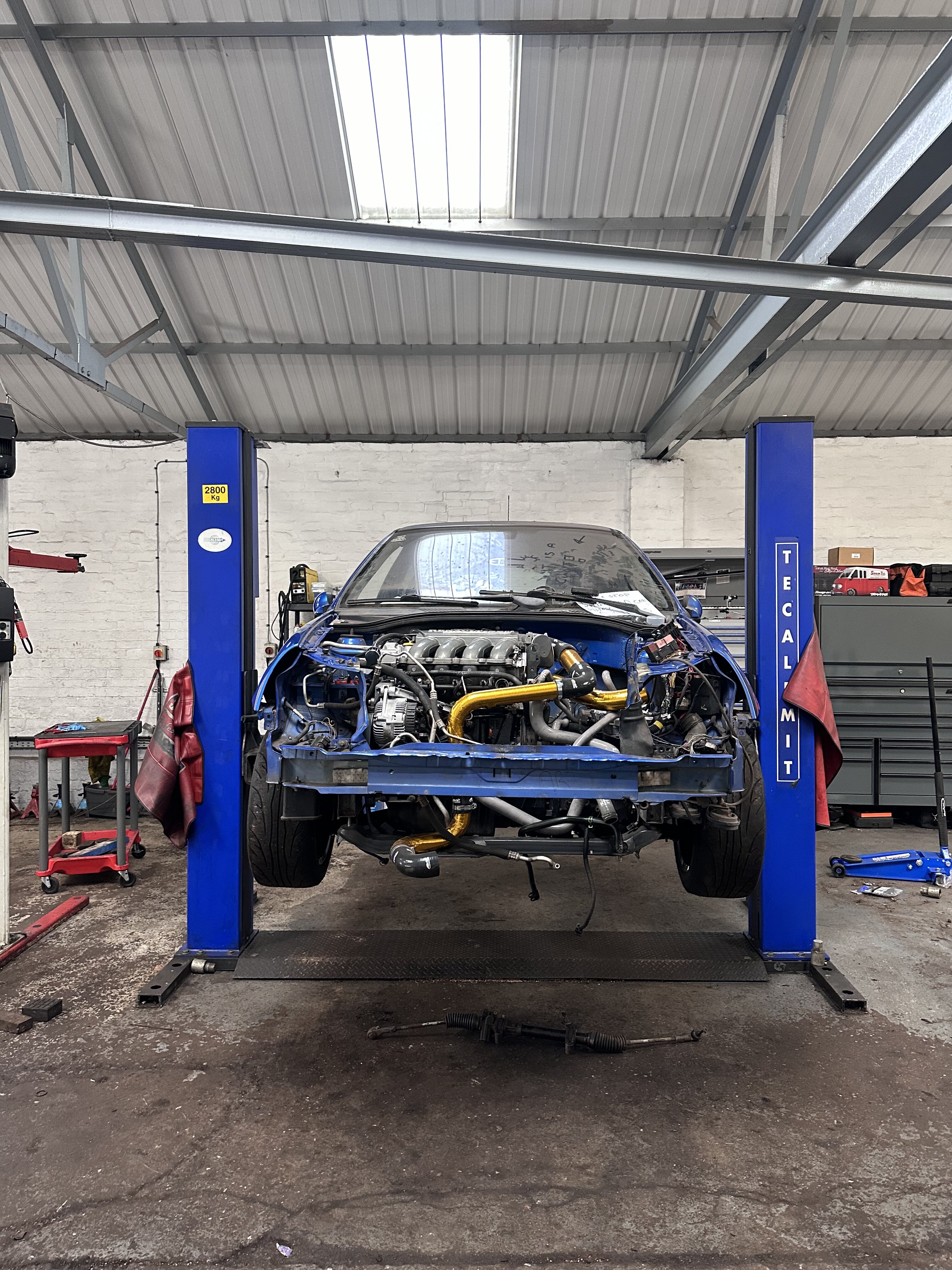

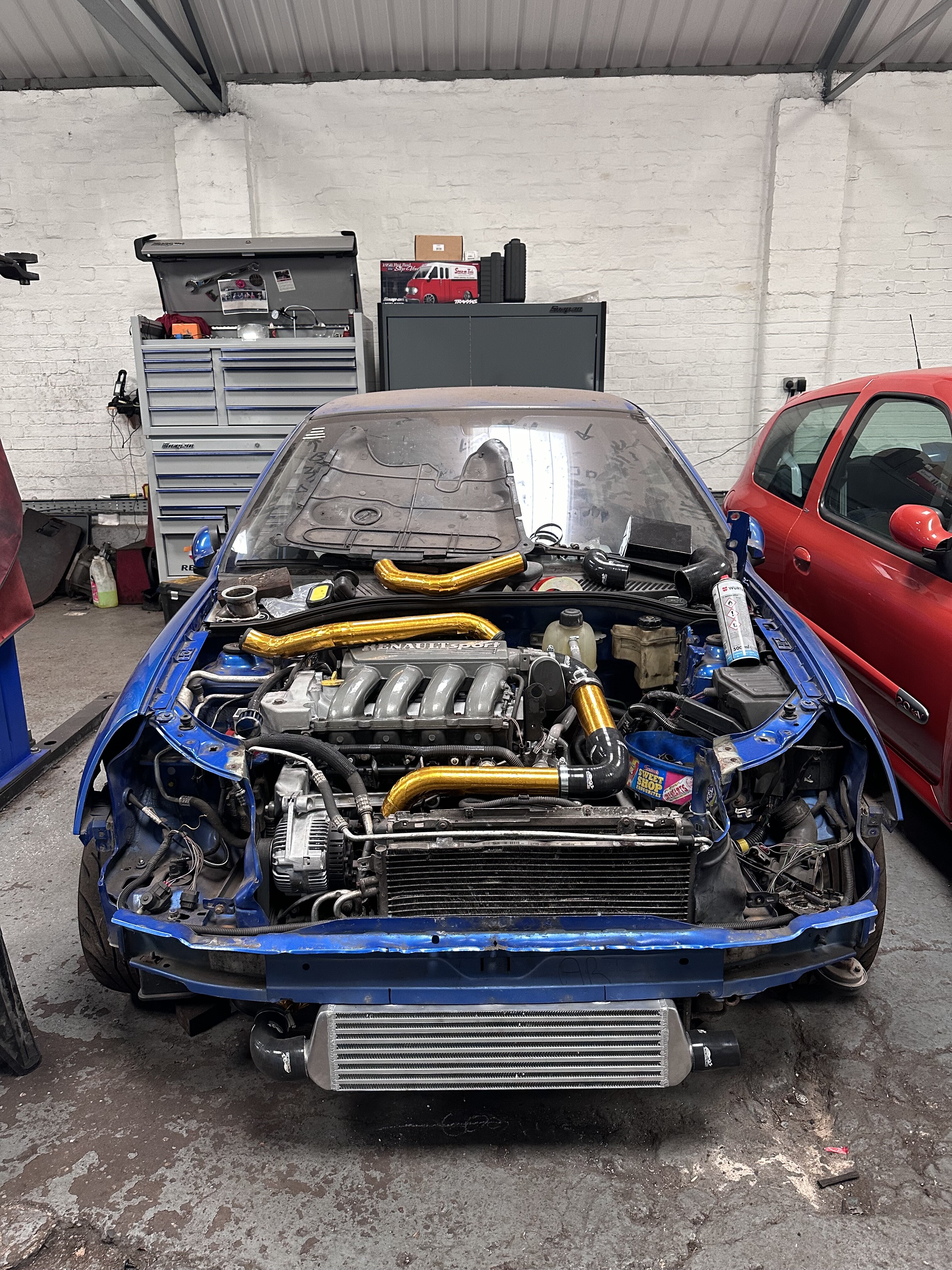

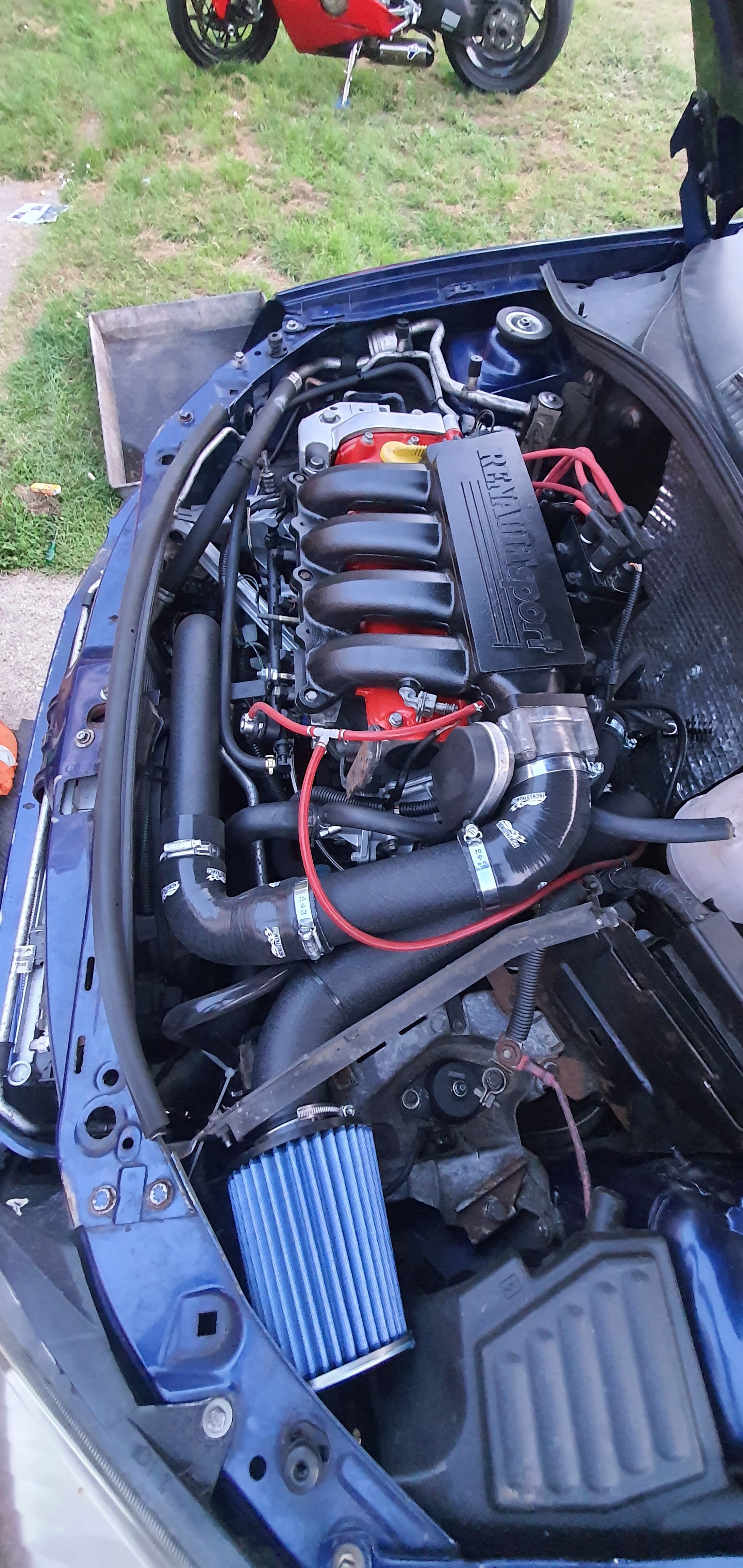

We’ve got it on the ramp and got the powder coated subframe fitted with the steering rack. Having a mare with the downpipe, so ordered a t25 to v band adaptor (like the ED one) and having a friend cut and weld my downpipe to be v band. Waiting for this be done to put the driveshafts in.

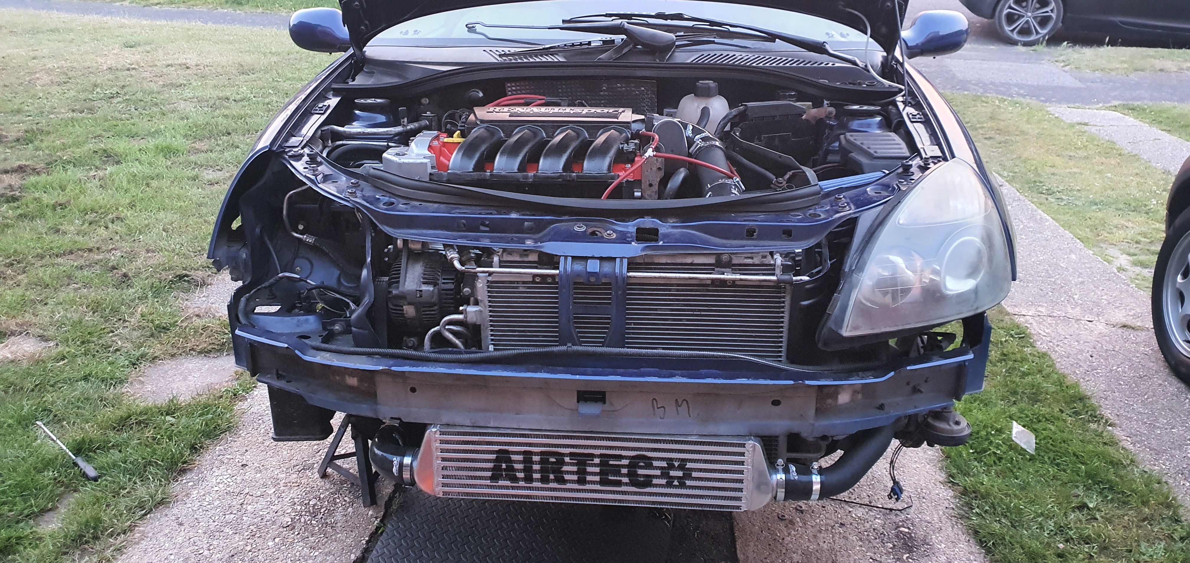

I need to get the radiator fitted so I can line up the intercooler. Can anyone post pictures of their engine bays/intercooler setups? Struggling to remember where some things are routed 😂 It has been apart over 3 years!
Got my motul gearbox oil in with a fresh engine oil filter ready for it to run.
My question is, can I run the car with a boost pipe disconnected? I want to get the turbo module from EFI when in it’s closer to being completed.

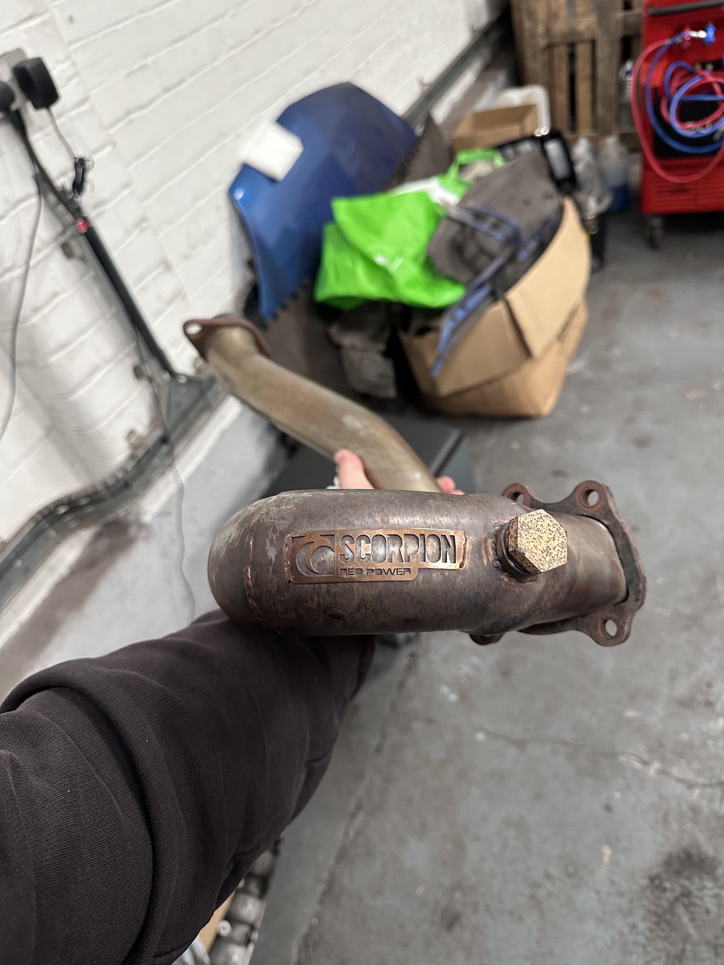

I raided some of @Louis stuff, such as a FPRV & Scorpion turbo downpipe and link pipe. Decided to stick to my Scorpion cat back and have a turbo back system. Hoping it sounds naughty

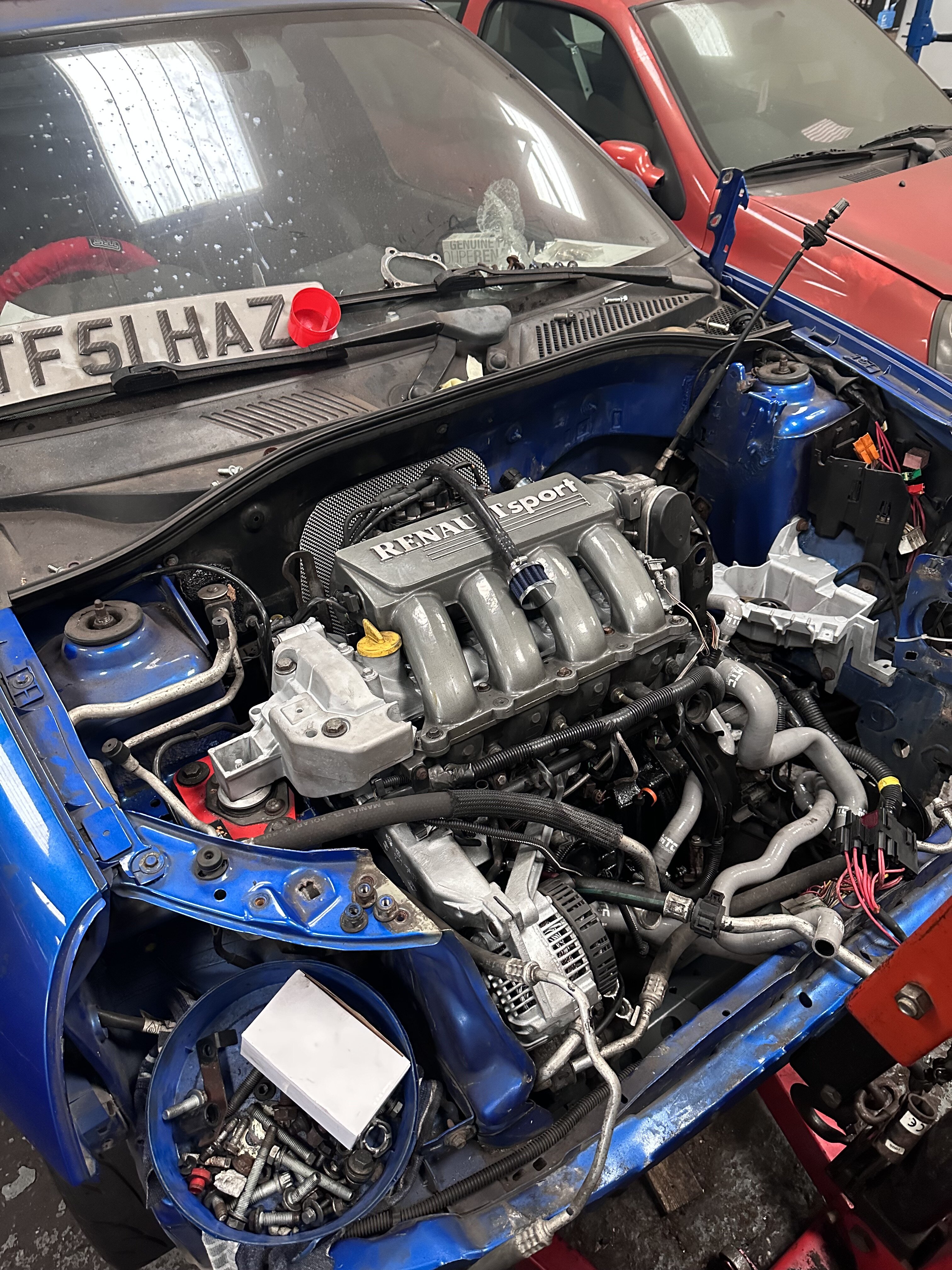

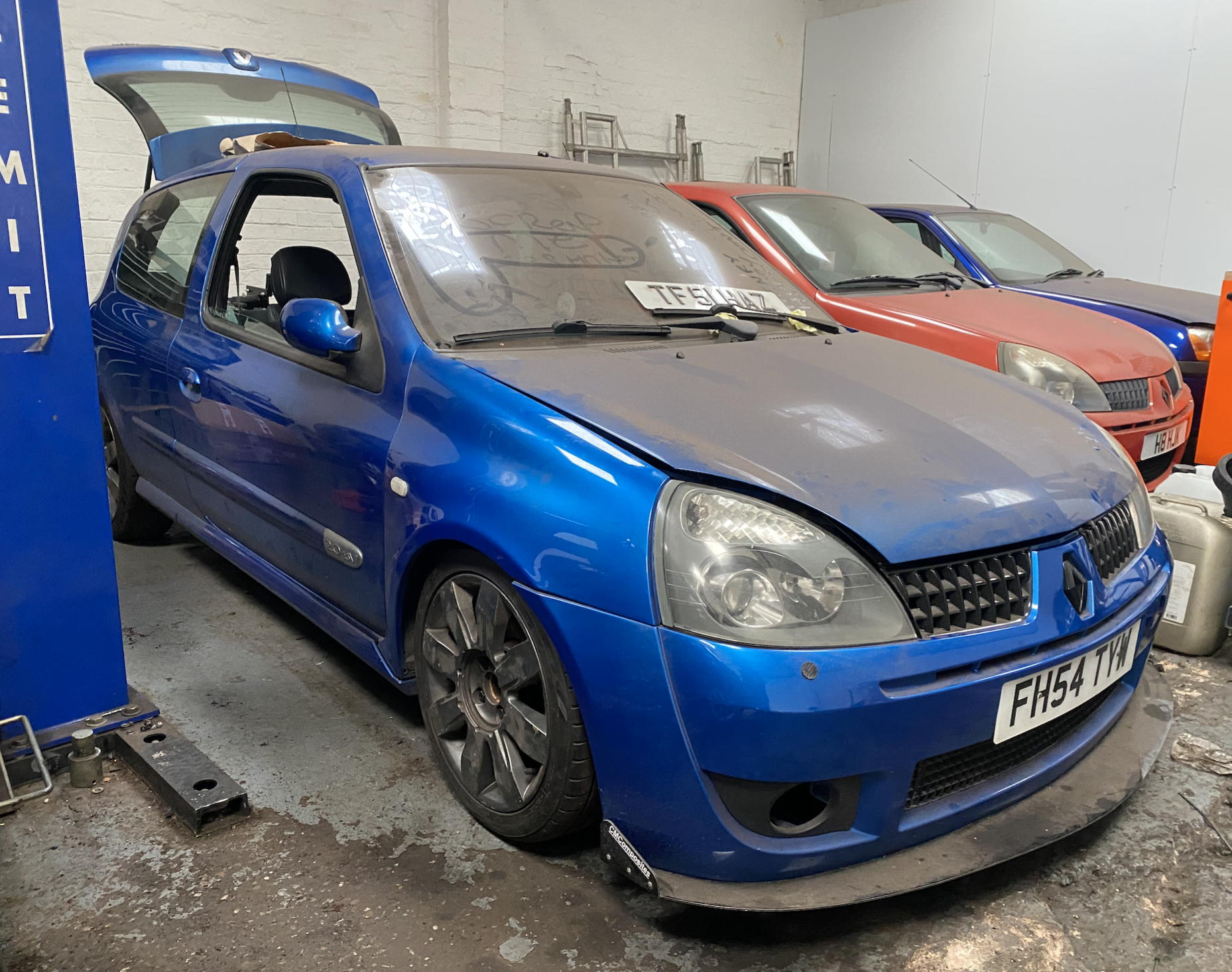

Put a couple more bits on here and there, I’ve lost the part that links my gearbox cable to gearbox so need to try and order one of those.
As it sits (we’re nearly there :ROFLMAO:)
