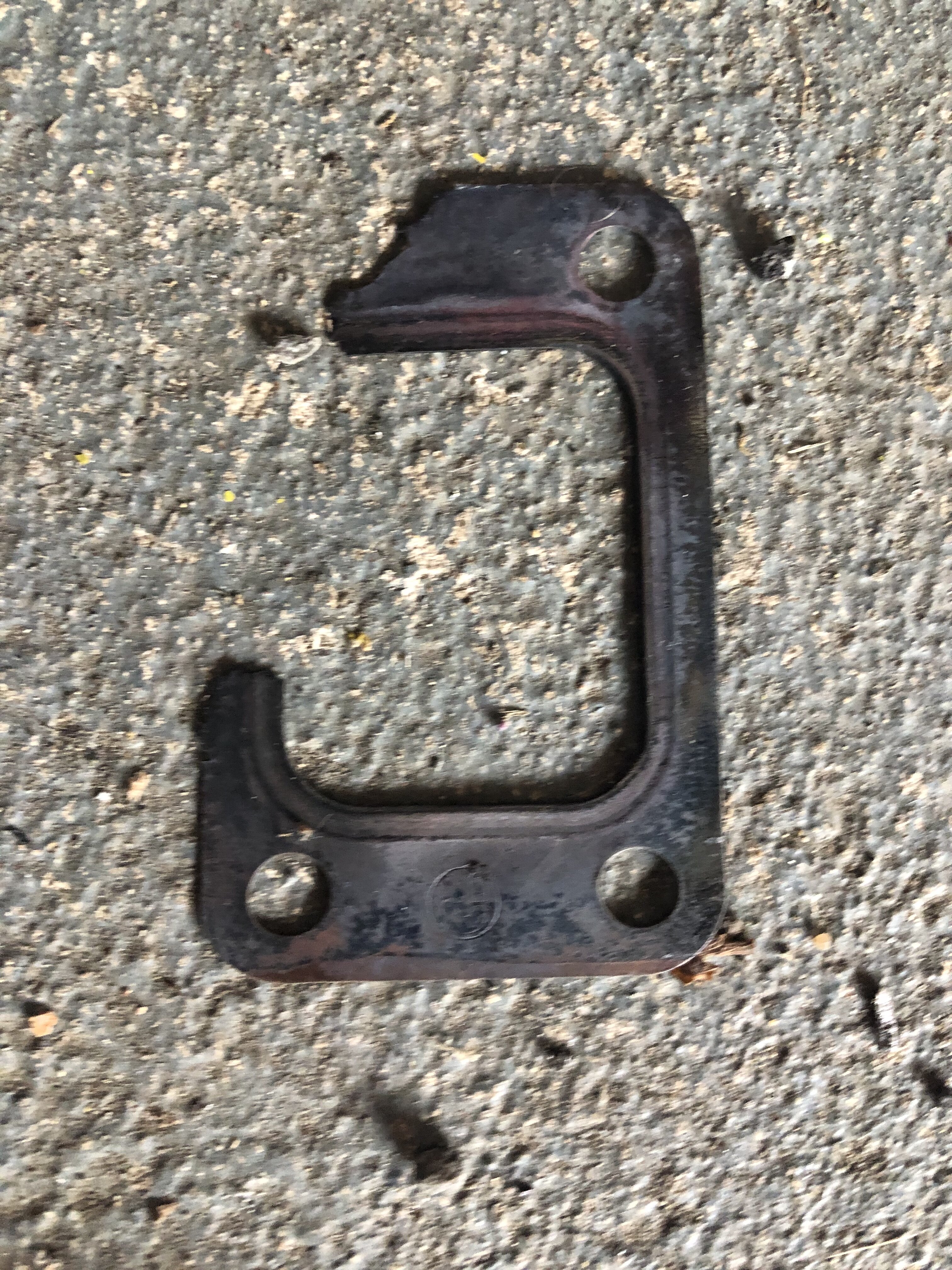

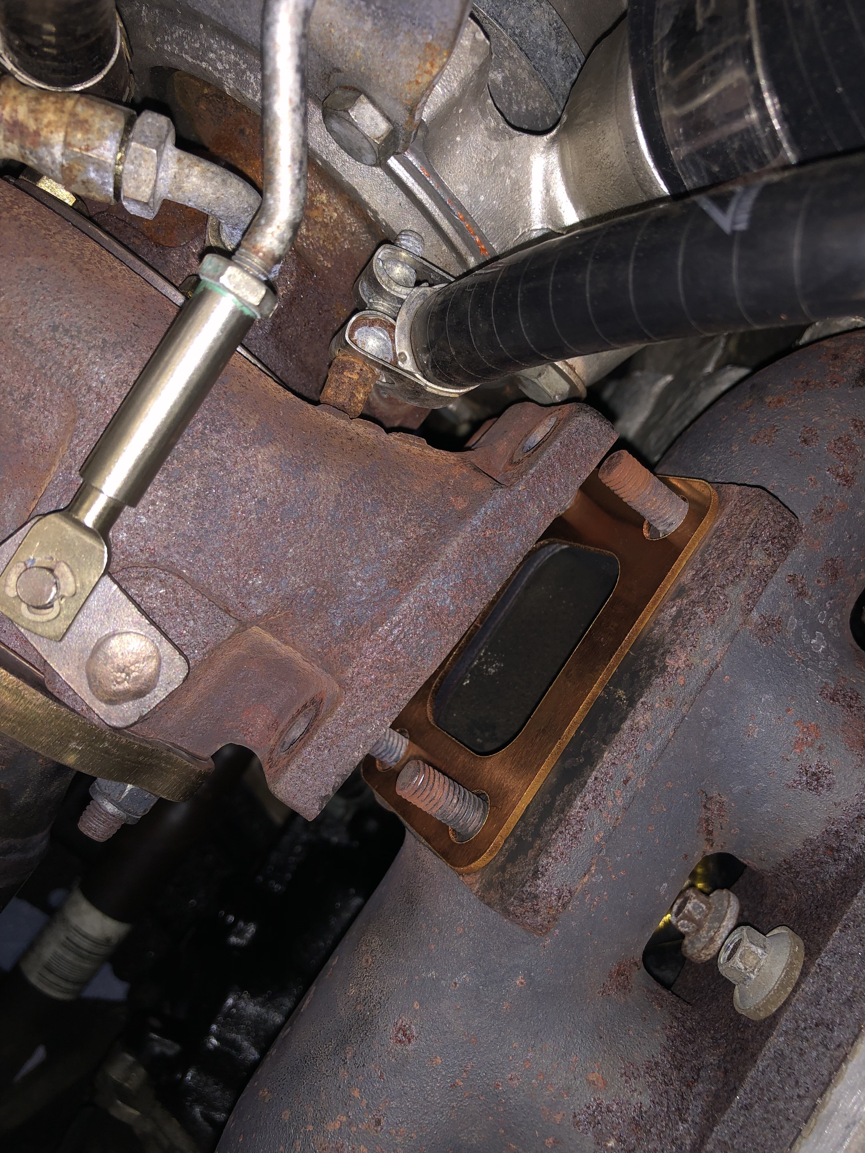

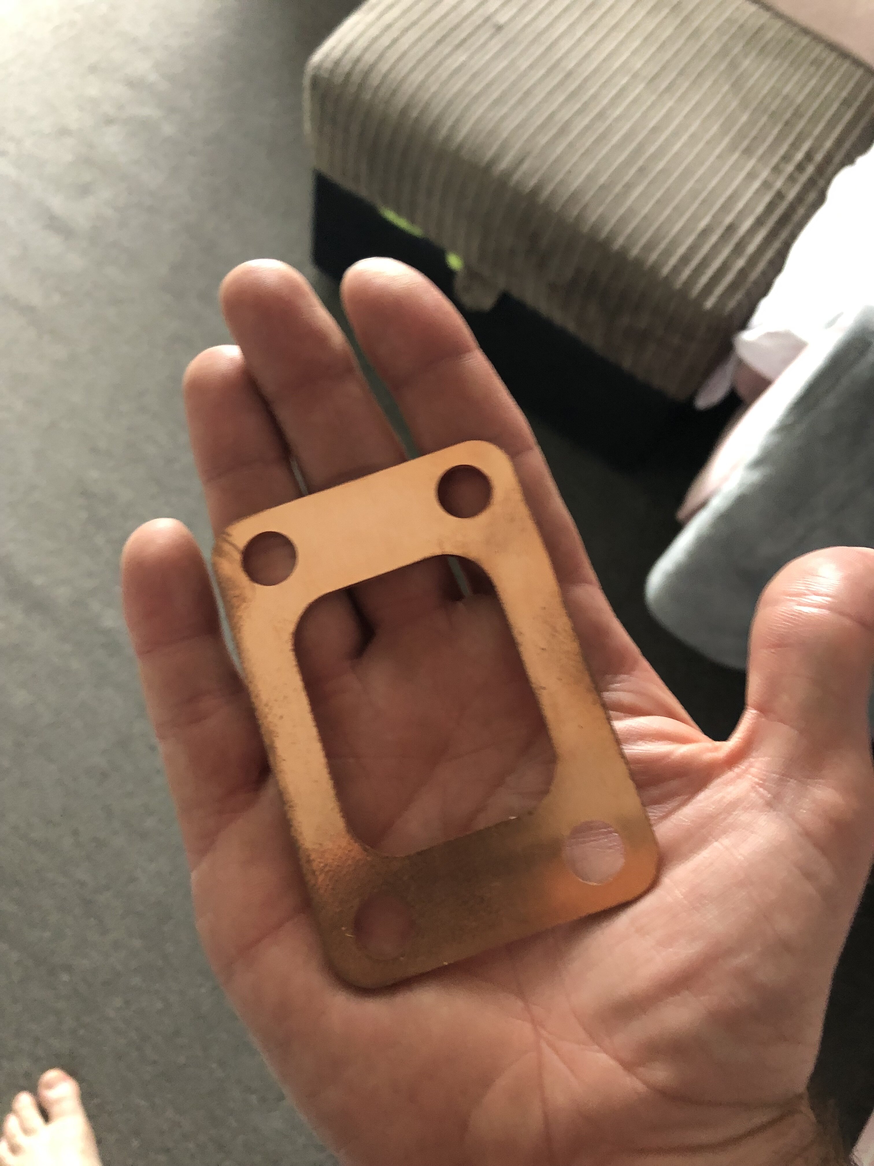

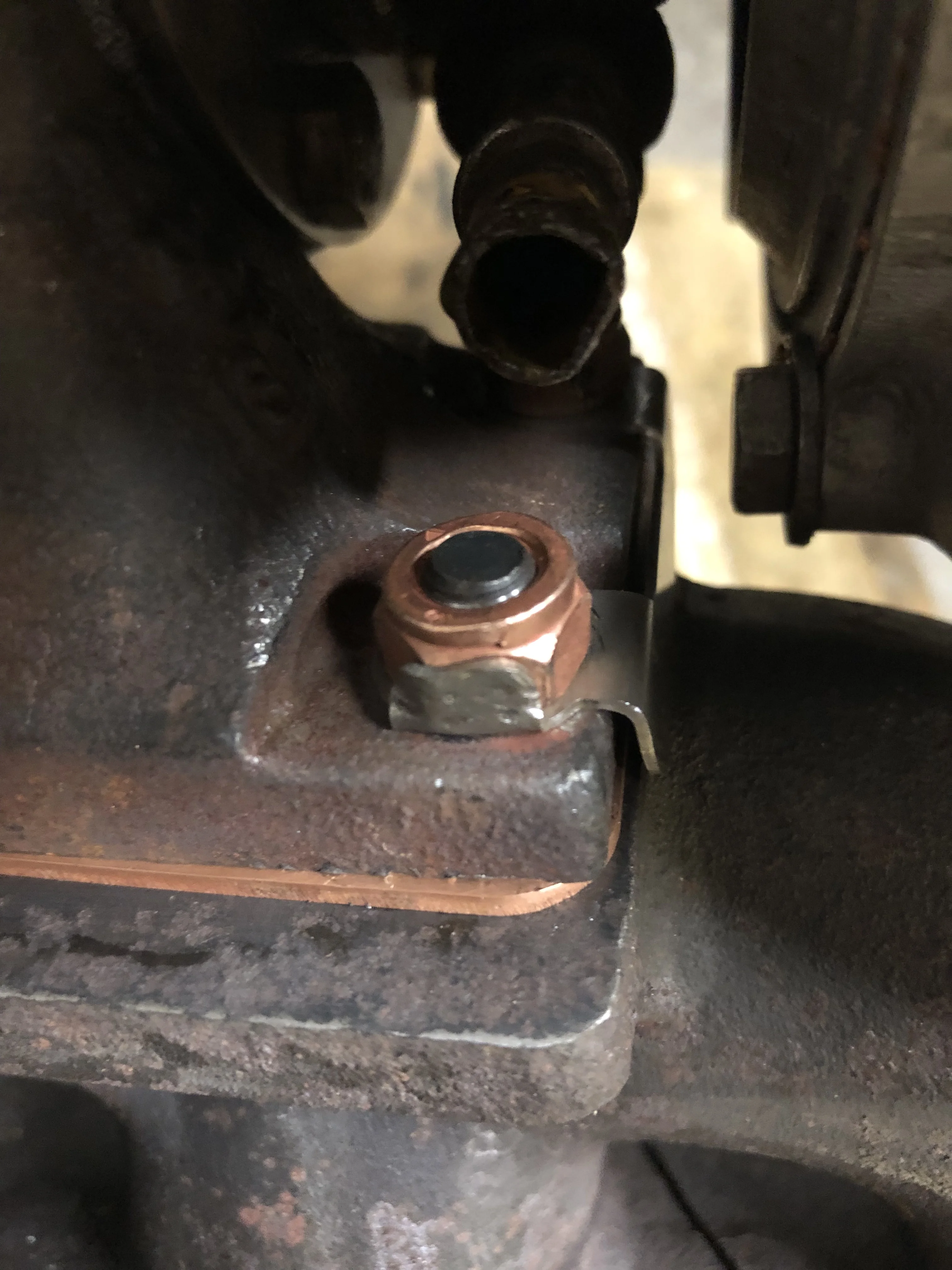

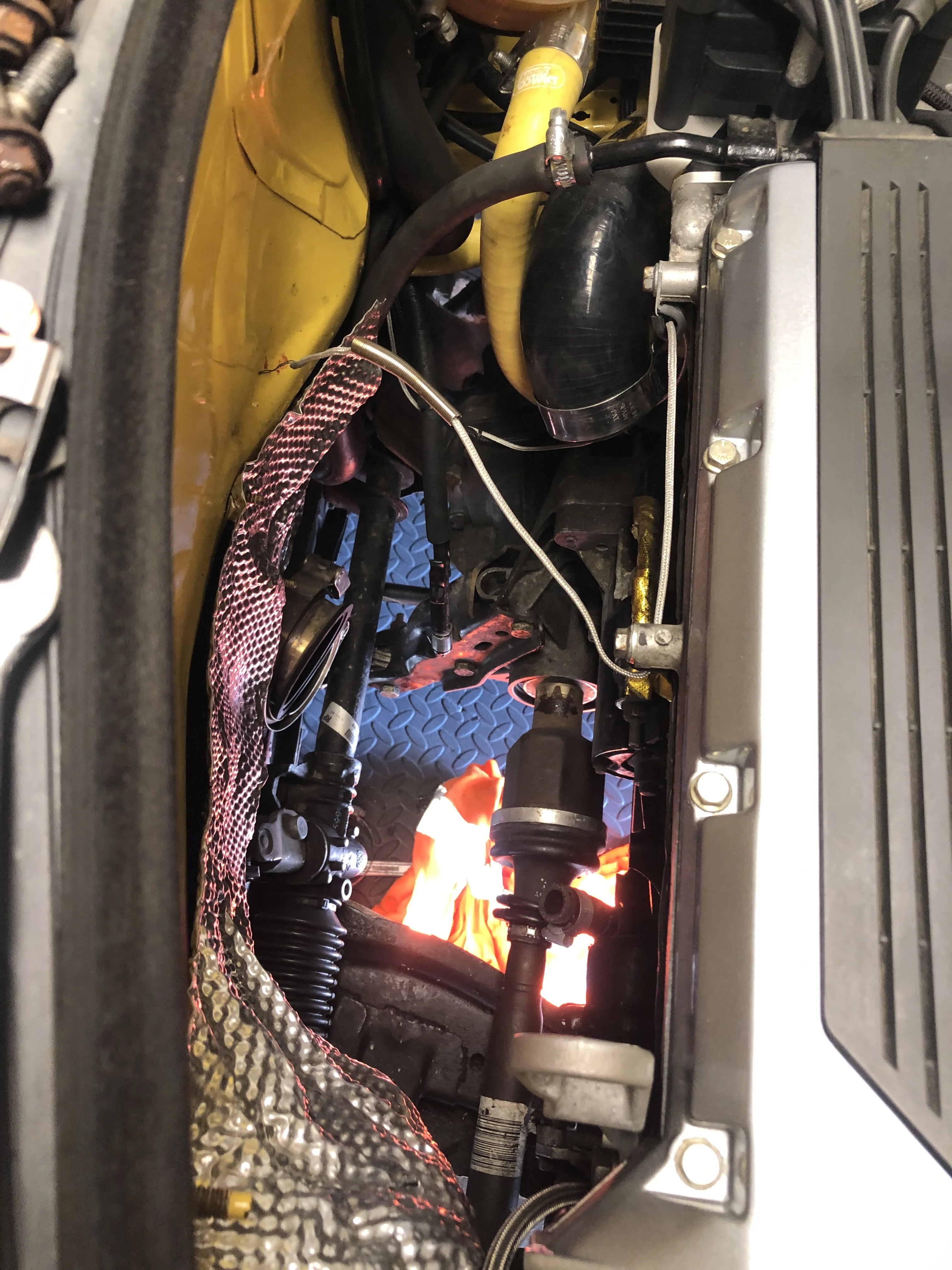

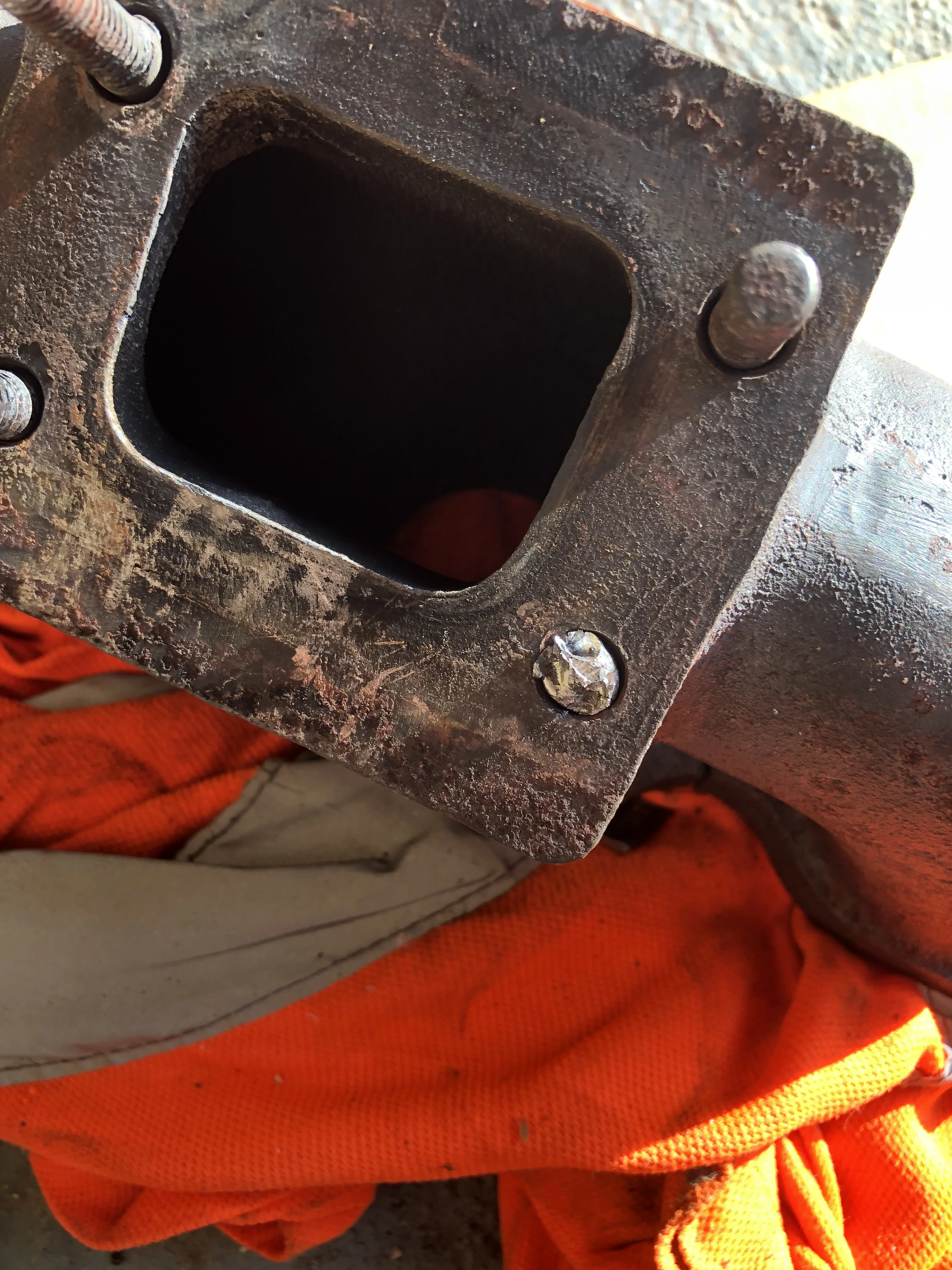

Was the copper gasket properly annealed?
I would give it another go using better nuts, inconel studs and either tab washers or NordLock washers before going to the expense/hassle of getting the manifold and turbine housing ground perfectly flat to be able to run without a gasket. Looking at that manifold flange face it needs a lick over for anything to seal regardless
Get the mating faces checked and sorted if necessary, and run no gasket. R5gtt doesnt run one, ive only had issues with manifold to turbo blow when one of the faces is miles out.
What the hell is annealed?
Copper gaskets need to be annealed (heat treated) to soften them so they conform to the faces they're between, or they don't work, it involves heating them to a dull cherry red and quenching in water
But nothing is sealing on that manifold flange the way it is, get the studs out and clean it up before doing anything else 👍
