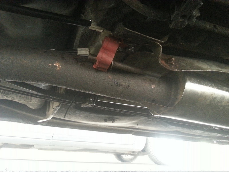

@JamesBryan Do you know why mine doesn't sit properly? Running a decat unless it's too long! It's still got the original olive joint though.
Sorry to thread hijack! Completely OT too... haha
You mean how the rubber is being pushed over?
Looks like the bit that goes in to the mount has a stop/washer type thing which is pushing the rubber over. Mine is just the bar without any stop on it.
Ahh, i thought that washer was normal! Will grind that off then... Toyosports quality.
