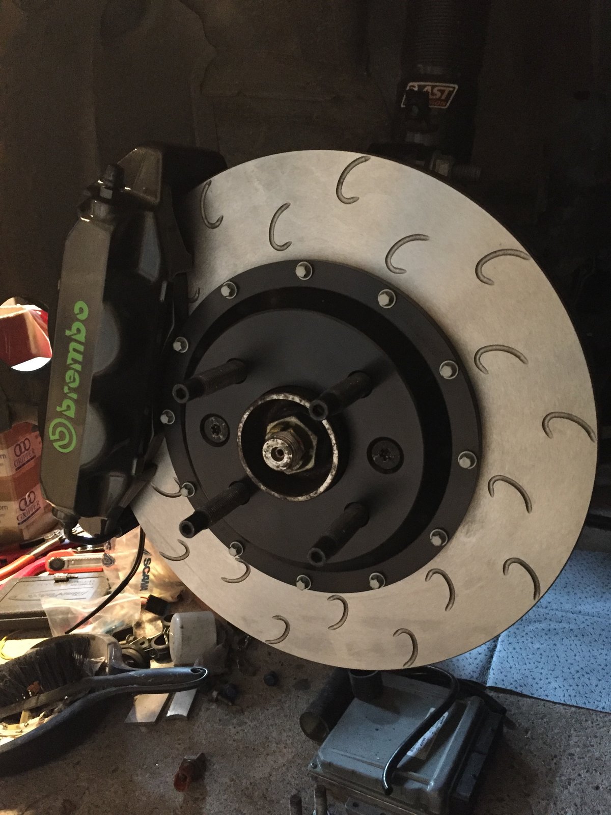

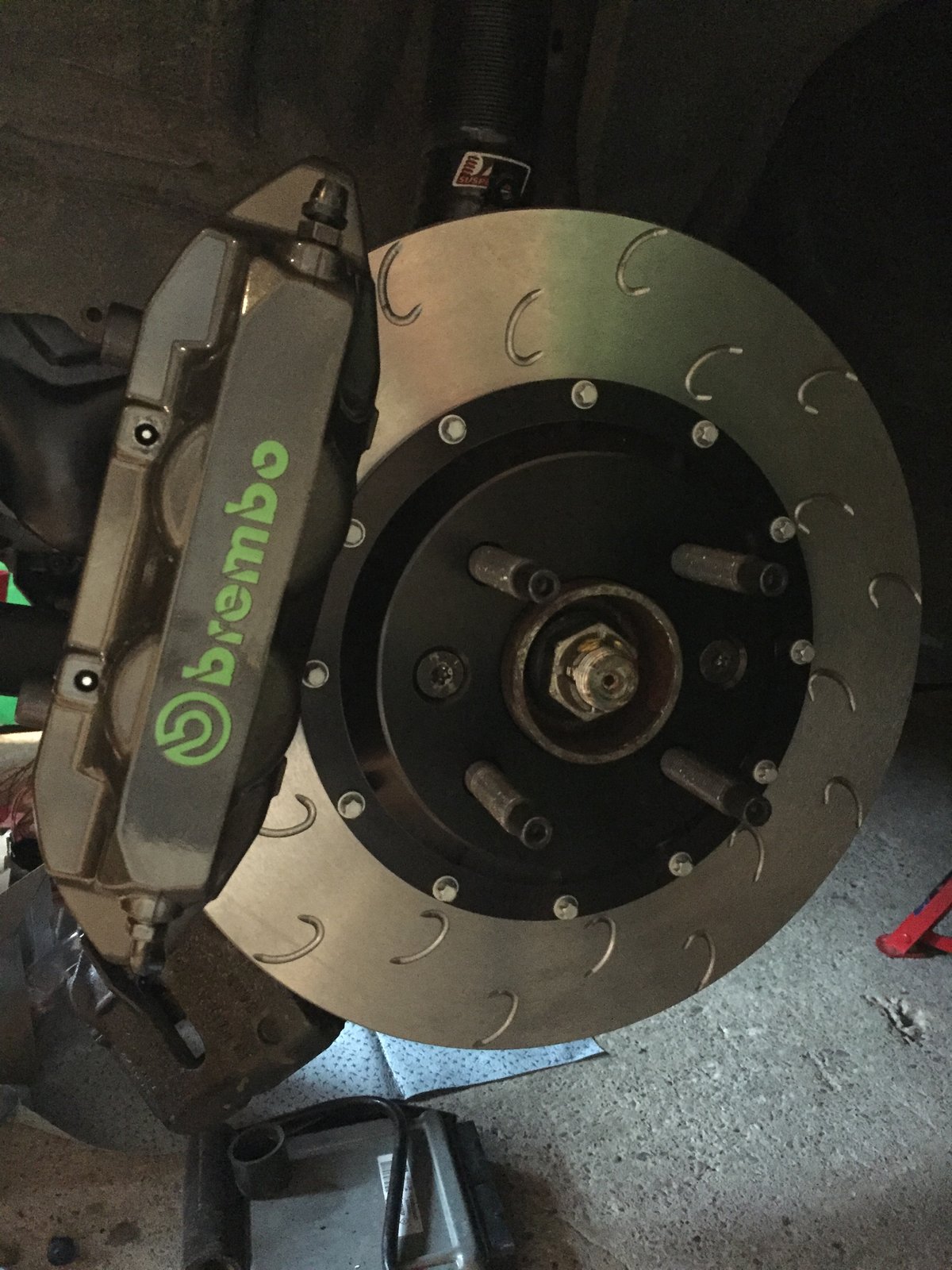

Me and the other half (@not normal dan - lol!) had a little road trip today to sort out the front brakes. This time next week should see me with a pair of 295x28mm 2 piece rotor and bell setup. Changed a few details of the bell to hopefully rule out the need for a spacer when running the superleggeras as well.
Yet another job ticked off the list! I'll hopefully have the fandango rear stub axles and brackets next weekend as well, so lots happening now.

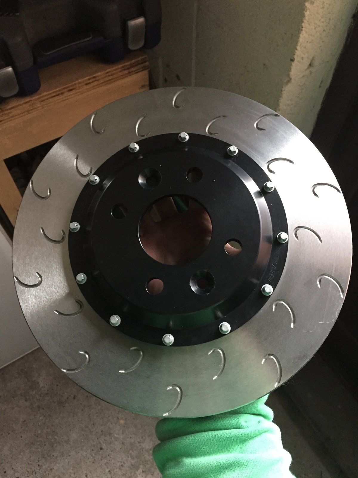

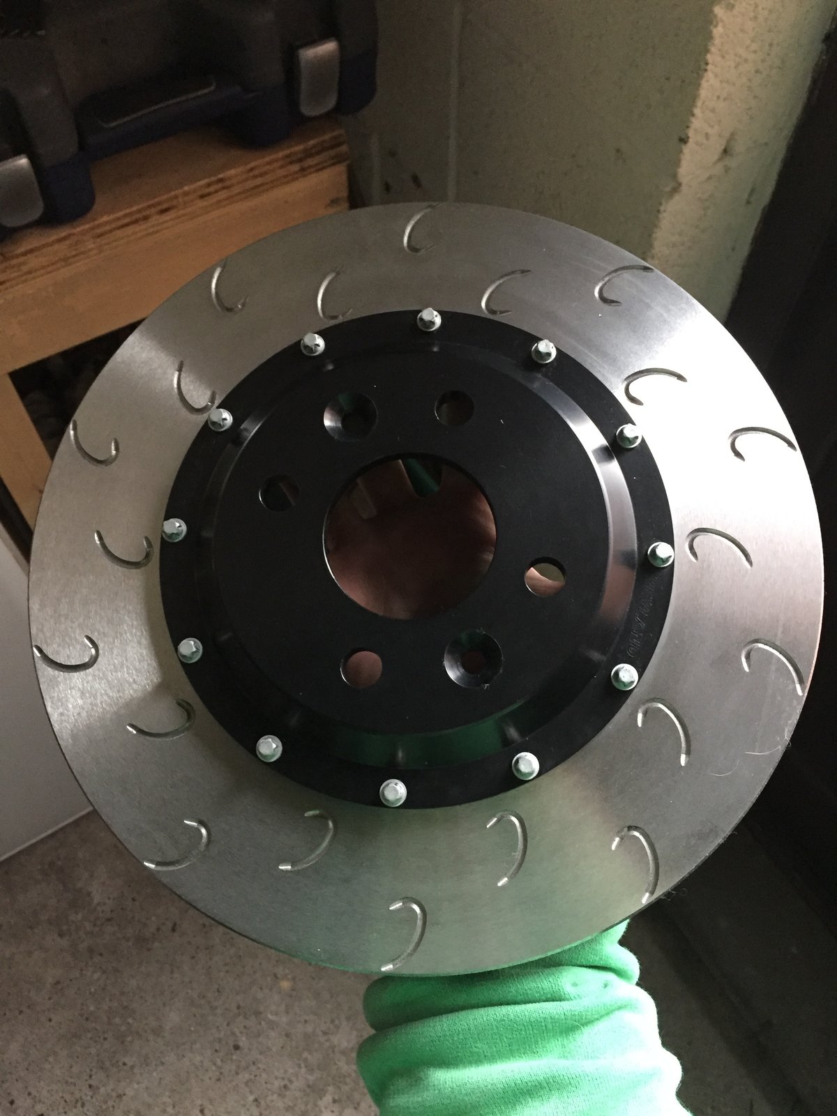

Today I got the call to say my brake bells and rotors were ready for collection. Very pleased with how these have turned out!! These are a custom 295x28 setup and they're still lighter than the original 280's, so substantially lighter than the 300mm scenic discs! Winner winner. Chicken dinner!
Anyway, less waffle more pics!
The bottom of the pad has .5mm - 1mm clearance on the bell itself, so it's a very close fitting brake setup. Needless to say, I love custom stuff!!
Anyway, less waffle more pics! View attachment 149578View attachment 149579 View attachment 149580The bottom of the pad has .5mm - 1mm clearance on the bell itself, so it's a very close fitting brake setup. Needless to say, I love custom stuff!!

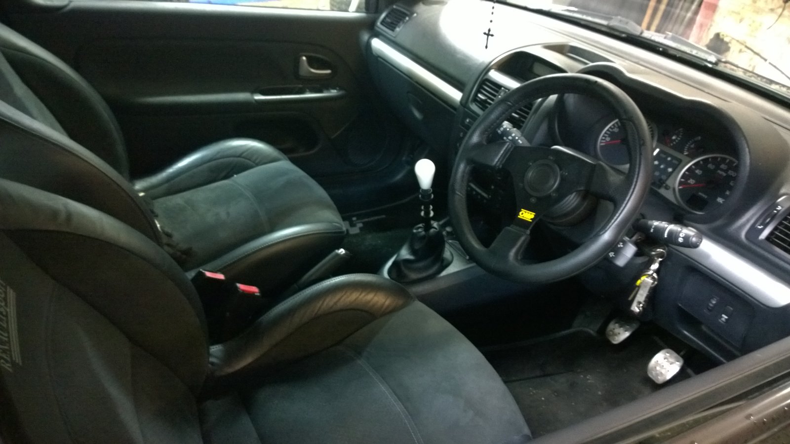

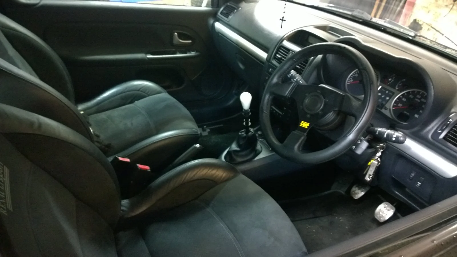

Had to remove heat shield though as it was catching a bit with the longer stick but all is good.
Feels nice and tight :smile:
Happy days mate. The nylon know looks well too! I'm ordering a pms shifter next week I think.

I would of gone pms but hear a lot about it being noisy.
Not to bad in a track focused car like yours but in a daily would do my nut in.
Yeah, I like the knob. Feels weird at the moment but will become normal.
