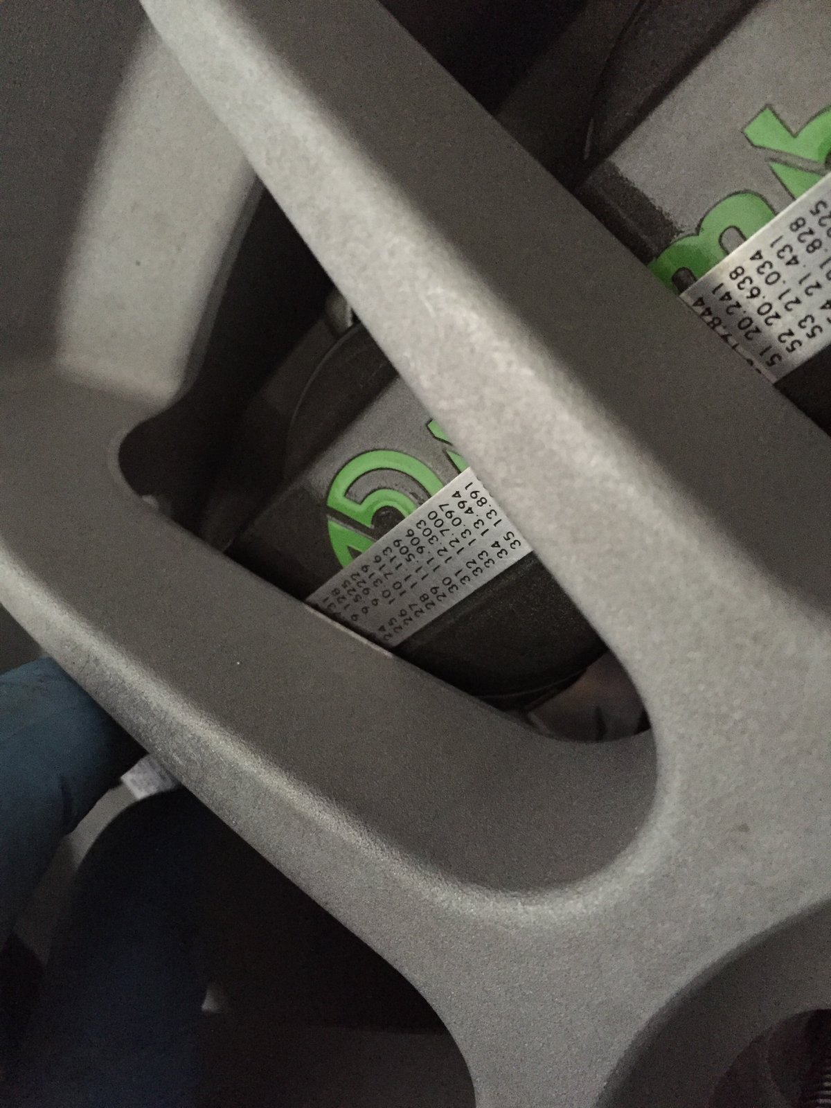

Checked the superleggeras for clearance this afternoon. Needless to say, it's close!!
I can't fit the steel ruler between the spokes and the the caliper all the way down, but the caliper does clear the spokes and the wheel turns.
Happy. Days.
Not sure how brave I'm feeling though yet, so I may order some 5mm spacers for if my balls shrink. Lol!

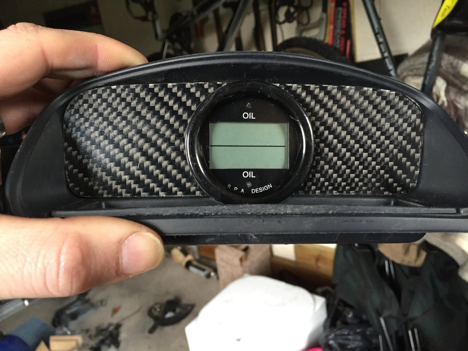

Made this for the oil pressure/temperature gauge.
Not fully sold on it atm tbh so not sure if I'll bother with it in that position. I'll look better when the cars outside.
