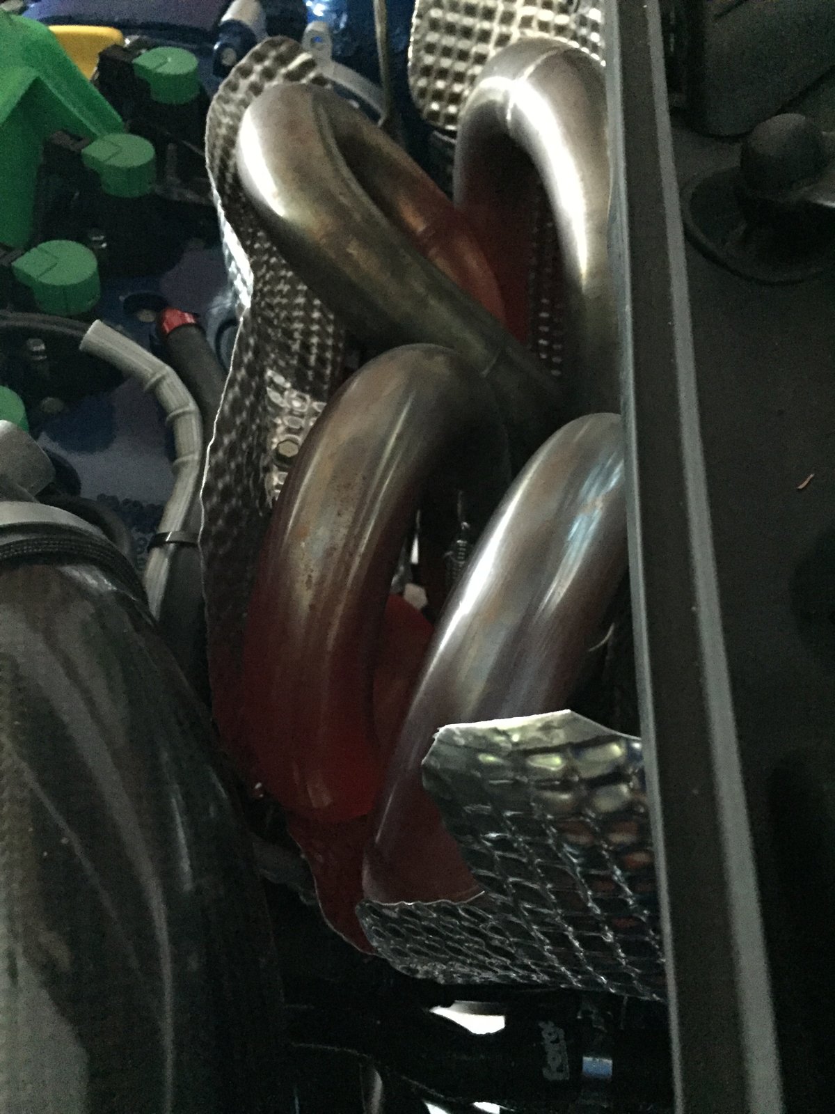

So this is why it's not going to be running on a 172 cup cal file anymoreView attachment 150018The engine was running when this was taken, and yes, it's f**king glowing! Lol! Bit lean methinks. Does look good though!!

I'm glad you've come in here! I'd forgotten that it's on 225 injectors tbh, so combined with a cup map I'm amazed it runs as good as it does. :up:Glowing most likely down to the scatter idle and having a bit too much ign r****d.

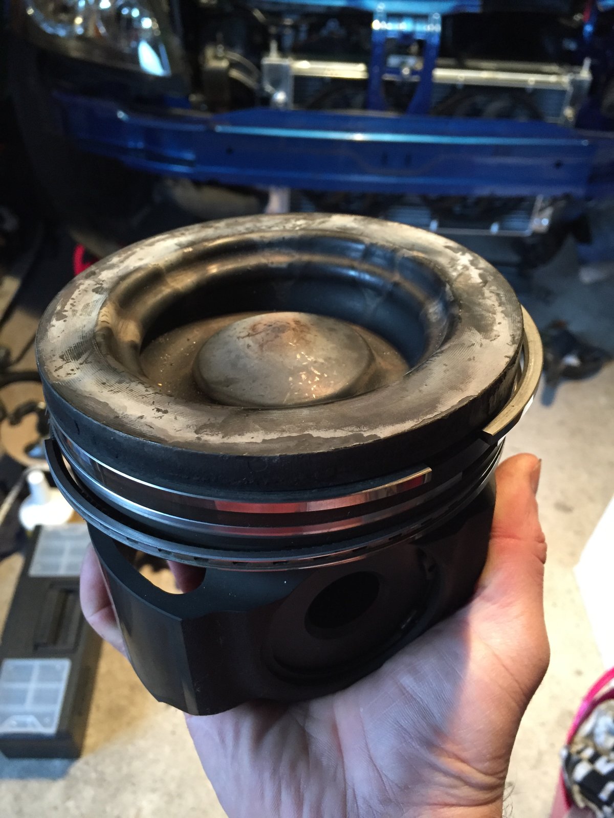

Lol!! I don't even think you could machine the block to fit 2 of them, or even 1!!! That picture is of a 13ltr Scania piston that I have in my possession. Don't ask why! I just like trinkets like that!! 🙈What do I have to do to fit those..... mill the block into a 2 cylinder perhaps! 😂
Not liking the look of what the static CR would be either!!
The heads in the Scanias are flat faced, so no dish for combustion. This is all done in the bowl of the piston, where the air file mix is promoted to swirl/mix - hence the shape. It's a shame I've cleaned it up as you could originally see the spray marks from the injector nozzles.oh I thought it looked like it would give a low CR, looks in the pic like a kinda dished piston crossed with a direct injection like centre to it.
Unless I assume then it is the whole circumference of the outside that is raised above the deck height to give the high CR?
Anyway the weight of that thing would probably take all the power to turn it over! More parasitic losses than a supercharger! :dizzy:
