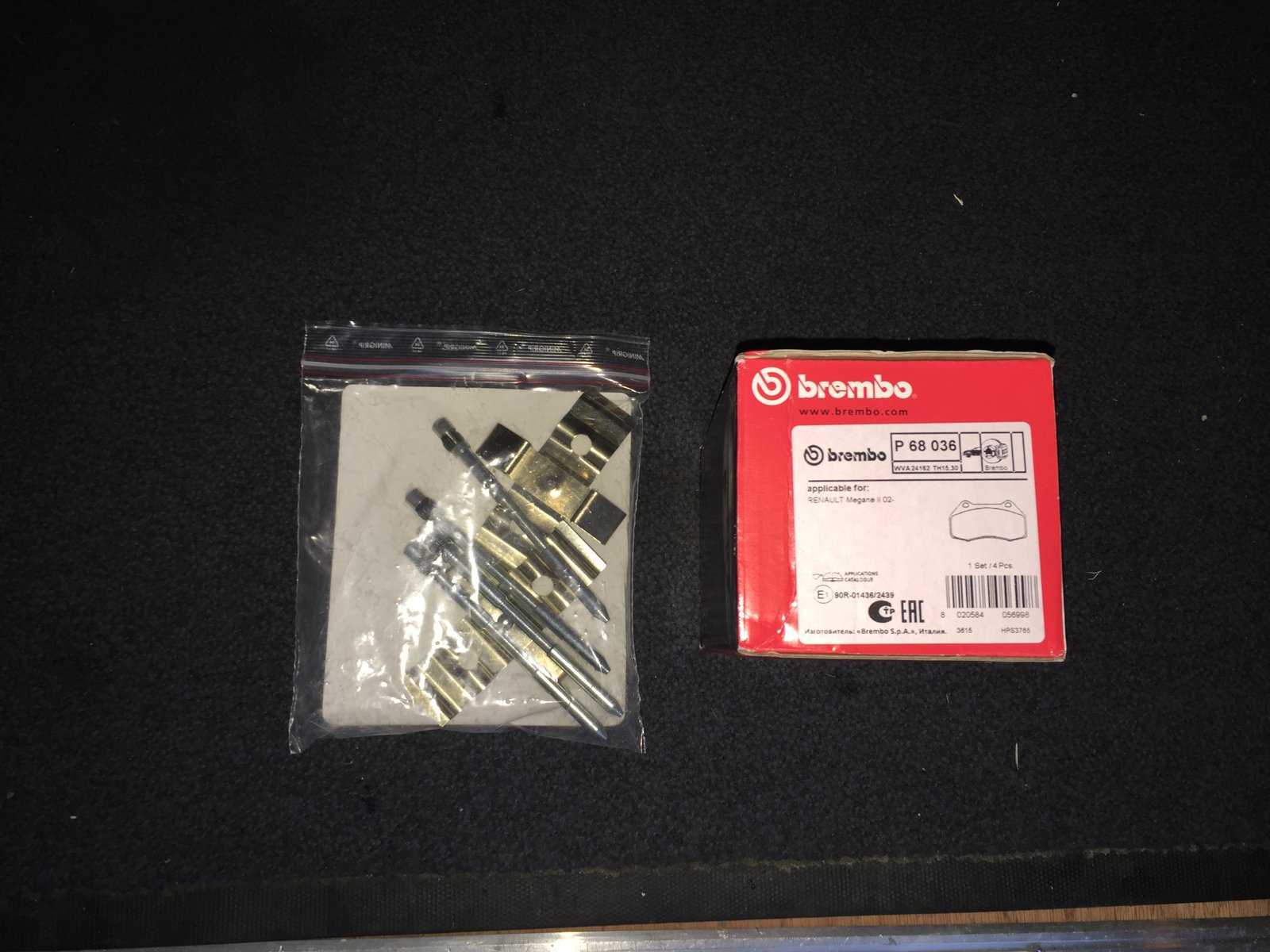

Yeah no worries mate. Just wanted to confirm before the engineer starts doing something different! Where did you guys get the pin kit for the brembos?
  172 Turbo
Took a while but found them
Can do Brembo Pads & Pin kit for under £40.00
