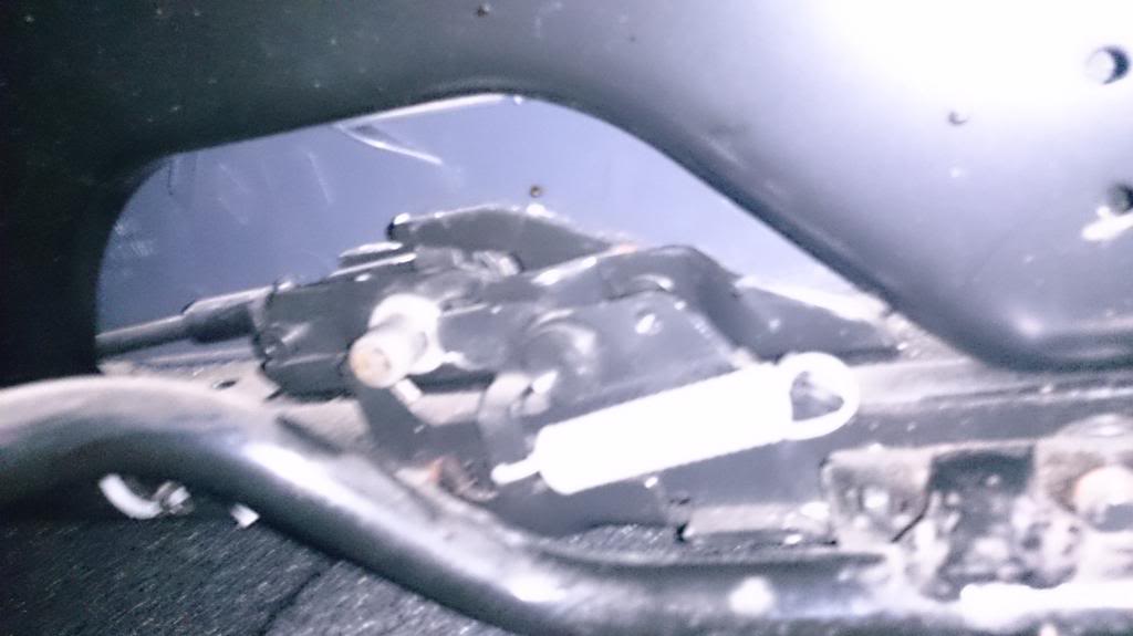

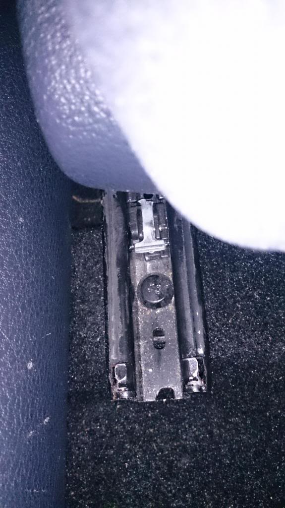

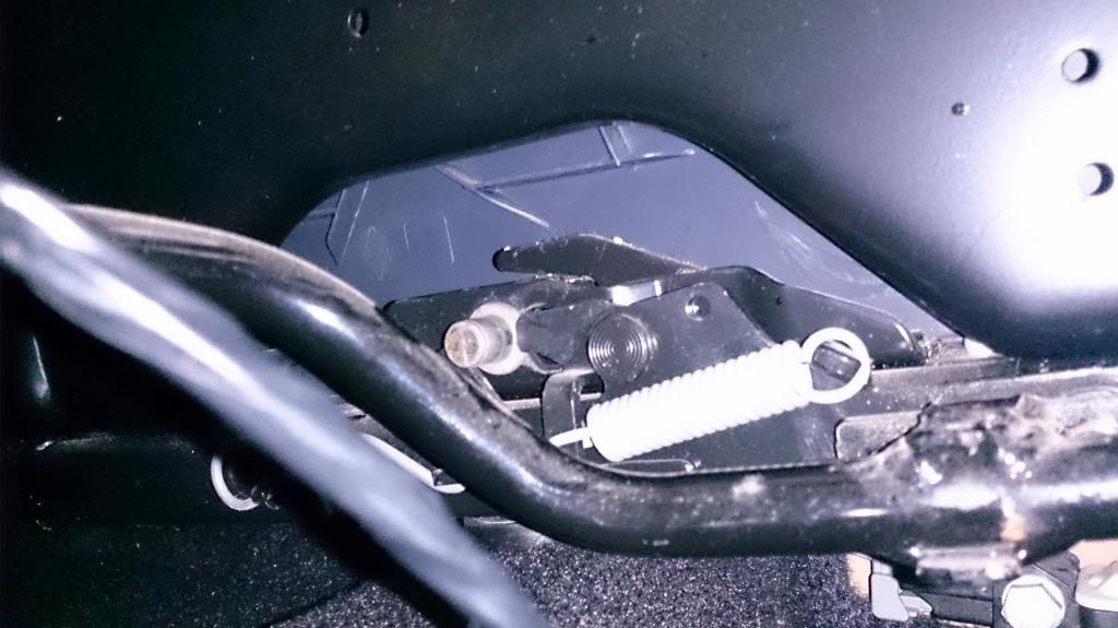

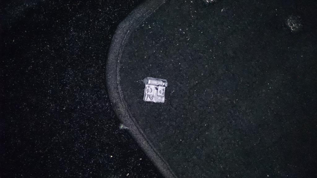

So I got myself a 182 cup yesterday and managed a whole day before something breaking. The passenger side seat is sliding back and forward and will not lock into place. I have taken a few pictures in the dark but can't tell what I need to do to fix it. The pin on the door side rail does not return into the catch and I have found the pictured broken part to the back of this rail.

There all the same runners on the mark 2 and can be had on eBay cheap, just check with the seller the runner doesn't have the same issue as you have posted.
