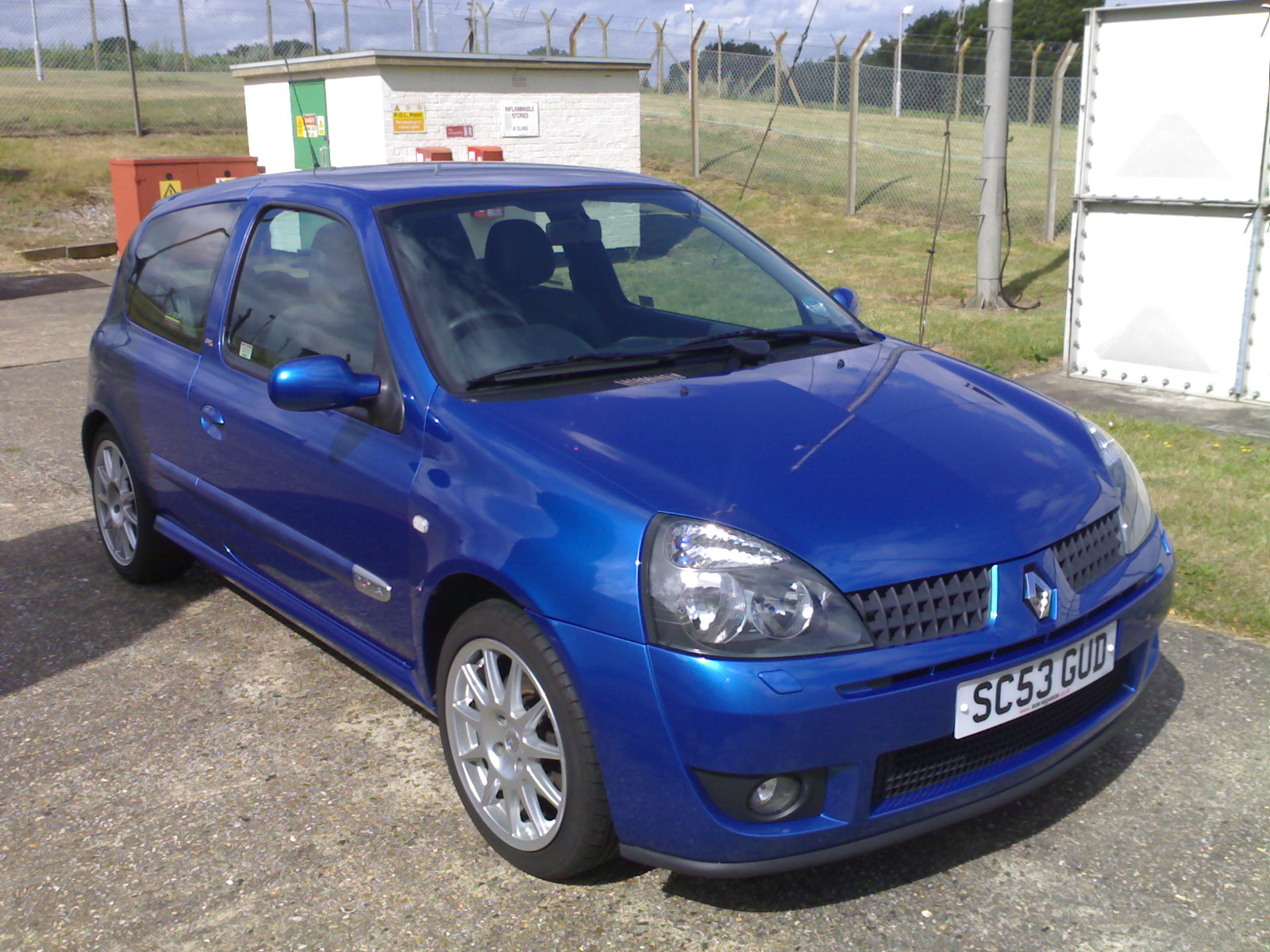

Here She is as i started with her

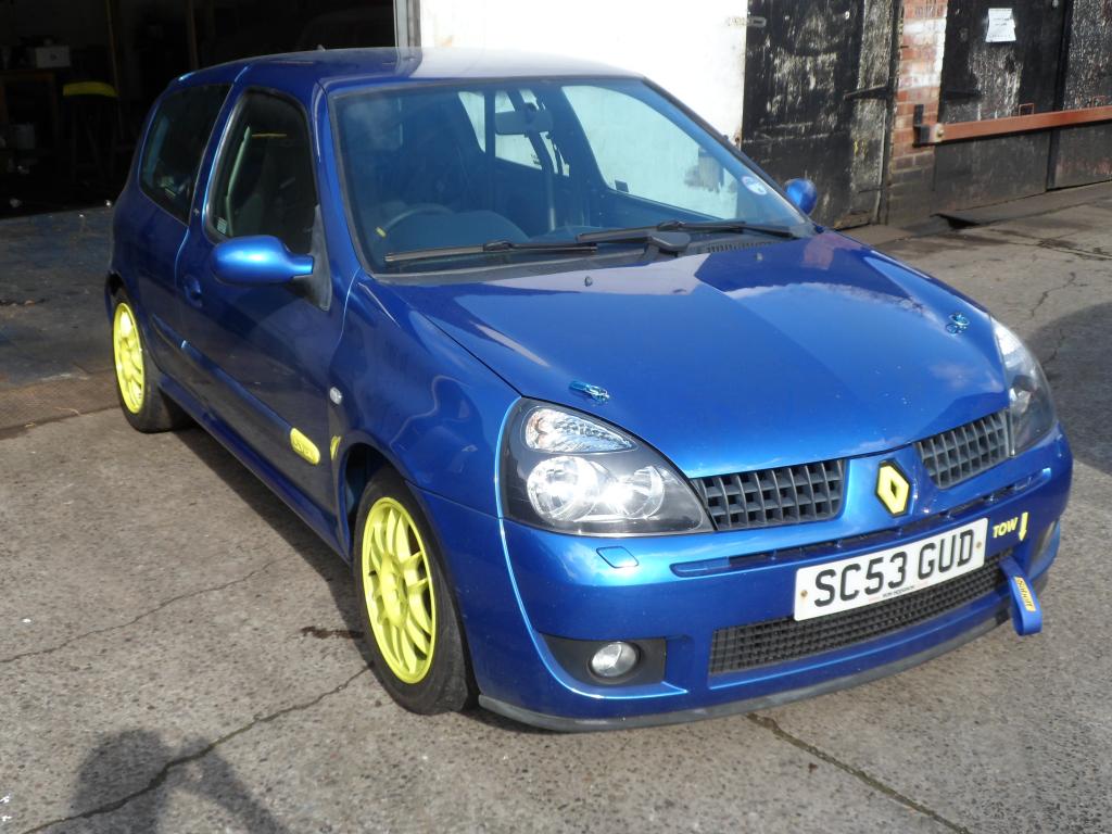

A Very Tidy Car , but was Written off after some Damage to the OS Rear quarter. Sold The wheels and Interior to 2 different memebers off here to recoup a couple of quid back for Goodies and This is how She Stands now
So , We have , Gaz Coil overs , Rear Camber Spacers -1.5 10mm , Front Camber Bolts , OZ F1s , A Cobra Imola Seat , Braided lines front and rear , Bolt in Half Cage
Marangoni zeta Linea Tyres , A phase 1 Airbox , an Odessy Race battery (currently Mounted in the engine bay until i move it) Koni Adjustable Rear Shocks , Oreca Steering Wheel
booked onto Oulton on the 25th Of March - So Brakes need Bleeding , new front pads , passenger Seat and Harness'
The Cost So Far INCLUDING buying the Car is £1100 Quid - Give or Take
Ive been Really lucky/crafty/pure cheeky by Getting alot of Stuff off this great Forum , Ebay and Generally Landing on things at the Right time - Like the OZ F1s Which Rolled in on a Car ready for Scrap and got them for £60
Id like to Say we will Dip under the £1500 bracket all done - Which Makes my Share of £350 pretty awesome if you ask me.
thanks For looking , ill get more pics up as an when.

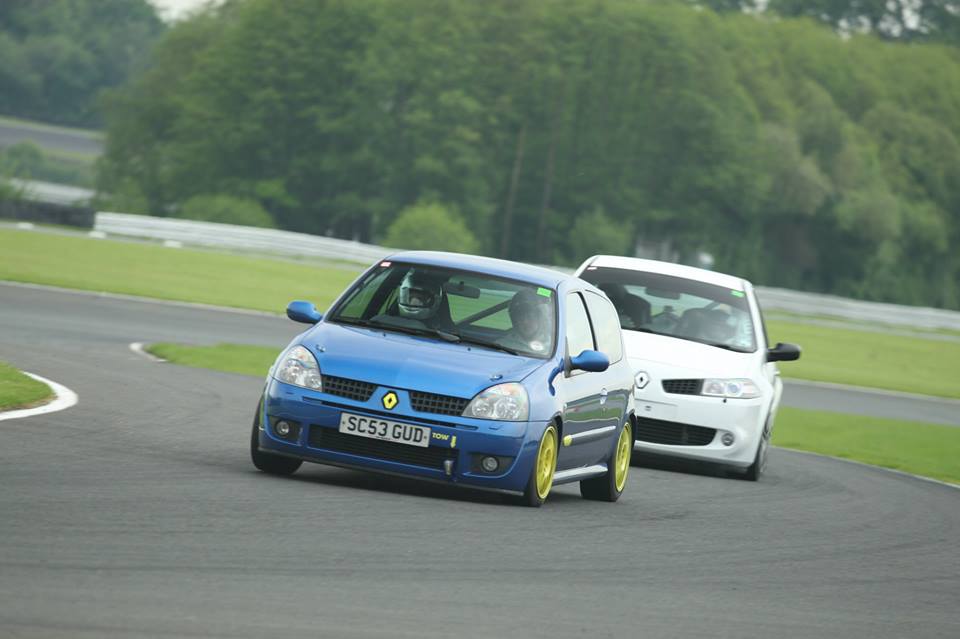

Done 2 Track Days March and May - March was wet , VERY wet , May Was Dry and awesome
Highlighted a couple of problems - a grabbing Caliper on the os which was fixed for the May track day and Then Overheated Discs - Well im presuming it was
Hit Brakes and nothing happened - Running Cheap Standard Discs and Mintex 1155 Pads - Ive got no Cold Air Feeds So that must be a Factor id hope and i was trying some left foot braking to quell a bit of understeer...............
Done 340 Miles on Track and hasnt really missed a Beat - Looking at trying to Do July 25th if we Can Here are a Few Pics From our days so Far - Already Planning a summer make over , pure motorsport suspension/wishbones and solid top mounts would be nice, Think the front shocks are getting Tired But i was told to get them refurbed when i got them , maybe increas spring rates
