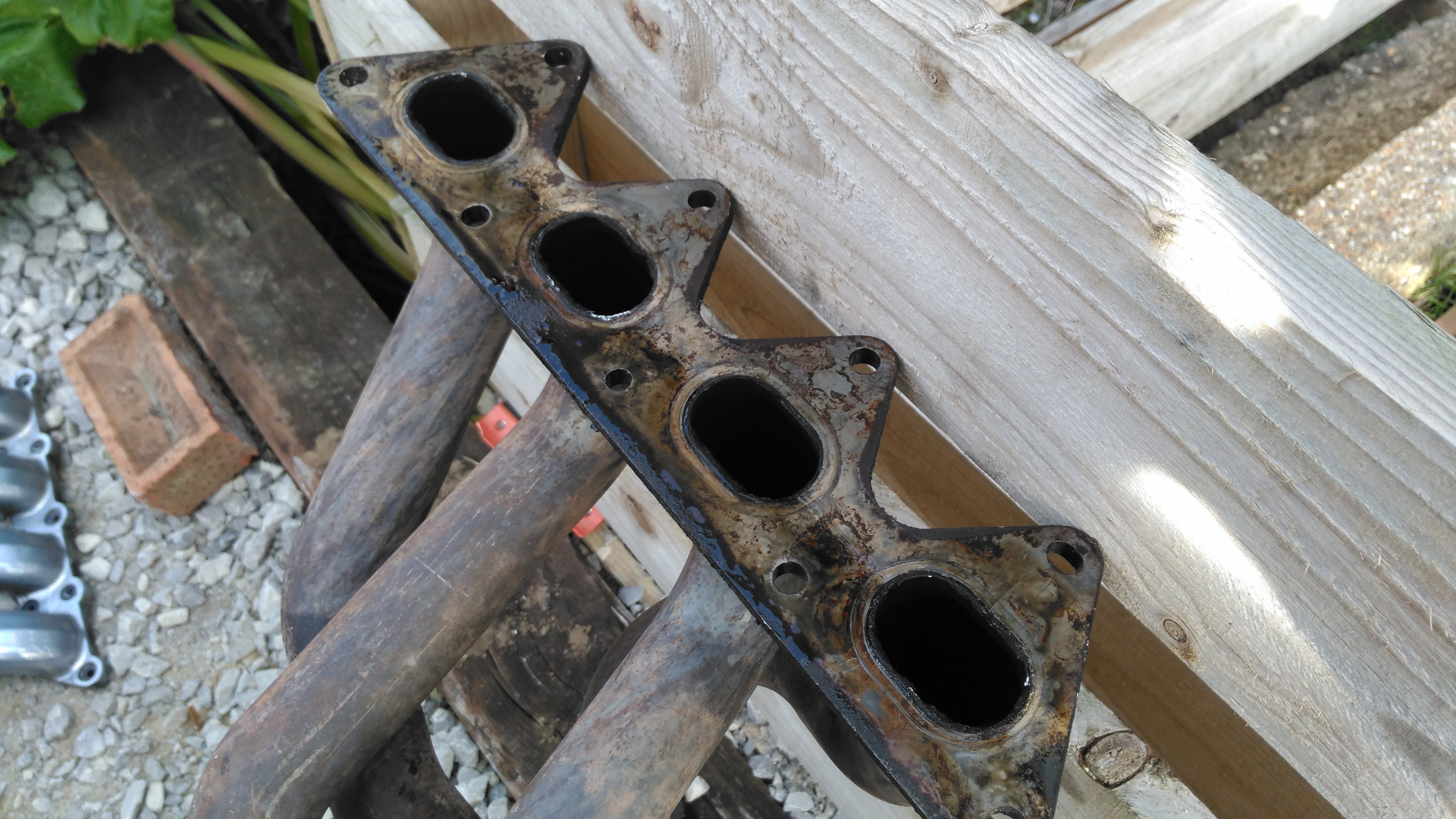

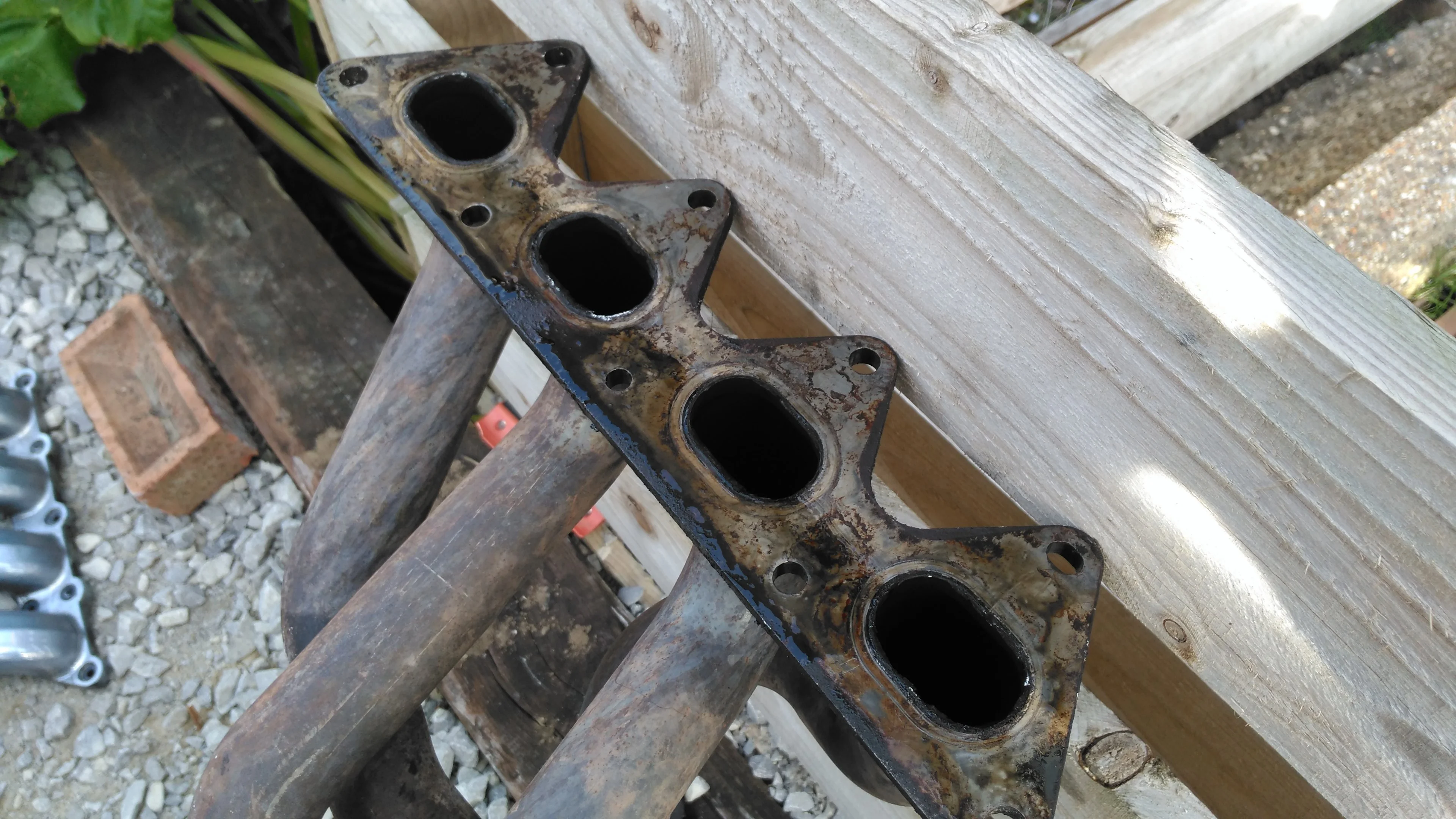

Also, when taking the exhaust manifold off i found quite a lot of oil there on the bottom side of the manifold, almost like it was trapped between the gasket and the manifold? Picture attached shows the manifold.

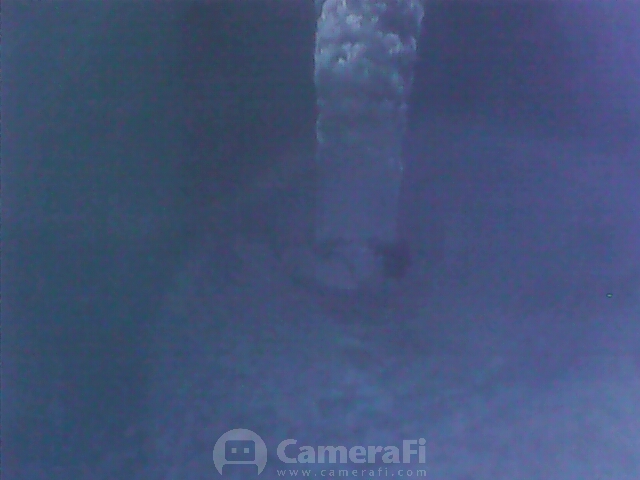

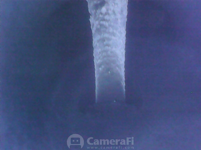

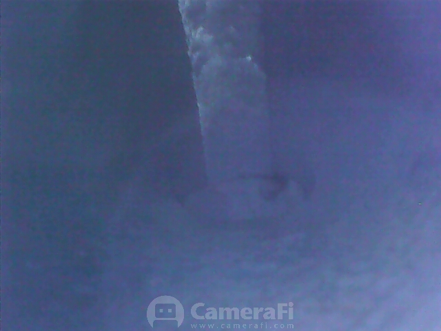

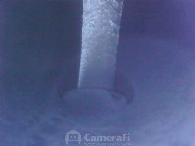

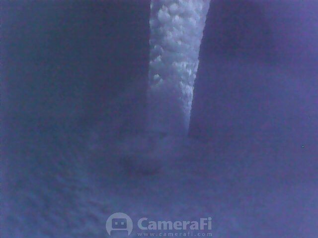

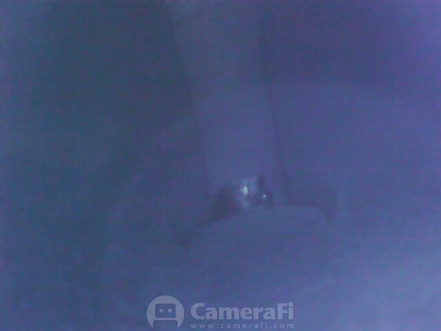

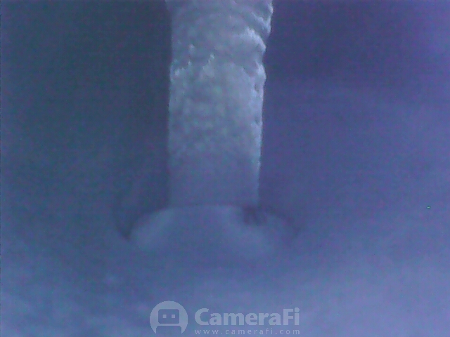

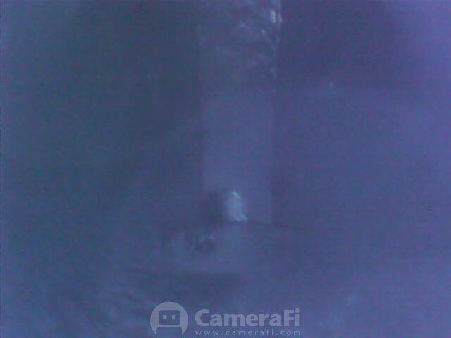

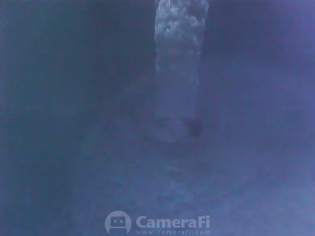

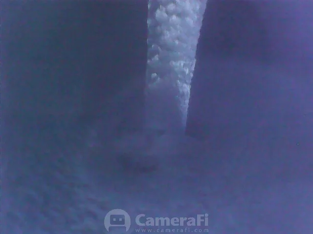

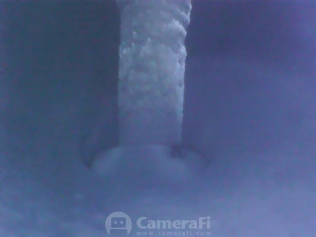

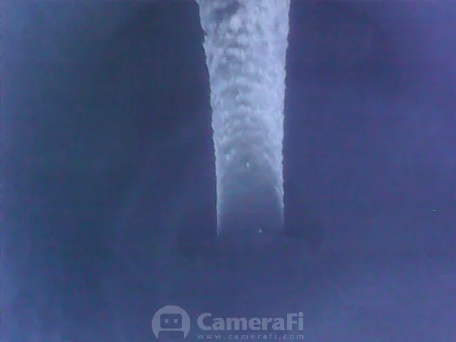

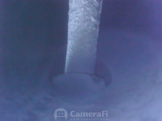

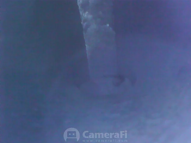

Also a couple of mates of mine have been screaming 'valve stems' at me, so i purchased a cheapy 'borescope' camera that plugs in your phone, and i've noticed some smudges around the valve stem area on some of them? Granted the camera is sh*te quality, but would this indicate anything? The car has been sat up now for around 2 months not started. I've attached the pictures from that borescope too!
I know i'm probably going to get moaned at for not seeing a specialist yet, but they're few and far between in Norfolk and with the gearbox issues its been hard getting it anywhere
181016_173104.jpg181016_173119.jpg181016_173131.jpg181016_173140.jpg181016_173200.jpg181016_173212.jpg181016_173230.jpg181016_173242.jpgIMG_20181007_151102.jpg
