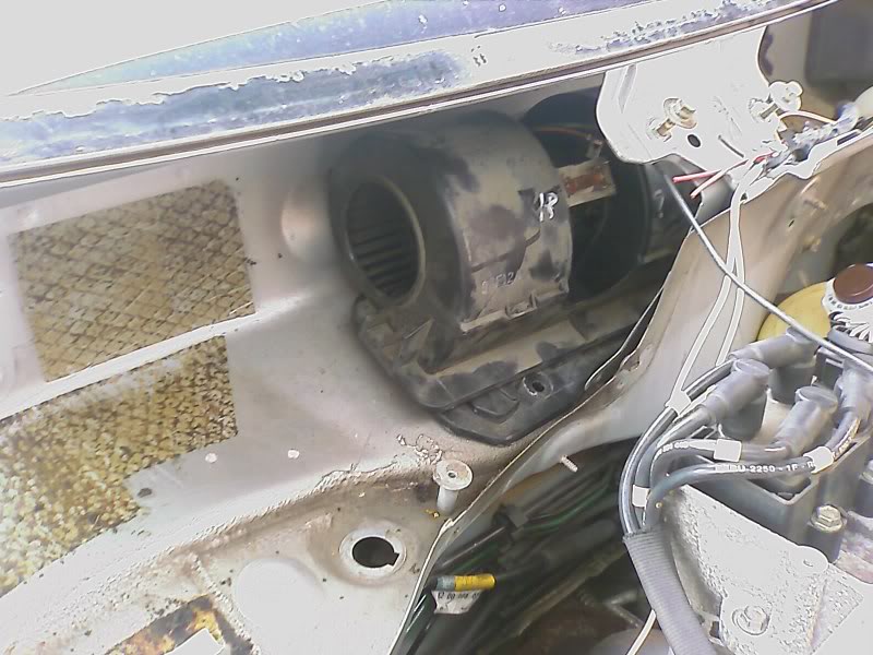

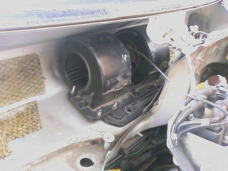

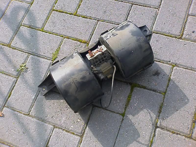

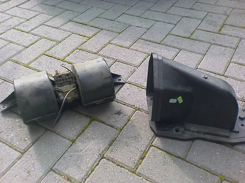

Have something in mind to replace the fan unit, Not sure it will work yet but its in keeping with the normal Burpspeed way.
After searching the local breakers yards for a non aircon heater fan & not finding one, I decided to do something different.
Got a mk5 Escort fan unit for £8!
Now the task of making it fit the Clio.

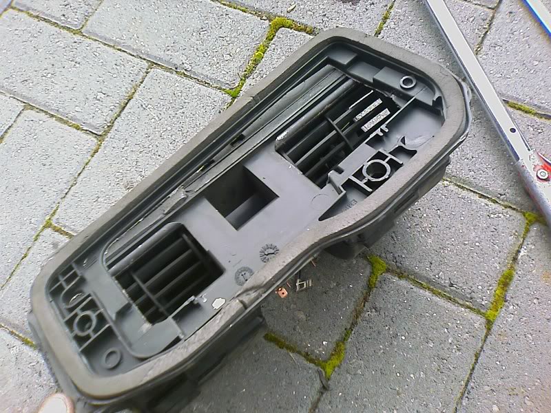

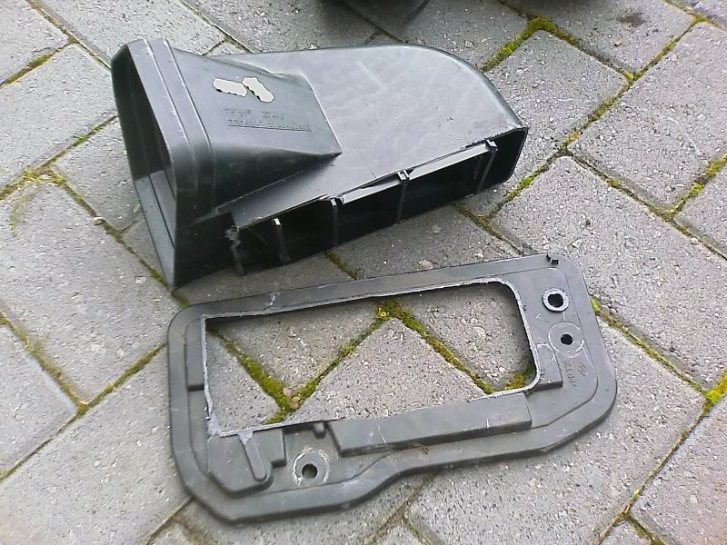

First I cut the top off the clio heater fan inlet, leaving just the base plate to work with.

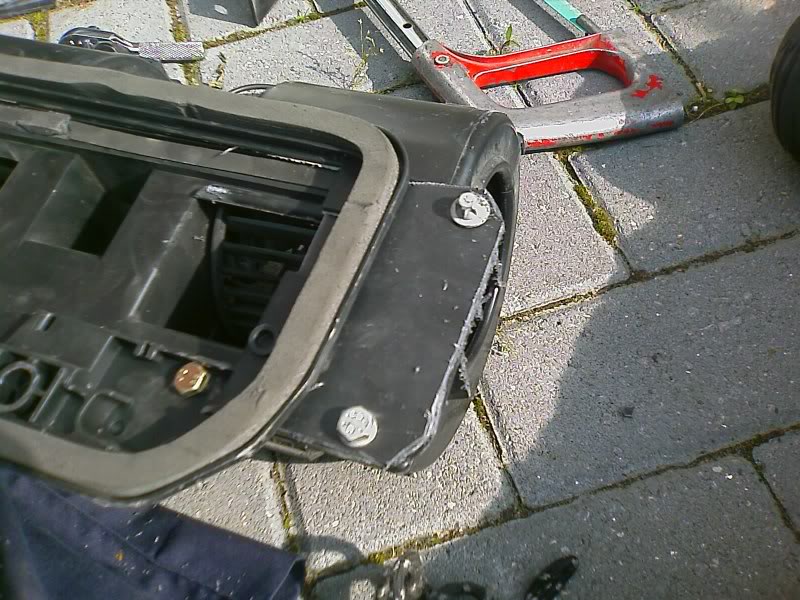

I cut the original mounts off the Escort fan, Then trial fitted the base plate to it.

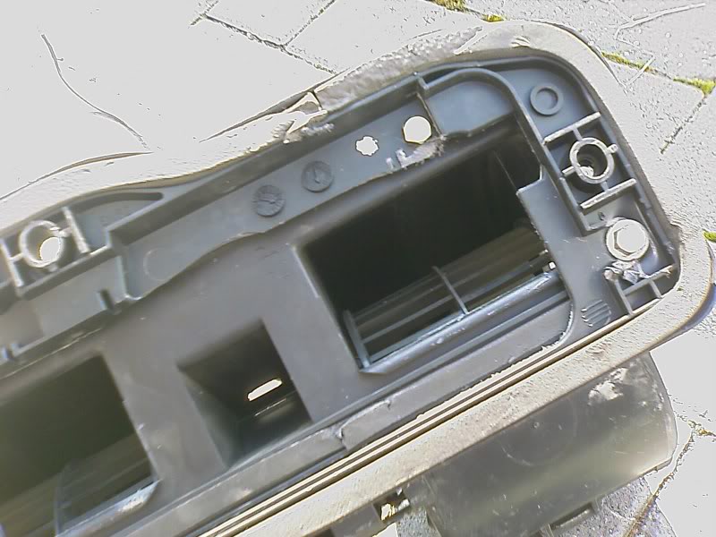

First trial fit & I had a slight clearance issue.
Very quickly sorted!

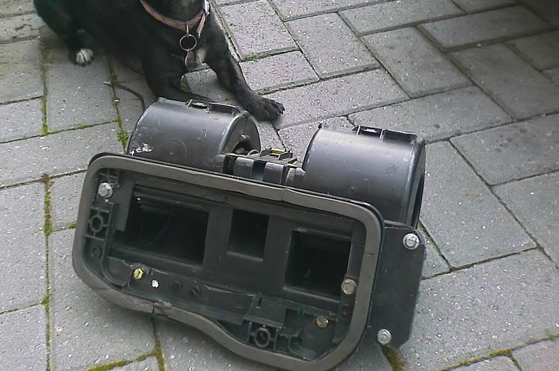

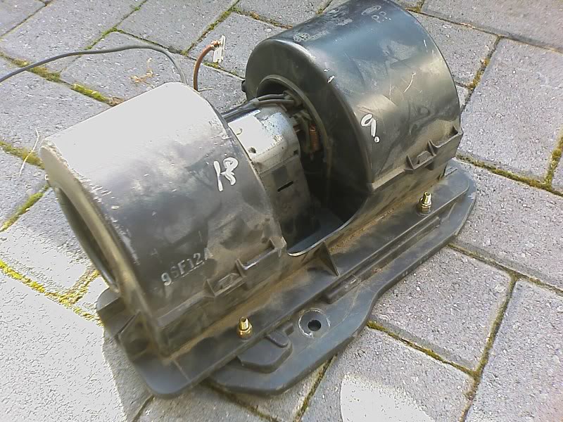

I then drilled & bolted the base plate to the fan unit.
Voila!
The fan overhangs slightly so I made up a little blanking plate so the wind doesn't escape.
The finished item.

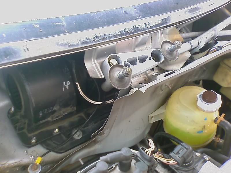

All fitted in its New home & wired up. I'm only going to run a one speed (fastest) fan, as its purely for demisting the screen in wet weather. So took off the resistor pack.
Loads of room to the wiper linkage & motor, its all good.
Also the Escort fan is around 1kg lighter than the Clio one! :rasp:

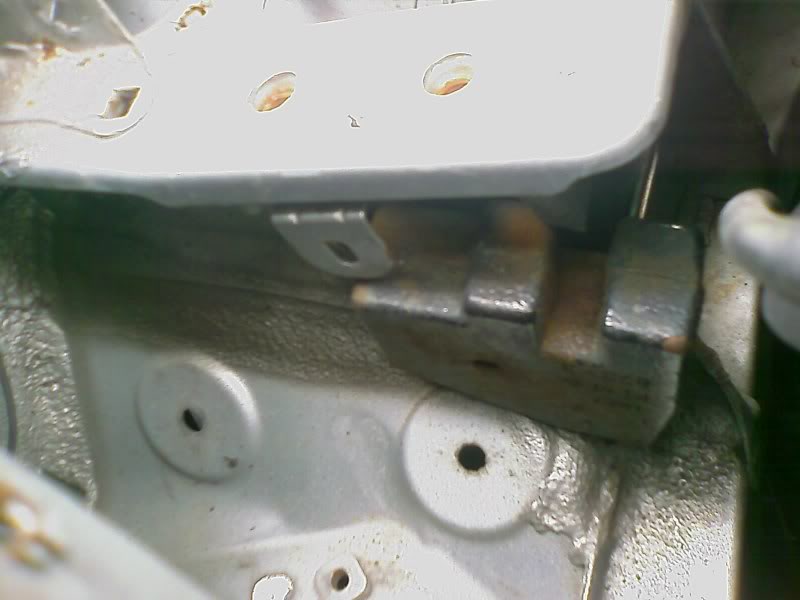

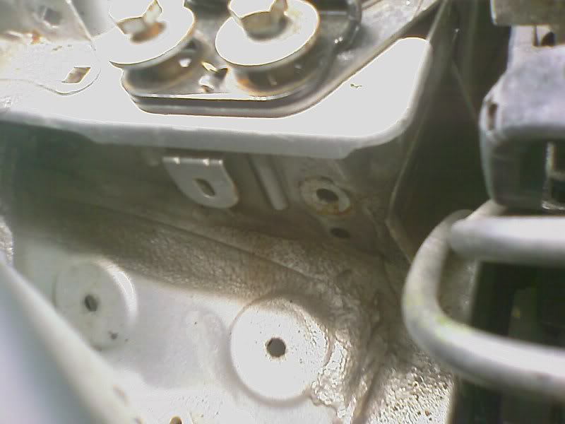

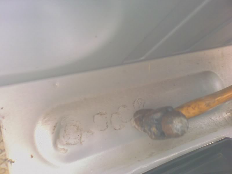

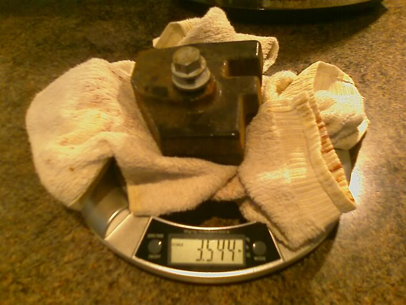

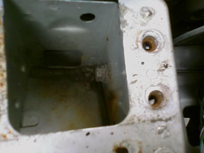

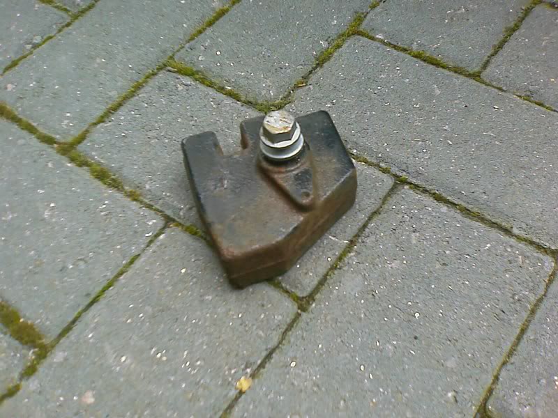

Not a massive update but quite a nice weight saving.
Under the engine mount is a useless lump of iron
Or shall i say, there was.........
Hows this then?
Not as heavy as the one on a 182, that is a massive 6kgs!!!

What exactly does that lump of metal do?
Yosemite Sam
  Whichever has fuel

Burp: Is this easy to remove? Can you do it with the engine and engine mount in-situ?
I've got one on my 182 and might have a crack at removing it.
  e92 + E46 M3 + Cup
Re: My Ph1 172 track sl*g Progress Thread
Its a 15 min job to undo it lol
* remove the splash gaurd
* support the engine on a jack
* un-do the 3 main bolts on the engine
* un-do the 4 bolts from the engine mount
* Remove the bugger burpspeed style!

Sounds easy, but I have visions of collapsing jacks and engines lying in the street!
