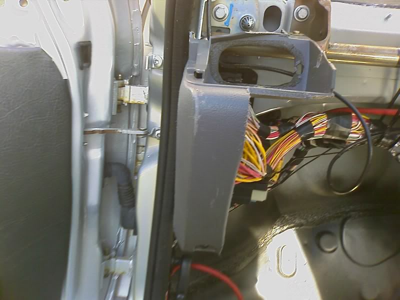

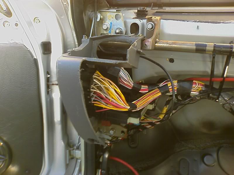

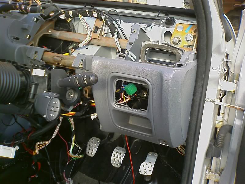

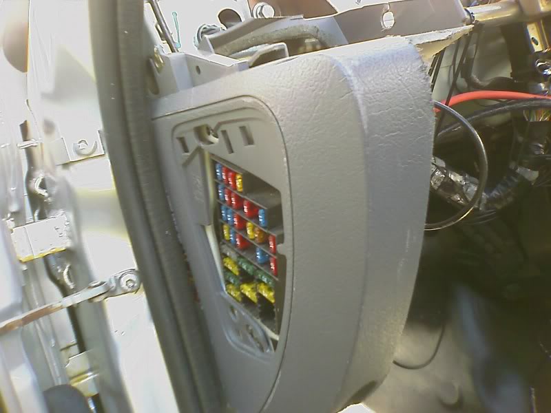

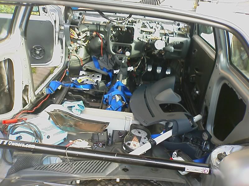

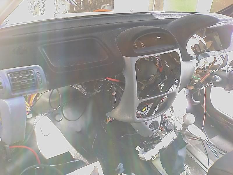

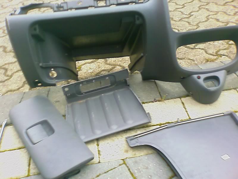

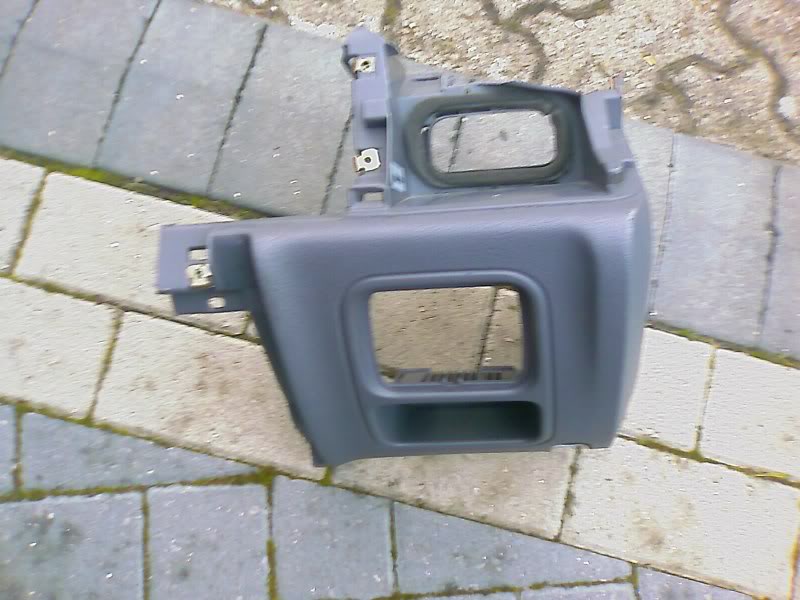

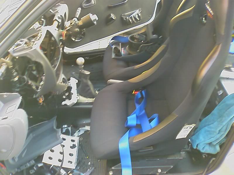

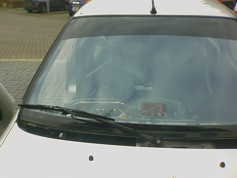

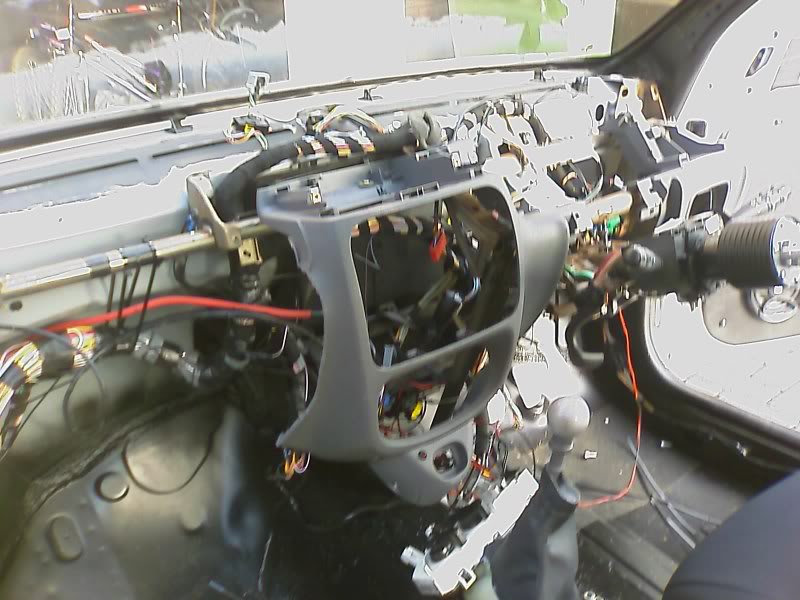

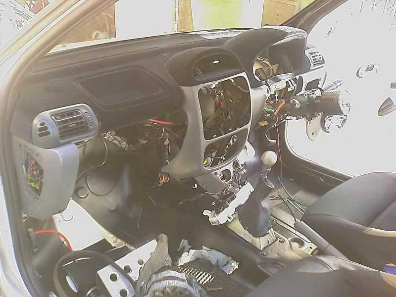

Ok so here is some updates to bring us to the current position. Some of this was done ages ago but it makes more sense to post it all now.

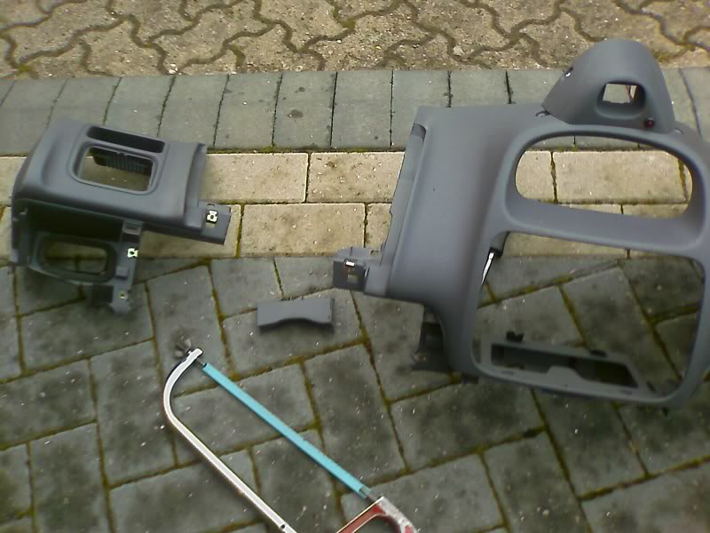

As you know the dash came out weeks ago to remove all the unwanted tar and heater box bits. After getting some inspiration at Castle Coombe rally day in September, I took a hacksaw to my dash. I'm not really sure why now. I had a picture in my mind of what it would look like and it just didnt.
The drivers side is fine but removing the glove box just didn't work, I saw lots of Nova's and Pug 205's with the passenger side of the dash removed and it looked quite good. Doesn't really work on the Clio coz of the more curved shape of the dash. The only way would of been to relocate the fuse and relay box and cut out the metal dash support bar.
Couldn't be arsed with all that and would make the dash top insecure.
This is what i had in mind, just keeping the centre dash with all the controls.
Wasn't happy with the outcome at all but hey ho, loads of other ideas have worked very well so i'm not worried too much. I just need a new dash now :)
Ive sold the flocked top to Adey as i wasn't entirely happy with it.

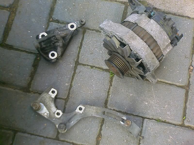

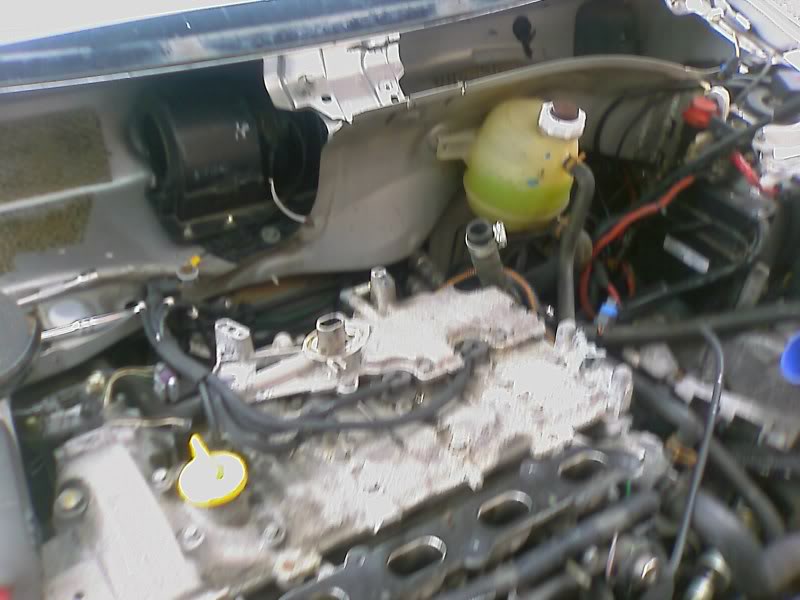

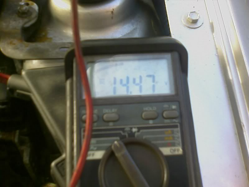

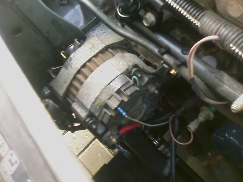

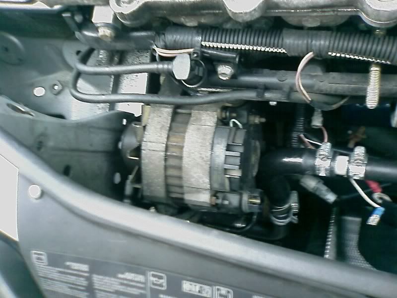

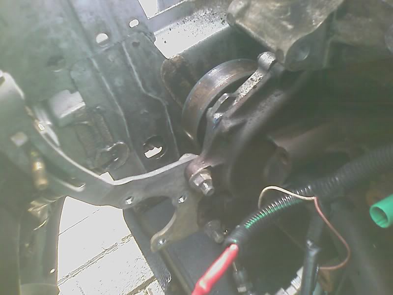

A few weeks ago I sold my Volvo/custom pas and alternator setup to Adey.
So I went on the hunt for a replacement at the scrappy and came back with the same again, my tried and tested Volvo 440 alternator and adjuster bracket, with a Laguna top bracket. Total cost £12!
Bolted it all on and after connecting up my jump pack to the car (ive sold my battery too!!) the car started and ran for the first time since August.
Checked the charge rate of the new alternator and all was well.

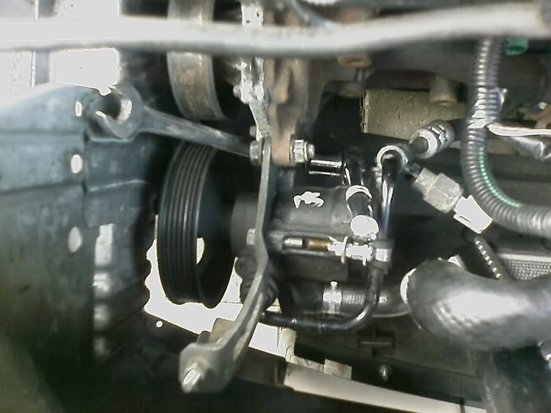

This currently leaves me pas pump less. Manual rack WAS the plan but watch this space.

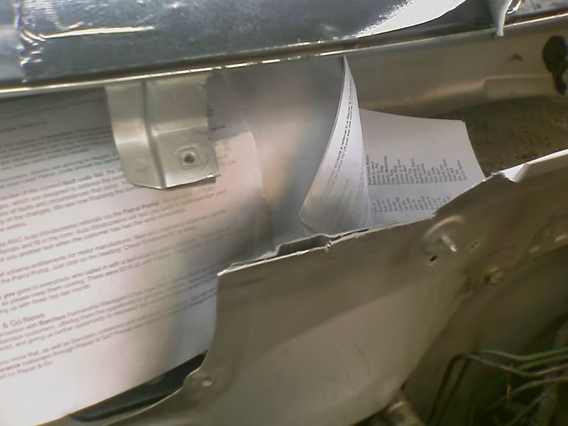

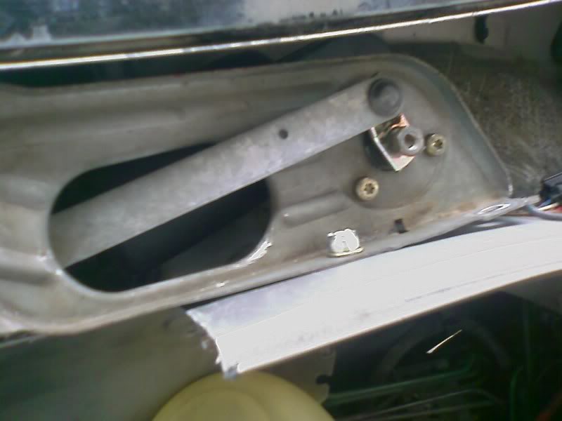

Now, the best bit........ while I was doing this my neighbor said that madness can be cured but i am beyond help.

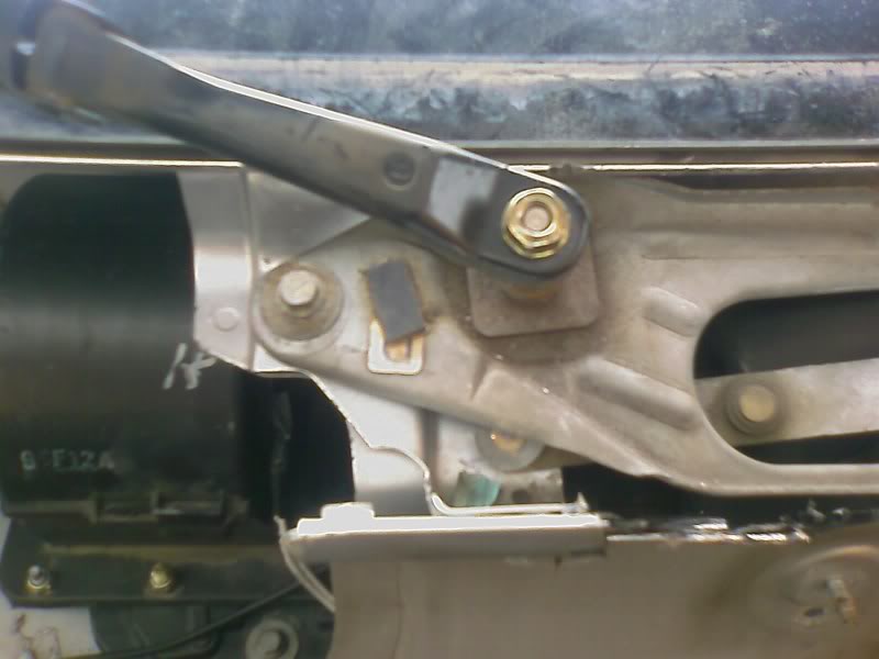

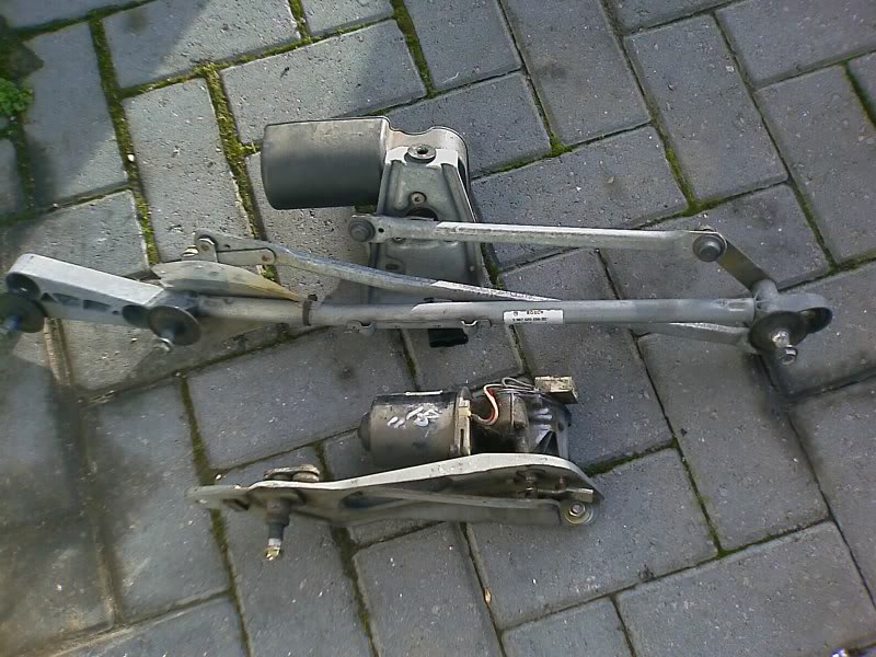

While at the scrappy the other day getting the altornator, I picked up (for the huge price of 8!) a Citroen AX wiper linkage (the single arm one)
Here you can see the difference of the linkages....

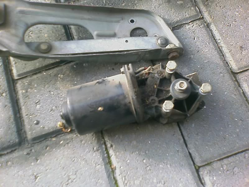

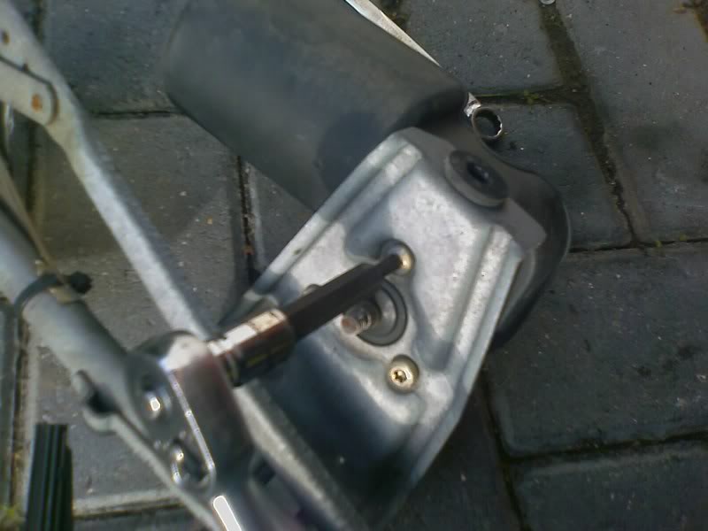

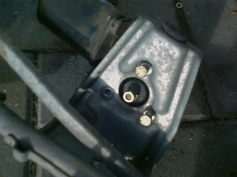

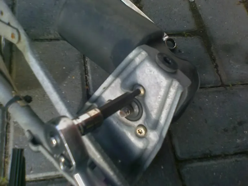

First I took the motor off the Citroen one as I wanted to use the Clio motor to save me having to dick about with the wiring.

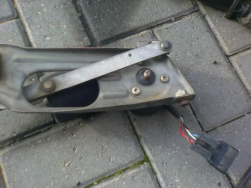

Then took the Clio motor off its linkage.
Trial fitted the ax motor to the clio linkage to make sure the holes line up.............. and they did!!
So fitted the Clio motor to the AX linkage..........

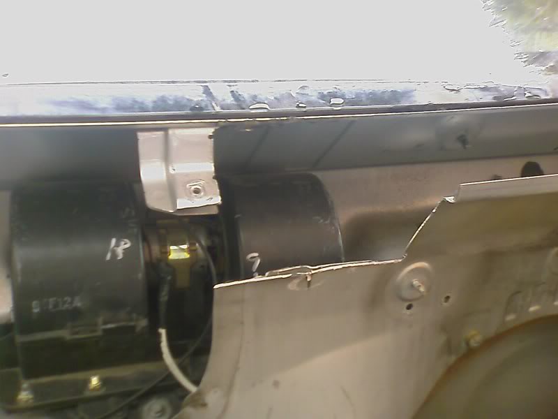

and checked the clearance. The Clio motor being a very similar size but has a cover on it.

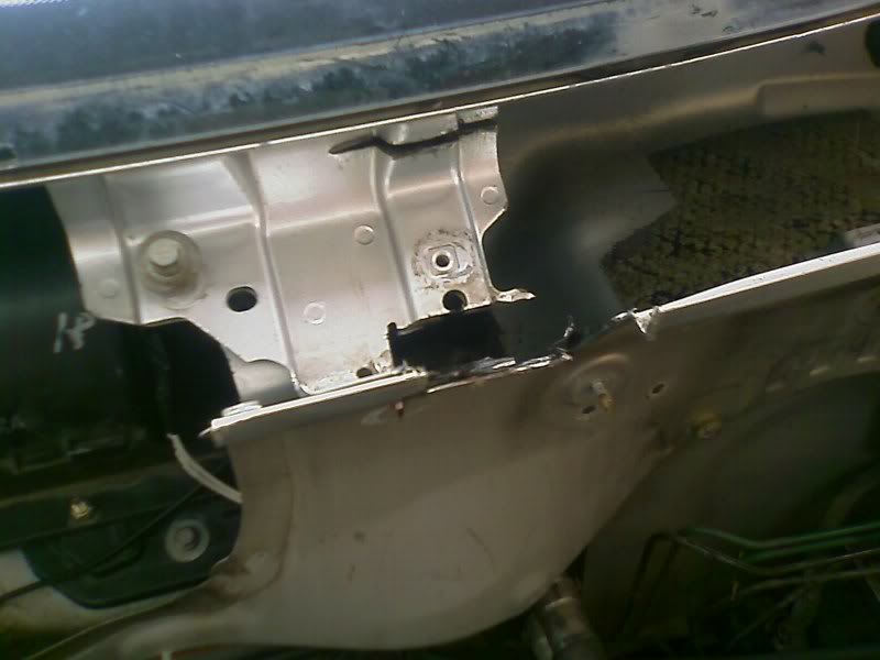

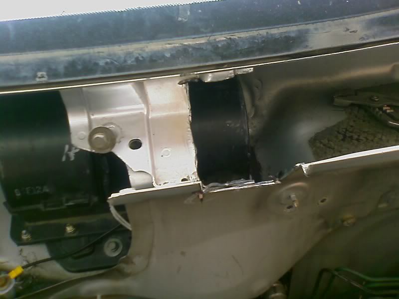

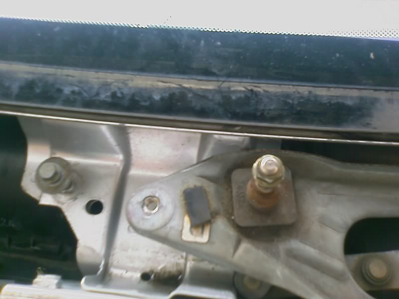

Next I offered it up to the car and realised it needed to be mounted further left towards the centre. The original wiper linkage mount was in the way.

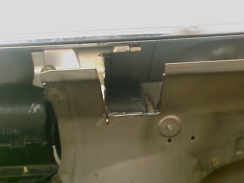

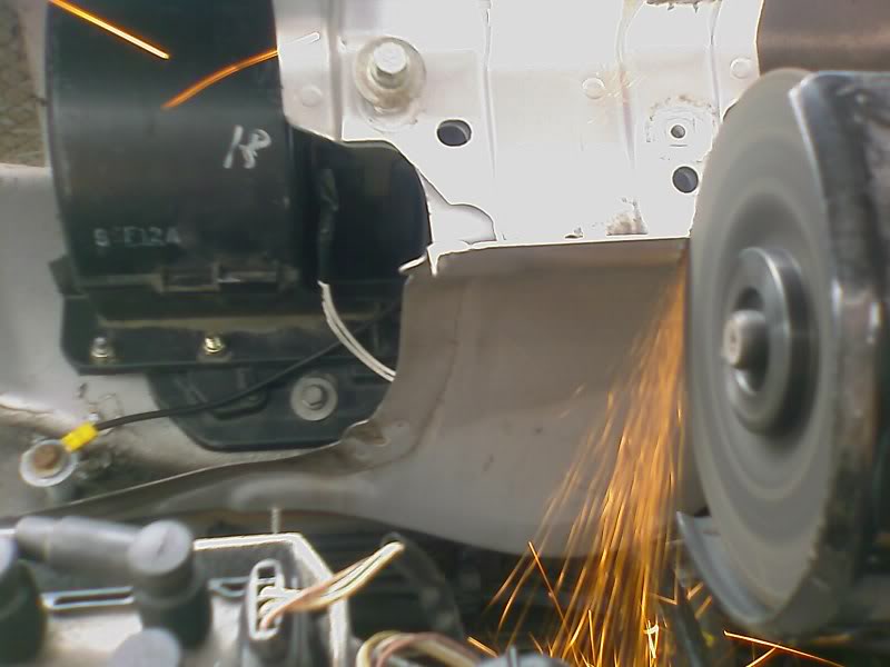

So I made some room with the grinder. Hello old friend! :evil:
Took the plenham of to give me some room.
and went nuts

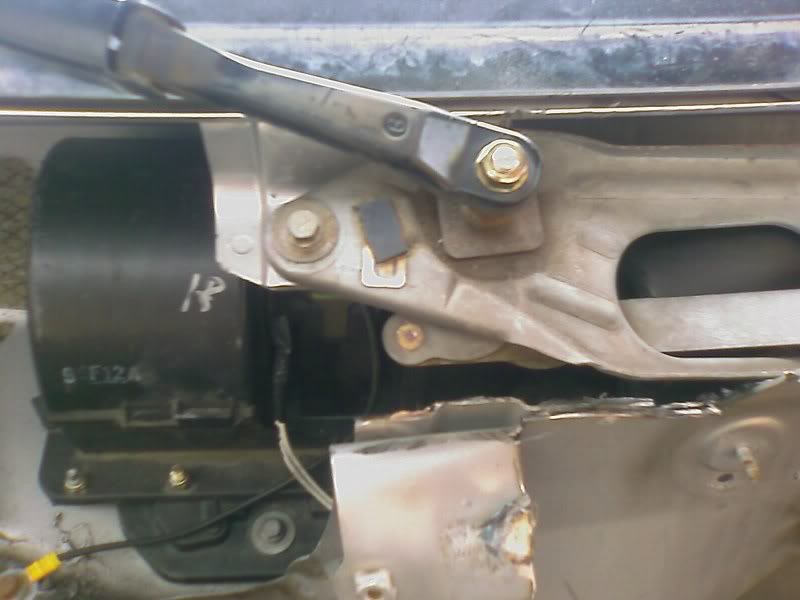

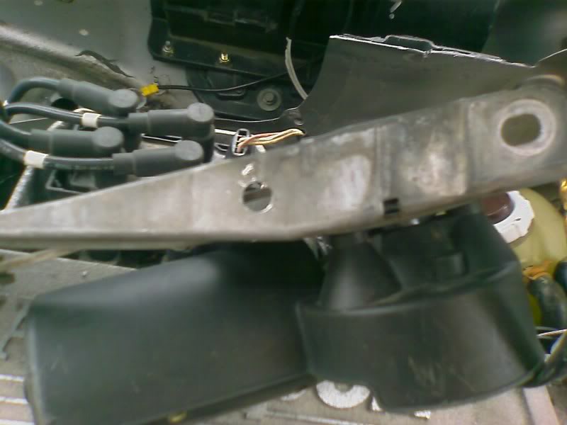

Managed to get the new linkage central, even using one of the original mounting points and bolt.
Loosely put a wiper arm on it to check the positioning.
After several trial and error's, I needed to make some more room for the linkage. It couldn't move through its whole cycle due to more metal in the way.
better, but still catched in places. more trial, grind more off and try again untill i ended up with this.

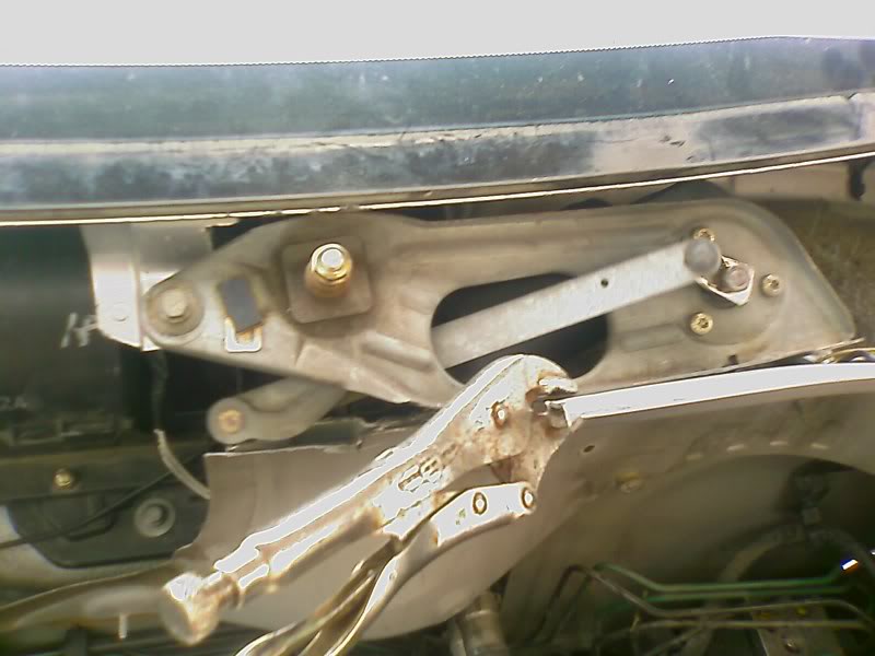

Bolted the linkage in using the old bolt spaced up abit with a nut and used a pair of mole grips to hold it steady while i tested the operation.

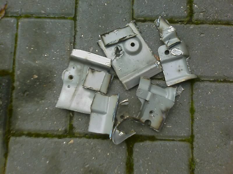

So happy that the grinding work was done I cleaned it all up and gave it a quick paint to prevent rust.
All the bits of metal removed. 0.5kgs! ;)

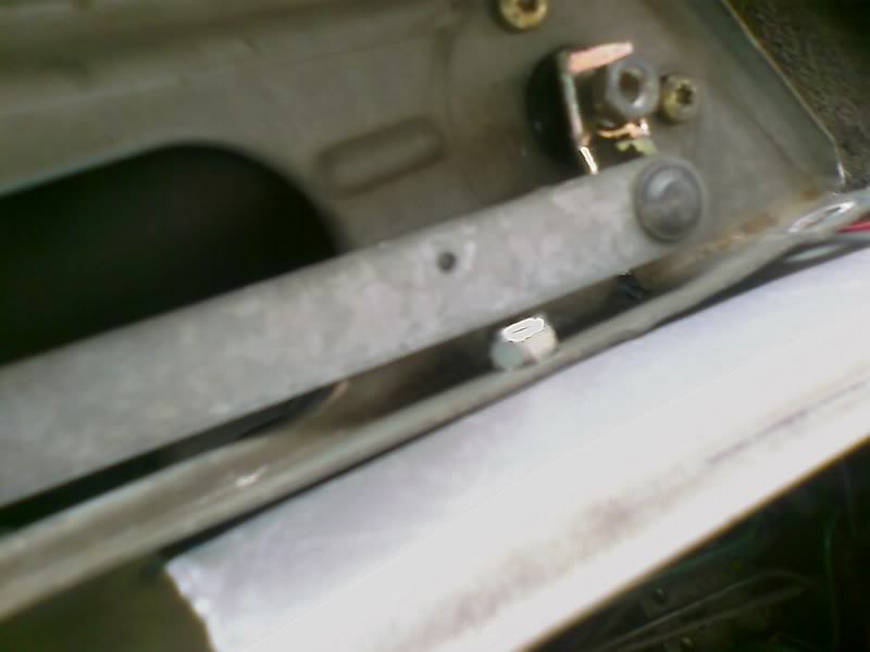

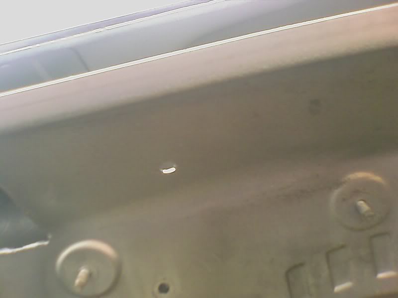

Obviously the mole grips couldn't stay so i drilled a new hole in the linkage to secure it to the bulkhead, the standard AX linkage mount hole not being in the idea place as it wasnt sitting flush with the body.
Lined it up and drilled the bulkhead.
and fitted in.
Had to remove the washer and cut the bolt down as it was very very close to the linkage when in operation. Or too close to the expansion bottle on the other side.
Roughly weighed the old liknage, both arms and blades before I started, then when id finished, the new setup.
Standard Clio = 3.9kgs
Burpspeed linkage = 1.8kgs
AND 0.5kgs of metal was binned.

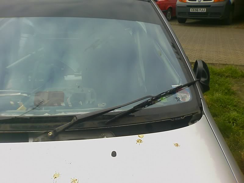

Weight wasn't the main reason I did it. Its different, frees up some space under the scuttle for a future plan and looks cool :cool:
I need to experiment with different arms, blade lenghts, alignement and park position to get the best sweep, but it currently works like this..........

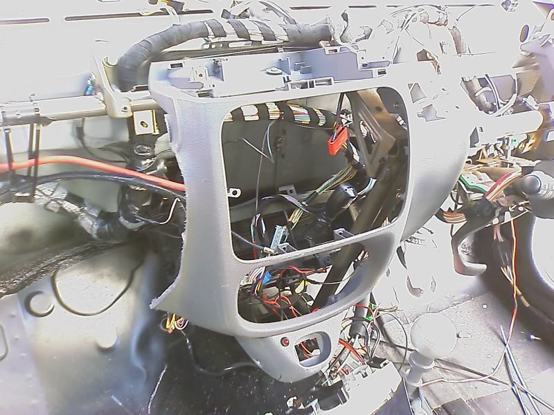

How hard (much of a PITA) is it to remove the whole dash? I've had the top off and undone any bolts I could see but just leant it forward to remove all the brown/foam crap from behind it. Is there much tar behind there??
  172 Race Car
Re: My Ph1 172 track sl*g Progress Thread
No tar behind the dash, just that brown s**t. You will need to undo the heater from the bulkhead (under the scuttle and above the pedals) to get it all out. pm me if u need to know more Dave
Ive spent the best part of 5hours doing this today... so many bloodey wires!!
I removed the top fine, removed about 80% of the brown foam... cant get the part off where the fuse box is though or the heater matrix :dapprove: looks like the whole dash is coming out.... next weekend!
