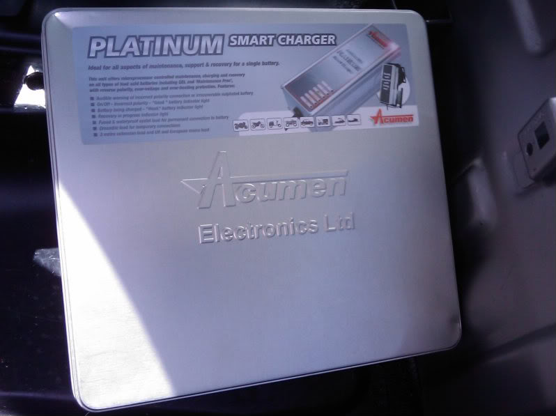

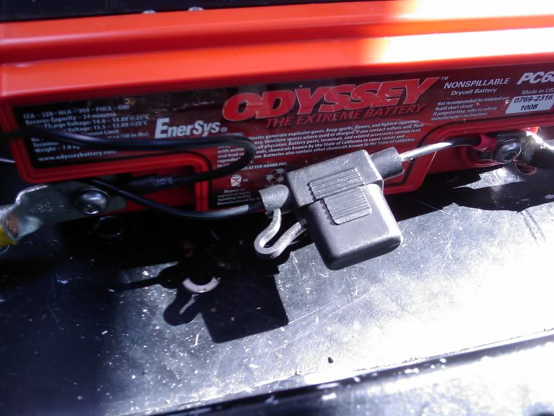

I bought a battery optimiser to keep my 'posh' battery in a charged state while its parked. Cost me £35 from the battery specialist I got the battery from. It has a very small output, 0.2amps, when the battery is fully charged, so it will keep it topped up nicely. The kit come with a small flylead that attatches permanently to the battery. Its just a case of pluginng it in when I get home. I've got no power outside the house yett so it has to go though the living room window, Lol.

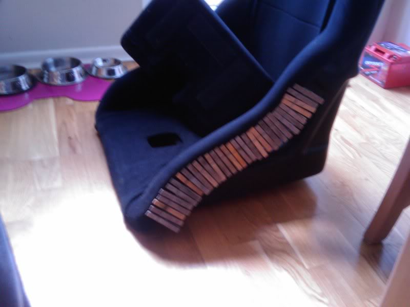

Over the last week or so I've been sticking down the fabric around the edge of my passenger seat. Had to use pegs to hold it down while the glue set. Its much neater now. Will fit it in tomorrow.

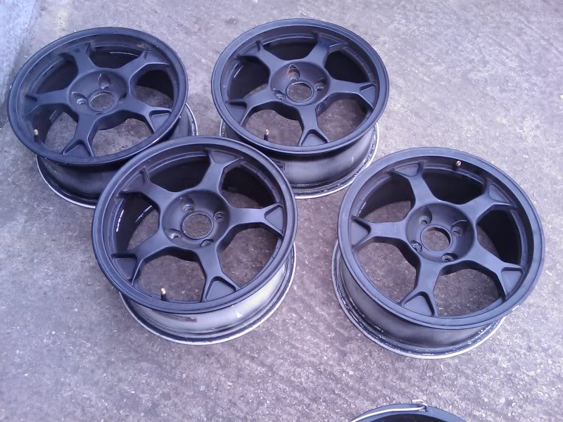

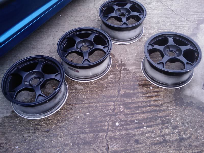

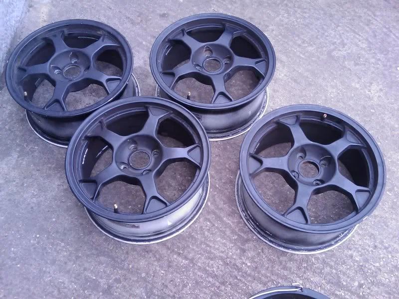

Went up to my mates place to get the track wheels sorted. Had to give them a wash to clean the ferodo dust off them.
My God, they are black not grey! :eek: Then mounted a set of 'previosly loved' R888's. I'll put them on the car before friday so Curtis can set it up with the proper wheels on.

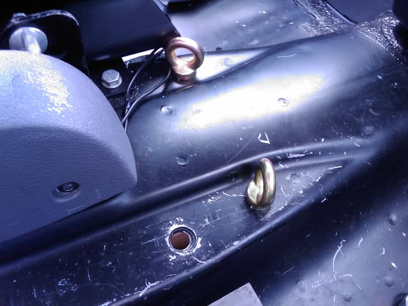

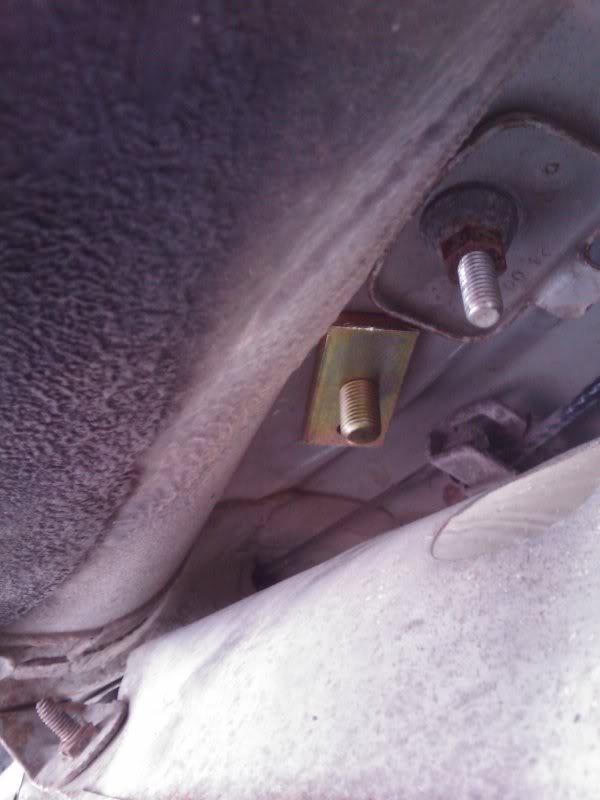

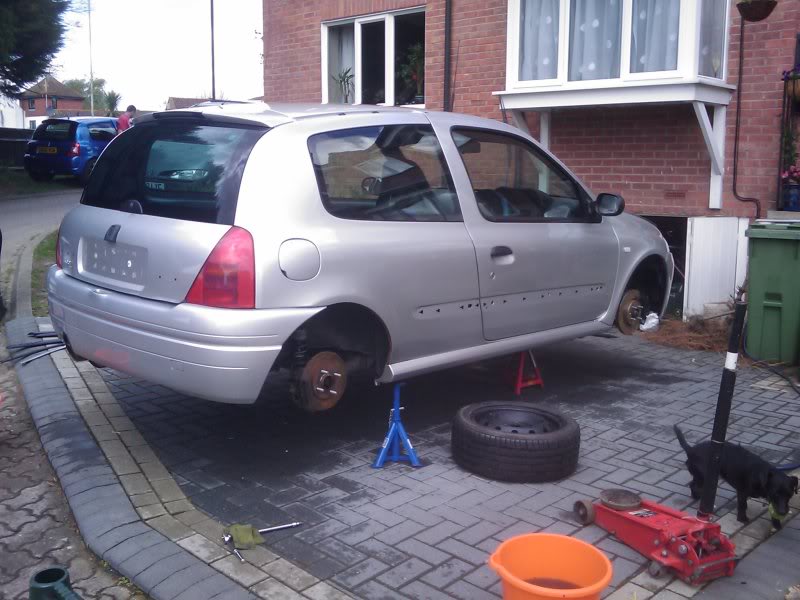

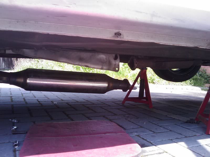

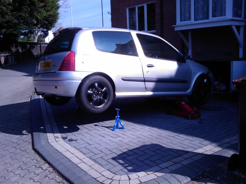

First job was to fit some seatbelt mounting points to the tunnel. I didnt want them on the seat subframe I wanted them further back. i got hold of some spreader plates for them. To do this we had to jack the car up and remove the exhaust to get access to the underside of the tunnel.
Marked them out and drilled the tunnel. They fit very neatly here and are in a perfect place.

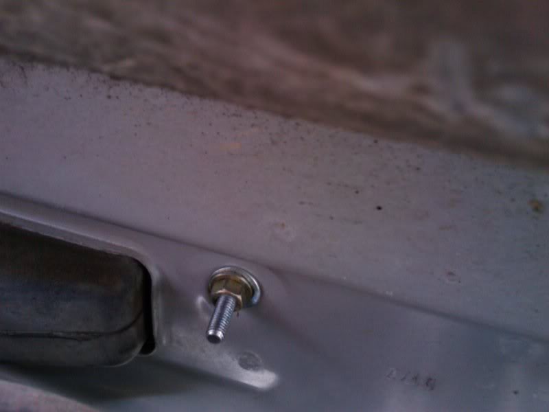

While i was under there I noticed the handbrake mounting stud was ripped away from the floor, so knocked it out and replaced it with a bolt and nyloc nut. Handbrake lever is much more solid now. Probably been like this for ages.

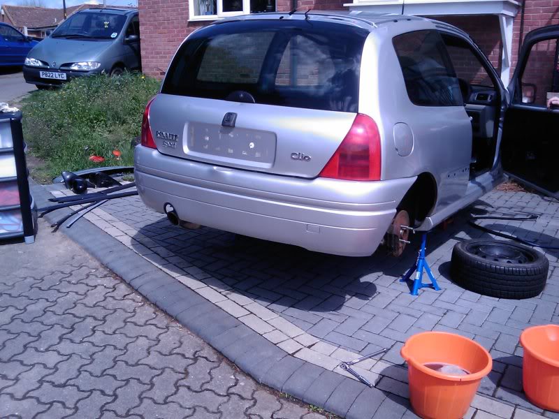

Exhaust went back up (it really doesnt fit very well, hangs so low, a job/expense for another day) So then we could get on with giving it long overdue and much needed bath.

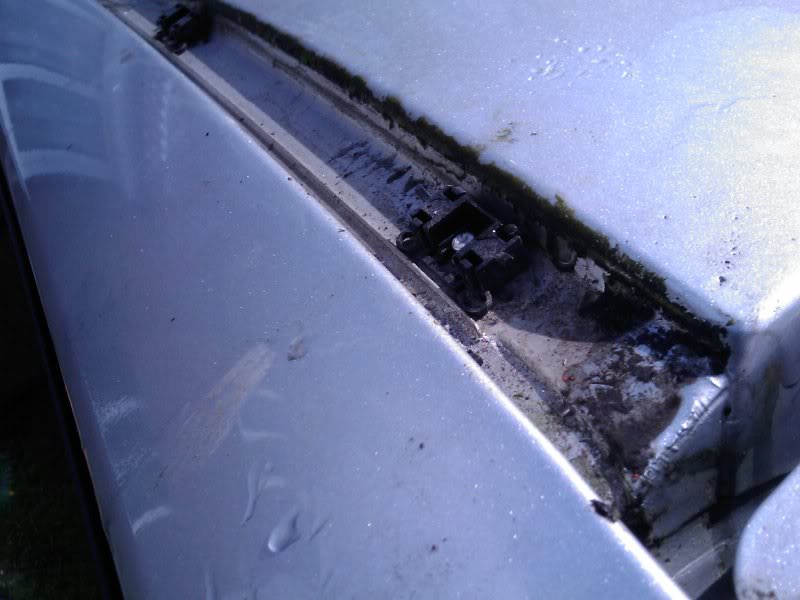

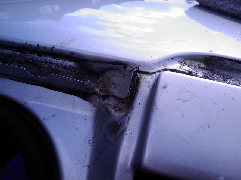

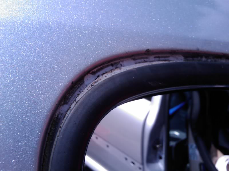

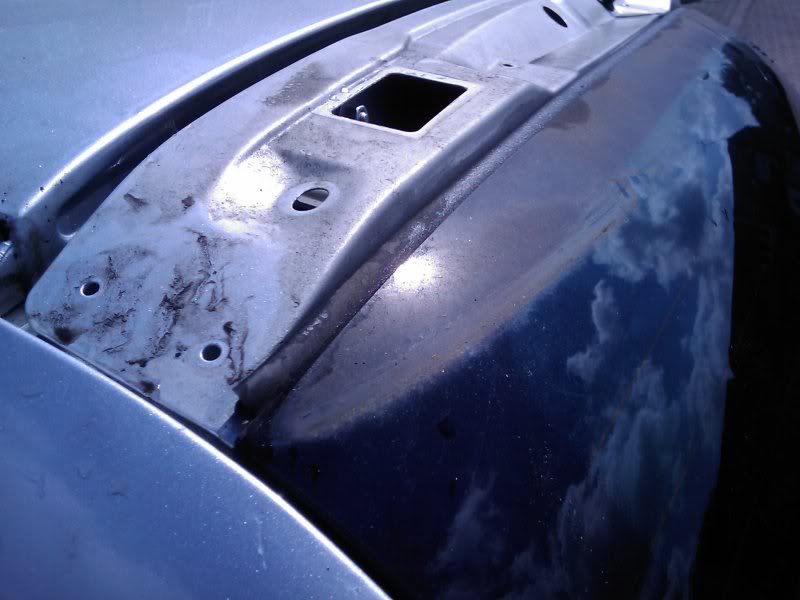

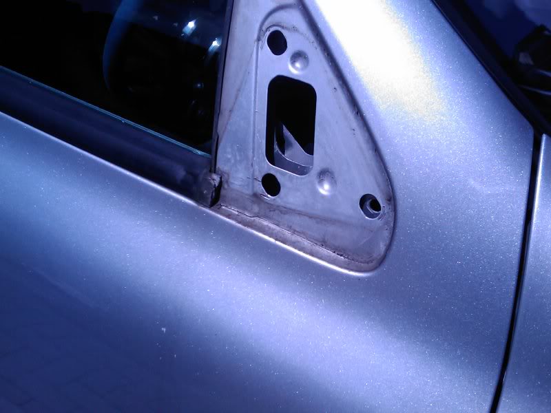

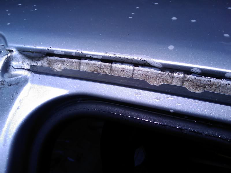

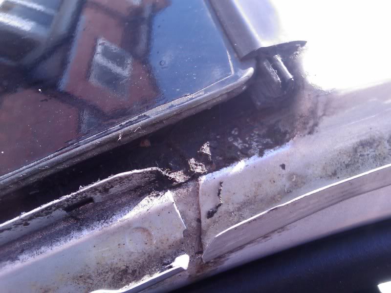

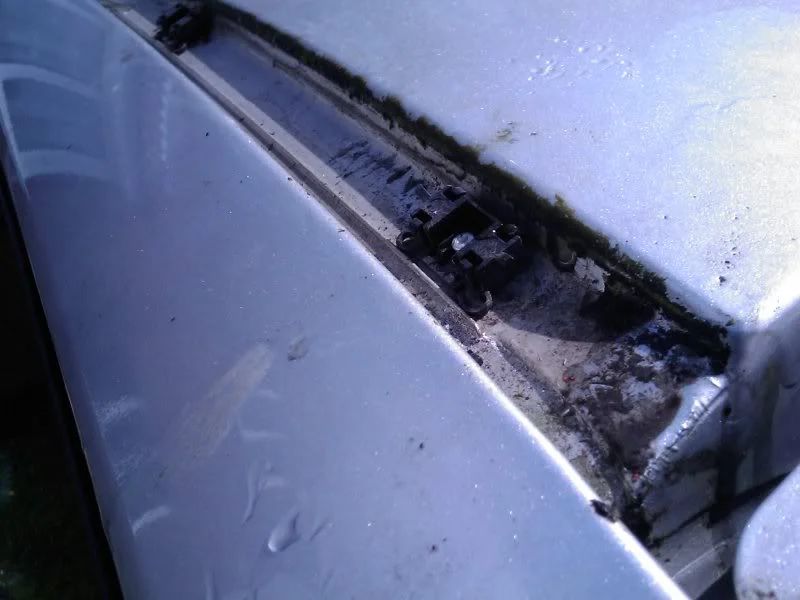

We took all the trim off, mirrors, spolier, bump strips, window rubbers etc, to discover the true horror of it!
:eek: :dead:
Looked like it had been rescued from a pond!

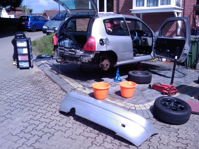

We went to town on it, cleaning it in places that i didnt know existed. Not a mega 'anal' detail but more than ive ever done to any car ive ever owned!

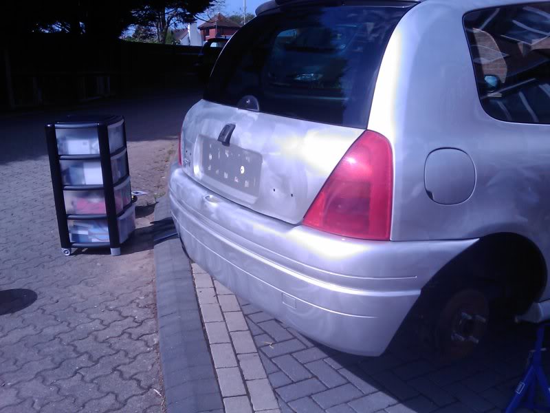

I then decided that now would be a good time to fit that rear bumper id had in the loft since August.
Had to make the cutout and fit the surround to it. Its not perfect but when i get the exhaust sorted out and fitting propery i'll get it tidyer.
At least its Titanium now and not some halfords rattle can guess colour. It has a scuff on the nearside. not too bad, looks much better than the other one so thats all the matters.

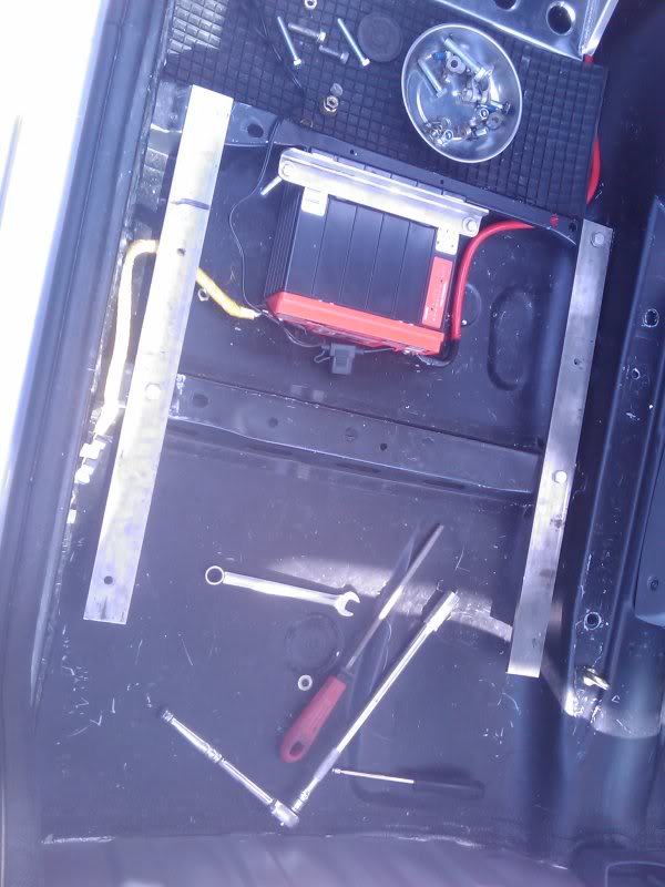

While he was busy with the wax I got on with fitting the passenger seat so we could go out on a test drive later.
Moved the seat further from centre now, as it was far too close to the drivers seat. Its a very wide seat and I may have some trouble getting a cage to fit beside it at a later date.
Probably get another seat before then anyway.

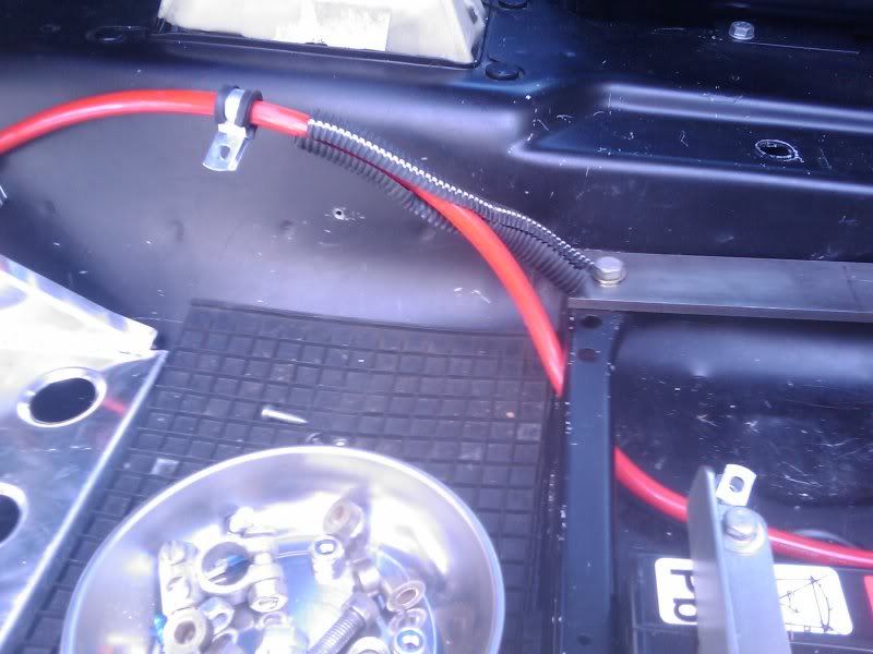

Then I finished off the battery cable.
I havent got a pic of it totaly finished, forgot!

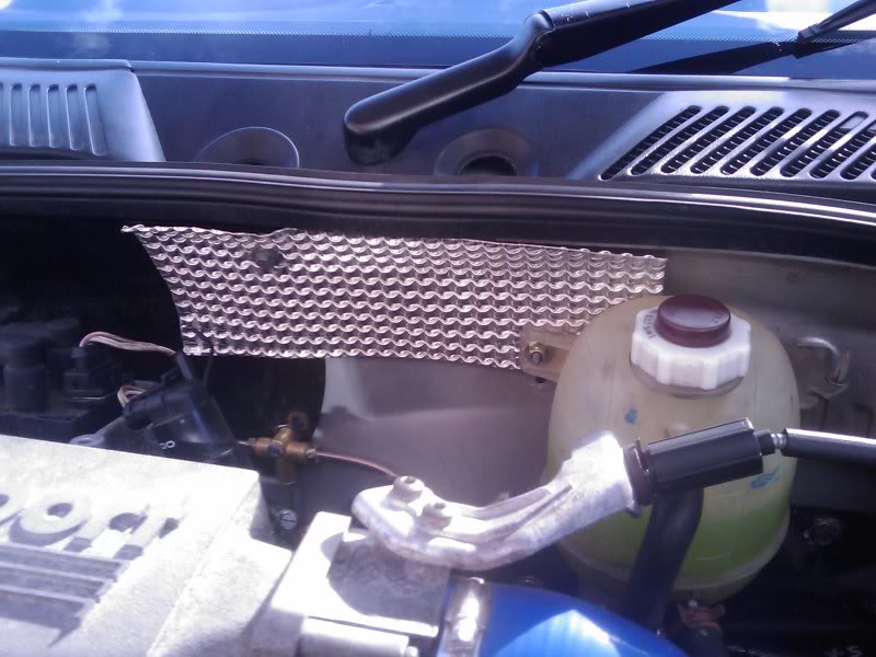

Made up a little heat shield to cover the hole i made in the firewall. This should stop the engine bay heat going into the fan and blowing warn air. We tested this later and it worked a treat.
