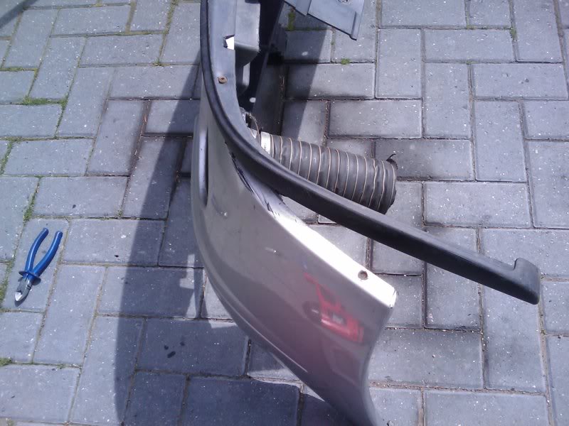

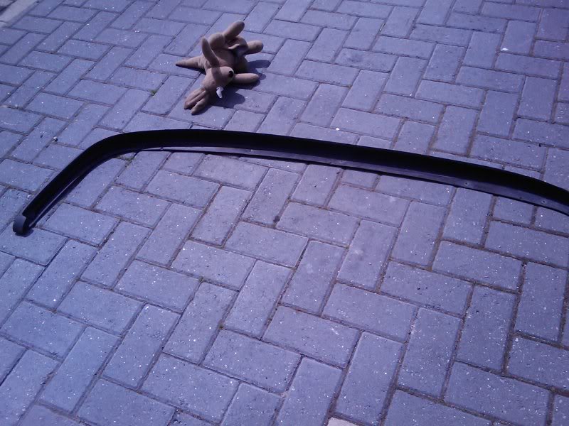

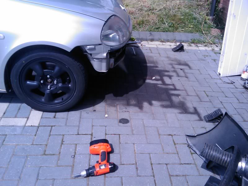

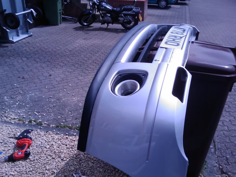

Picked up an old megane spiltter a while ago and fitted it on saturday.
Took the bumper off.
It needed a little strategic cutting to make it fit.
Finished and ready to go back on........
Not bad for £2

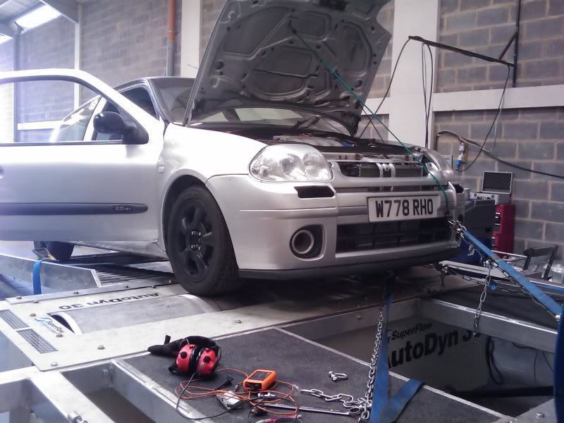

After that I popped down to GDI for a power run. Chained it down to stop the fan blowing it away.
[youtube]<object width="425" height="344"><param name="movie" value="http://www.youtube.com/v/xmSU1etxfR8&hl=en&fs=1"></param><param name="allowFullScreen" value="true"></param><param name="allowscriptaccess" value="always"></param><embed src="http://www.youtube.com/v/xmSU1etxfR8&hl=en&fs=1" type="application/x-shockwave-flash" allowscriptaccess="always" allowfullscreen="true" width="425" height="344"></embed></object>[/youtube]
The result?
181 bhp and 157 lbf
Still with a cat and stock inlets, not bad for 106,000 miles.

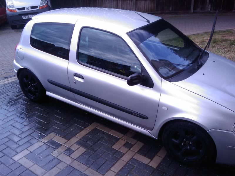

Today I gave it a quick wash :eek:
Twice in a year! :nono:
What have I become?
Was for a very good reason tho. A few of the locals got together for a proper photoshoot.
Cant post any pics yet untill Shadowness has finished editing them but the results look good.

Looking good mate, PH1 standard inlets are shocking! Getting them matched + the de-cat should see really good gains, what maps it currently running?

All in good time mate. Will be getting the exhaust sorted later this year.
Running the Group N map and 98Ron.cal file.

sweet matey, fair play on 181 bhp too, i really gotta pull my finger out and get my spare inlets matched, then get an rs tuner

Good result on the RR!
Mine made 181 BHP and 161 LBF last year, with a set of Angel works inlet/plenum... But still with the aircon.
The biggest gain is still the weight, Go-kart FTW!!
  106 GTI
Mine made a difference, had the ptfe gaskets fitted to, however good they are?
Decat, inlets and remap should free up a few ponies

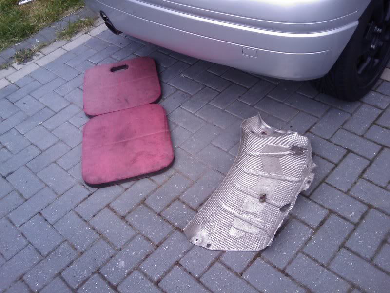

Last night on the way back from Cheltenham I noticed a rattle from the back, Found the heat sheild over the back box broken so took it right off and bin'd it.

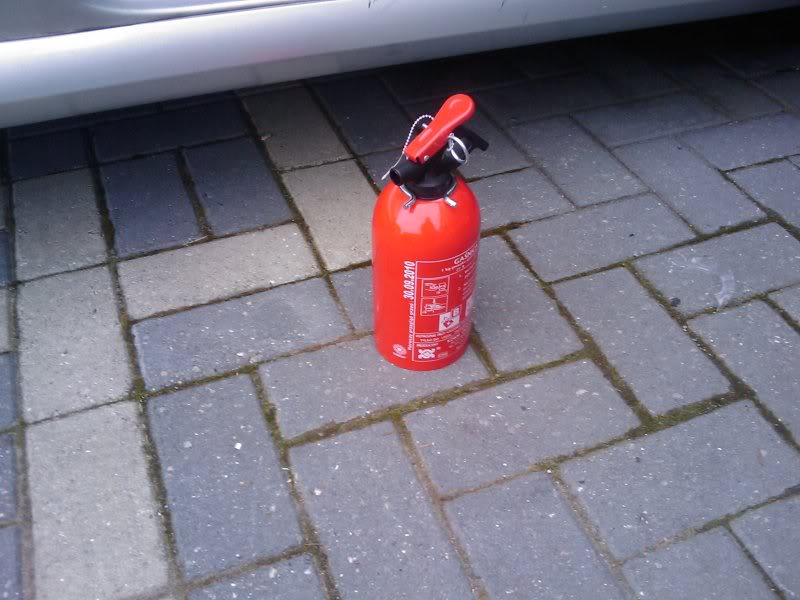

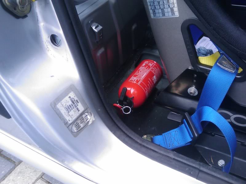

Fitted a small extinguisher behind the drivers seat..... You never know.

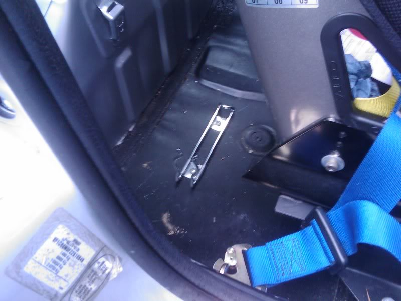

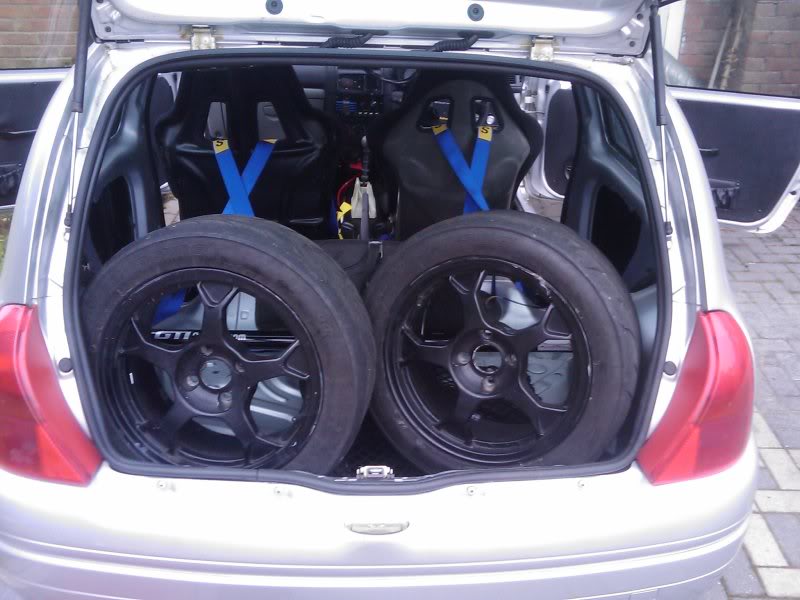

Then i decided to try and find how i would get my track wheels and tools in the back. Struggled to find a postion for all the wheels that ment I could close the boot and that wasnt resting on the seat belts. Eventually got there.
Would be much easier woithout that stupid bar welded into the back. Im not sure if its actually needed, might borrow a disc cutter and get rid.
Thoughts?

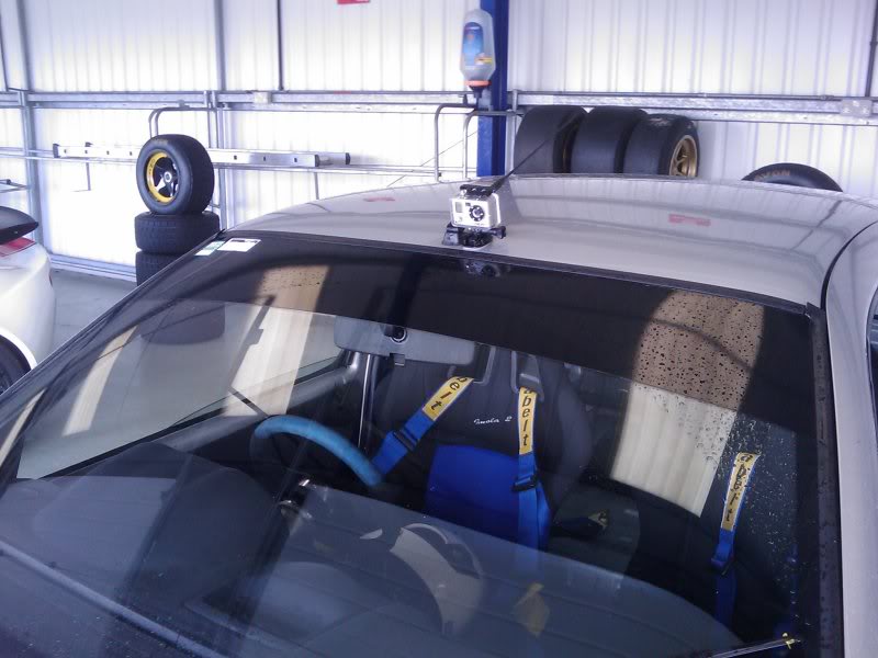

Fitted a new mount for my camera. Quite happy with the footage but the sound was crap (operator fail)

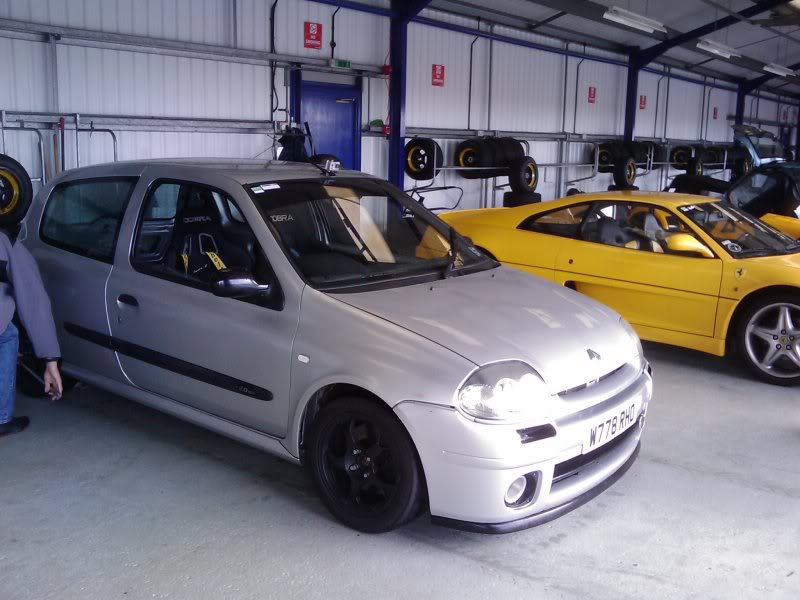

We didnt manage to get a full afternoon dry running so we didnt finish playing with the damper settings. the car wasnt quite right and then the rain came. Never mind. Nothing overtook us all day witch was surprising considering the amount of exotic and potent machinery in attendance.
Here it is posing with a yellow 355

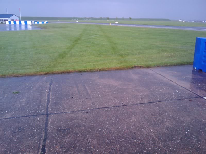

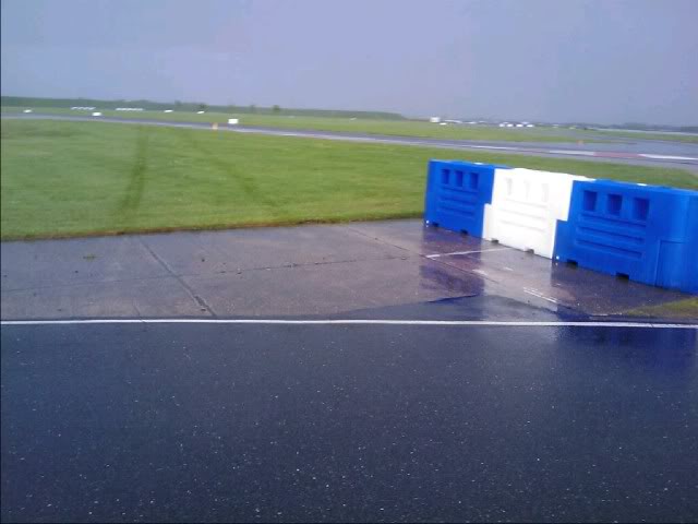

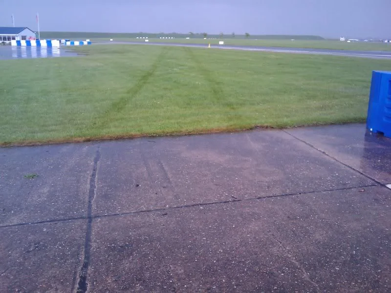

As said I had a few high speed excursions. the worst being when it swapped ends on me approaching a hairpin @100mph ish. I actually ended up on the pitlane access road from the carpark.
The lines on the grass are from being sideways! The head instructor was just coming up the access road as I came to a stop. He was amazed id got that far and that id not hit anything.

Looks like you had fun! Love the grass pic! I ended up on 12 clicks rear and 7 front at Brands the other day - but then we all know my spring rates are a little soft at the rear - no understeer though, so I'm happy.
  172 Race Car
DanR said exactly the same. Max (12) on rear and between 6 and 8 on the front. If its dry on Saturday at Mallory park I'll try that first. The biggest problem was the brake bias tho.
