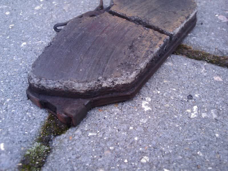

Before Mallory I changed the front pads, as a quick fix soloution to try and get the brake balance a little better. The Greenstuffs that came out had not coped well at Bedford, the brake pedal going a little soft and the brakes stinking half way around the first lap of the day.
The car now has Redstuff pads. A tiny upgrade but will do for the short term.
The old pads.............

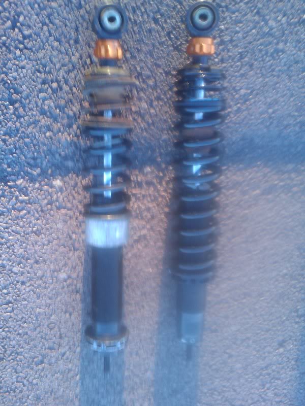

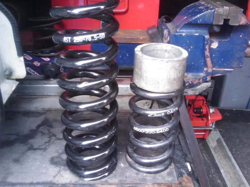

Spoke to Curtis@AST and ordered some 450lb springs. The AST rears use a 2'' spring and the normal length for these is 5'' these are too short for the Clio aplication so Curtis uses an alumnium spacer to pack them out to fit.
He wanted rid of this and being an even busier man now than he use to be I had to wait a while but in the end he supplied me some longer 250mm (10'') AST springs at 78.5 newtons (Exactly 450lbs)

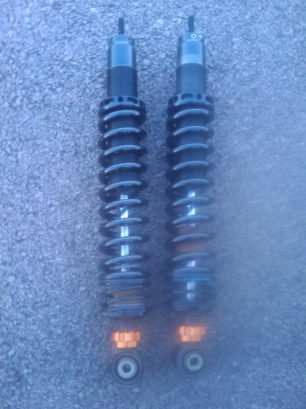

So I took the rear struts off and fitted the over a few days at work in my breaks.

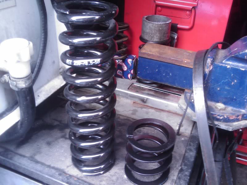

Here you can see that even with the spacer the new spring is longer than the old one by quite abit.

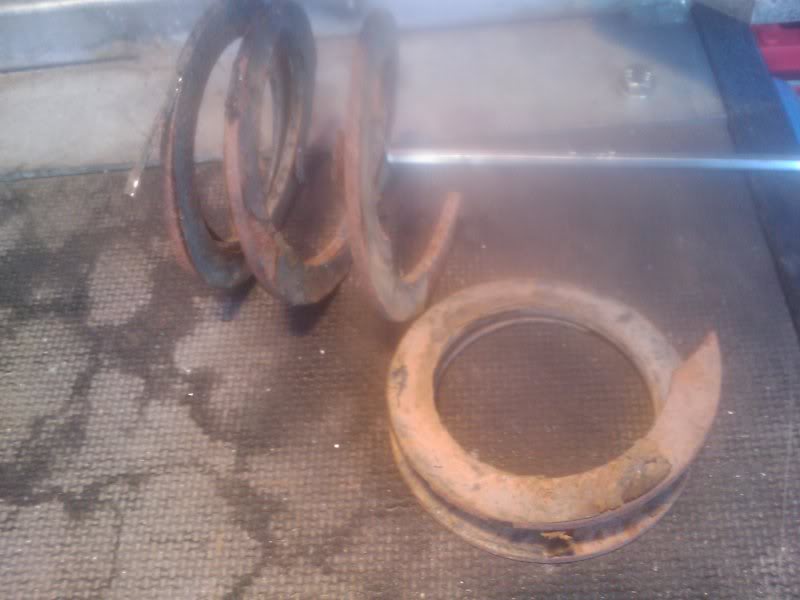

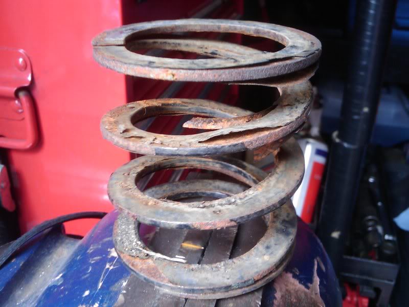

I also had some new helper springs to fit at the same time as the old ones had the usual problem of being manufatured from Edam.
old V new

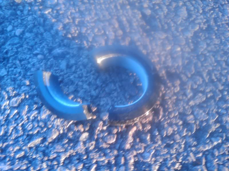

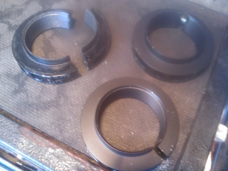

Came up against a problem when buildng them back up. One of the spring adjustment collors broke as it was made from Gouda (Notice the Dutch theme?)
The other had a hairline fracture too
Another trip to see Curtis the legend and some more new bits
Done!

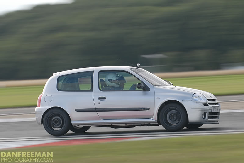

Booked in for Bedford on 31st July, kind of wished I hadnt coz really didnt have the time to do the jobs on the car I had intended beforehand.
Just managed to get most of it done but the non essential (infamous) 'to do list' is growing ever larger.

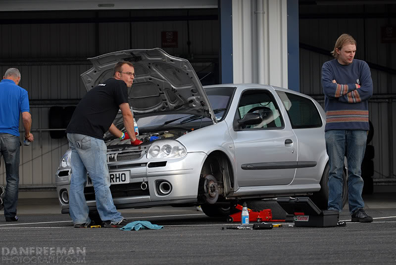

We arrived quite early at Bedford so had plenty of time to swap the wheels over and do a few minor jobs. Adjusted the gear linkage and that improved the selection. Used to have problems changing down on occasion.
I set the dampers on max -3 on the front and max -2 on the rear and off we went. Instantly the car felt alive, it wanted to turn into corners and had a very controlable rear end, go in too hot and a big lift brings the back round and tucks the front in. Awsome!
I handed over to Tony for a short run as he had a ride in the R26R booked.
we then had a strange knocking noise develop so it was back to the pits for a quick check over, nothing conclusive was found (Still havent found it, going on a ramp friday for a good look over and spanner check)
Dan jumped in with me for a ride and was instantly impressed with the new suspension setup. The brakes were working well too, I was being able to start getting brave and try to shorten the brakng distances and brake later (out braked myself once and the R26R behind followed me off the track, Lol)
Then disaster. Quite close behind a 197 and doing 80mph+ the rear stepped out and we went for a little spin. As we were traveling backwards said to Dan 'what was that?' It was such a sudden snap something had to be wrong, I was on the power and couldnt catch the spin at all.
A slow lap to the pits and the rear end was all over the place in the right hand bends.
Cut a long story short but it turned out to be gearbox oil pouring out and ended all over the rear tyre and turn 4/5.
Matt Wills: 'Some wanker has spilled oil all over the track'
Me: 'Yea that was me'
He had a big spin on it, Lol.
So they red flagged it and cleaned up my mess. Loads of people lent a hand to try and see where the oil had come from, i was expecting to have to buy a new box but it had driven ok back to the pits. In the end some guy found a bolt had come loose from the 5th gear housing (top man)
We tightend the bolt, Tony went off to buy some oil and we were back in the game :D
Didnt want to risk ruining everyones fun again so we waited till the end of the day to have another go. A couple of laps to clean up the tyres and I could start to push again, not too hard.
All was well and the car made it home ok, it had only lost about 1.5ltr of oil so no harm will of been done to the box.
Shame the amount of track time ended up being so short, Tony only had 10mins but live and learn.
