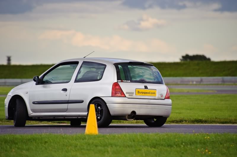

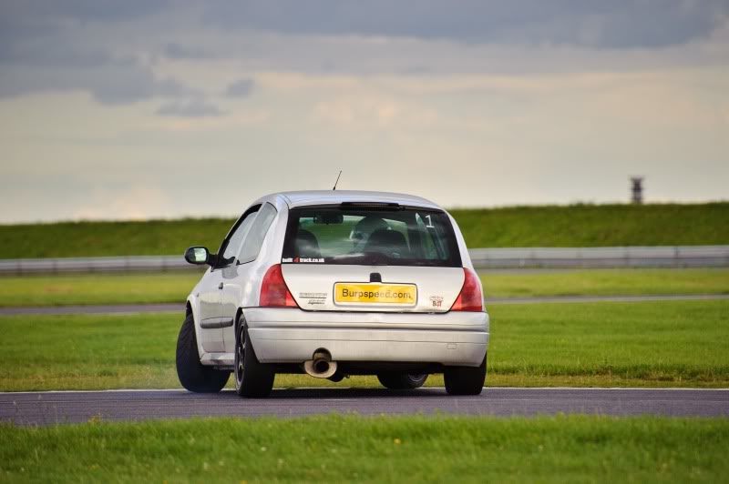

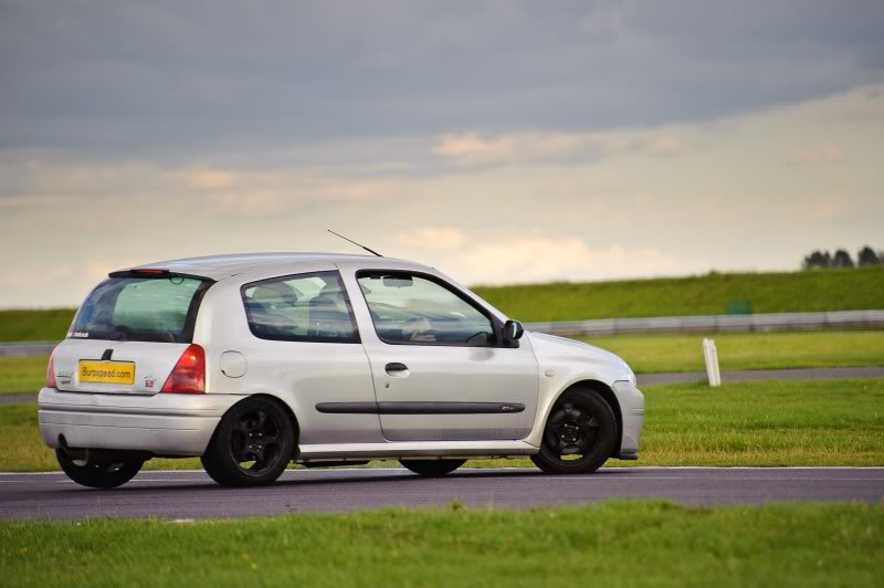

Some pics from Friday................
Tony on a mission..........
Me on my own, late in the evening, is the front wheel off the ground?
Tony about to eat an R26R, Powey's mate on board I think
and yet more pics of the car spinning with me in the passenger seat (need to get duel controls fitted :rolleyes:)

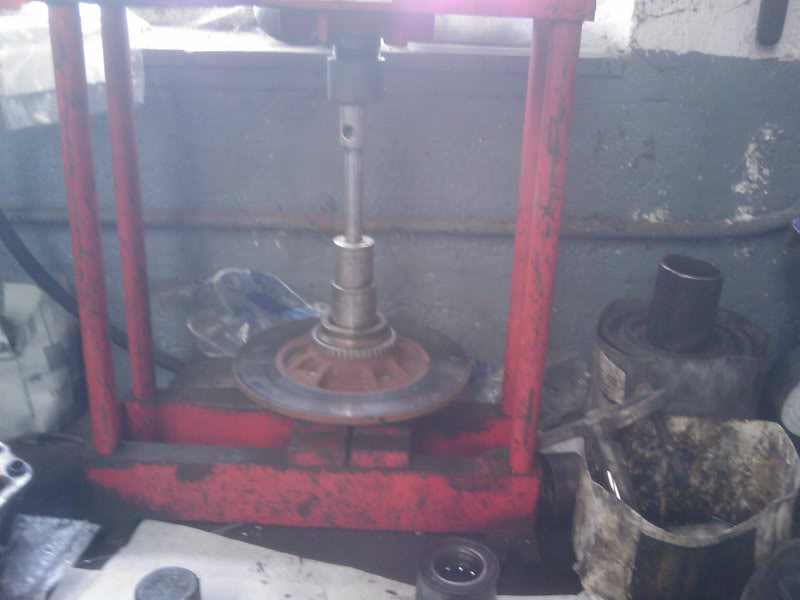

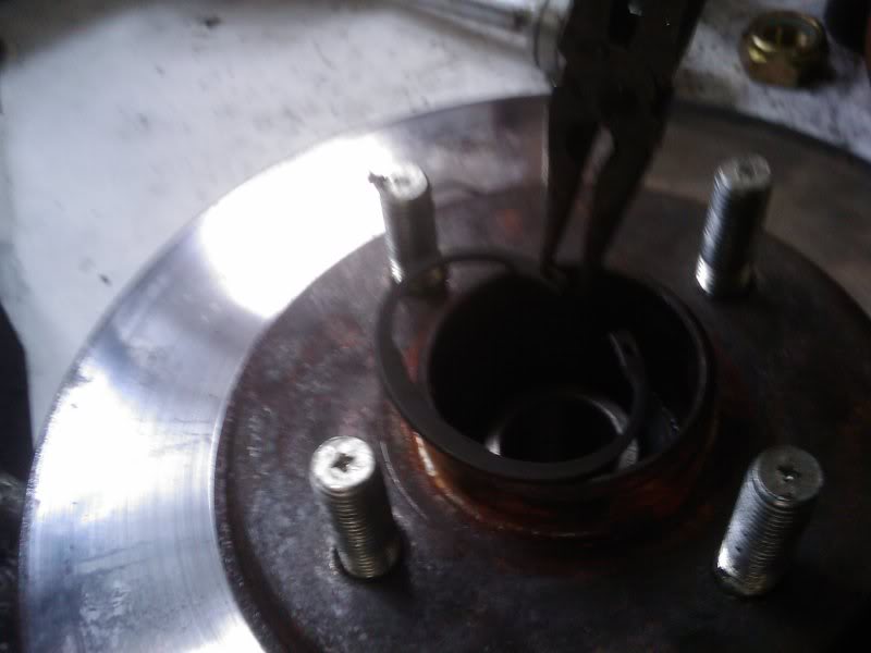

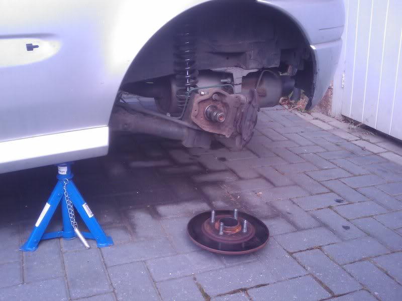

A few days ago whilst on the motorway I could hear a rear wheel bearing rumbling. It must of been well past it as I could hear it over the road noise and the delightful tones of Breaking Benjamin. :cool:
They are about 5k old but have had a hard life on track. Rather than leave them till the wheel falls off I decided to get it done and rather than just replace the one I chucked a pair at it. Took the discs off and popped intoa mates garage to borrow his press.
Ive repaced a few of these before and these were the most stubborn ive come accross. 9,000psi on the press before they started to move. New circlips and they were all done. Got to put them back on before Saturday (Karting meet)

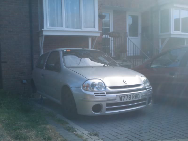

Overall the car is looking a little sorry for itself at the moment. Quite afew bits missing, for various reasons. Its still driveable, for now ;)
