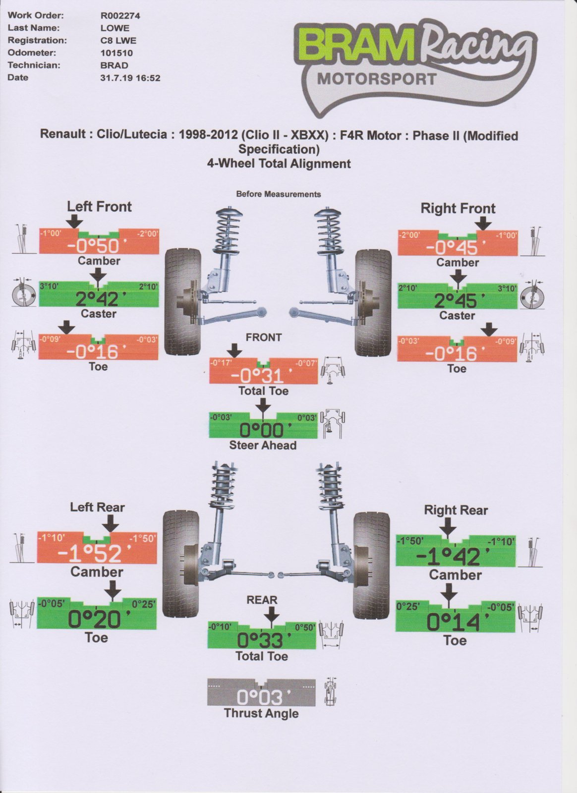

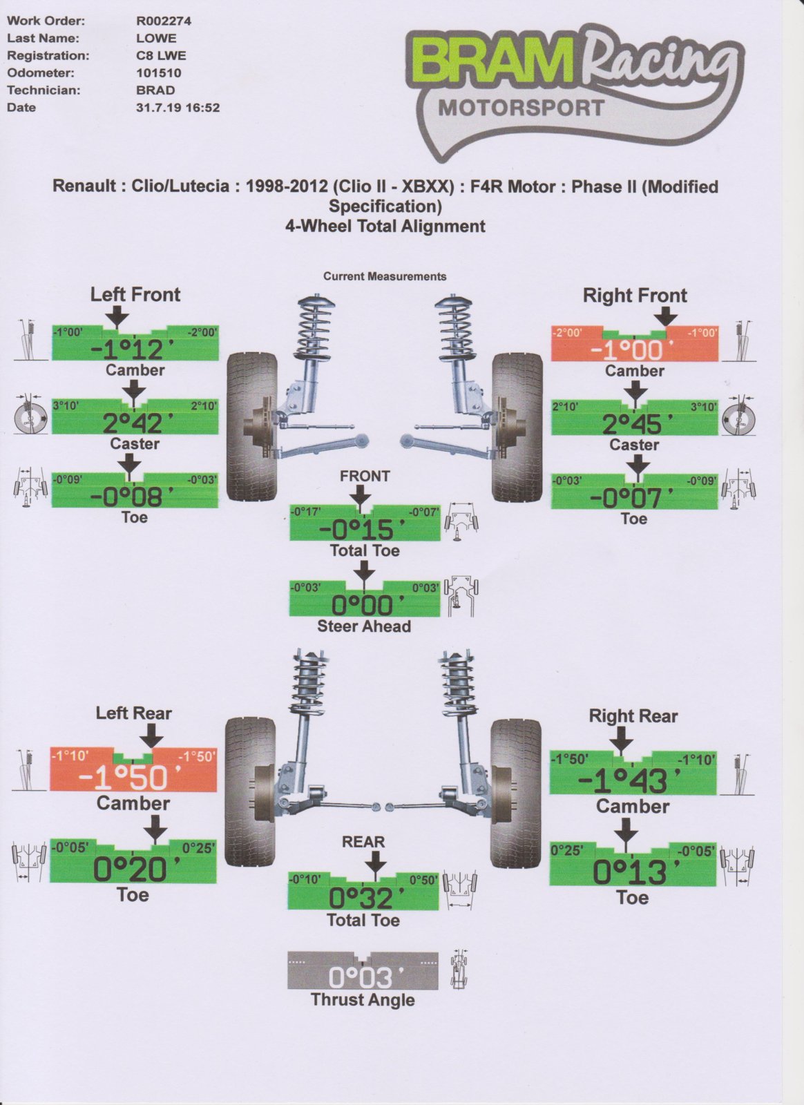

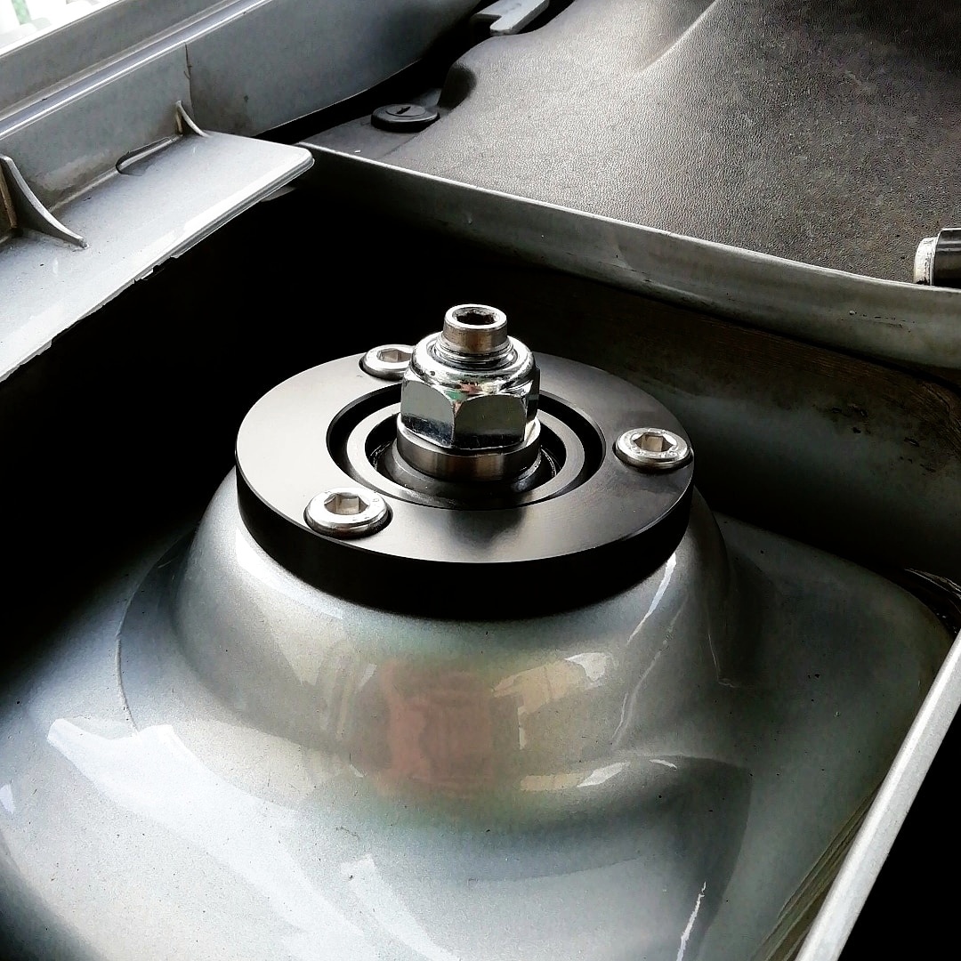

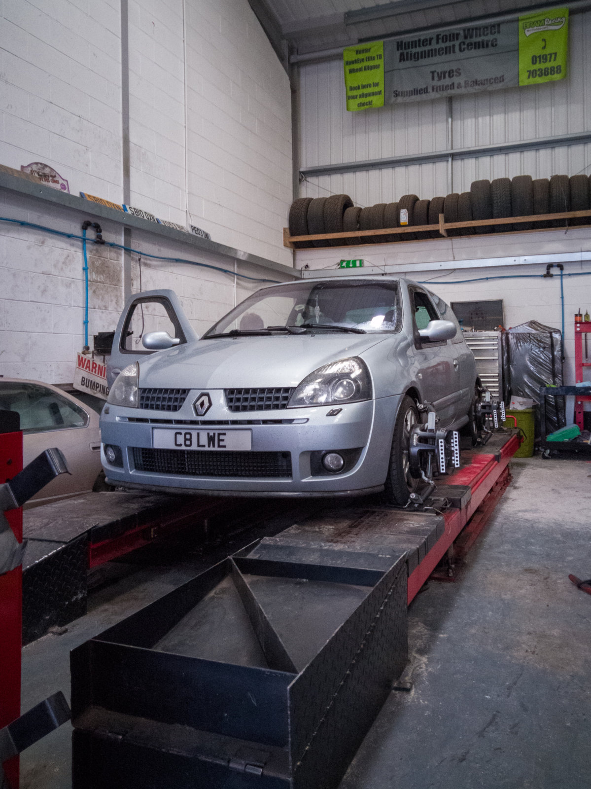

On Wednesday I fitted Powerflex Camber Bolts, Mike Arter Solid Top Mounts, new track rod ends & went to BRAM Racing in Featherstone to get my tracking and camber adjusted correctly:

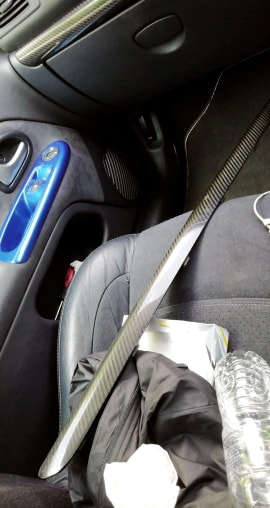

I then went away for the weekend and on my way back collected a Carbon Fibre Rear Bumper trim!!

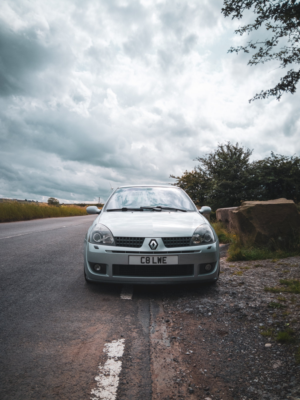

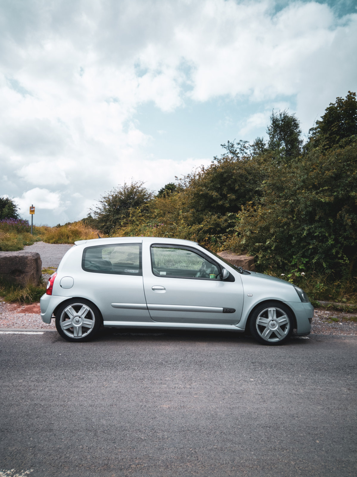

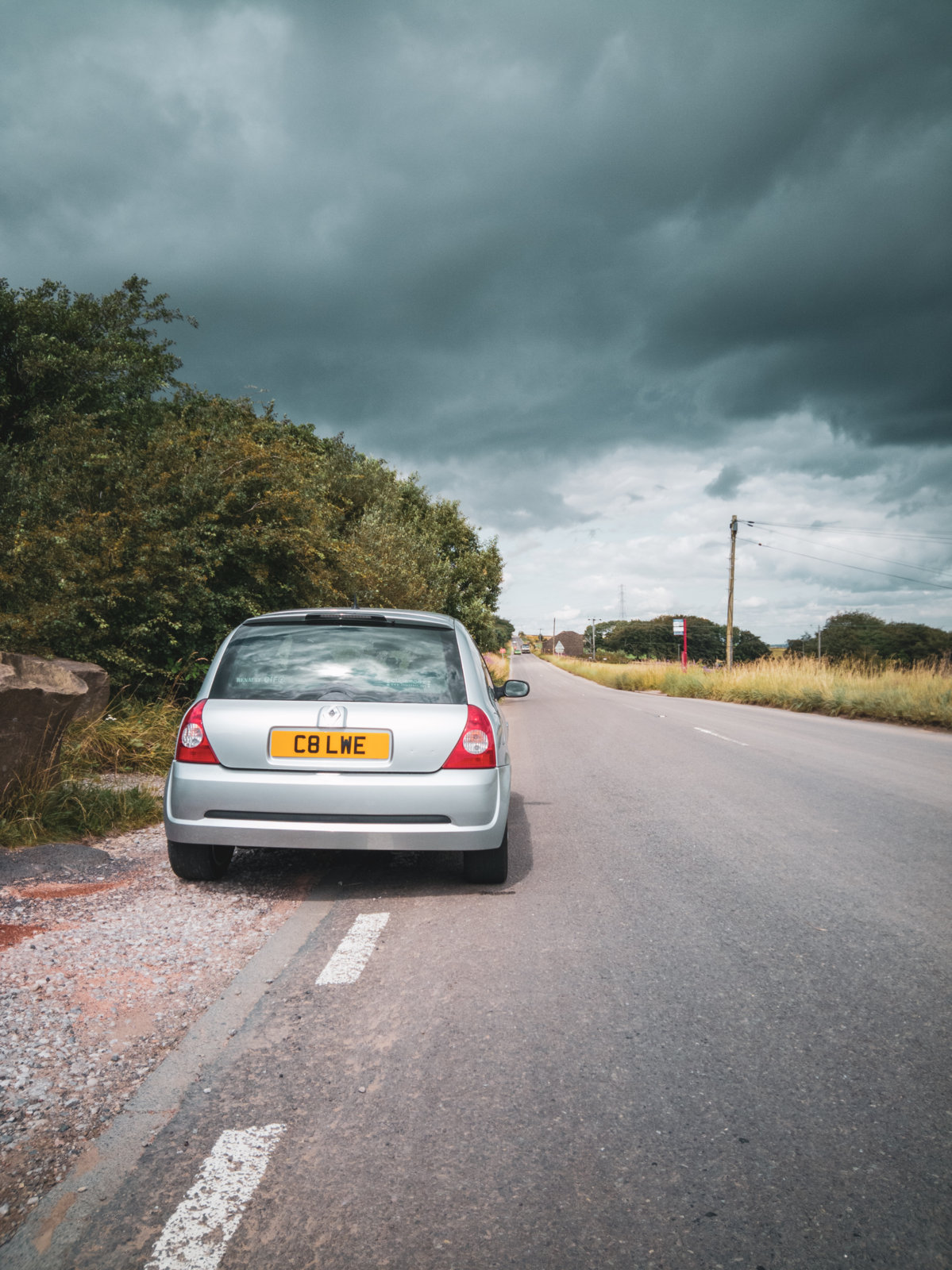

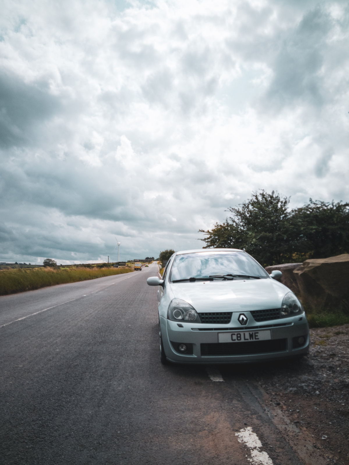

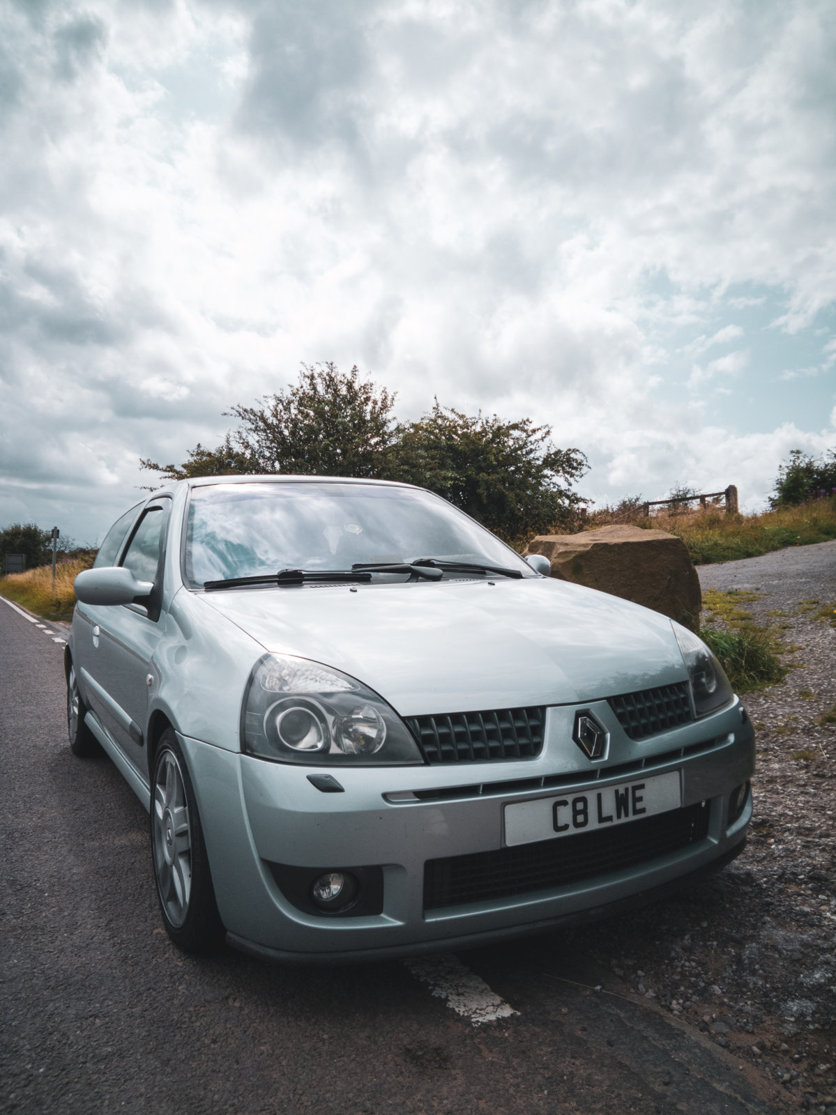

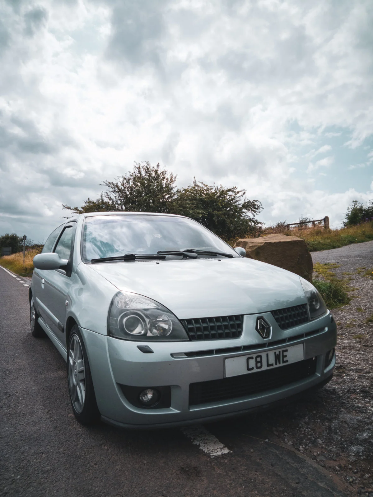

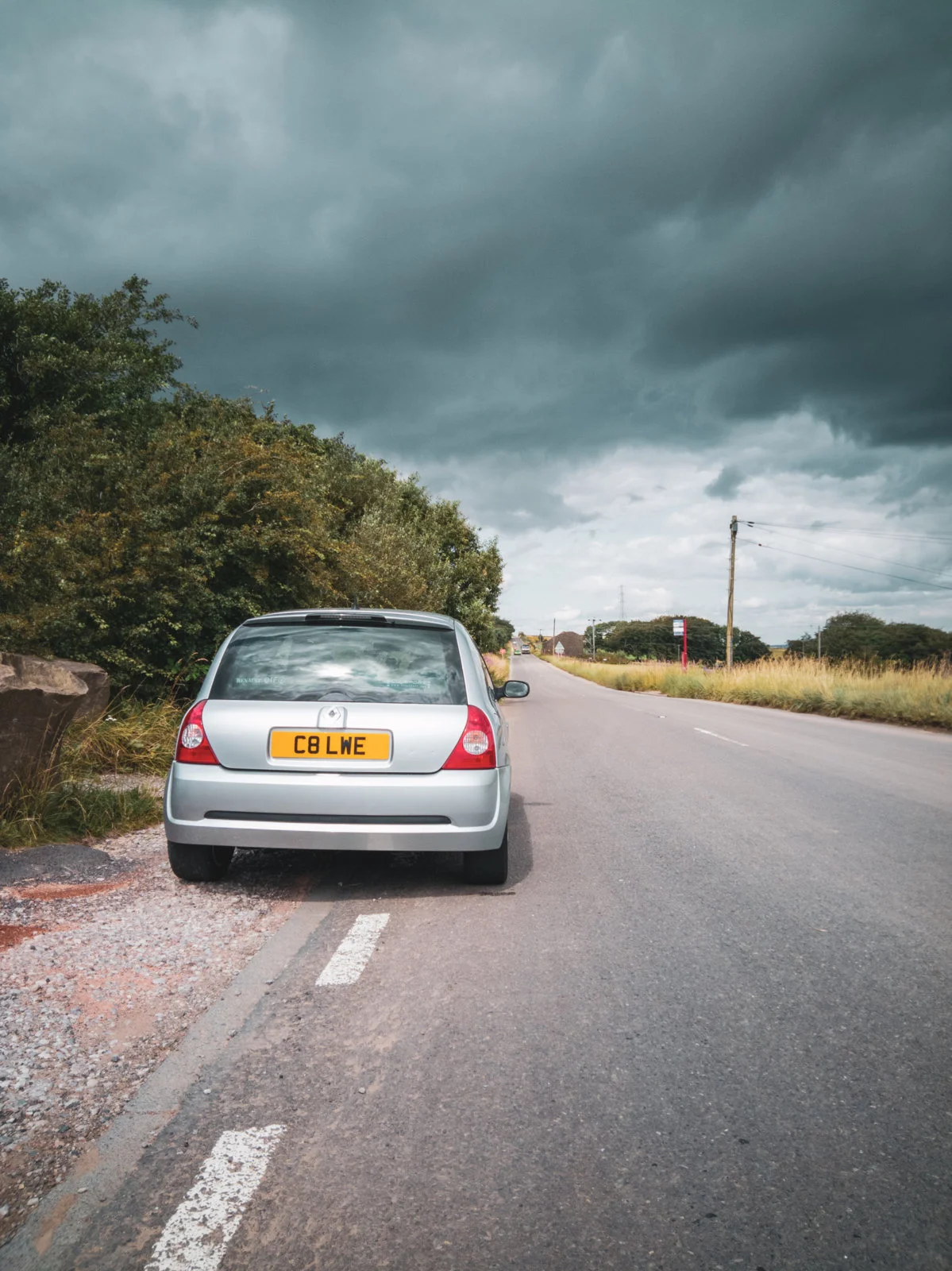

Then I also stopped off for a few photos at Scammonden Bridge:
What alignment did you go for?
Meh they managed to get -1.00 and -1.12 degree on the front as they just fitted me in a gap between booked in customers, the camber bolts need taking out and spinning to get more & I was hoping for a little more.
BEFORE:
1429137
AFTER:
Yeah they said that, what do you recommend?
Brad knows all about camber bolts, he saw mine enough times, so i'm surprised he said he had to remove them to get the required camber? Always made sure the tabs were in the right orientation after rotating the bolt with me.
no need for them to come out, they just turn the tab as you turn the bolt.
2.5 deg camber and about 1mm out drives nice.
2.5 deg for fast road seems like loooads? Doesn't that just tramline pretty bad?
What's 1mm in mins?
2.5 is fine, had a few set to 3deg and drive ok, as long as everything is fine on the car it's nowhere near how you think it would be.
When I last had mine done, I got 2 deg and 10 mins total toe out and it tramlined quite a bit on 205 45 16's.

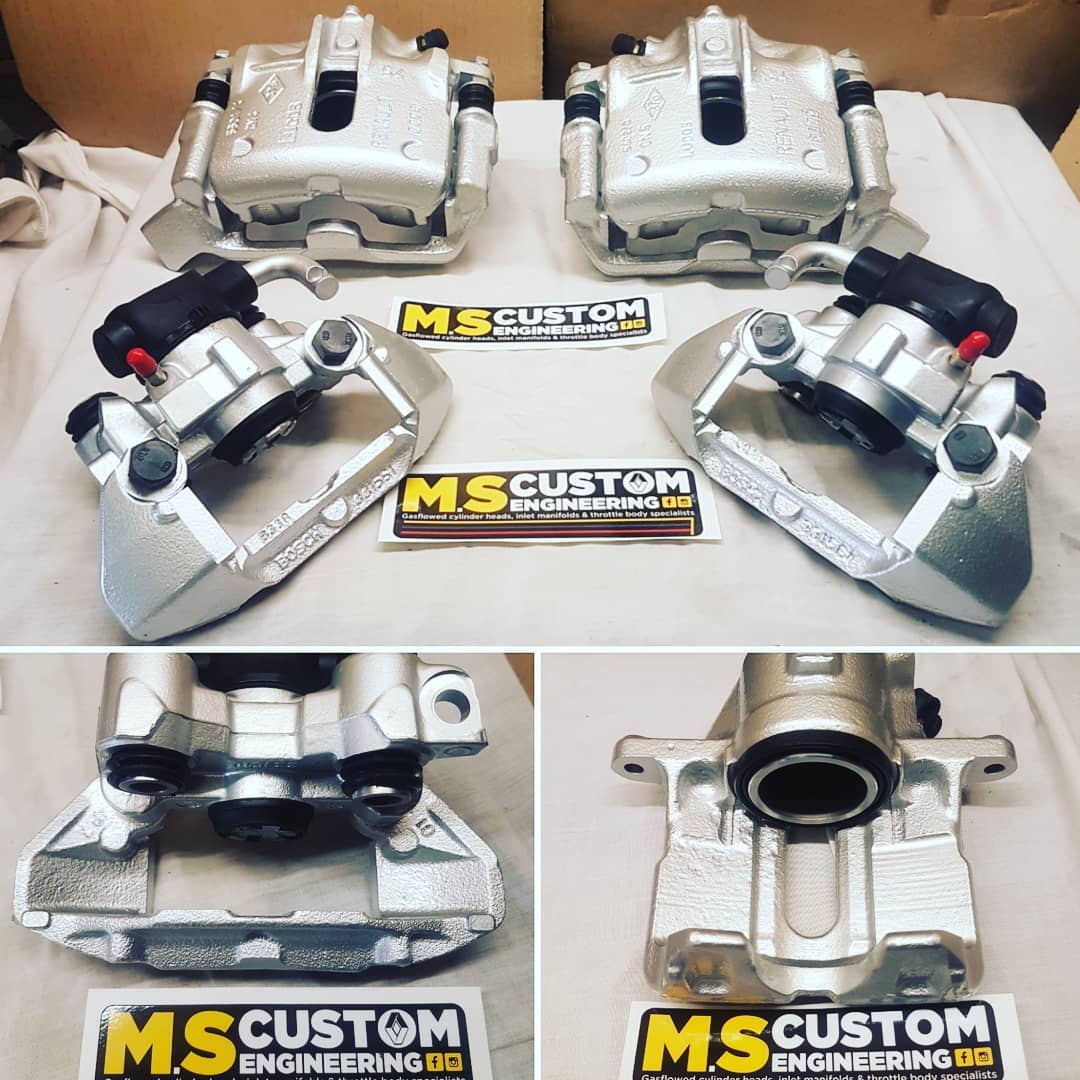

Full set of freshly refurbished calipers by Max at MS Custom Engineering

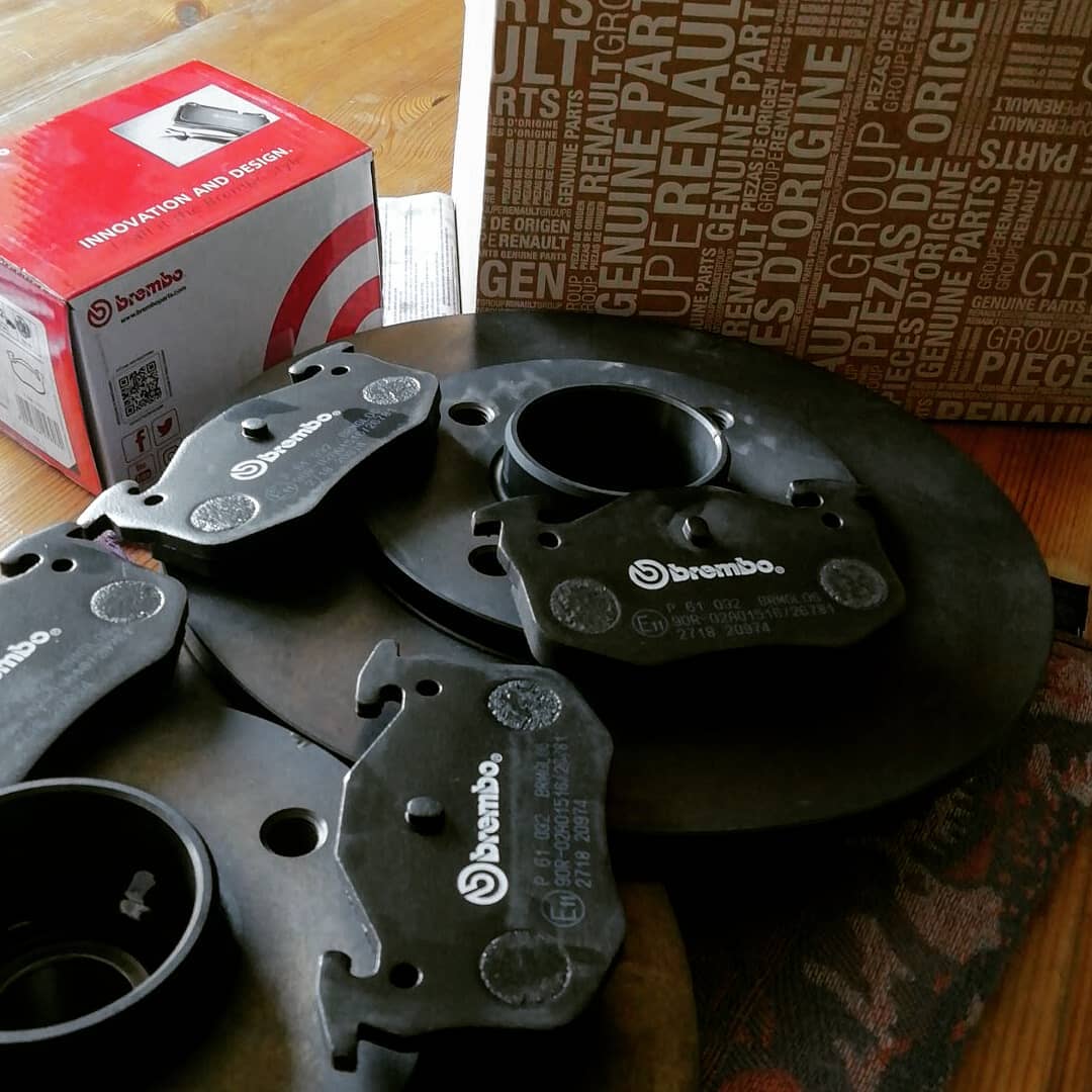

New rear brembo pads and discs just arrived today from @George@RTR_Parts

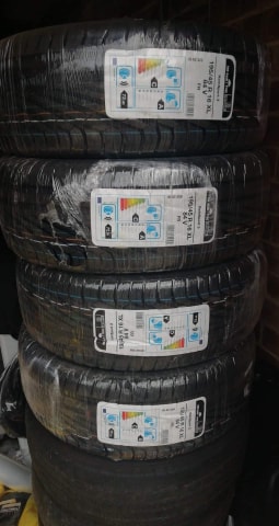

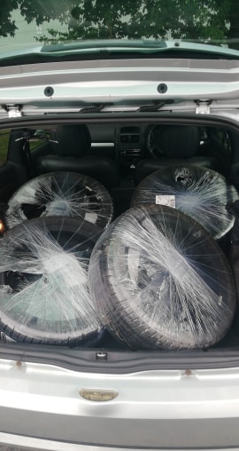

Purchased a set of 4 Rainsport3's for my winter tyres:

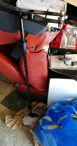

PMS Rear ARB ready to go on

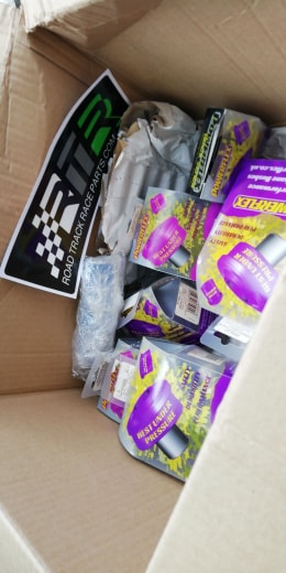

A load of polybushed bushes ready to go on

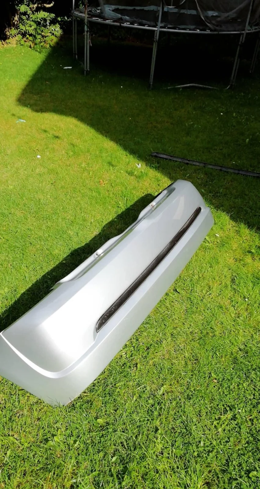

And not sure if I posted the carbon fibre rear bumper trim I purchased last week...
