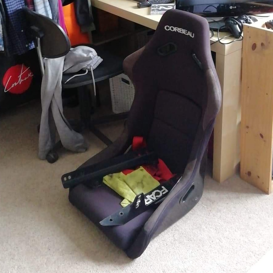

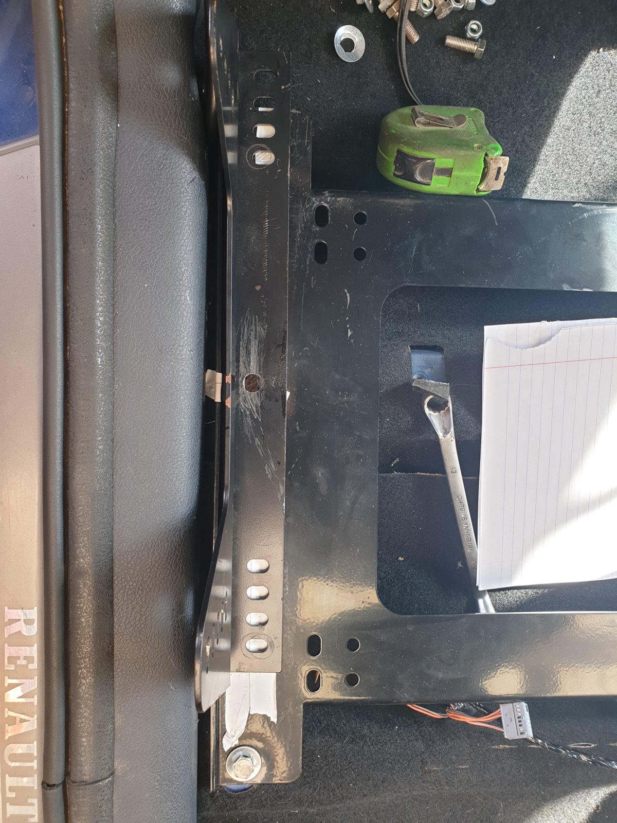

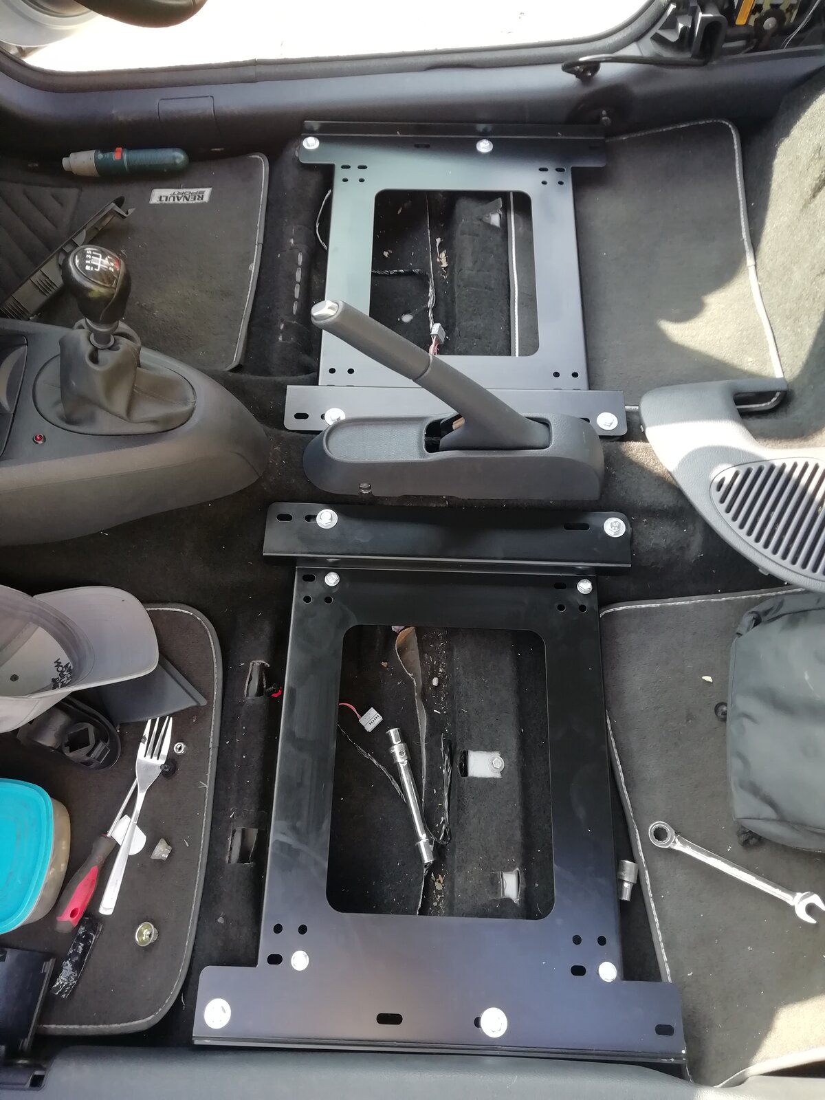

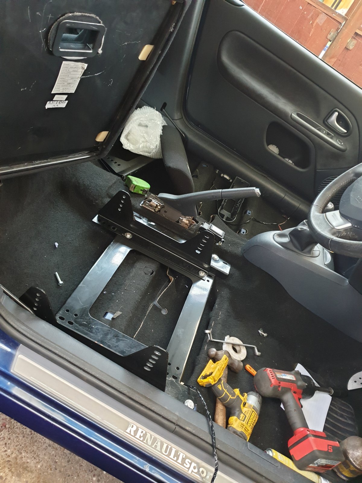

Started mocking up my buckets. I found a few bits wrong/annoying
Firstly, because in a fat c**t I have to get XL seats. Because they're XL they dont line up with any holes on the subframes??
Secondly, the previous owner of the seats failed to mention the part where he snapped off one of the mounting bolts in the seat. So yeah, cheers
And annoyingly it's the one I wanted to use as the drivers seat as it's still in FIA date until 2022 and the other one runs out this year and has a heat gun burn mark on it

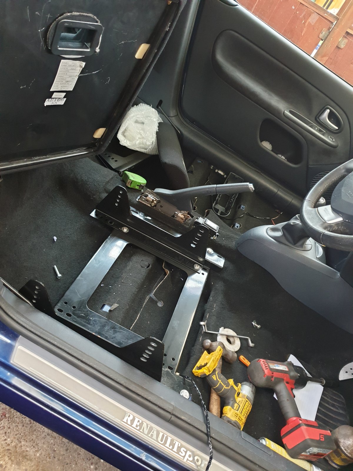

Never the less I needed to get one in there to love the car about for the time being. It's a tight squeeze when I placed the seat sort of where I wanted it
I came back to it the next day because adult duties called?

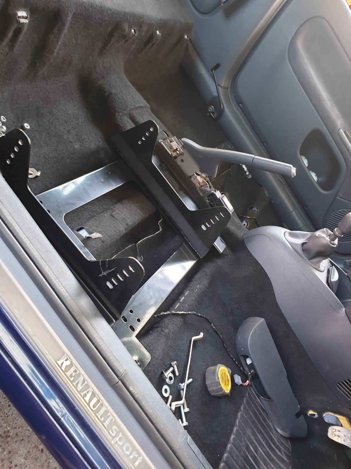

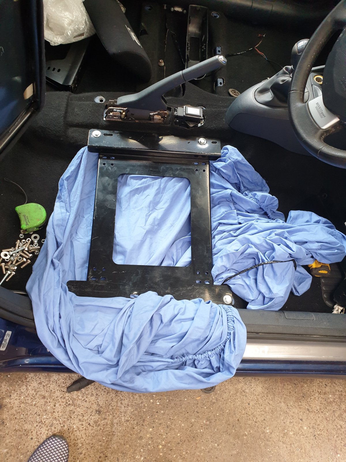

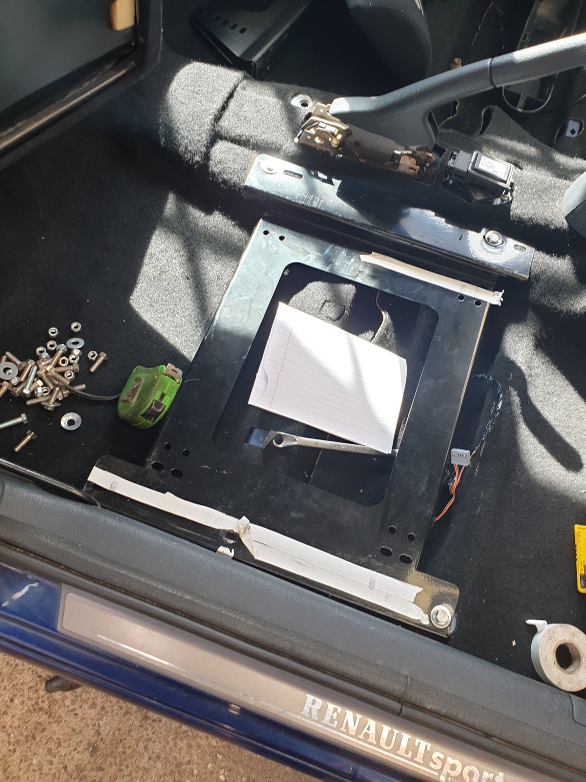

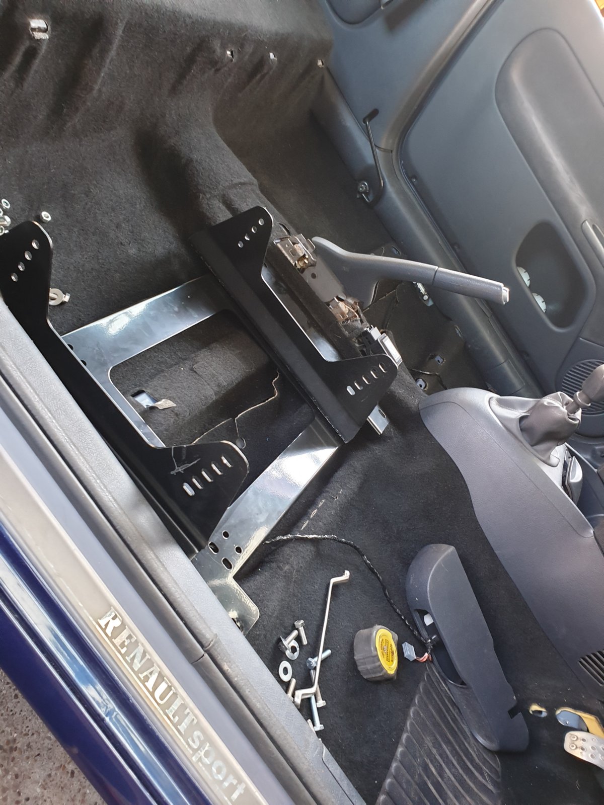

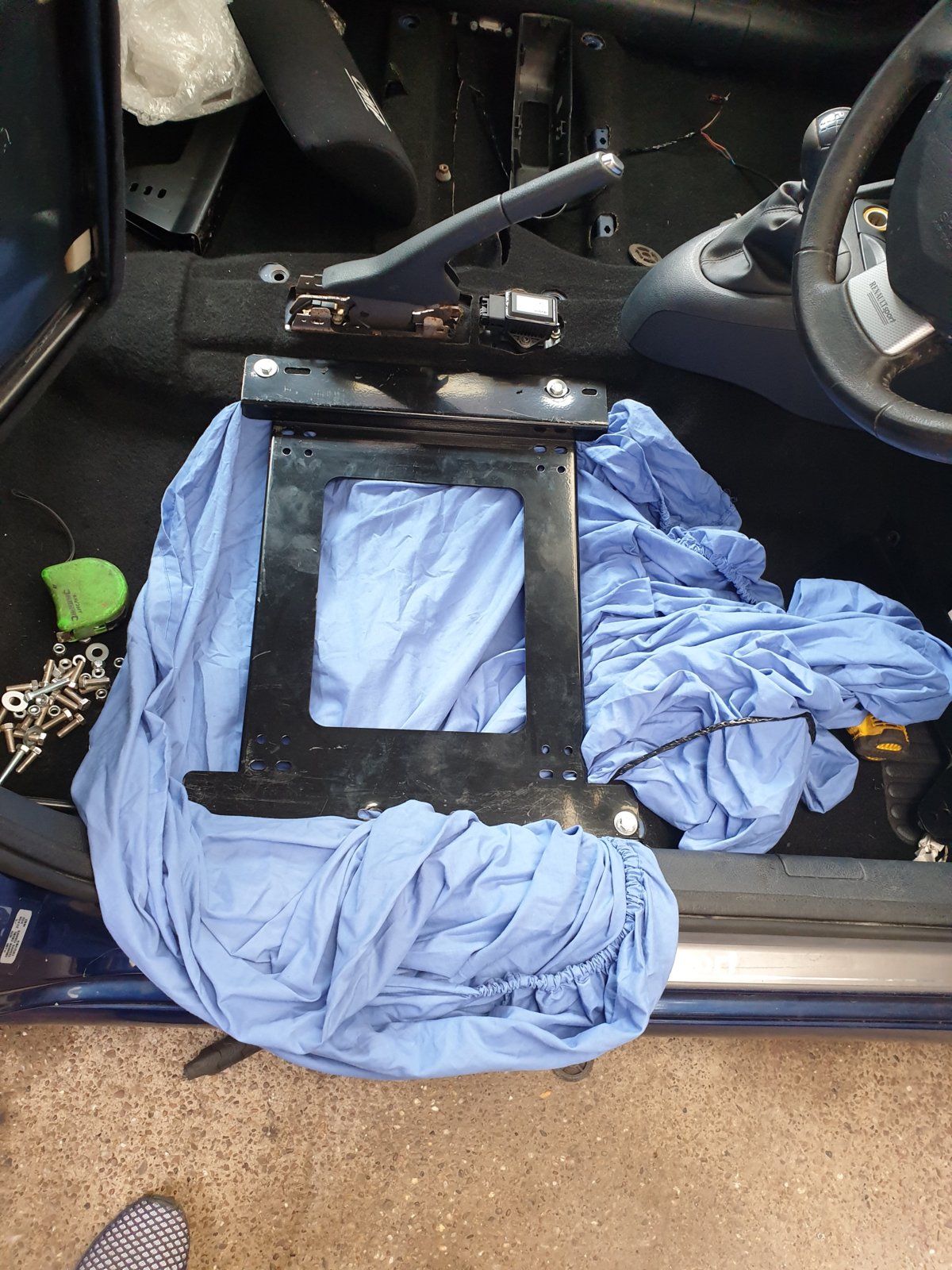

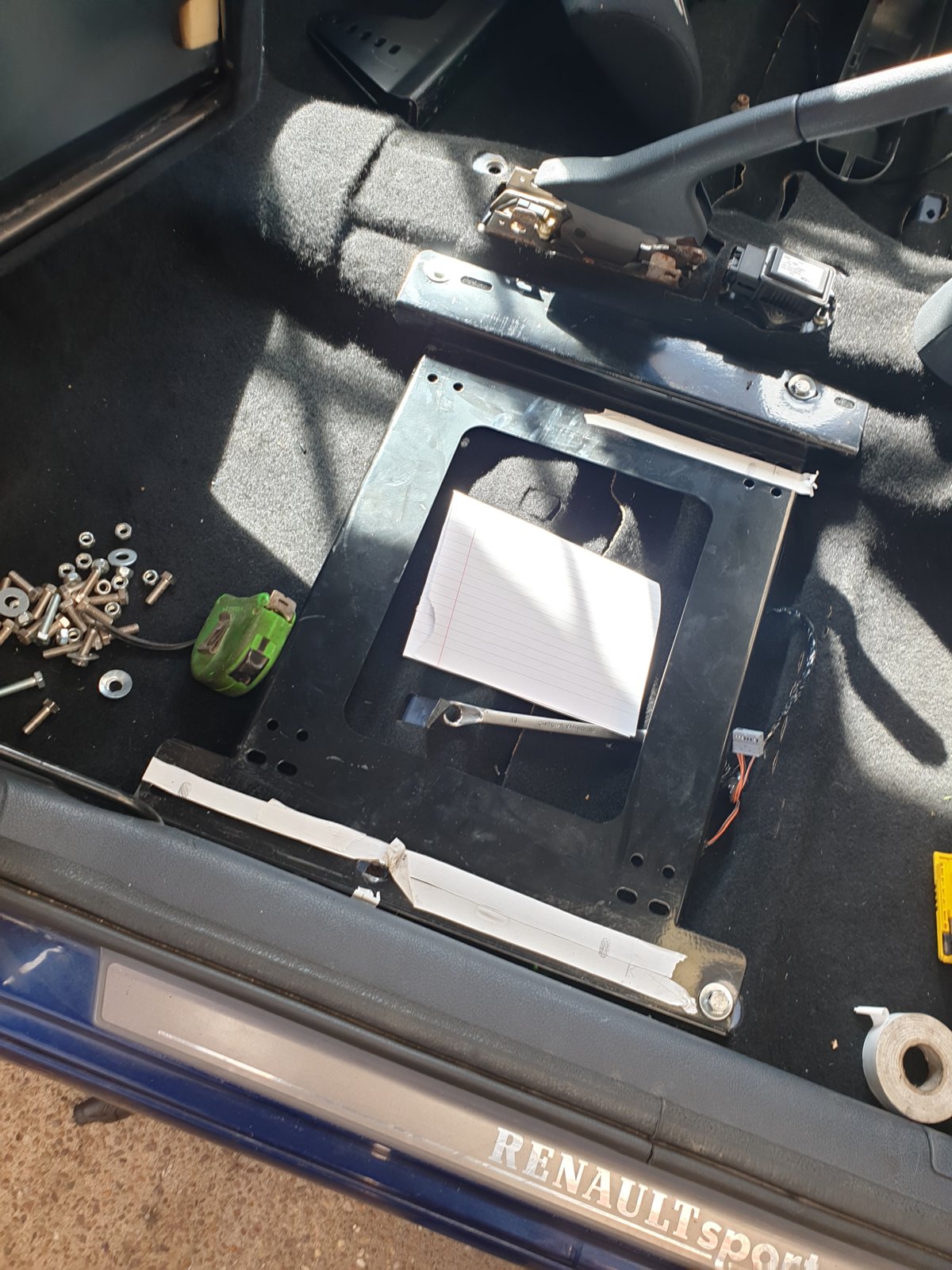

Started out by laying some tape and marking out a few places where I need to mount the side mounts to the subframes
Measured 3 times and then pressed on by drilling holes all over the shop?

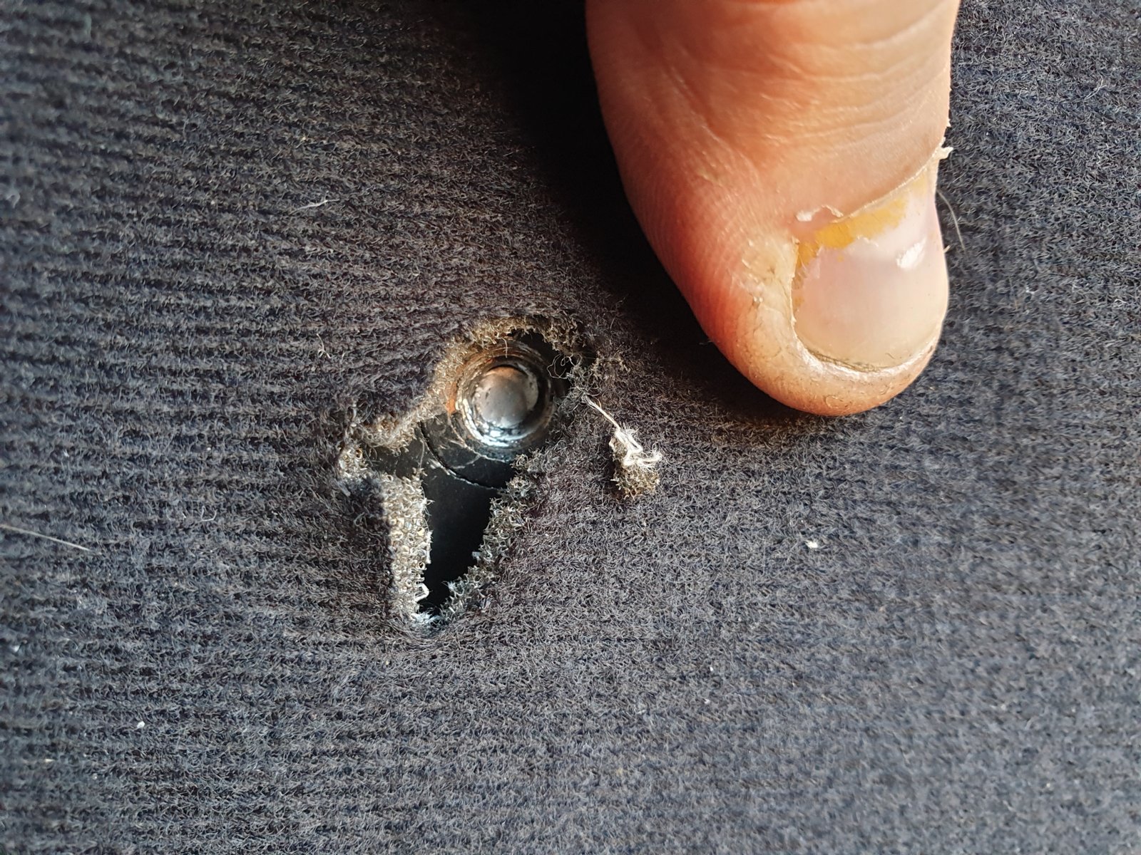

This hole goes through the sidemount, subframe and then uses the existing but underneath as the bolt would make the subframe rock if not.
I'd just hovered it and I couldn't be fucked to remove the subframe again so out came an old sheet?

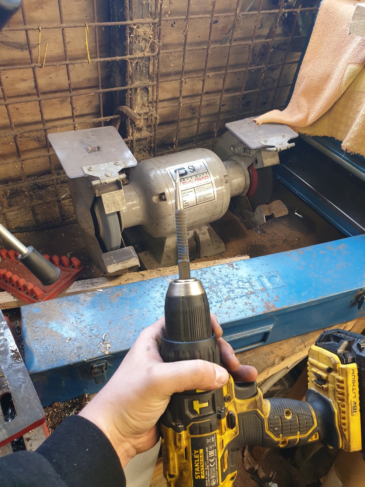

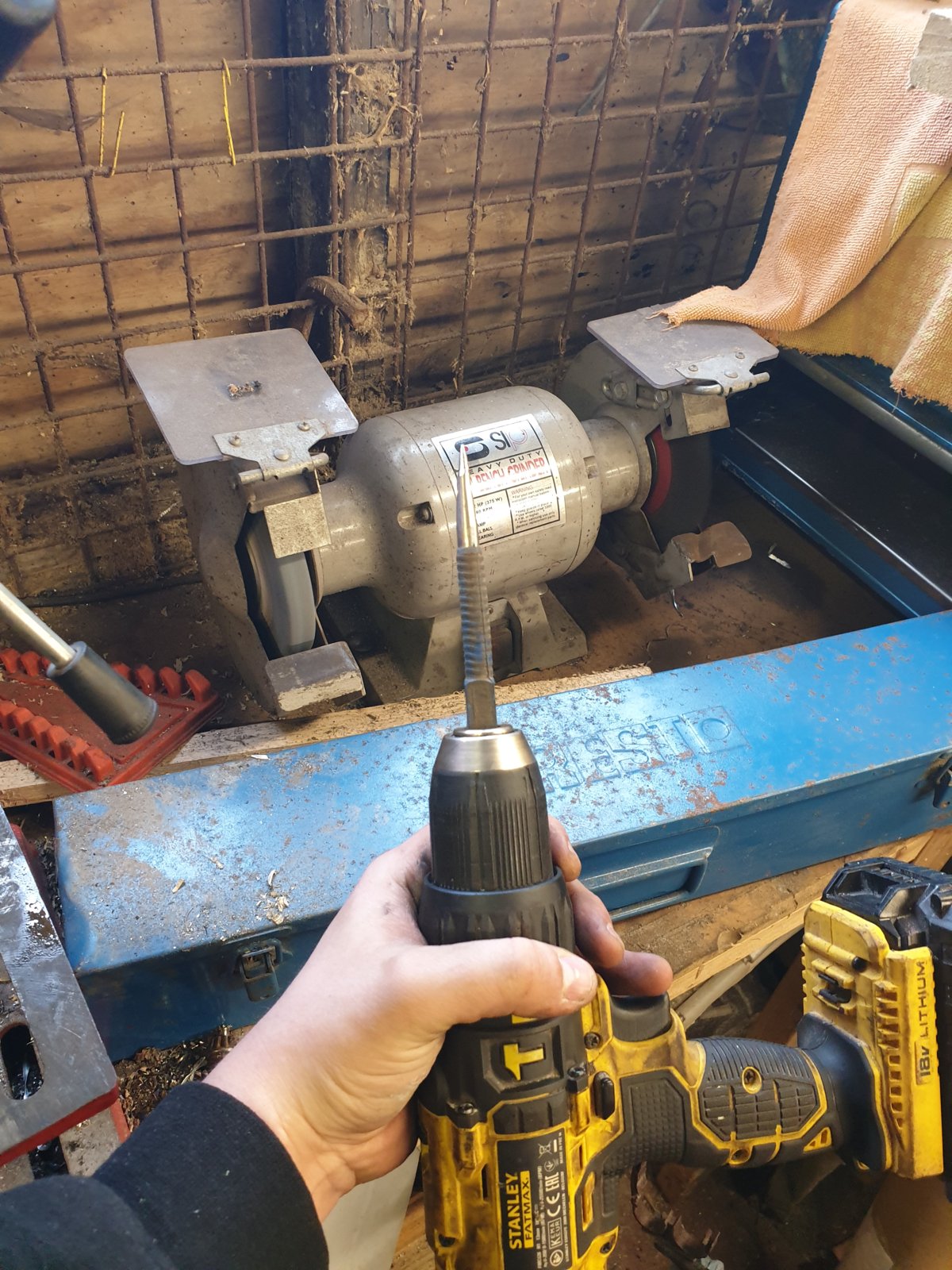

Then my punch started enjoying me so I stuck it in the drill and sharpened it on the grinding wheel. Now I dont have to worry about it sliding all over when I'm trying to stamp a point!

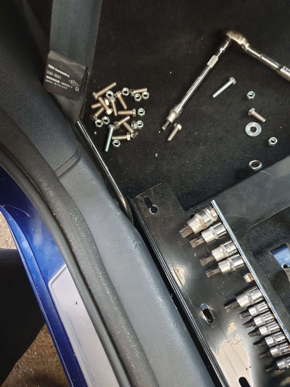

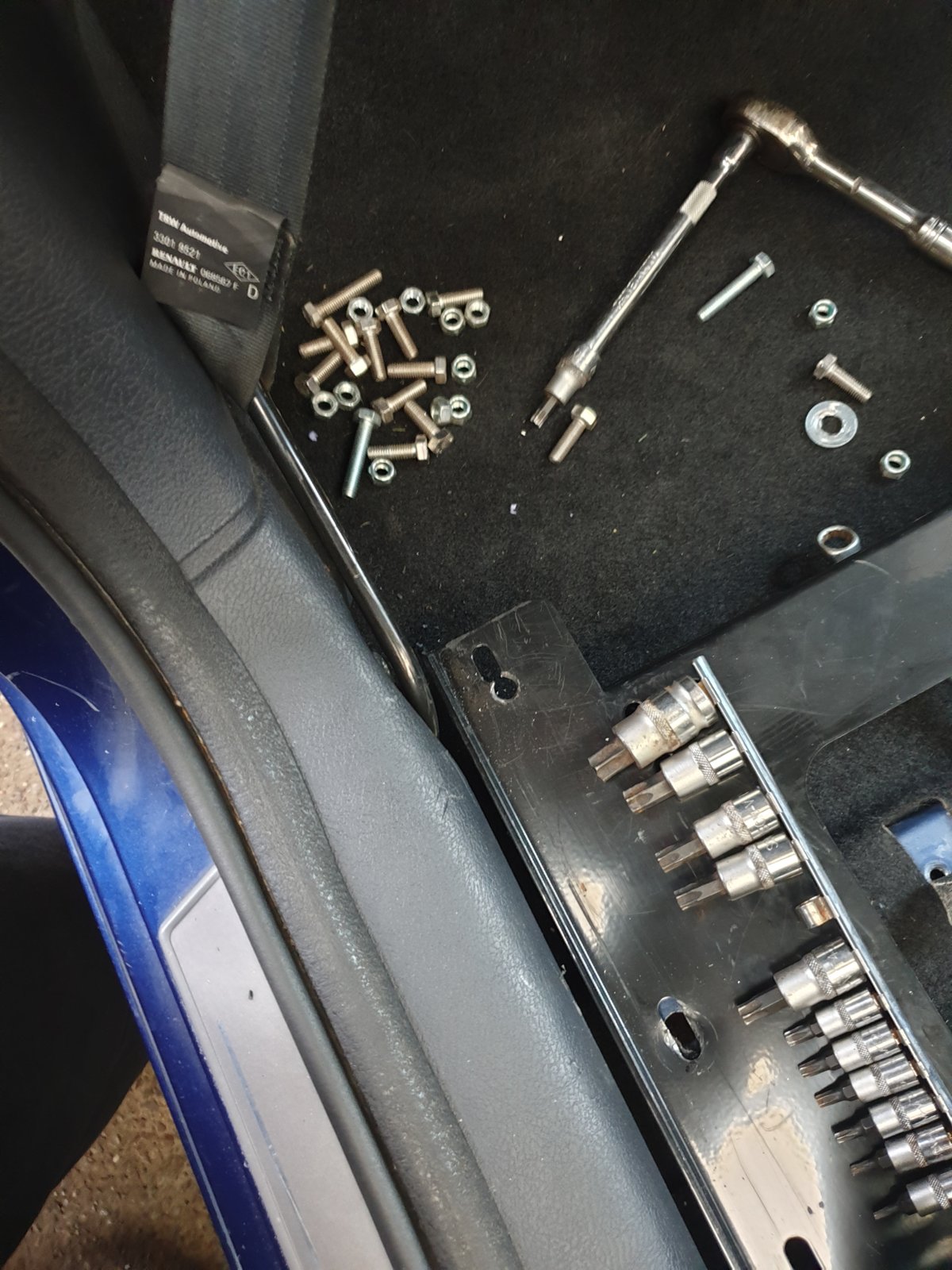

Got all my holes drilled and the sidemounts in place... I messed up at this point too. I spent 10 minutes bolting everything down like this...
Then forgot that I'd not stuck the seatbelt in!?☹ doh

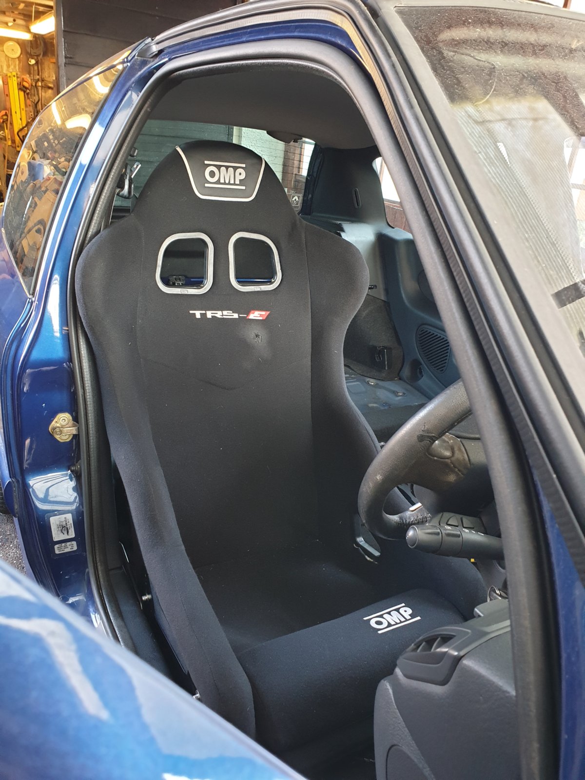

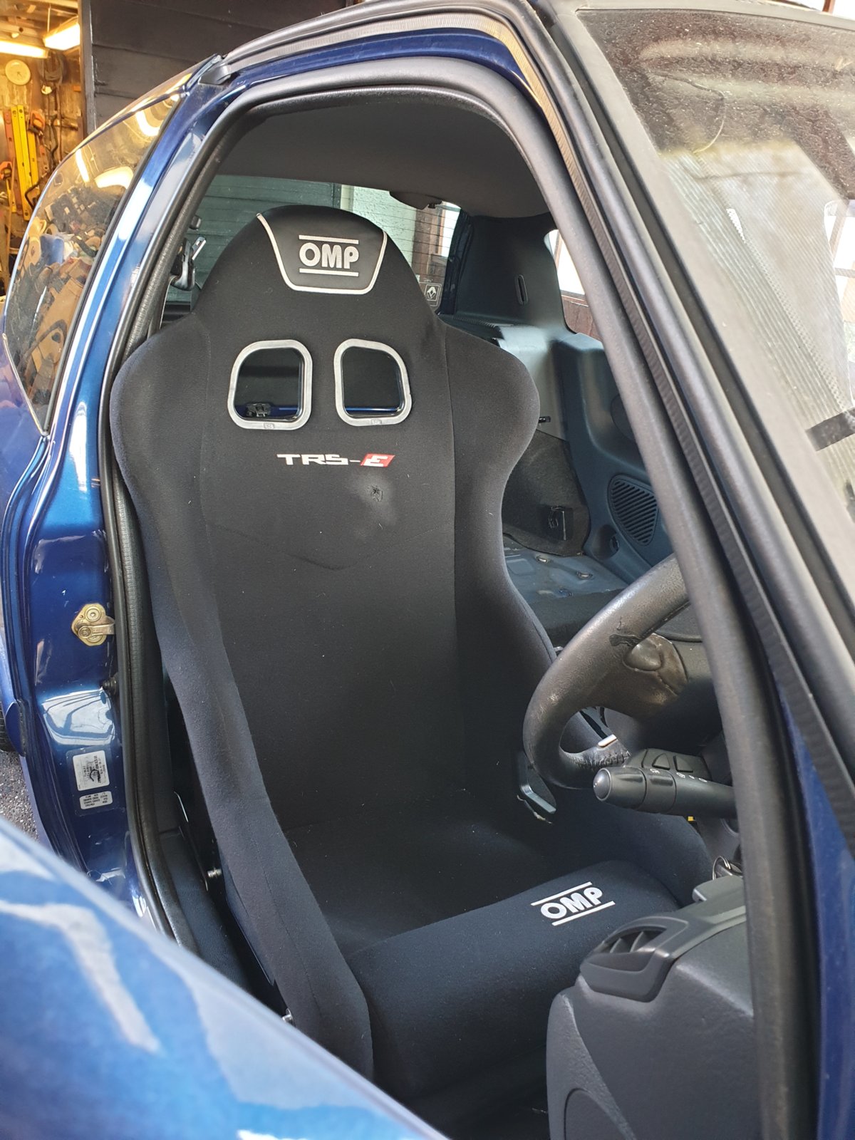

After all that I got the seat in and I'd raised it and brought it a little more forward than I first anticipated but it feels better for it...
This should give you an idea of the arse ache I went through

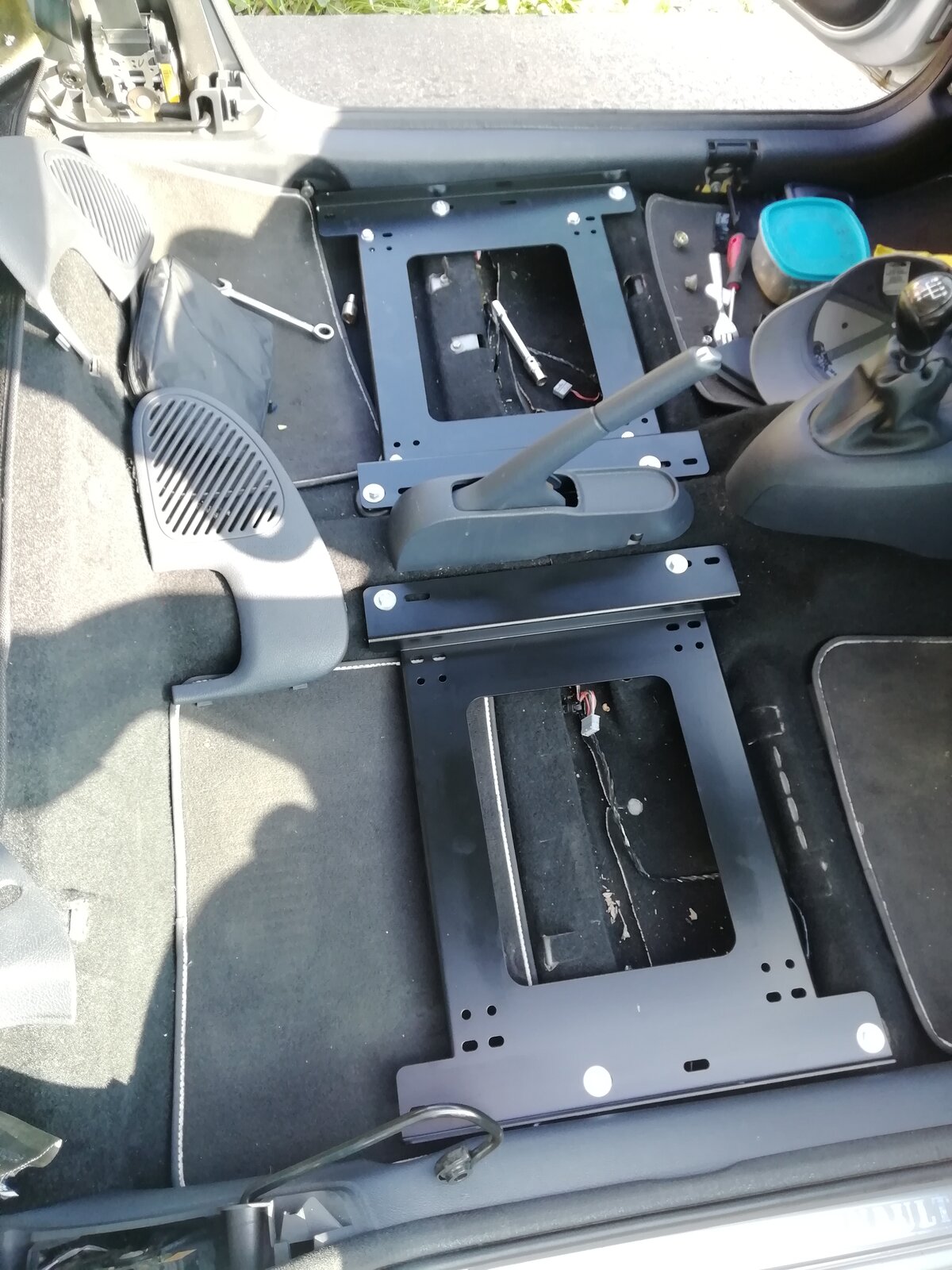

I've got OMP ChampR (slim fit) as my passenger seat and OMP RS-PT (wider fit)for drivers seat both on Jon Foz plates. No problems fitting either of them, all the holes were perfect..

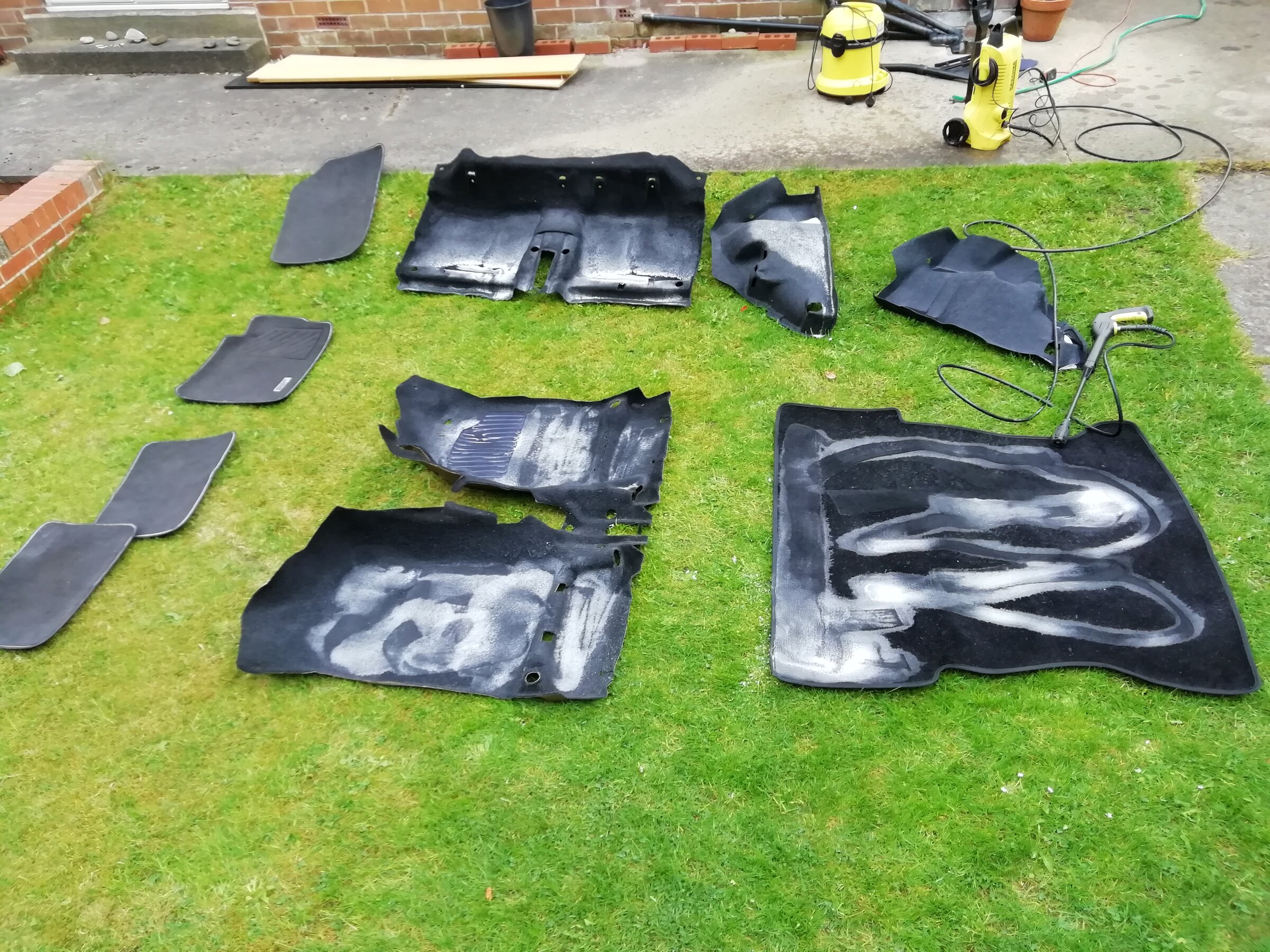

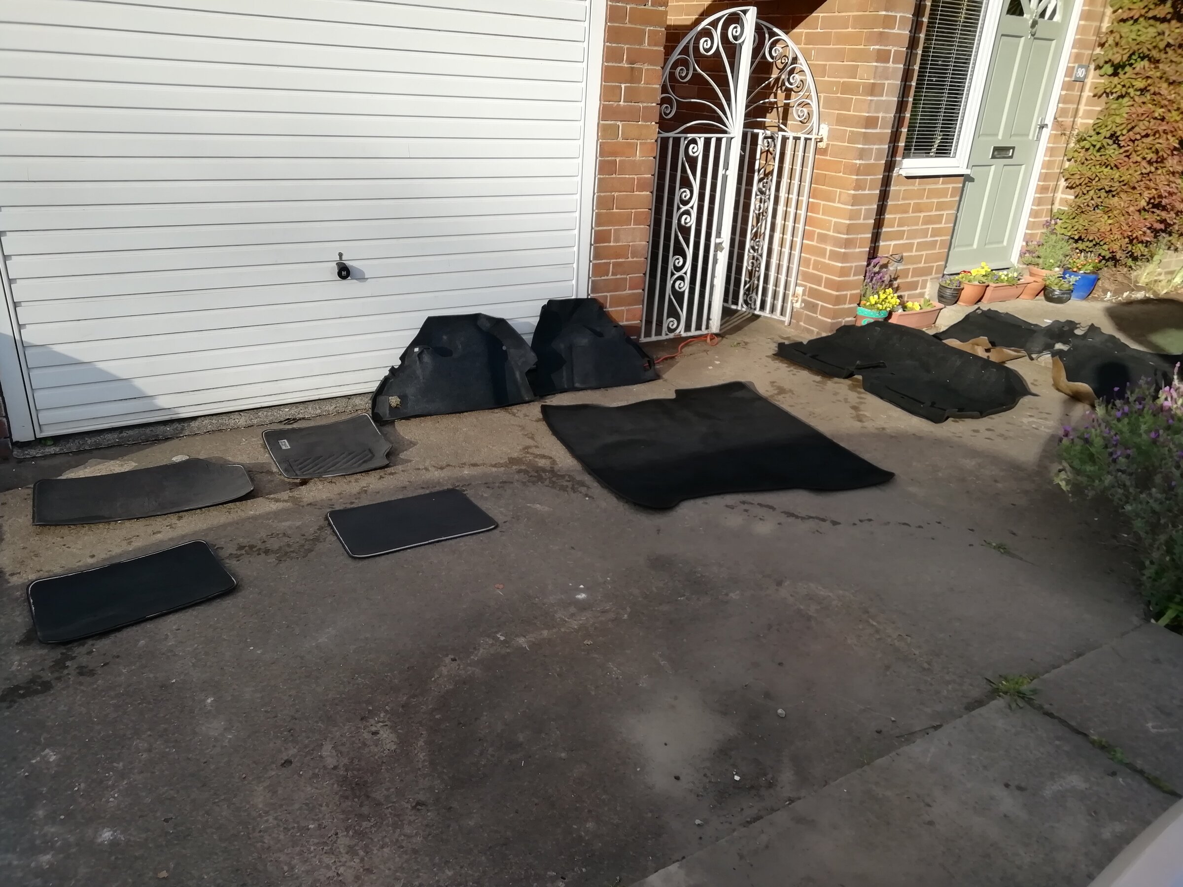

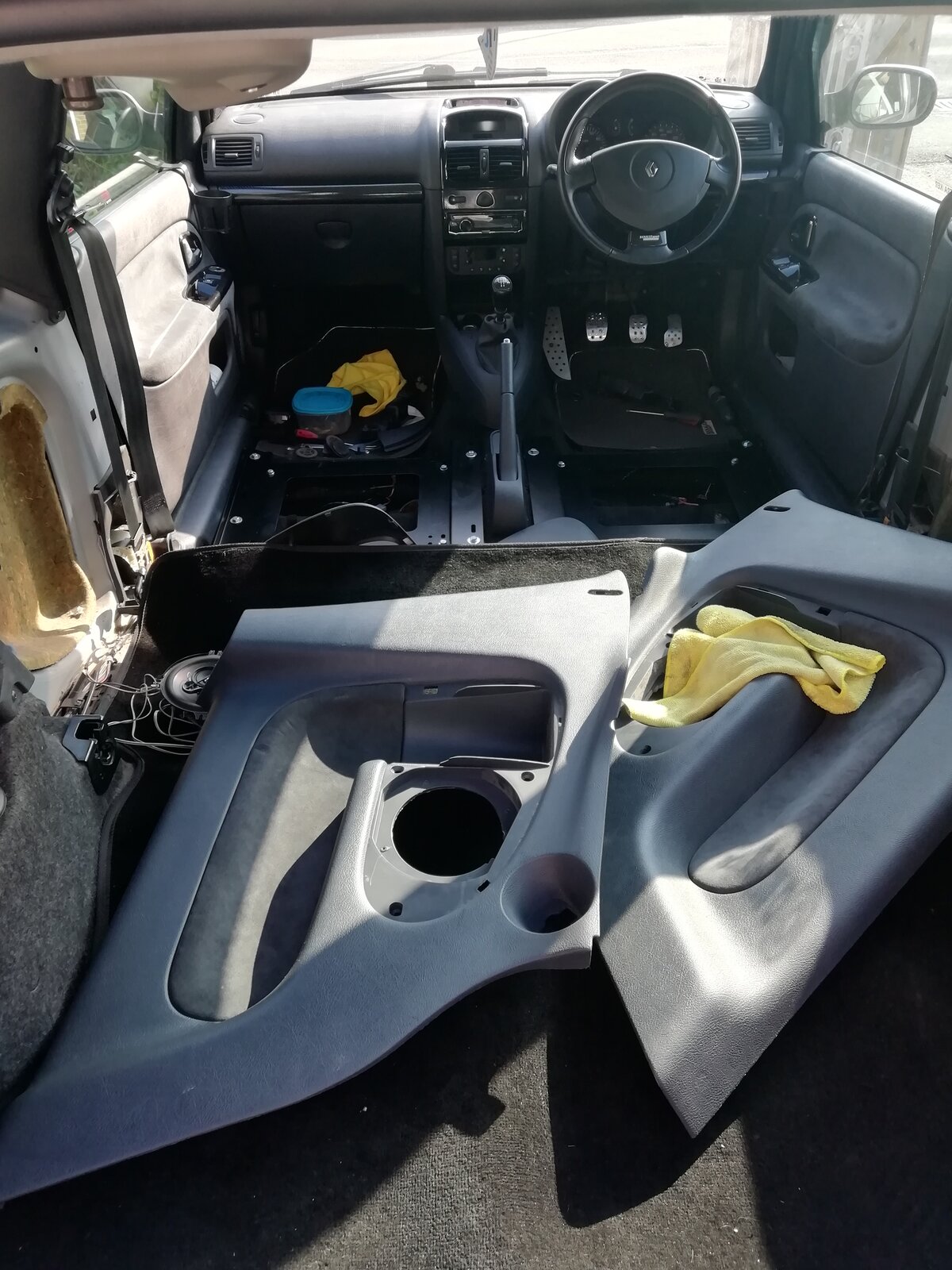

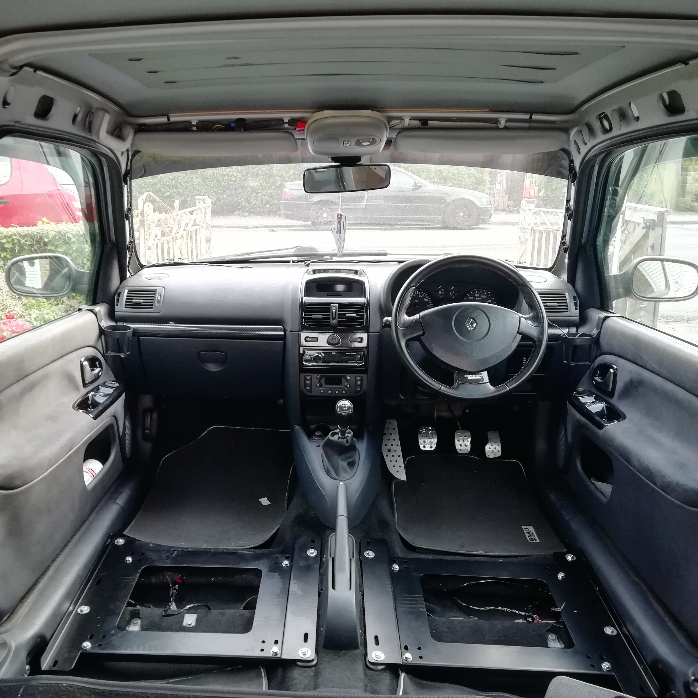

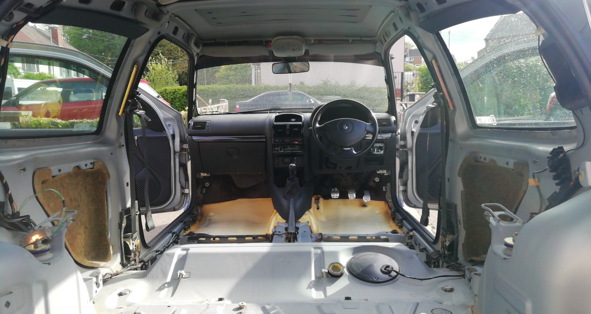

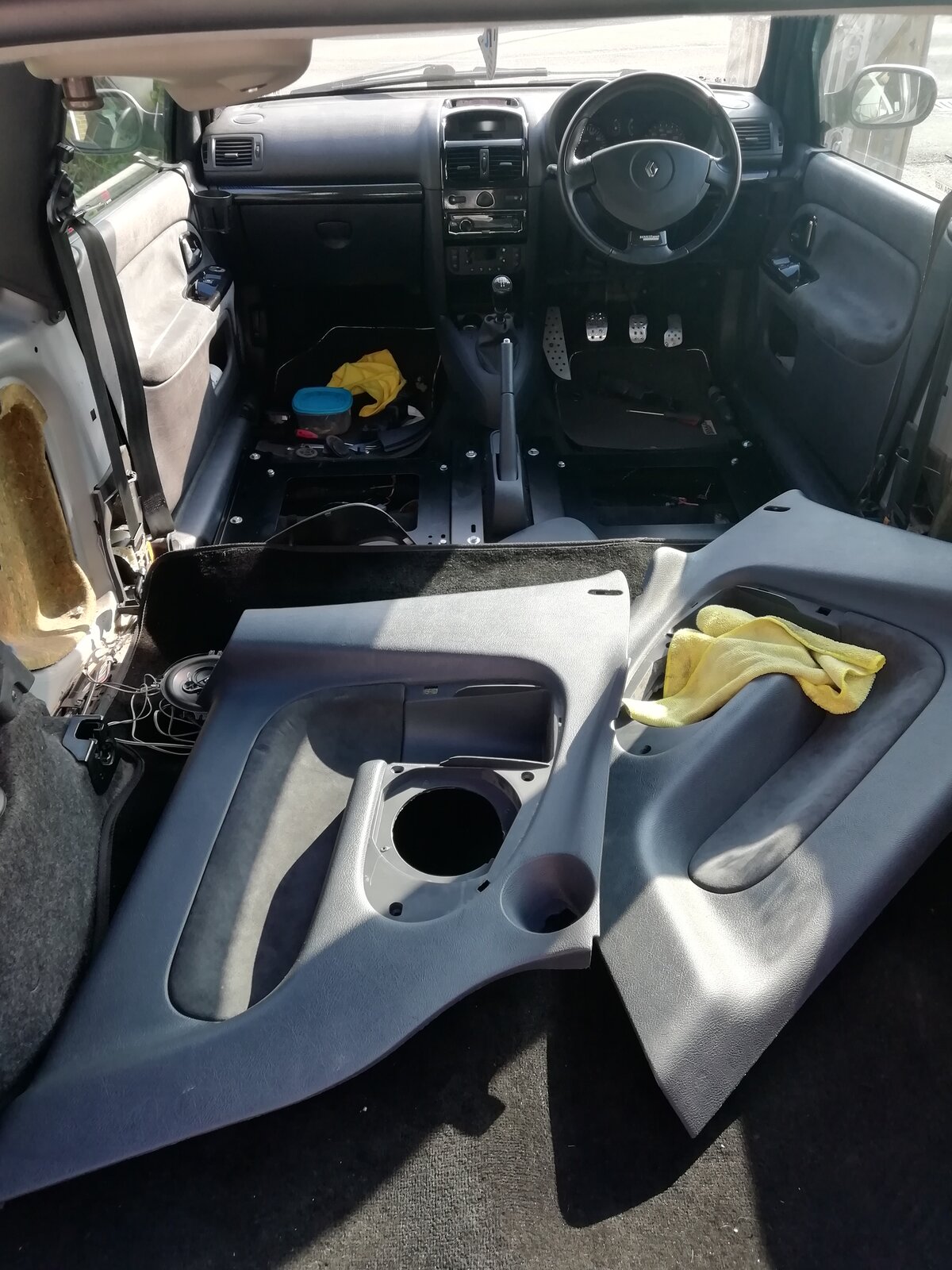

Got a few photos of starting on deep cleaning the interior, rust preventing inside the rear arches/sill bits. Just waiting on the Hydrate 80 etc.

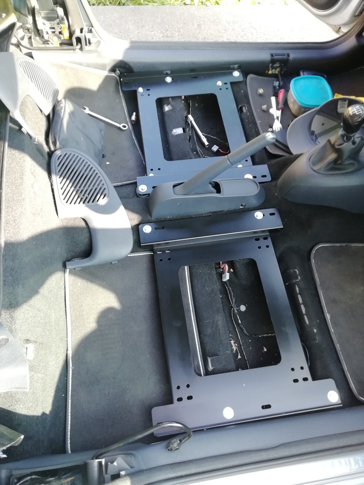

And also test fitted the Jon Foz Subframes ready for my new Corbeau Clubsports that are on there way.

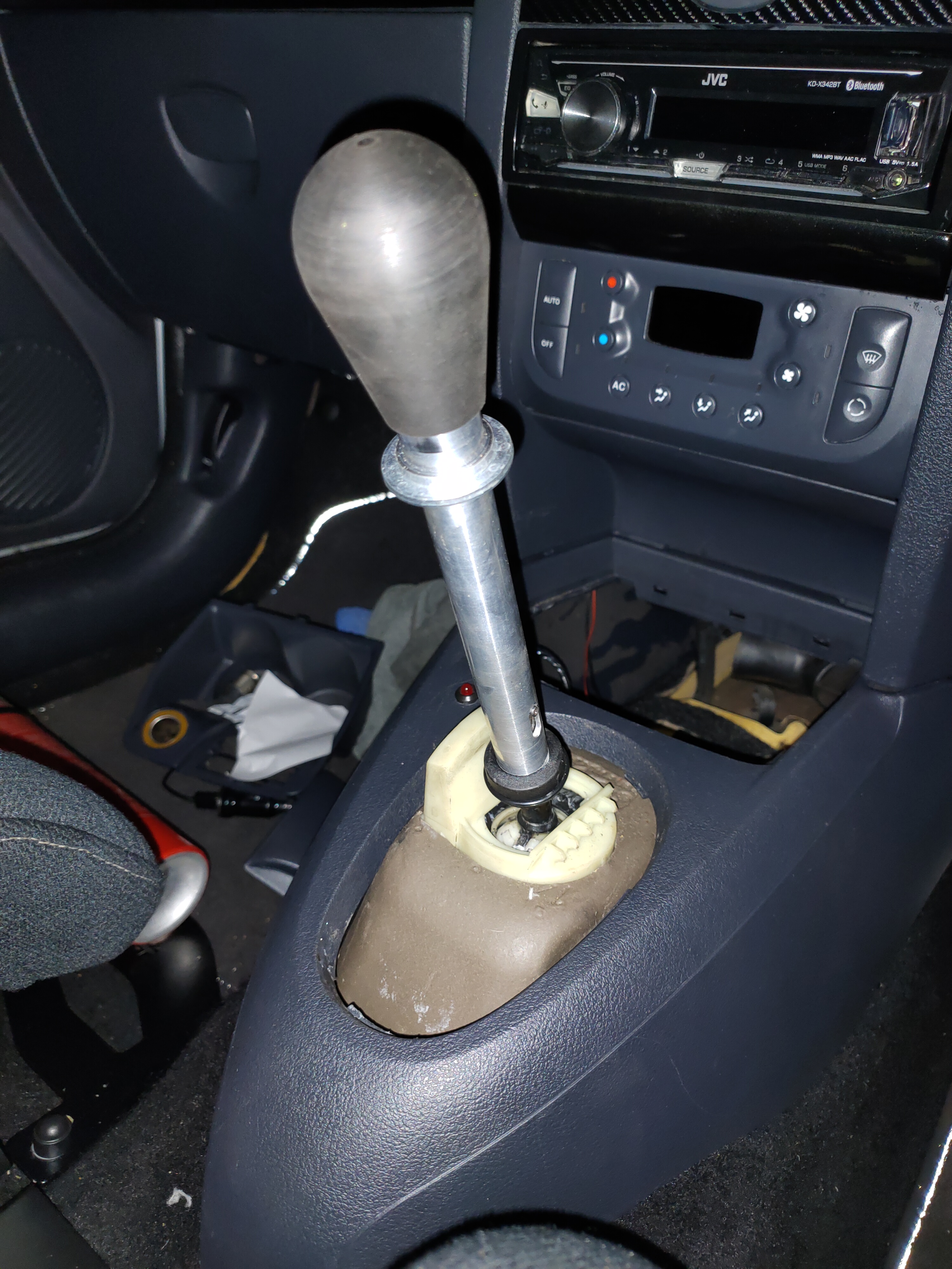

Wow an old black and decker electric screwdriver or is it a bosch? Also what's the fork for?

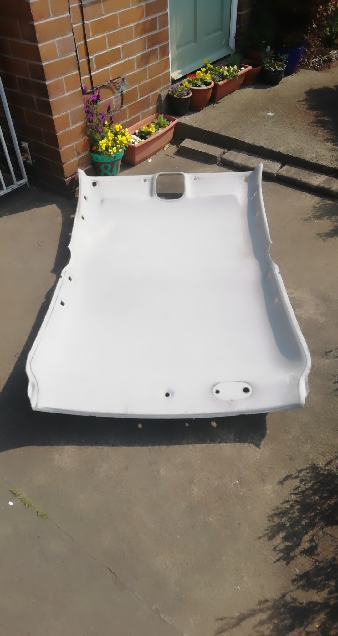

So today I got the headlining out ready to retrim in alcantara

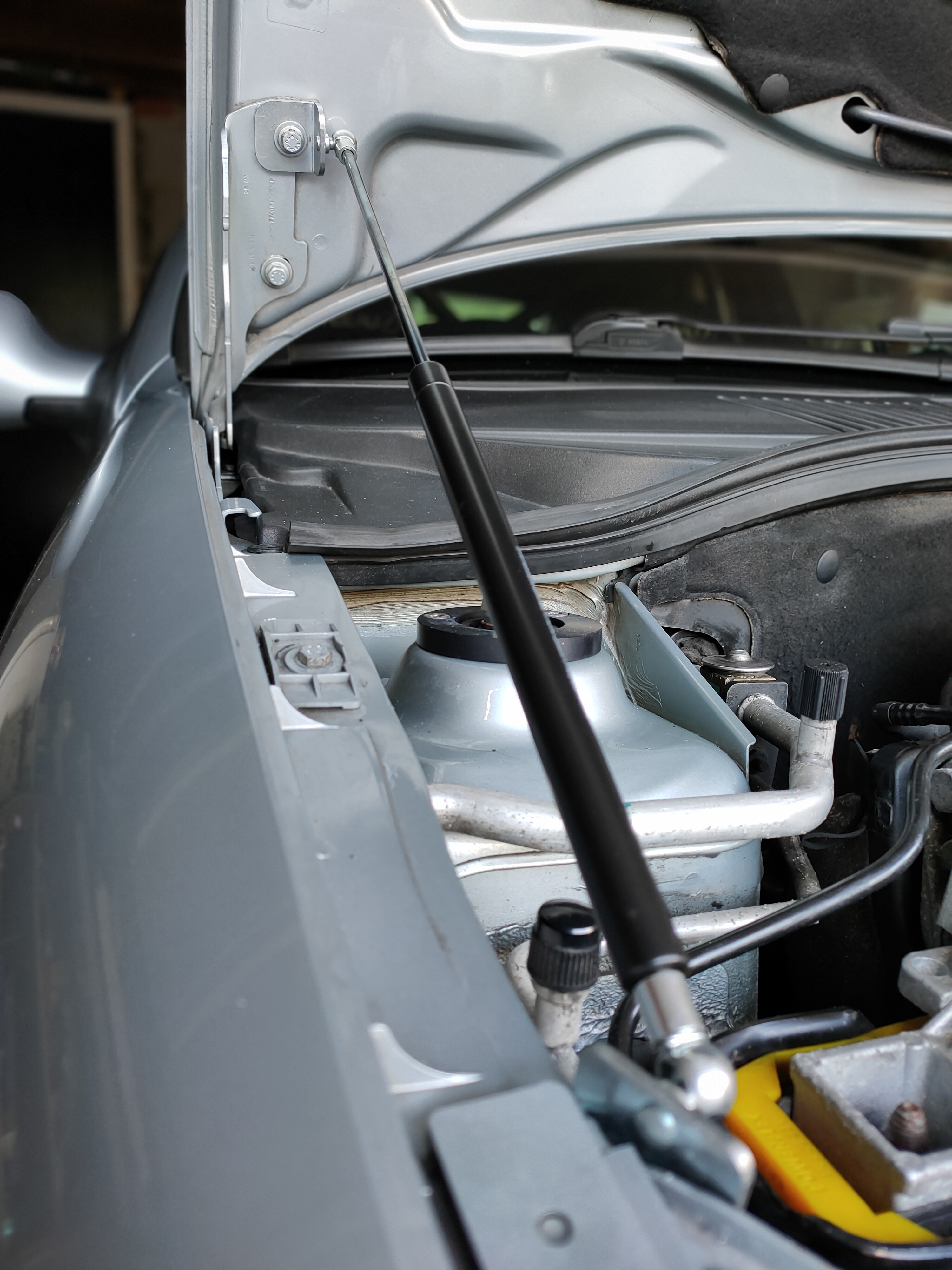

Gas bonnet struts
