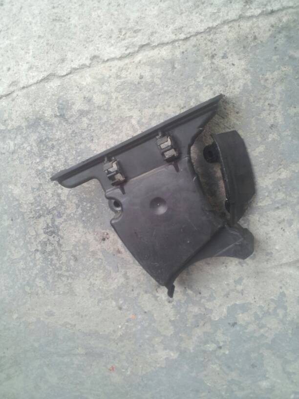

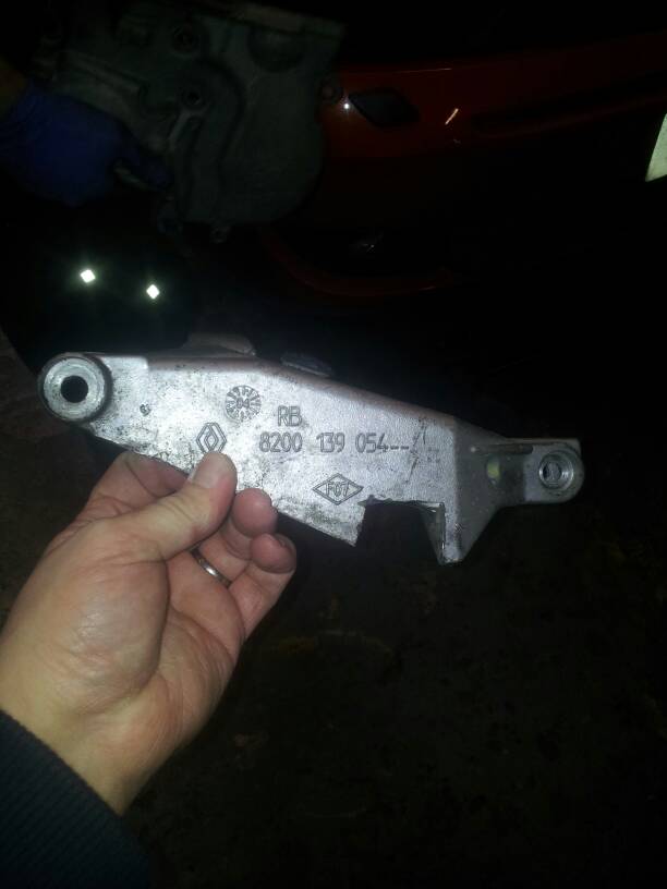

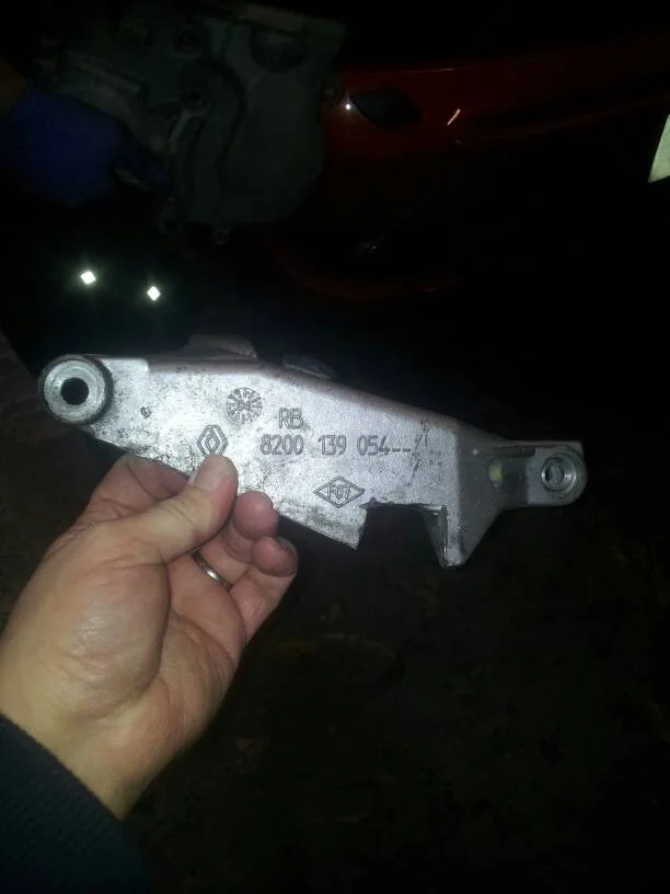

A good example of a cambelt change by a garage without the correct tools or knowledge (from my cars cambelt change in January, 2 years early and after 20,000 miles)
Aux belt tensioner support bracket. Grinded out so the tensioner could be fitted, incorrectly, as they couldn't get it in.
Mid timing belt cover. Snapped at the bottom and glued back together as they tried to put it back in the wrong order.
Part of one of the pulleys was also bent. So Mick replaced it FOC.
