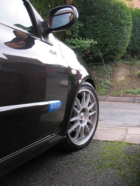

this is what im on about. stole it off danny
relate that to yours where it is totally flat and the sideskirt fits underneath it.

I suppose you could cut your skirts to match the angle? But most likely wont look neat.

cant my current sideskirt just overlap the 172 wing... look at the red line on dannys 172 wing.

no it wont, they interlock and ur current ones will hit the botton part of the wing there, u'll either have to cut the diagonal bit out or get new skirts.

Yeah, the picture of the sport wing is deceiving. It's actually alot wider than the standard one near the bottom, so no chance of your skirts overlapping.
