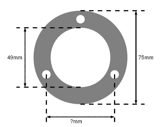

bit vague, but can anyone make a couple of metal rings? how much would this sort of thing cost?
thickness = 1mm. holes are to fit M8 bolts, i can confirm distance between bolts later.

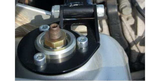

it's to go around the top of the bodywork on my solid top mounts. like what the strut brace does in this pic.

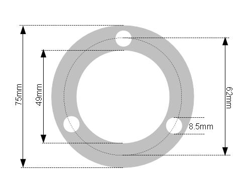

the holes are 8.5mm diameter and they are on a pcd of 62mm with equal length between them. i'm gonna try and draw something up in office(!) don't laugh.
  172DD Cup
two of these please
width anywhere between 1-1.5mm. you can see in the top photo what its used for, so whatever you think is best.
