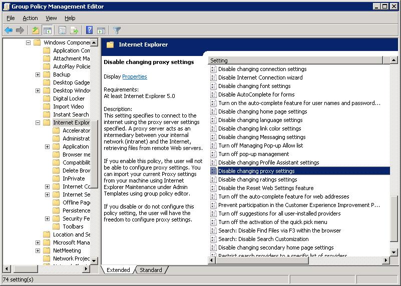

You need to disable changing the proxy settings then.
User Configuration > Administrative Templates > Windows Components > Internet Explorer > Disable Changing Proxy Settings (as below).
Yo' daddy - I am he.
it was already done like i said i think they were running ie as another use that does have the privilage of been able to change proxy but i have just gone through their GP and disabled more stuff now too
