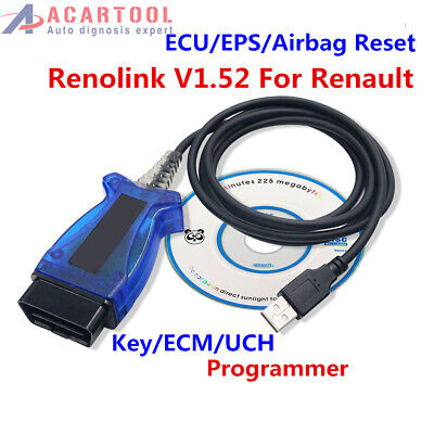

Ren0link is epic for programming keys too if you want to invest in some more software and an obdSX lead. It has an option to pull the isk/pin off the uch, super easy to do.
Robbie Corbett
Like this @Brigsy?
In fact i think it was you who recommended the CAN clip I bought - it works so cheers :)

@Touring_Rob the cartool version with red cable should be ok, i use the same cable and version 1.87, i got my cable off amazon and hoped to use a “borrowed” copy but ended up buying a licenced copy as my lead was blocked, was not too bad around £50 on ebay.
Clip is great, might be worth having a shot on coding keys with it if you have isk/pin available.
